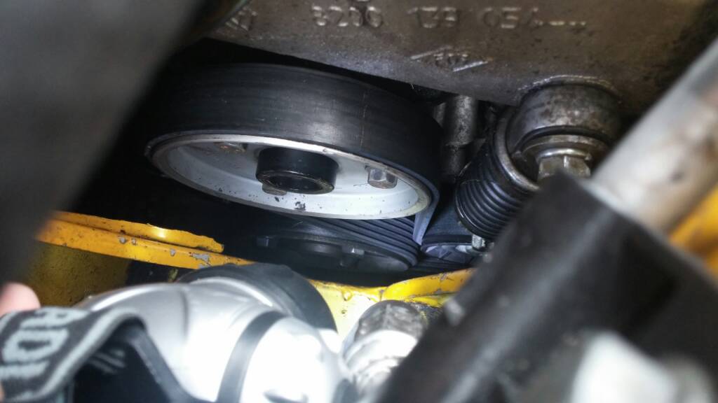

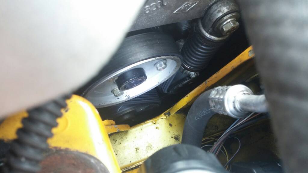

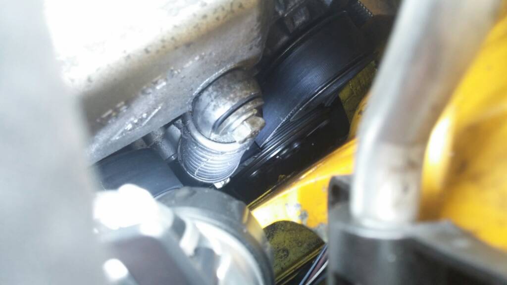

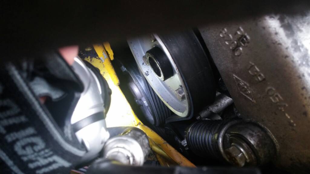

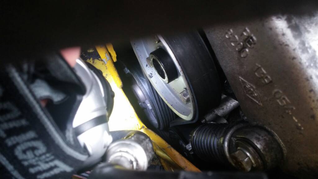

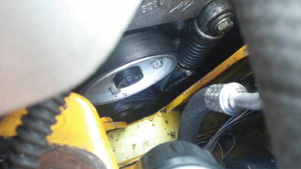

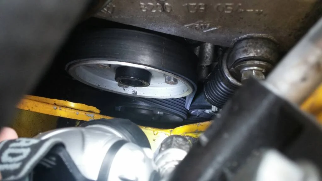

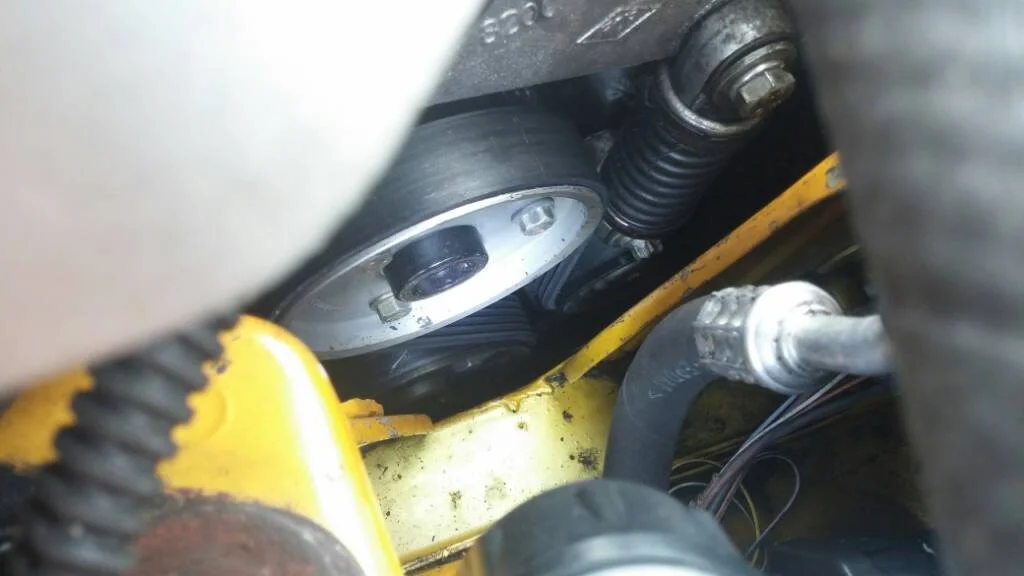

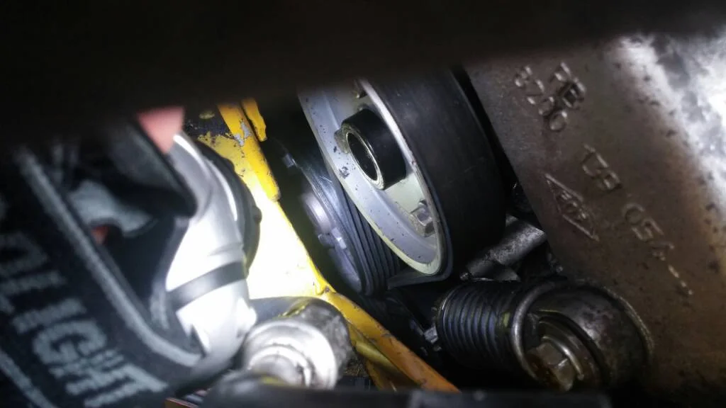

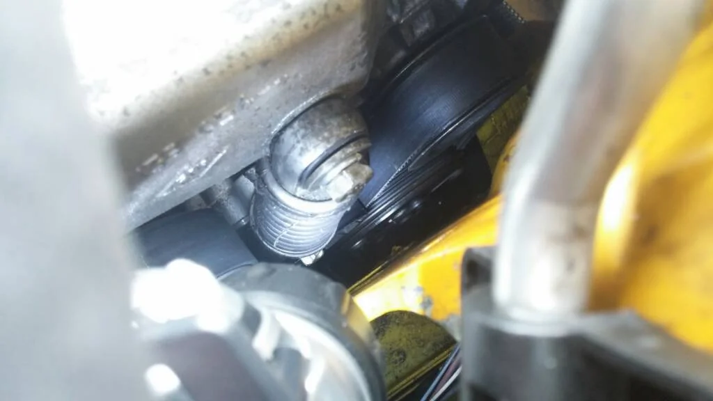

Have they fitted the belt the correct way round?
uploadfromtaptalk1409402516926.jpguploadfromtaptalk1409402523984.jpguploadfromtaptalk1409402529583.jpguploadfromtaptalk1409402536734.jpg
It's hard to get a decent pic. Does that look right?
I can't see any bubbles or foam in fluid res. Apparently that's a sign of air in system.
It's probably the pic quality. It's a new belt.
Once they fitted it I checked the belt and there's blue writing/branding on it that I could see and it looked brand new. No dirt and printing looked unworn
