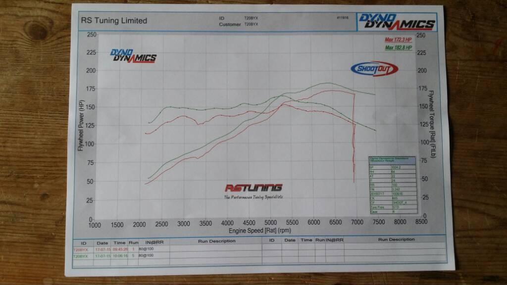

I have a graph of my car with a ktec induction kit, Scorpion cat back with janspeed ktec sports cat and a map from RS Tuning a few months ago so will get a direct comparison to what difference this will make!

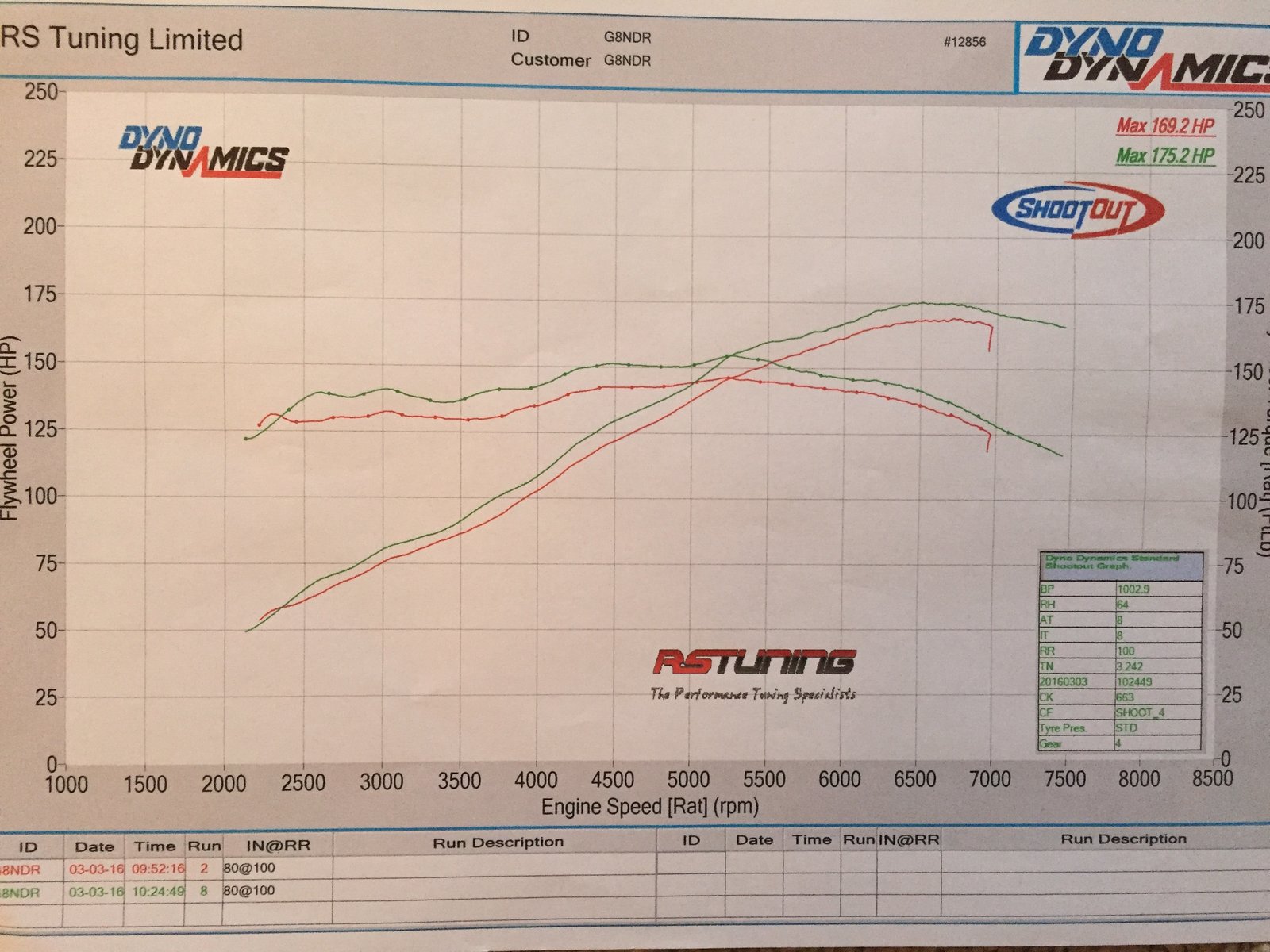

bashracing
this is before, smooooth like gravy,
But you can see past 5500rpm it's starting to struggle for breath
  BG Clio 182
Mine with the mods mentioned in post a couple above. I'm hoping for about 193 upwards

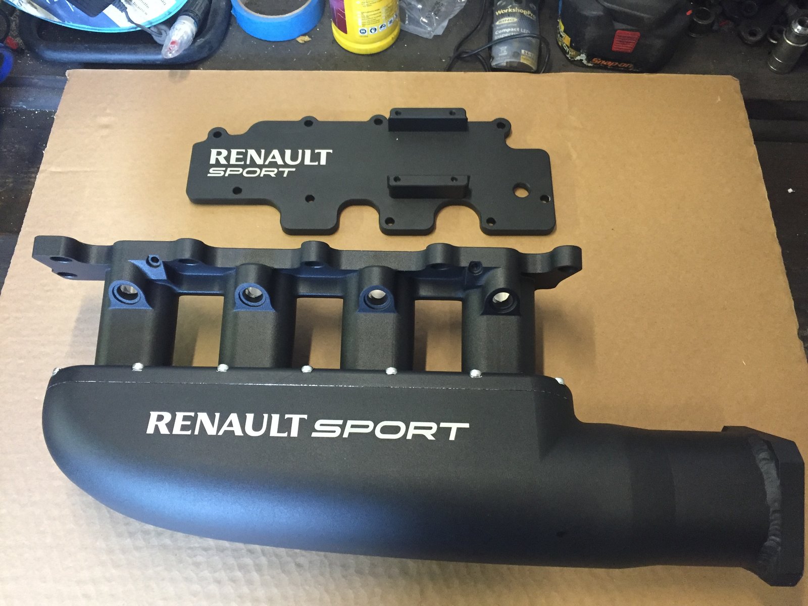

Surprised how good they look with the RS printed on them. Good luck with the mapping

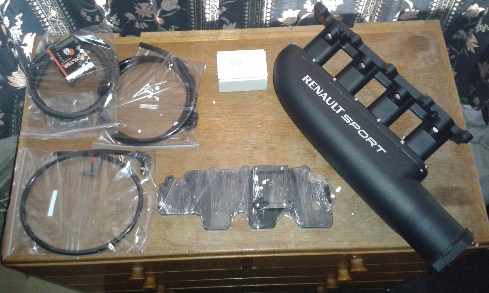

My intake is currently sitting at the Post Office, I'll try and pick it up over the weekend.
