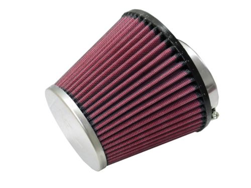

I've been searching through various filters to use, I prefer the K&N gauze type. The largest I have found, which would fit between headlight and battery, with an offset flange is this one (it looks angled but it isn't) - couldn't find an appropriate one with an angled flange which I would have preferred. Will see how it fits.
http://www.ebay.co.uk/itm/391298688938?_trksid=p2060353.m1438.l2649&ssPageName=STRK:MEBIDX:IT

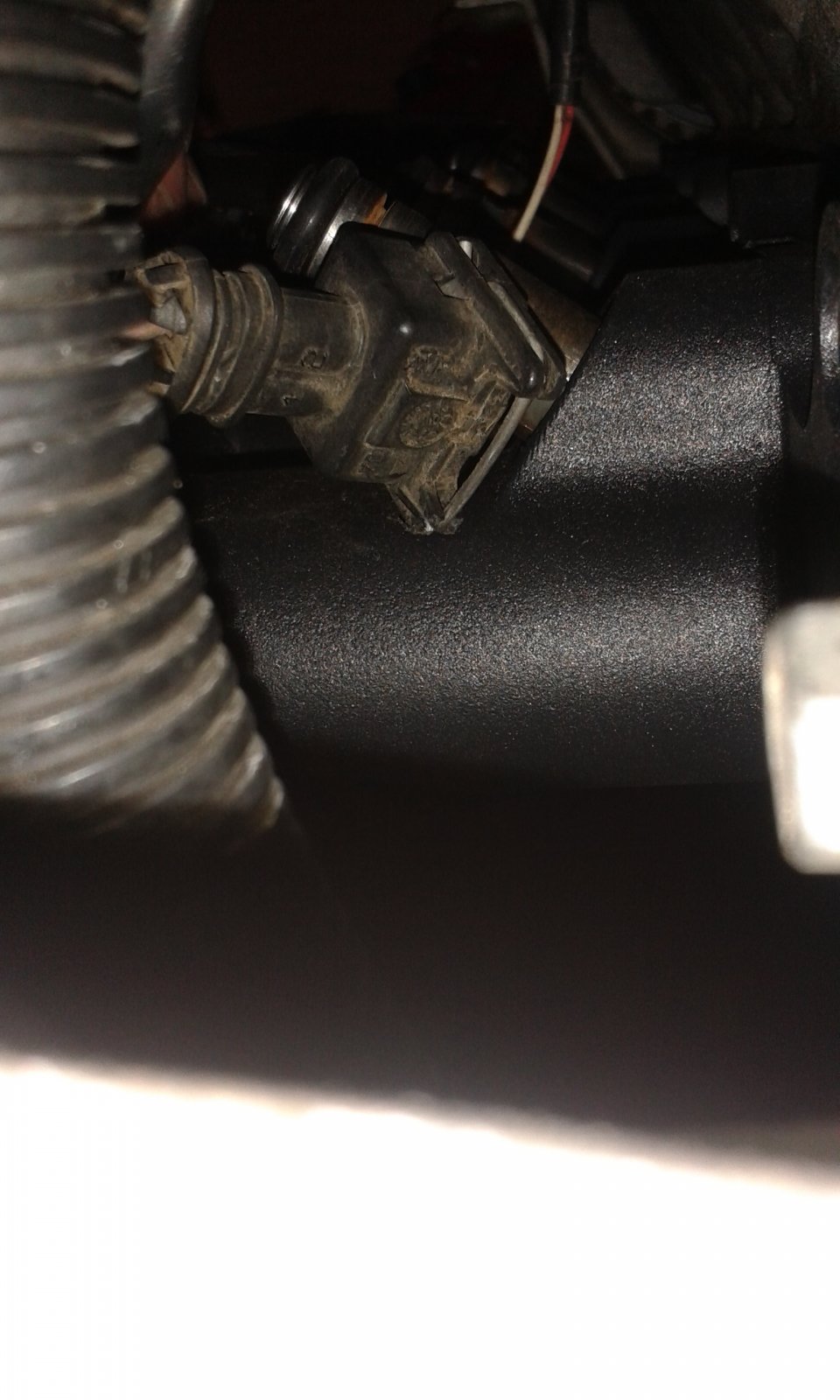

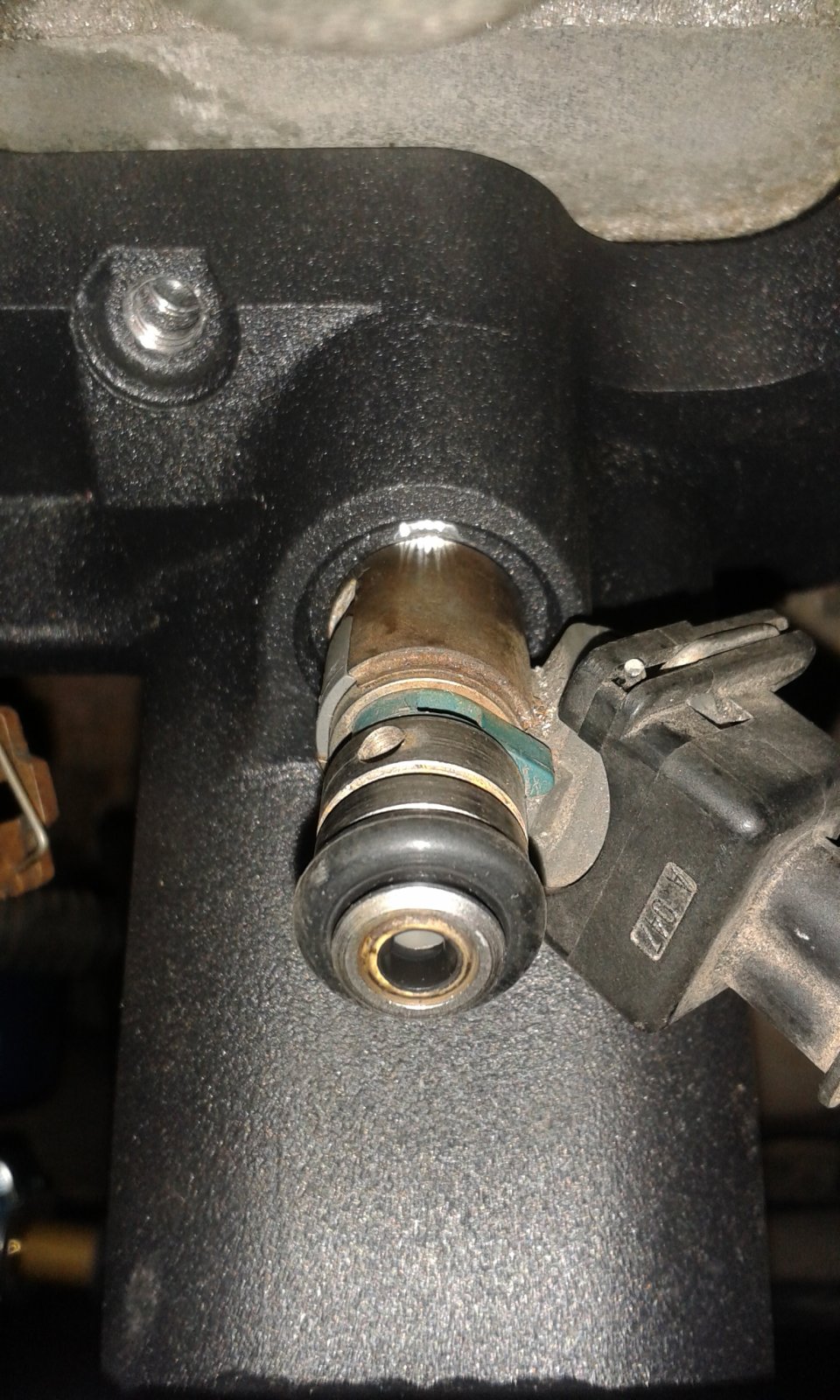

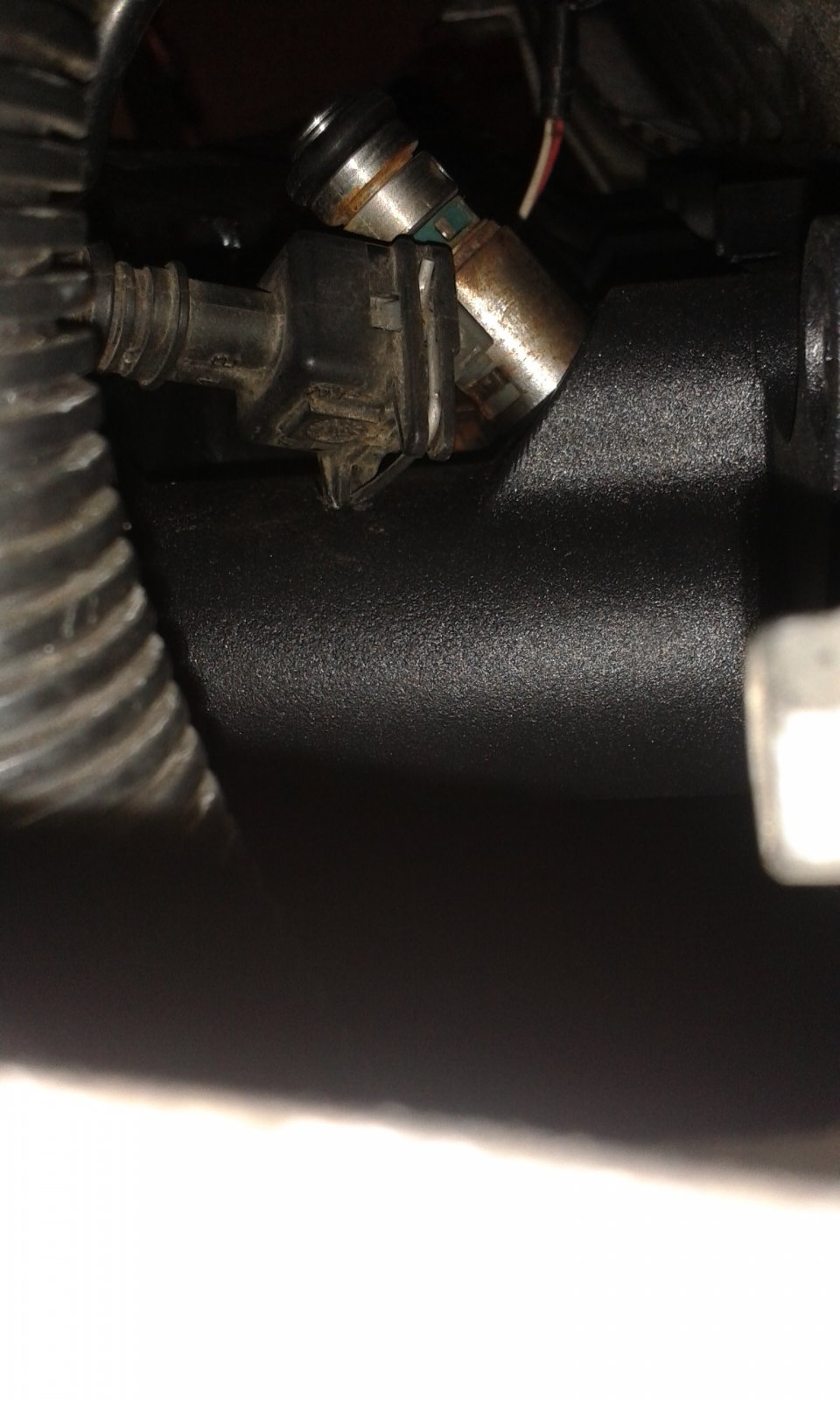

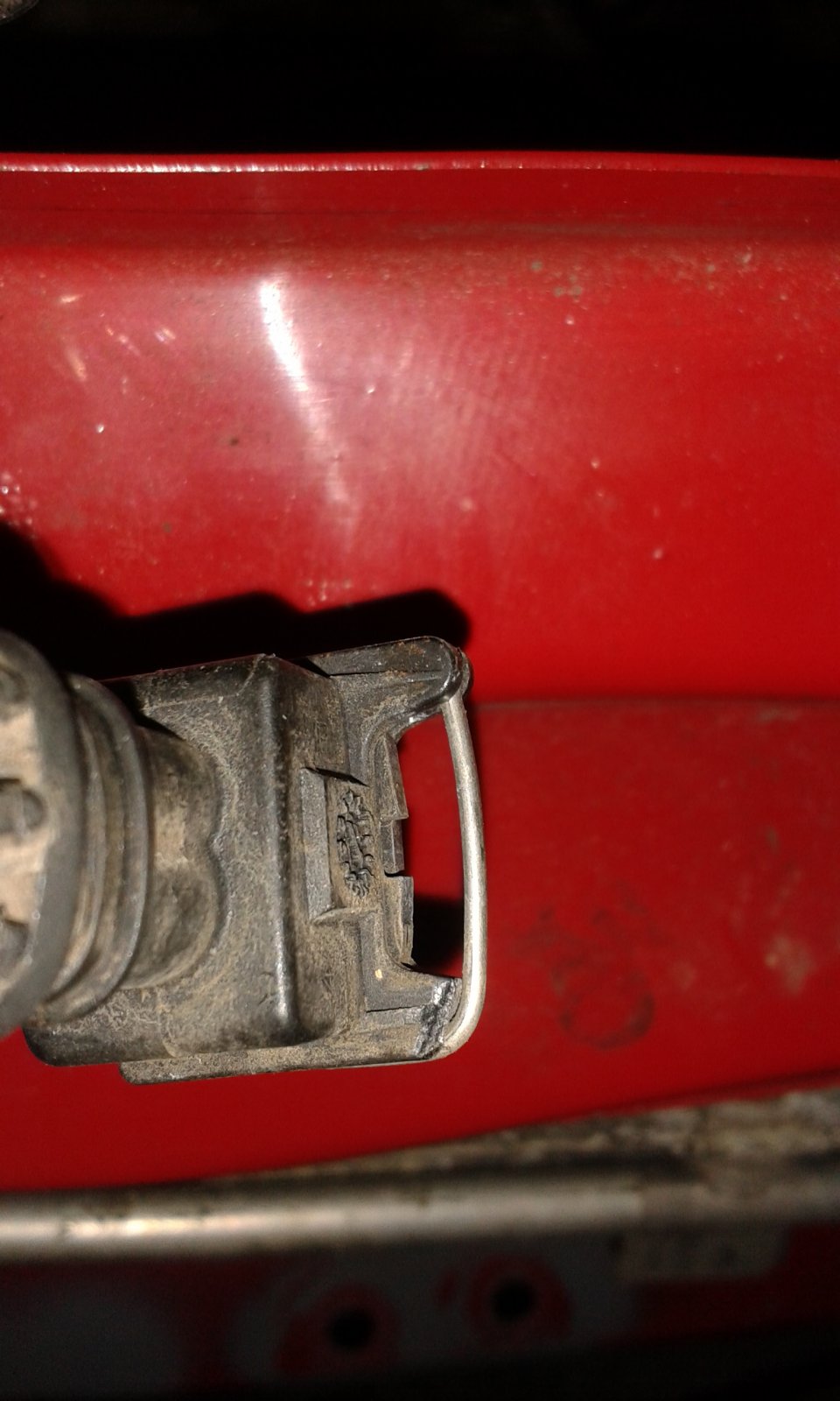

How have people got round the injector plugs clearance issues (which applies to all 4)?
This pic shows the angle of the injector when it sits square on the seat.
But its twisted so the metal clip can't engage in the hole.
If you twist it back to where it can engage, then the connector plug causes it to rise and not sit flush - you can see the o-ring starting to protrude.
I tried cutting the corner off the plug but doesn't help enough.
I may have to remove the corner completely and do away with the spring clip and secure them another way but would rather not use zip ties.
Any other solutions?
