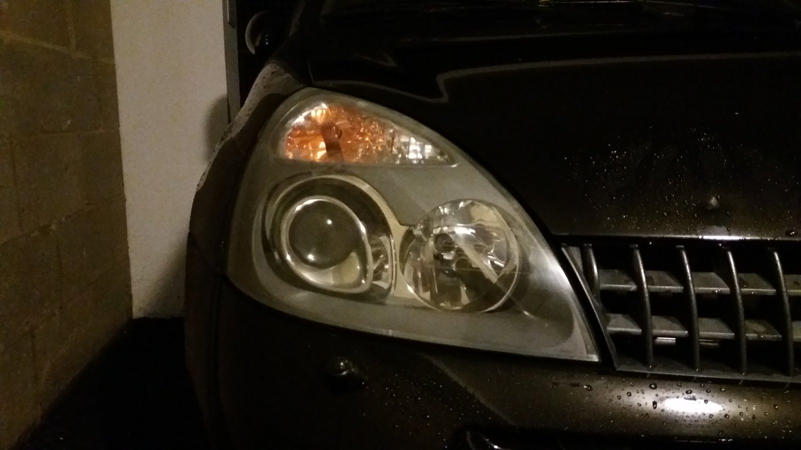

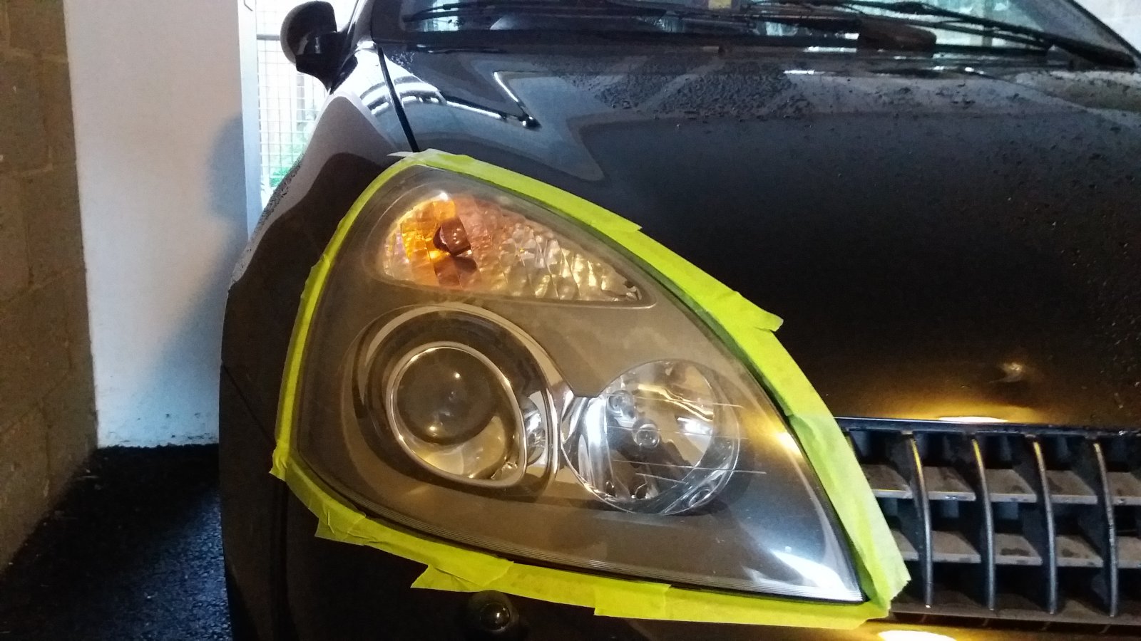

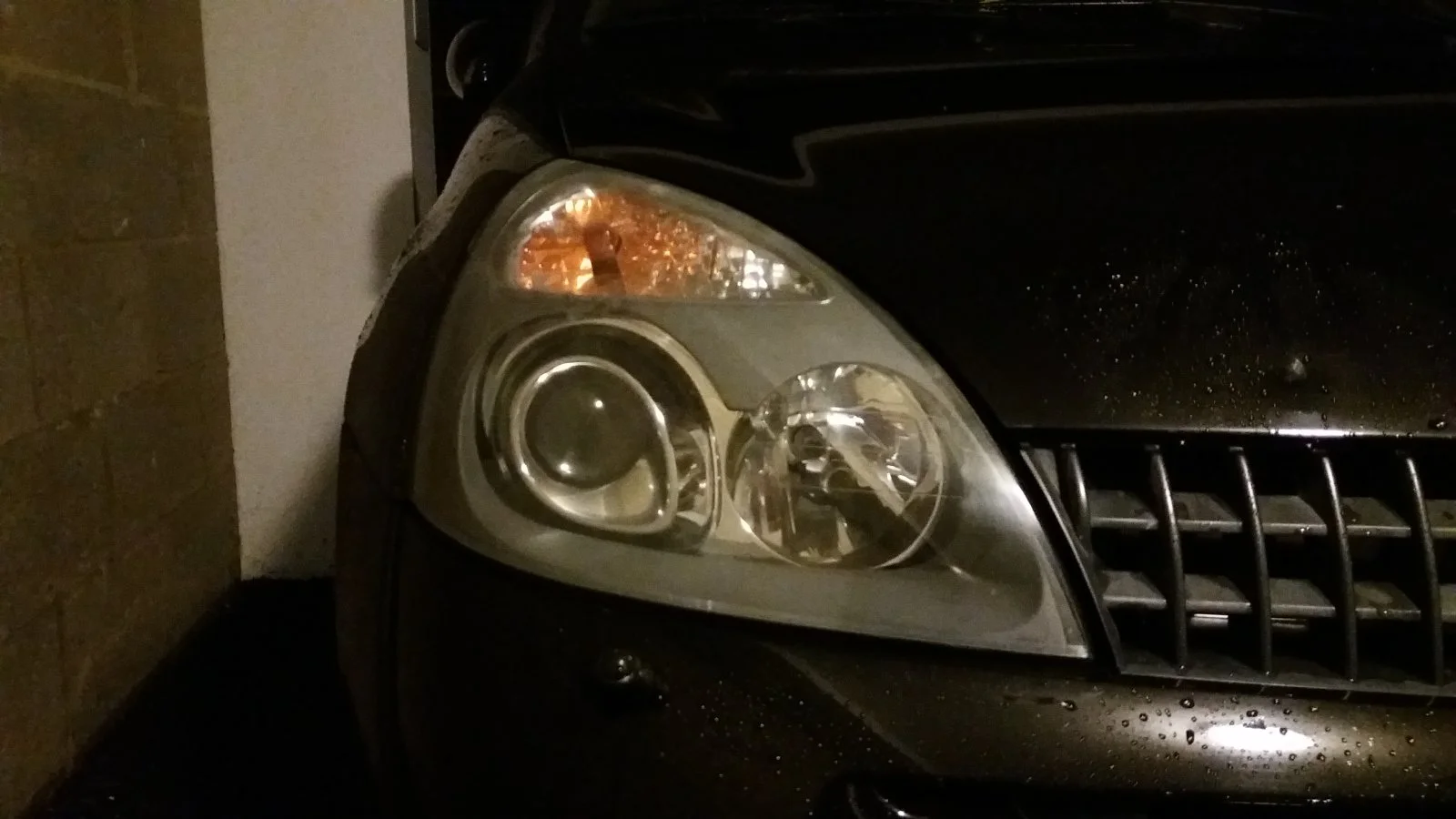

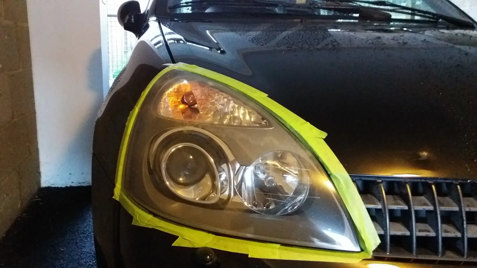

Restored the headlights tonight using the 3m restoration kit, looks much cleaner. Going to attack the bodywork next, get a nice shine back from the black gold paint job.

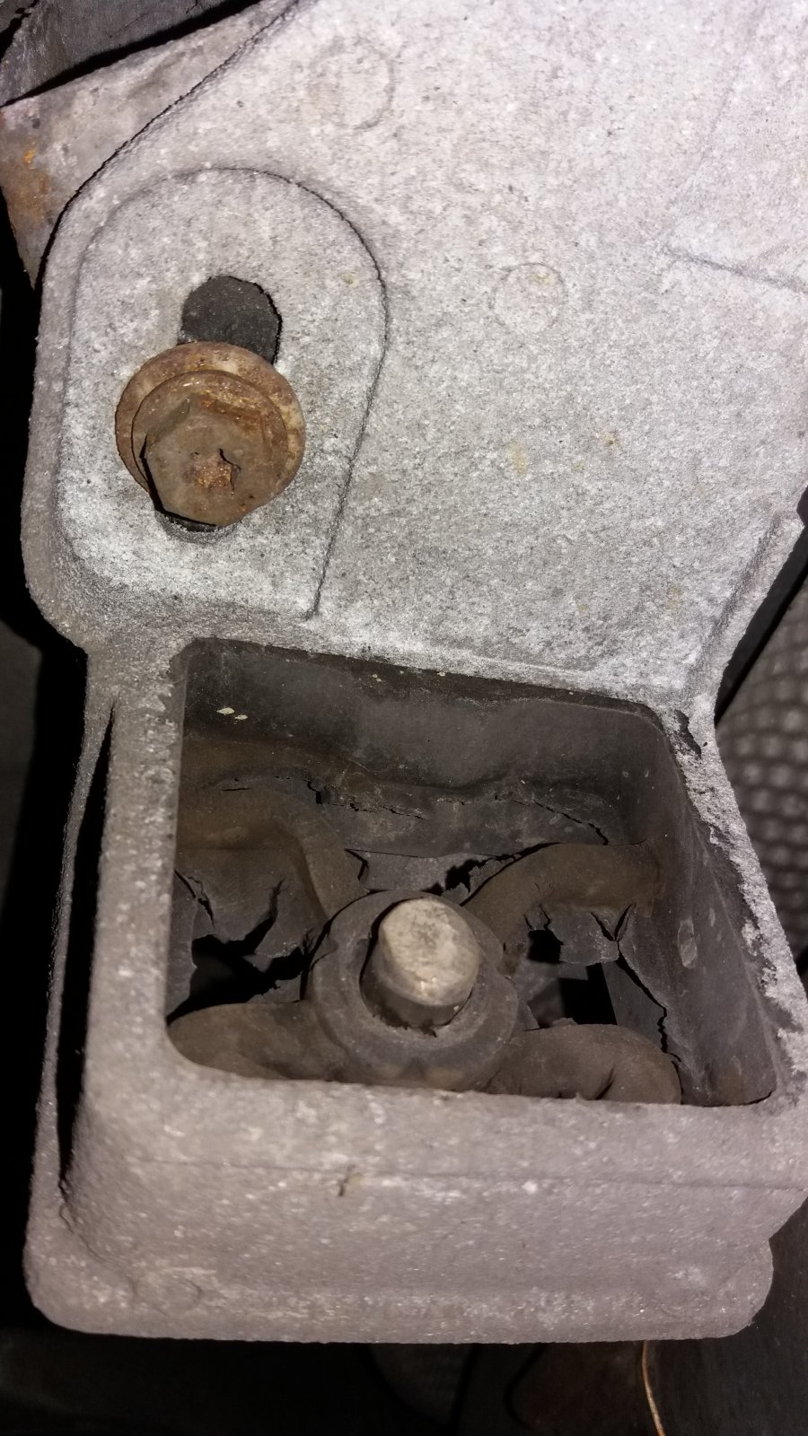

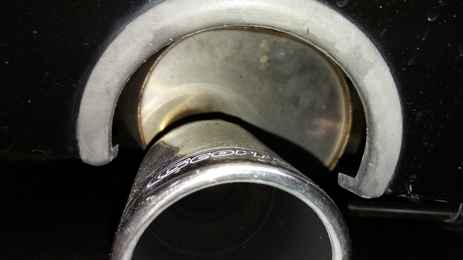

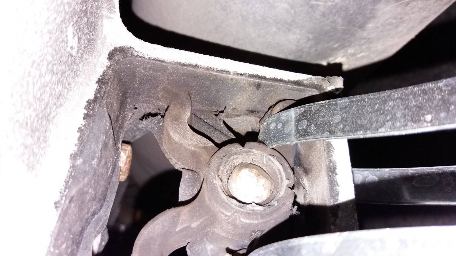

So the 182 went to the garage this morning to diagnose the steering squeal and intermittent PAS.

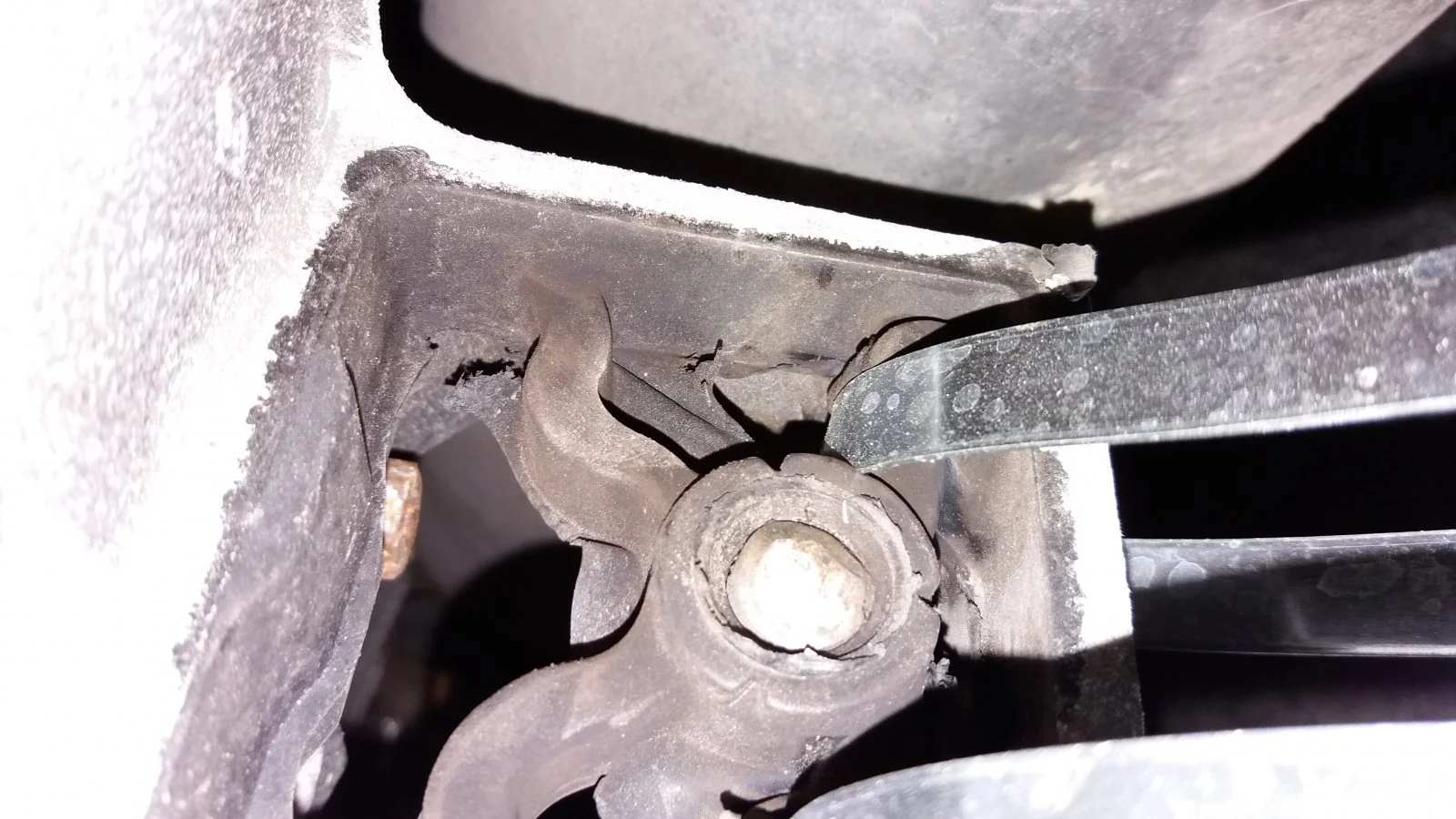

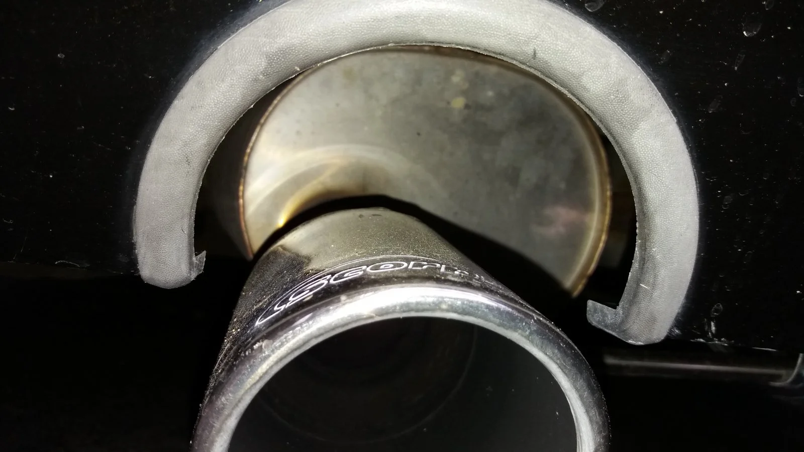

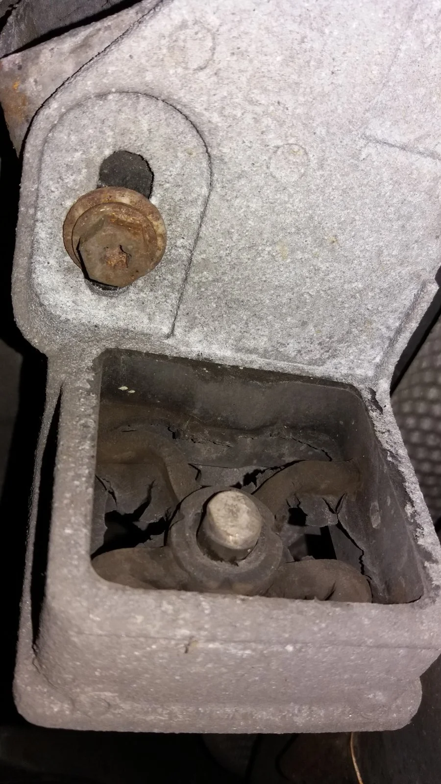

As i originally suspected the tensioner is rubbing on the aux belt, whoever replaced the belts earlier this year didnt align or retension correctly. Luckily the car hasnt been driven much or it could have been alot worse. £82 for a new belt and labour. Should have the car back for the weekend which means oil change (elf evo 900 5w40) and upper engine & rear exhaust bushing change for powerflex black. Couple of pics of the exhaust bushings. Also the exhaust, which is hanging ridiculously low.
