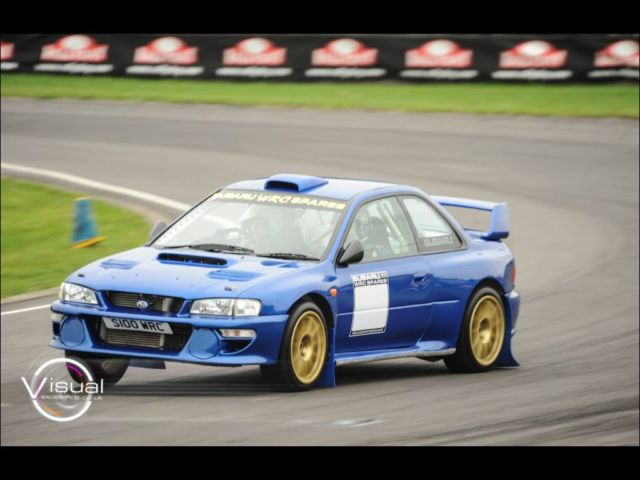

will decide in the next few months if I'm going to keep mine , plan on doing Epynt in march with it and decide from there as I bought a WRC Impreza today , p/x'd my GTR for it so going to play with the big boys now lol
Best of luck for Pembrey Ian! Would be a real shame if you got rid of the Clio but you've certainly not had an easy time with it.
Impreza looks great, anymore details of it? Never really seen specs of wrc cars

Love your new WRC Ian. Looking forward to seeing some more pics and videos of you playing (and I bet beating!) the big boys!

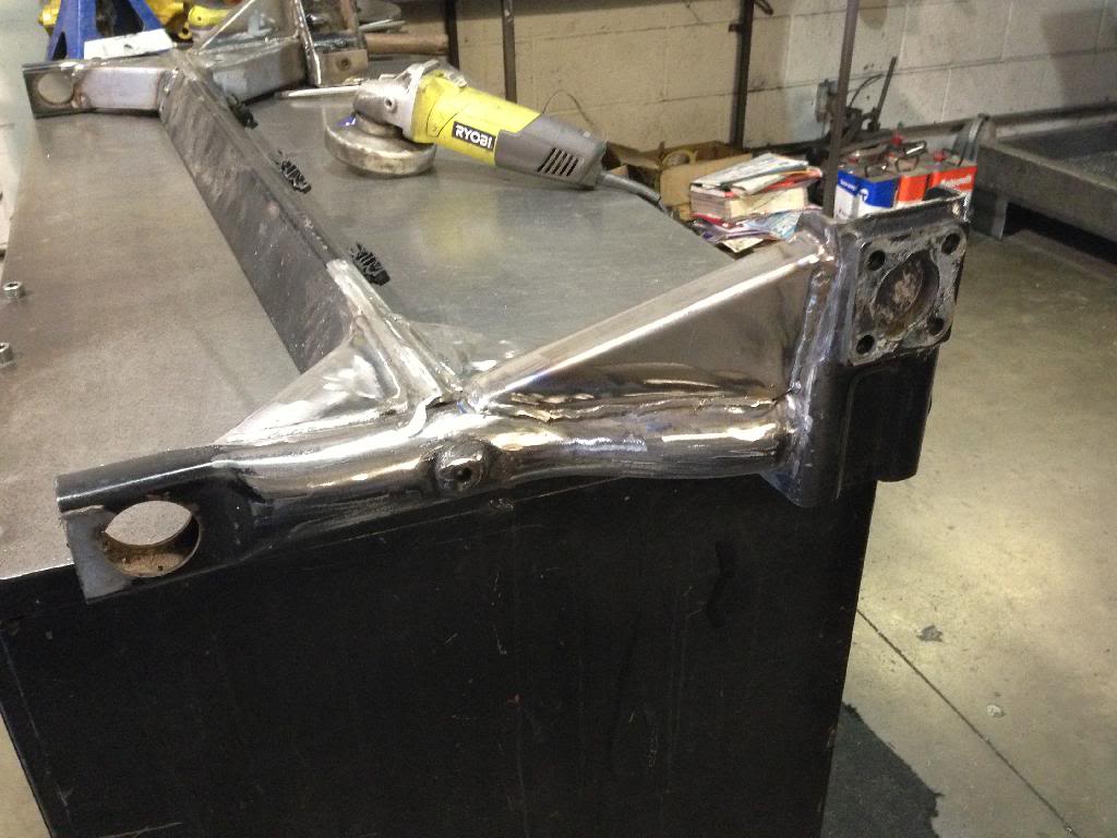

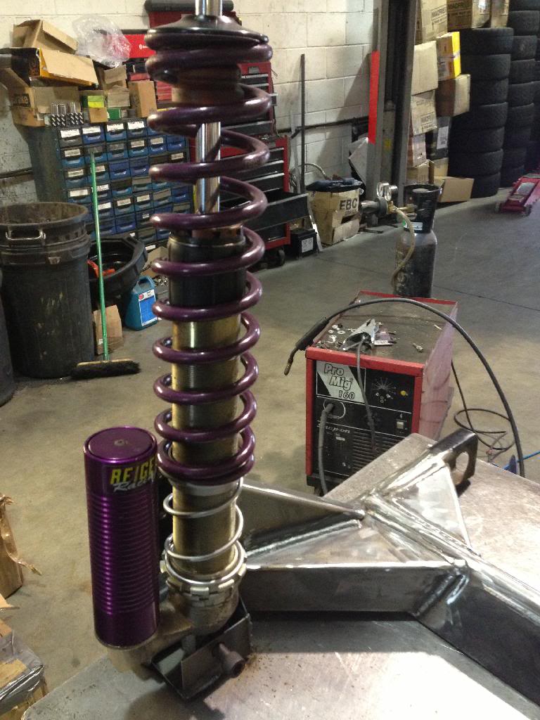

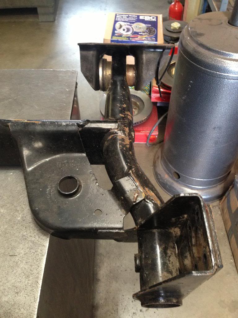

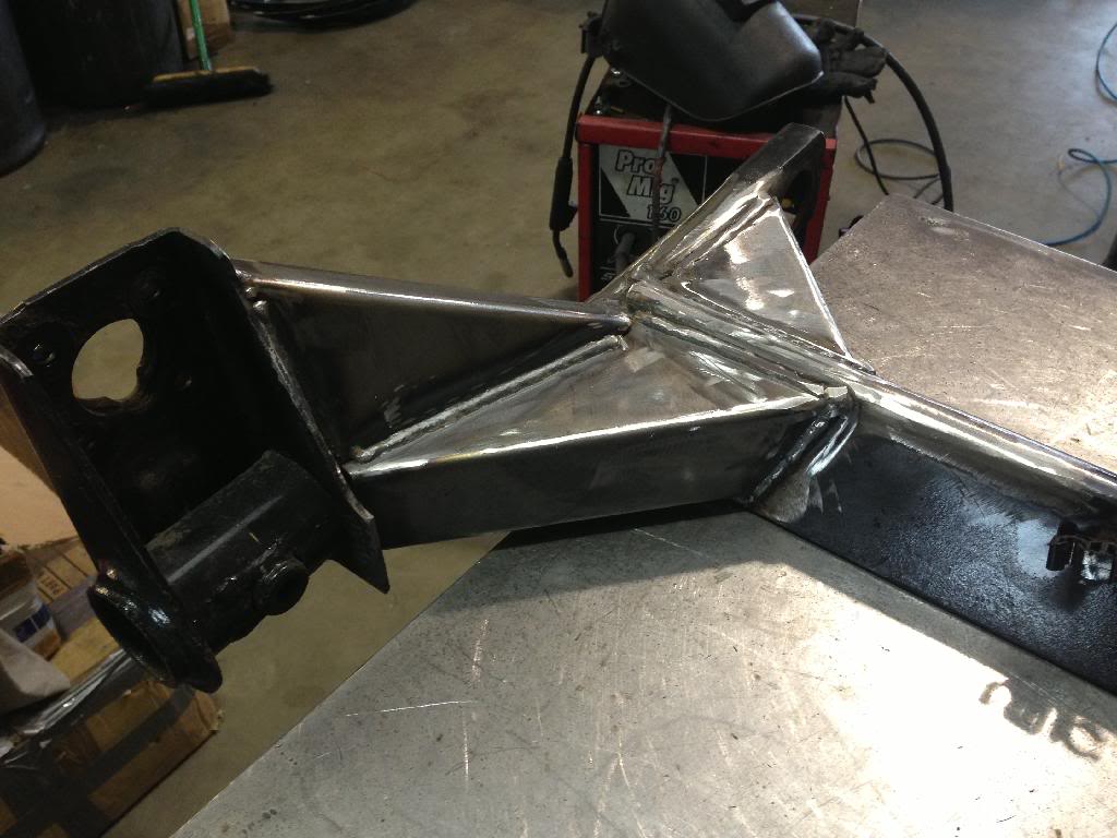

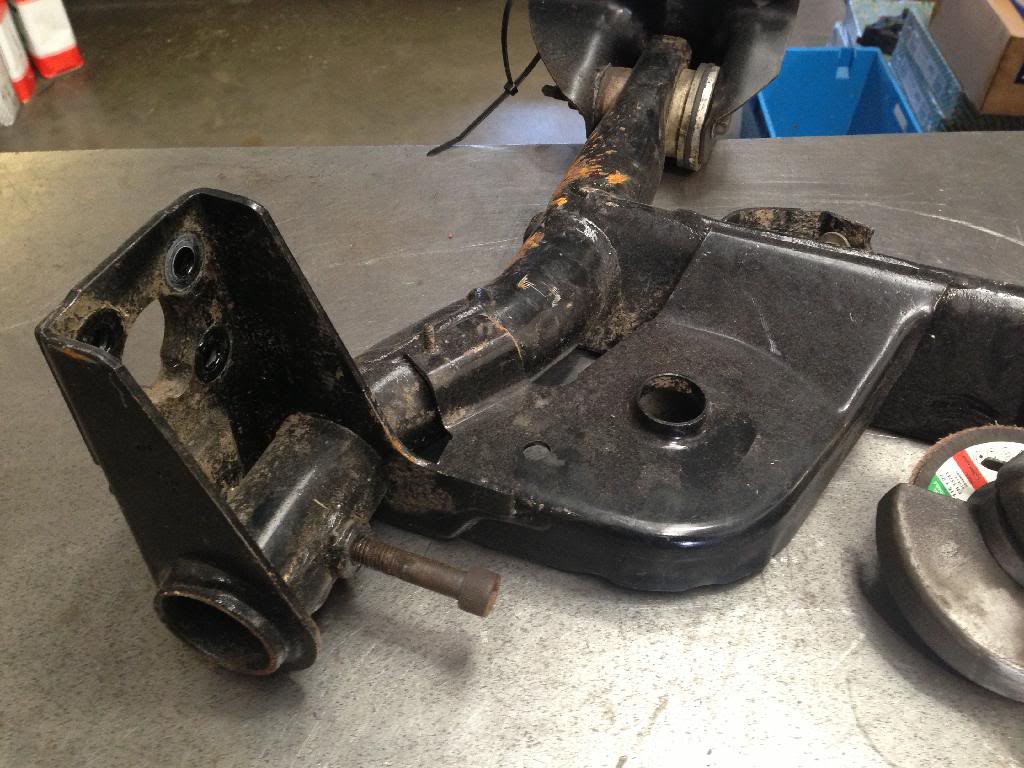

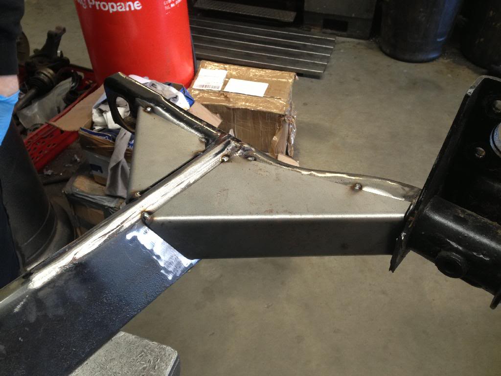

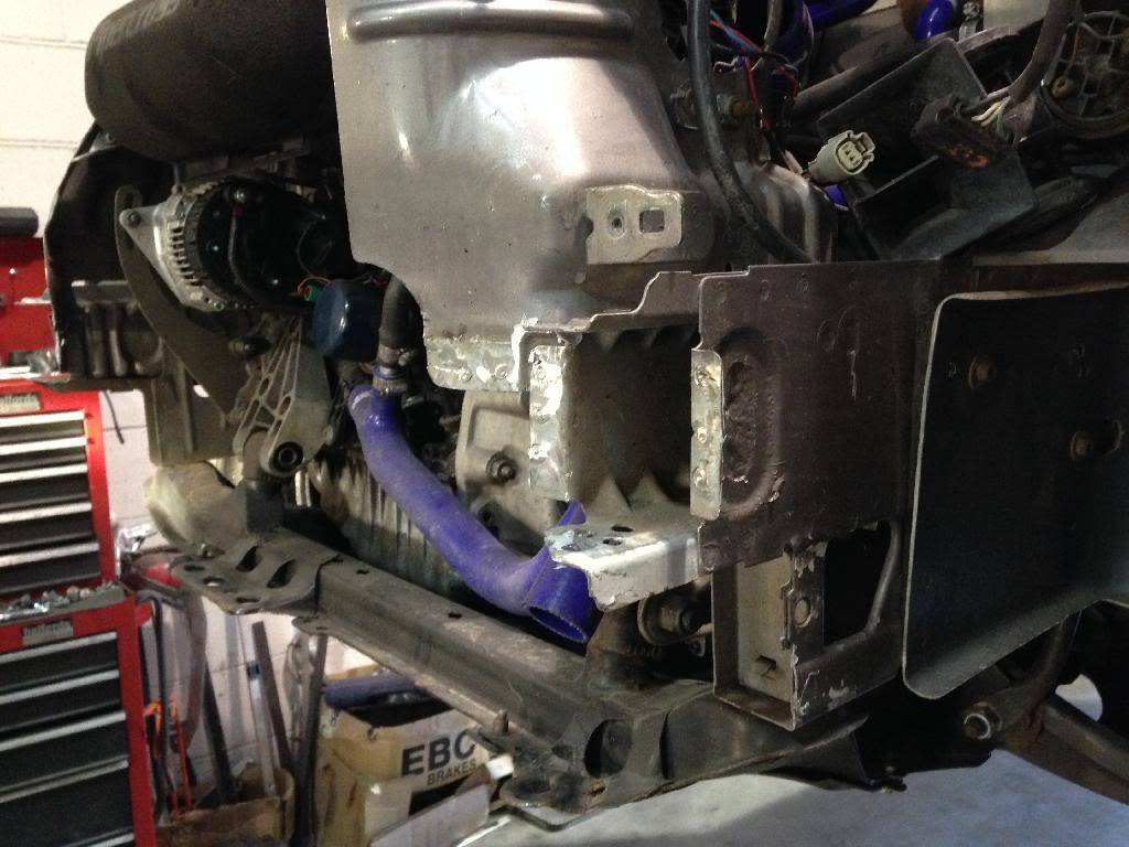

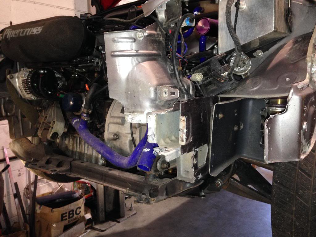

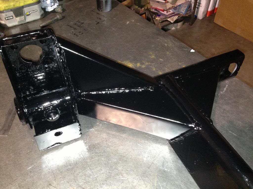

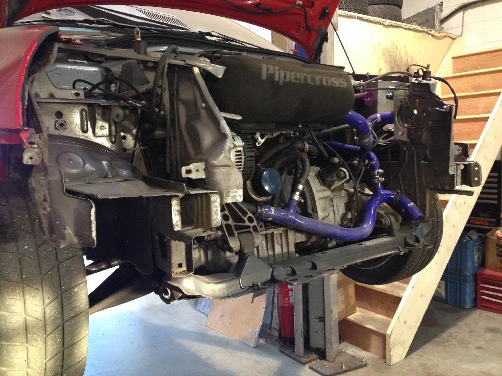

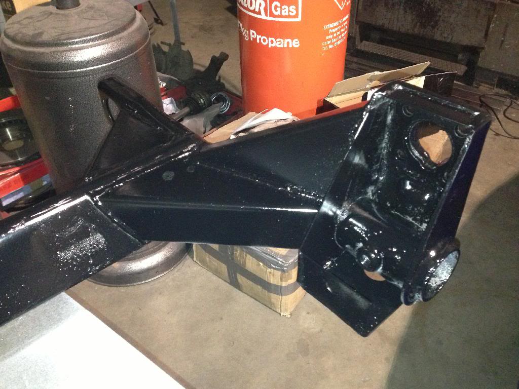

Thought i'd update where I am with the car , after the last rally in Pembrey the front panel was bent , so was the rad , although not leaking , so have cut the old cross member off and welded a new one I had on a spare shell , bought a new golf alloy rad and modified it to fit same as the last one , I have also bought the axle strengthening kit from Pure motorsport as I'm bending these really easily , and after the bearings collapsing thinking it was a damaged pin after hitting the wall in Jersey I have changed the stubs , and fitted genuine renault discs and bearings.
I'm doing Epynt next week so hoping for a good result on there , its going to be televised again for motors TV , then the week after i'm off to Ireland to do the West Cork rally , was planning on taking my WRC Impreza to that one but its not running right and we can't seem to find out what it is , so will have to go to a specialist to be done , no doubt i'll be ass raped with a bill !!

Nice work on the rear beam Ian. I was planning on doing this too, they bend so easily!

I did Bovington yesterday thinking the Impreza was fixed and it got worse , bloody thing.
There is nothing on my car that is on a standard one so doubt anyone has had the same issue , I think something electrical is breaking down , or a loom issue , hope its not a loom !
  Audi A6 & 172 Cup
Regards the WRC car, are you 22B.com? plenty guys on there that would be able to help or suggest where or who to speak to.
