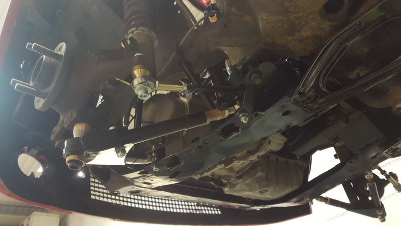

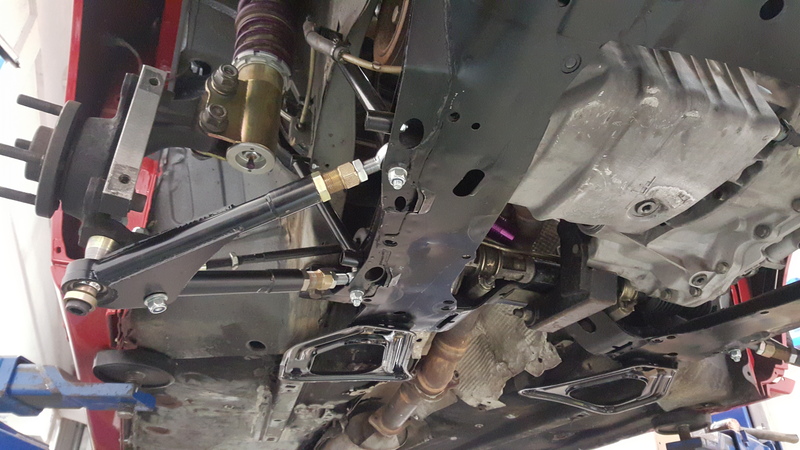

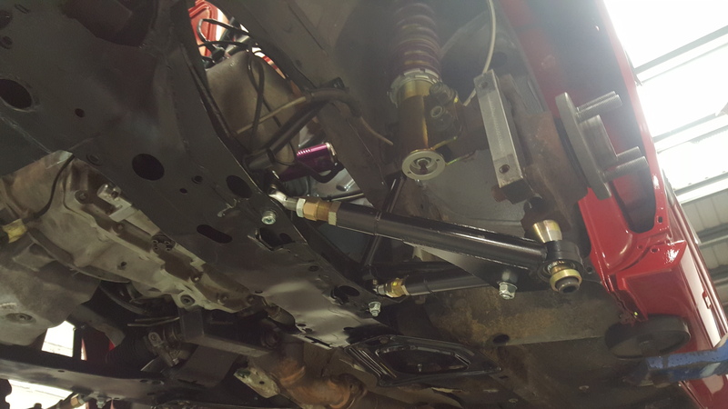

Bloody anoying as I had a perfect race car cross member , all joints and seams were strengthened up with bronze welding , always had it as it came with the spares when I bought the car , decided last week to buy the pure motorsport front arm kit , so have cut the lugs off where the standard fit , and welded the new brackets on that came with the PM kit , sprayed it all up , fitted the engine and box back in the car , fitted the new arms on , hubs and suspension and now found I don't have enough travel in the rose joints on the arms to suit my suspension , for some reason the kit is made with the rose joints horizontal and they should be vertical so they don't have any limits on the travel , rang pure Friday to see what they say but missed them so left a message.
I can't see how I'm going to make it work , I have a lot of droop on my front struts which I want to keep for the jumps , and bumpy Irish Tarmac
ian-speedy
  clio cup race car
So I'll either have to cut the pure brackets we welded onto my cross member off , and cut the standard brackets off the standard cross member and weld them onto my race car subframe , or see if I can sell my race car subframe and pure front arm kit , but take a race car subframe in exchange .

I'm sorted now thanks , Pure motorsport modified there designs to suit my car , its all fitting nicely now

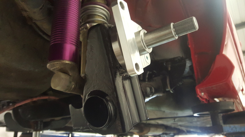

Made some changes to the Clio , had some parts from Pure , as I bent the TCA when I rolled the car , I decided to go fully rose jointed on the front , which means modifying the cross member to suit , which I had the issues above with , they have made me new arms to suit the droop I have on my suspension , so it all fits now.

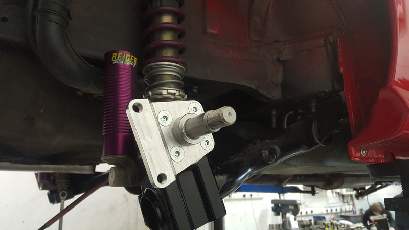

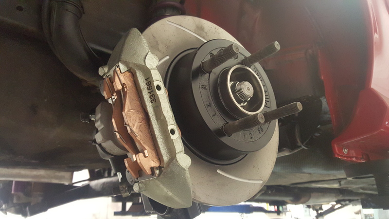

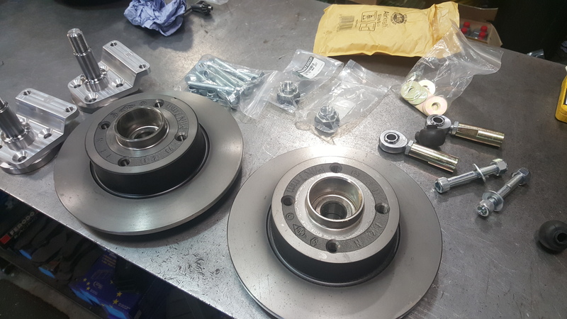

I also went for there rear bearing upgrade as I have done a few rear bearings in the past , going to genuine discs makes it better , hopefully this will be better again.

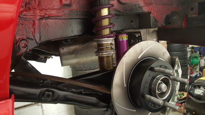

Put some grooves on the discs , fitted some brand new calipers , and some CL pads
So slowly getting there , got new discs and bells to make for the front , as I broke one in the crash , going to rebuild the front Laguna hubs , new bearings and paint them , hopefully it should be all finished in the next few weeks

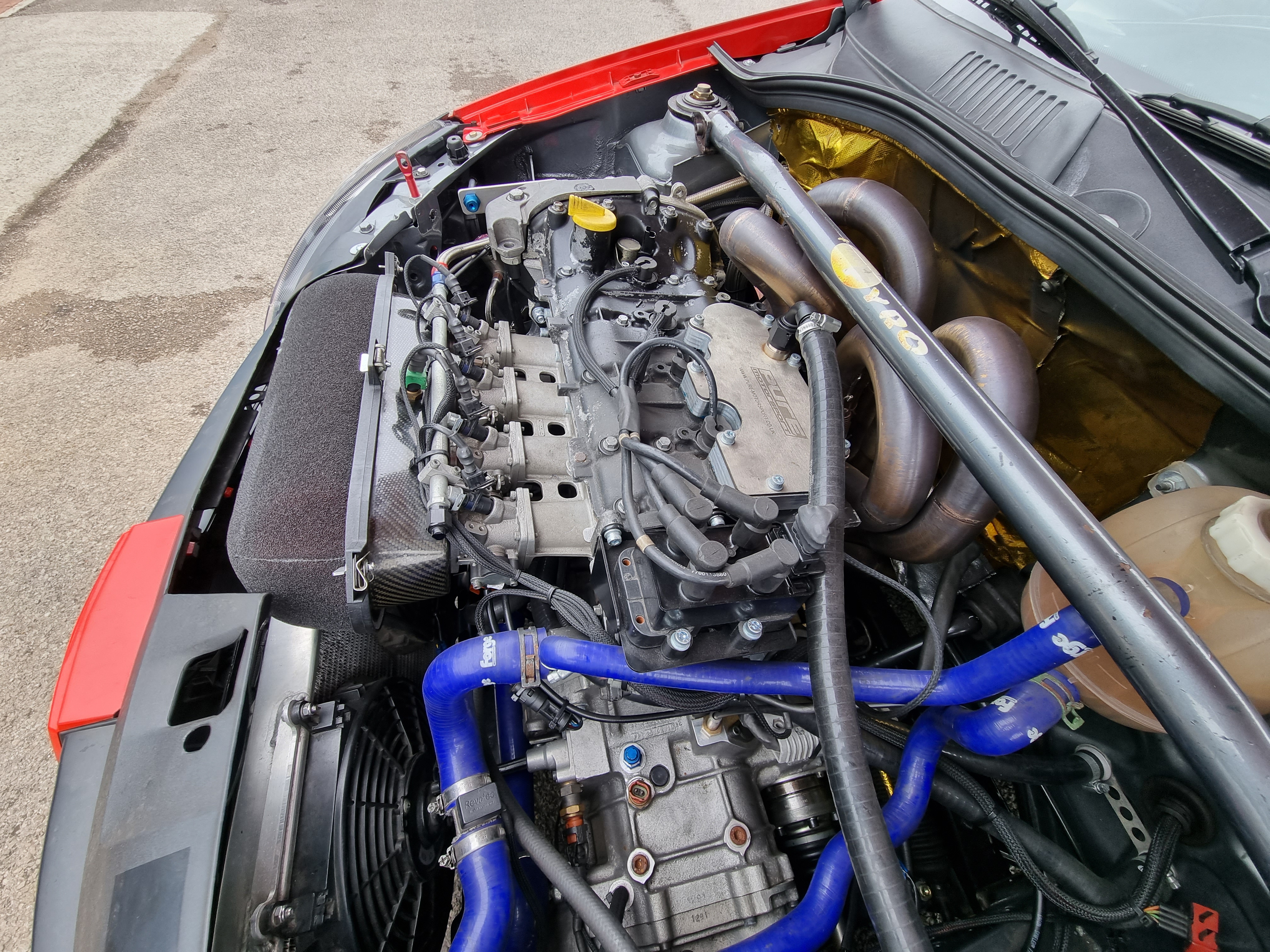

Still have the car for now although it is for sale as I bought another rally car , is now fitted with a new Pure motorsport engine , and Sadev ST75 gearbox , along with a host of other parts , had it mapped by Sandy Brown and goes very well now , although it was no slouch before.
My son is using the car in Pembrey on the 28th Dec to give it a run , and hopefully help sell it with a good result , i'm out in my Swift , so should be a good day
We took it to Llandow last week so he could try the car , and make sure all is good as it hasn't really been driven since it's been rebuilt , fair play it goes very well now.
