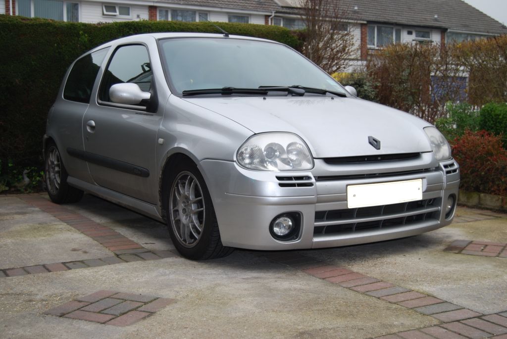

Few more goodies turned up yesterday for the PH1.
Looks like this is going to be a busy weekend for me and the car ;).
Nickson

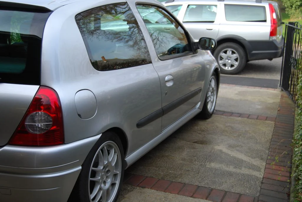

Set to work on the car today.

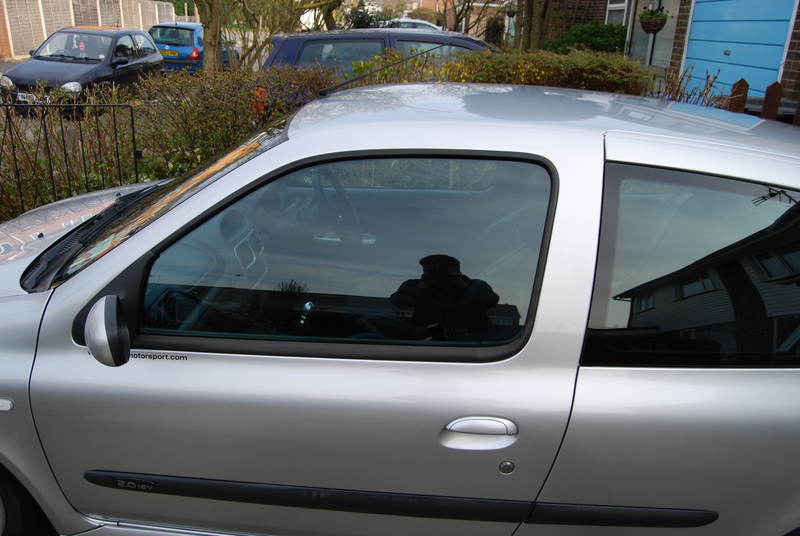

Managed to get the quickshift fitted without the gearbox pin. Im not going to bother fitting the pin, the throw is hugely shorter, a bit too short to be honest, but feels very positive, so thats not bad!
Managed to get a few filthy pics of her mind:

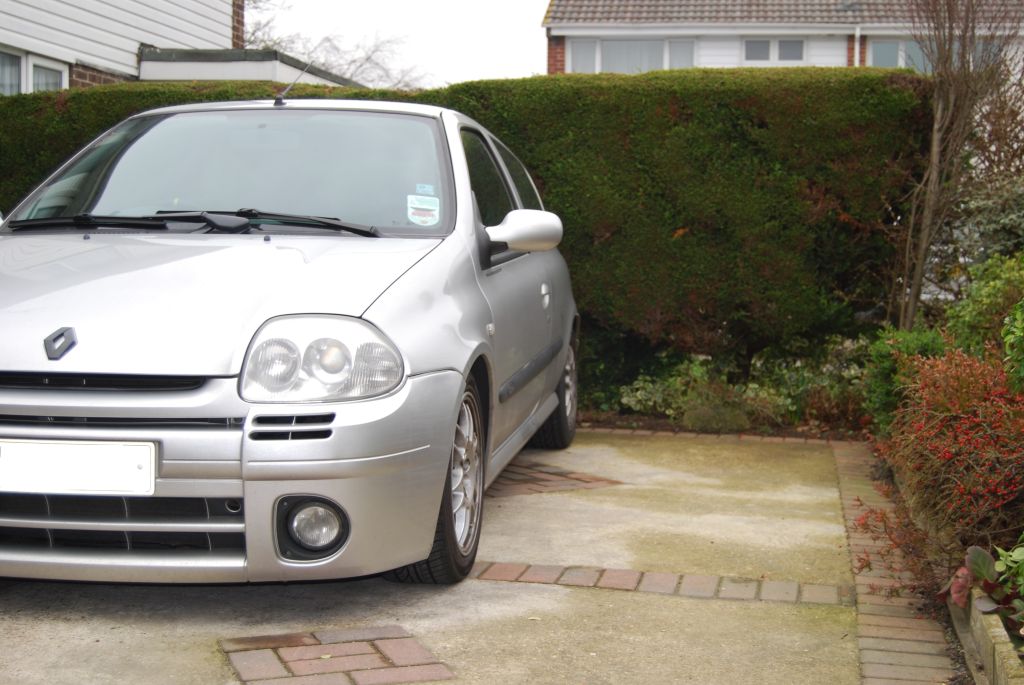

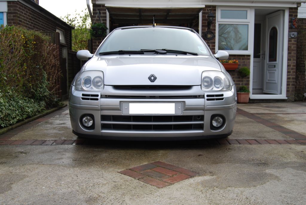

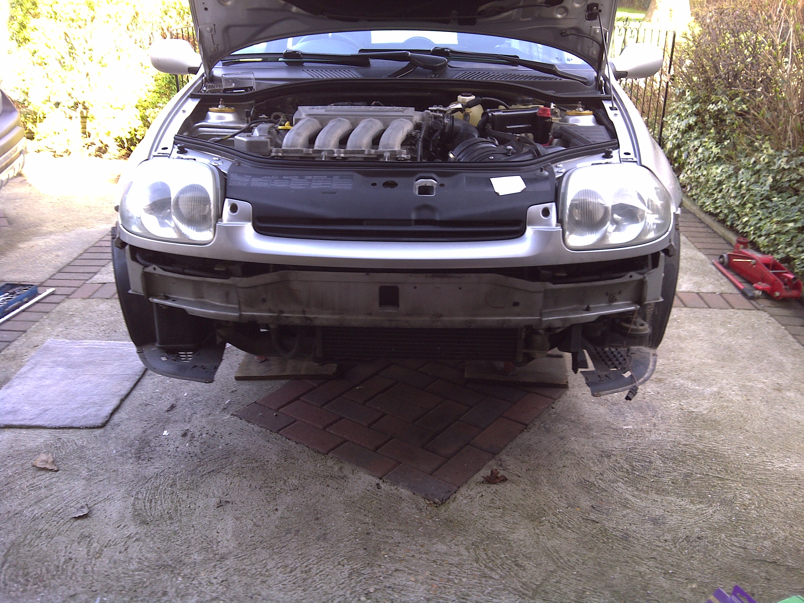

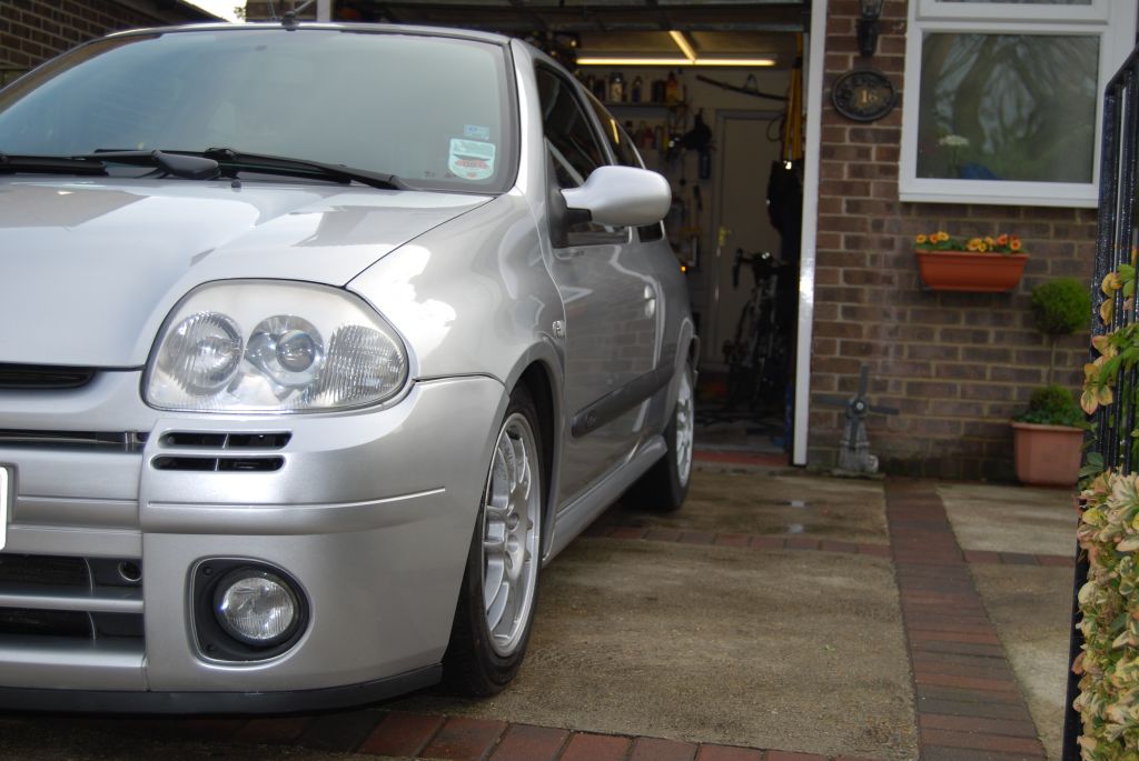

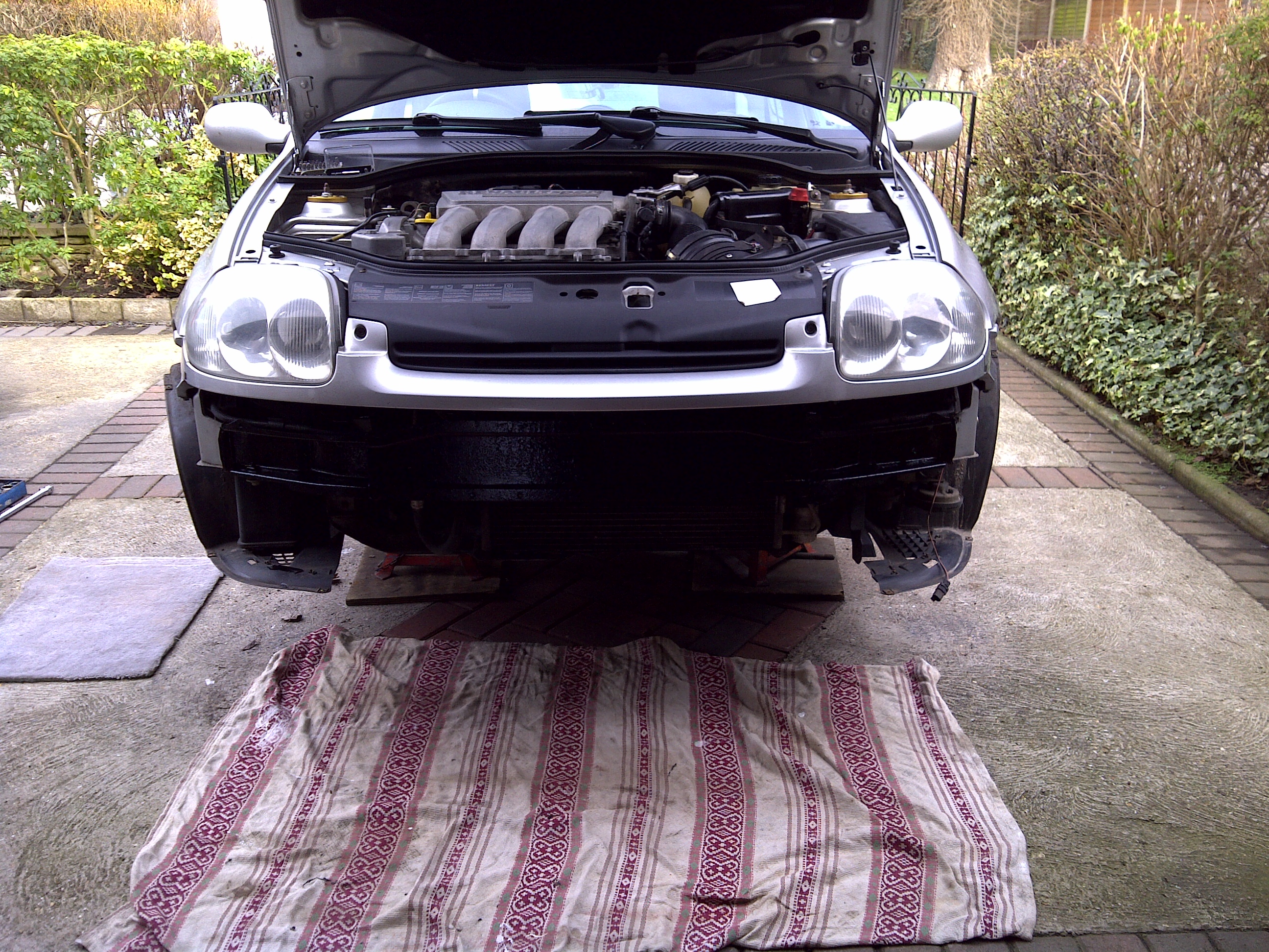

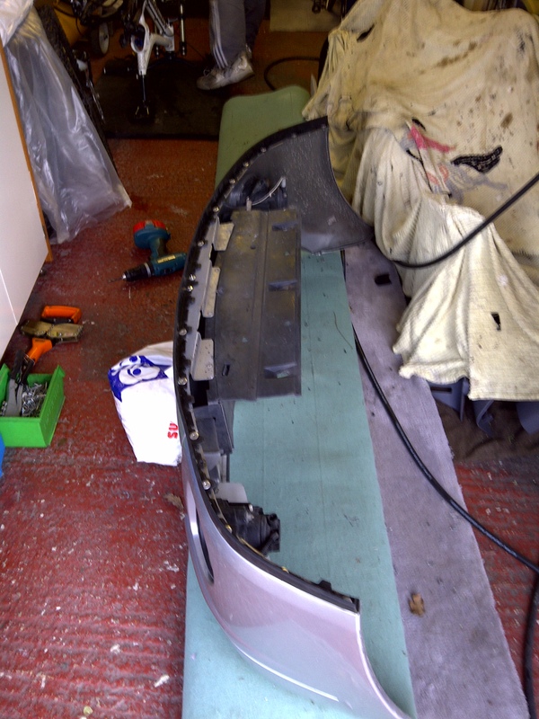

Next job was to tackle fitting the Skoda splitter... For this, I thought it best to remove the front bumper:
Very easy job to remove the bumper, much easier than I thought it would be!
Next we set about drilling and riveting the splitter to the bumper:
Finished!:
Whilst the bumper was off, I thought it best to remove all of the rust on the front of the car with a wire brush, treat it, and give it a lovely coat of Hammerite!
I honestly do not know how I would survive without the stuff!
Bumper refitted :)

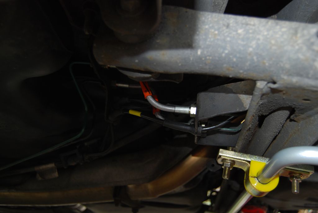

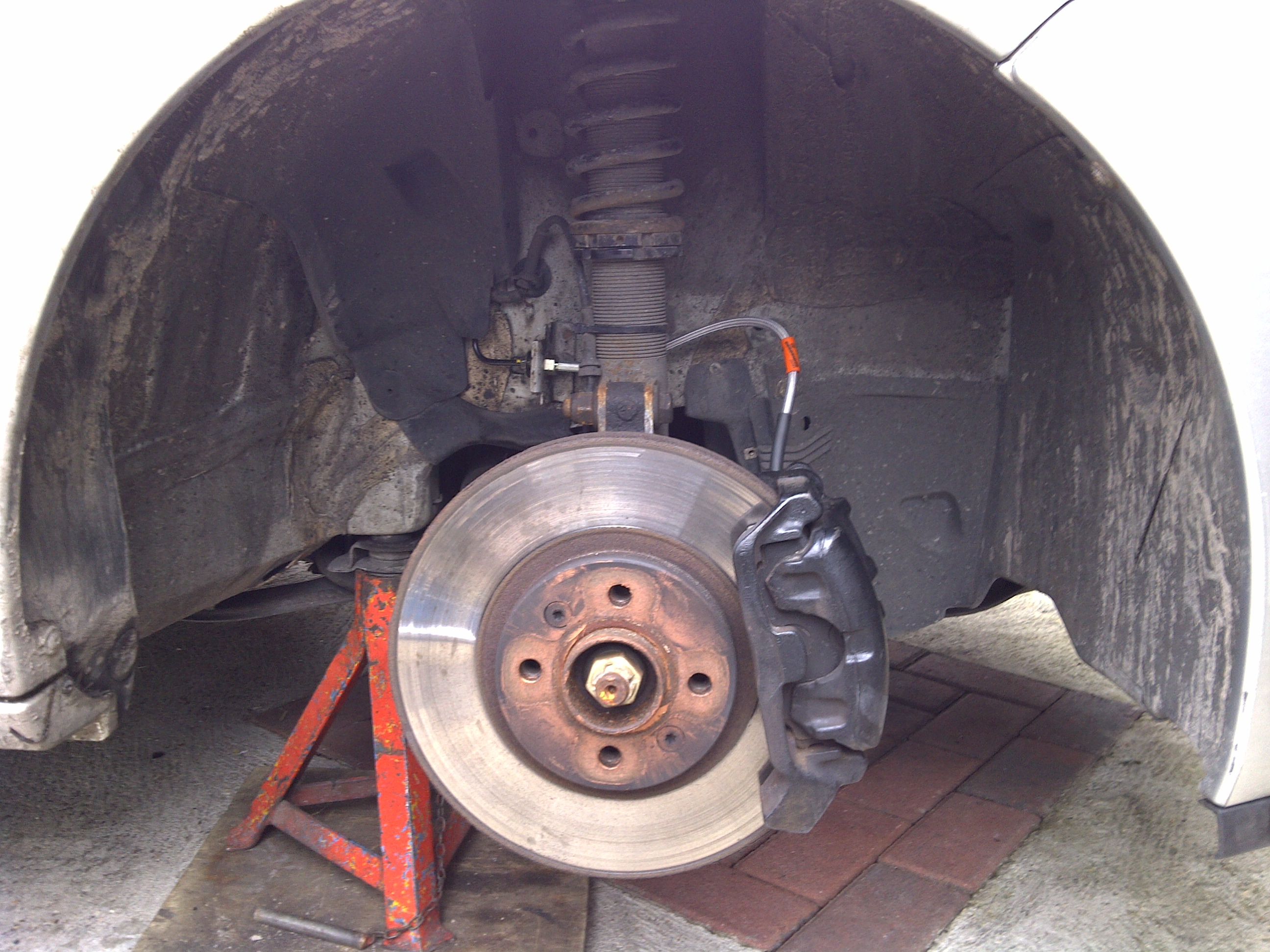

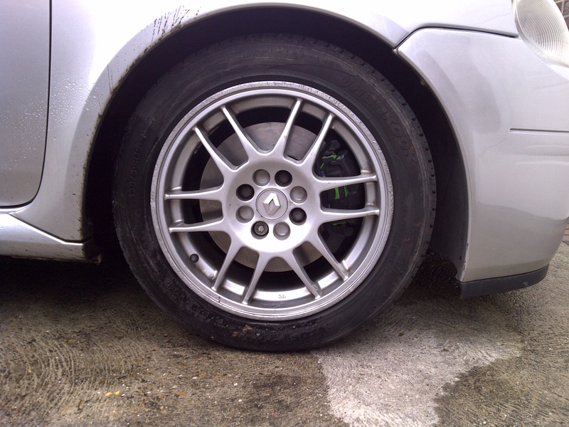

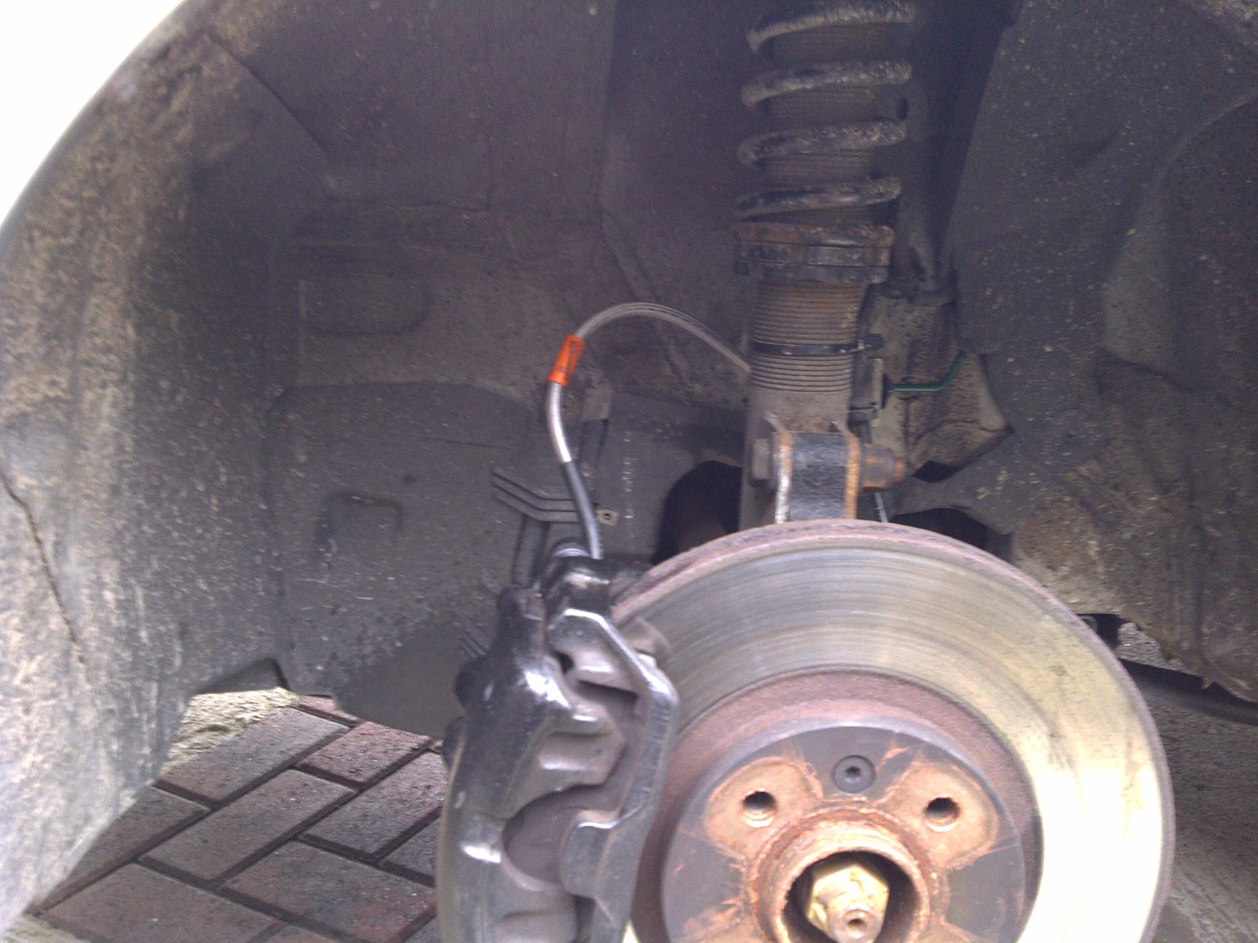

Next job was to crack on with fitting the Goodridge hoses, before:
Please excuse the muddy arches :eek:
Front hoses fitted!

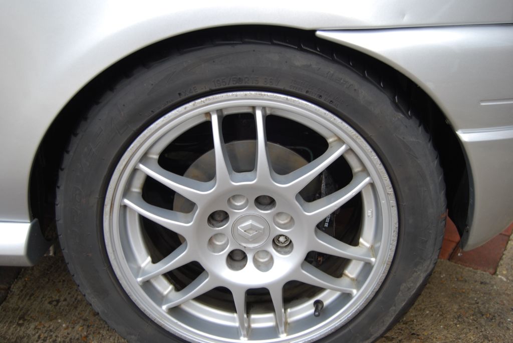

I have just bought a new set of discs and pads to be fitted next week as these are getting on a little bit. Will have the calipers off to give them a good clean up and another lick of paint! But what colour to go for? Im thinking possibly yellow...?

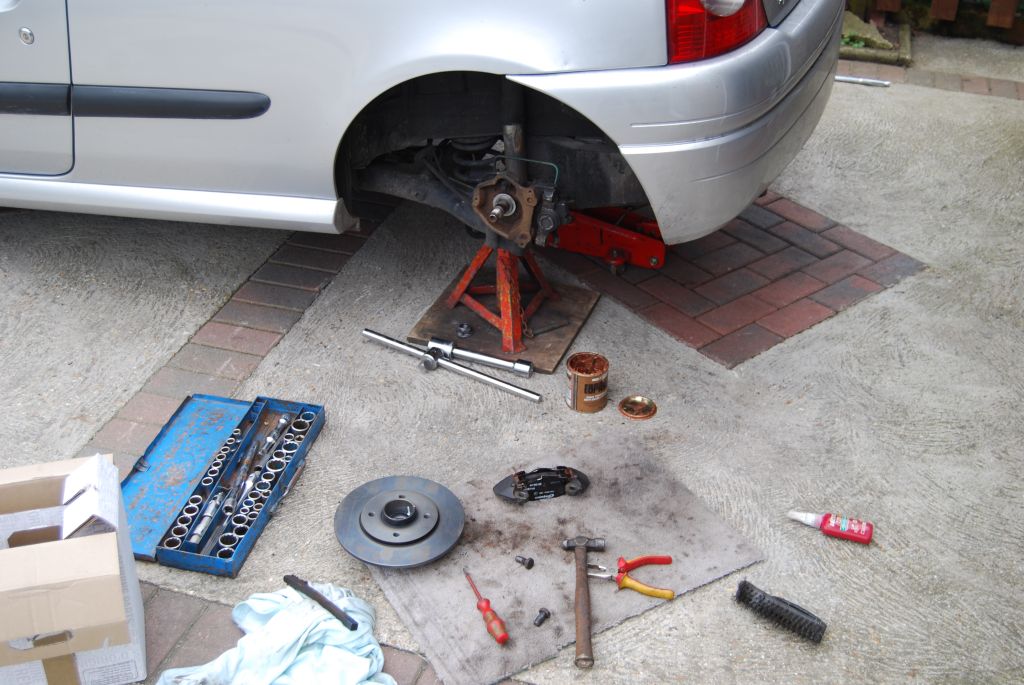

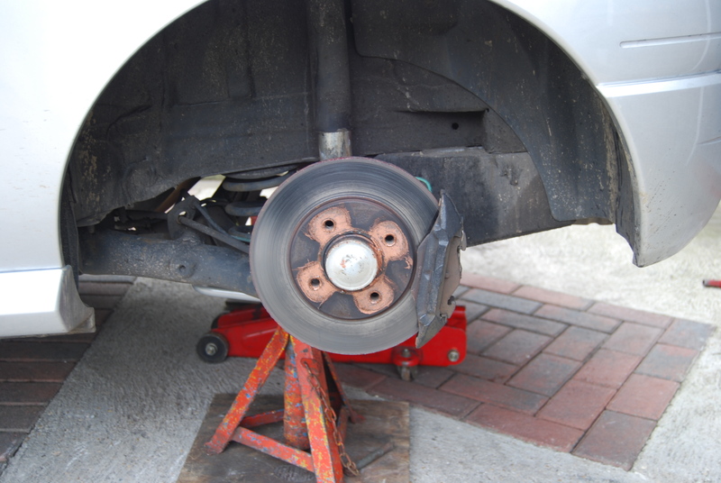

Unfortunately we didnt manage to get the rear Goodridge hoses fitted today, as I was having problems with a binding rear brake caliper. After stripping it down, greasing it up refitting it and still having the same problems, it turned out that the sliders had siezed. So we spent the remainder of the day sorting that out, with no daylight left to fit the hoses. They will be going on next week with the new discs and paaaads (if they arrive in time).
Quick dirty picture:
Also... :(

Splitter scrapes on everything :(
Hit it a few times yesterday on small things, luckily not at speed..
May have to raise the front end a little now haha.
68k is something! Shes nearly 70k :(

Don't worry about the splitter scraping, just replace after every 6k and you'll be fine! Mine has lasted forever.
Car is looking brilliant though, I can't wait to get my f1's on now.

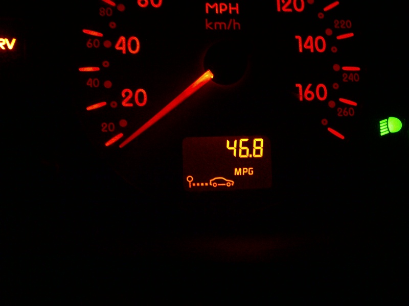

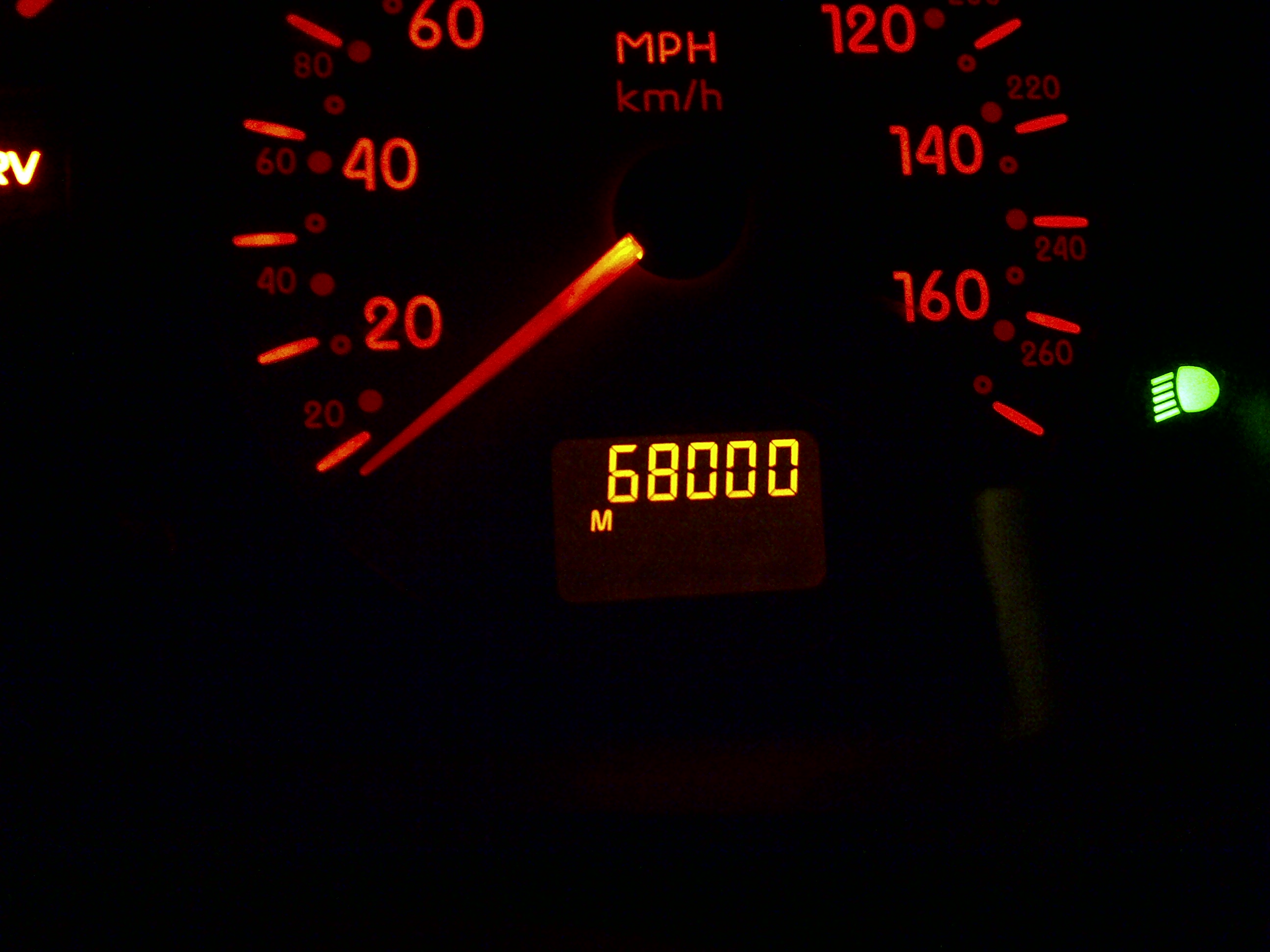

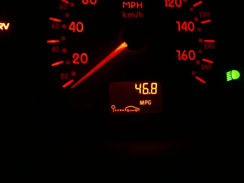

Also, I didnt think this was possible..
Managed it on the weekend on the way back from the New Forest..

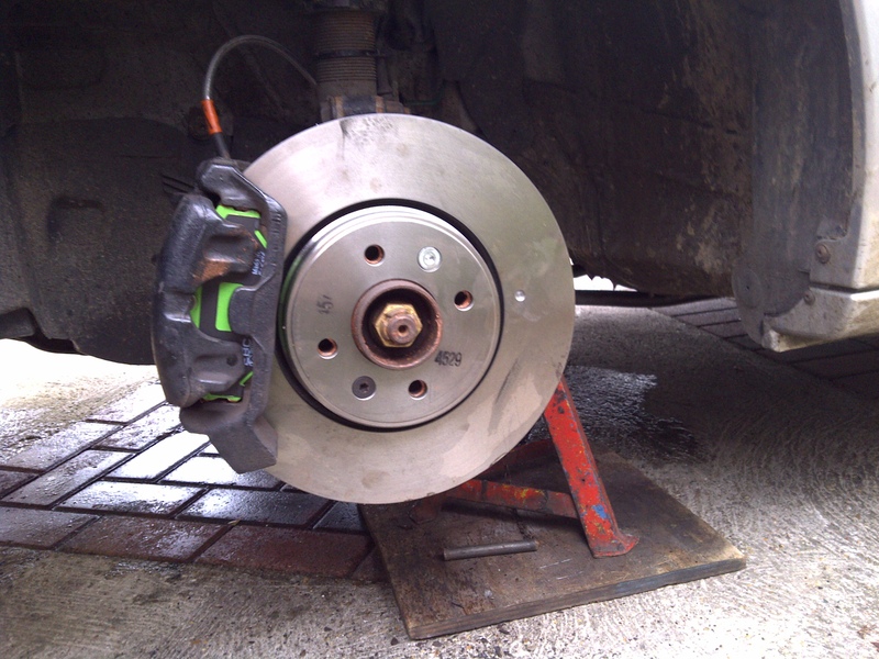

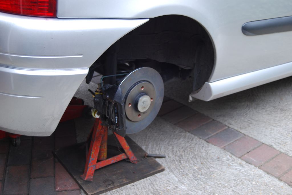

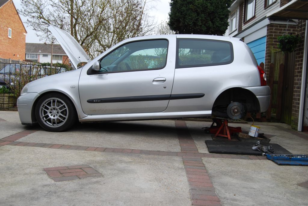

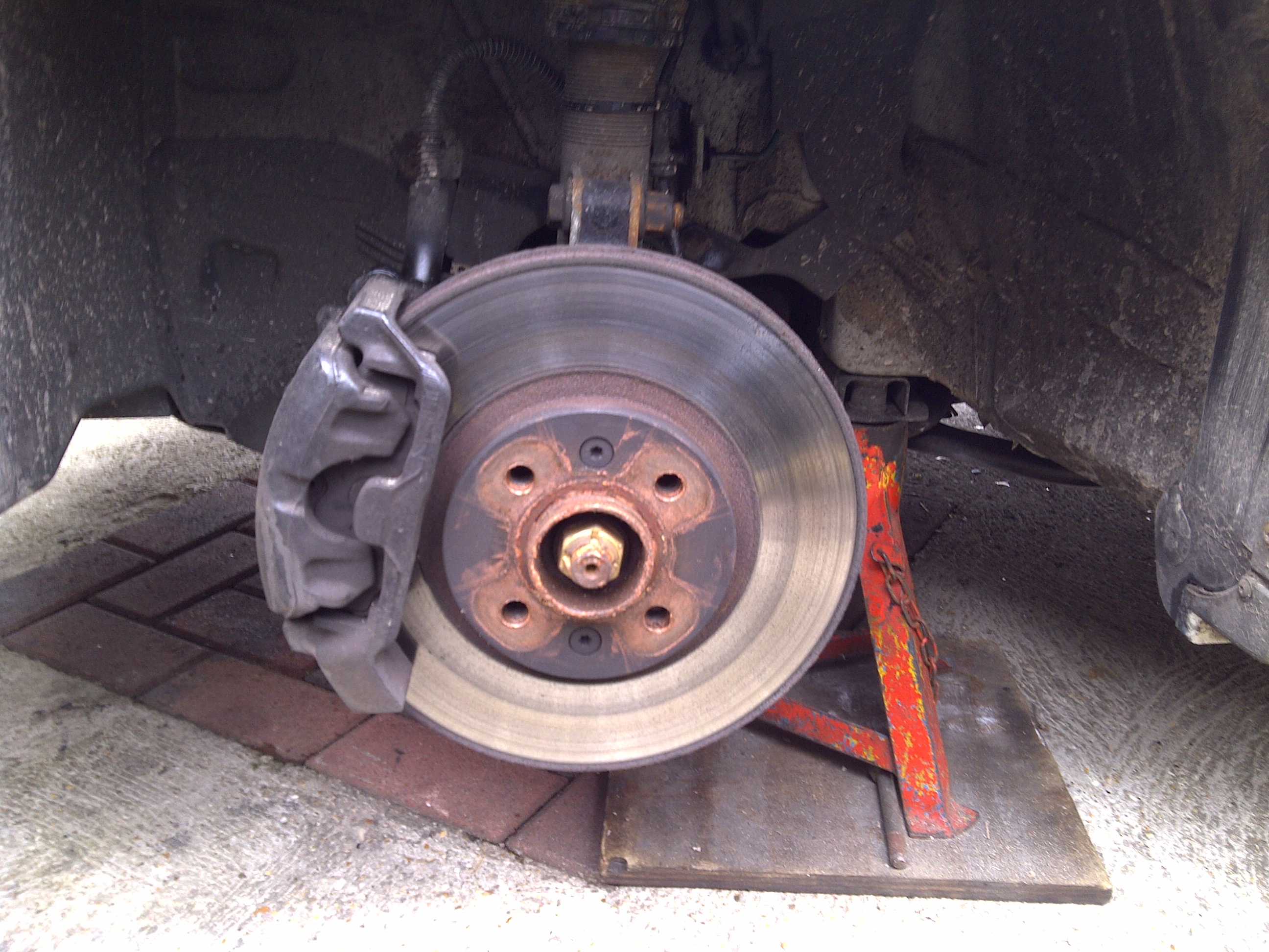

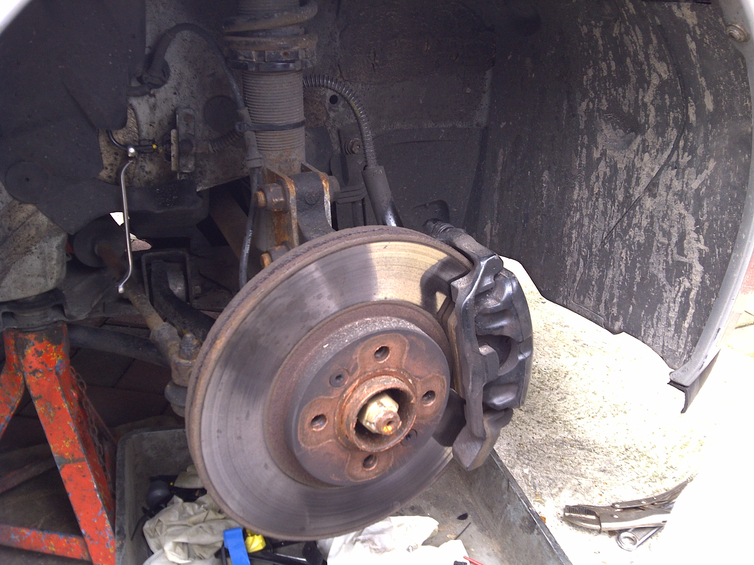

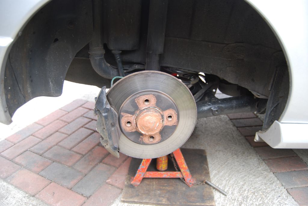

The discs and pads have needed changing since I have had the car.

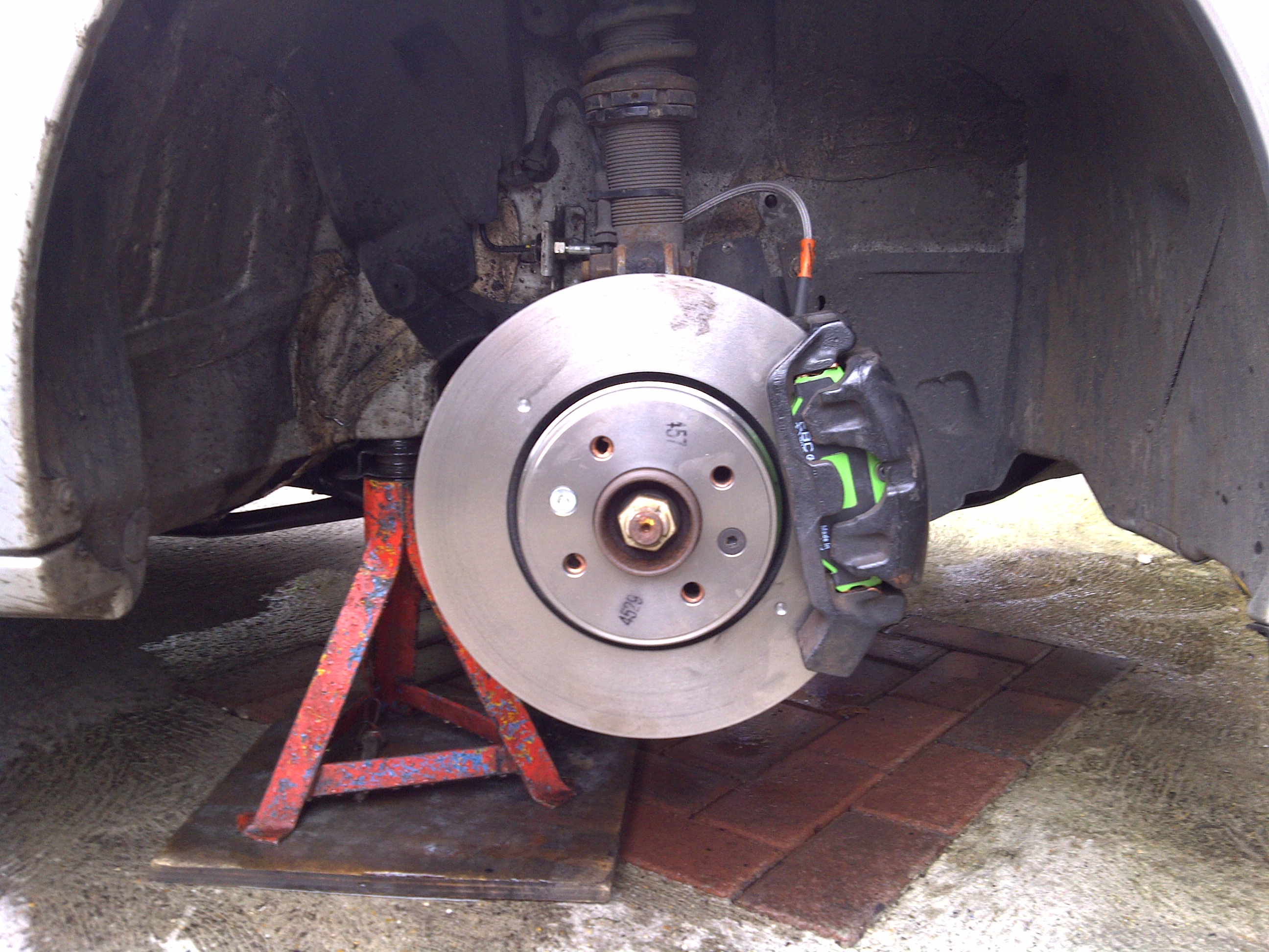

Having bought the discs and pads during the week, and having a free afternoon, thought I would fit them to save me from doing it over the weekend.

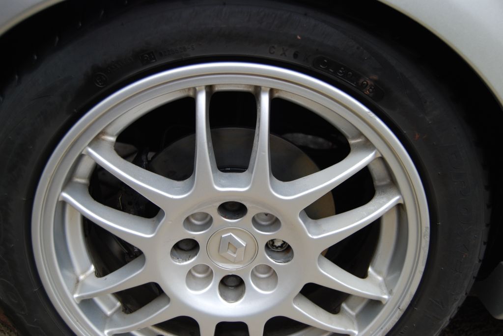

Firstly, the new discs and pads.
Brembo HC's, and EBC Greenstuff pads. I know the pads get mixed reviews, but we shall see how they perform!

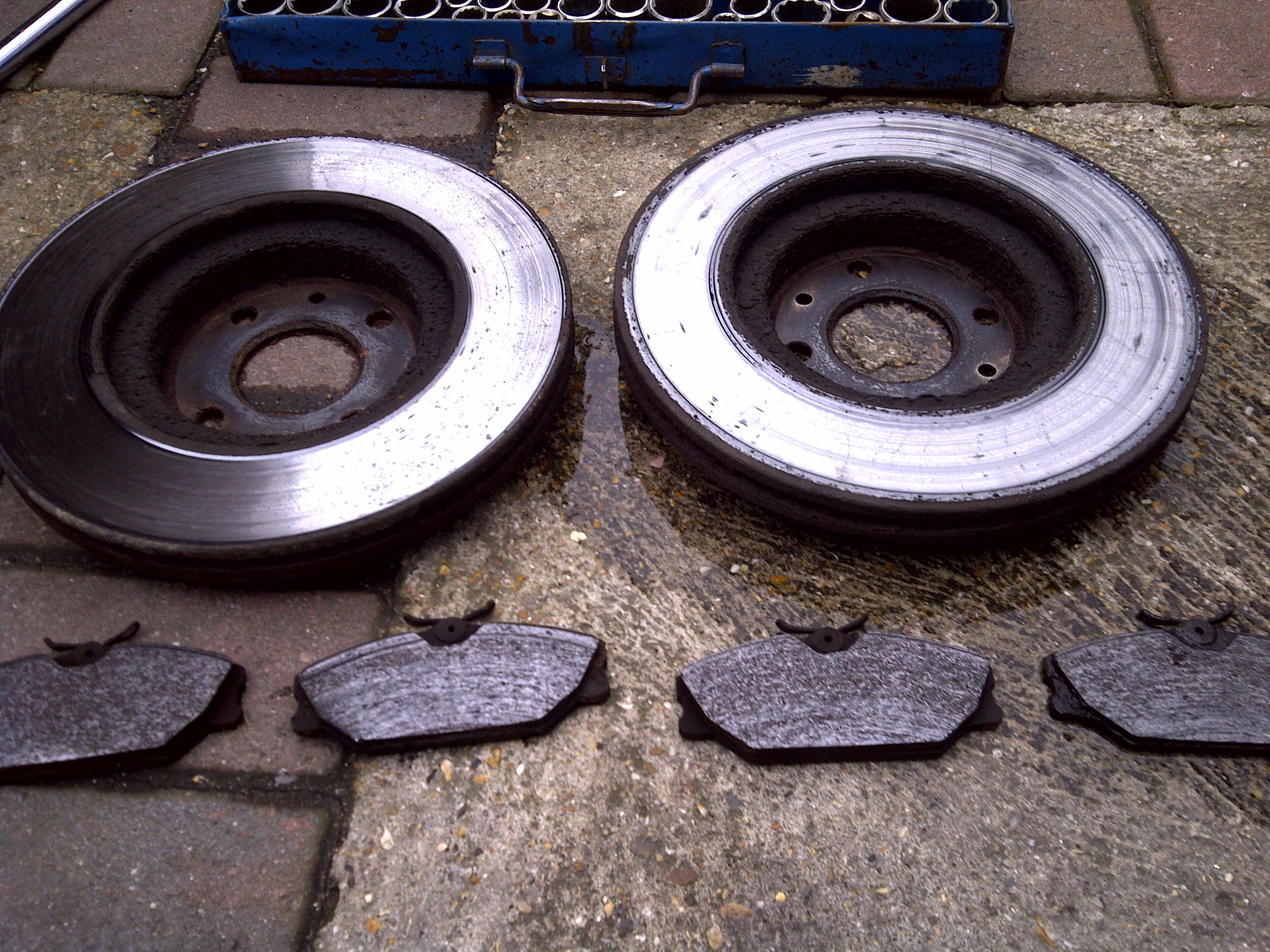

The state of the old discs and pads on the car:
Fitting was very easy! Took under 30 mins for both sides of the car! Luckily none of the bolts were siezed!
Fitted:
Thought I would take a picture of the state of the old discs and pads. Very happy I changed them when I did as they would not have lasted much longer the state they were in!
Finished!
So far so good!

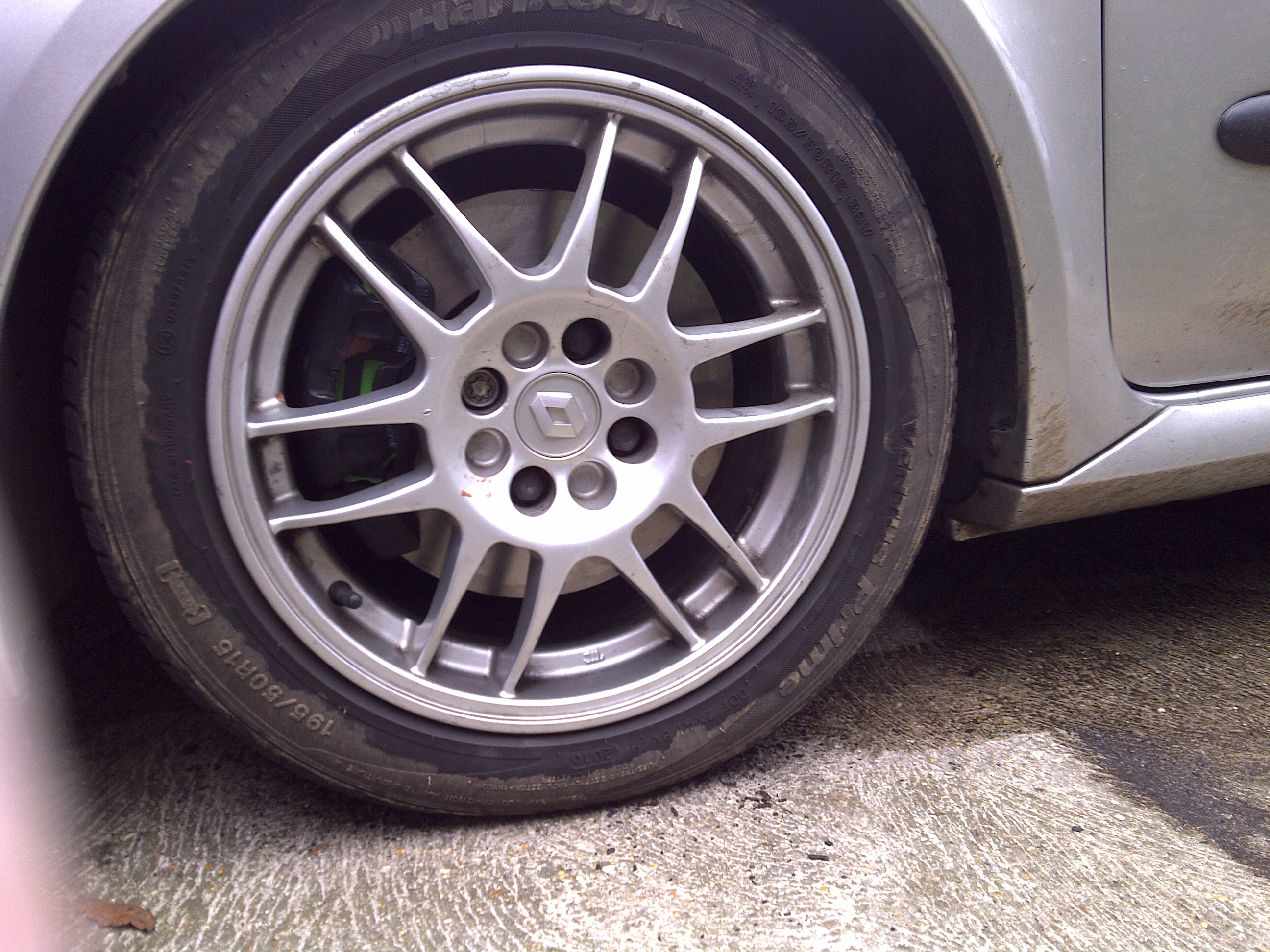

Very happy with both purchases. Braking performance is 100% improved!

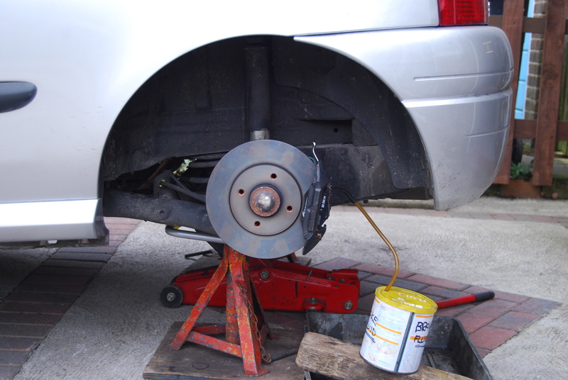

Fitting the rear Goodridge hoses tomorrow, fitting the new rear pads and bleeding the system with some decent brake fluid.
Hopefully will be pretty awesome when done :)

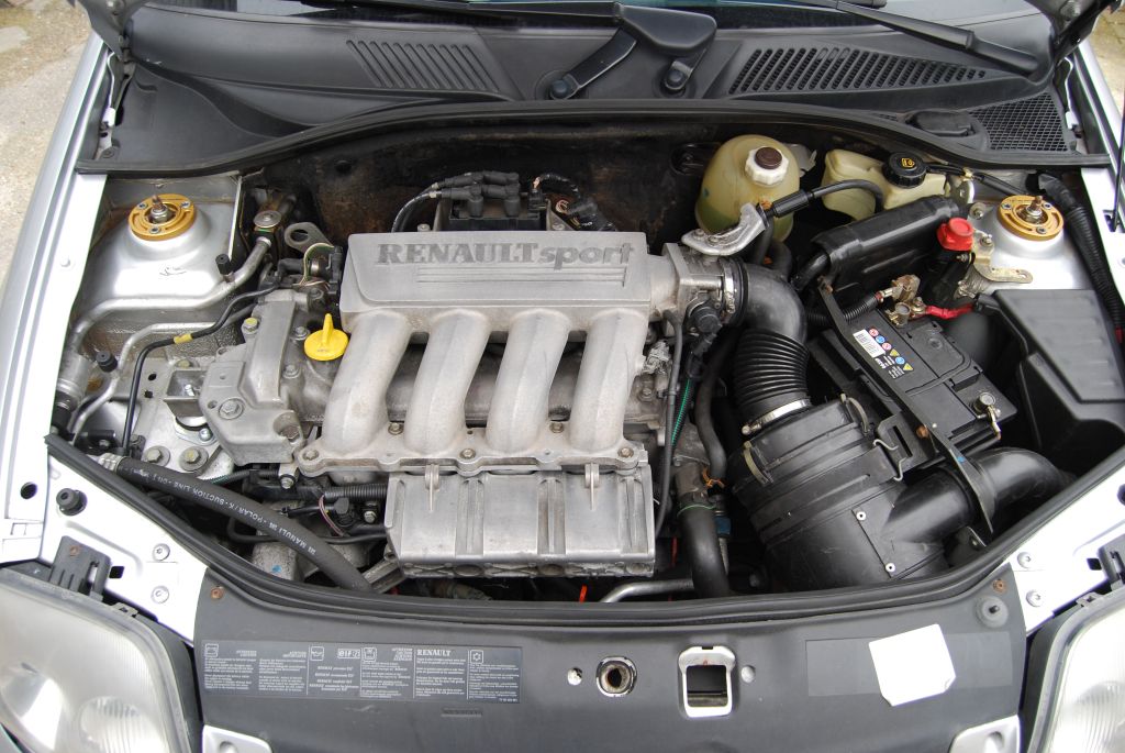

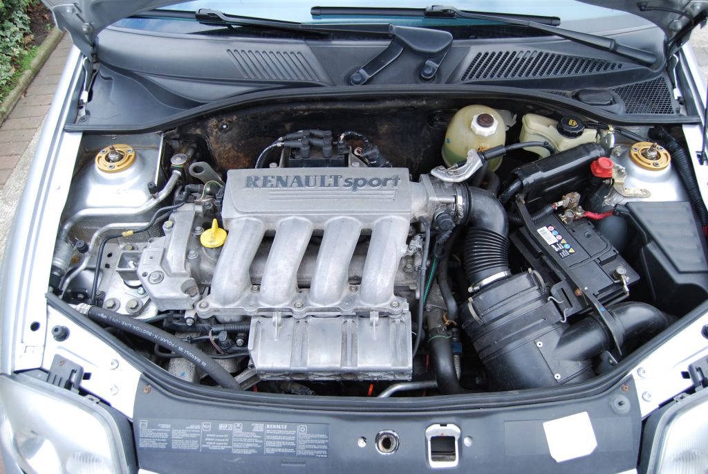

Had a little go at polishing the "RenaultSport" logo on the inlet:
Shinyy!!

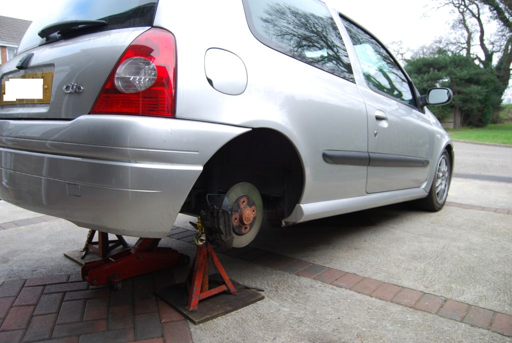

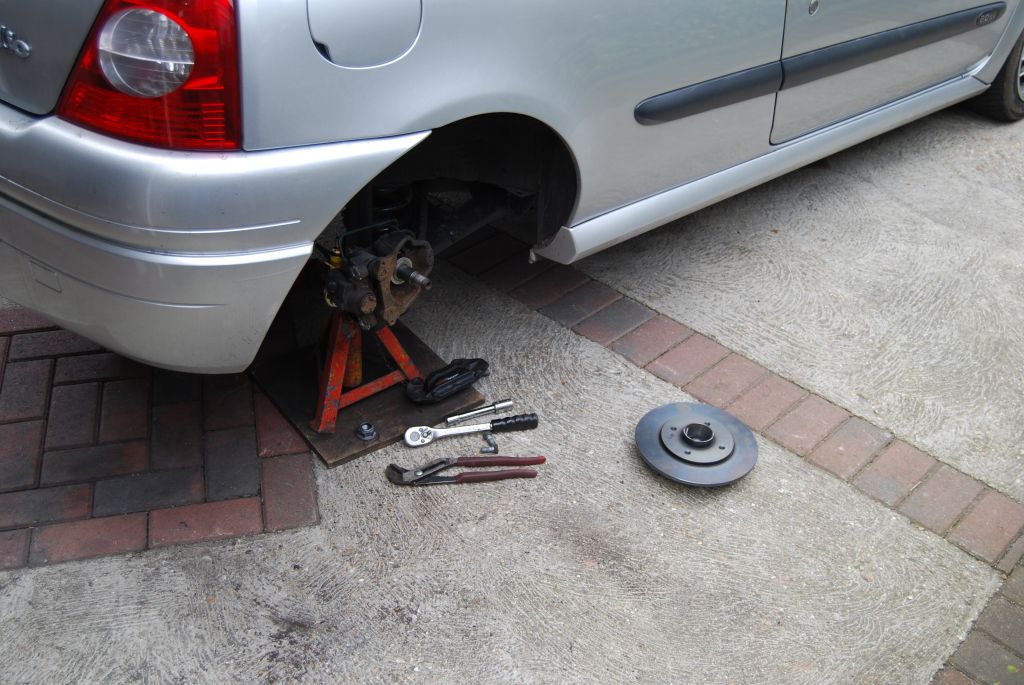

Thought bugger it, may as well fit the new rear discs and pads whilst the rear of the car is up having the Whiteline and Goodridge rear hoses fitted, so just bought these:
http://cgi.ebay.co.uk/ws/eBayISAPI.dll?ViewItem&item=250605807071&ssPageName=STRK:MEWAX:IT
Quite an expensive Monday morning if you ask me! Haha.
Should sort her out for a while..

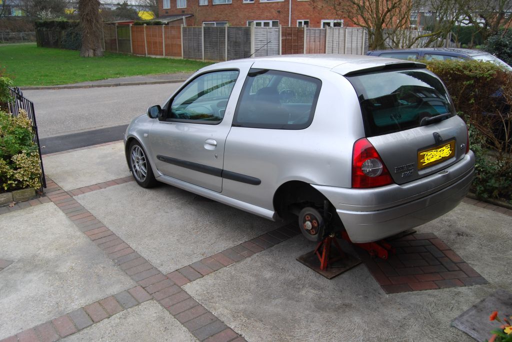

Few more bits arrived today courtesy of mr DHL (and my credit card) ;)
New rear discs ready to be fitted on the weeeeeeekend!

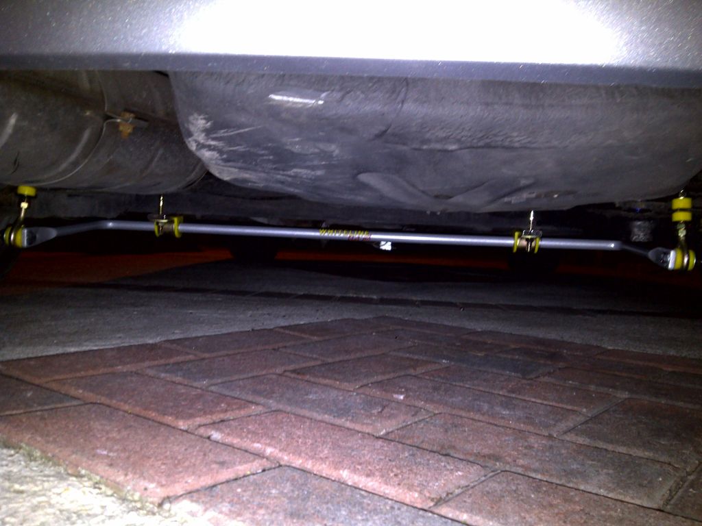

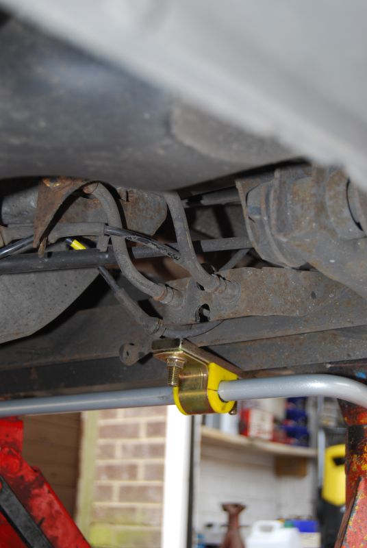

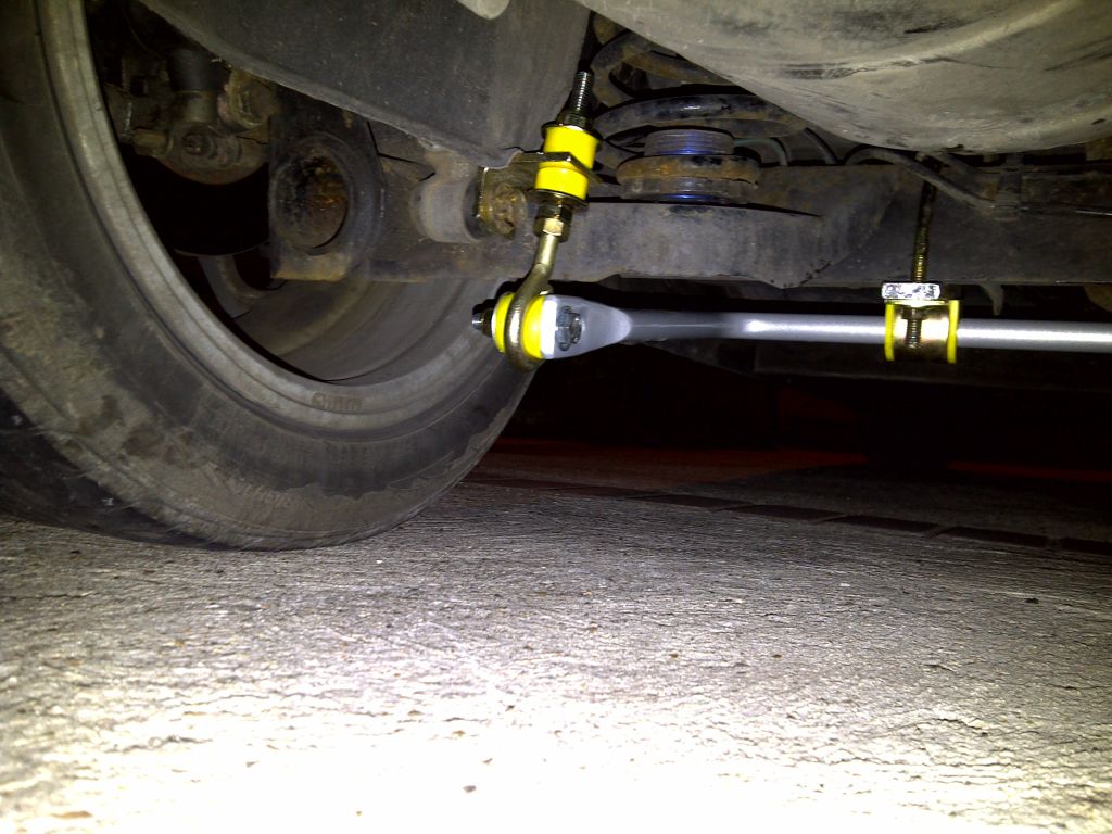

Riiiiiiiiiiiight!
Well how do I put this..

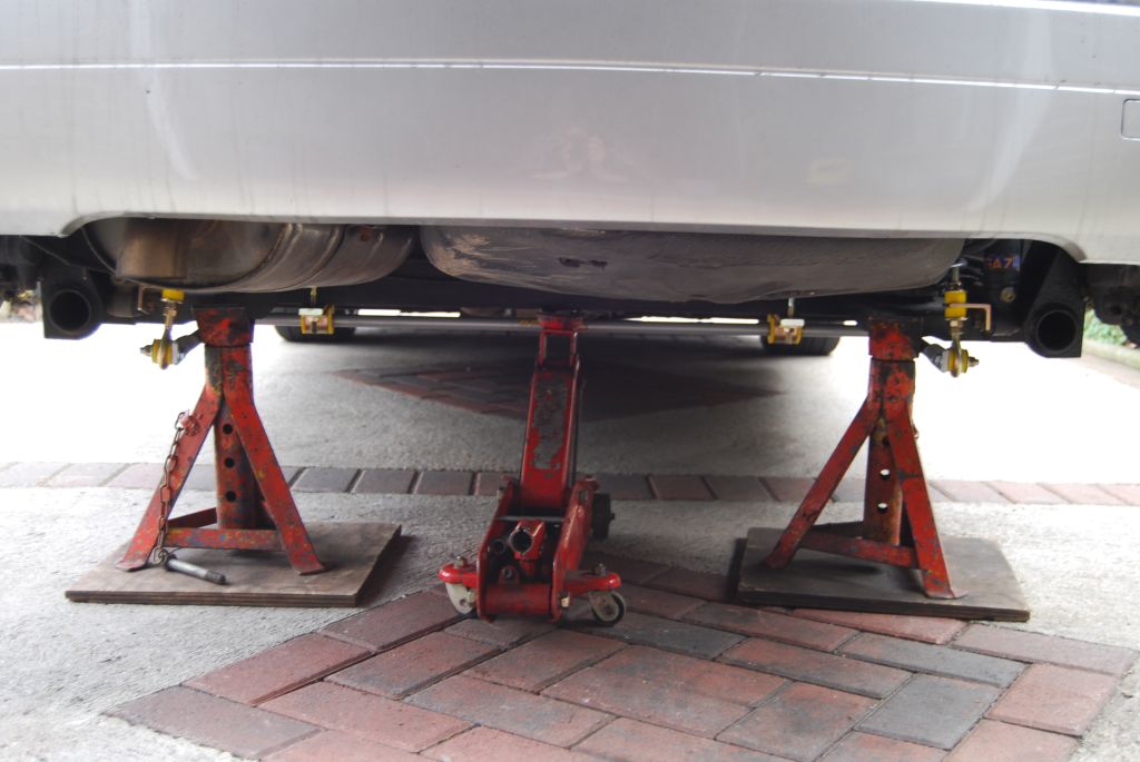

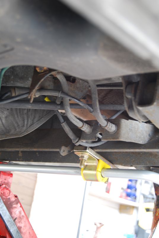

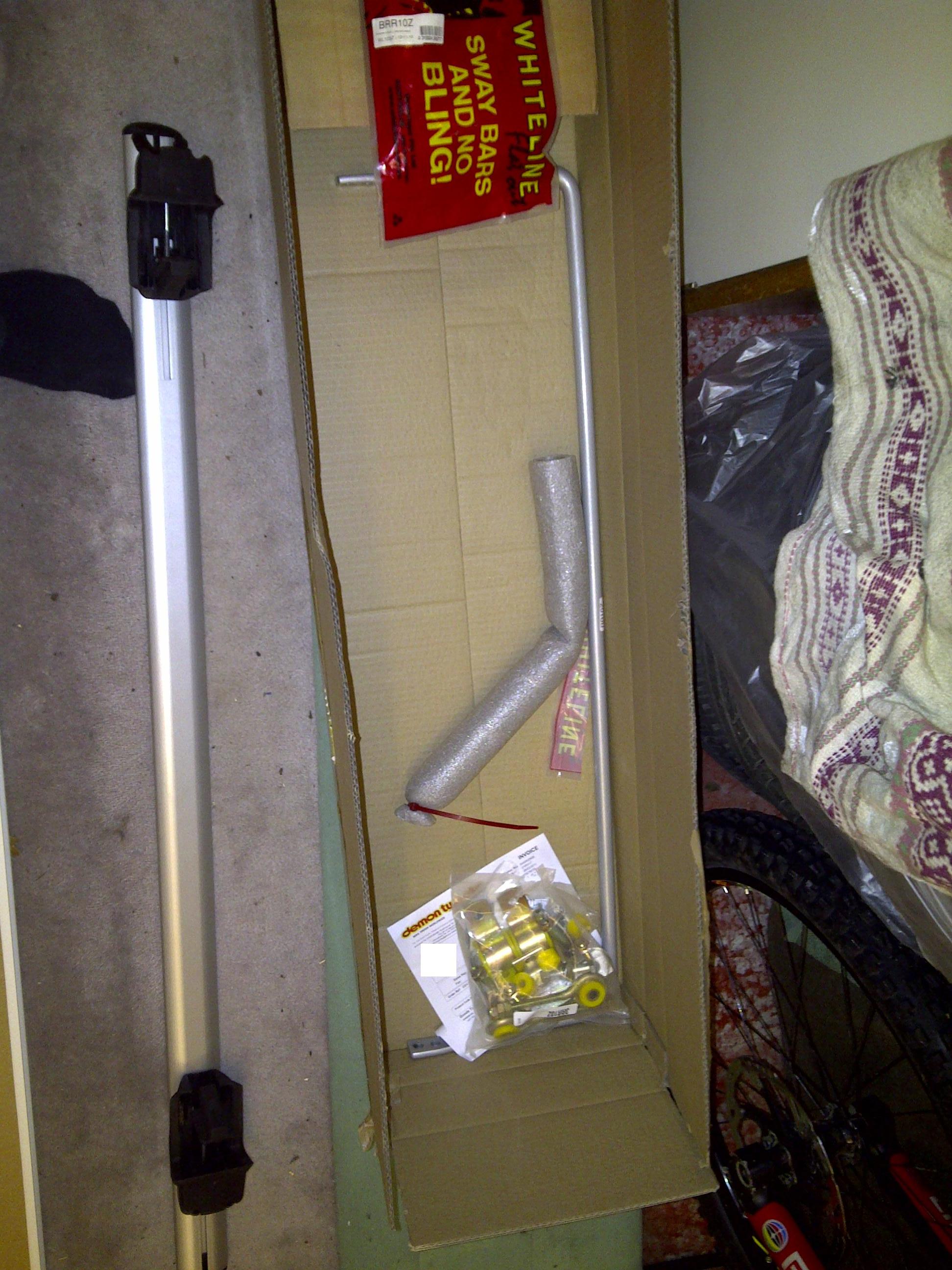

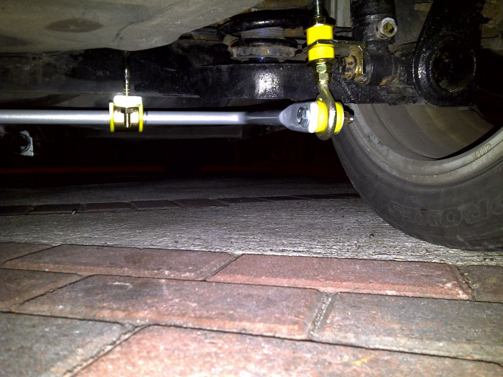

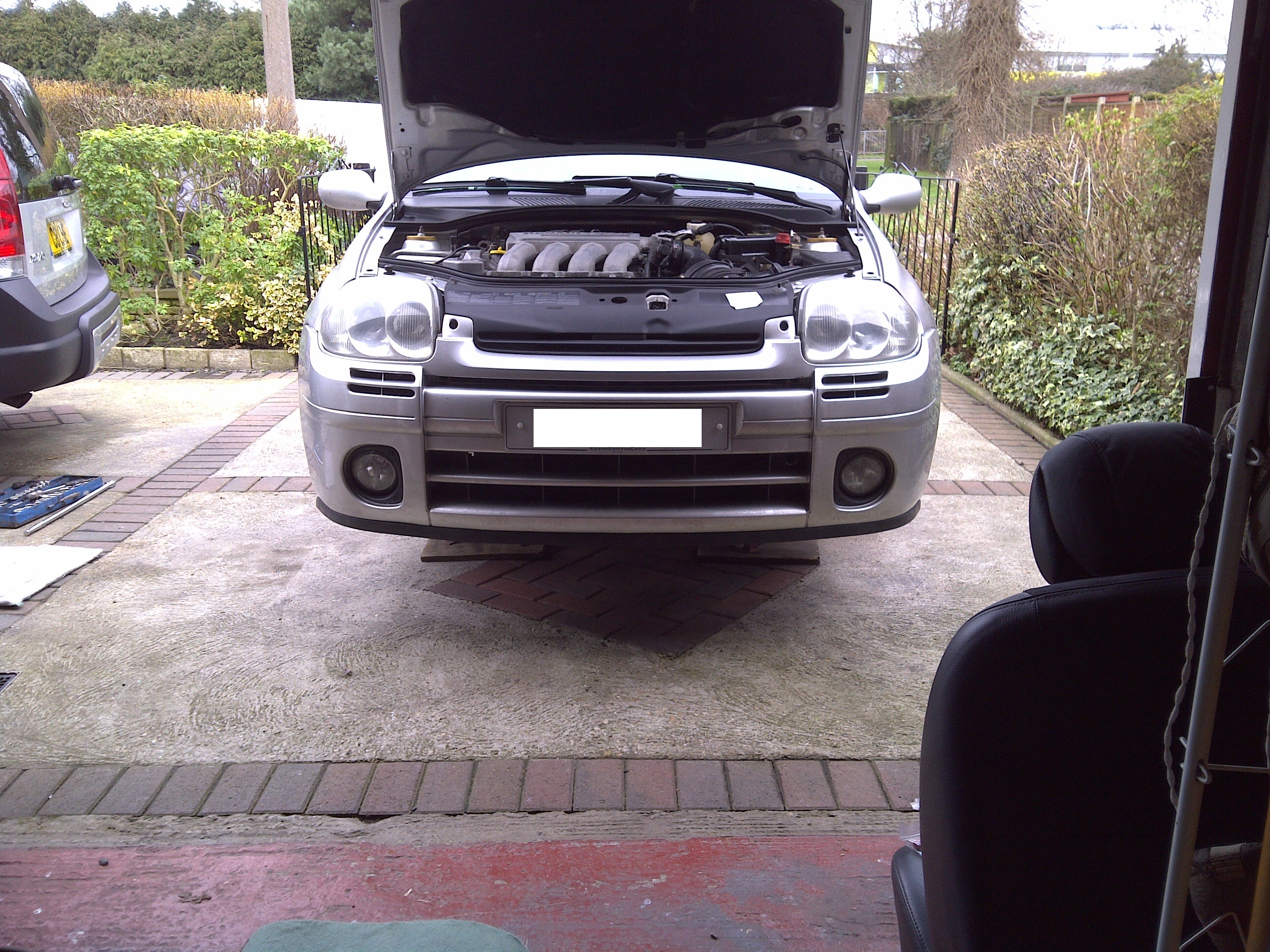

I got bored.. And, the Whiteline somehow found its way onto the rear beam of my car...
Finished work at 20:30 :dead:, had nothing better to do, so backed the PH1 on the drive and cracked on!
Went straight on without any problems!
Pics:
Please excuse the poor photography! I forgot to take some pics whilst the car was in the air, so had to get them off the axle stands, which meant lying down on a freezing cold drive, with numb hands..

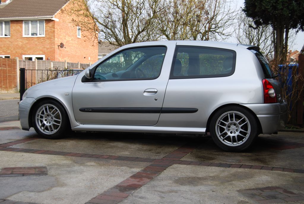

Time to take it for a drive.
Nickson
Good work, give us a review upon your return.
I'm buying one soon.
Cheers Rob!
Well all I can say is wow!
As can be seen from the pics, I have it set on its softest setting, and my god it makes such a difference!
There is so much less bodyroll, and the car feels more composed, and as everyone else has said, more "planted" to the road.

First thing was to get the car jacked up.
This is showing the state of the old discs and pads!
Cheeky picture of the Whiteline ;)
Few more random pics:
Dirty much?
Next thing was to remove the old discs, which proved to be extremely easy!
Slap the new discs and pads on, and thats one job down!

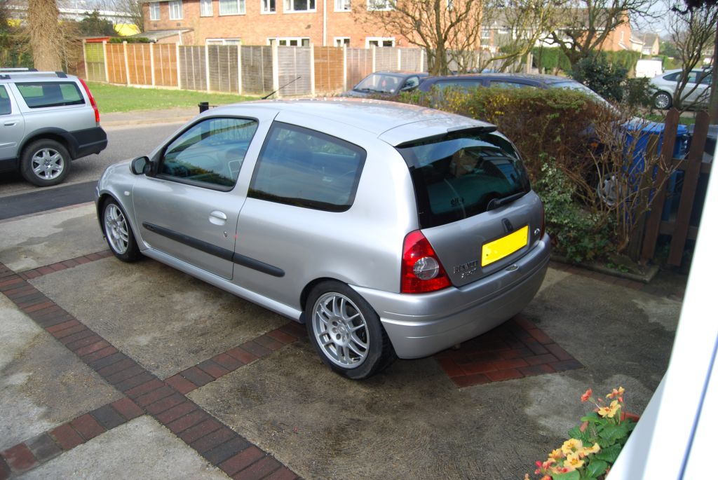

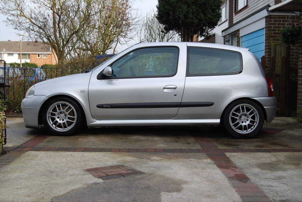

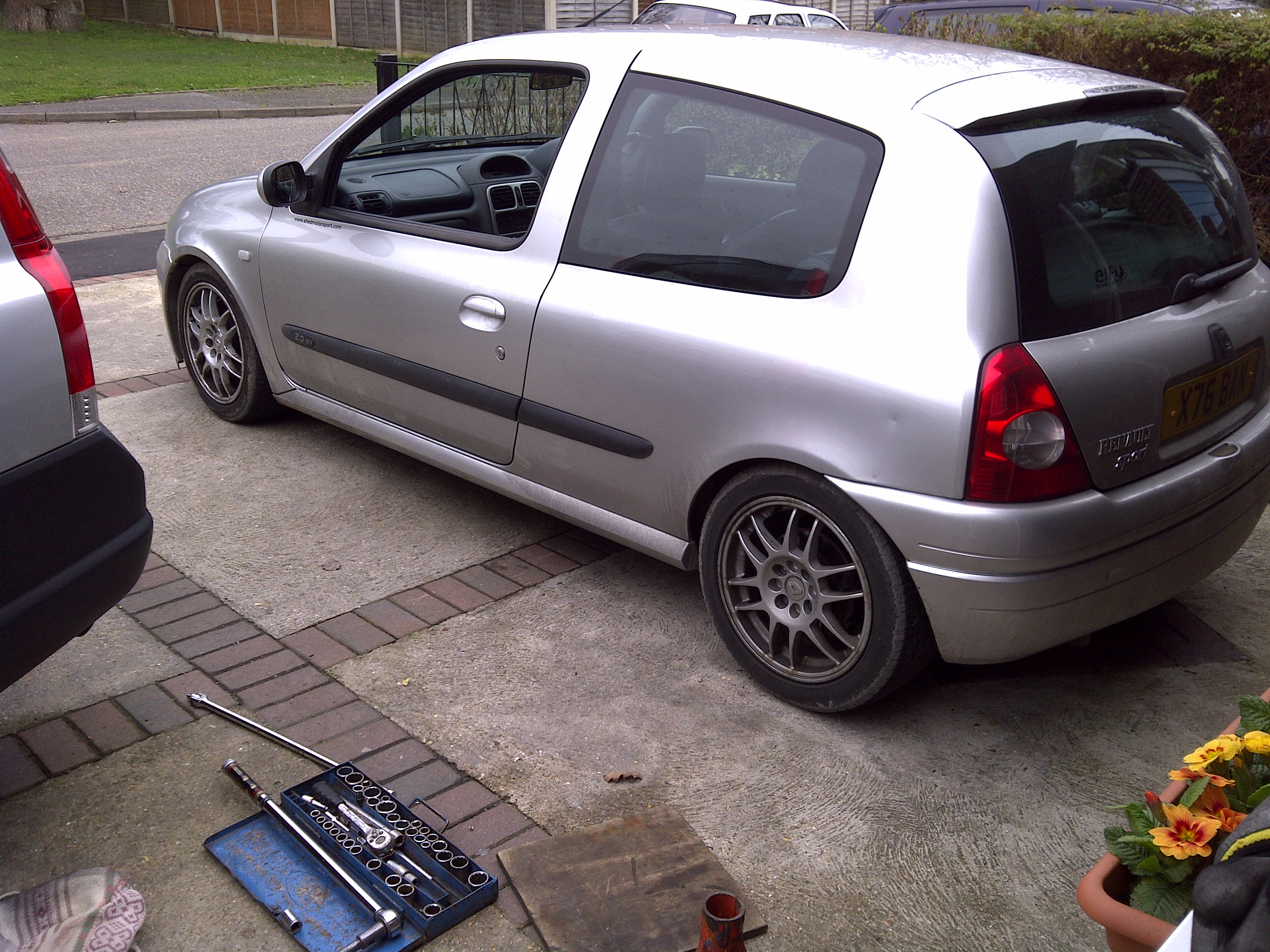

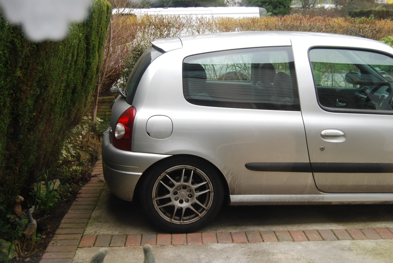

Stance...
Wheels back on:
Next thing on my list of things to do, was get rid of the old hoses, and replace them with some nice new Goodridge items.
Old:
New!
Looking pretty evil :evil:
