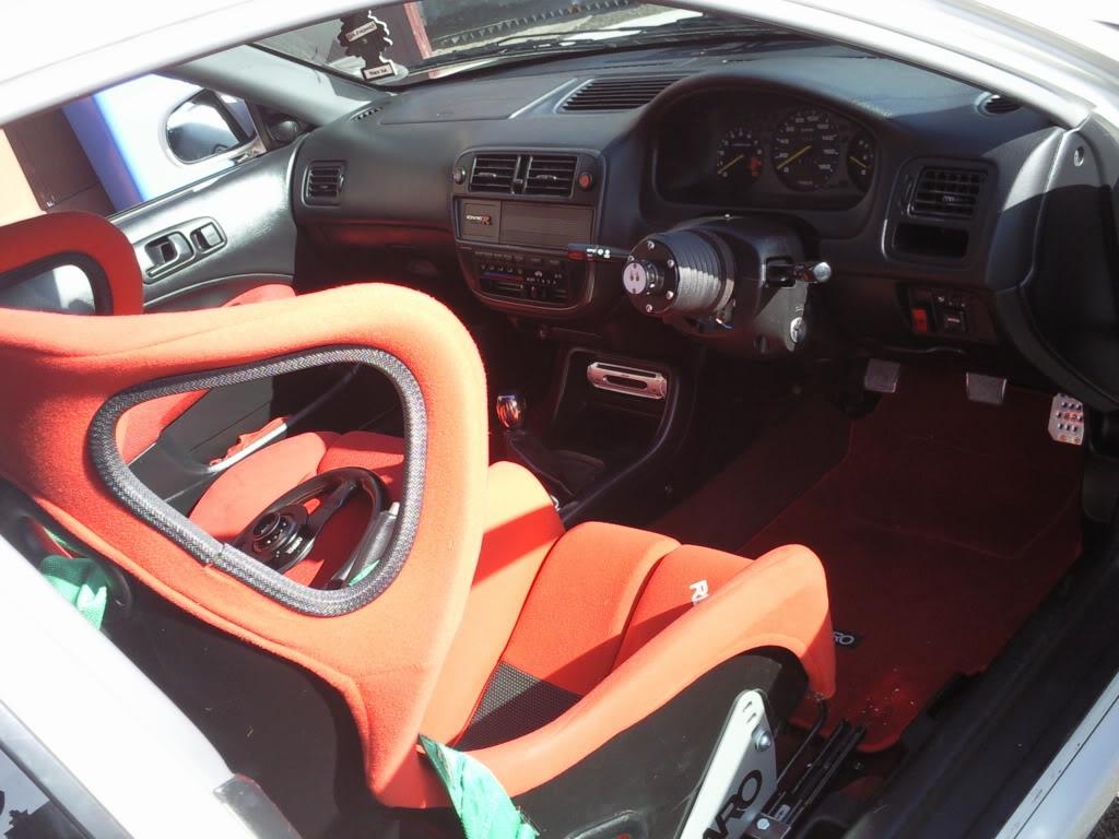

Awesome, love the diffuser. Not a fan of the drivers seat, ott for road cars imo.
You're wrong but thanks for you opinion. :eek: It'll be tracked aswell, Warren iirc.
I forgot to mention the seats, you have awesome taste mate, most people would have fired in a black racer bucket but you've got 2 red ones well played, love the standard ones anyway.
  Charged Superleggera
Cheers again for the kind comments :).
Once its back on the road and mapped it will be getting tracked. It wont be a dedicated track car but would love to get on a few track days next year and maybe a trip to the ring in the summer.
Diffuser and drivers sear are a bit much imo, but it's an impressive thread this!
Thanks ali :)
tbh even a standard ek9 is overkill for the road. Your right though the seat is pretty hardcore and getting in and out is a real challenge unless you snap the steering wheel off. If it was a daily then i couldnt live with it but since it only really gets used in the weekend in the summer i think i can live with it as it offers an great driving position in comparison to the ek9 reclining recaro. As for the diffuser, well in theory it should make a difference by at least reducing some of the drag caused by the rear bumper. Im not expecting a difference really but it should make for an interesting technical exercising at least. Main reason i bought it was for aesthetic purposes really as I have always been a fan of the time attack look with the mad canards and diffusers so thought i would try it on to see how it looks.

Only reason I don't like the seats is the HANS bits. Nowt wrong with fixed buckets, especially in something like this. Love the colour of them.

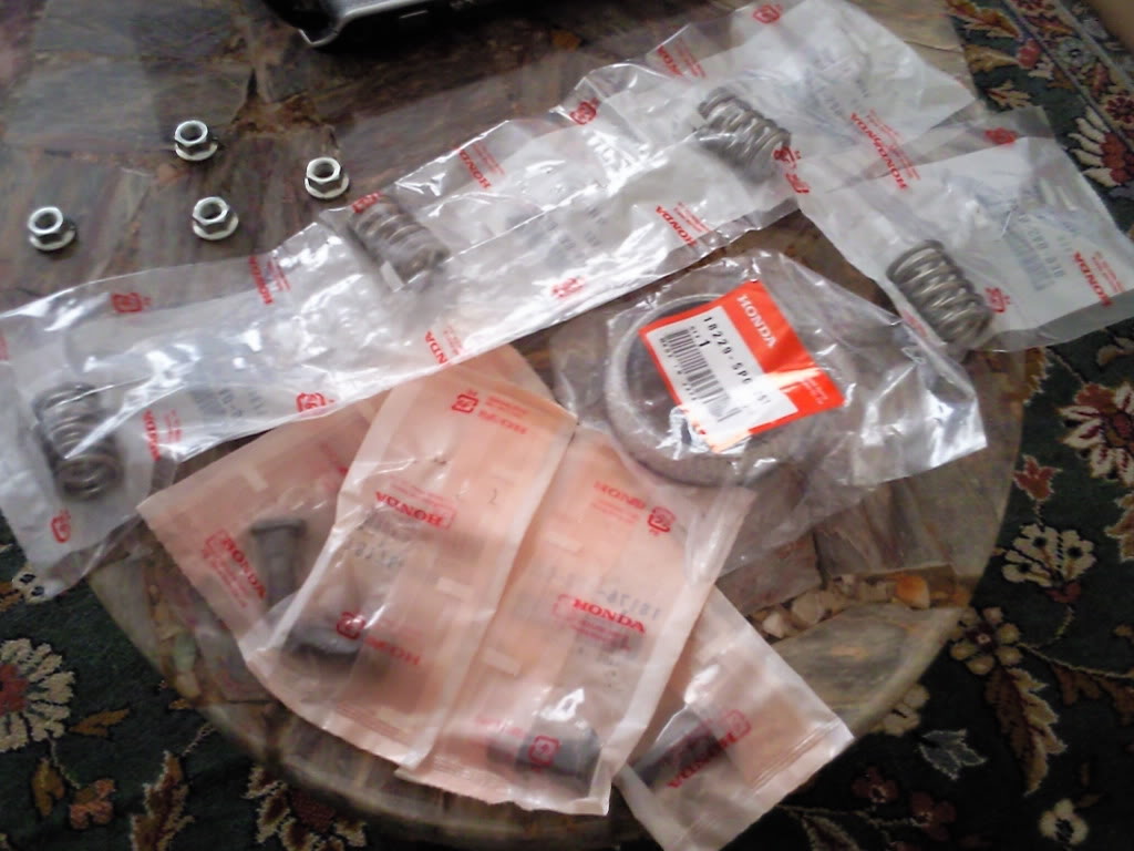

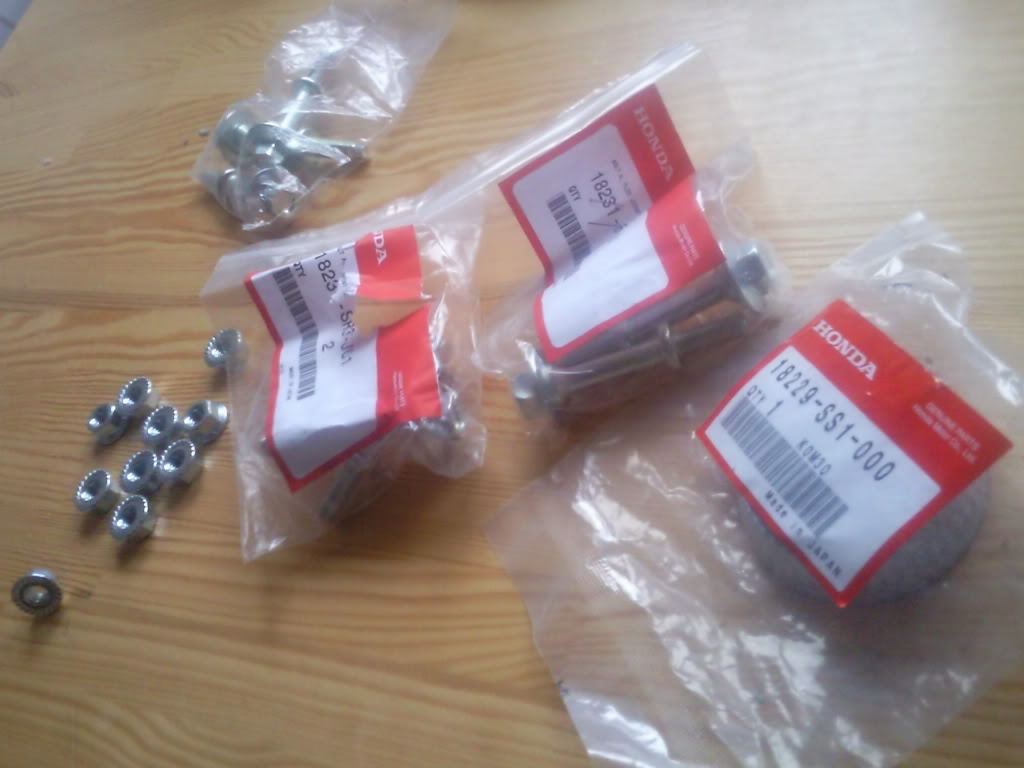

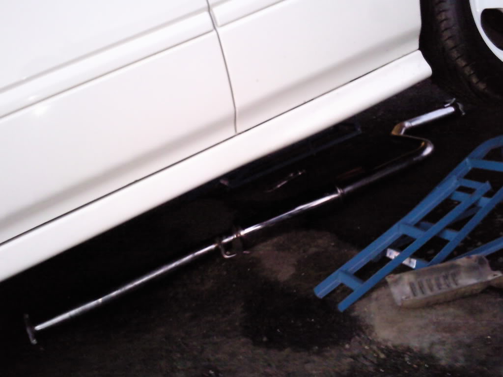

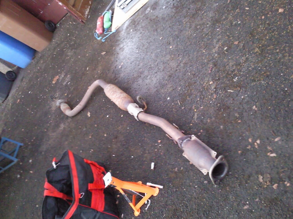

Planned to fit the spoon b pipe so in anticipation of the bolts snapping off i ordered some new bolts, nuts and springs and a new doughnut gasket.

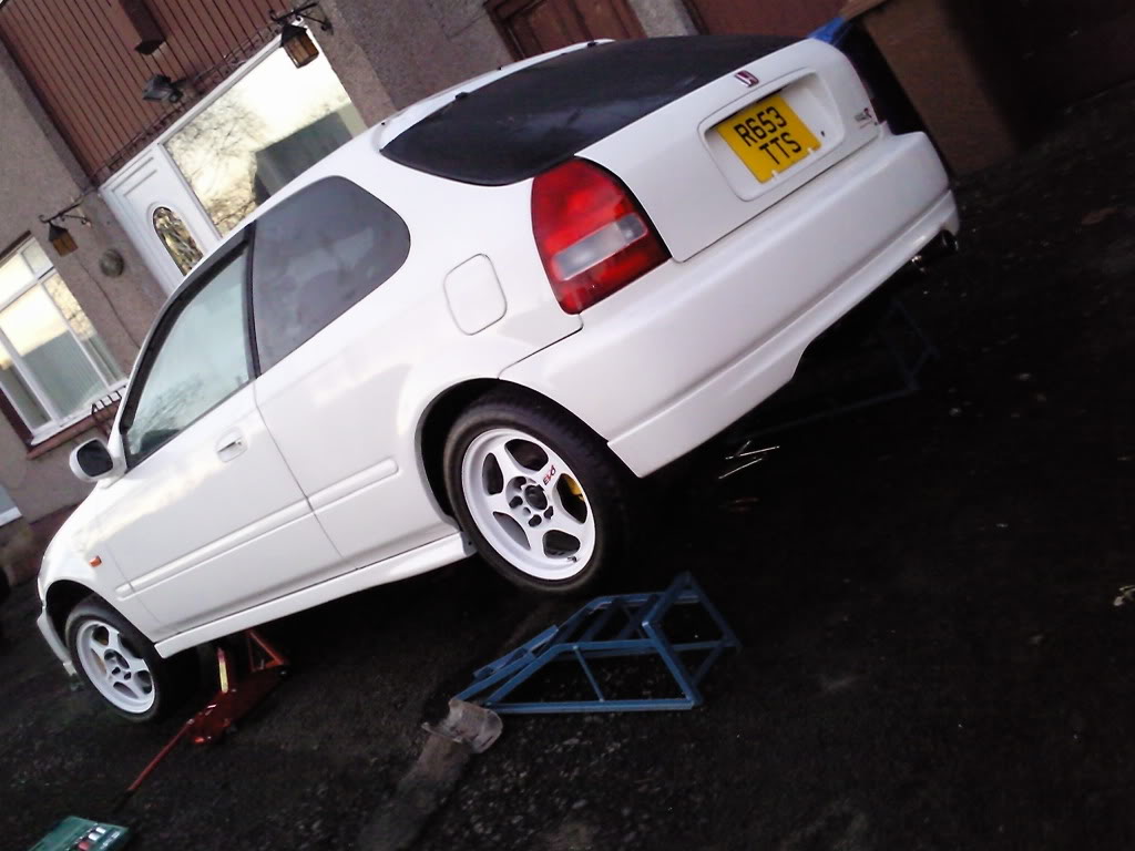

Put the car on the ramp and jacked the front up.

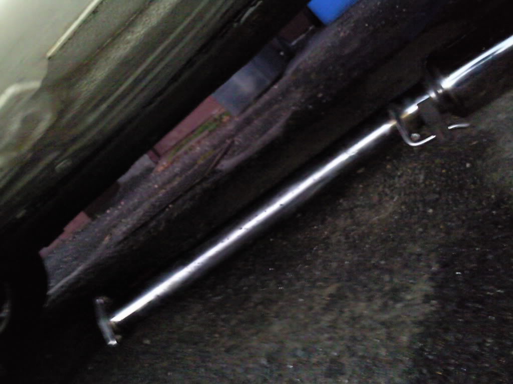

Old b pipe with cat still attached
Spoon b pipe with the 2.5" resonated decat ready to go on.
Once fitted i took it for a short blast and it sounds insane. Seems to pick up revs quicker aswell.

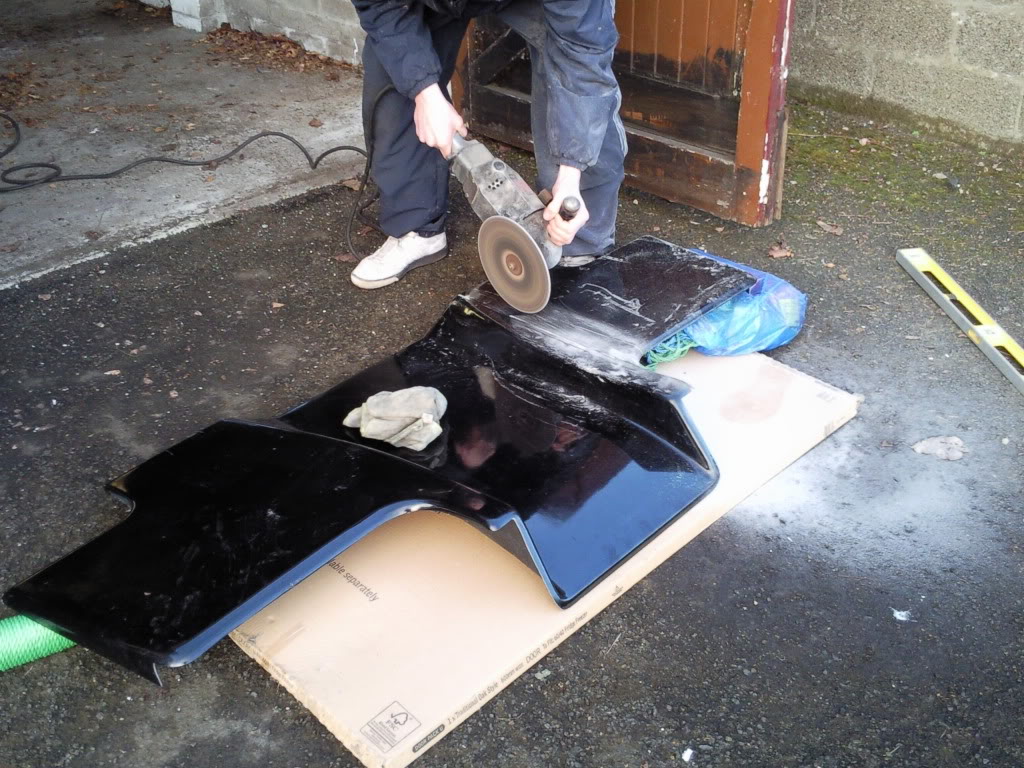

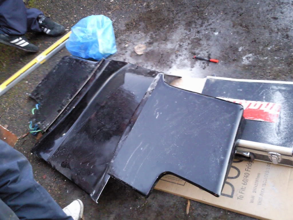

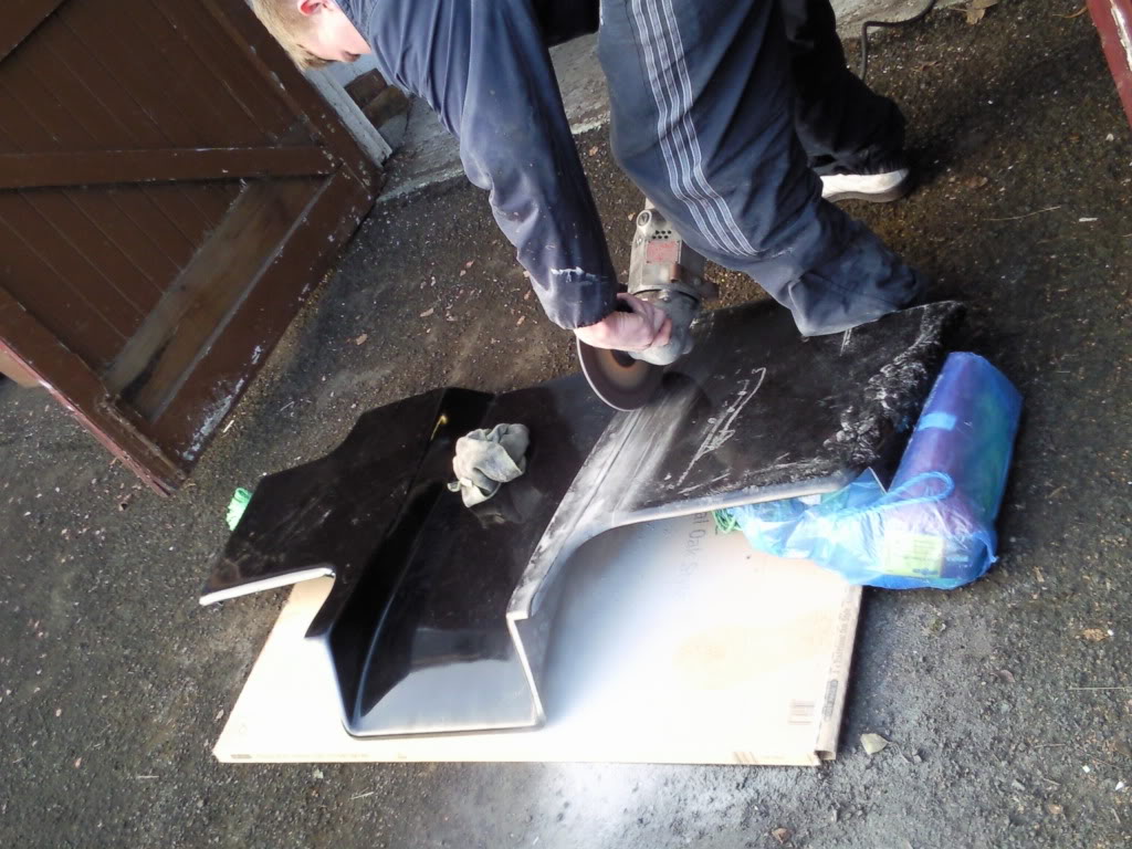

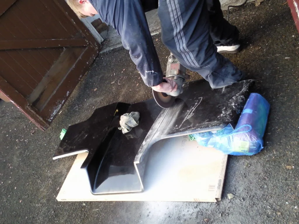

Started with custom fitting the diffuser aswell so my mate came round with an angle grinder and a thin disc and we started. Didnt feel right cutting it but its the only way its going to fit. all went well though and is 80% there.
This is as far as we got with the diffuser as the angle grinder packed up. only needs slightly trimmed from the side then its going to the body shop to get the 3 pieces put together and smoothed out.

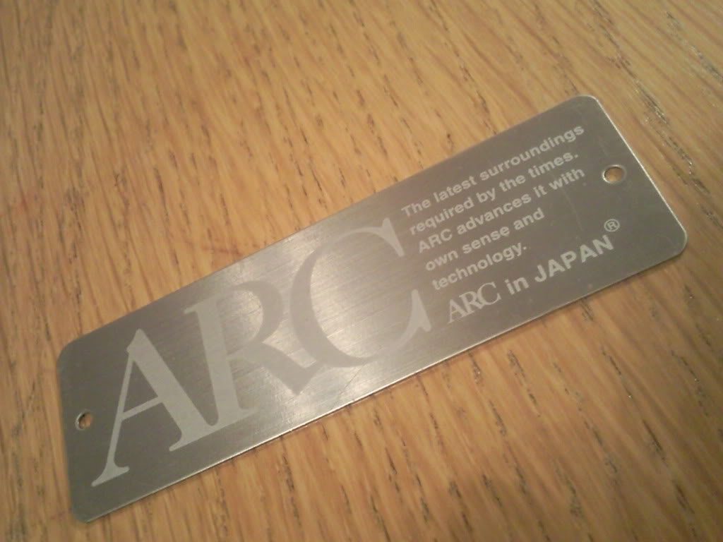

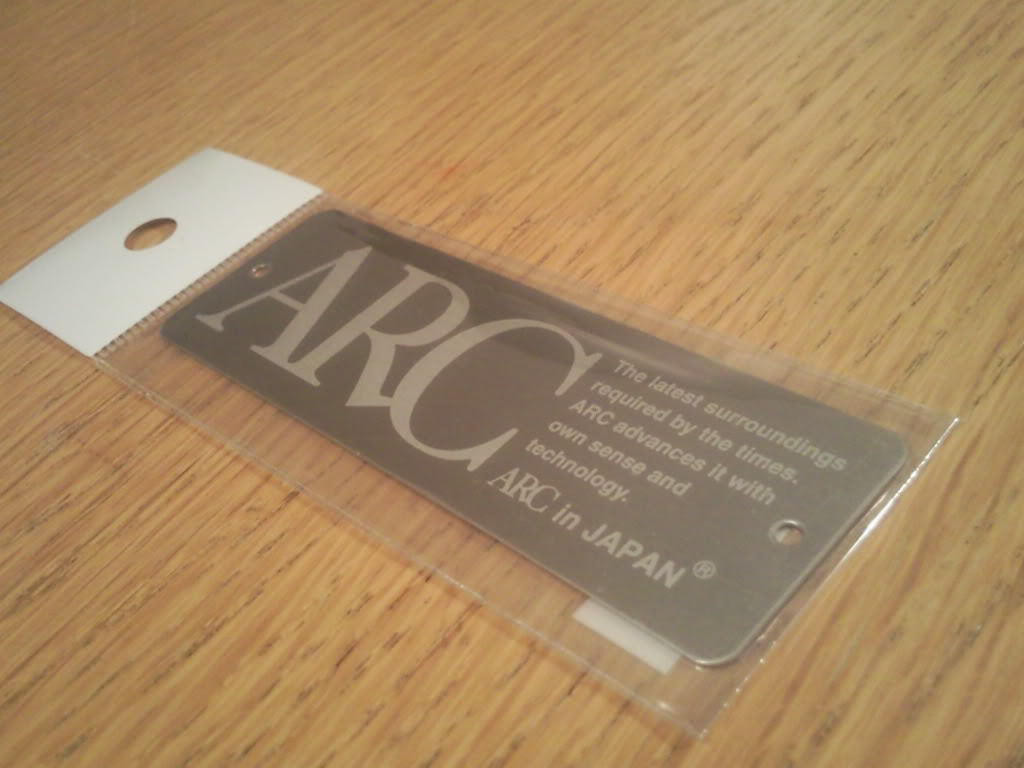

Arc engine bay plaque. not fitted yet.

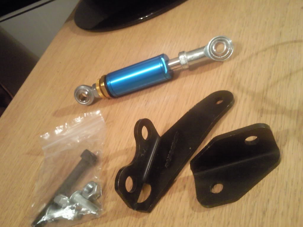

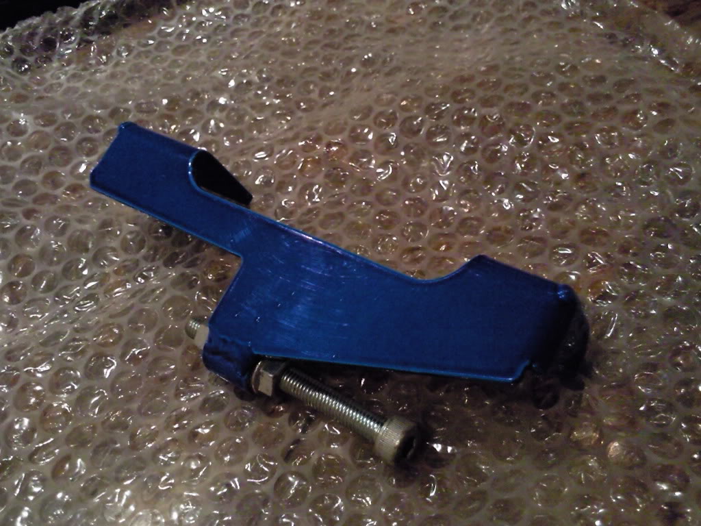

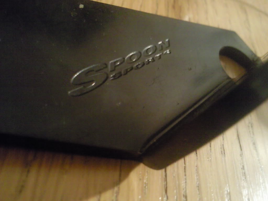

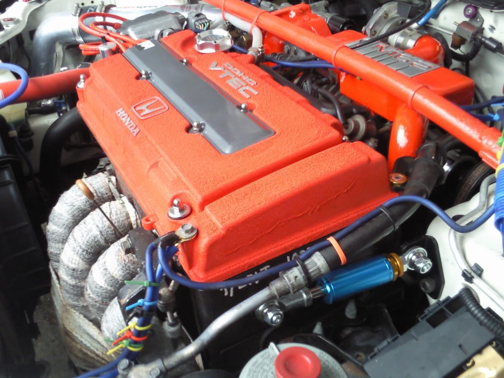

Spoon engine torque damper yet to be fitted. Acts like as an accessory engine mount and helps reduce engine movement and helps with putting the power down at the wheels. Thought i would give it a try before buying solid engine mounts.

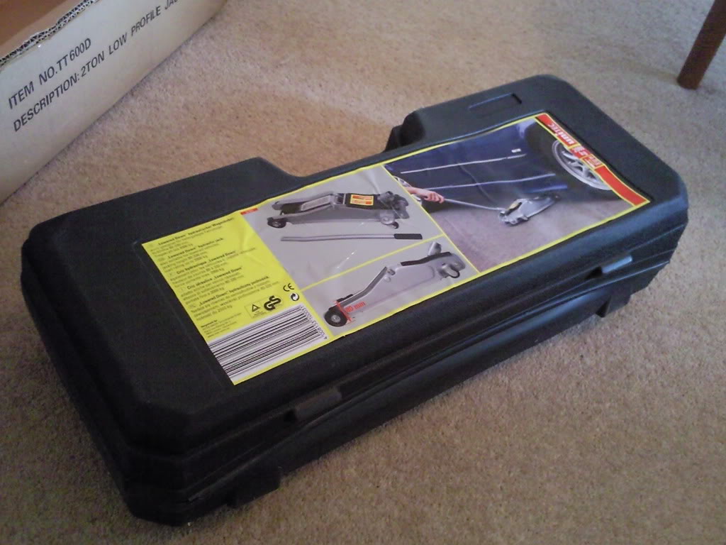

Bought a few tools at the start of the month.

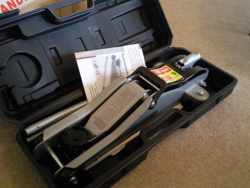

Low entry jack.

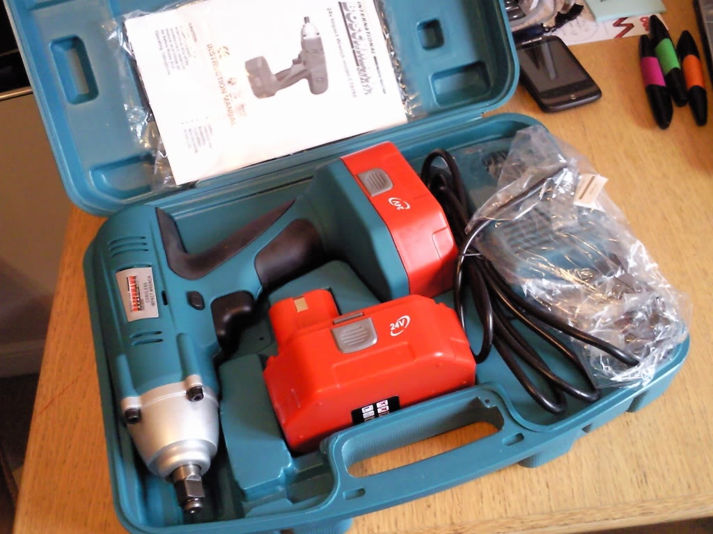

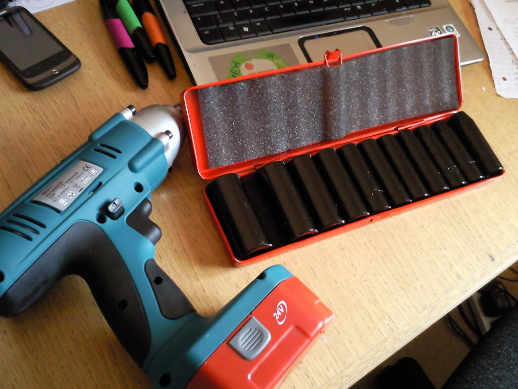

24 volt cordless impact wrench.

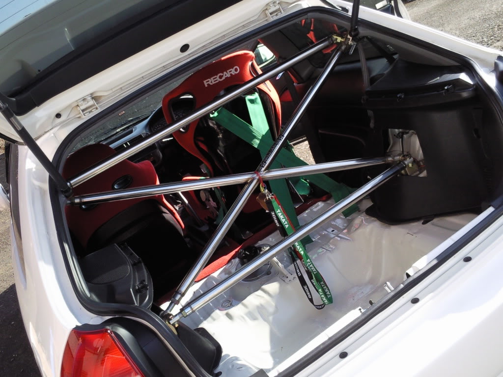

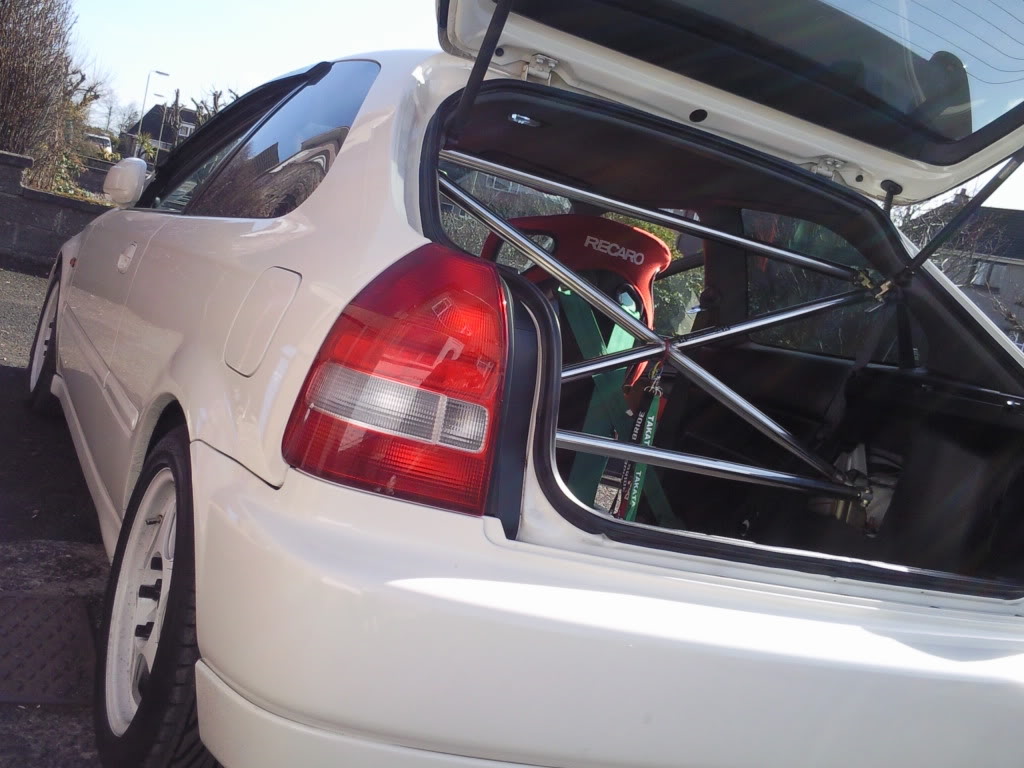

Finally mounted the drivers seat properly.

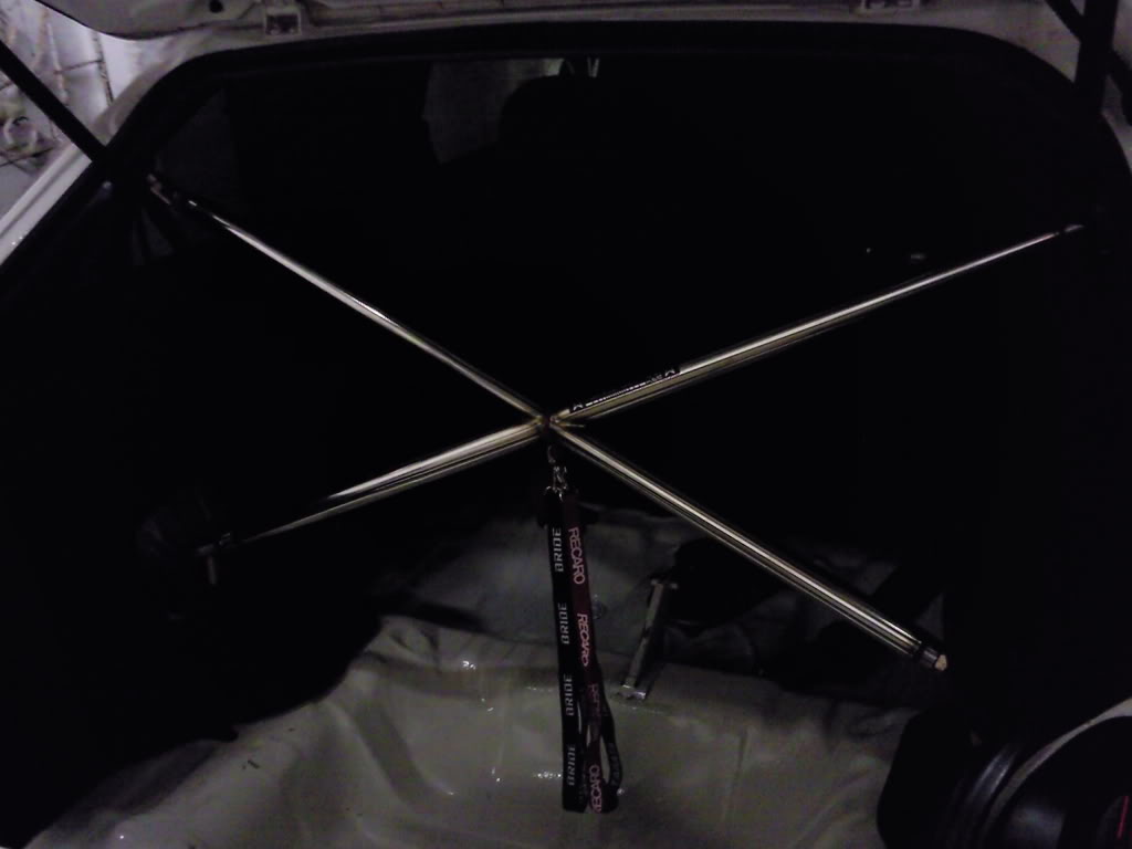

Fitted the miricle x brace upper and lower bars i got at christmas. before:
After

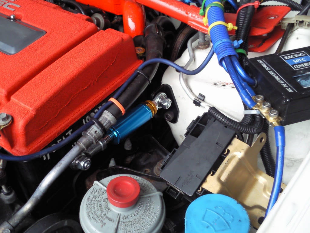

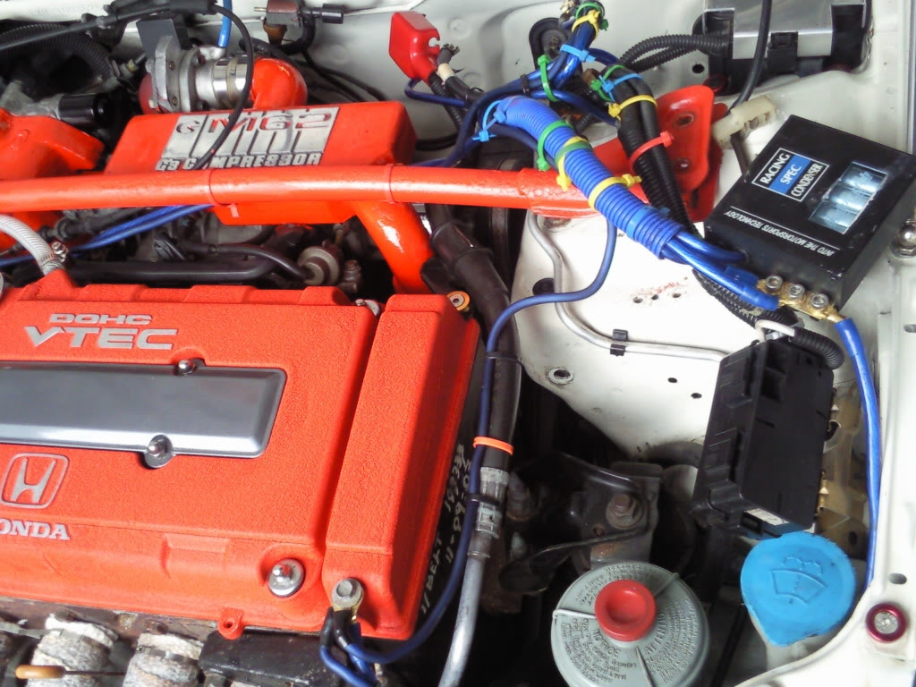

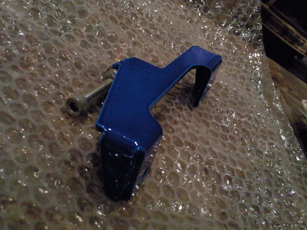

Fitted the torque damper.

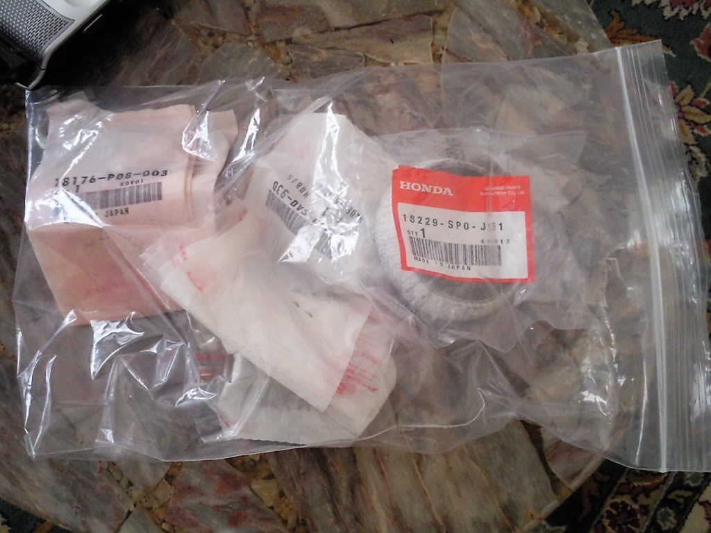

Got a cheeky parcel from a friend at honda lol. cheers again wayne :p

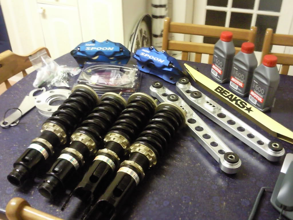

Had plans to fit most things this weekend so brought everything out and set it up on the table ready for the morning the night before.

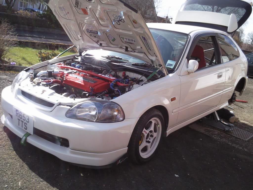

Got up nice and early. Weather was brilliant that morning so akes a change from working in the wet and freezing cold. Started the car up (for the first time in 3 months), let her warm up for and moved her out of the garage and onto the flat part of the drive.

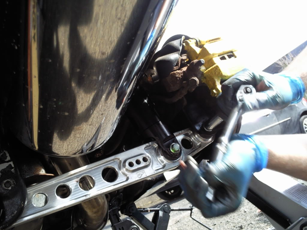

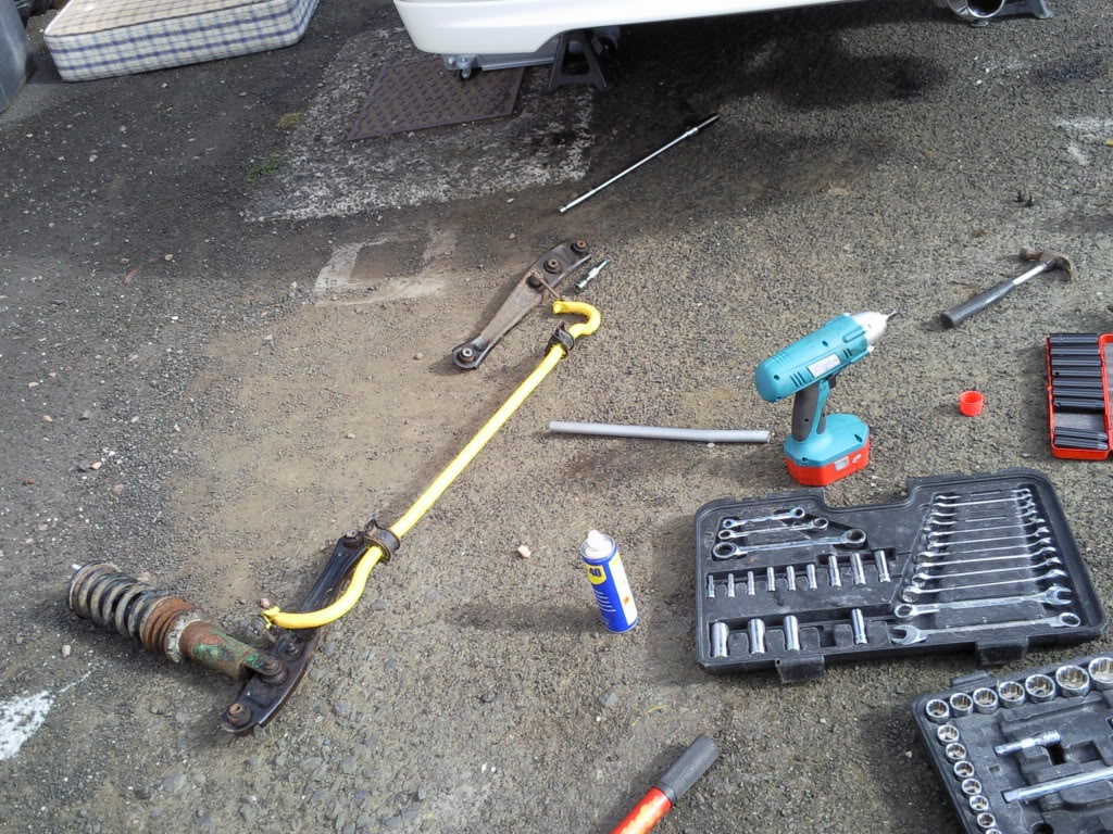

Keith turned up an hour late! :p lol cheers mate you were a big help. Bolts were royally f**ked so was a major task getting them off without snapping them. The impact wrench was useless so had to rely on a good old fashioned breaker bar and a lot of elbow grease instead.
Jacked the car up, took the wheels off and got cracking

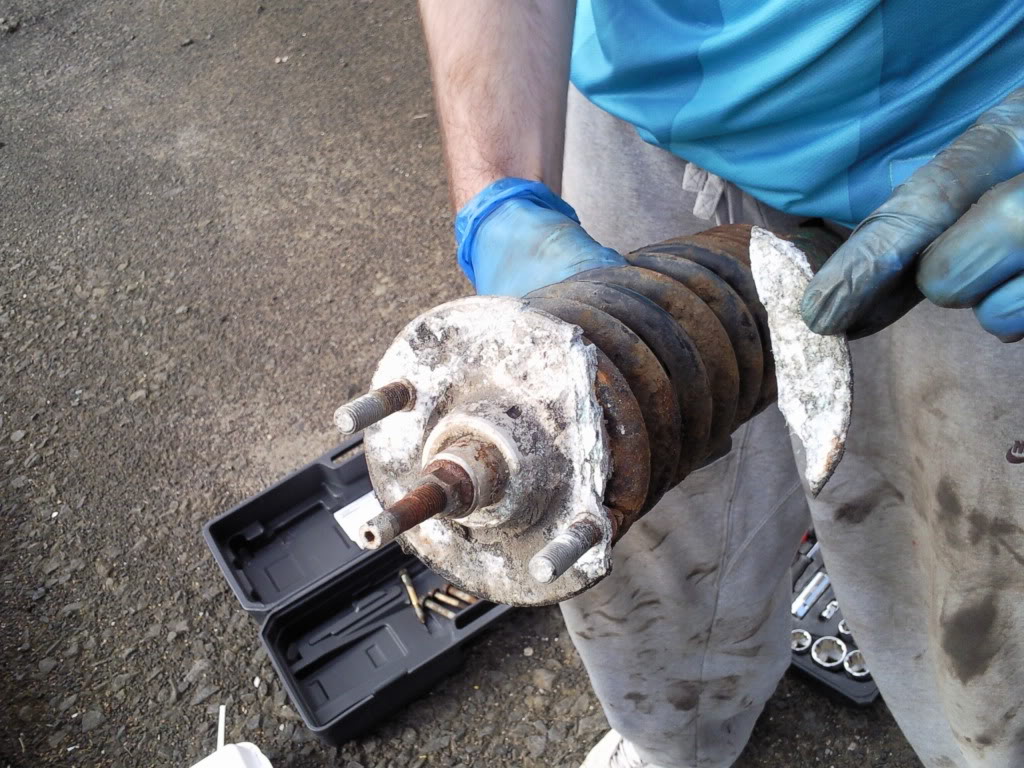

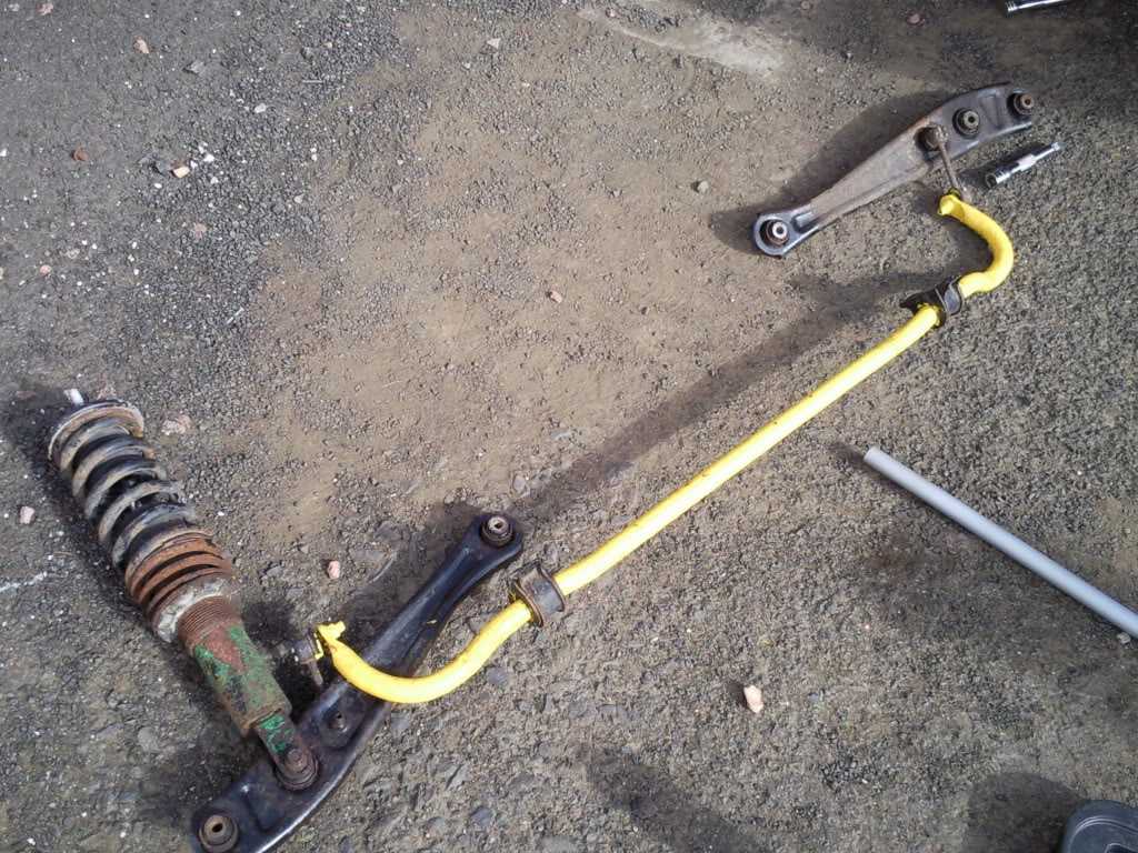

Out with the old. Believe it or not, under the rust exists a set of tein supers street coilovers. The ARB drop links bolts were rusted on to the old control arms and wouldn't come off so since we were changing control arms aswell we dropped the whole unit out with the shock, arb and control arm still attached. Will get an angle grinder onto the drop link bolts in the weekend as i have fresh drop links to go on anyway. ARB is getting sandblasted and powder coated either orange, yellow or white. Still haven't decided yet.
oops disintegrated top mount...

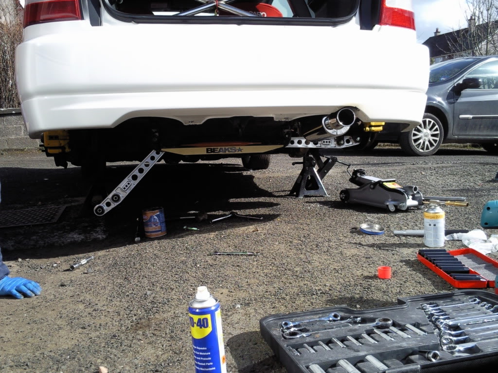

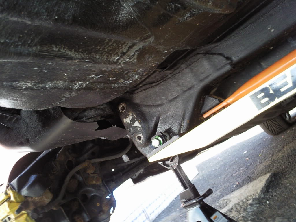

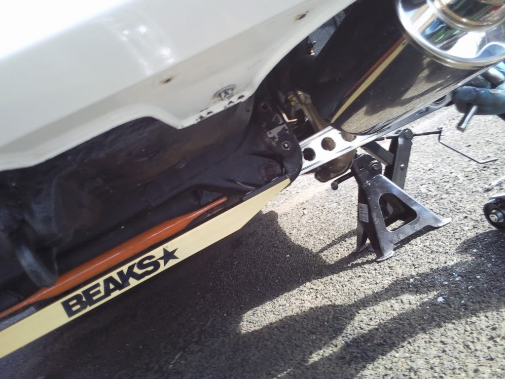

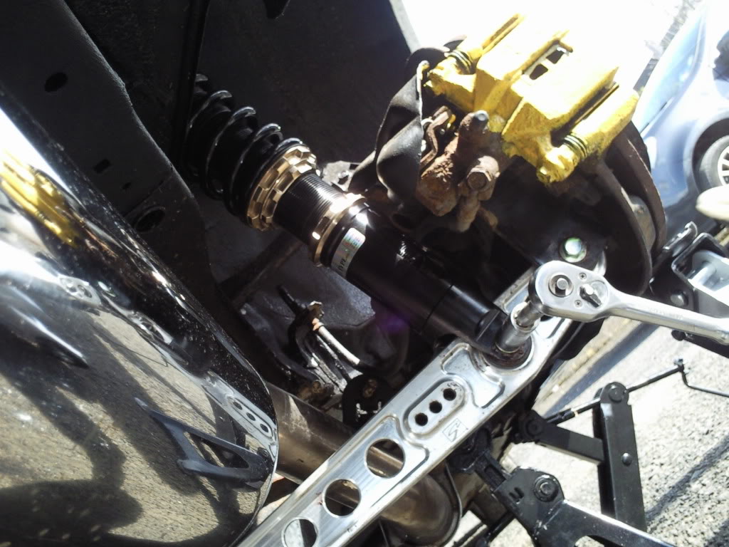

Got the new coilovers on with the skunk2 lower control arms and beaks tie bar on with fresh new bolts from honda. Old ones didnt snap but since i had new ones i decided to stick the on anyway.
Beaks tie bar on
Rear calipers are sticking a bit and will be replaced soon with new calipers, with braided lines and new rear discs.

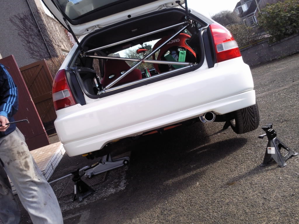

Then tightened up all bolts and put wheels back on. Ride height at the back is good but i still want to fiddle with it a bit more. Couldn't fit the front coilovers or spoon brakes as we had to call it a day as we all had different plans for the rest of the day. Off for 3 weeks over the easter holidays on friday so should have the front coilovers, spoon brakes and diffuser on this weekend. Also got a few bits in the post that should arrive sometime this week so hopefully get them fitted aswell. should have it back on the road and taxed within the next 2 weeks. Really cant wait..
