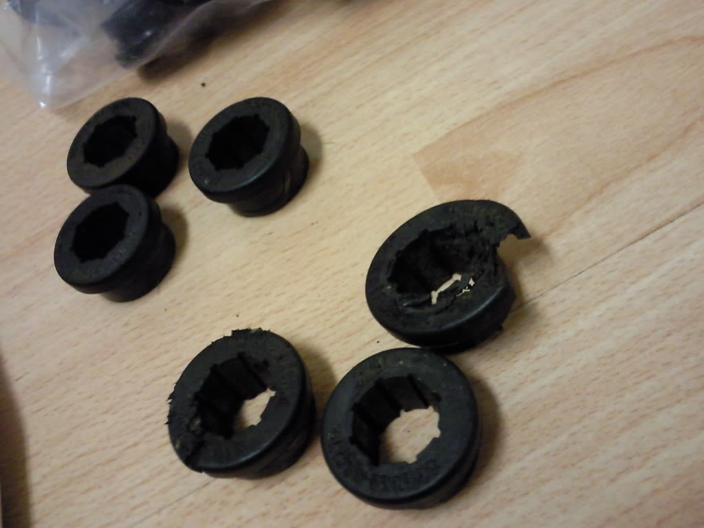

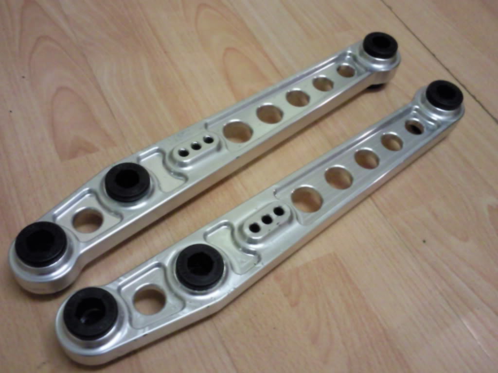

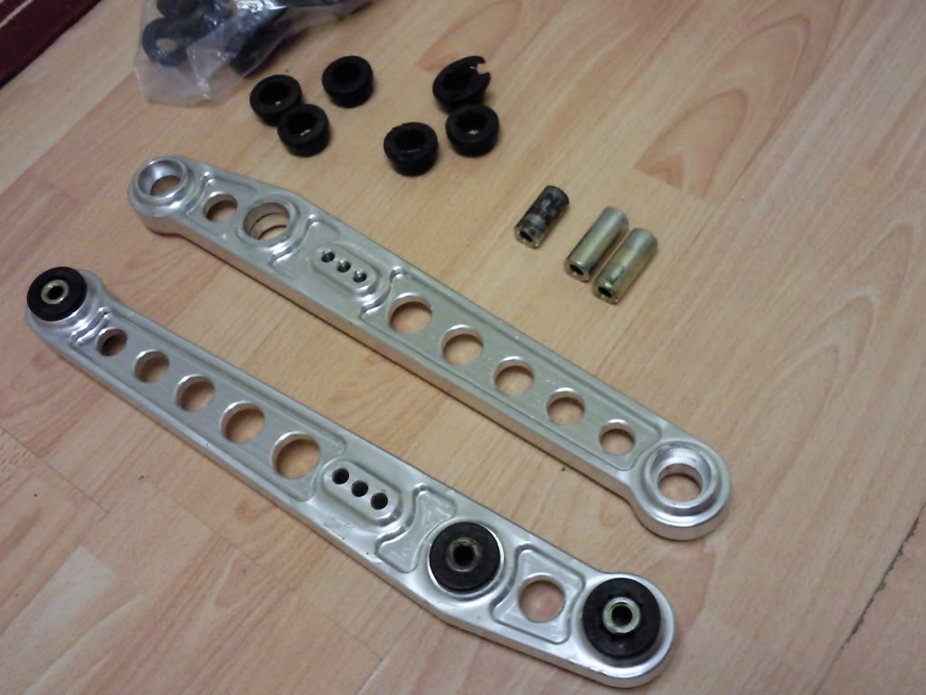

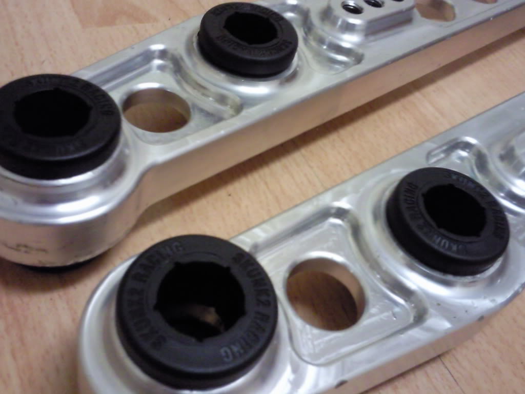

Finally got round to changing the bushes on my lower control arms.

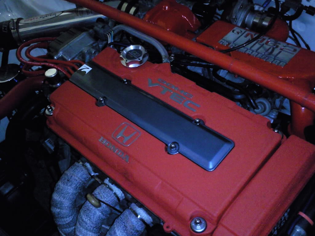

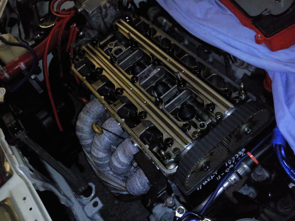

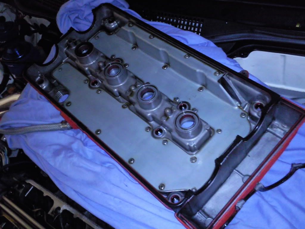

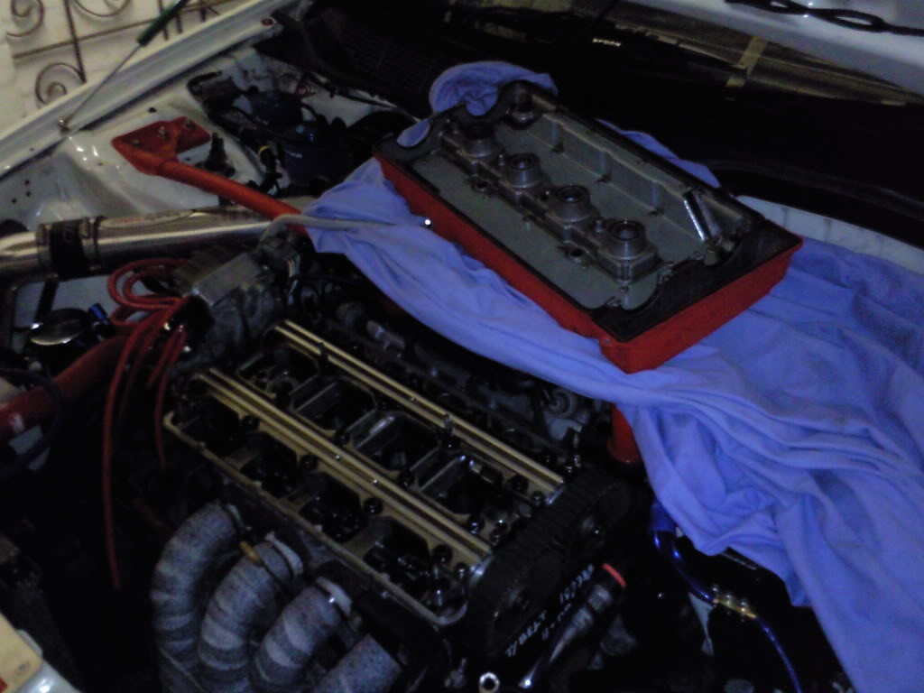

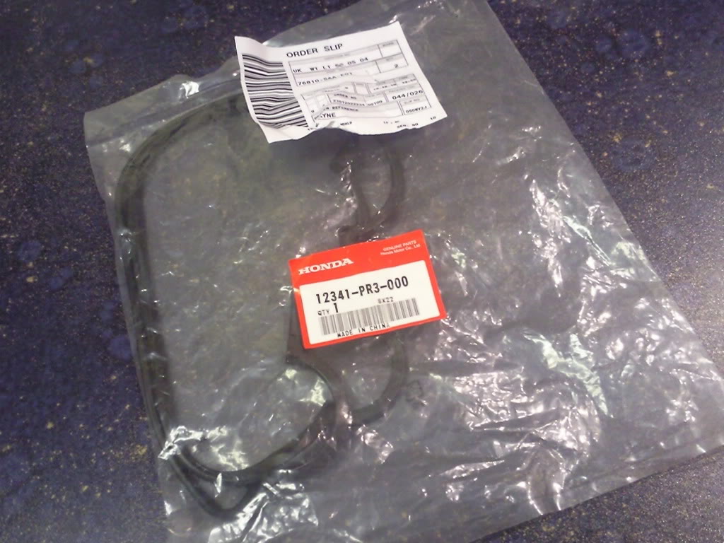

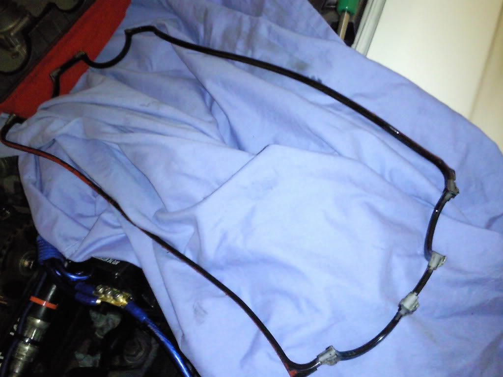

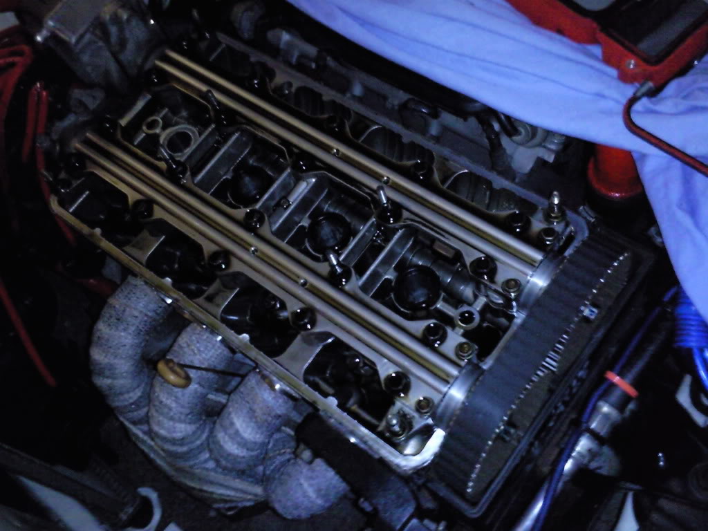

When i repainted my rocker cover in the summer i never replaced the gasket so i picked a new one up a couple of days ago and fitted it.
New gasket on and everything fitted back up

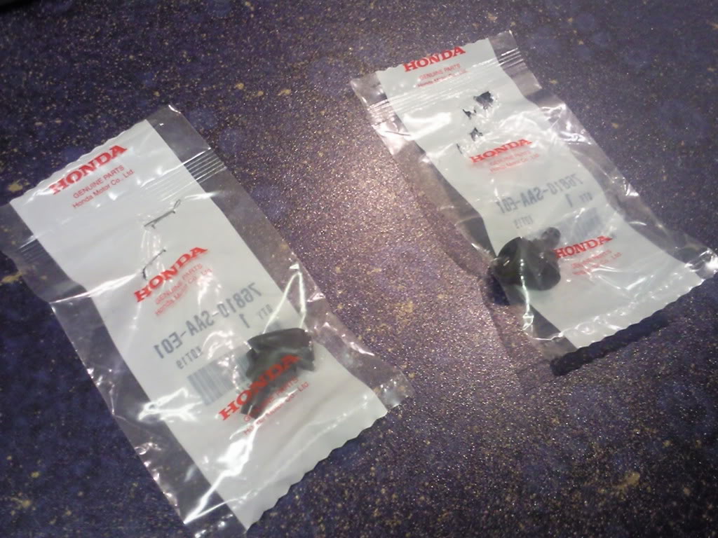

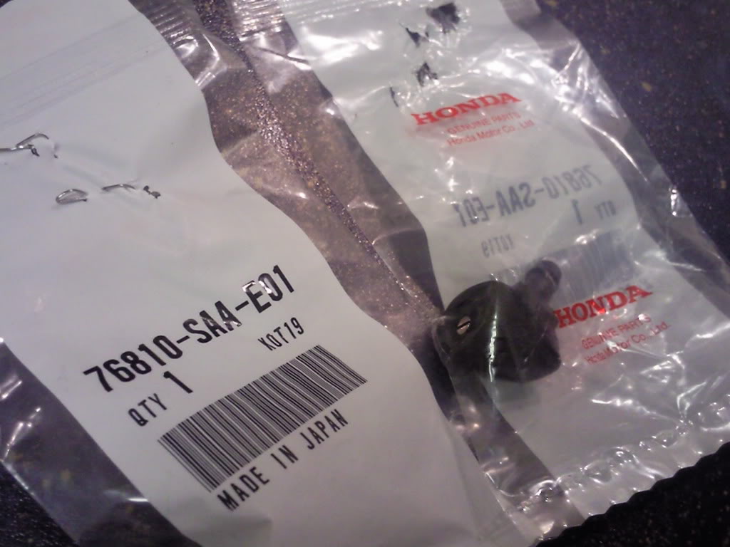

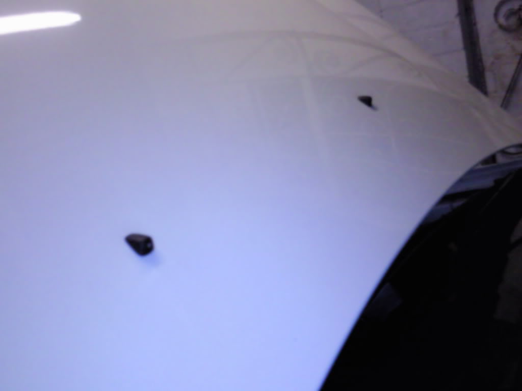

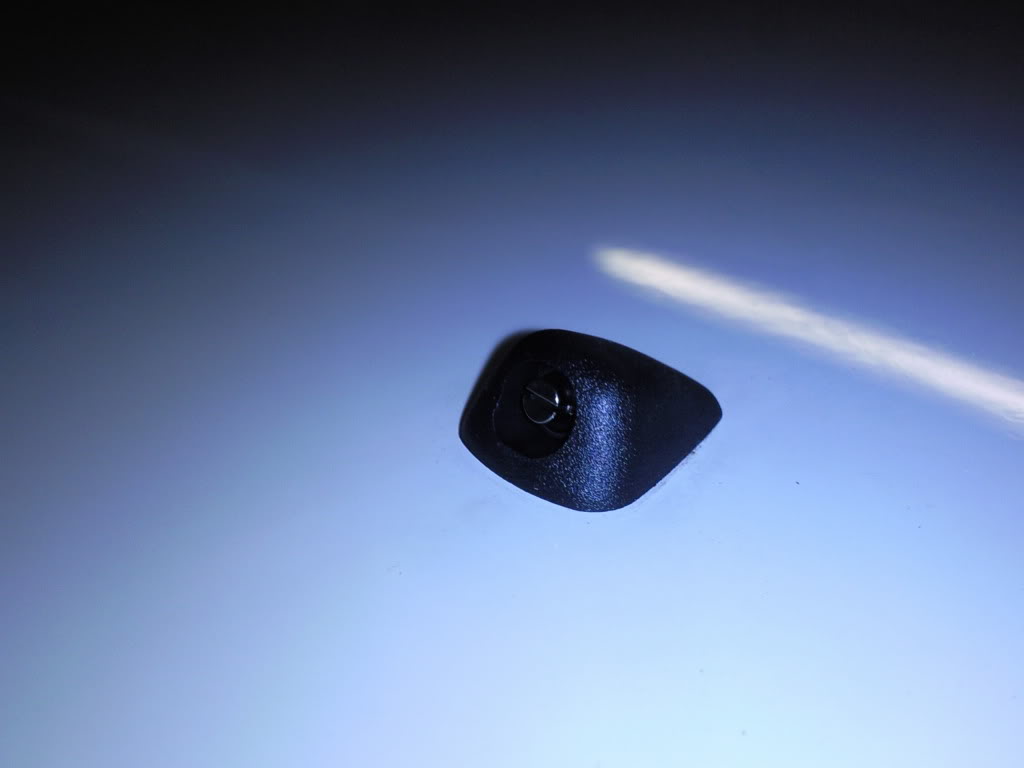

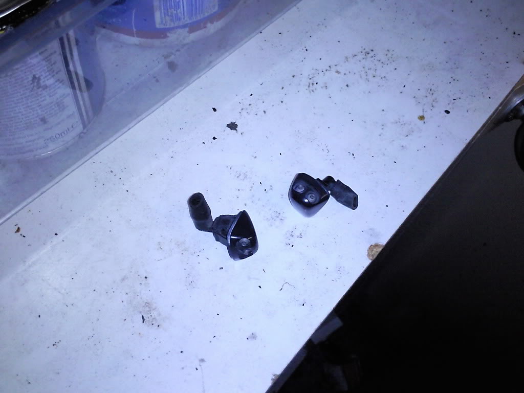

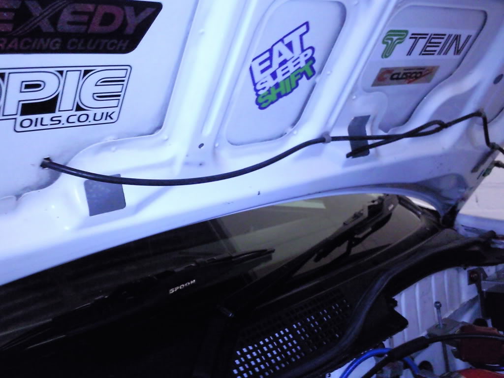

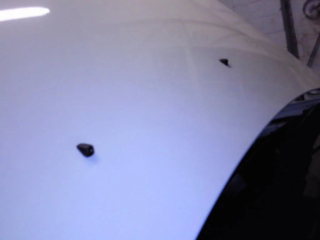

Also picked up a new set of honda jazz washer jets as the ek9 ones are awful.
Out with the old ones
gave it a wipe down before i fitted the jazz jets

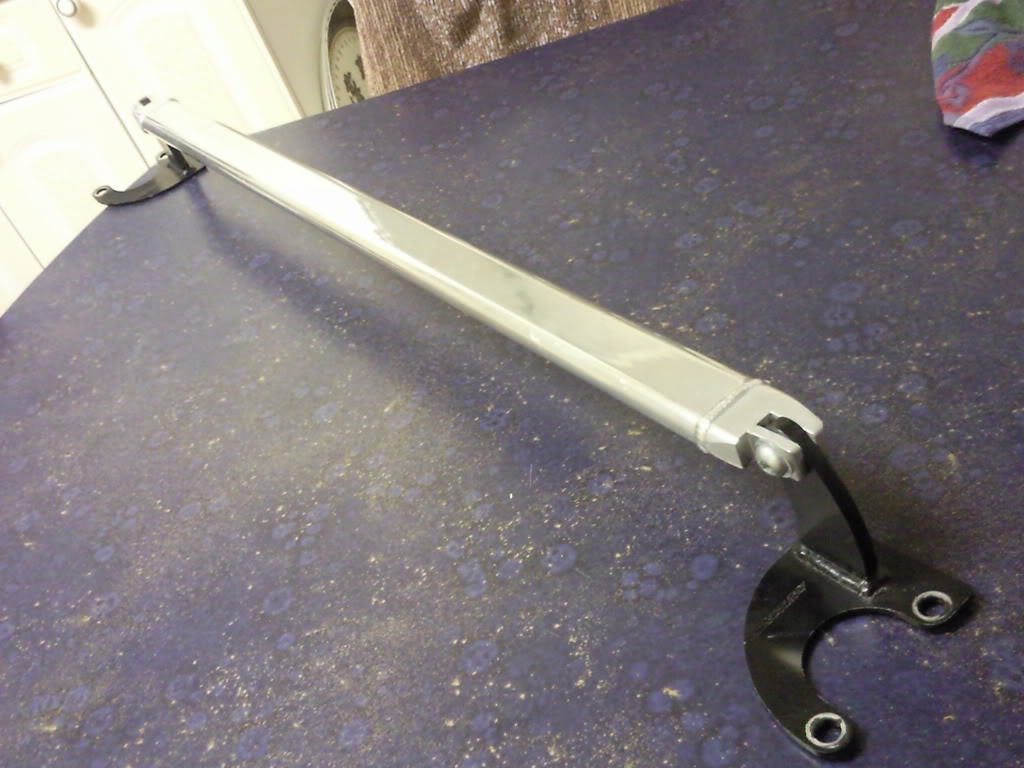

Also got hold of a rear spoon strut brace but i have decided to keep the miracle cross bar instead. The spoon strut brace is very light though, much lighter than the miracle cross bar but i love the cross bar and its pretty rare so getting hold of another one will be difficult.

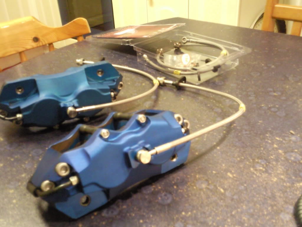

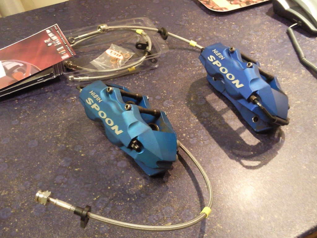

Was hoping to fit the spoon brakes this week. I ordered 3 bottles of motul rbf 600 brake fluid and only 2 bottles turned up so i was pretty disappointed as it means that i wont be able to fit them till after the new year. For 3 bottles i was just under £50 delivered but it was highly recommended and its meant to be very good stuff so looking forward to getting the calipers and lines on, bled and see how much of a difference it makes. Pads and discs will probably be changed nearer mot time as there is still some life left in them.

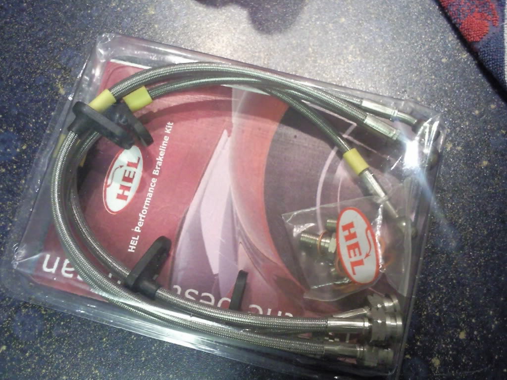

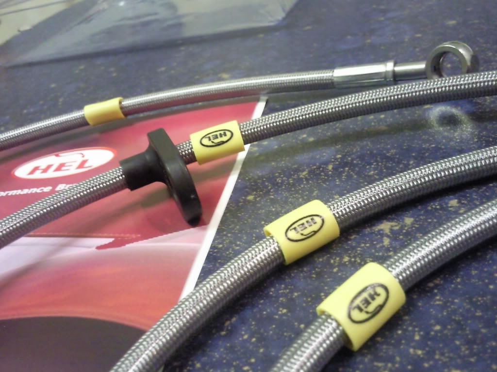

Also ordered some hel braided lines to go with.

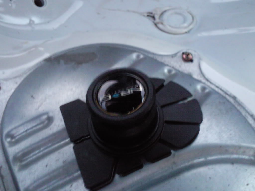

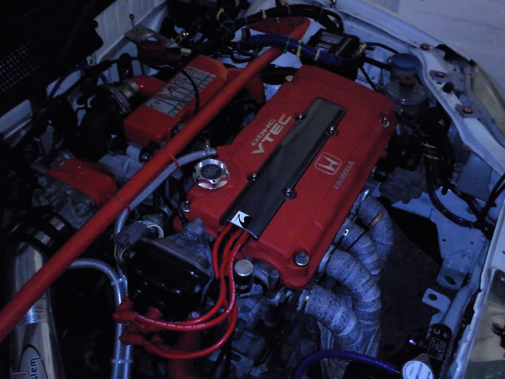

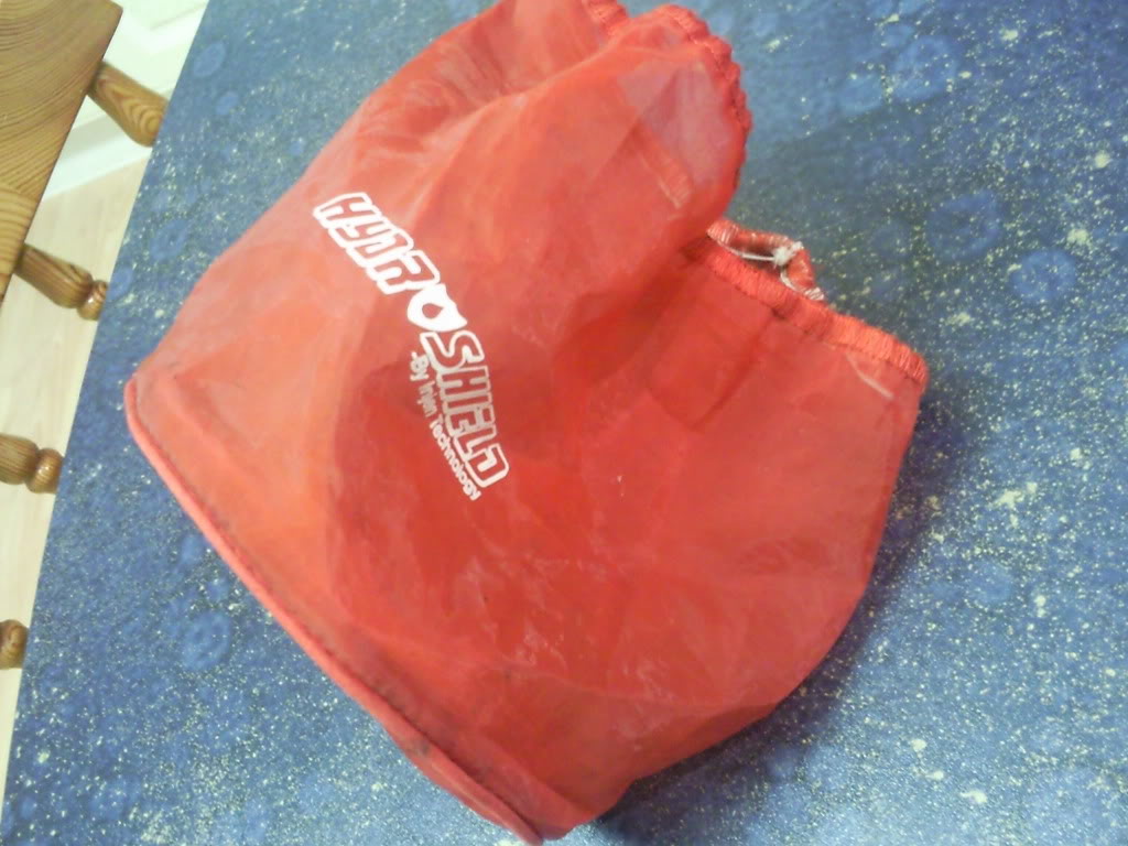

Picked up an aem hydro shield as the the aem intake i have positions the filter down infront of the wheel arch meaning that if you go through a large puddle the filter will suck water into the engine(hydro lock). This hydro shield is meant to cover the filter and protect it from hydro lock.

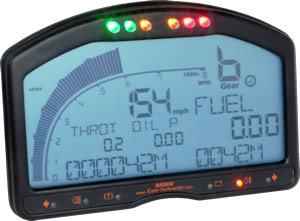

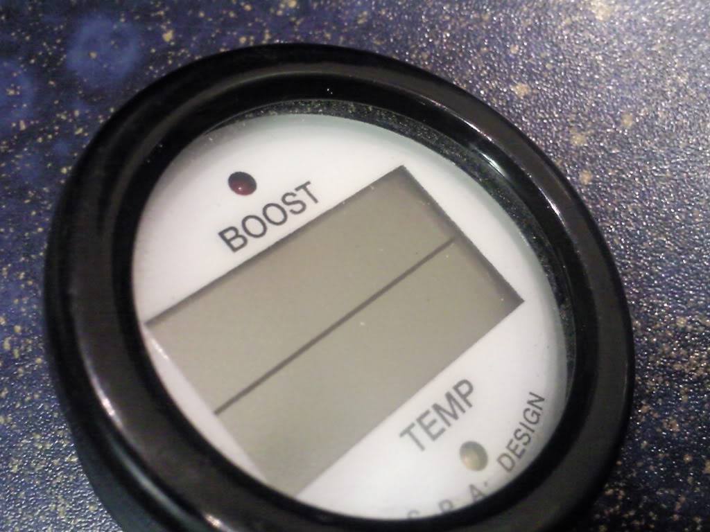

Spa fual gauge also arrived but have different plans now. Thinking about a digital dash instead.
Digital dash, will be ordered once i know which management im going with for definate. As far as i know its plug and play with dta and no hard wiring is needed as it reads everything from the ecu.

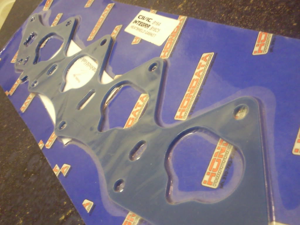

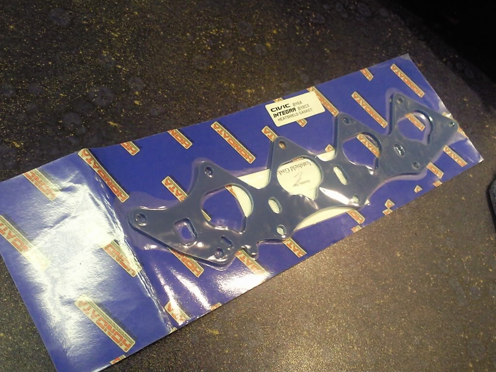

Got this hondata inlet heat shielda while ago. Meant to lower intake temps a fair bit

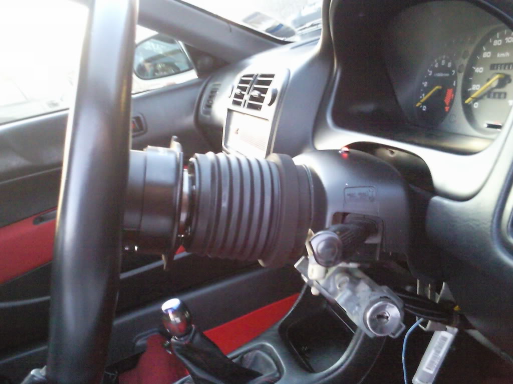

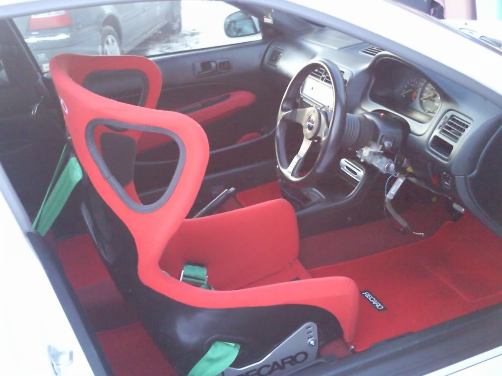

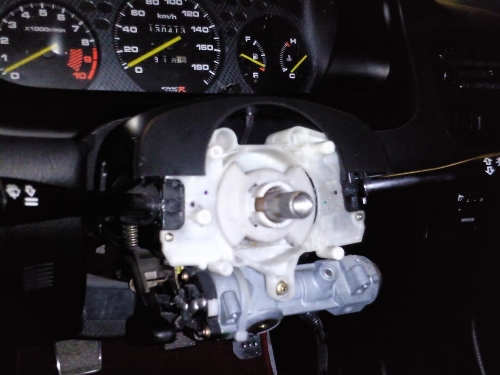

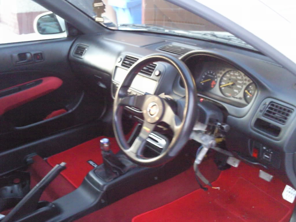

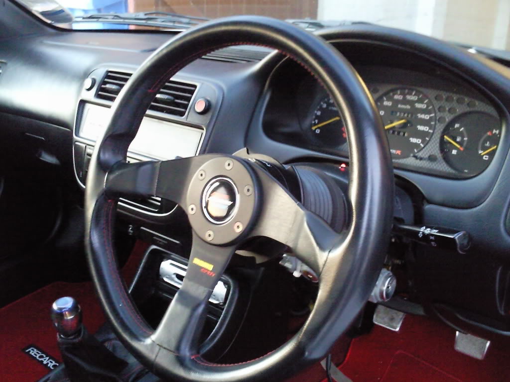

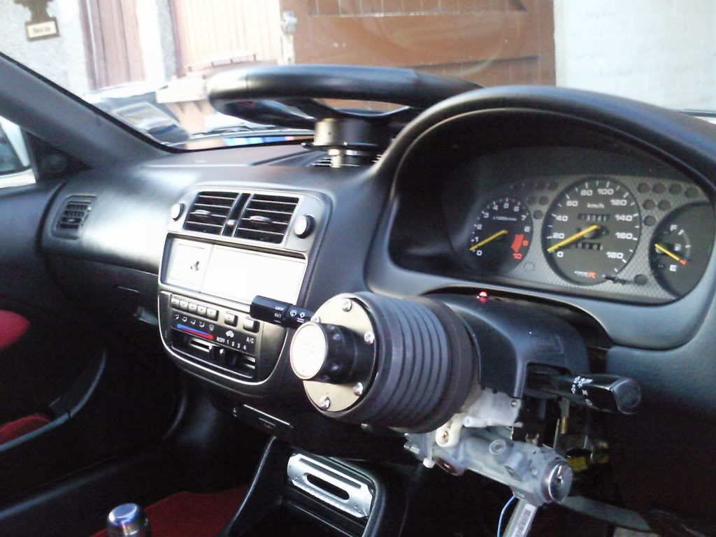

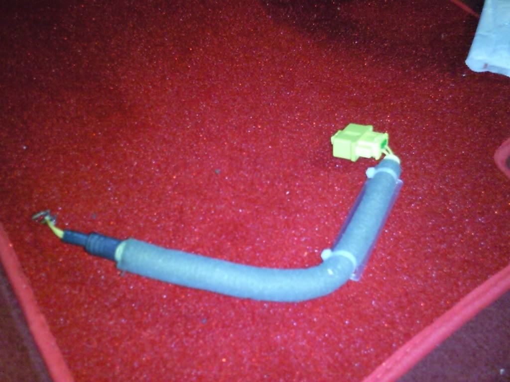

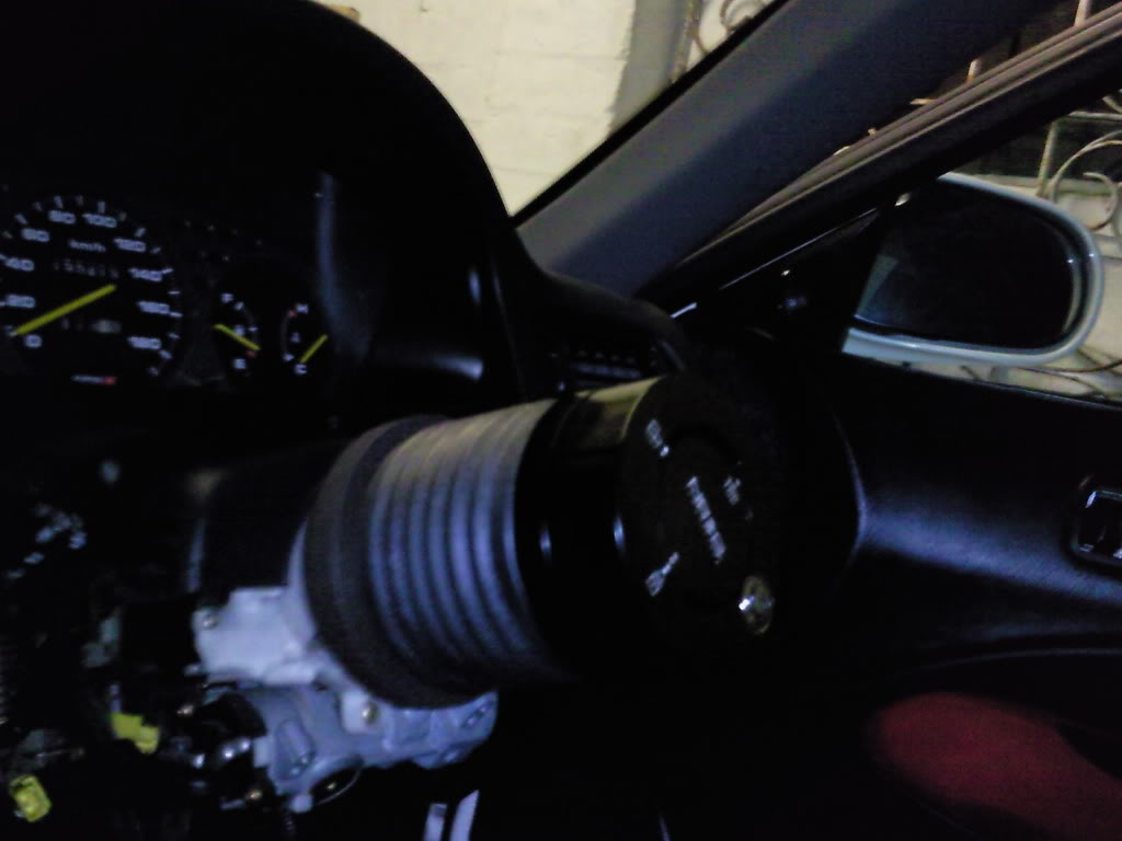

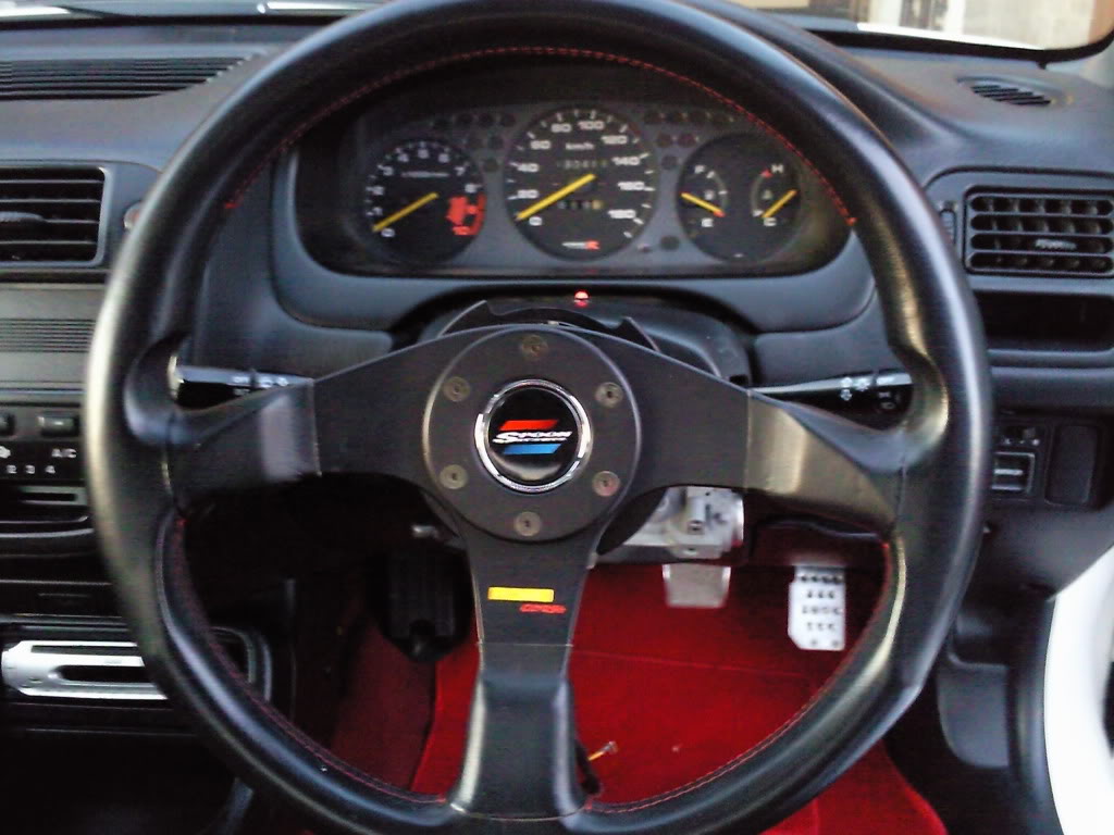

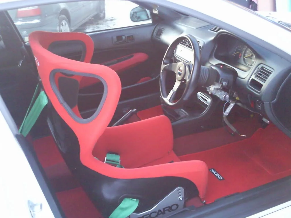

Also finally fitted the steering wheel/hub set up. fairly straight forward apart from rewiring the horn was abit of a faf. still waiting on a resisitor to turn the srs light out.
The steering wheel sits much closer to the driver with teh combination of the momo hub and quick release. Should make for a good driving position with the recaro pro racer seat once the rails are here.

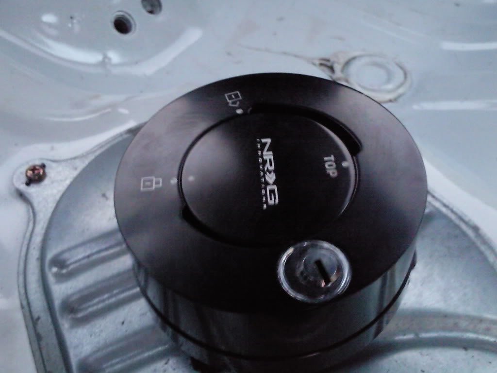

Lock on so another steering wheel cant be put on.
Got this to turn off the srs light. just waiting on a resistor for it.

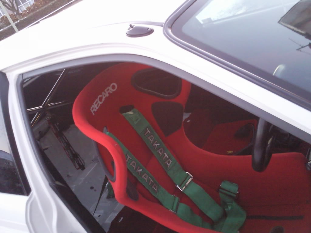

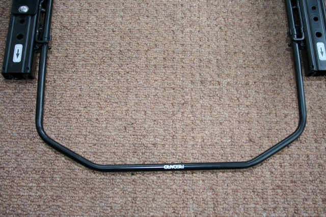

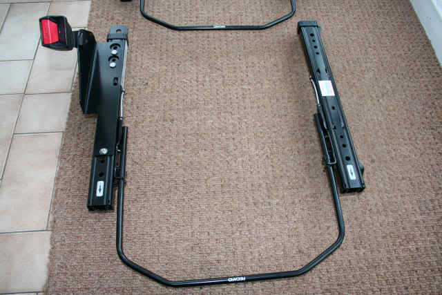

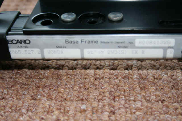

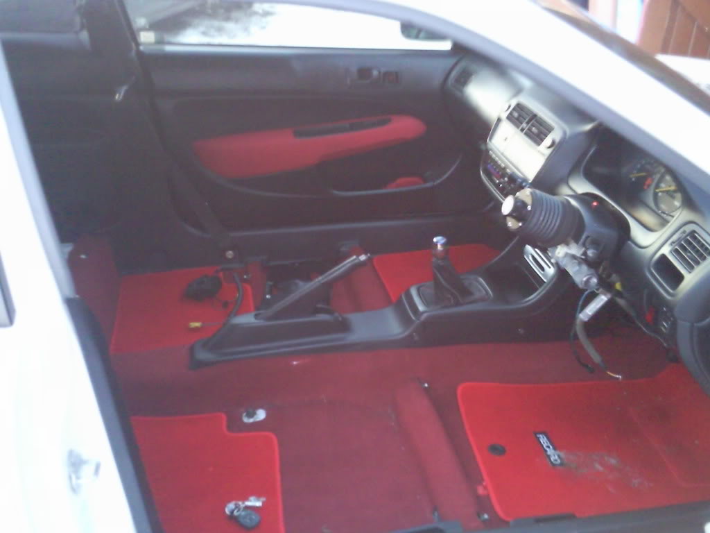

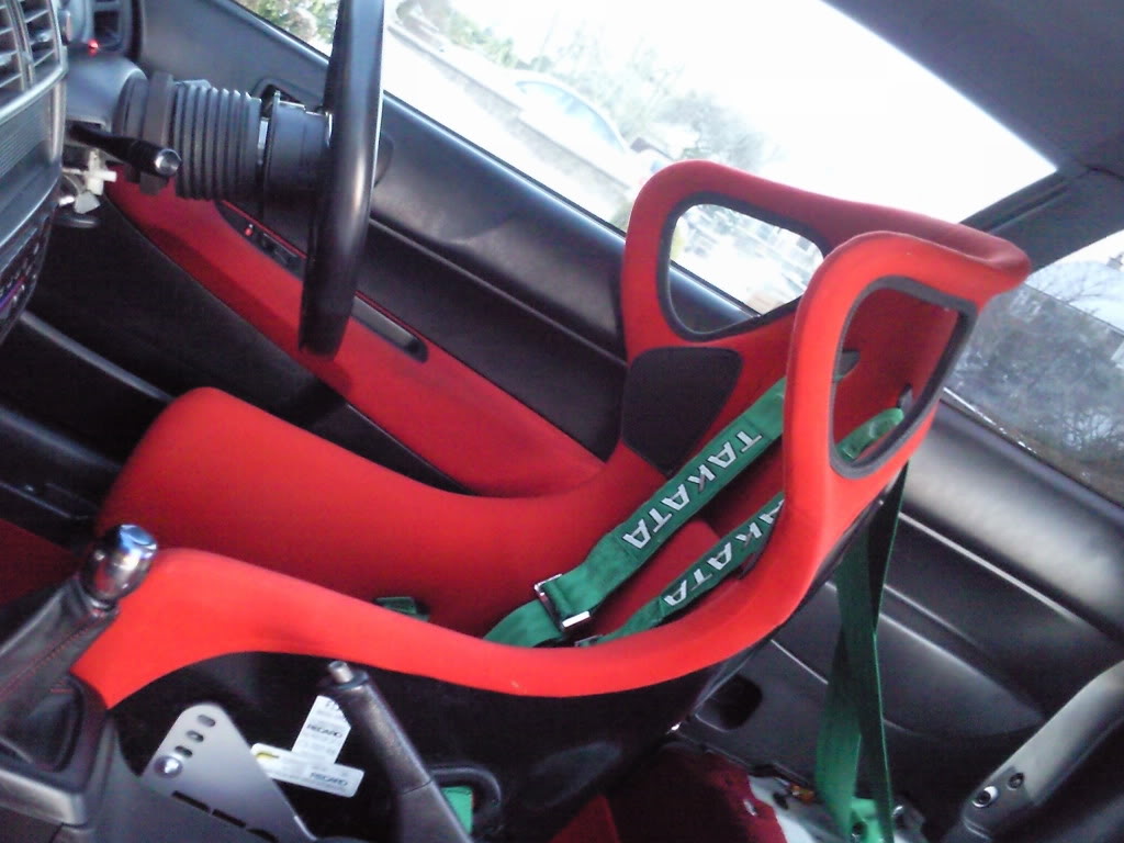

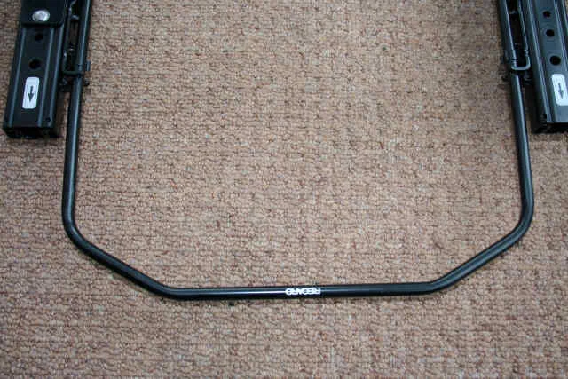

As for seats im still waiting on lowered recaro subframes. Wont be here till after new year though so currently have no seats. I bought a tommi makinen edition recaro seat for the passenger. that has been in transit for the last 3 weeks. Its a bloody joke tbh and im getting pretty pissed off with the city link.
Was tempted to stick the seat in just to see what it would look like so rolled the car out of the garage and mock fitted the seat. Also glad i went for the snap off steering wheel as it makes getting in and out of the seat alot easier.
