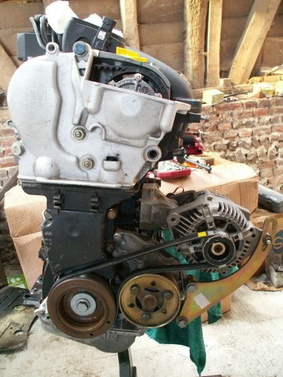

Thanks franx,i have the rack etc but before i fit the engine i wanted to remove the p/s pump and re-route the shorter belt onto it without the pump,i take it thats what i need to do and what route does the belt take around the water pump and alt,thanks
as far as i can see if i use an 850 belt and the water pump sits between the belt so its being turned by the bottom part of the belt then the water pump will be turning the opposite way to standard and that aint good,any advice please,thanks
easy
