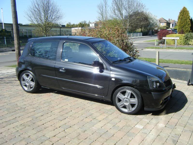

Got a set of 172 alloys off a member on here, Delivered weds although missing them and having to travel to City Link depot was a pita.

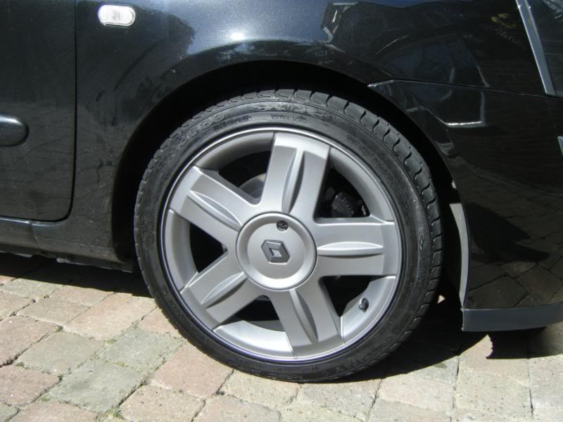

Took me 1 evening and 2 days on and off to refurb them in Rover steel grey, Its no where near perfect but you cant tell unless your close up.
Love the look... Only problem is the very slight rubbing and sort of air resistance sound, Which i think could be the tracking needing looking at at possibly front spacers.

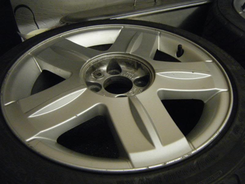

Before, For reference:

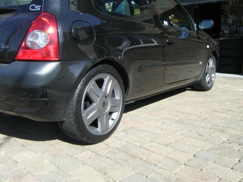

Is the tyre on the rear wheel on the right way around? It looks the a directional 'V' pattern.
nice colour, bit differnt to anthracite but i like :)
tyre is the wrong way round ;)
yea that looks like the right should be on the left side. very nice colour mate
Oh.. :o
I thought the v pattern pushed out, But thinking about it now yes they are ! ha
The front left tyre is MOUNTED on the wrong way round.. Will this be ok? Im wondering is its also contributing to the slight noise.
Will get those changed round tonight...
The rears arent rubbing on anything but i think the rubber moulding spikes are brushing against a mounting thats close, Think ill snip the rubber spikes off and see if it stops.
Got to wait till monday for the tracking.
Rear wheels have been switched round now, Clipped the little moulding spikes off and it seems to have got better. Still think i need spacers on the front..
But i think the brushing of the spikes was causing some of the noise seeing as it is a tight fit.

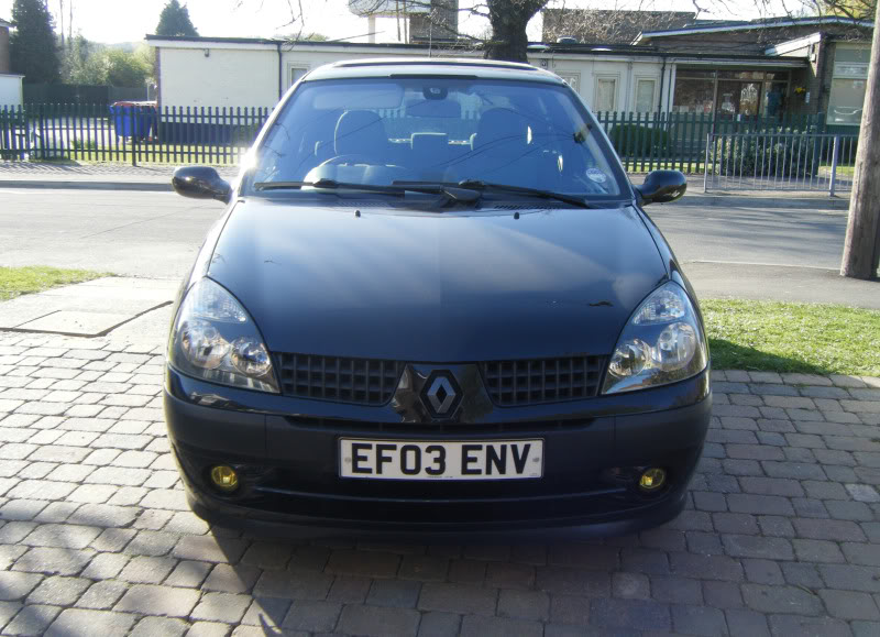

Opinions on the lamin X fogs? I love them personally, Front end will look nice once ive got the colour coded parts on i think.
laminx looks good man, dont get ebay spacers! unless you want your wheels to fall off in the middle of town, get decent ones mate :)
Id rather spend a few more quid and get a kit with bolts if thats needed, With the eibach susp the ride is harder imo... And if the bolts aren't in far enough i could see my wheels going walk abouts !
Opinions ? Or places i can get the spacers please?
