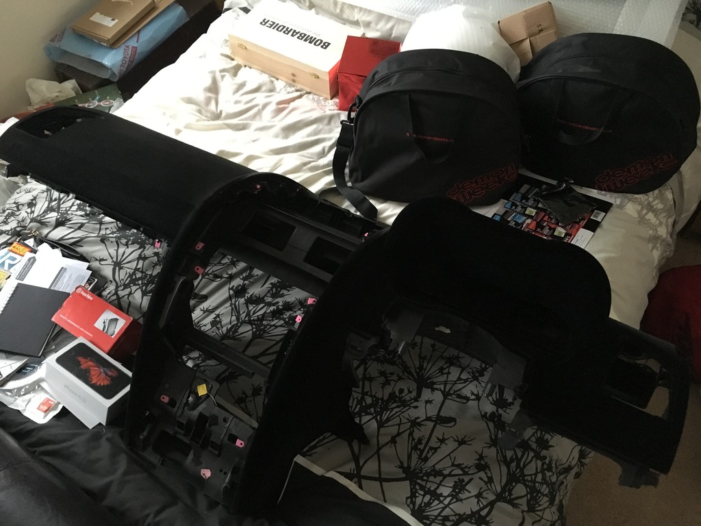

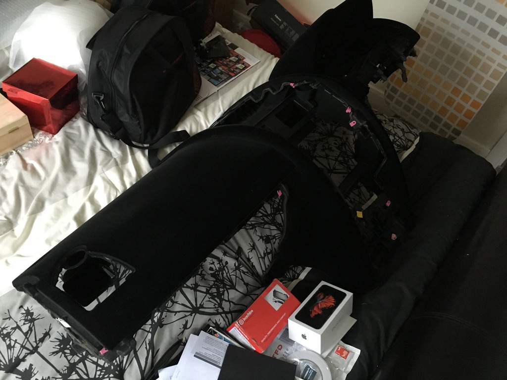

So remember I won that uber cheap flocked dashboard off eBay back in November?????
Well it finally turned up this week, what a joke I know heard various reasons for it taking so long etc but it's finally here!
Technically I won it for £2.20 plus the 17.50 postage!!! Winner!

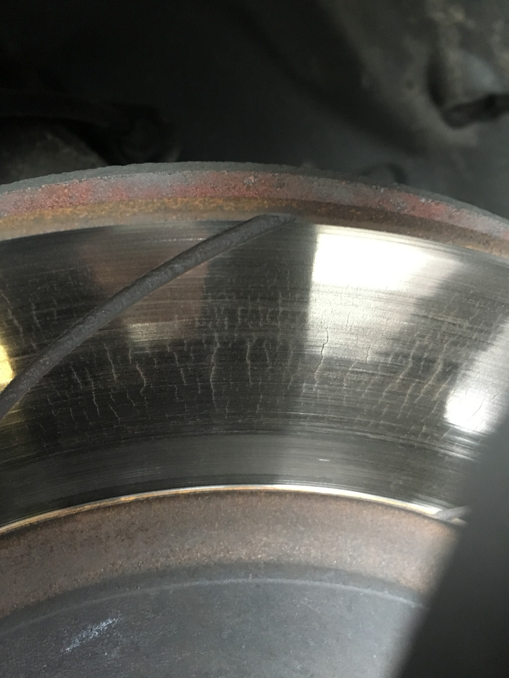

Gonna swap the front brakes out two after the Ktec black grooved discs have cracked!

I have done but there's not a lot of information on the actual rotor material and properties, also although it is 2 piece it isn't a proper "floating" setup.
My biggest concern when paying out for that kit is I don't want to be in the same position I am now only with rotors cracking that are going to be much more expensive!
That's the current disc, it's one of Ktec's black grooved discs, apparently H/C material.
I spoke to a friend who's a Motorsport tech in GP2 and he suggested adding some form of cooling to aid the discs.
He used to work for RML on the Chevy world touring cars and said in a weekend they'd get through 3 sets of rotors due to this!!!!
That flocked dash looks unreal for the price! Shame about the wait :(

Yeah can't fault the quality, I'll use the company again give the chance to redeem themselves lol.
I think the only reason it didn't go for much was it ended before payday for a lot of people and just before Christmas

RE those micro cracks in the discs you posted, Thats perfectly normal for that to happen with an aggressive pad and particularly when used on track, Its only when you can get your fingernail in or they run edge to edge that i would be worried. All my discs have done it on the Megane, Granted the Mk3's brakes run stupidly hot which doesnt help matters

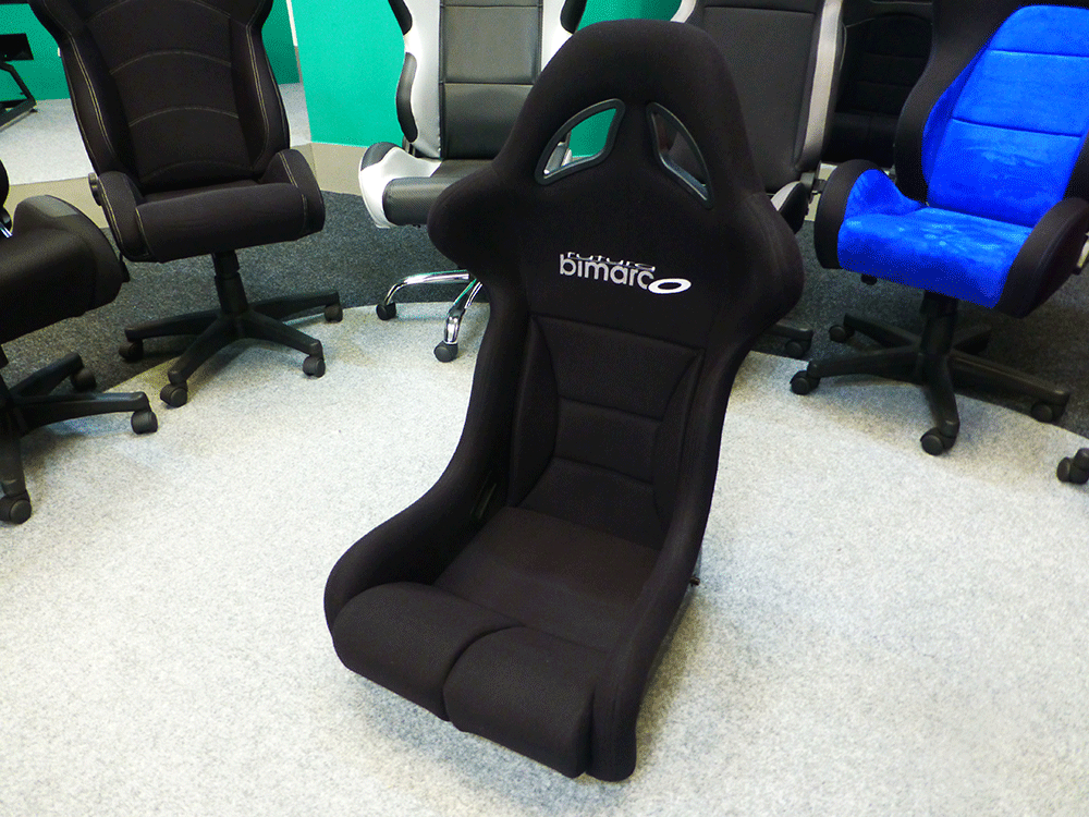

So today I woke up and thought sod I'm ordering me new seats and harnesses so I can have them in before my first Trackday in March.
Spoke to Gareth and Felix at GSM in Nottingham and after a long chat I've decided to go for the Bimarco Futura. They come bigger then most manufacturers GT (wide) fitment which is handy for myself at 6ft1 and a smudge under 16st.
Whole reason I went for these is they seem to get really good reviews, there FIA approved so have to meet some form of standard and Gareth at GSM highly rated them and also I couldn't warrant spending over 1200 quid on a car that on a good day is worth somewhere in the 6k region.

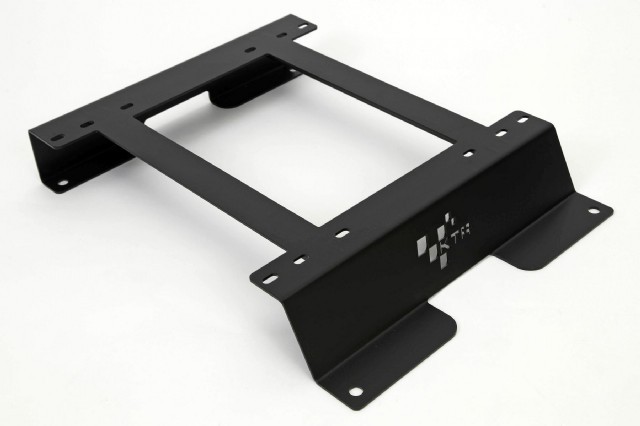

Unfortunately Ktec seem to be the only people that manufacturers a subframe for the mk2 Megane so purchased 2 of those

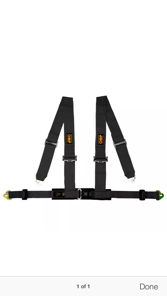

And then a set of 4 point harnesses from demon tweeks, these are 3 inch items so nice big straps

So can't fault demon tweeks service on the harnesses, ordered at one yesterday and these turned up at 10.
Looks like they've even chucked in a few fittings.

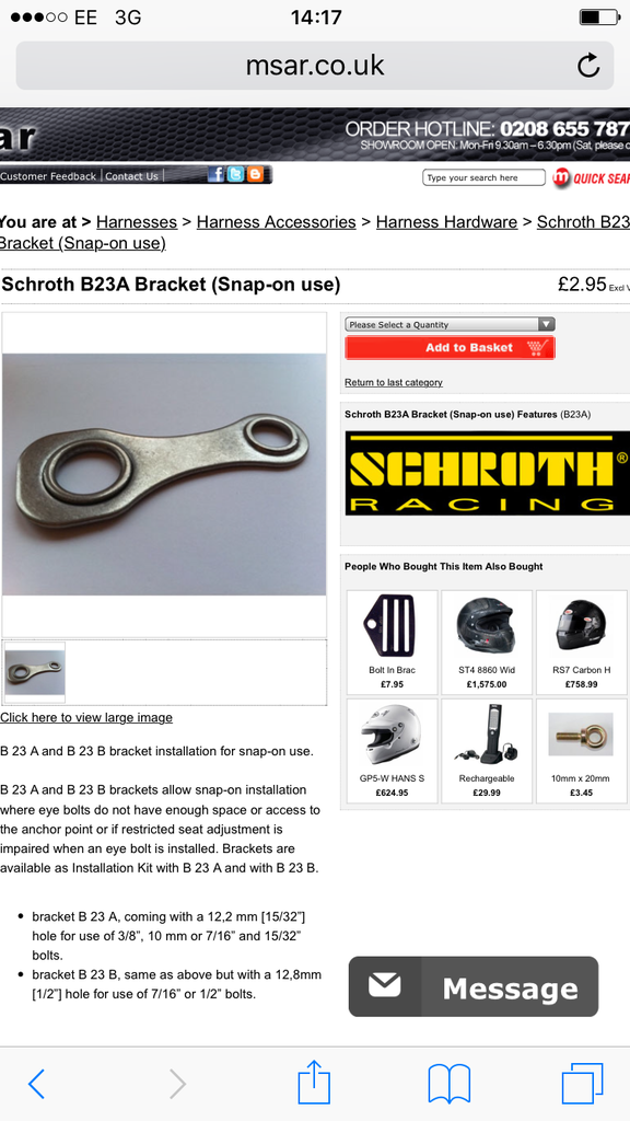

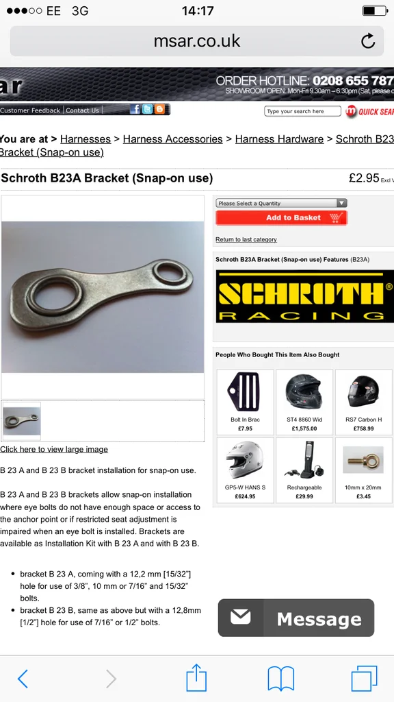

Also ordered these after speaking to a few other Megane owners. Scroth snap on harness mounts, good enough for Porsche they'll do for my Megane and there really handy where space is restricted

Cheers mate, the recaros are great on the road but they just don't off the support on the track and it does get to the point where your using the steering wheel to hold on which is never right!
Heard plenty of good things about the seats so can't wait either
The Recaros are w**k, I've always stood by that.
I'm looking into those Sparco tilt frames that allow a fixed bucket to tilt forward so I can still get the nipper in - Not really finding much info on them though!
Shame you had to get K-tax frames though - I'd have to cover that logo!

Yeah unfortunately after searching high and low they seem to be the only people the produce a seat frame for the mk2 but can't fault there service as they'll be here tomorrow
