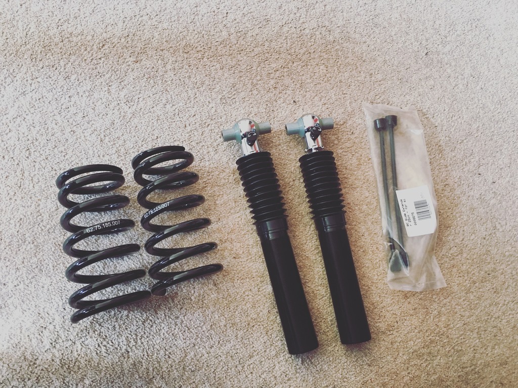

The rear BC racing 7kg rear springs and the matched dampers along with the handy remote adjusters.
Got them through Jonny at TFD, really helpful used him a few times now and service is great!

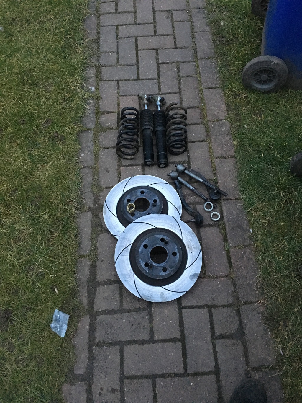

First off I swapped out the rear BC 4kg rear suspension setup for the 7kg trackday setup. Didn't get any pictures as I got stuck in but for saying they've been on a year I'm happy to report that all adjusters were free, top coating!

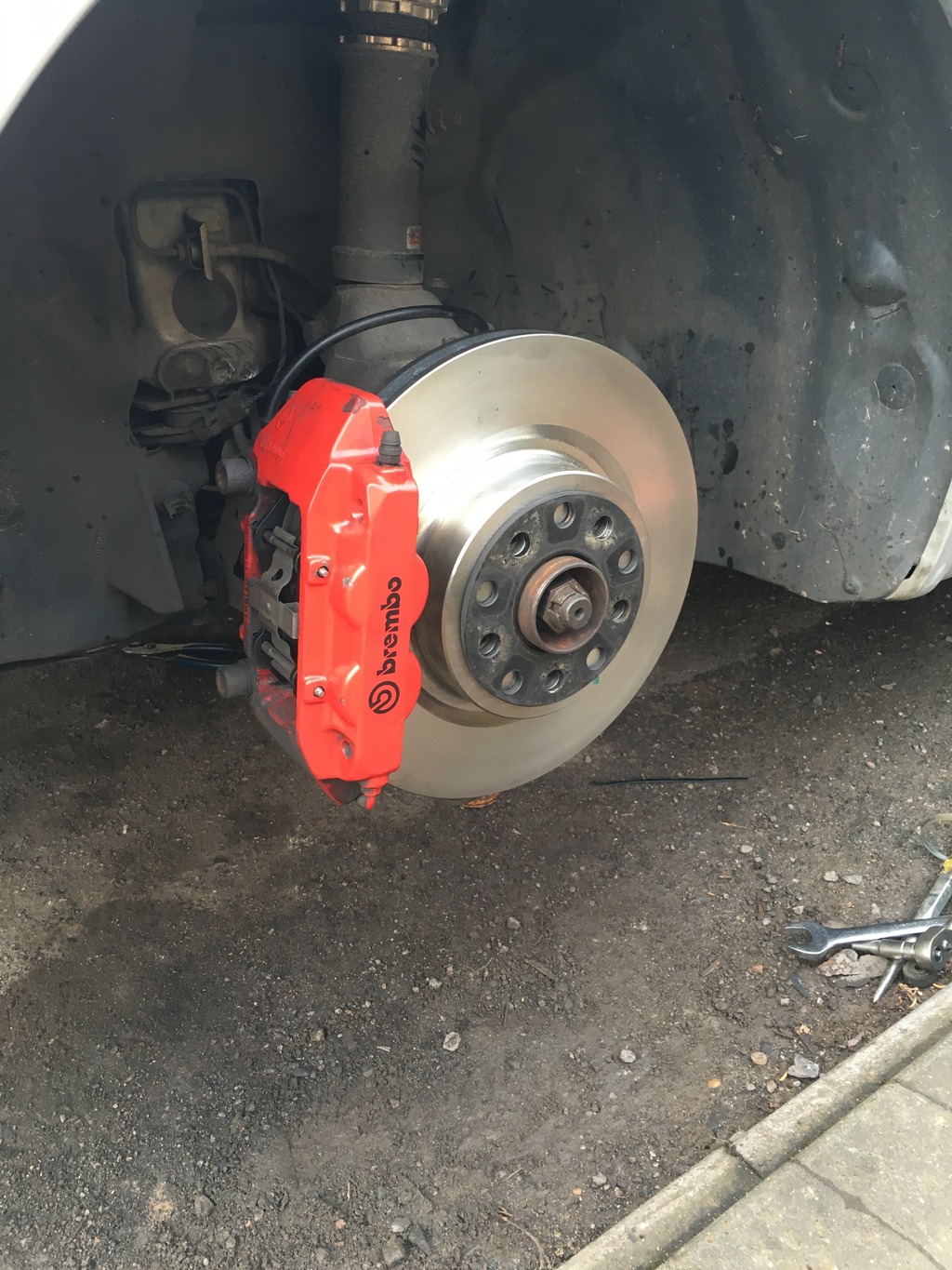

Then I moved onto the front, first off I swapped out my tired looking Ds1.11's for a fresh set and swapped my cracking Ktec discs for some brembo HC's

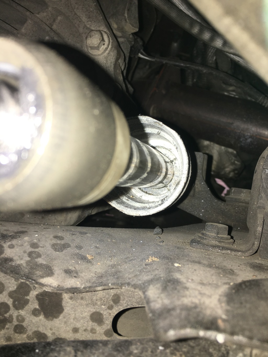

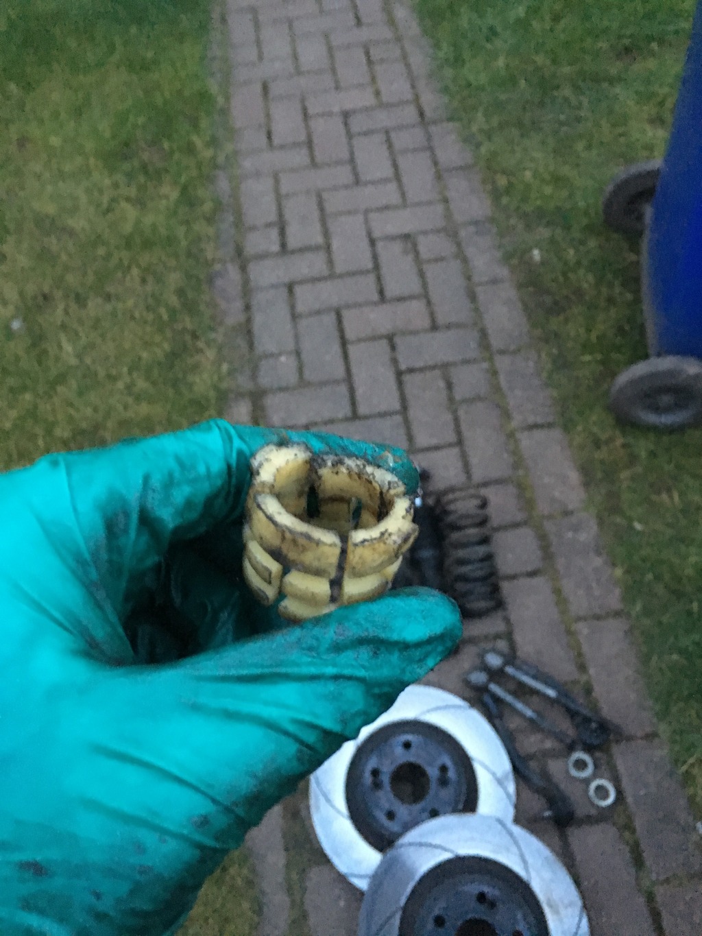

Then I set about swapping my inner steering joints and track rod ends and my steering rack bush with a new TFD item
That's the new bush in place, was certainly a fiddelry little bugger!
I built everything up with anti seize to save any future issues.
Once I built the rest of the it back up they was still some play in the passenger side and a small knock! Frustrated to say the least and at first I thought it was a steering issue but after disconnecting the track rod turns out me lower hub bearing has play in it!
Now I replaced these back in July but there's a pretty nasty pothole that caught me off guard on the way to work a few times so I suspect I've fell victim to that!
So fingers crossed Derby bearings delivery turns up today so I can get it swapped and the geometry done!

Old rack bush
Old parts

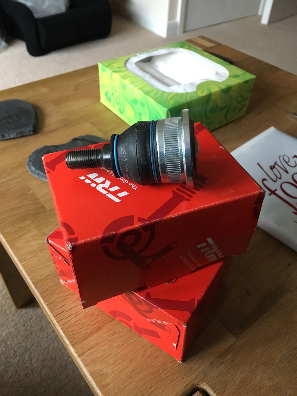

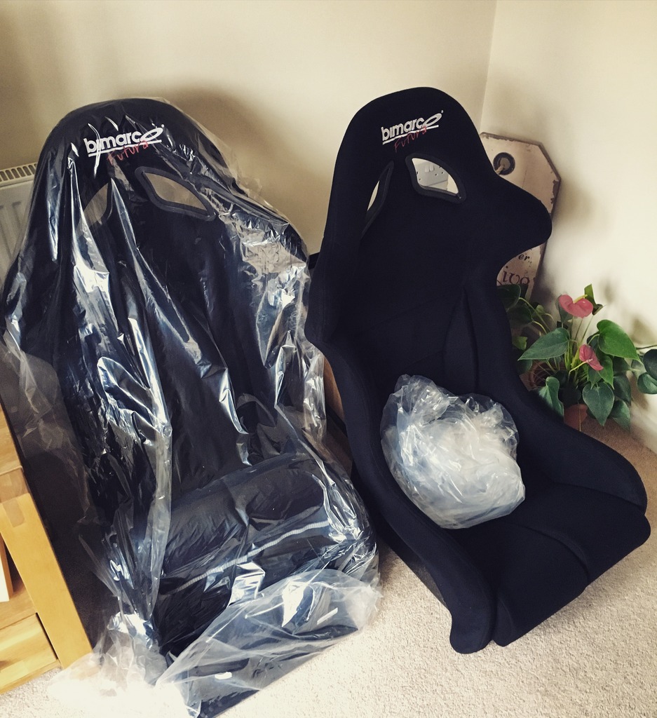

So just had a delivery!
New seats thanks too GSM performance, can't recommend these guys enough! Gareth and Felix are both really helpful!!
Also had these
Genuine TRW bottom balljoints from mister auto (correct ones after some searching)
One of the arms has some play in it on the car so going to rebuild my spare arms with new balljoints and powerflex bushes which is the only things I'm waiting for now!

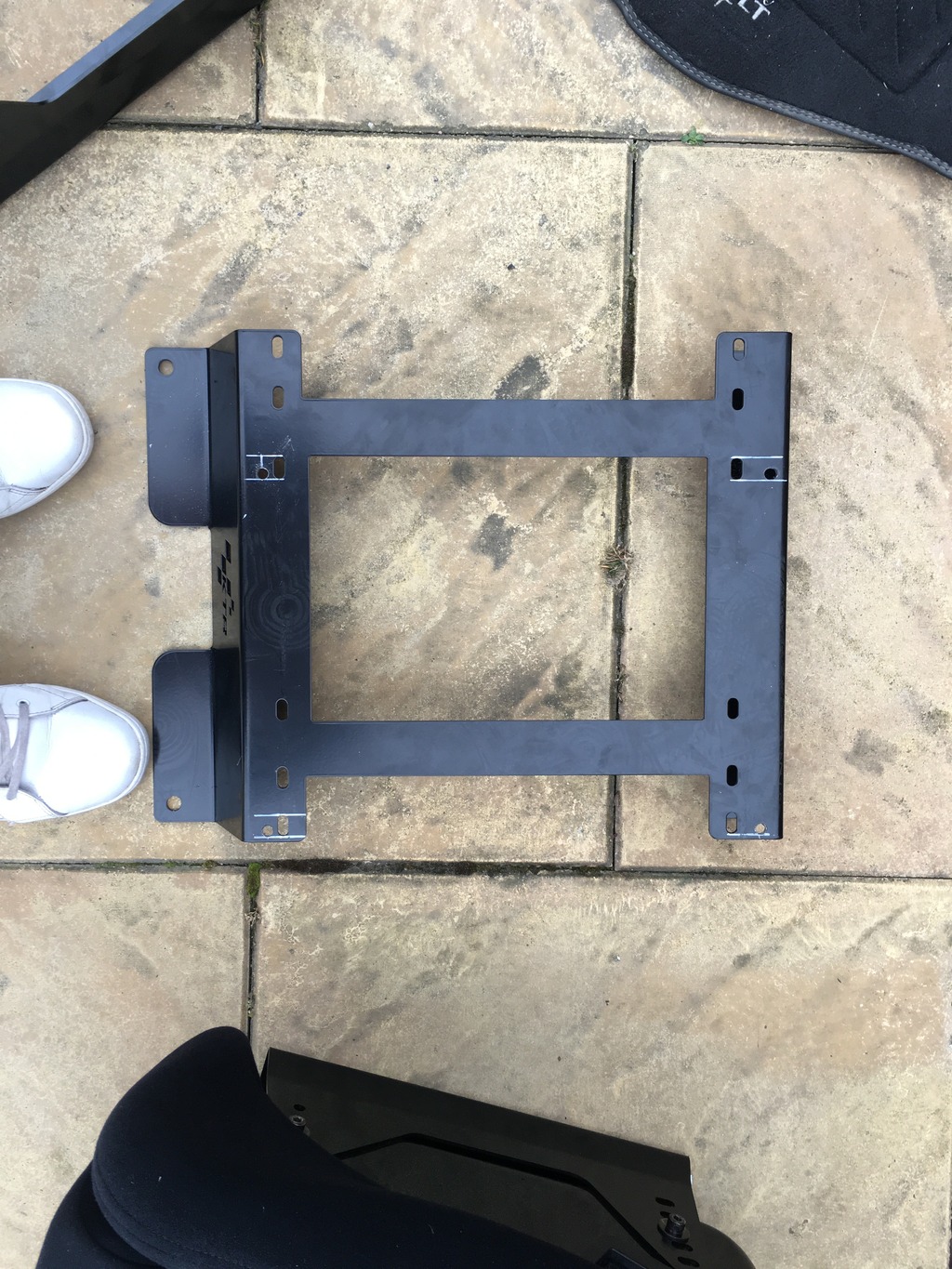

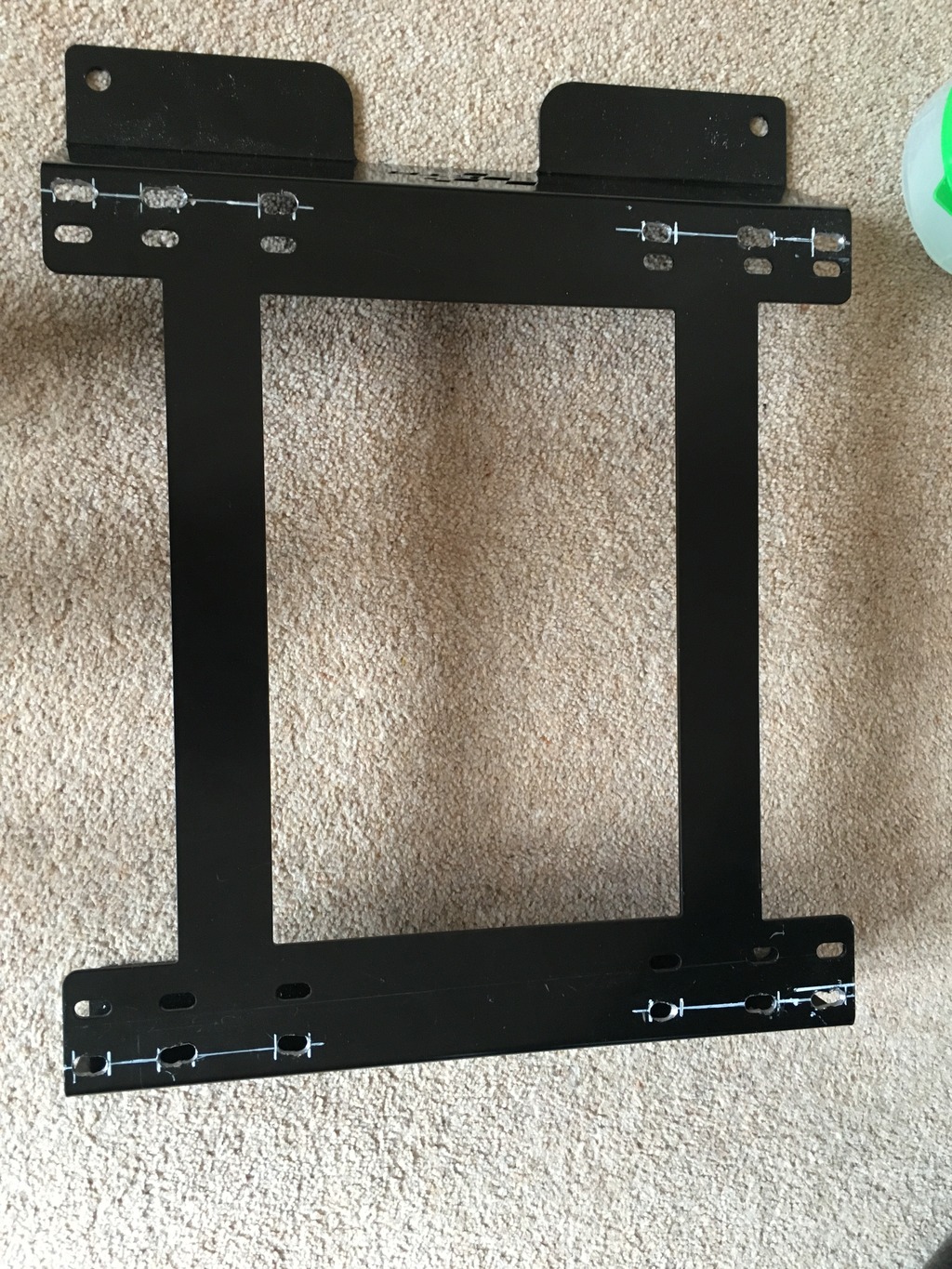

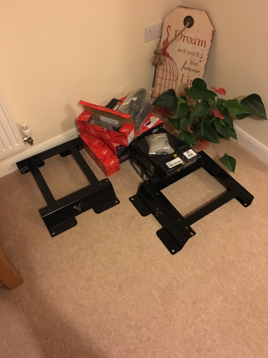

So spent the afternoon redrilling one of the Ktec frames for the seats as due to the width the mounting holes don't quite own up.
Seems quite common issue when going for wider fitment seats with these frames.
Just a little bit of filing on the new elongated holes and a dusting of black paint and then it's time to trail fit them in the car or at least the first one

Tidied up on the first frame I drilled with a little bit of round file action.
This has since had a dusting of paint to make it look more presentable and is now drying.

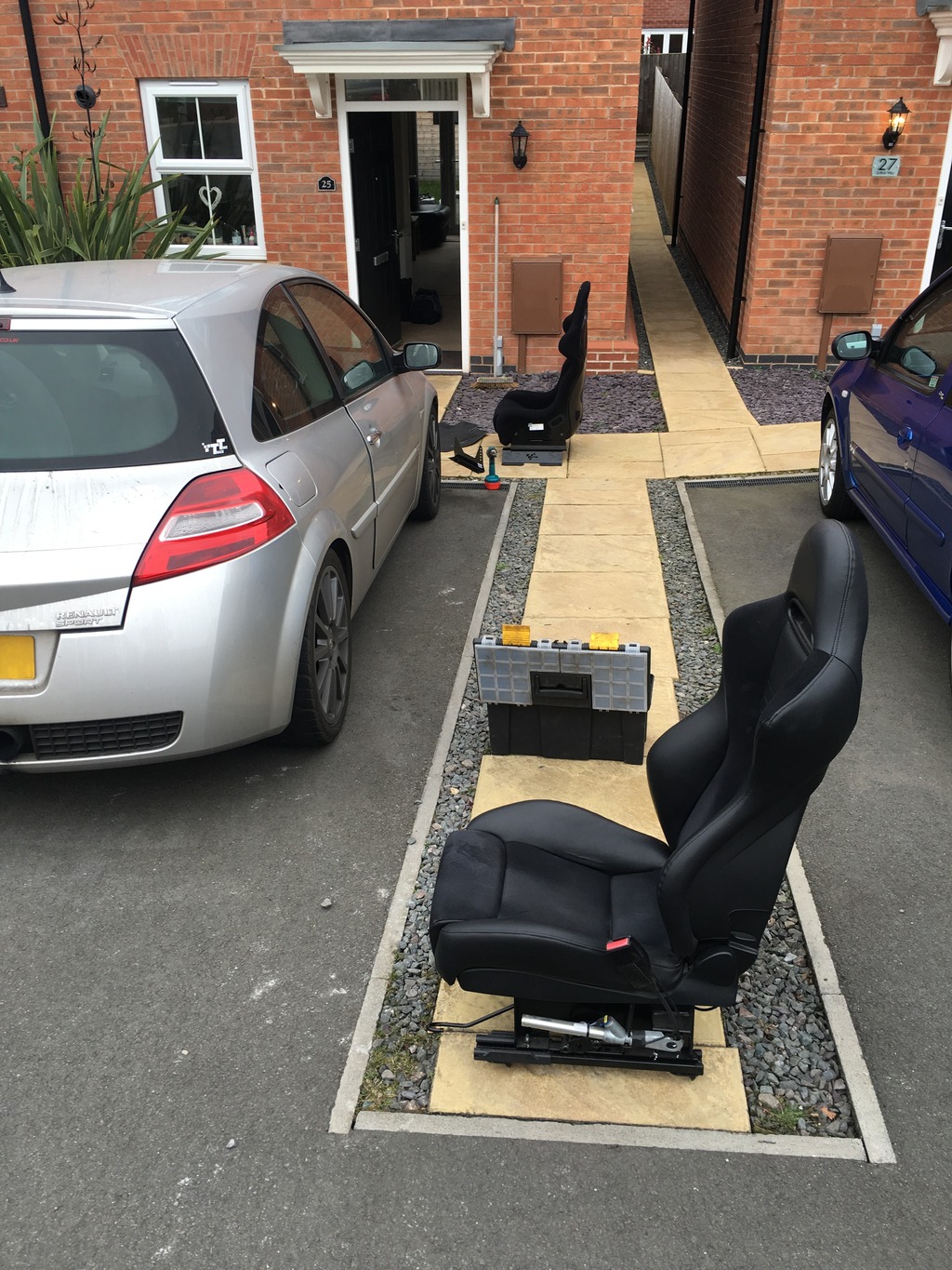

So I removed the drivers Recaro and plonked the new subframe in and loosely bolted it into position
Excuse the mess, it will be getting a tidy out tomorrow once the rear interior is removed and before the seats are finally installed.

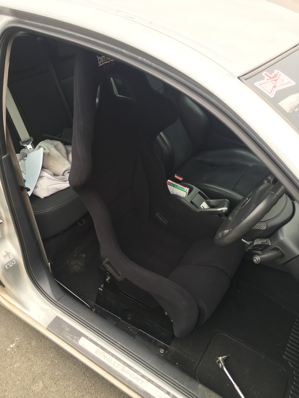

So test fitted the seat
I'm not running adjusters as I want to get the seats as low as I can tbh, the side mounts will be dropped another hole or too before fitting too.
I then measure the passenger frame for drilling. As it doesn't require any form of adjustment I only drilled 4 holes that allow it to be mounted in the same position as the drivers seat.
Again it's had a dusting of black paint to get rid of the bare metal.

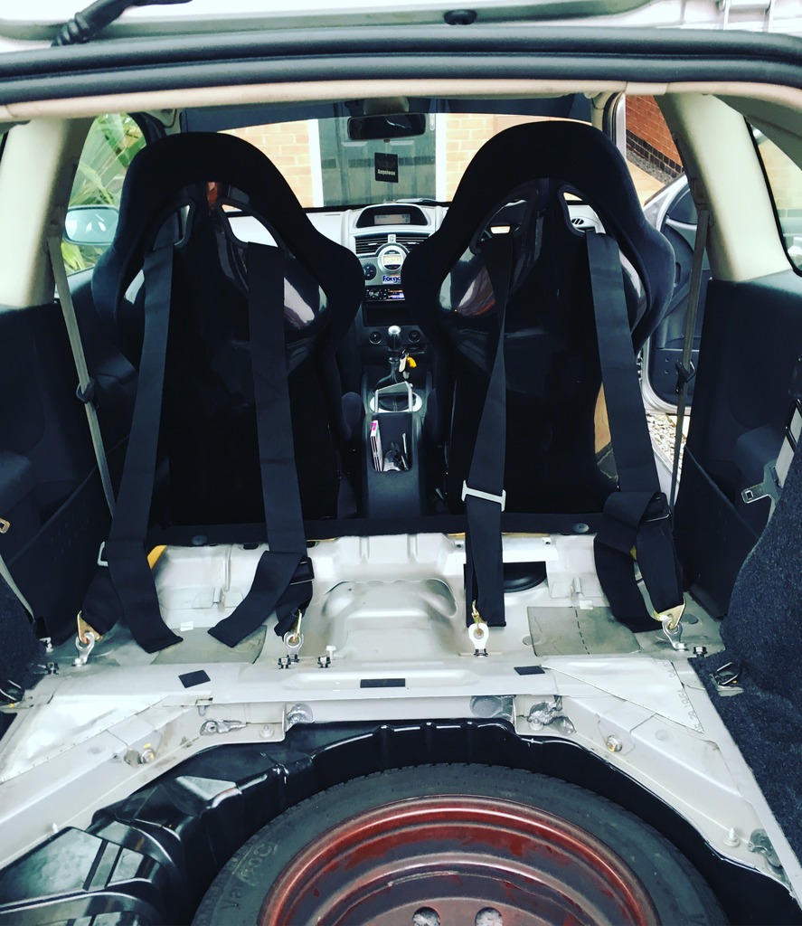

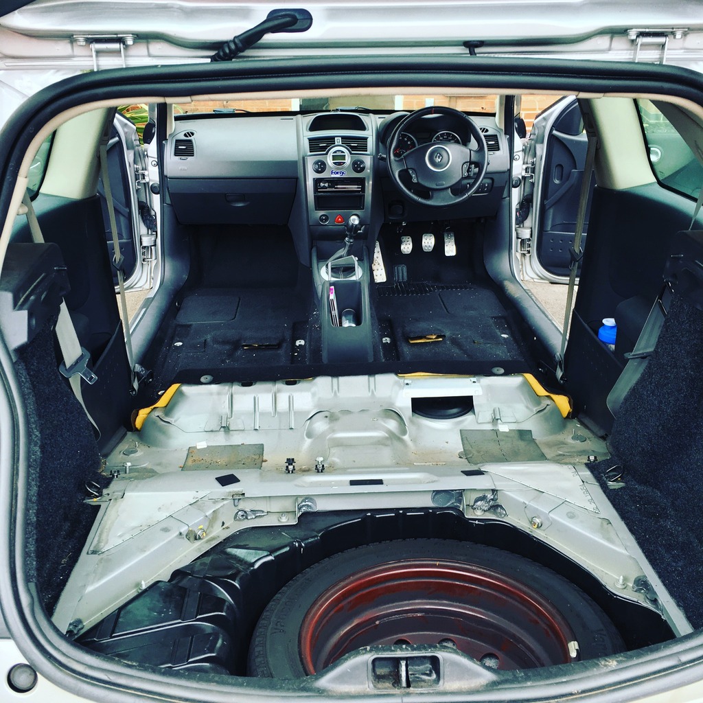

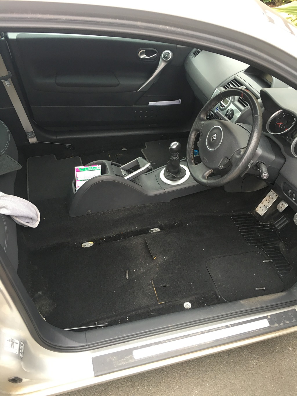

So just woke up, ripped the majority of the interior out.
For now this is as far as its going for the next few months, going to pop the rear panels out and then the carpet, roof lining etc will be coming out when the cage comes out

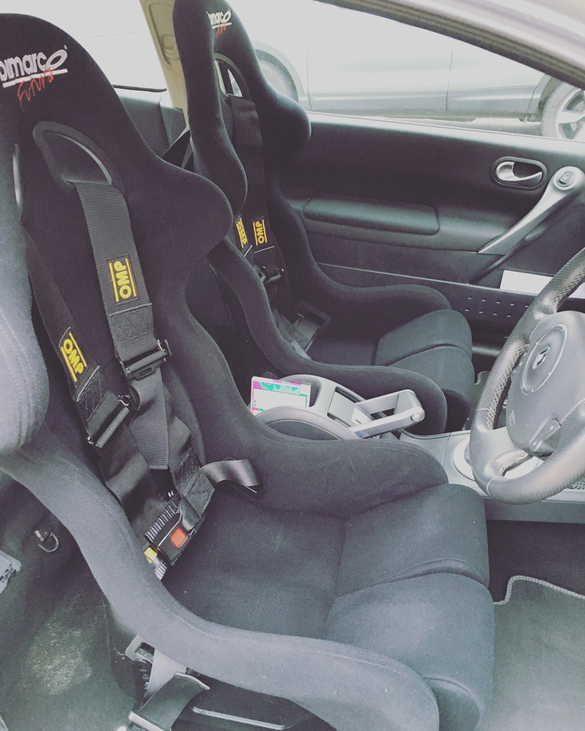

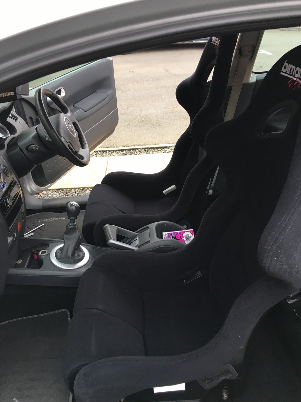

So there's been some updates today finished off me seats and harnesses when I got up.
First I started cleaning the car out and the stuff that collects under the seats over the years and then removed the rear seats
I built the seats up on there mounts and set about fitting them.
The seating position is great, much lower and still fairly comfy

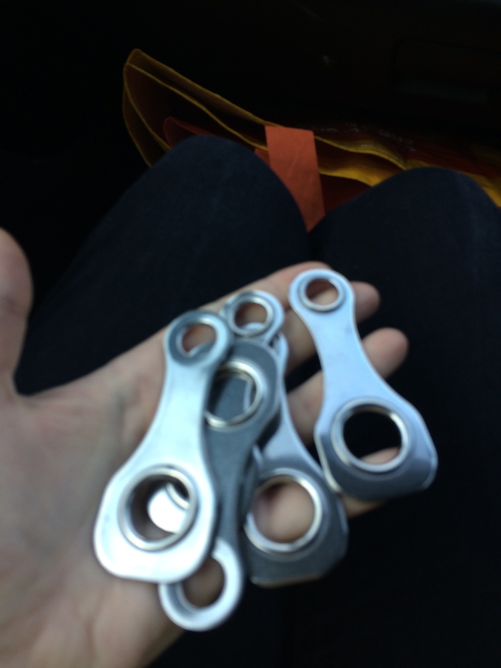

I mounted the harnesses using the Scroth snap off eyelets (used buy the likes of Porsche) which are great as they can be mounted in restricted areas.
*harnesses weren't adjusted there, hence the slack angles
The harnesses are mounted in the same location as the R so meet the requirements for the acceptable angles.
Eventually when the cage is installed I'll have a harness bar that be ideal!

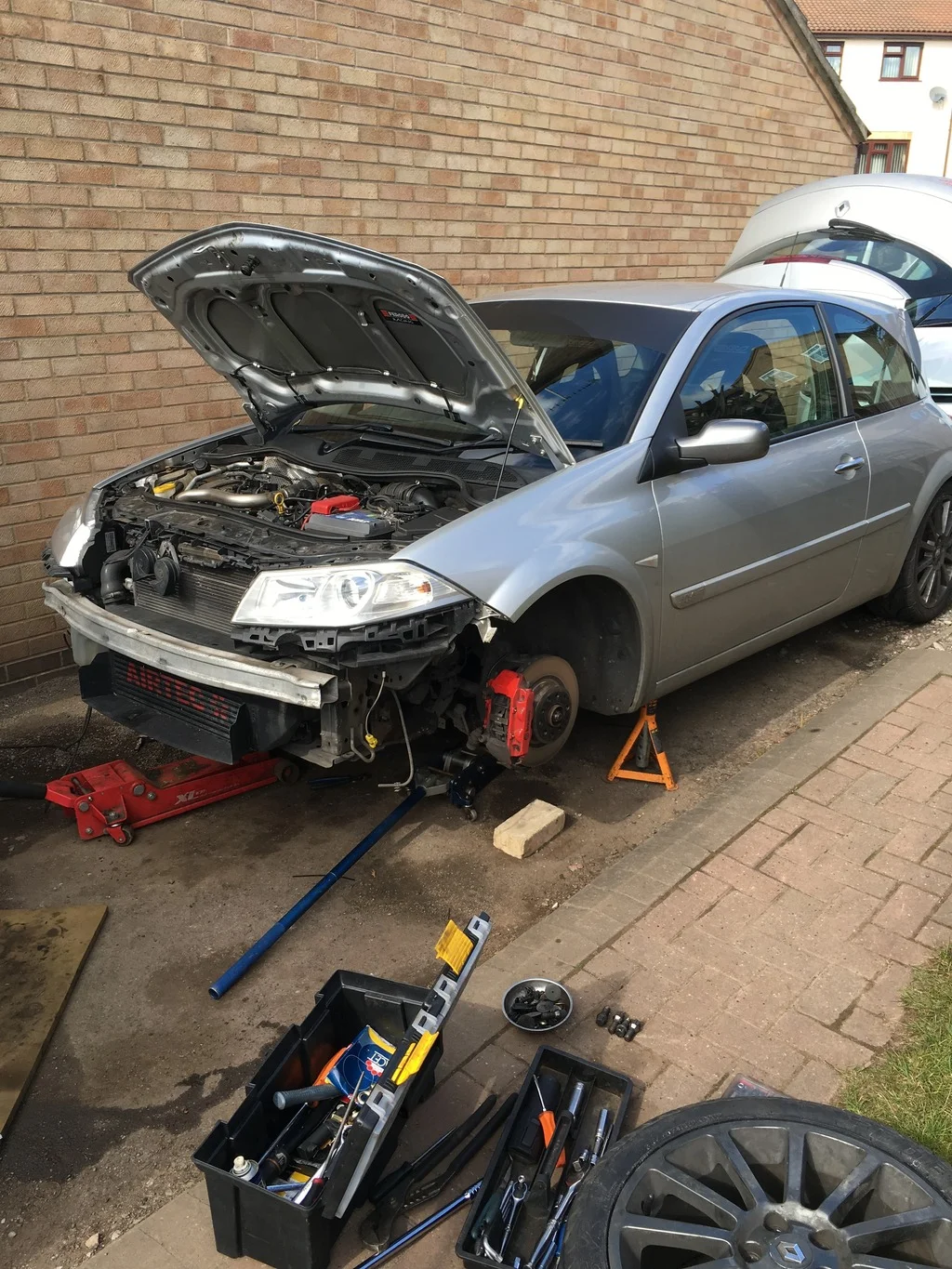

So yesterday I cracked on swapping my wishbones. Whilst carrying out my steering refresh I found substantial play in the NS bottom balljoint.
Now luckily I have some spare perfectly usable R26 lower arms so I swapped the pair out. The plan was to rebuild them before hand as I've already got new OEM TRW balljoints but due to powerflex cocking my order up last week I decided it made more sense to fit the R26 arms as they were and rebuild the knackered ones I took of especially with Snetterton looming and me being short of time in terms of getting the GEO done.
Unfortunately all this has to come off to get to the front bolt on the lower arms! Fun fun times!
Luckily it's all been off before so no dramas although I have decided that the Megane has the worst designed front bumper in the world haha
Anyway it's all back together no and service is resumed. Since the refresh and upping the rear suspension rates I haven't been able to really drive the car knowing there was play in the balljoint but so far the improvements seem to have increased the turn in dramatically

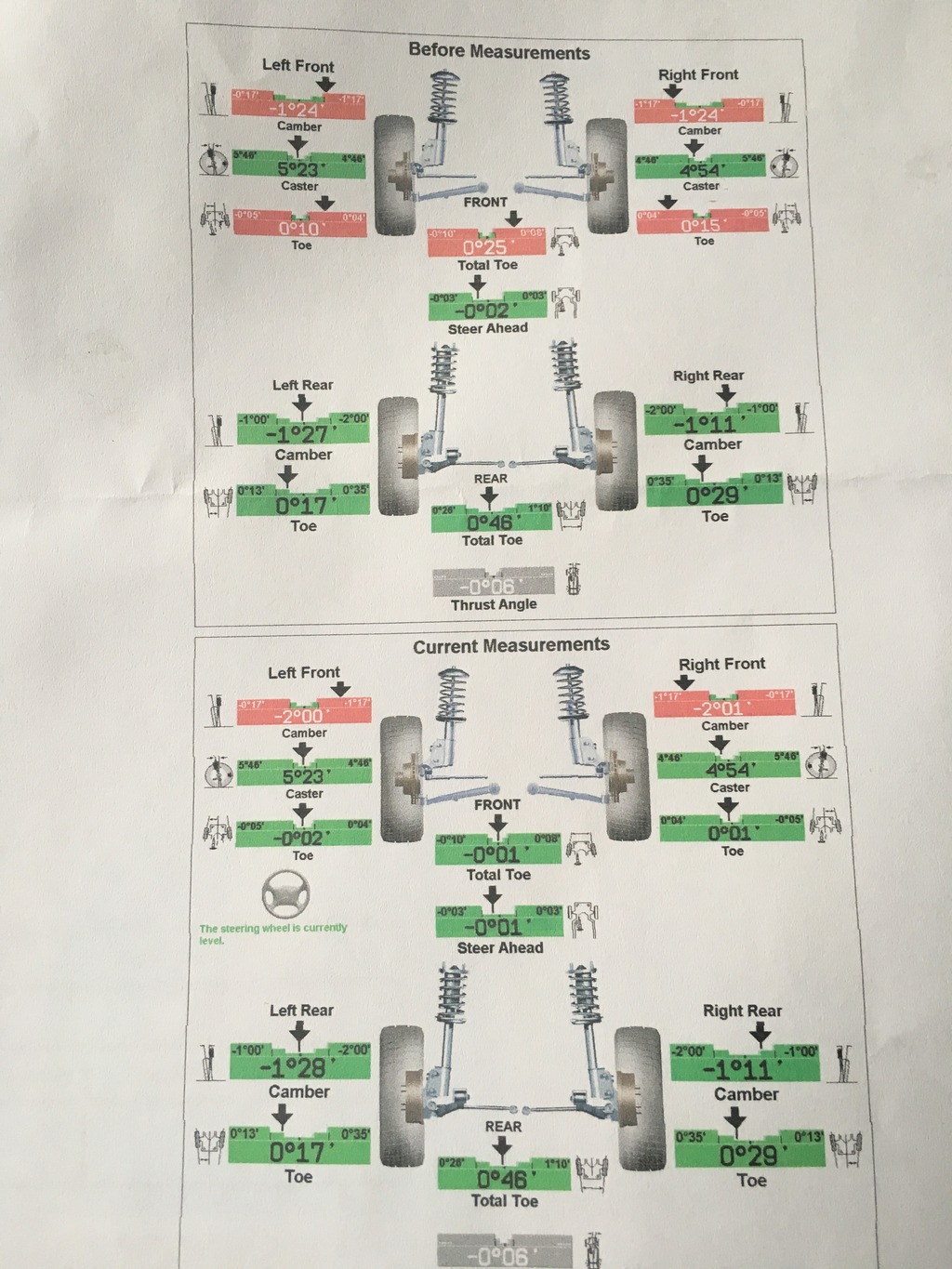

So then Geometry is done!
Added some more camber to the front from around a degree and a half up to 2 degrees after the passenger side outer edge took a beating at Mallory and Oulton.
Other then that not much to report, rear beam still in spec which is nice as you can't adjust or shim them like the clios.
Only issue we came across is that the tie rods have near enough bottom out off adjustment after we added extra camber, if I want any more I think I'm going to have to chop 2 or 3 threads off them but all good for now!

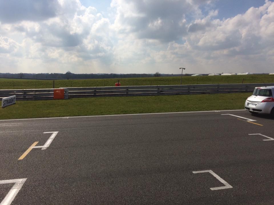

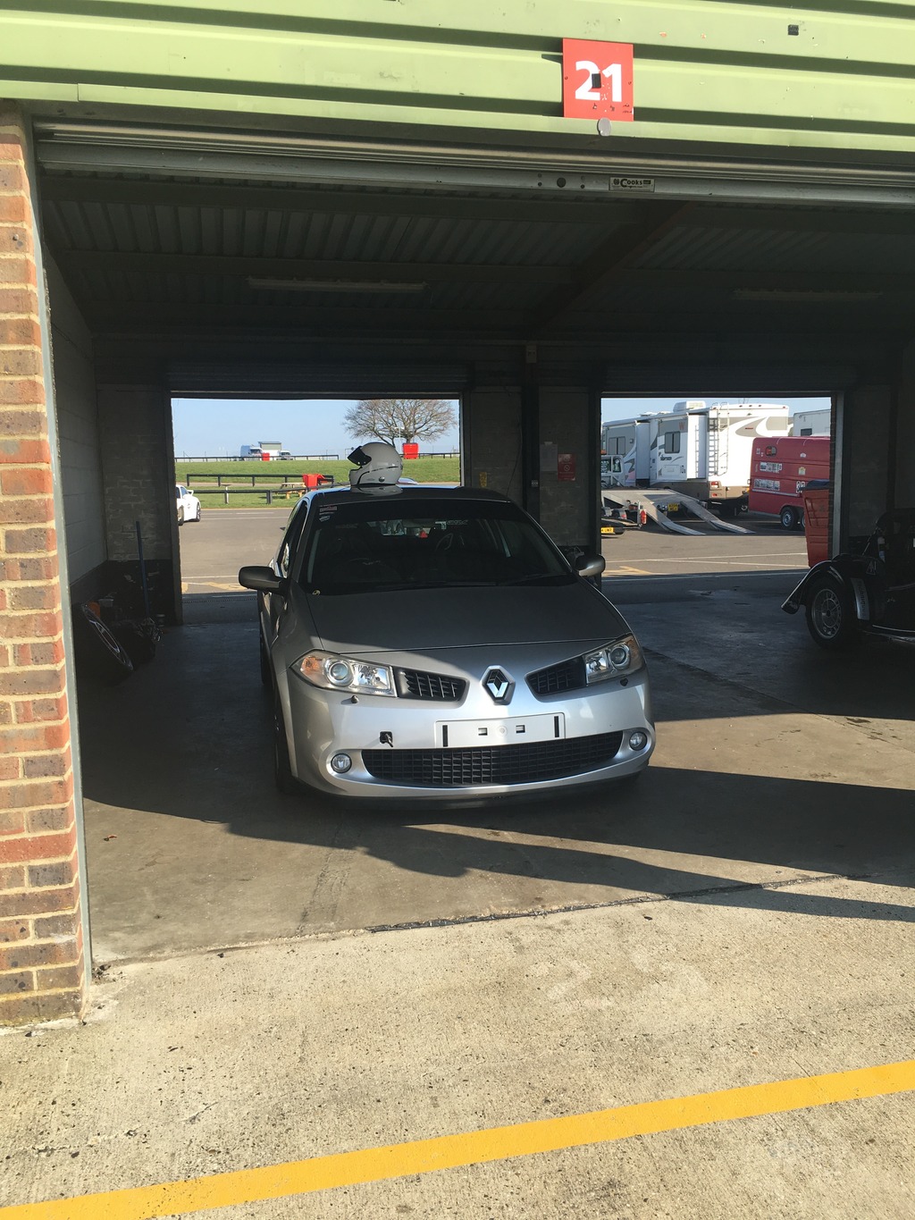

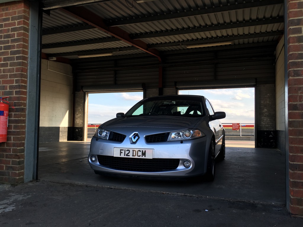

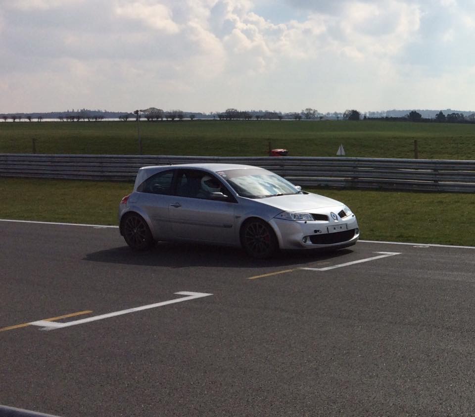

So yesterday I did Snetterton 300 in the Megane, open pit lane with MSV.
I travelled down the day before with the missus and stopped in a travel lodge about 10 minutes down the road to save the 2 and a half hour trip in the morning.
Got to the circuit about half 7, welcomed by a lot of race teams but I guess they see them as cheap test/shakedown days although MSV really enforced the "NO TIMING" rule!
So headed out did a few decent laps and came in and adjusted tyre pressures to my usual hot settings.
It's a very fast track, every straight section you easily see 100 plus no problem so the brakes can take a hammering but it did make for an exciting day.
Missus snapped a few shots from the pit wall, she sat out the session before dinner as she reckoned the weight of the helmet gave her a little neck ache.
Sack the photographer
All in all cracking day, clocked near 200 mile on track again and really can't fault the Megane yet again!
Videos to come soon!
