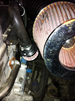

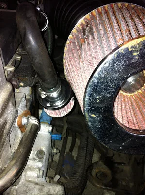

Wow! That breather is horrendous!
Marco was telling me about it the other day, when me and Lise split, the car had a decentish pipercross filter on, then when I bought it from her a few months later it had this filter on. No idea what happened to the pipercross, but had I noticed the wire wool, it would have been sorted asap!

Lolz at the comments on here - especially Marvv trying to blame the wire wool on his ex.

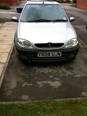

The VT bodykit is a complete joke and I have no idea how it stays on any saxo for more than a month.
Stuff complete:

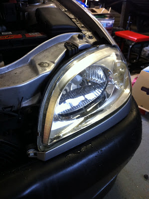

Headlight - ordered on from the bay for £20 and although its not an exact match, it isn't broken. Fitted and tested, happy days.
The retardo bodykit has been secured - not brilliant on the front near side arch but miles better.
Wire wool replacement installed

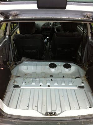

Majority of the rear interior (and front door cards, speakers) and sound proofing + grill removed...
Suprising how much weight has actually come out! The rear has risen a bit, which I'm happy about and the car feels more nible without half the interior.

Lol at the wire wool. TBH though, it will have done the job fine. It's only a breather. I've seen worse from cars more reputable specialists have worked with.
I <3 grinderz. SRSly, i'm surgical with them now.
I know bud, I was just going to leave the pipe exposed. Those breathers are a load of sh*t really, but for £3.99.....

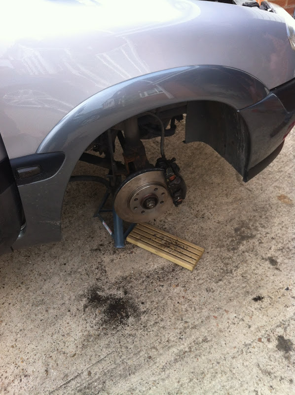

First up where new NON-performance discs and pads on the front. Matt complained the pedal was hard and he was right, although this appears to be a standard trait of the saxo's, I saw that the discs were pretty bad, but the pads almost new. For £50 I replaced them both with Mintex jobbers.
Then I thought I'd try my hand at installing some 5.1 brake fluid. Had to get the old man to explain what needed to happen and I've learnt that I can now bleed brakes. Learn something new everyday.
J20 bleed bottle FTW.

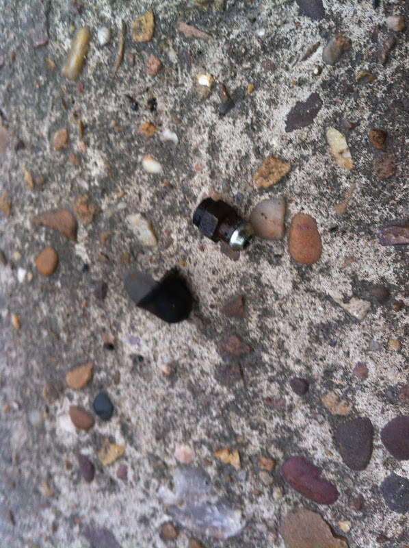

Slight issue with one of the rear nipples though - I snapped it, whoops. This was tightening it back up, so I hope I don't have to bleed them again.

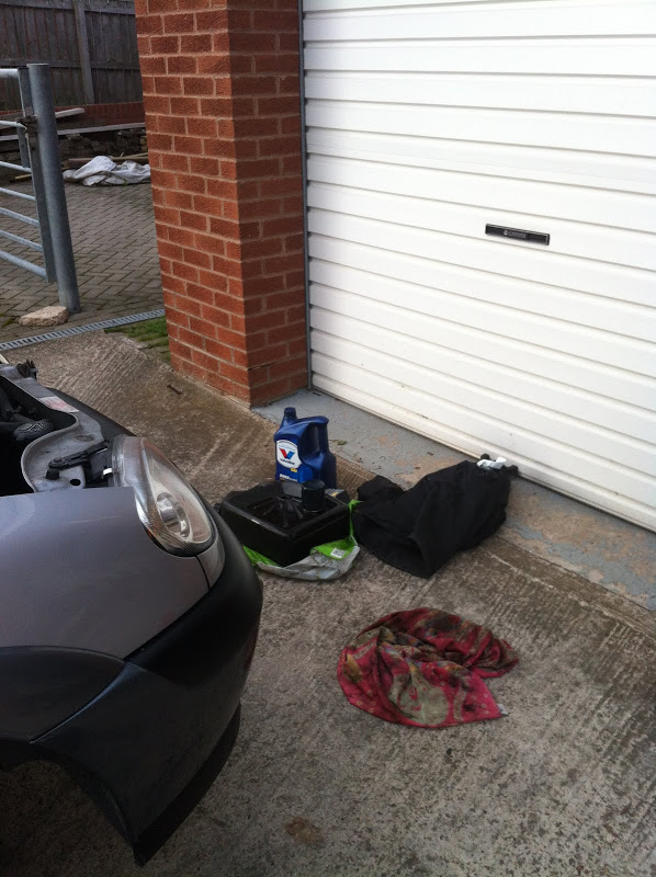

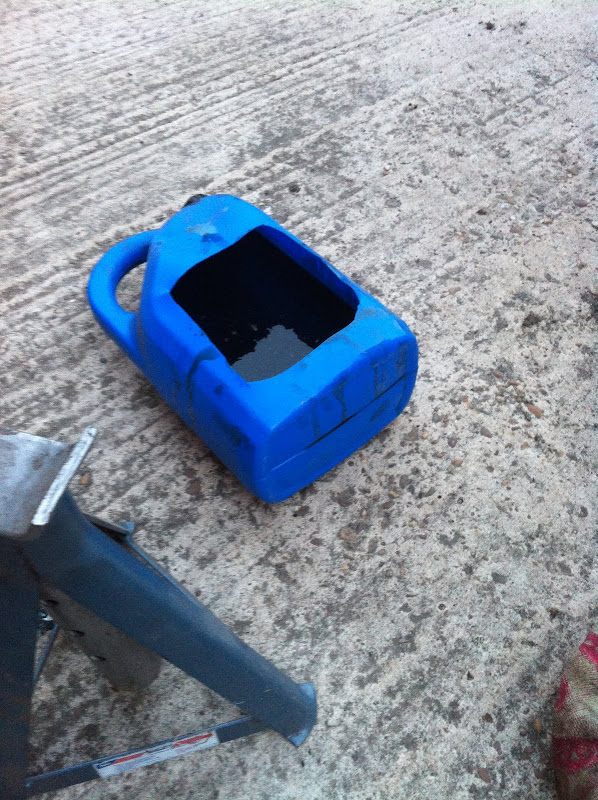

I was pondering changing the plugs and gear oil, but to be honest, I think they're ok. Plugs are a year old and the gearbox seems fine. So just dropped the oil and a new oil filter.
er... but I forgot that its a 1.6 and was a bit hasty with the oil. Put the entire 5litre bottle in and then thought.... thats gotta be far too much for this little thing. I was right. FFS...
Had to drain a good 1.5 litres or so. But put it back in the bottle so the budget isn't shattered.

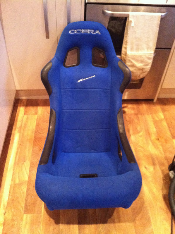

That was it for a day or so and then Len decided to sell the Cobra's he'd bought for a failed 206 project.

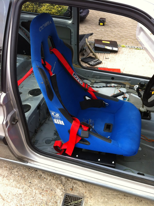

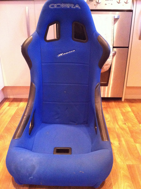

2 seats and 2 harnesses for under £130 - couldn't say no, even though they are classed as the hardest seats EVER.
A bit grubby:

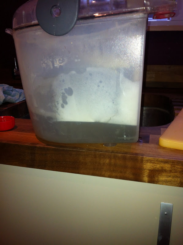

Still had my sisters carpet cleaners so set about cleaning one of them.
Nice. That was after just doing the sides! The final bucket was black, no word of a lie. There are some scrubbers about, who obviously don't wash at all.
The finished article. Not bad.
So I then set about getting a least one subframe for it and some eye bolts for the harnesses. Now, I'm not afraid to admit that Google and Sax-p played a large part. People have done pretty much everything to Saxo's and just by googling Saxo seat bolt size, the top searches produce accurate answers! its such a piece of pi$$ to find answers to anything with these cars.
So I went to Larkspeed - who are still going. They are still in the same place in Leeds too. I remember going there when I was a 14 year old and tugging myself silly over some TSW venom's they had on show. Anyway, they had some harness eye bolts on the cheap and that was that. They bolted straight into the existing seatbelt holes. WIN.
The subframe was not as straightforward and after ebay searching and discussing potential purchases with 17 year olds on sax-p, I decided I was prepared to spend a bit of money on a couple of goodies I'd fancied for a while.

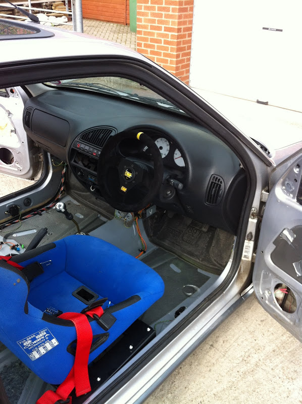

Demon tweeks had a subframe for £99 - slidey too - and I bought an OMP Trecendo suede wheel and boss kit whilst I was at it. Delivered next day, can't complain.
Fitted them both and we're ready.

Just for future ref, 3 litres is all you need for these!! Think the official sump capacity is like 3.2L.
So if you buy a 5l can and a 1l can that will do you for 2 oil changes. One thing I definetely do miss!

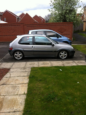

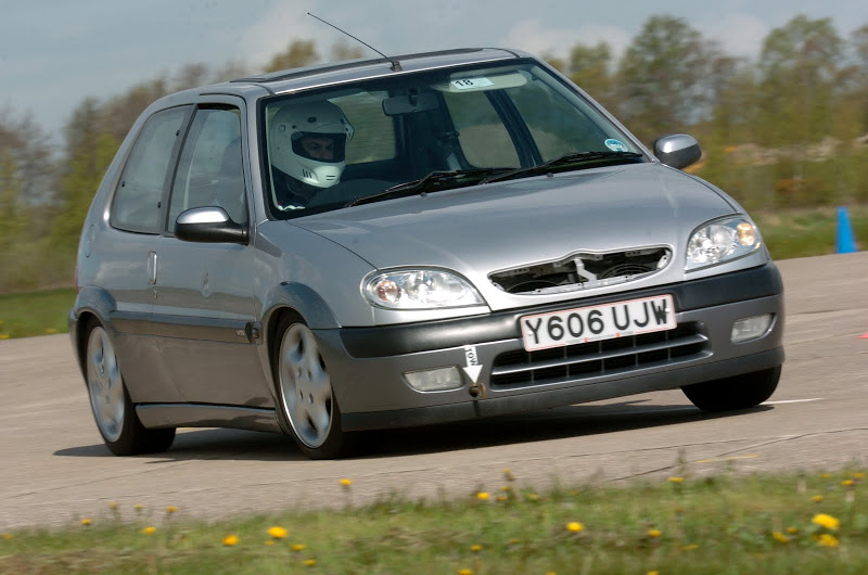

I'm delighted to announce that the little saxo was on form. To, on and from the track it was flawless. It is also suprisingly easy to drive and very planted. The non-performance brakes could only cope with 7 or 8 lap stints at full tilt, but nothing much more to complain about.
A quick pic, but will upload a few more later (some serious machinery was there).
Looks awesome, really nice progress too.
Get that grille back in though, please?
It looks purposeful with everything you've done, then it looks like some chav stole the grille and you can't afford to put it back.
Looks great on track there. But as I've said previous and as Rob just said, please put the grill back, it makes it look like an old banger when really it's a pretty clean car.
