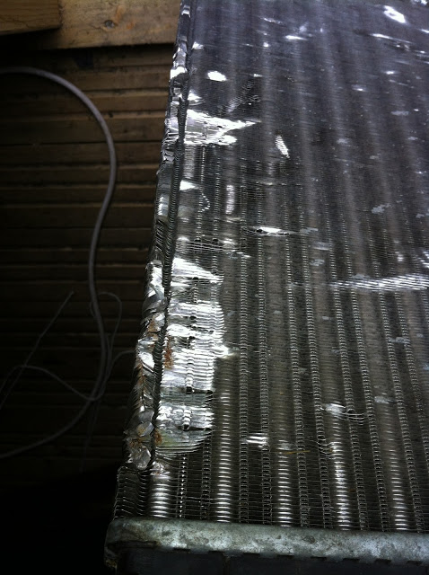

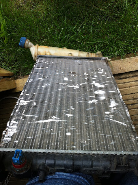

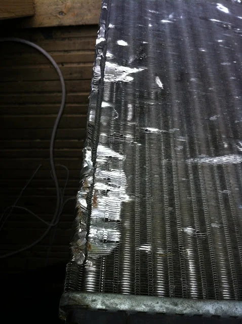

I bought a decent second hand radiator from saxp, but it wasnt boxed well enough and reached my house in this condition (and thats the good side):
Only cost £16 and I was refunded, so no major problem - but I just decided to buy a new one from a local motor store at £80 and have done with it.

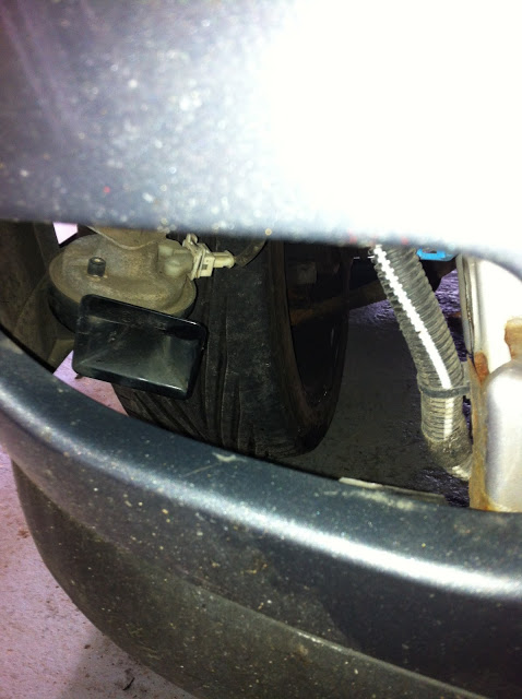

The other job I wanted to do was clear a path from the fog lamps (which have been removed) to the brakes. On one side you have a horn:

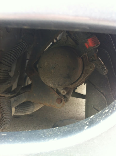

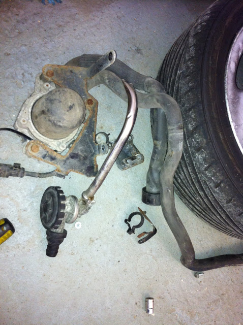

And the other side, you have a fresh air pump that was used on later saxo's to keep emissions down - basically pumped fresh air into the exhaust manifold on startup:
Removed all of the fresh air rubbish, which weighs about 5 or 6kg, so a bit of weight saved too.
The horn was a different matter, I just relocated it further up the wheel arch.

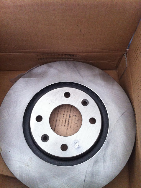

- 283mm GTI6 front calipers
- Brembo HC discs for the front (cheers George)

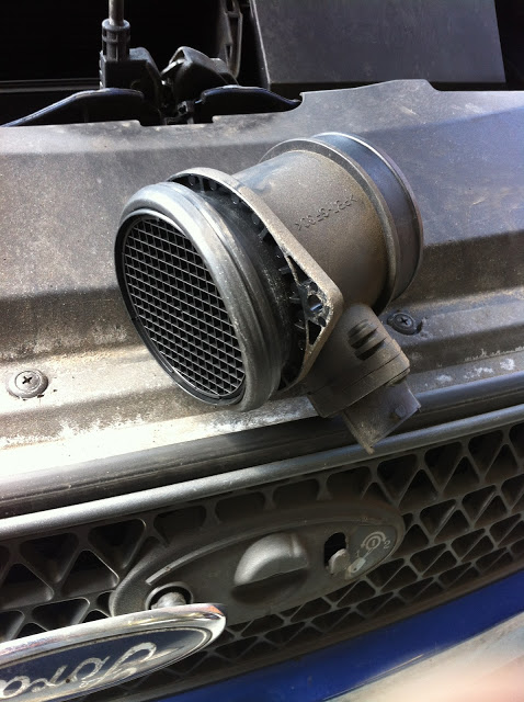

Then my other car broke down, the focus ST. The wife had been complaining that it wasn't driving as well as it should do and every now and again it displayed ESP failure messages and went into limp mode. I dismantled the MAF and cleaned it then reset the KAM and its like new again.

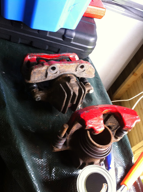

And so, I managed to get the discs and pads, new lines, calipers and fluid sorted - only to find that one brake is doing all the work. So its either sticking or one just isn't working. after a few hours I gave up and thought Id just order a rebuild kit and start again :( bit disappointed but they are second (maybe 15th) hand calipers. It doesn't help that we snapped one of the rear bleed nipples and thus I'm not totally convinced all the air is out. Hey ho.

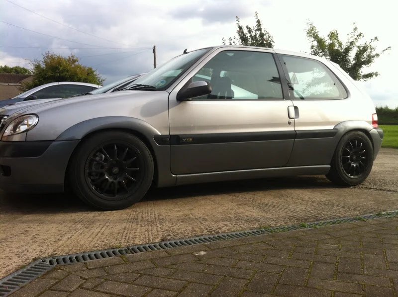

Here's what she looks like now:

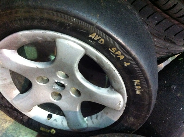

Also got some real race slicks (collected from Spa - not by me) put on the Pug wheels I used to run. One of the lads who has a roll cage in his paxo will run them on the day. There is still a little question mark about running slicks means you need a cage? dunno.
