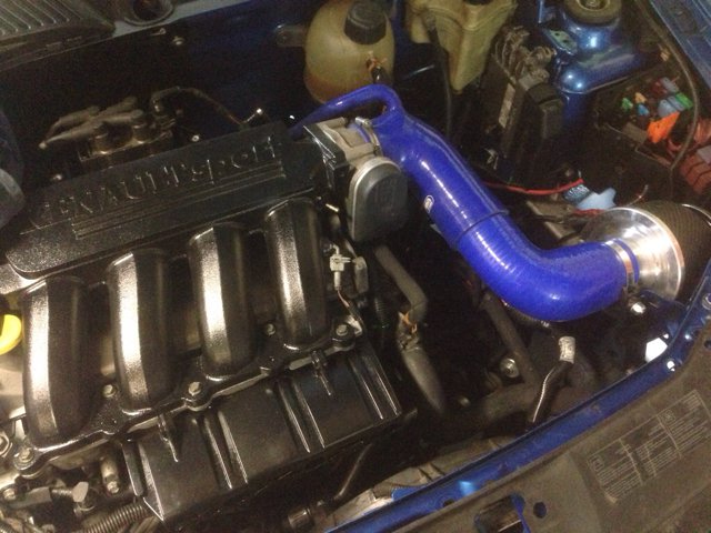

- a bit of weight reduction including removing rear wiper, engine weight, PureMS air con delete and top mounts, fattys induction fitted. Just rear mounted the battery and have sport lines to go in tomorrow.

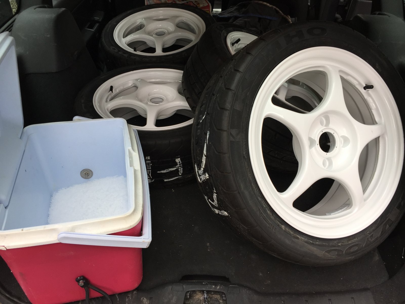

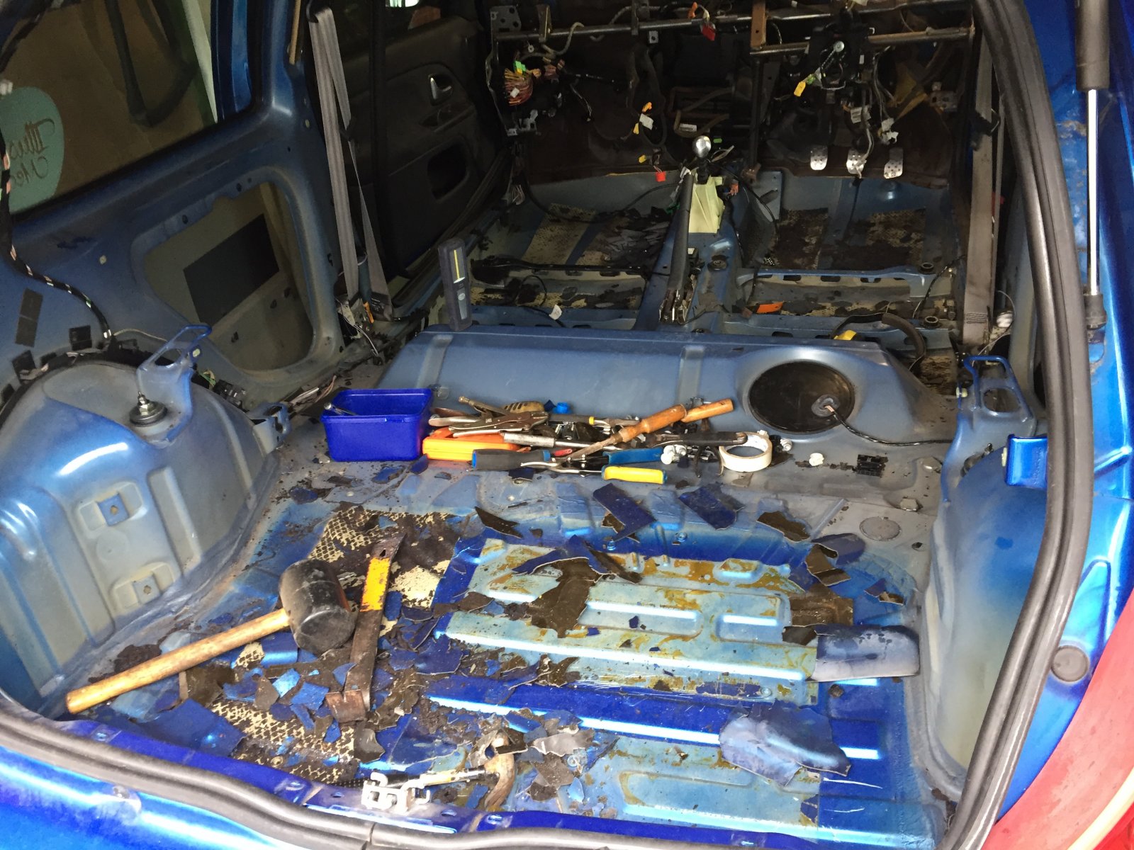

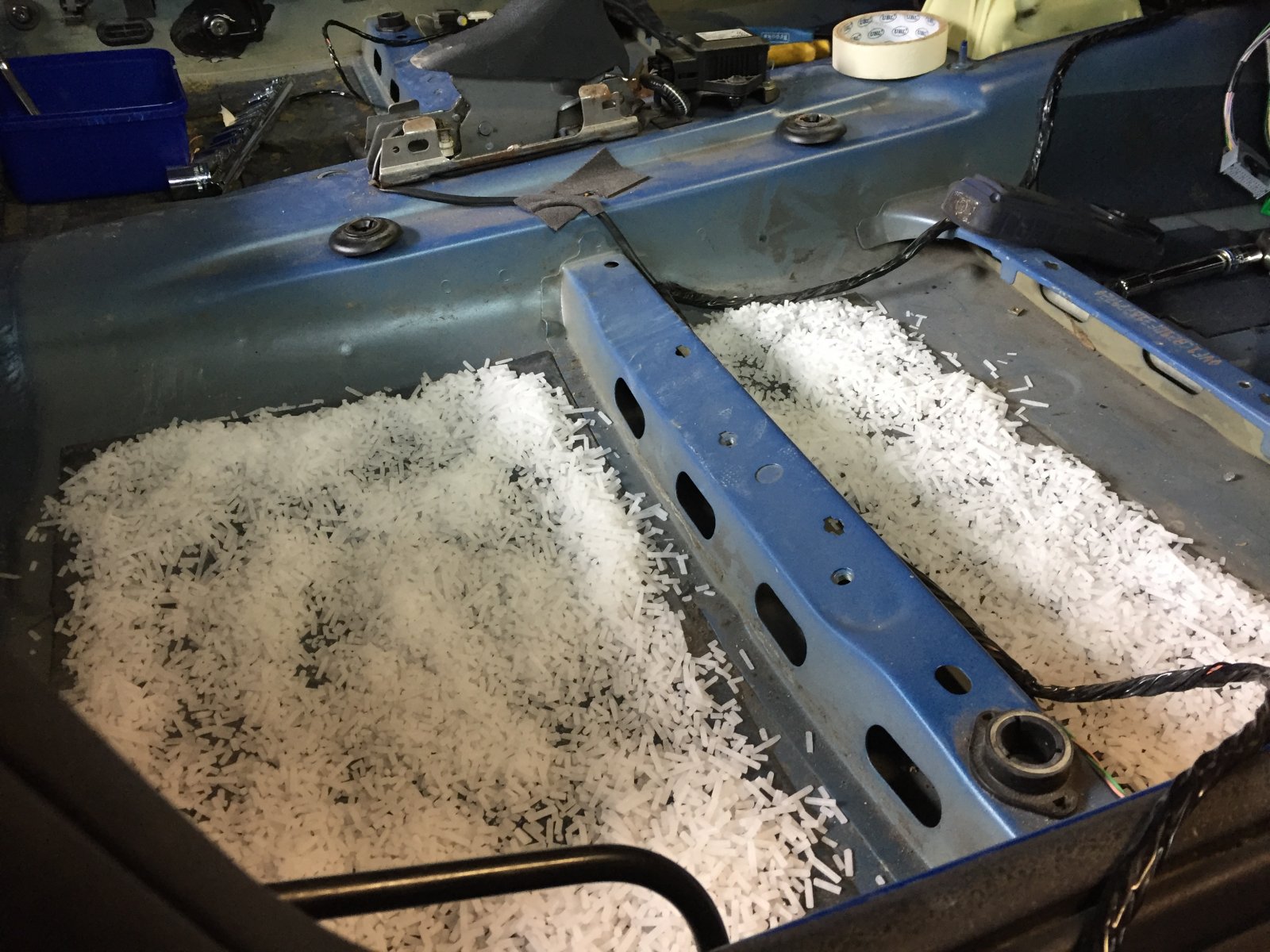

DRY ICE!! Update time. I bought a lightly written off FF 182 from Christchurch (NZ) a week or so ago (@Ayven!!). It's going to be a track toy. I've stripped the interior out and today smashed the tar sound deadening out in 20minutes. I used dry ice. About 2kg was plenty. $8/kg then smashed the frozen tar with a hammer which was very satisfying.
Aircon out. Heater out. Repainted rims and Kumho V70a semi slicks home today too. A good day.

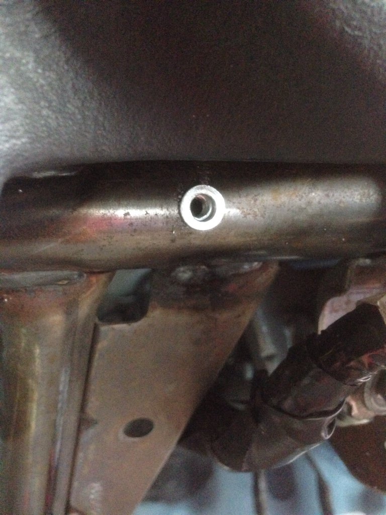

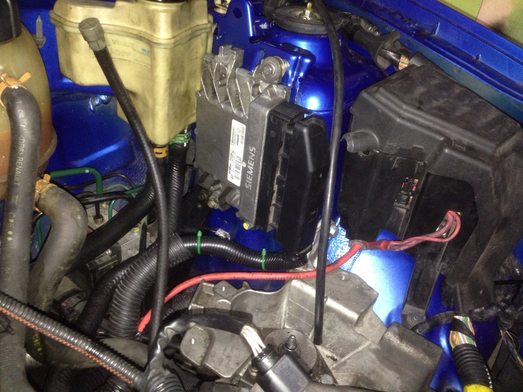

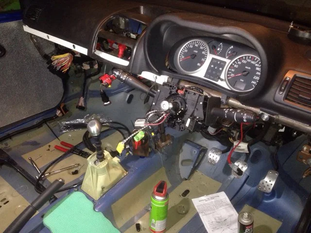

Progress report. Dash secured with a few rivnuts and a bit of ali profile. FIA cutout switch mocked up. 25mm2 cable run and ecu secured.

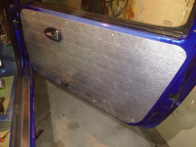

Door cards in 1.2mm stucco Ali. Need some finishing.

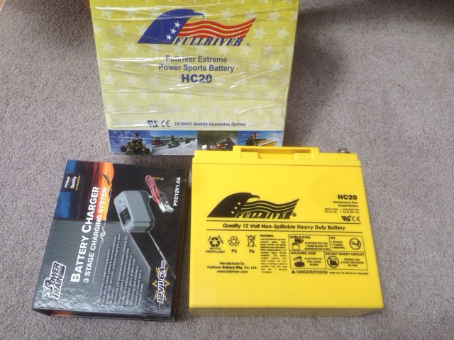

More new bits today. 5.8kg battery.

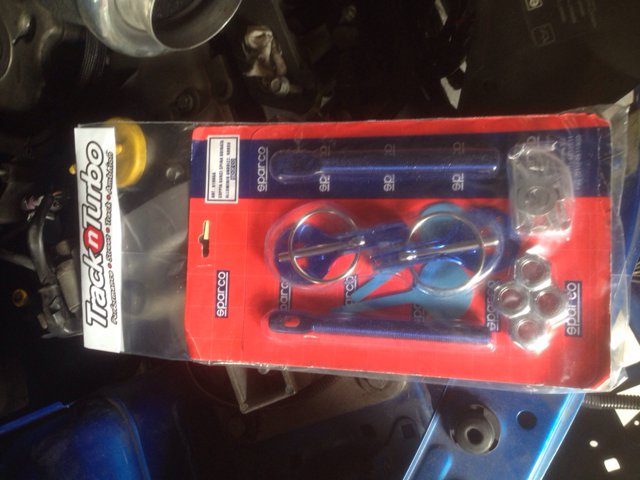

Bonnet pins too.

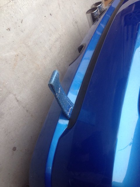

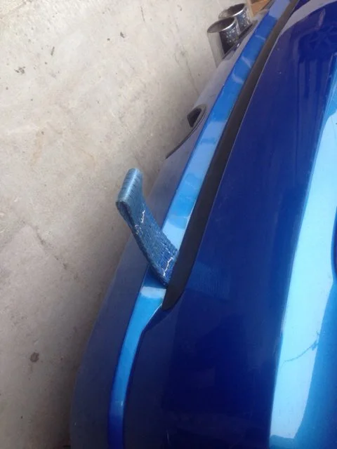

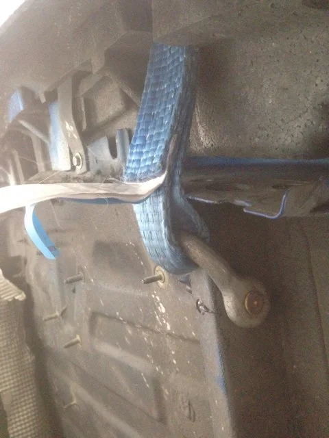

Managed to fit a rear tow strap quite tidy as well. Pulled the trim, cut in behind and pushed a 2000kg rated ratchet strap end through. Mounted to the chassis with a bow shackle.
Trimmed the trim. Nice result for no cost.

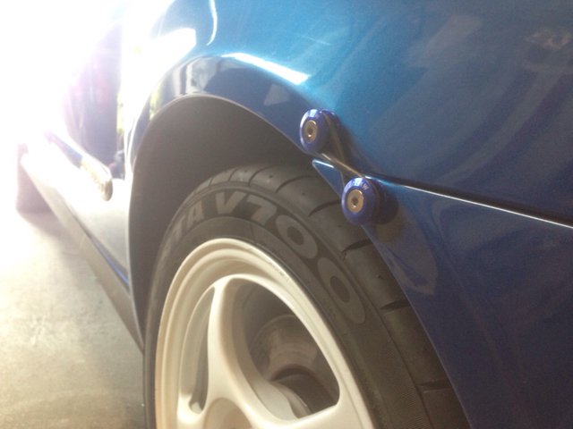

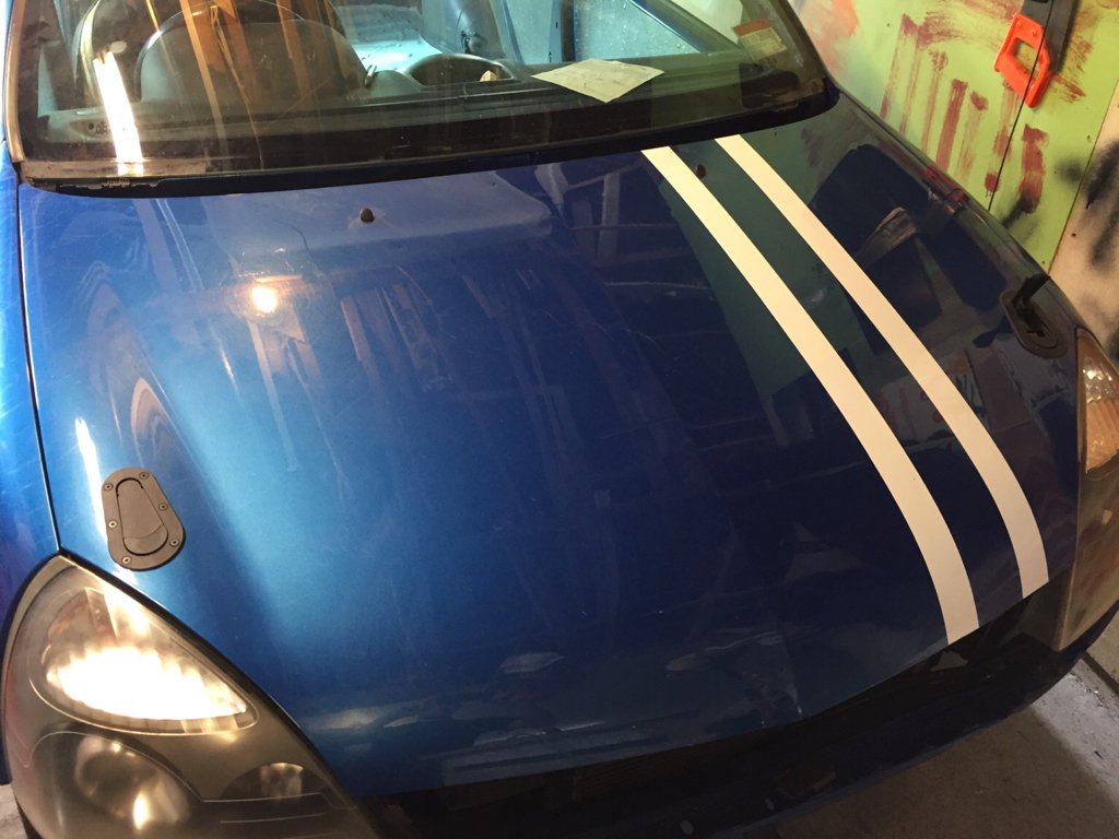

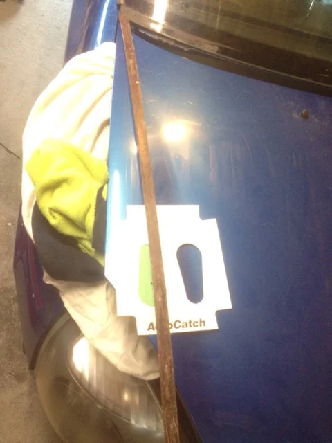

Aerocatches in. Fair bit of messing around. Bit worried they are not far enough forward. Note to self for next time - push nuts into backing plate so they don't drop down inside the bonnet recesses!

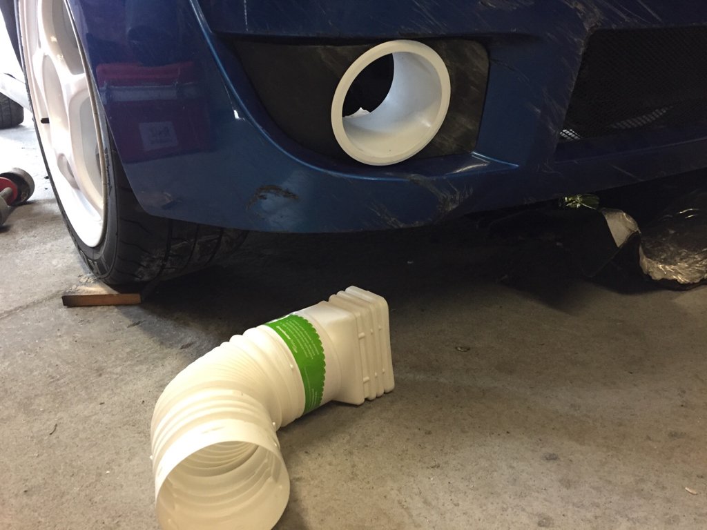

Here's an alternative brake cooling duct setup. Found these at the home depot store. 100mm pvc pipe connection and flexible downpipe adaptor. Mint.

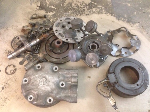

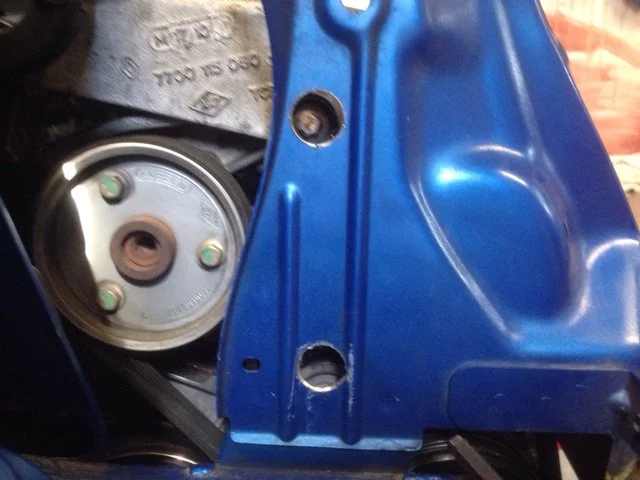

Alternator back from getting repaired so fitted all the aux belt hooha. Grrrrr. Good not be stuffed pulling the pms AC delete off the 172 so fitted the 182 track car with the AC but ....... gutted a spare one I had. Took 3kg out of it.
. Pic of the bits removed. Also used a step drill to open out the top hole on the tensioner.
. Found that a draw bolt rather than a hose clamp (similar but stronger) worked well. 90mm between centres seems to be the correct compression of the tension spring.

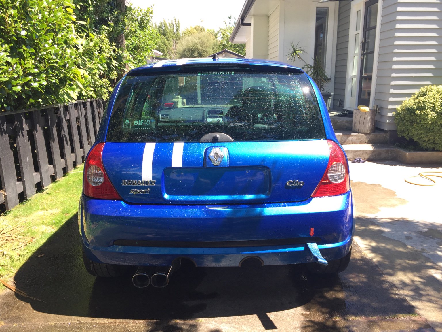

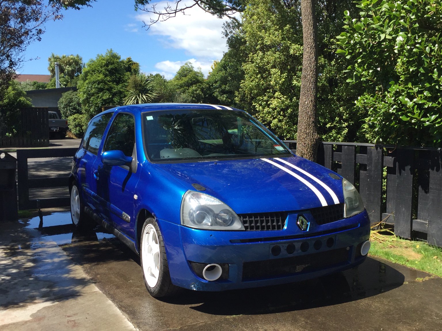

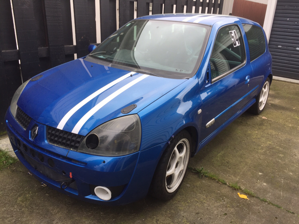

First time out of the garage for a quick wash. Doesn't look too bad for having been through a chain link fence. Track time here we come (thermostat not working tho)

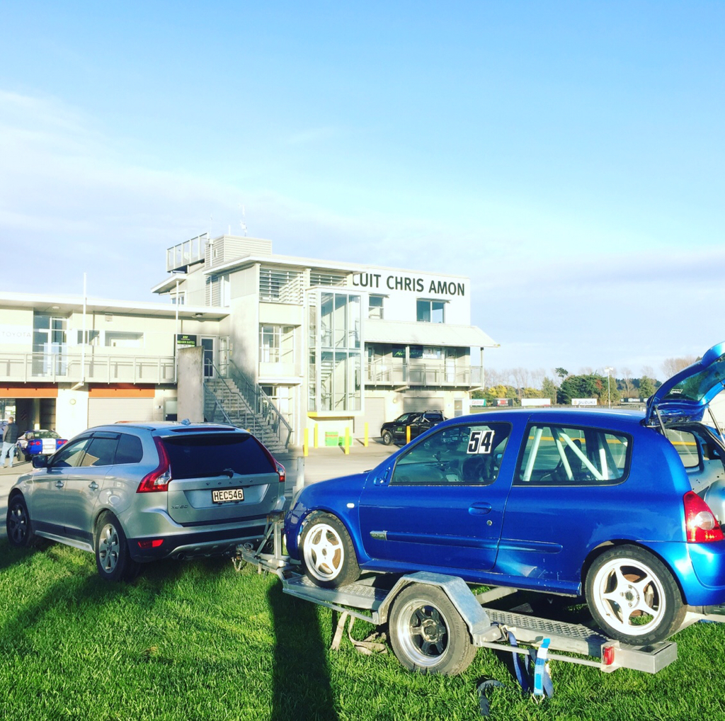

Thinking about joining a club. Until then Playdayontrack at Manfield track.

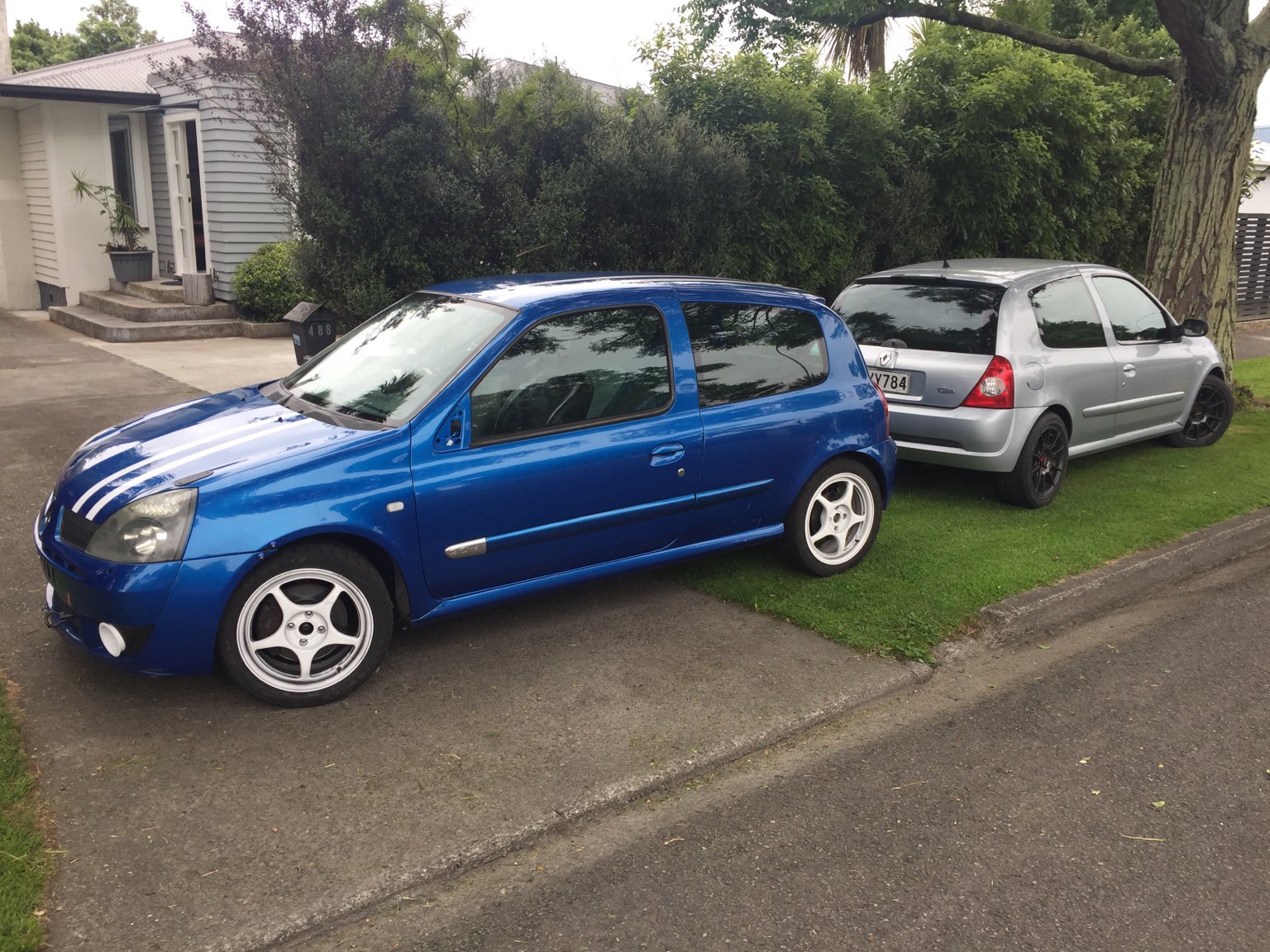

Thread is a bit confusing sorry. I started with a silver 172 but then bought this 182 as a track car. Haven't tried the kumhos yet.

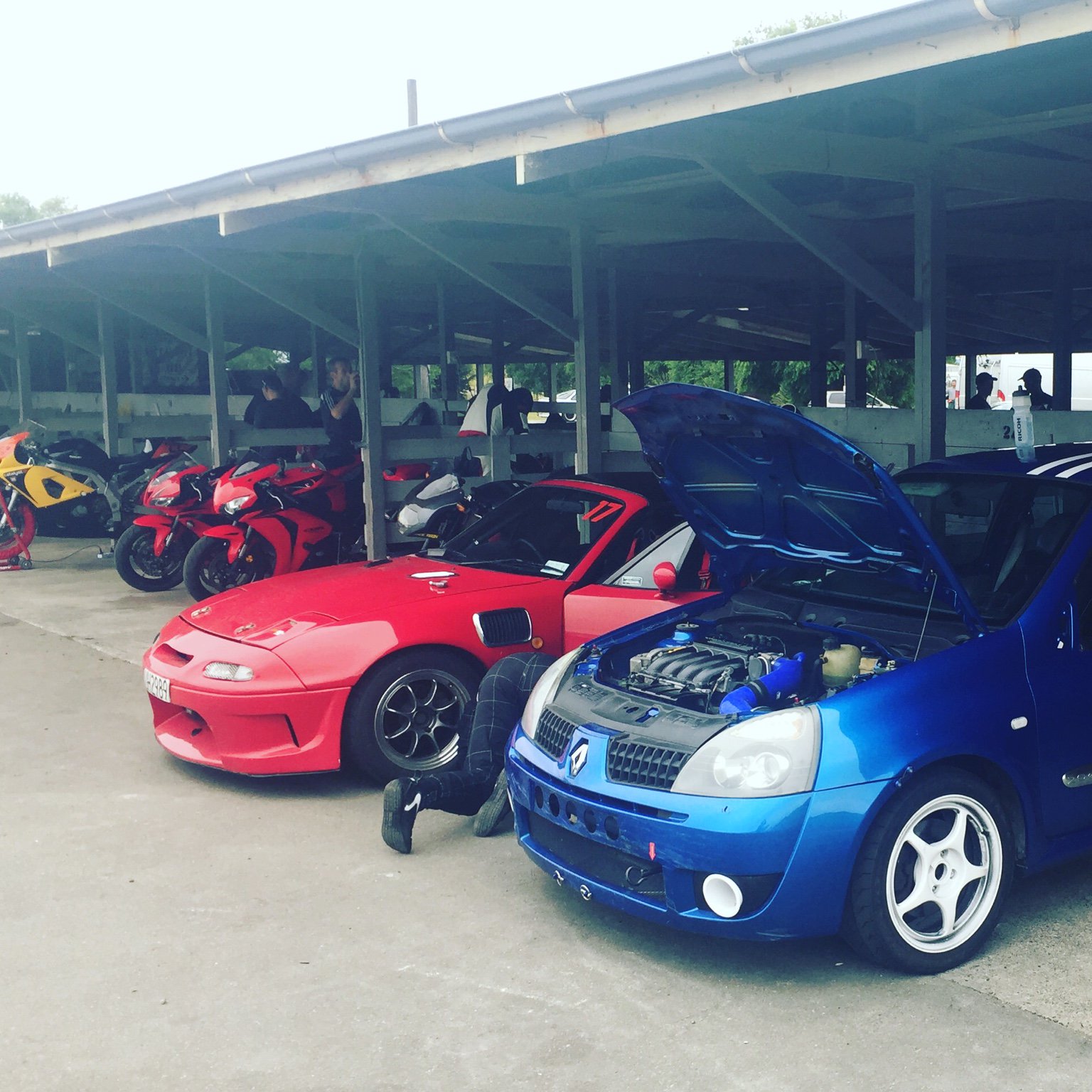

Manfield track day report : 182 went awesome. It was the first time I have driven it and managed to get my best lap down to 1:26.0 - well happy. Shot below of the pits setup - the MX5 beside was turbo'd with a few trick bits and sticky tires. They were very surprised that the little Clio was a few seconds quicker!

Khumo V70 semi slicks were great on track. I ended up running pressures lower and lower. Next time I will start cold at 25psi rear 26 front I think. Heres the 182 with my DD 172.
