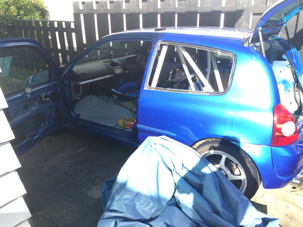

Ha can't wait to see your car. All internals, tar, half dash, gutted headlights, brackets, etc. Going to go for a PAS delete I think - arm strong steering.

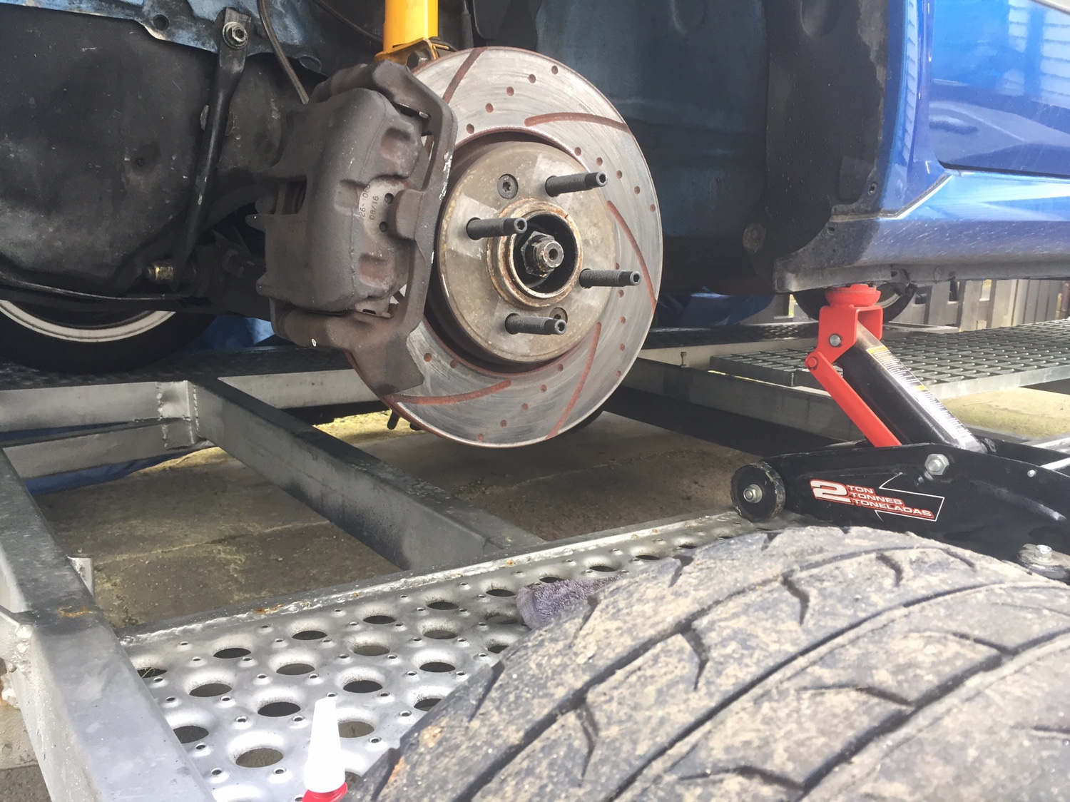

PMS hub bolts on.

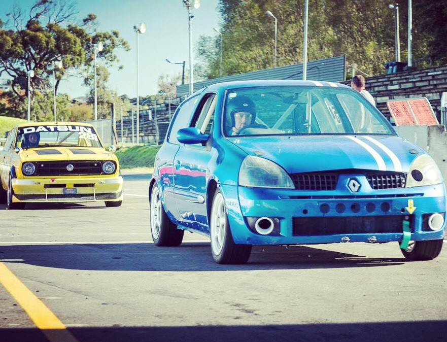

PMS PAS delete fitted as well. Absolutely fine on track with 360mm steering wheel. Lap times still falling.

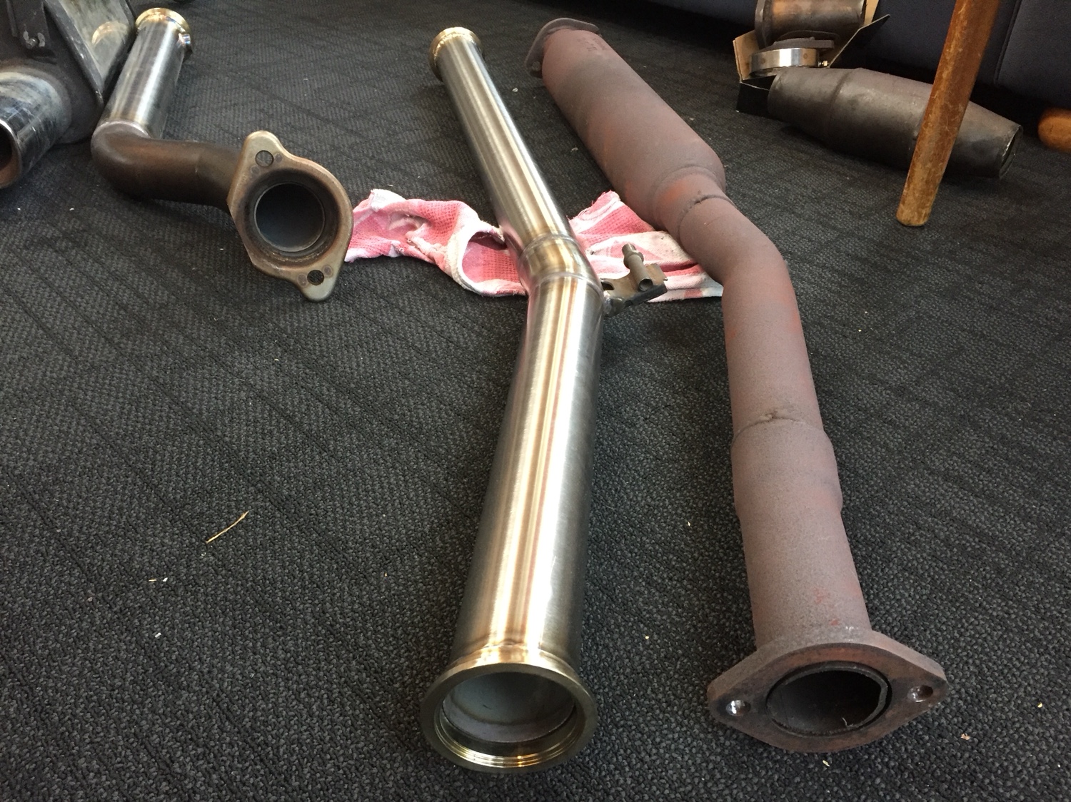

SS dairy tube exhaust is in. Cat and mid resonator are out, cost me $100 to get it tig’d up & $80 for two vbands. ABS is out and custom brake lines made and fitted. Bought a double flare tool and 3/16 tube bender to do the job. Much cheaper than premade.
