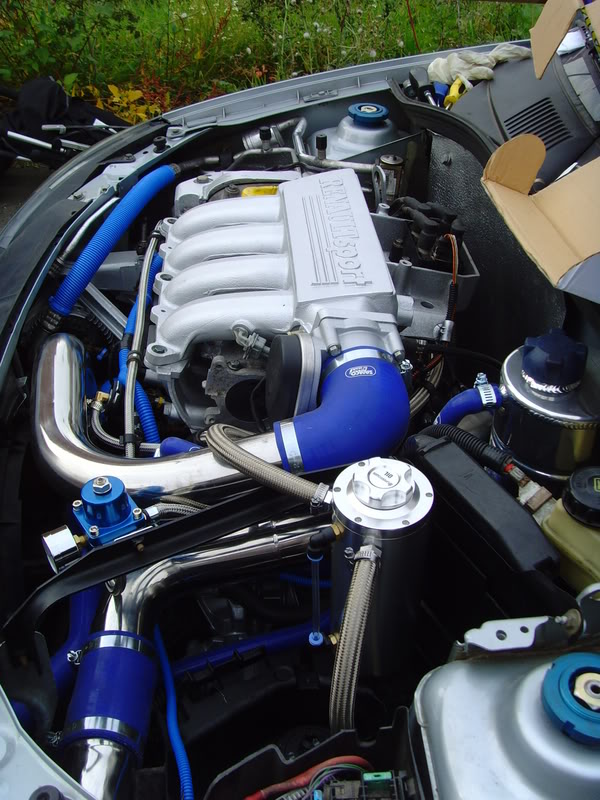

Here's mine on my 172 turbo( metal canister by the ECU at bottom of pic), hope it helps answer you question mate. Pipe from breather on cam cover goes into the catch tank then vents to atmosphere through a small filter connected to the second pipe under the car.

It would. Your problem is your breather is venting right next to the scuttle as your bonnet is lifted. Fitting a catch tank and breather AWAY from the scuttle area will stop you getting smells inside the car.
Fit the catch tank to the bulkhead then the breather filter on a pipe lower down near the master cylinder.

just out of interest, where can i get my hands on some of those hoses, looks very neat :)
