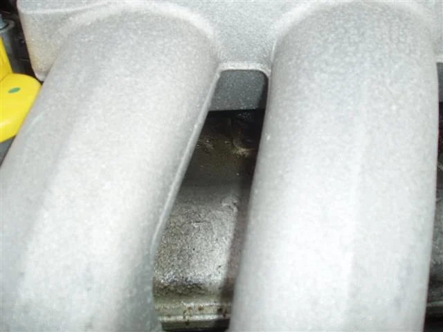

When doing the old 6k Oil change over the weekend i noticed oil on top of the engine.
not knowing a great deal about these things, i'm just wondering if this is kind of normal? or if i have a slight oil leak.
(been hearing about a common 172/182 oil leak.. is this it?
Any ideas?

Mate mine went into Renault on Friday with this problem, and has been re-booked in to get it fixed.
Renault told me, there is a little hole on the joint of the rocker cover. Renault use a sort of putty sealant instead of a head gasket. It's a big job, requires taking off cam belt and head of engine. About 8 hours work (mine is going in for 2 days)
Get it booked into Renault, hopefully it is under warrenty!?

8hours!!! hahahaha, gotta love renault!!! the head stays on, 5hour job MAX
95% of them leak there, very common

hell.. so it is a problem!! bugger
It's under warranty until November (luckily!)
I didn't think it was too much of a problem.. I was wrong.
Better get the thing booked in.

By the way, would this make the 'oil ------' & SERV light come on when the oil isn't all that low? (i've been having that recently)

can do a quick fix too by sealing the bolt heads, which I think they did on mine as it didnt take that long for mine to be done.
That was about 12 - 18k miles ago and never been a problem since.

make it as dumb f**k proof as poss when u take it in i.e. tell them its the rocker cover and its a known fault.

very very very common fault ;)
