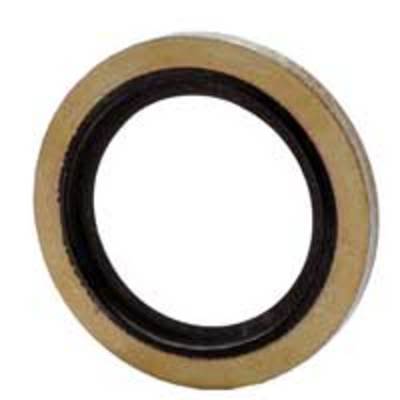

The reason for it is you can place a copper sealing washer (known as a Dowty Washer- which can be found on eay or a local hydraulics source) against the face of it to seal on the engine block the same as the standard oil pressure light/switch sensor.

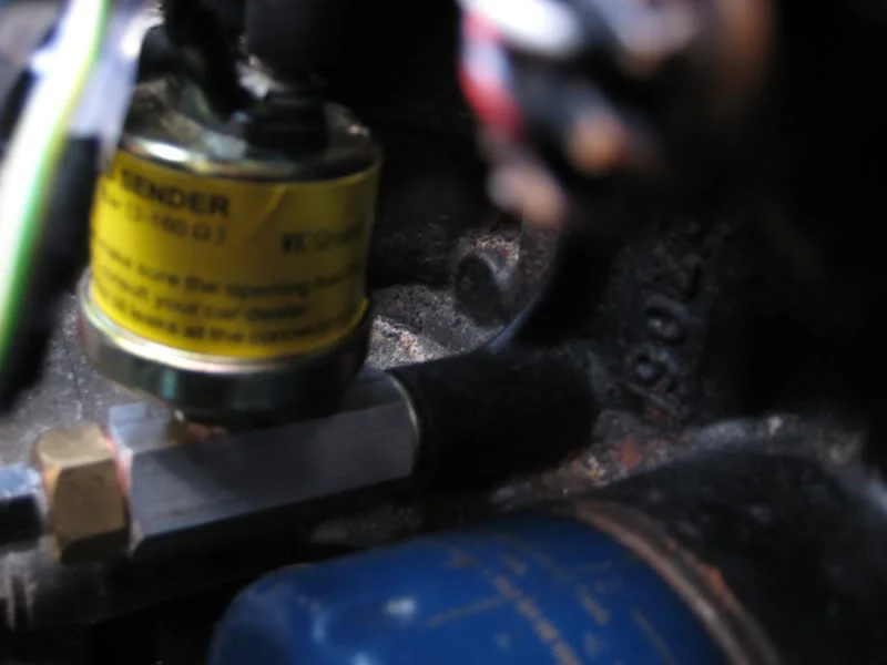

Heres a pic of what i settled for before removal but it doesn't show the fitting with the standard oil pressure light/switch sensor hooked in.
The adaptor in the end of the T fitting is to reduce the M14 x 1.5 Female thread to 1/8" NPT to allow me to fit my temperature gauge sensor in the end as it was too long to go in the side.

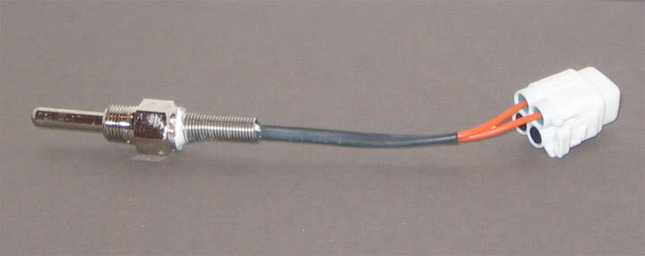

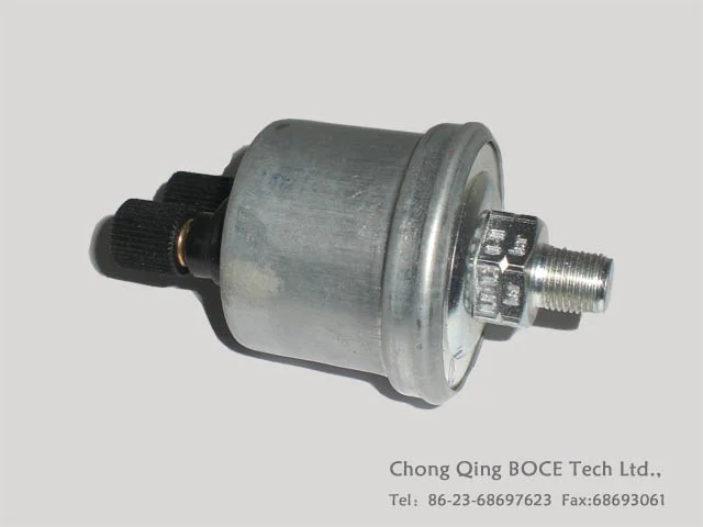

The port in the side is only suitable for a oil pressure gauge as the sender/sensor for temperature is twice the lenght of most oil pressure sender/sensor thread shanks/shaft...
Its quite self explanatory in these example pics the difference in lengths.
OIL PRESSURE
OIL TEMPERATURE
DOWTY WASHERS (A.k.a Copper crush washers)
