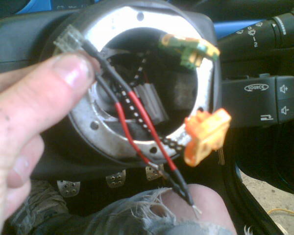

Got any pics? might jog my memory lol. Fitted a momo kit in the summer. iirc, the square speaker type connector is the horn, does the fused wire have any resistors inline or under any sheathing?
there are wires for the horn, and also wires to act as a resistor for the steering airbag i think.
Its the same one i got!
Thats the air bag then, but if was anything like the momo kit, you need two. Iirc, you will need x2 4 ohm reistors from maplins etc, and another inline fuse. There are two connections for the airbag.

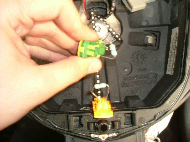

Found some pics from when i did mine.. You will have something like this yes?
^you need to either make another, or just make two form scratch using the 4 ohm resistors.
They then need to be connected across the two pins on each connector (green and orange) You can just short the resistor between the pins, but using the fuse(s) will be safer.

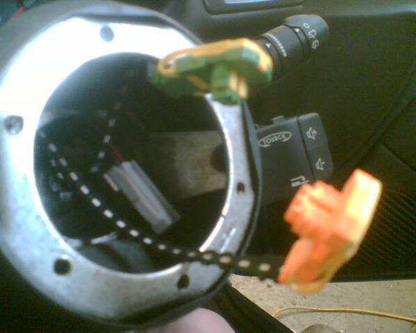

no, on the back of the OEM wheel there are 2 metal things that sit in the plastic ring to tell the ECU which way the wheels are pointing, this is for the ABS and traction. I had this problem last year, i removed it but all the lights came on.

No you shouldn't. If you check the orientation of the wires that come out of the console they should be at the top of the boss when you connect it up and put the new wheel on, should help with 'zeroing' the sensor.

This pic show the original wheel still on with the airbag removed. Just plug the two resistors into each connector.

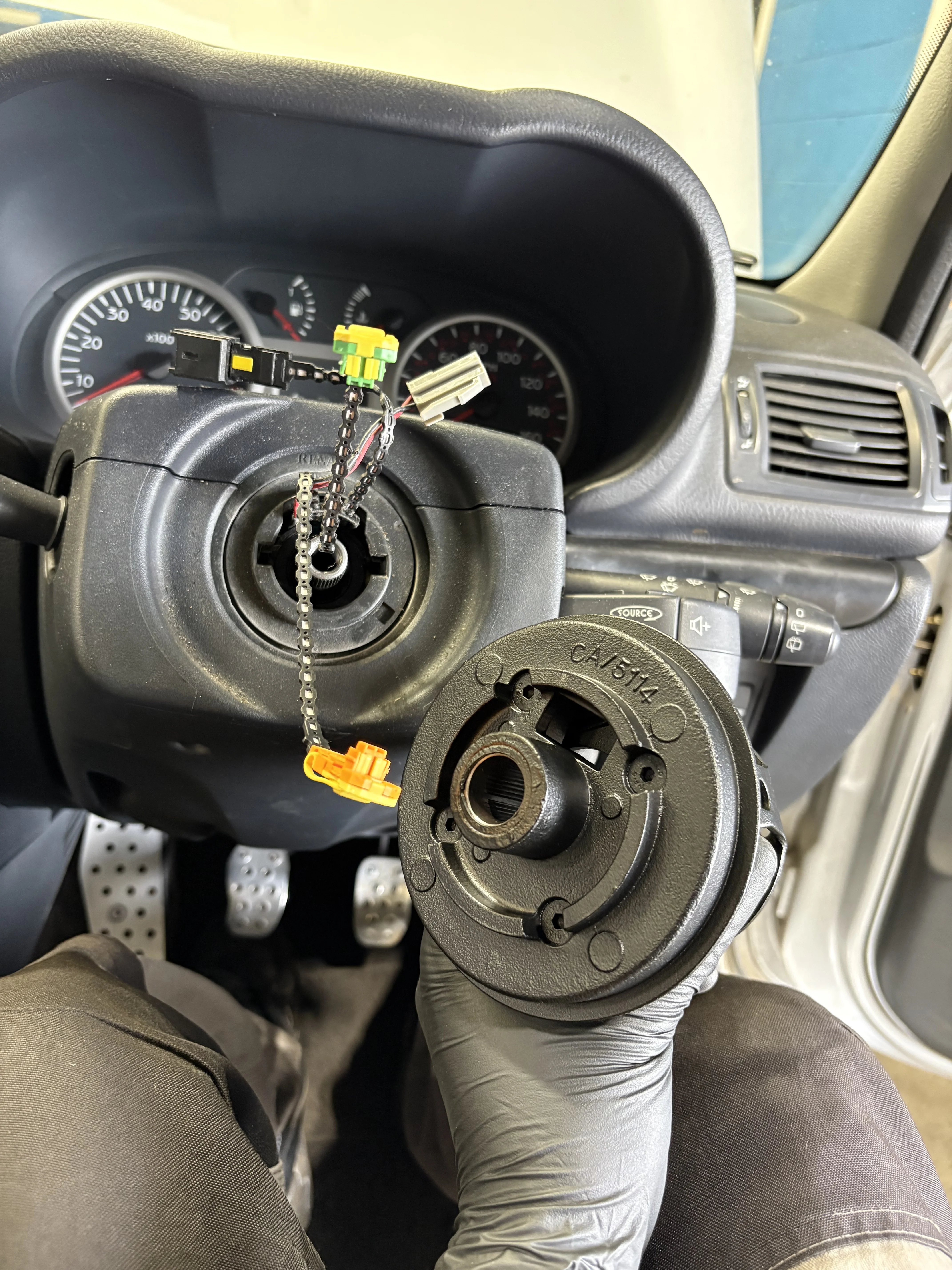

How did you manage to get the plugs through the boss kit? I’ve got an omp one here for my 182 and the opening hole isn’t big enough for the plugs, any help would be great
