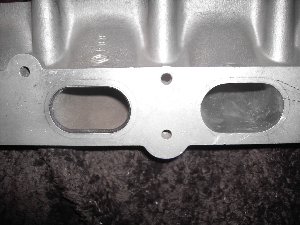

overlay of exhaust ports ph 1 vs ph 2
So messing about with the head today

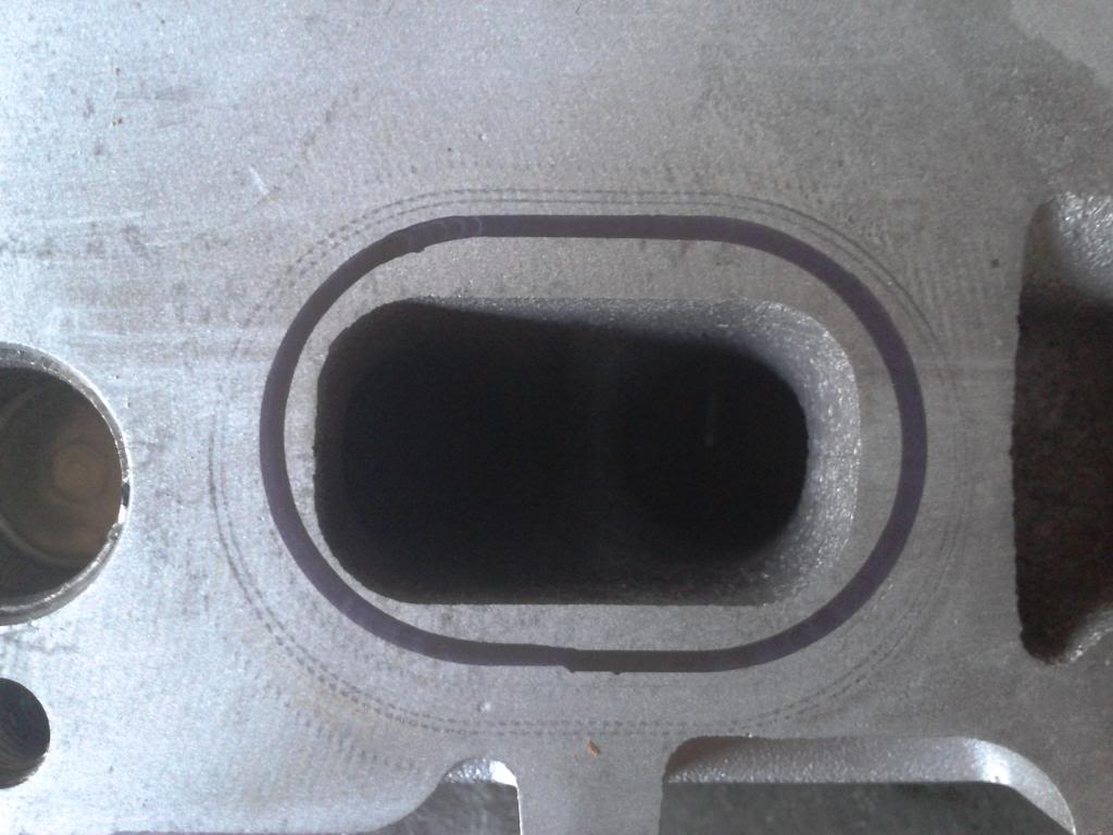

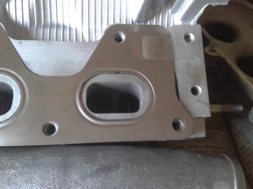

i have a ph 2 head and was comparing gaskets from a ph 1 and ph2
i already knew ph 1 ports were bigger

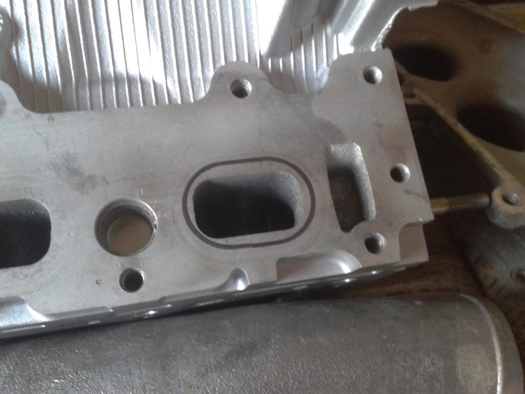

^ ph 2 head with ph 1 gasket
there is quite a size difference
so the question
does any one know if its possible to convert the ph 2 port to ph 1 size?
or am i going to hit a water way ect
as i think the smaller exhaust ports will be a restriction on a boosted engine

Yes you can open them out to ph1 size mate. In fact you can go significantly larger than ph1 if you want but it's a bit pointless. It's all in the shape of the ports not how big they are mate. What hp are you looking for? Original ph2 head flows fine in boosted applications anyway (up to a point though obviously)
thanks may have a go at them over December then
yeah the port shape is not the best but they seem to flow fairly well as standard as you say to a point
i am not really aiming for a figure any where over 300 will be more than enough
just trying to make it make it as best i can with out spending any more money
