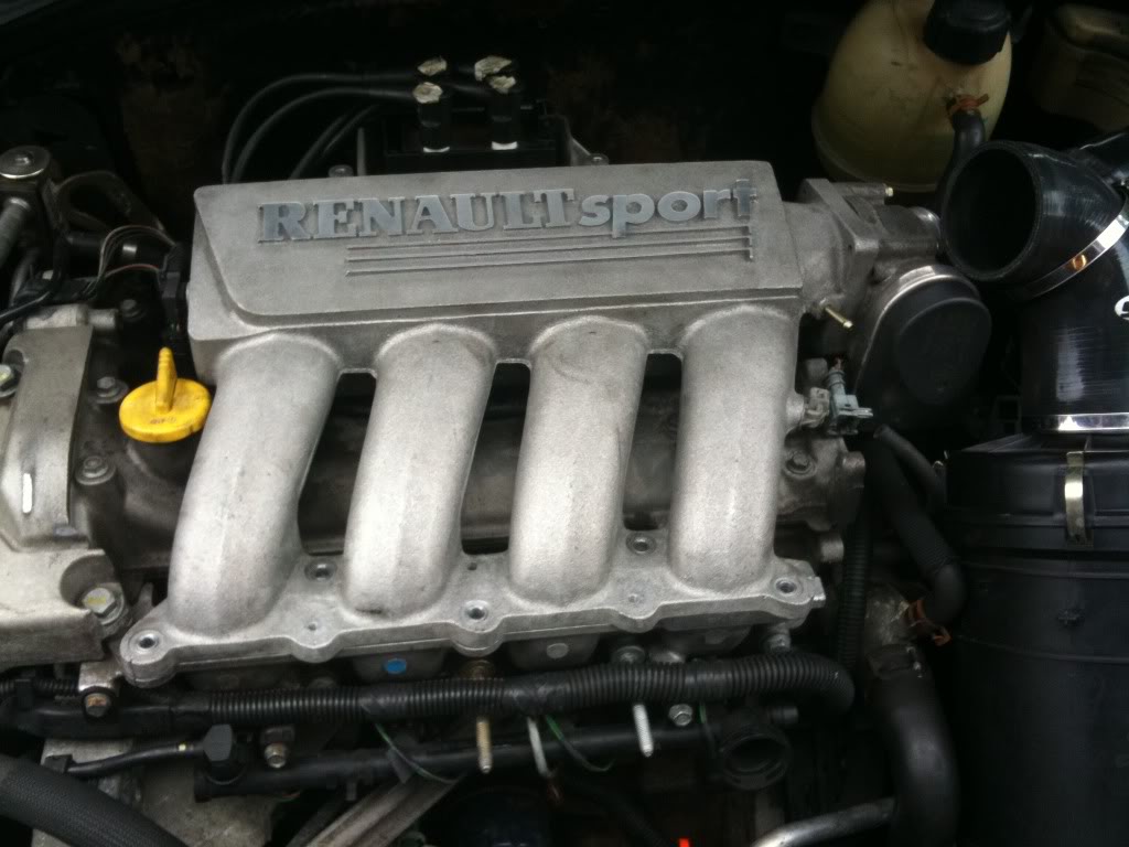

Here's the inlets before, bit grubby looking :dead:

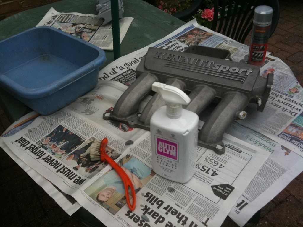

Cleaned with AG Engine Cleaner, wet sanded then prepared for painting with thinners.

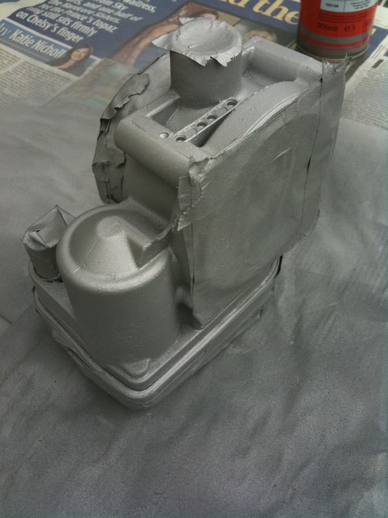

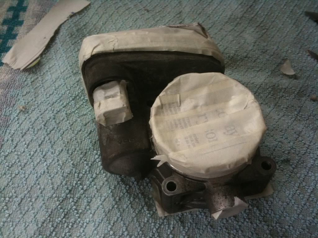

Masked up inlet and tb ready for painting

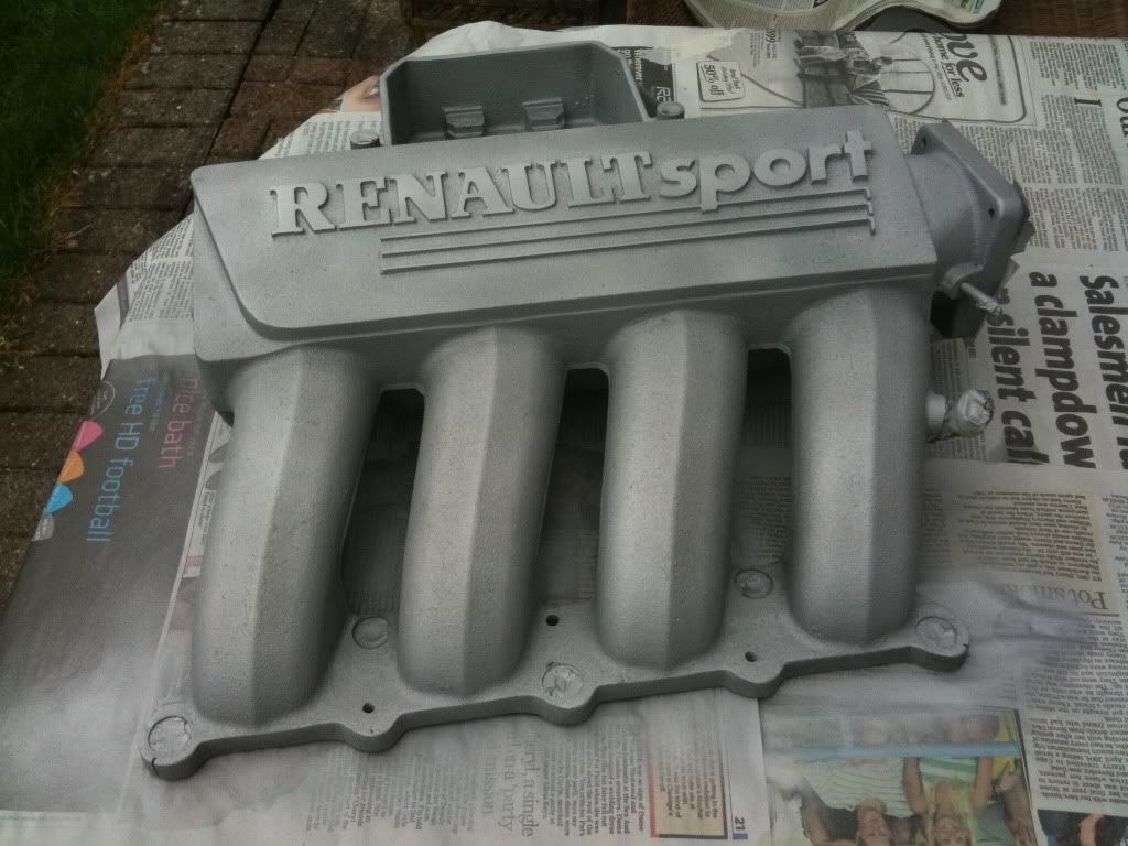

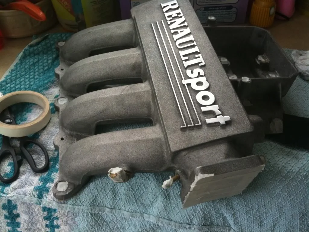

First coats of Halfords Very High Temperature Aluminium Paint

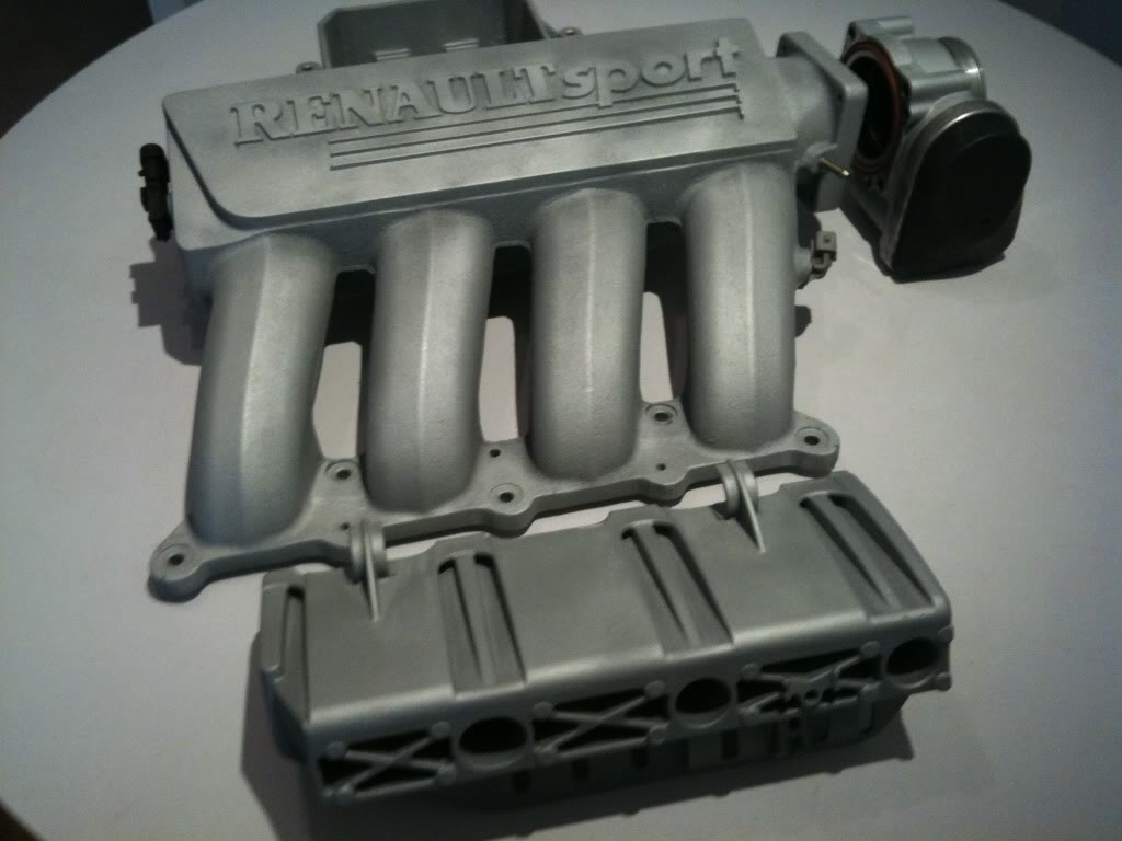

Few coats later ready to be refitted.

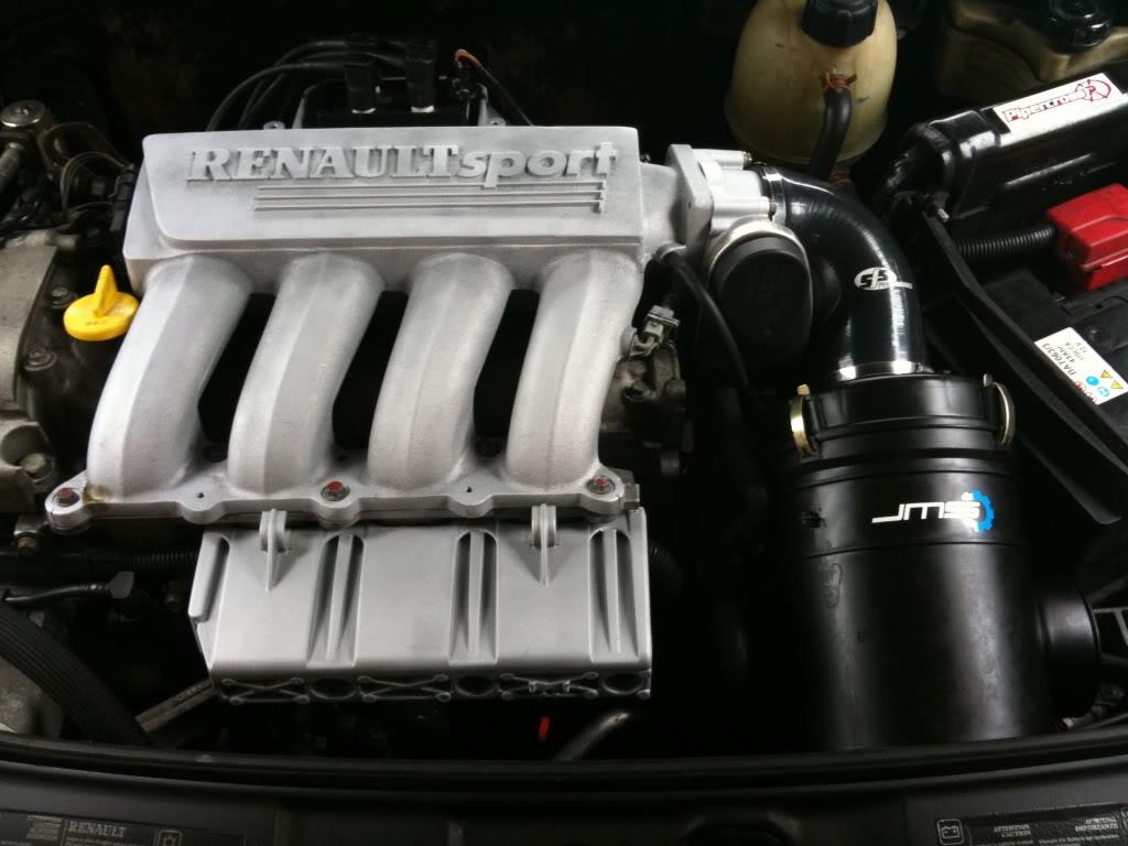

And the bits back on the car with my polished up JMS induction kit :D
The Renault Sport part is going to be sanded back to metal or painted a different colour but haven't decided yet.
