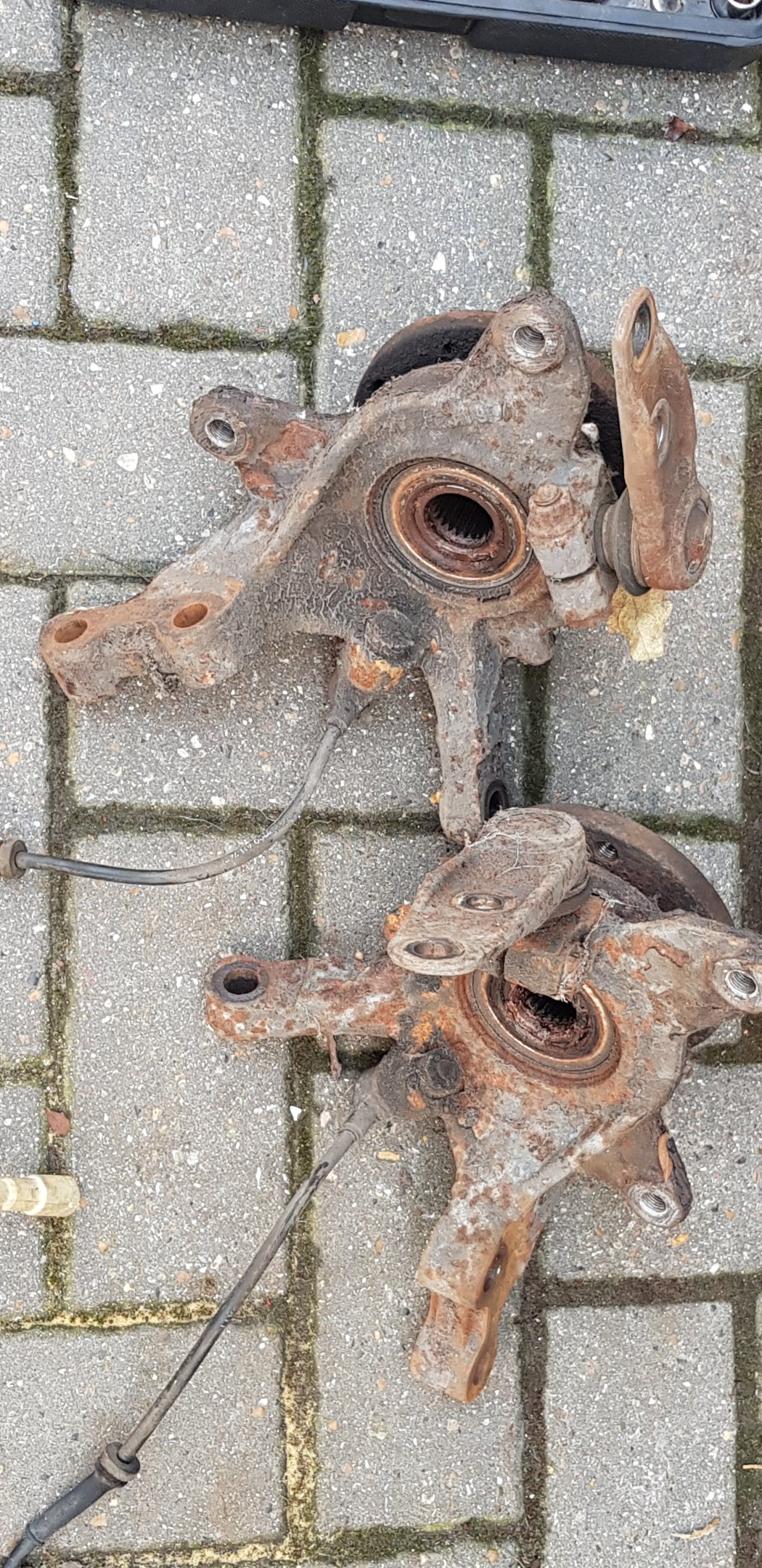

The wheel bearing noise was really annoying and was hard to tell which one. I removed both front hubs yesterday. The drivers side one was definately gone. The passenger side has a small amount of movement. I have ordered a pair of FAG bearings, which will be fitted this week. I will then reassemble with some new track rod ends and get the tracking done again. Should then be good to use a bit more!

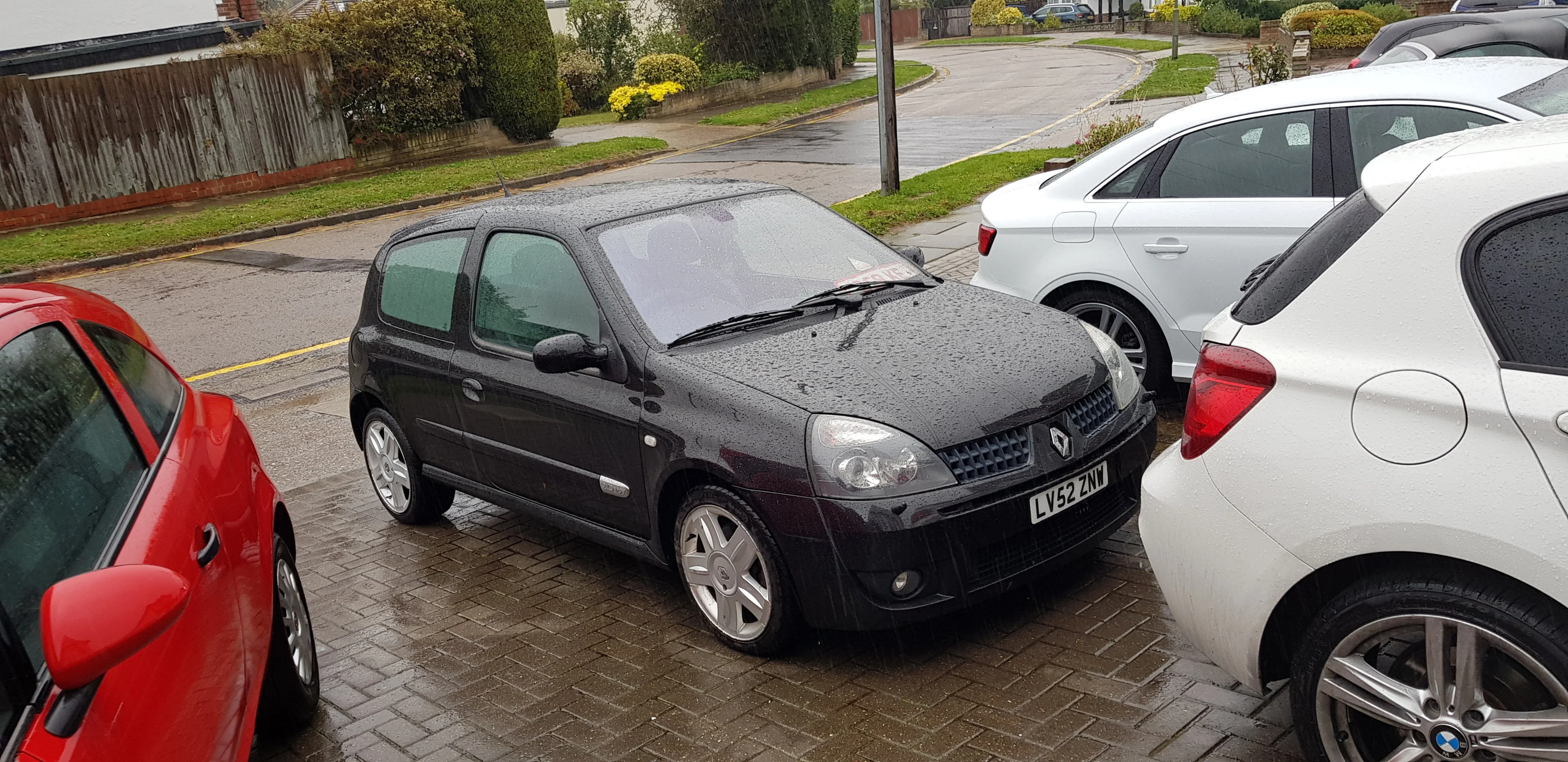

Most recent pic I have...
Hubs removed ready for new bearings. Will be all cleaned up and painted before I refit.

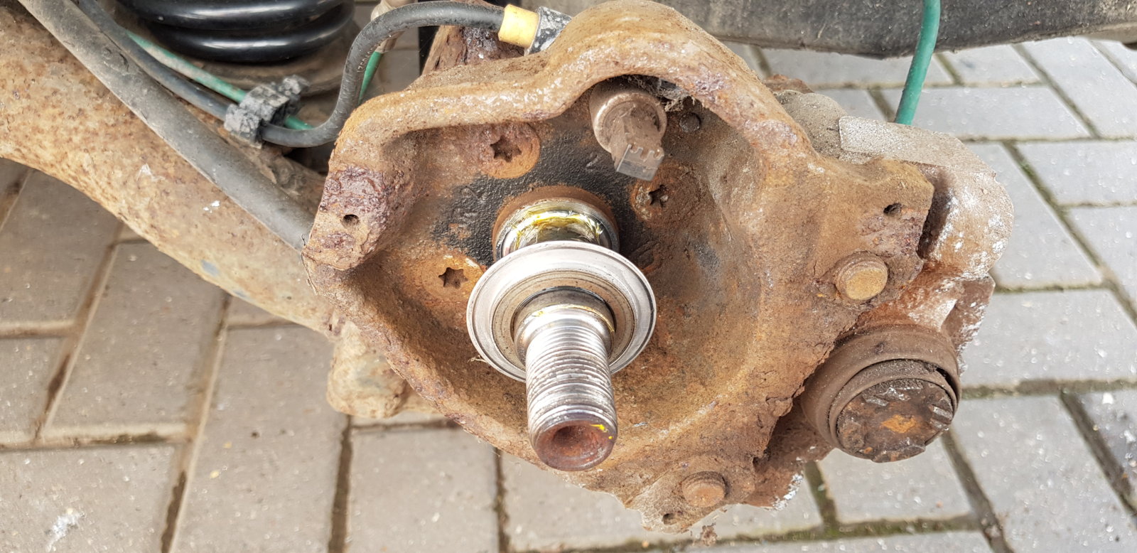

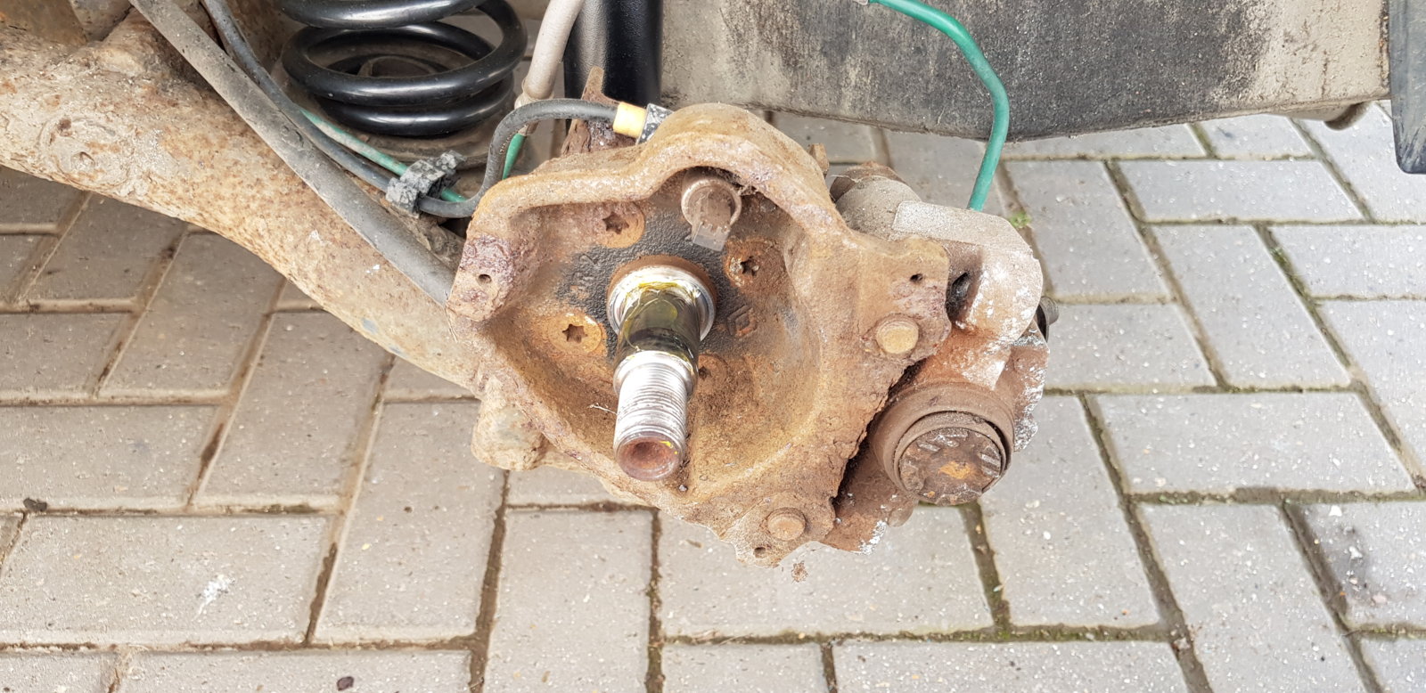

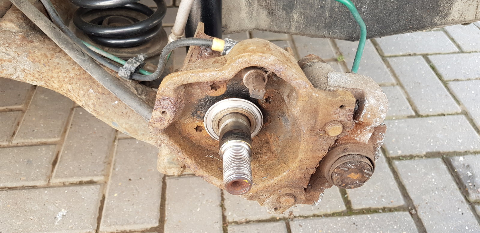

It's back now though and managed to get a few bits done today. After getting the front wheel bearings done, which were both knackered, I still had a horrible drone when driving. Rear discs didn't look great so ordered a pair from eBay with the bearings pressed in along with some Mintex Pads. Did the drivers side first. On removal this was clearly my issue. The bearing was knackered. This did not show up until removed. No play and when spun with the wheel on seemed fine. Once removed felt terrible. Was good to see the washers present behind the discs. Have taken a pic for anyone not sure what the washer looks like.
Both sides done. Passenger side bearing seemed fine when removed. Rear nuts torque up to 175 NM. Took for a drive and all is good. No more drone. All four wheel bearings have now been replaced.

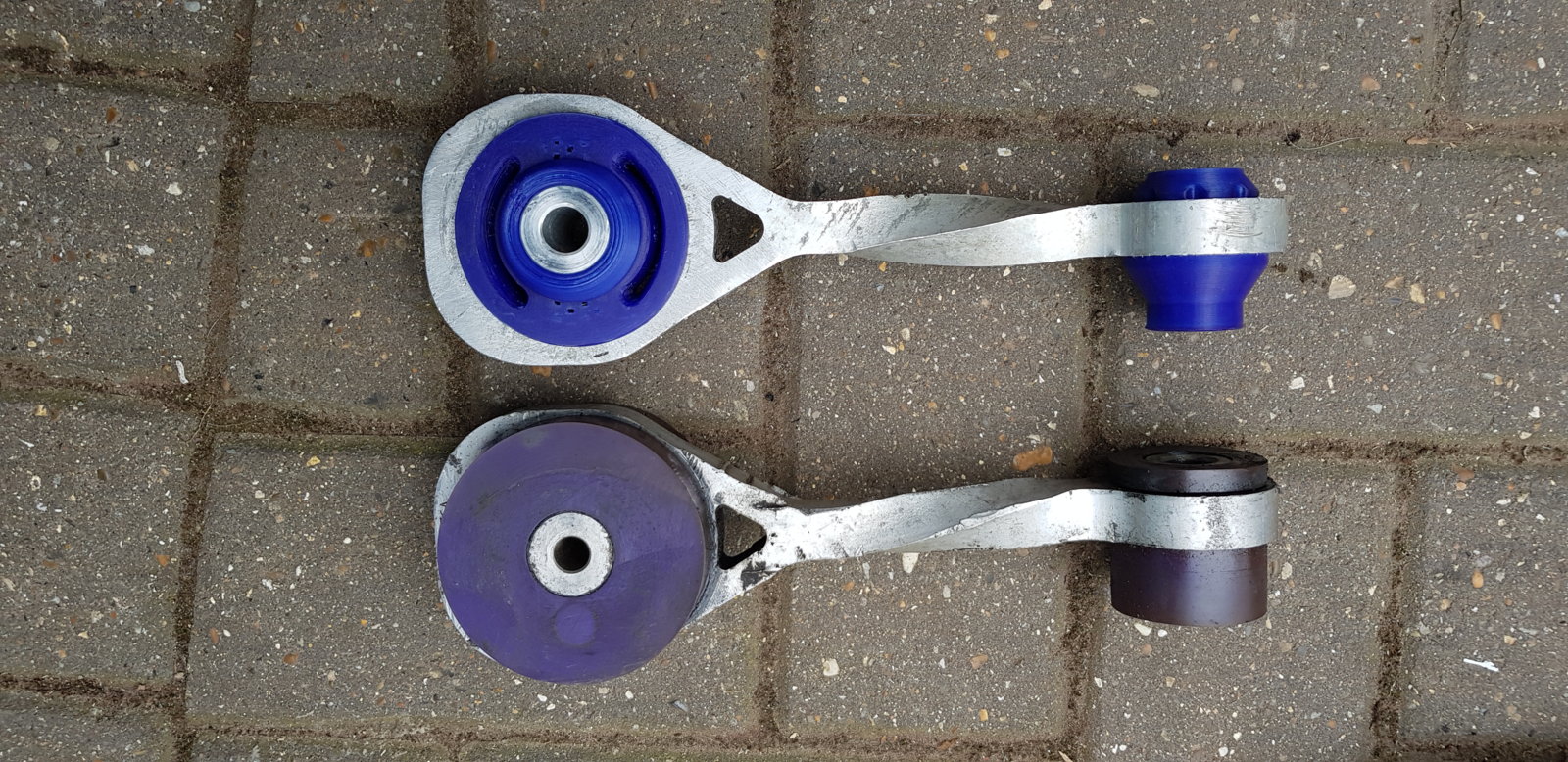

I have recently purchased one of the upgraded road dog bone mounts from @PhillipM to try. As the car is for road use I would like it to be fairly refined. Pic below is of the Powerflex one fitted and the new one from.

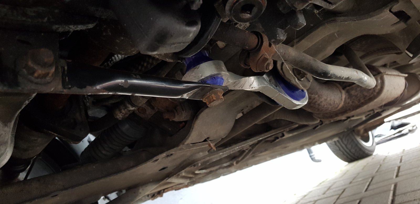

Today I have removed the top engine mount and this is definately the culprit. Completely collapsed. I had a good one in my spares with a yellow Powerflex insert which I have fitted today. Already seems much improved. Will test it properly tomorrow on way to work. The engine is definitely sitting a bit higher and no where near as much movement.

Have put over 500 miles on. Unfortunately the top engine mount was shot, so have replaced that. There is still too much movement and I think the upper gearbox mount is at fault so hard to evaluate at the moment. Certainly not getting as much vibration in the car as I would with a solid one. Once I have replaced the gearbox mount(this week) I will give a proper review.
Initial assessment is it is well made, stiffer that the standard dogbone and definately not as harsh as the solid ones available.
