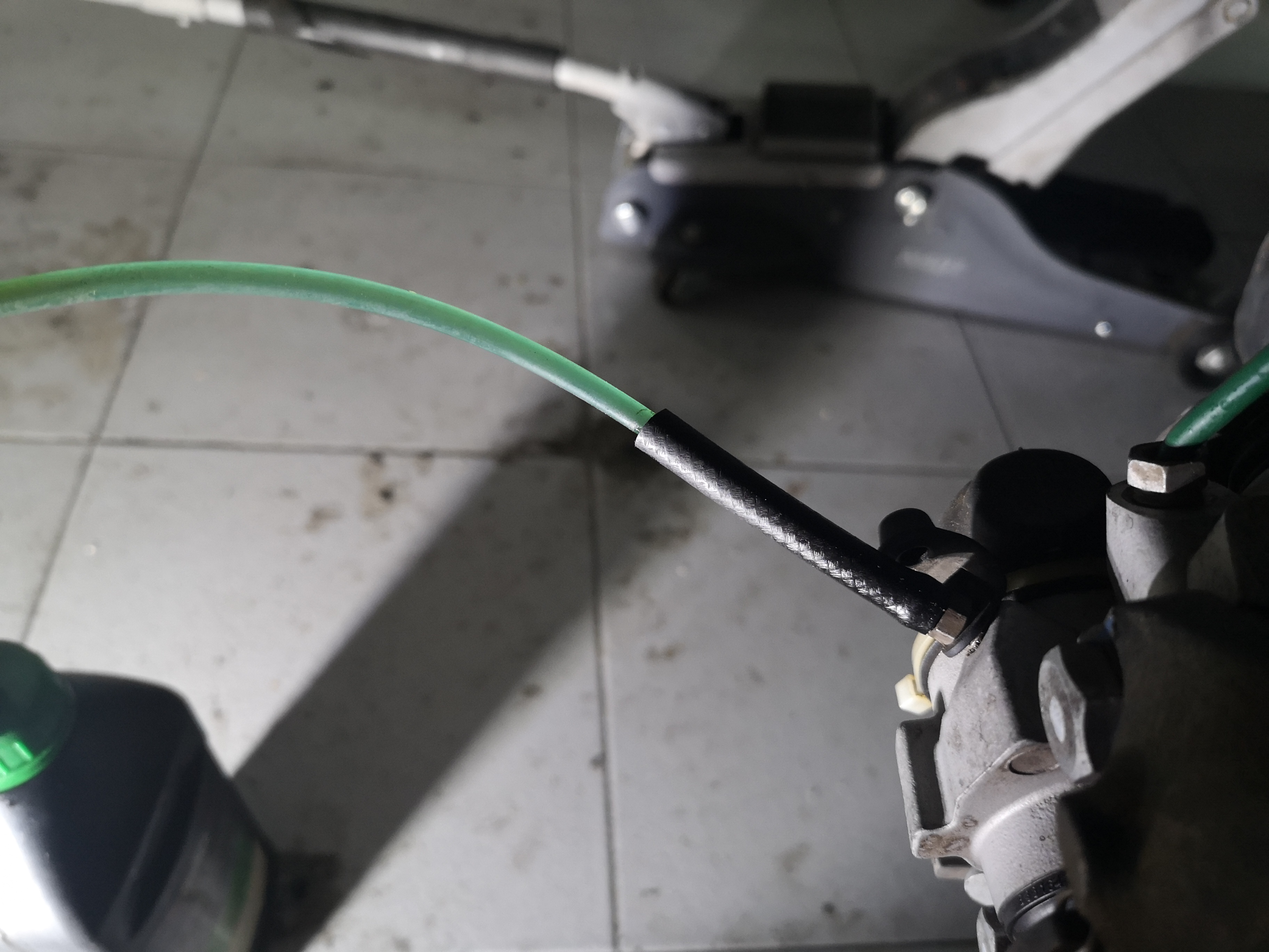

This weekend as filled with frustration. A simple brake flush turned into a shitty job!
Starting...

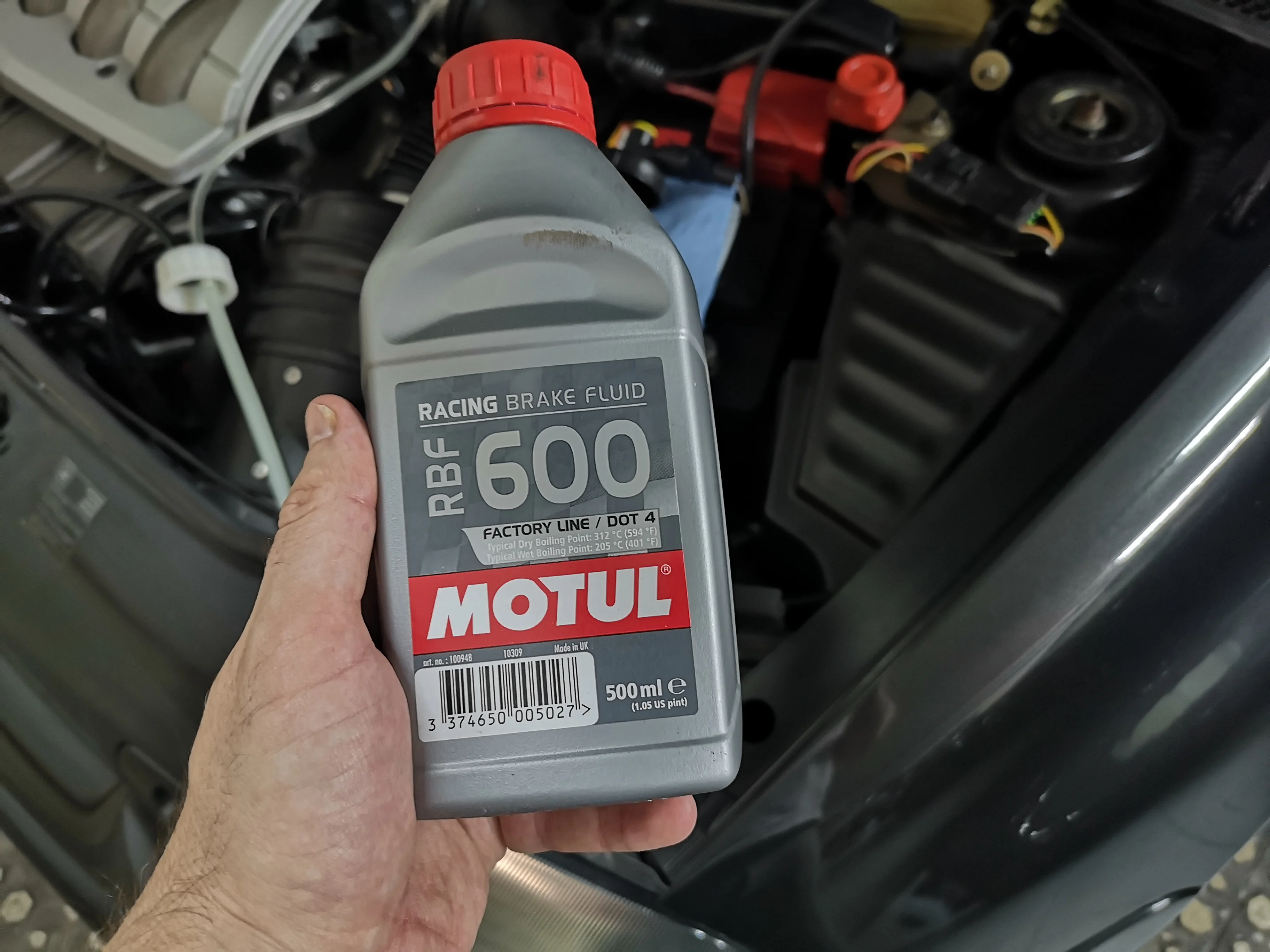

Old fluid looking a bit old.

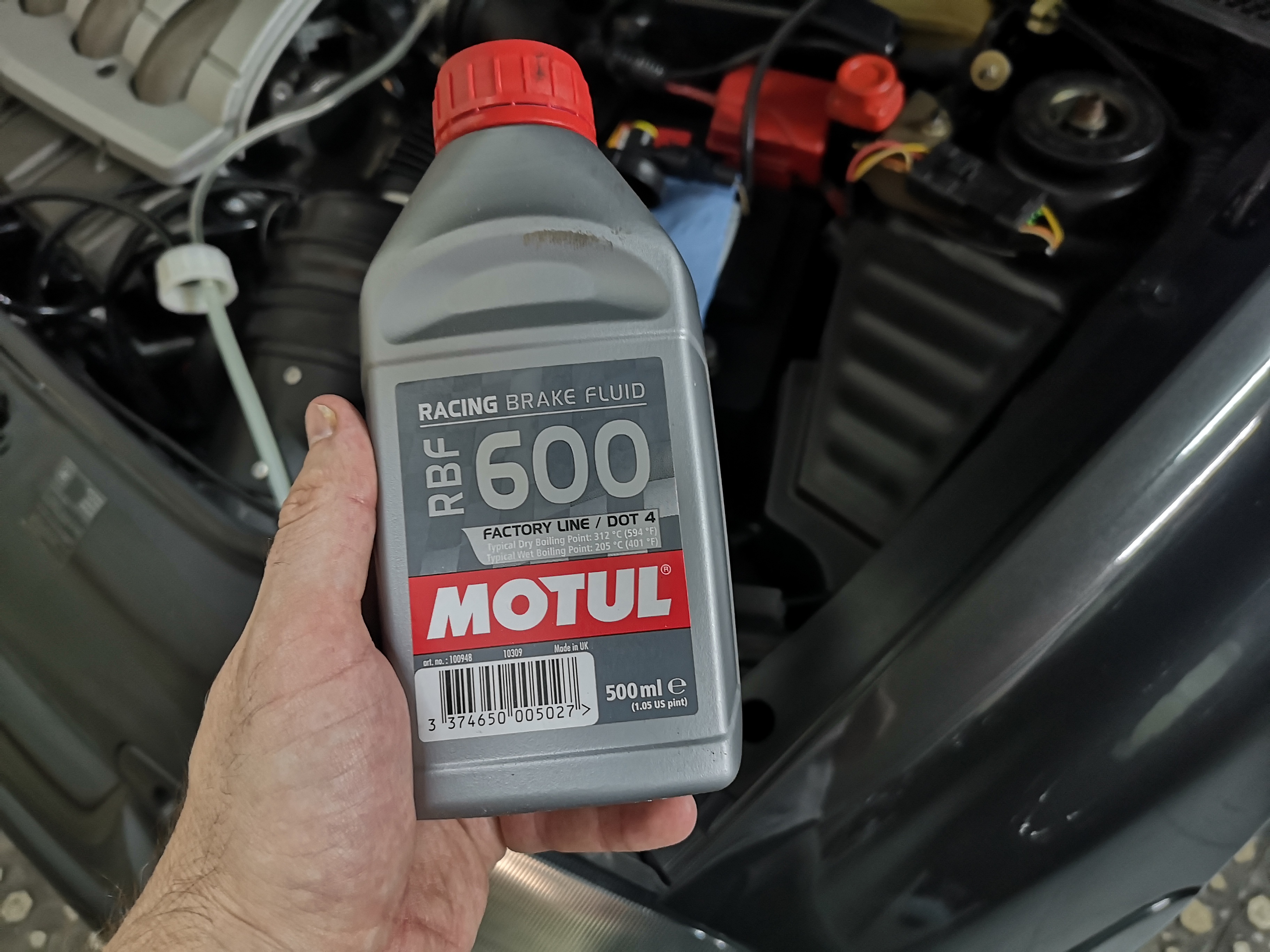

Motul RBF600 more than enought for this car use :)

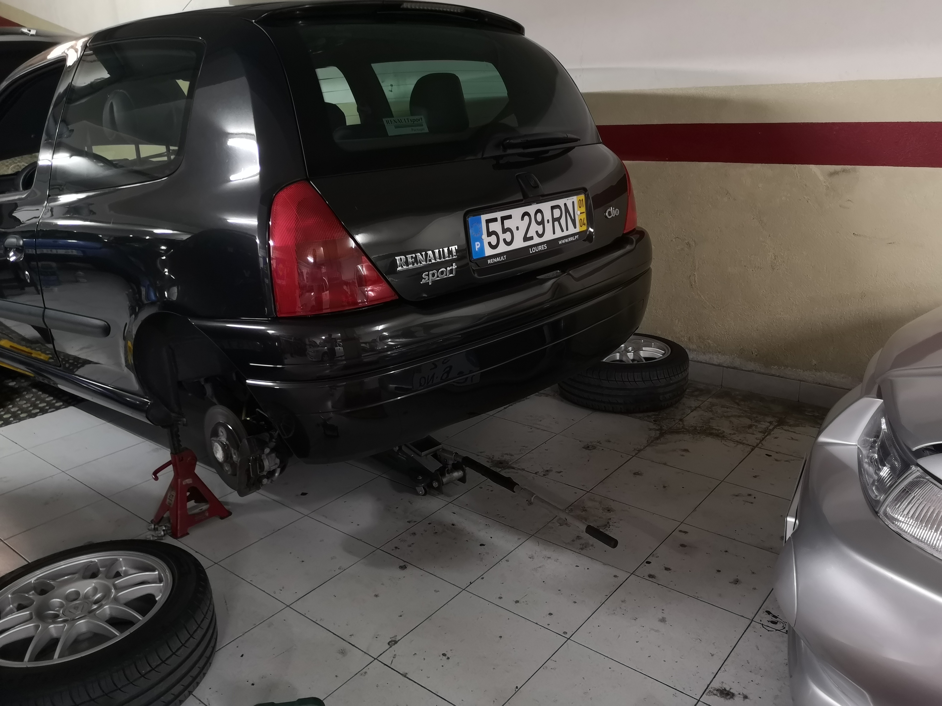

Since all the rear brake parts arrived, i decided to tackle the job on this rainy weekend :)
Preparing the car to lift it.

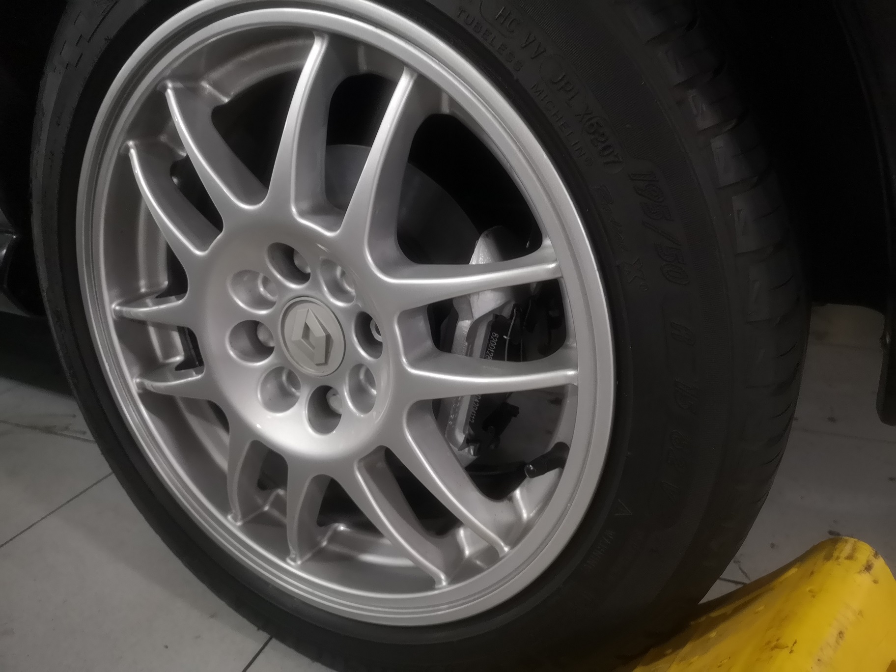

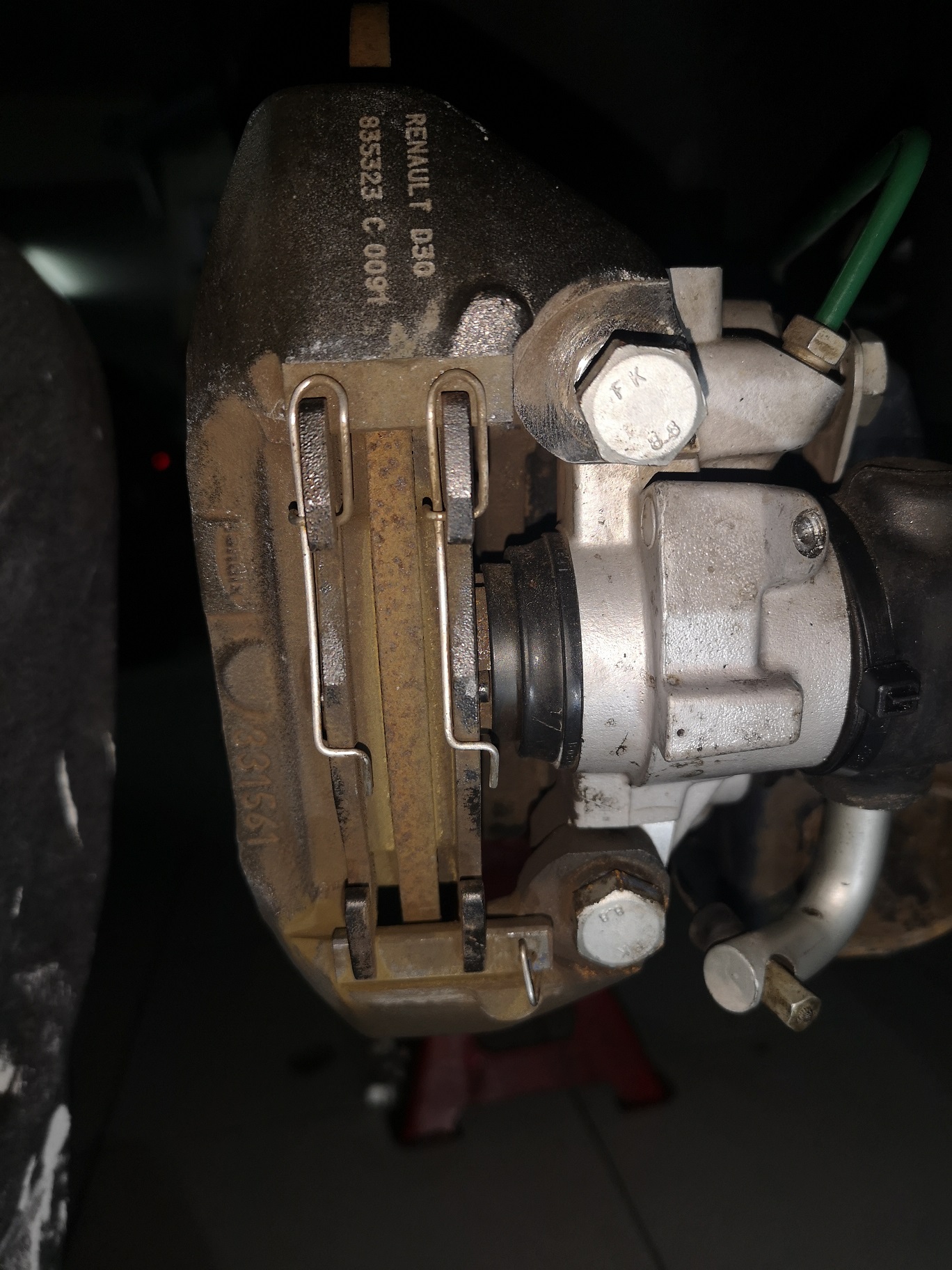

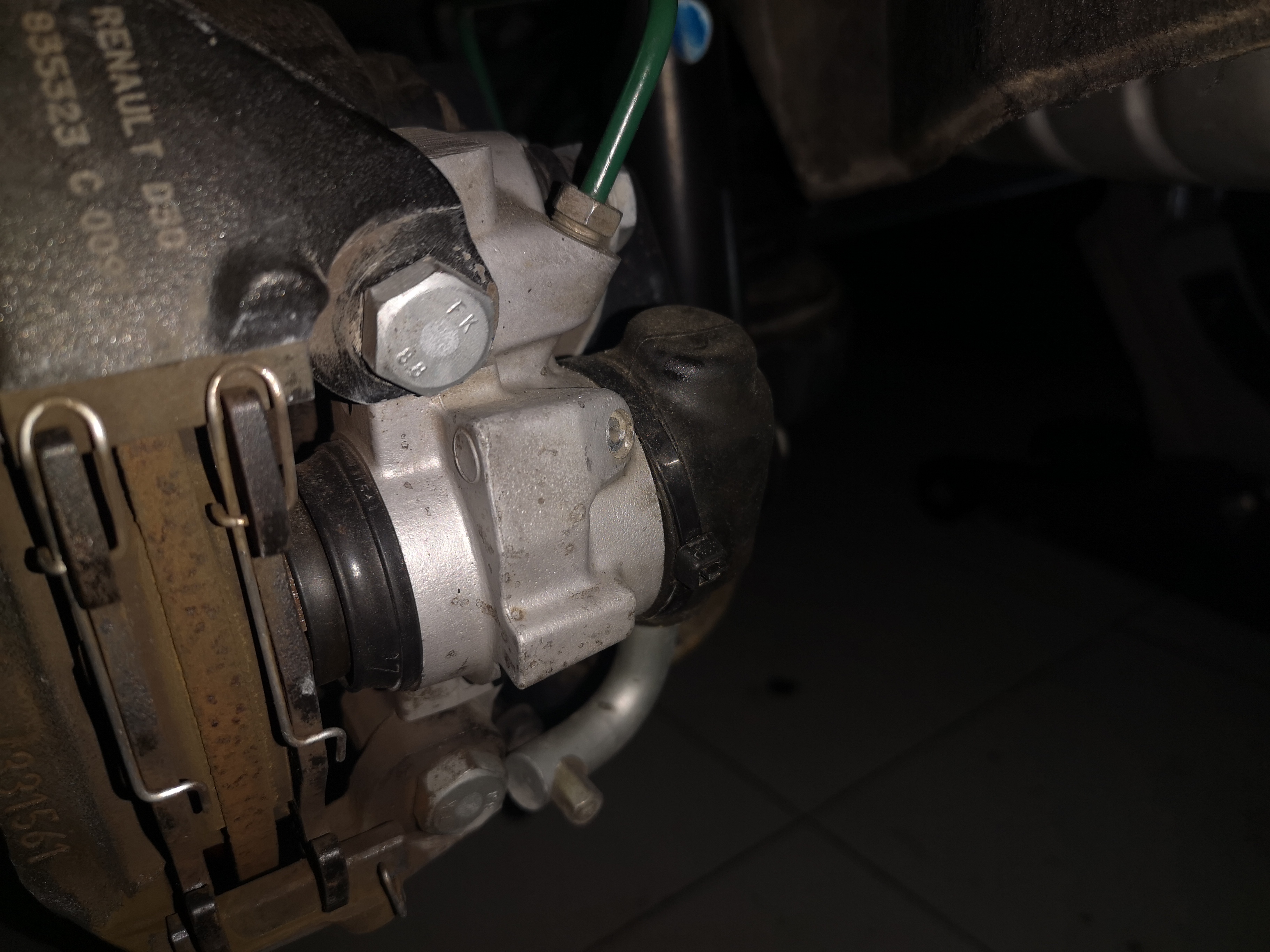

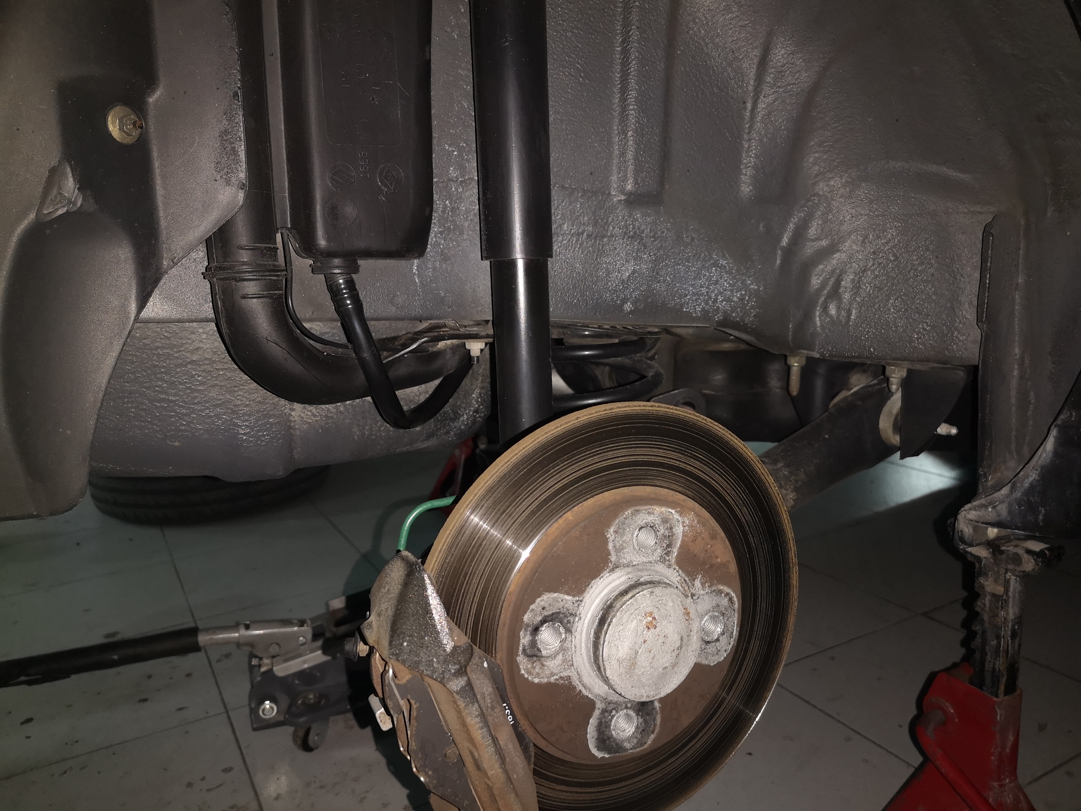

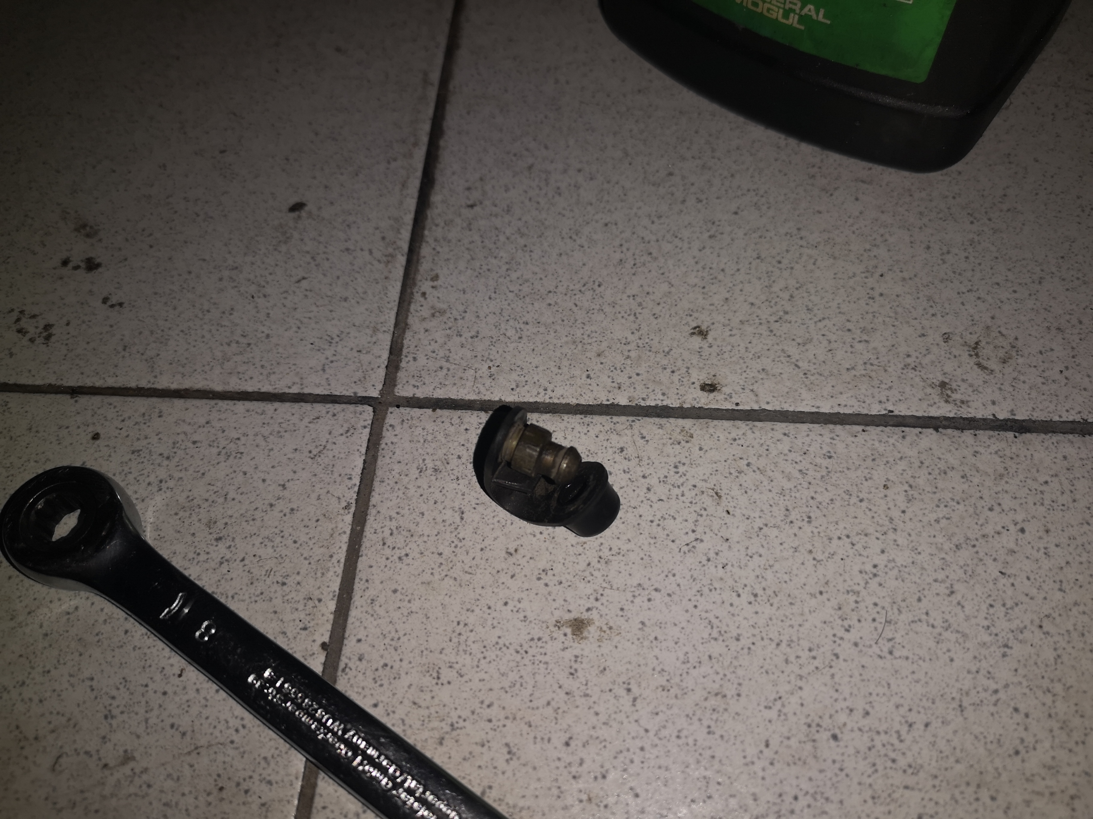

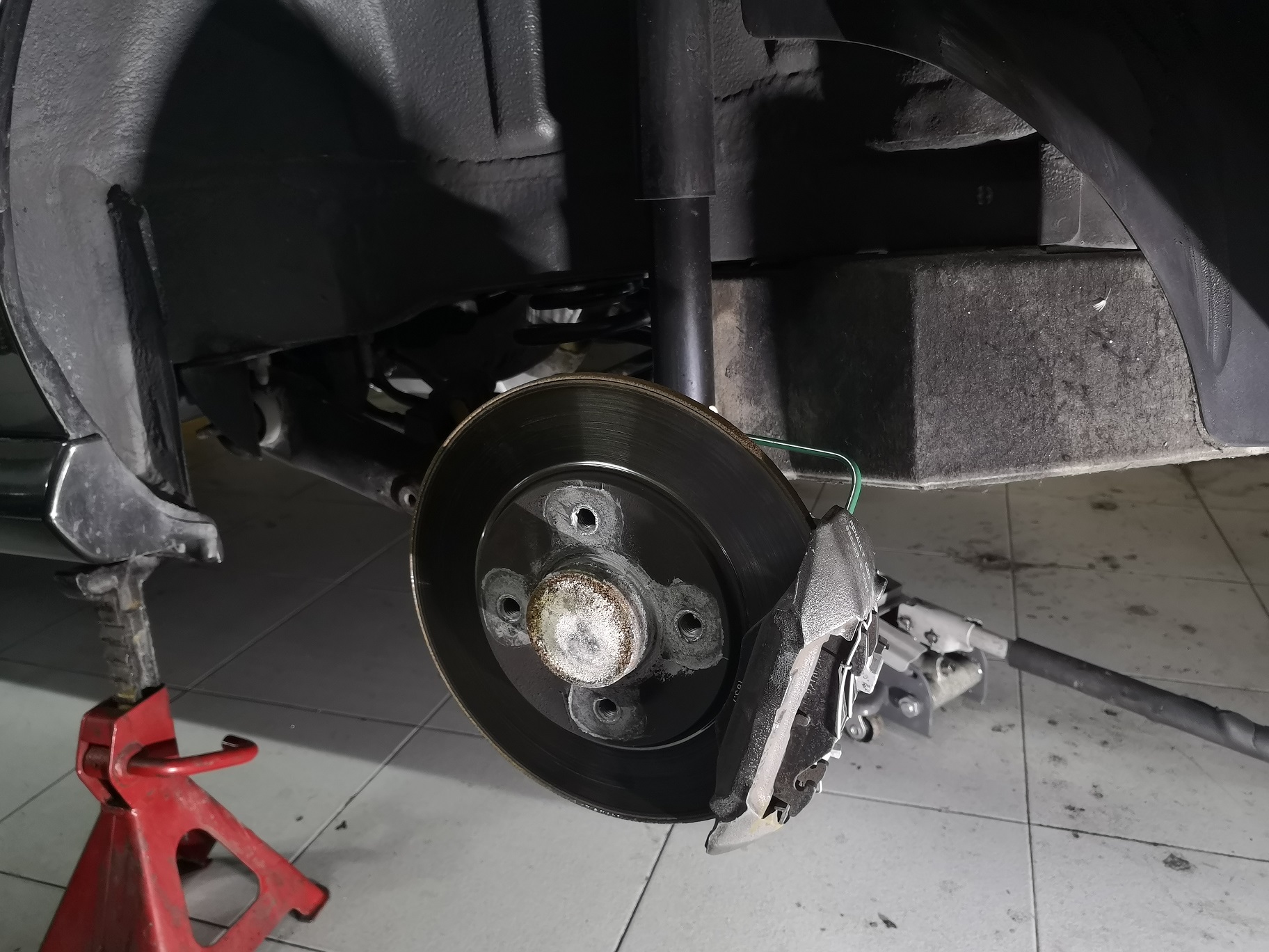

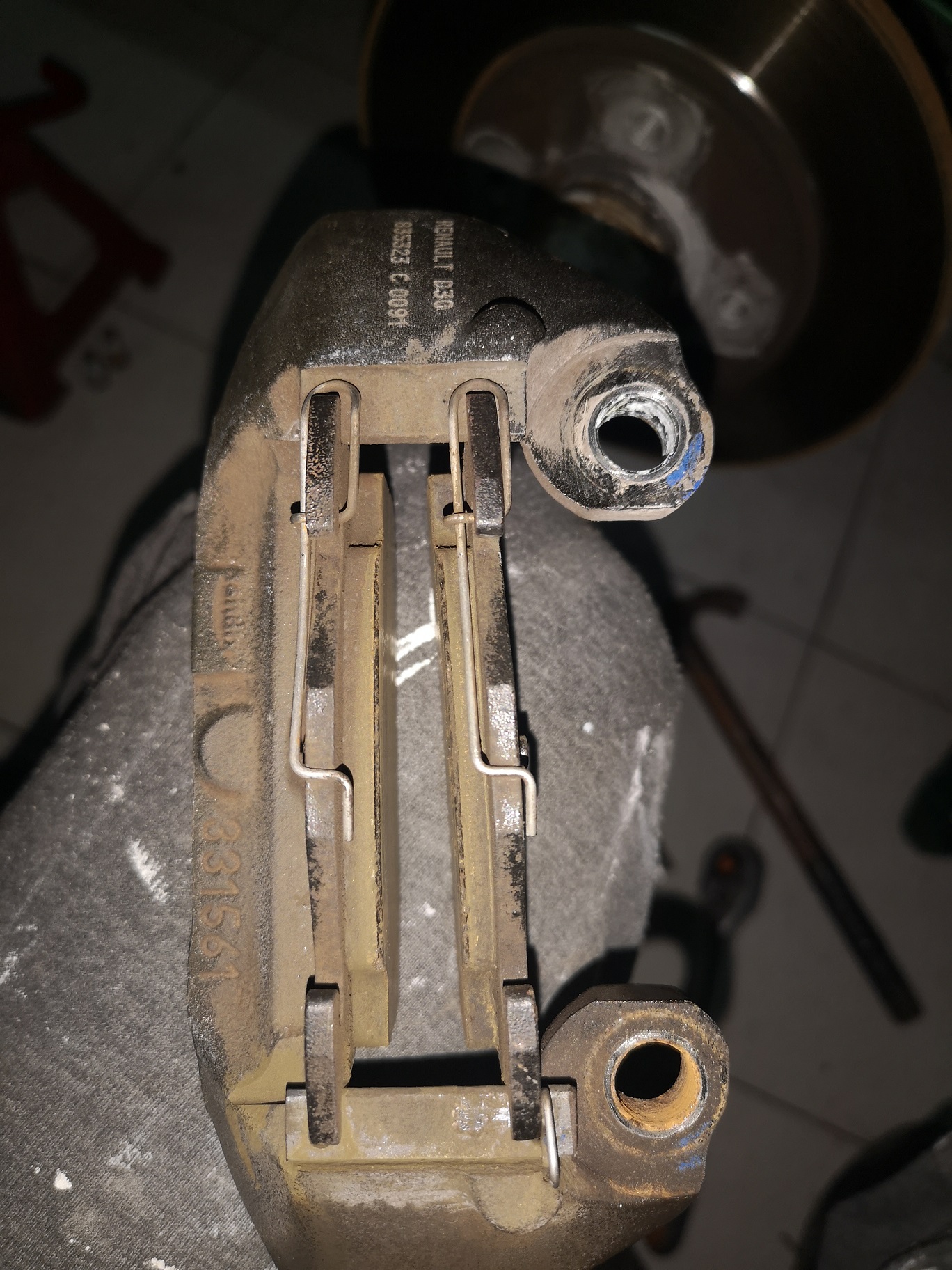

On axle stands and looking at the offending rear caliper :)
The broken bleeder ...

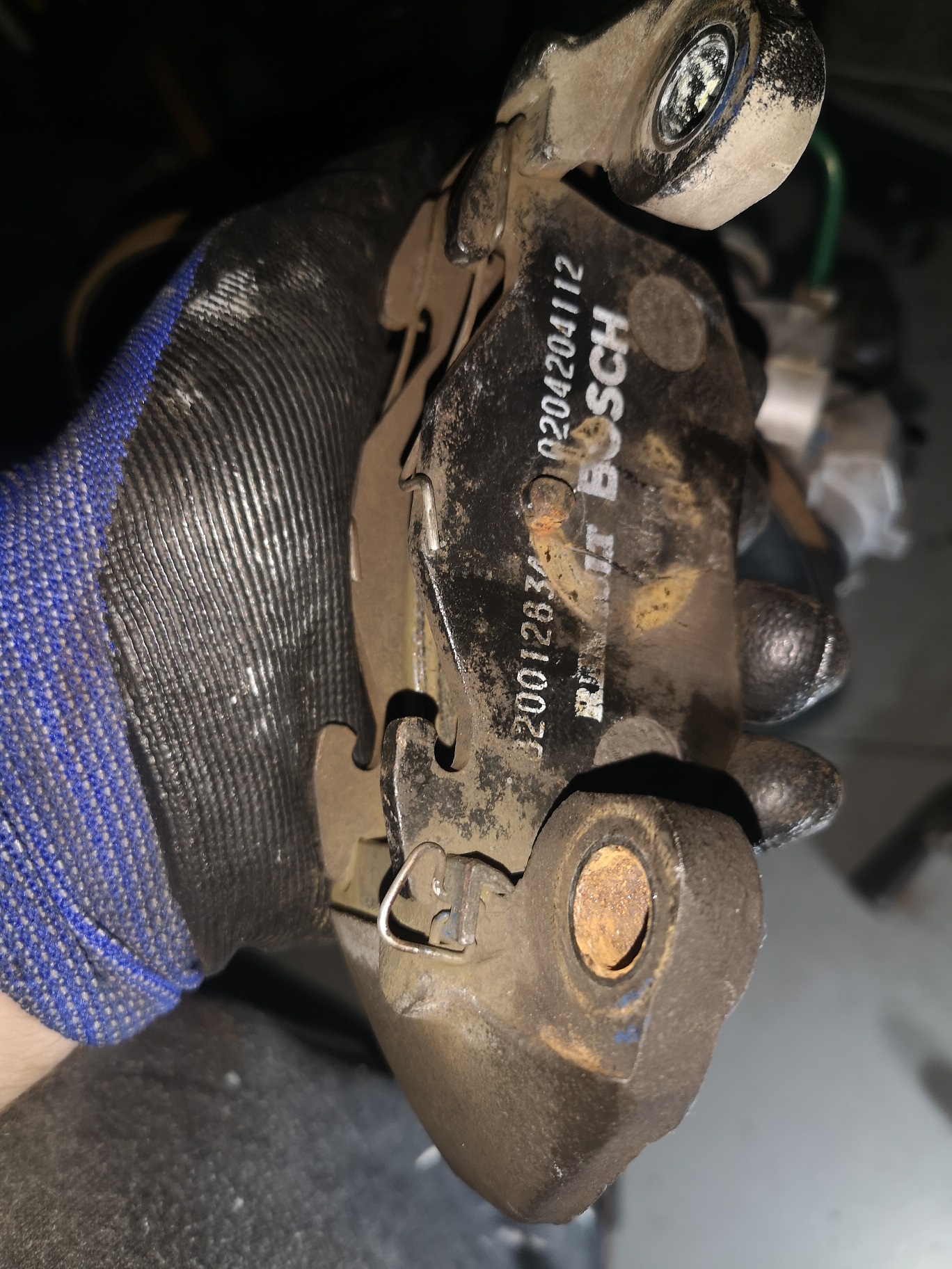

And the caliper bracket with the pads. To be honest i thought they were on the limits but had still plenty of life left on them.
And original too

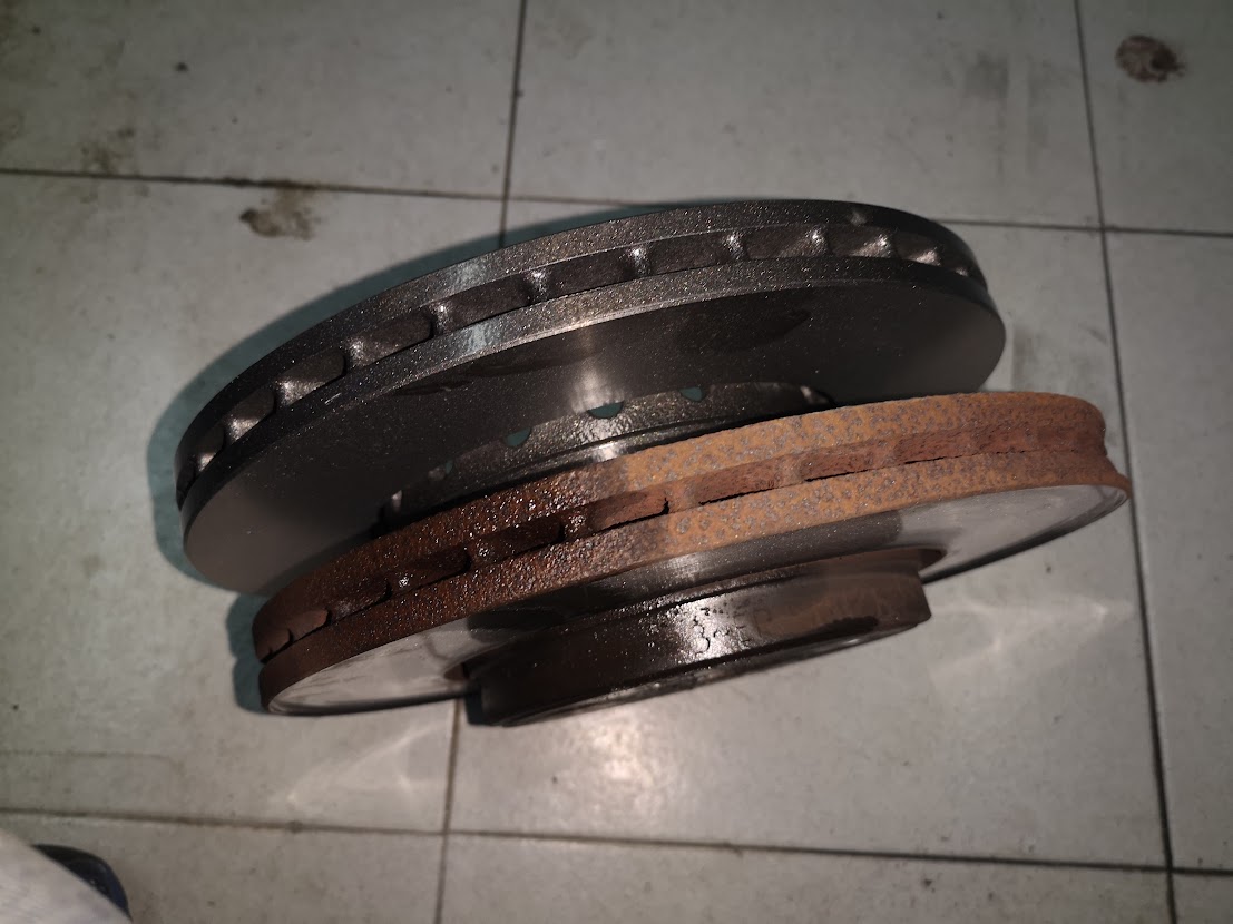

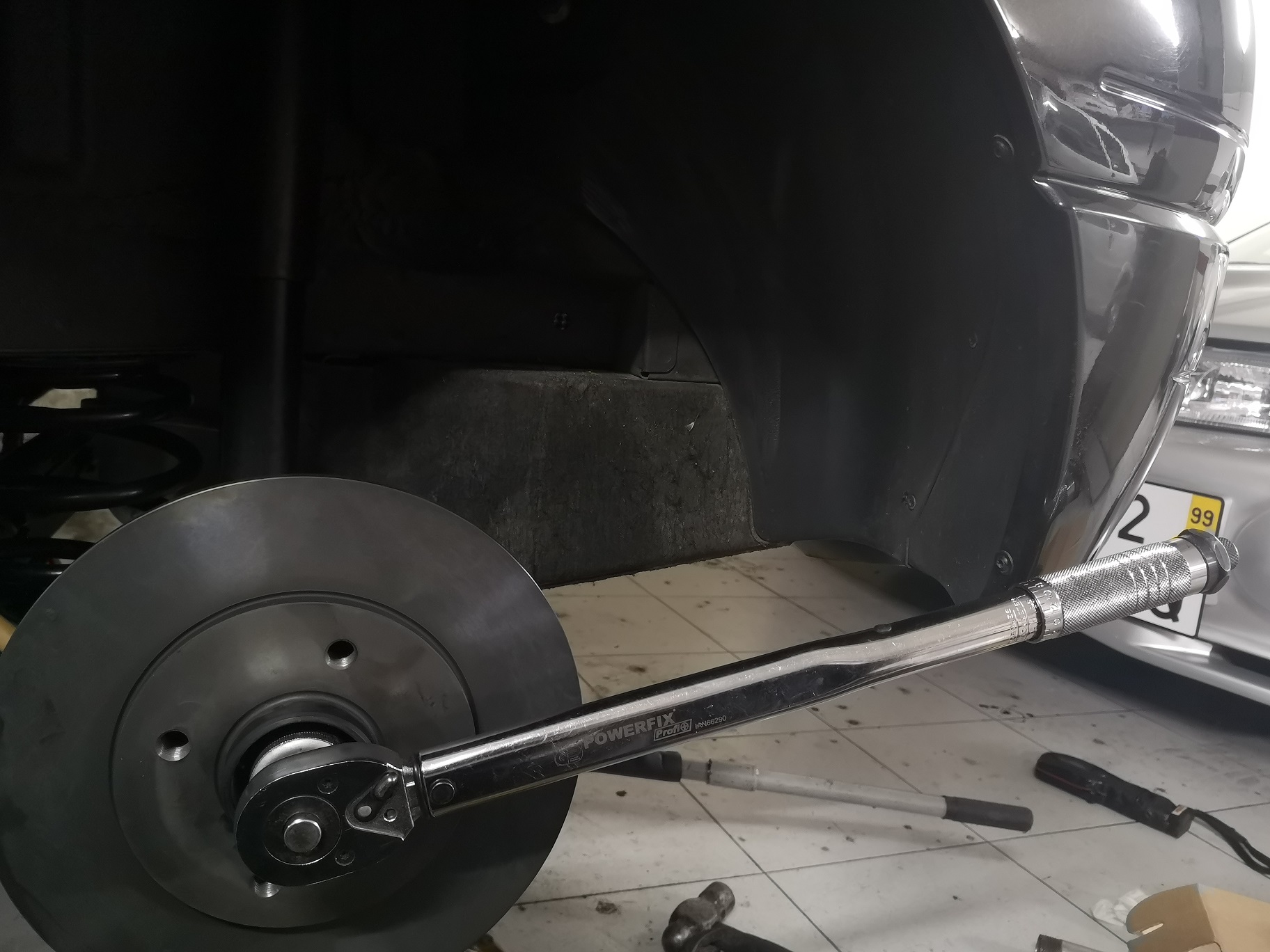

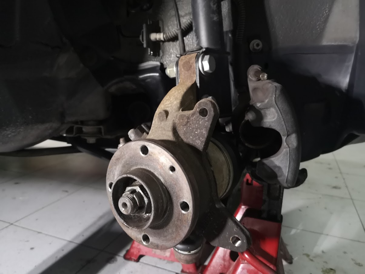

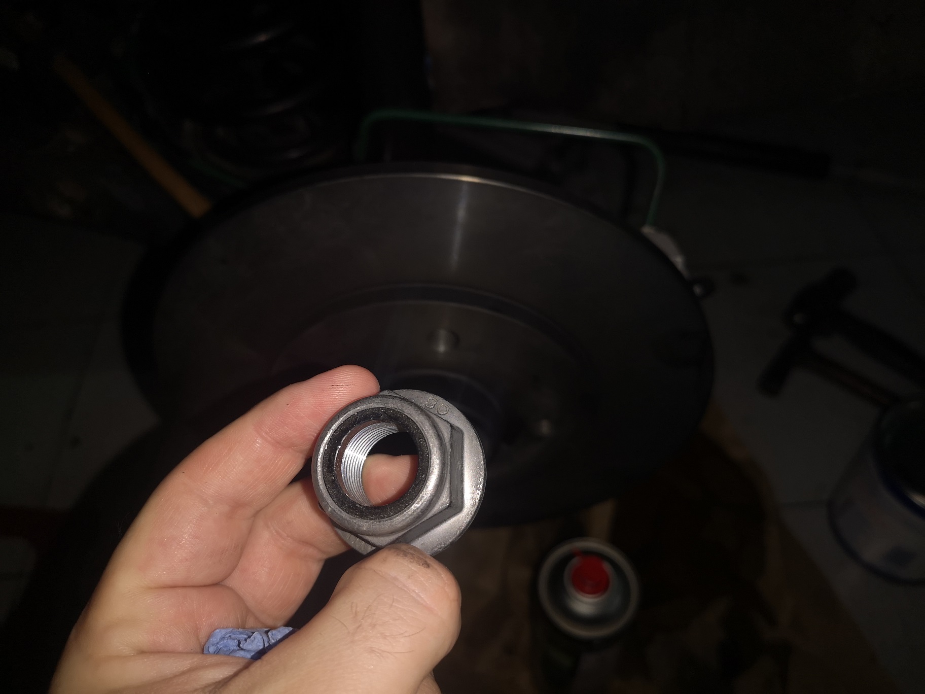

Time to start loosening the 30 axle nut.

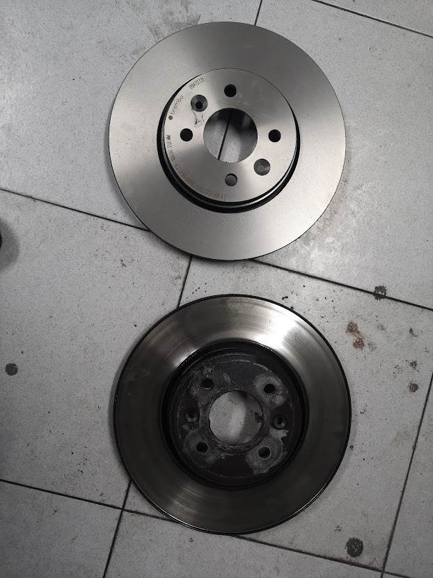

And after that the disc came out without any effort. Was surprised to be honest.
Plenty of dust from the 20 years of road use.
A quick wipe down

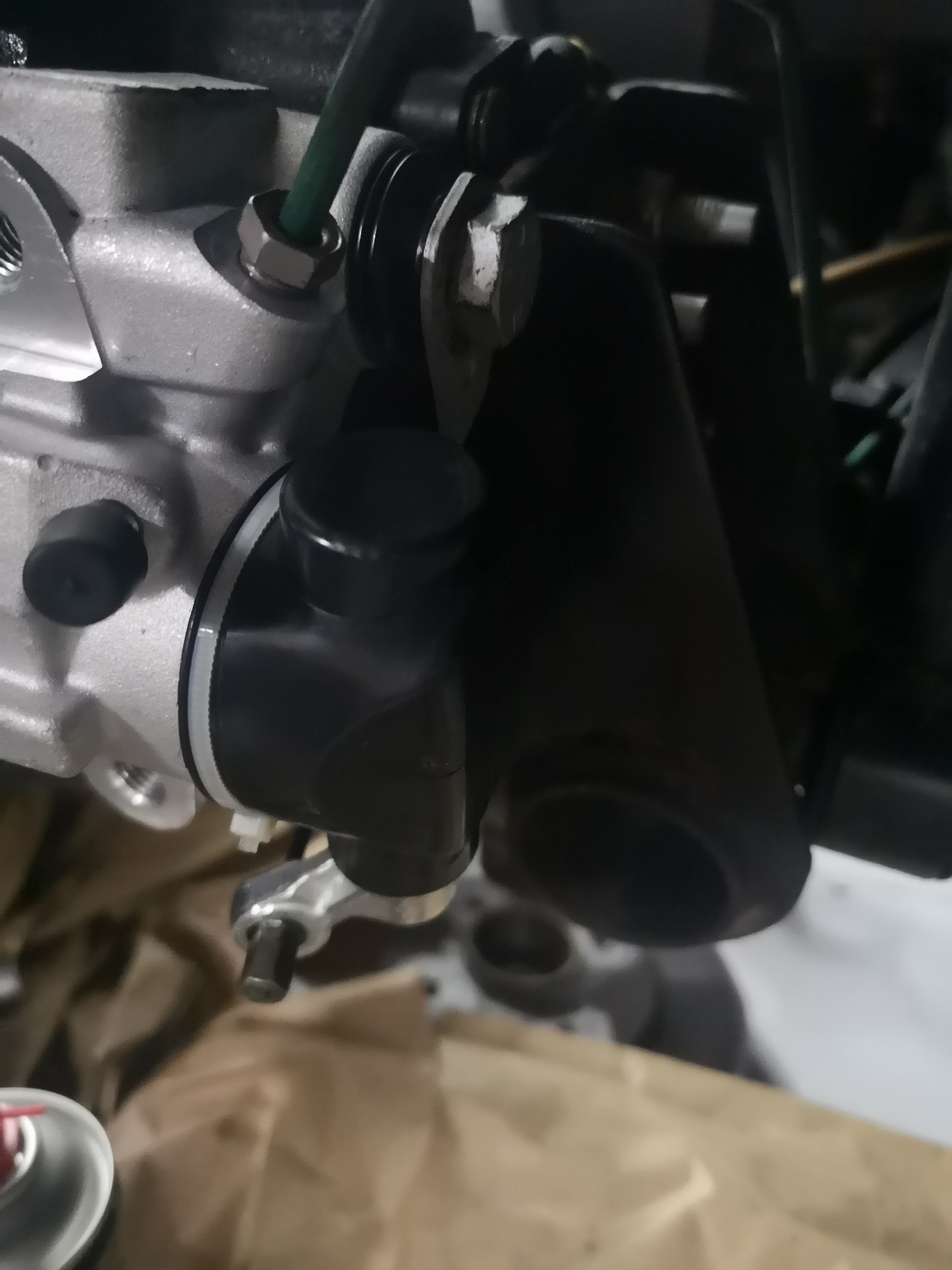

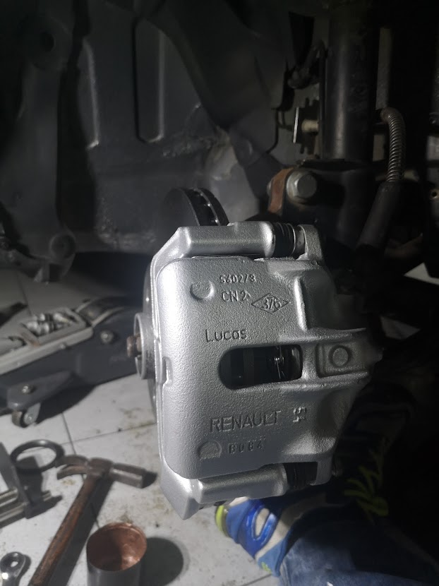

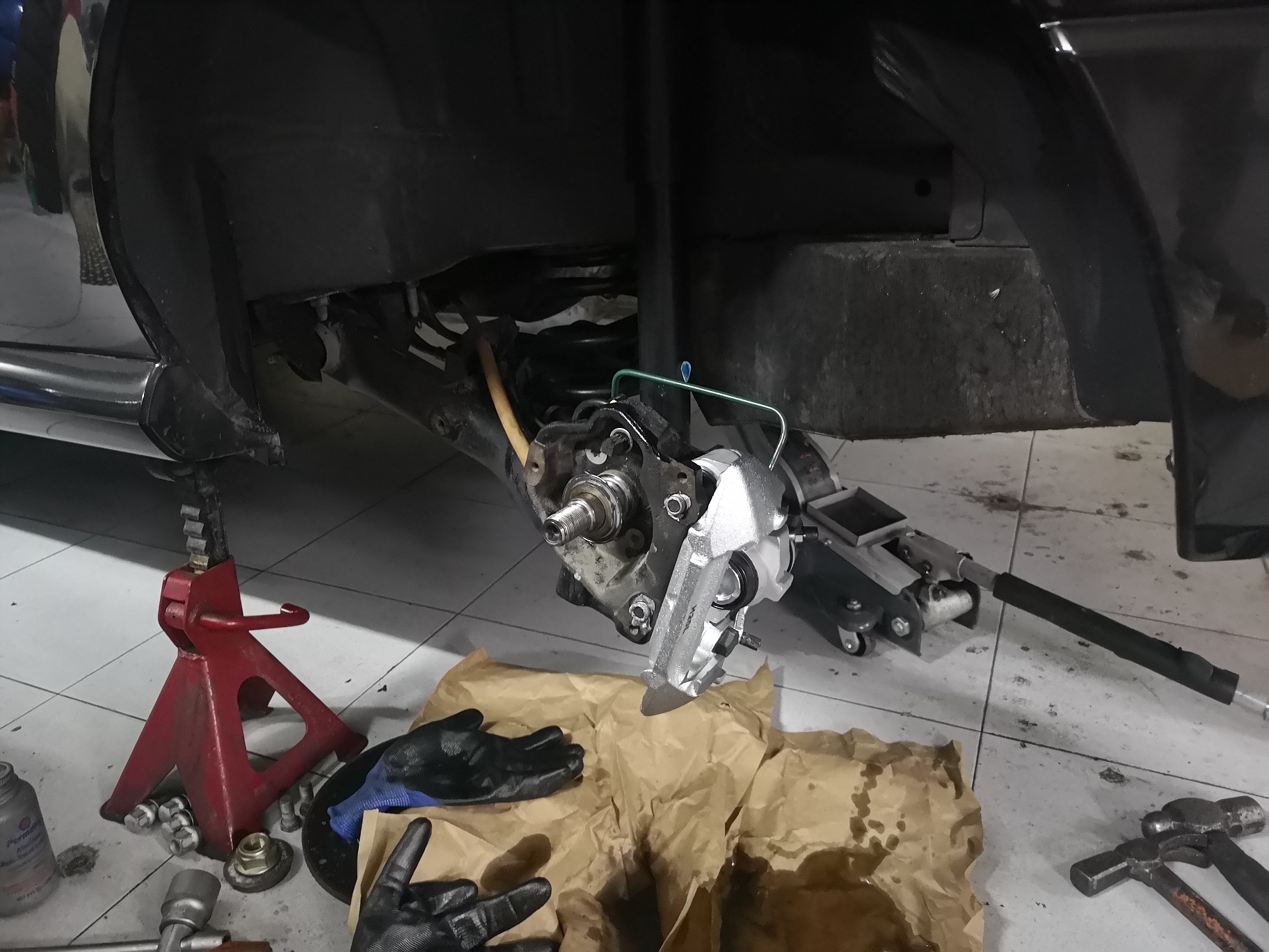

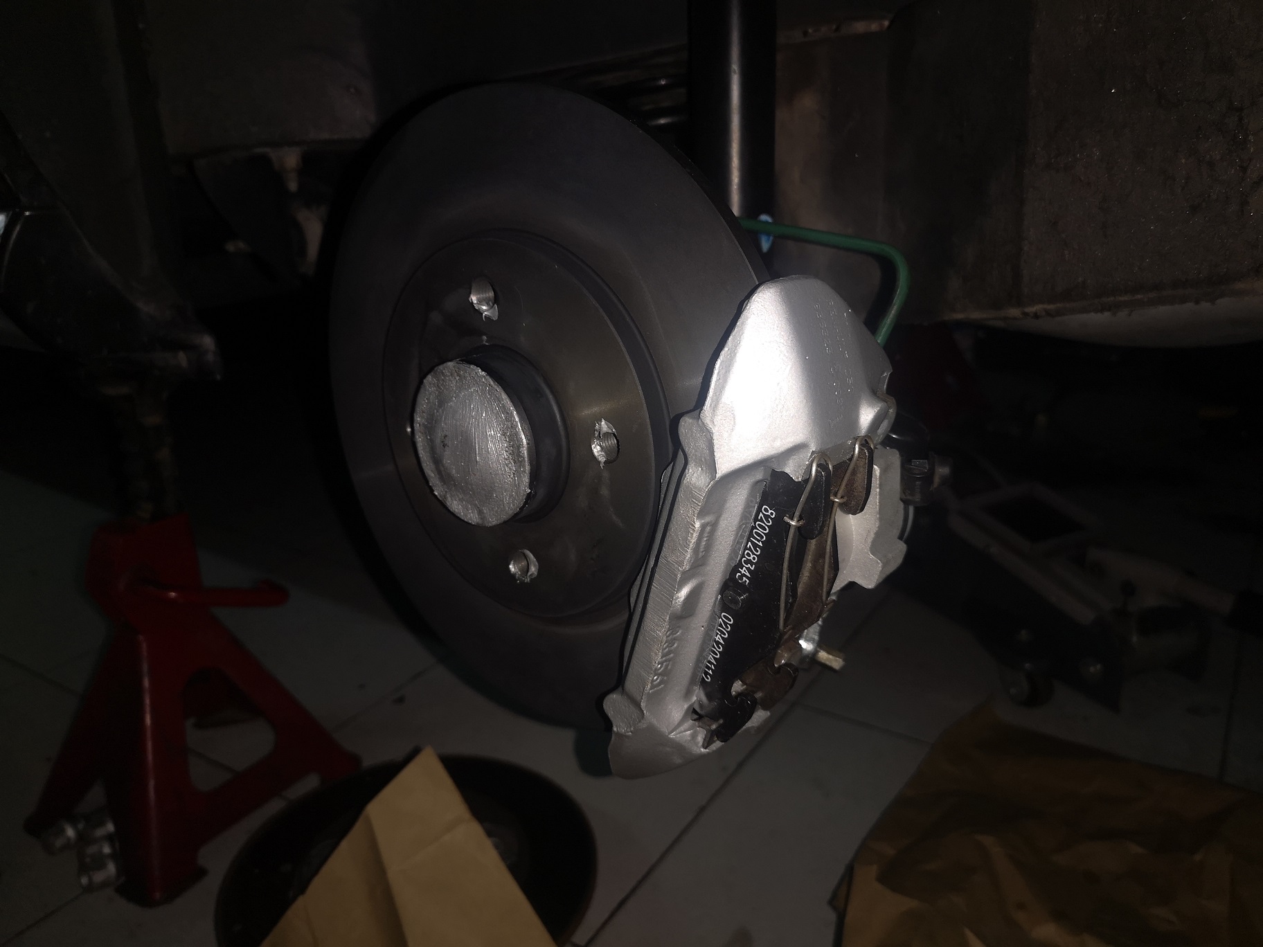

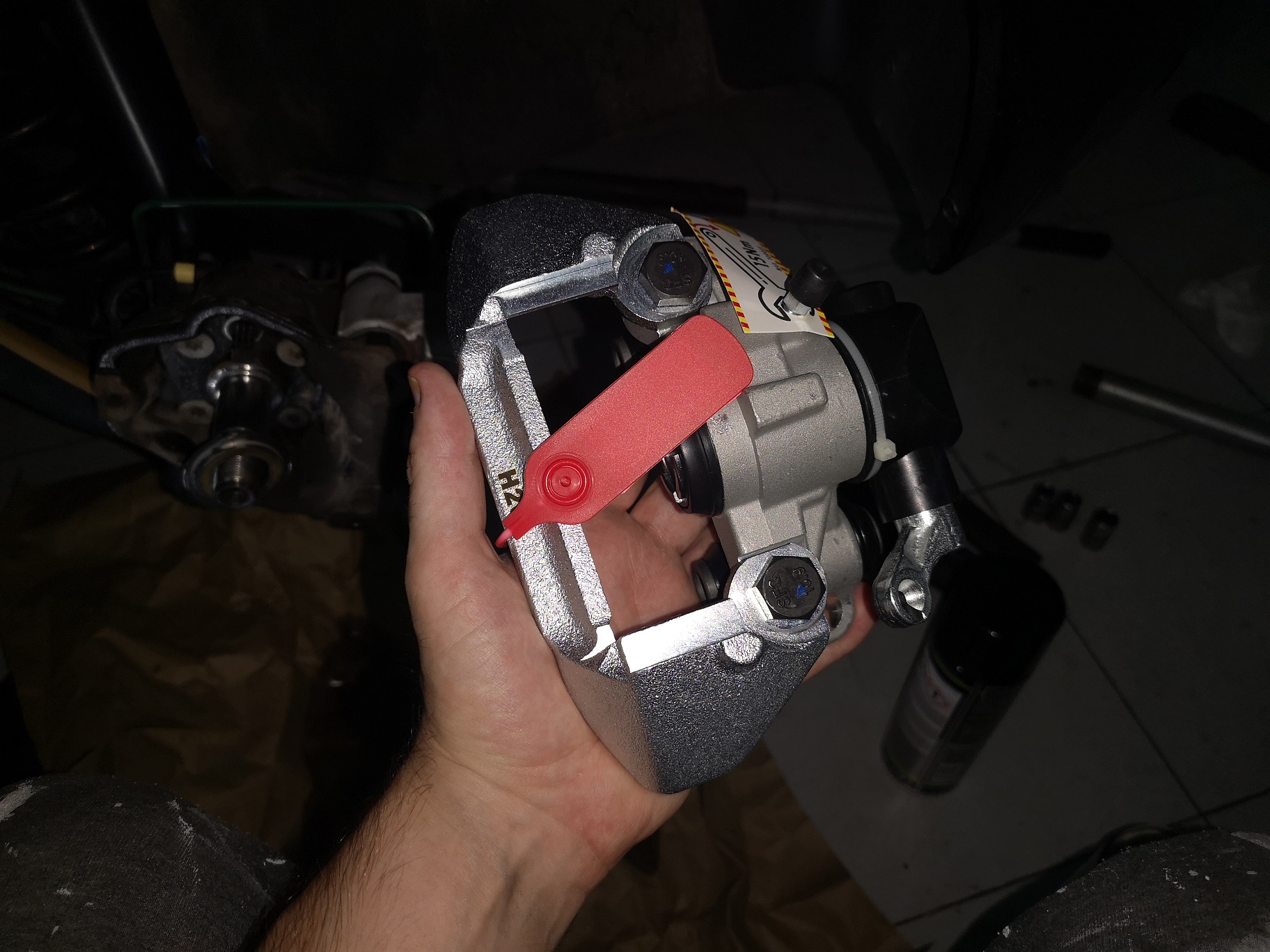

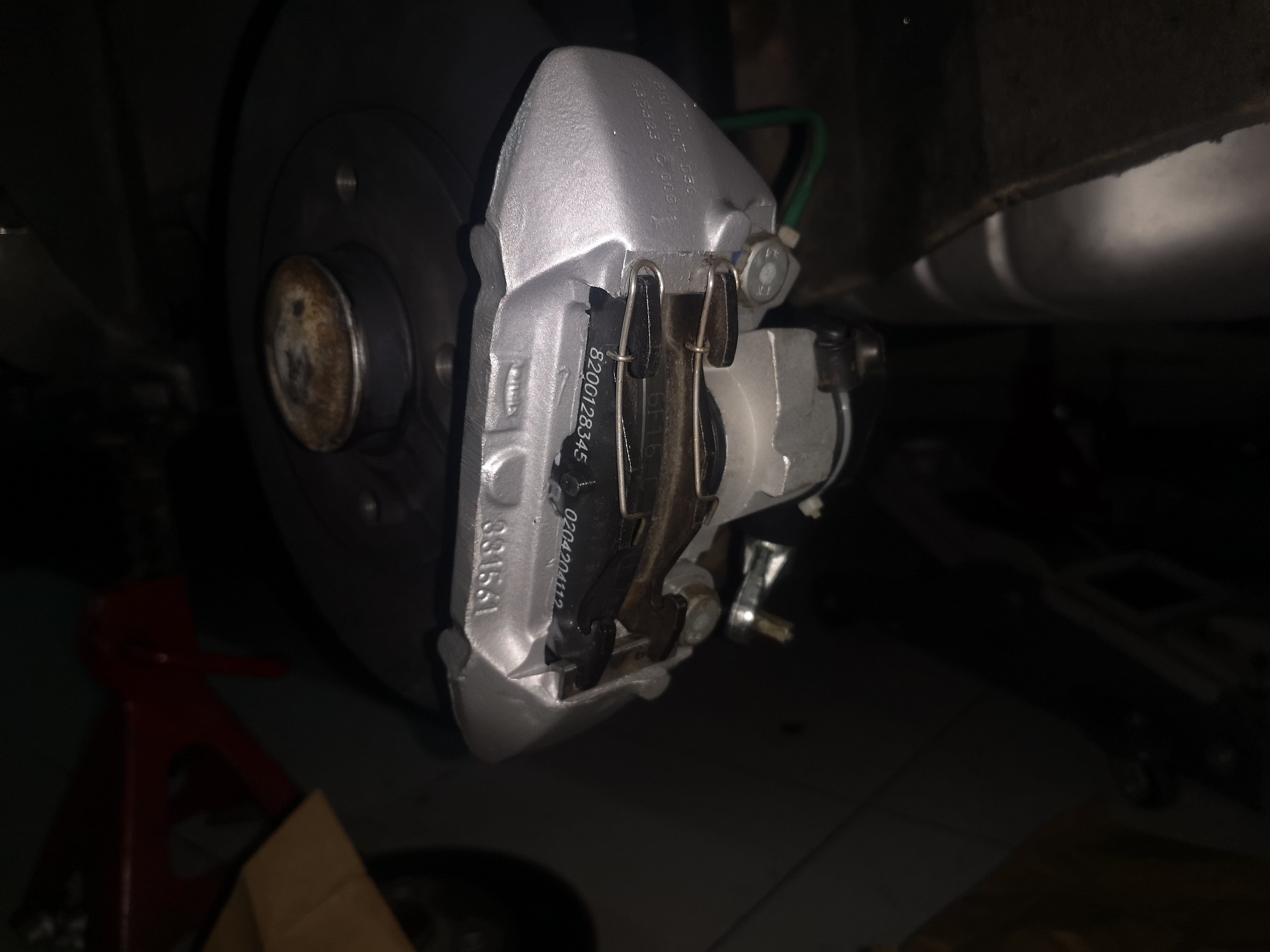

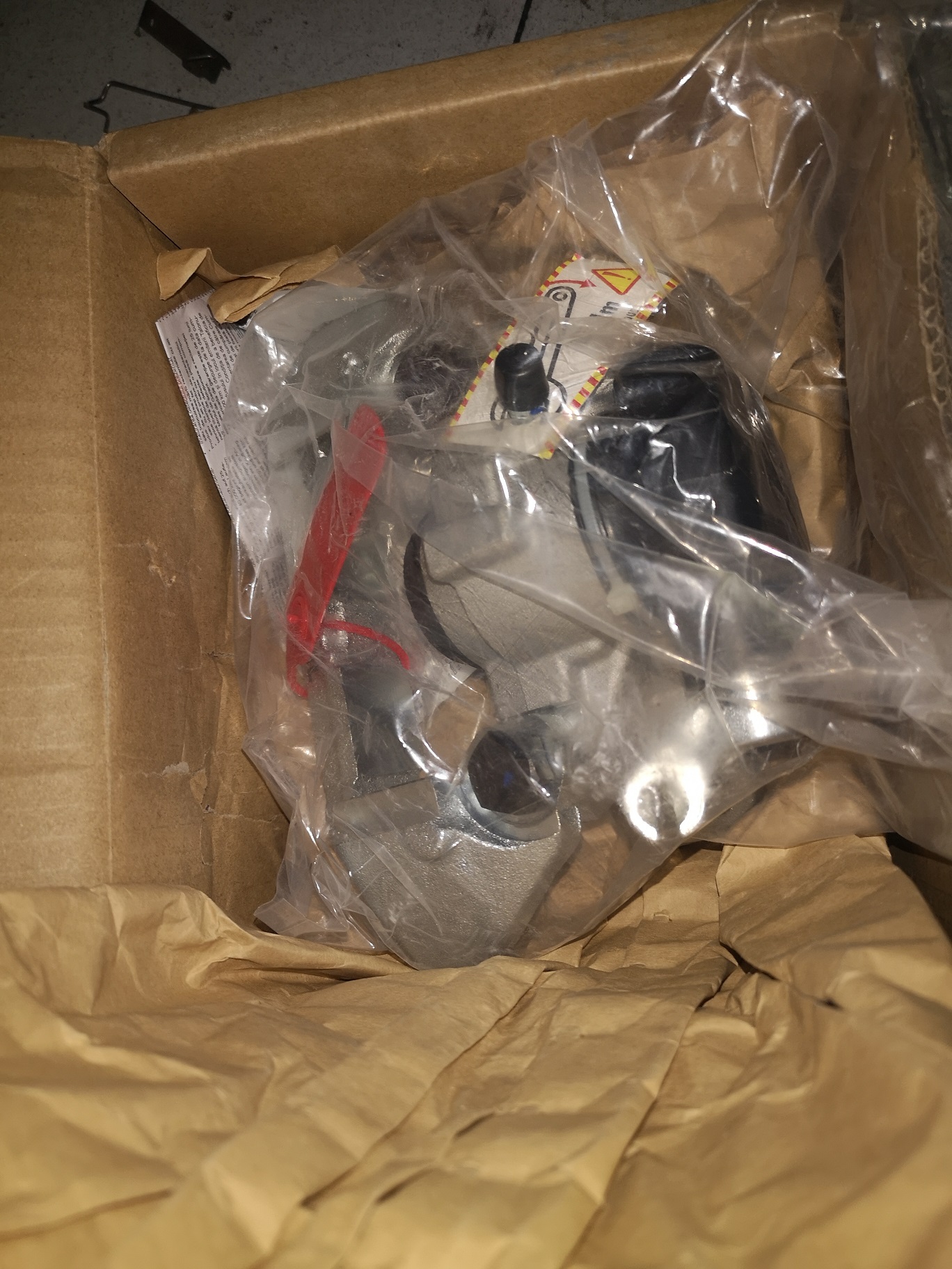

And the new caliper to be installed

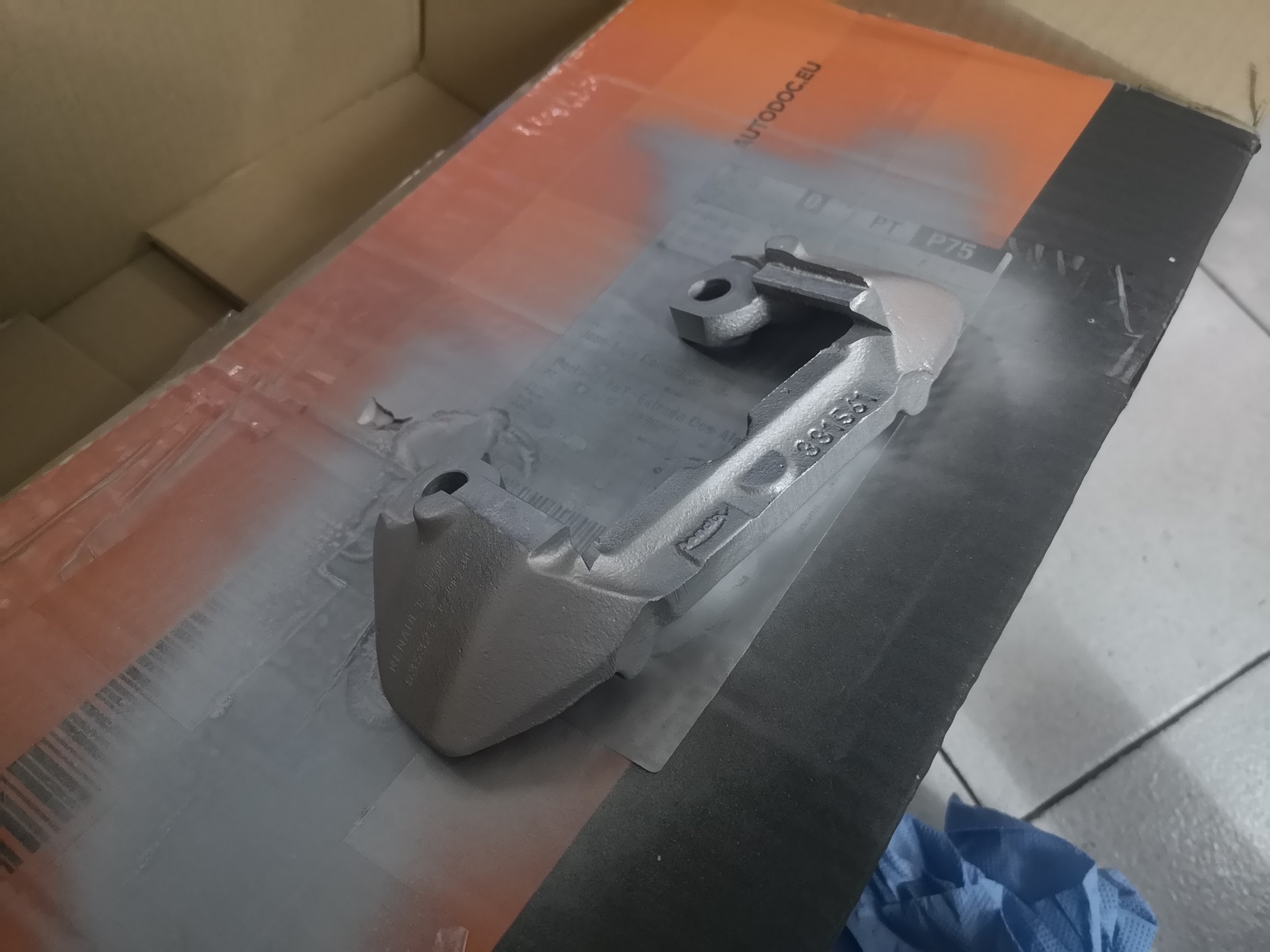

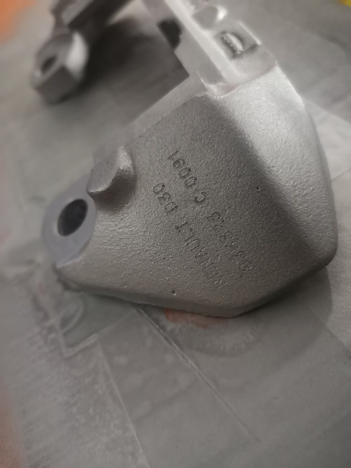

So, with the new caliper in place i did not like the look of the pads bracket. So decided to use the old one and paint them with high temperature silver paint.
The old pads bracket receiving some paint.

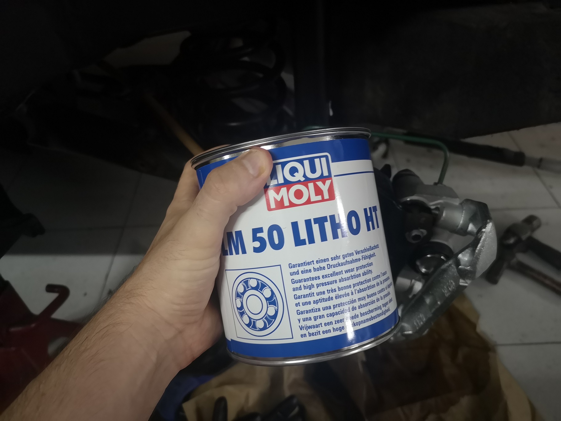

Time to lub the axle
New caliper in place and caliper bolts torqued to 60nm.

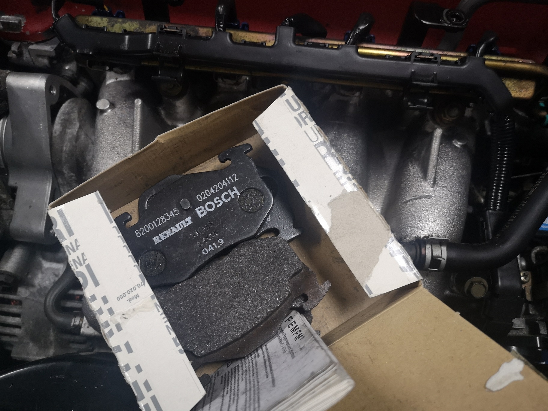

And rear pads
And yes, that´s a k20. But not for the Clio :D.

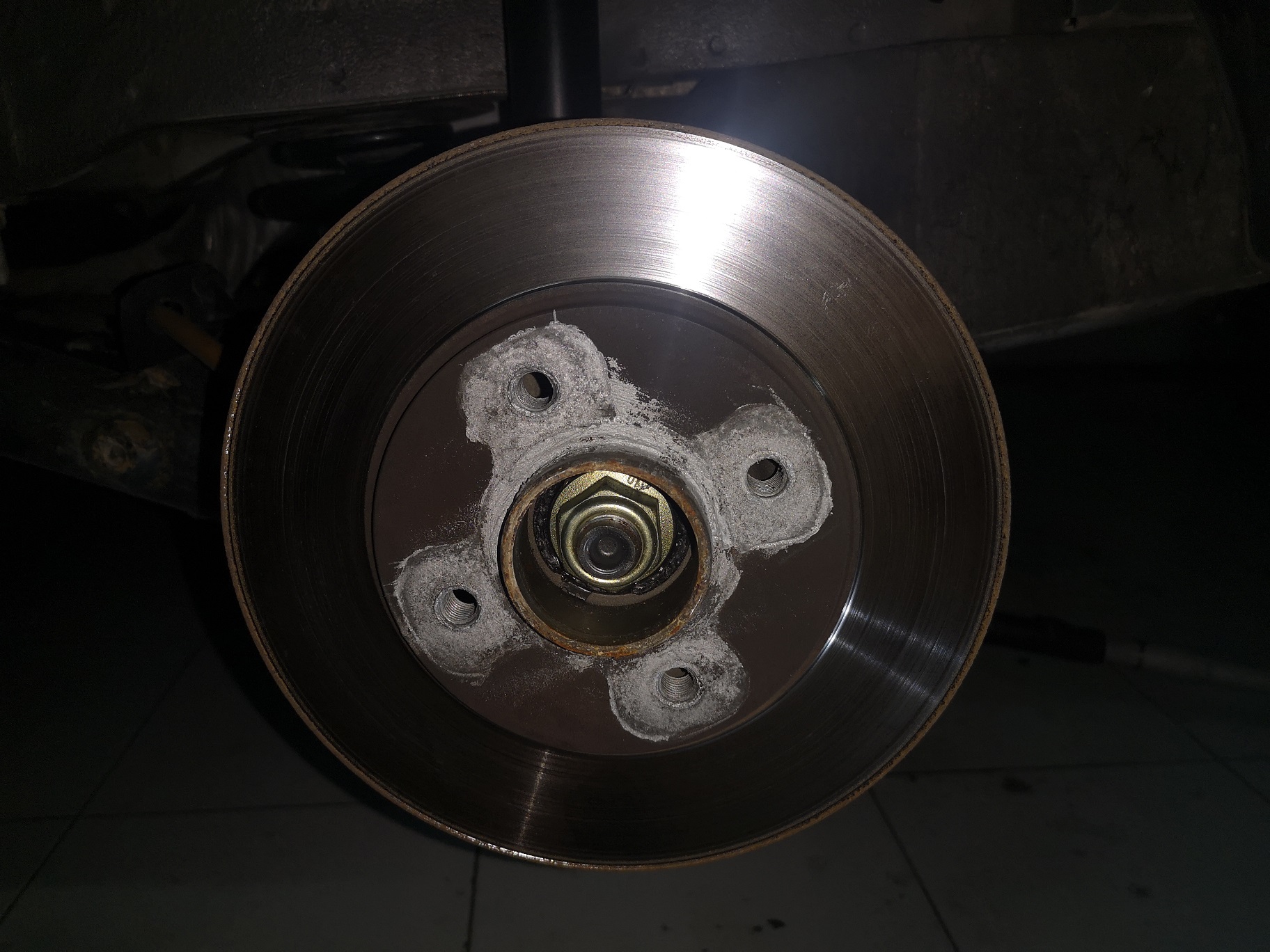

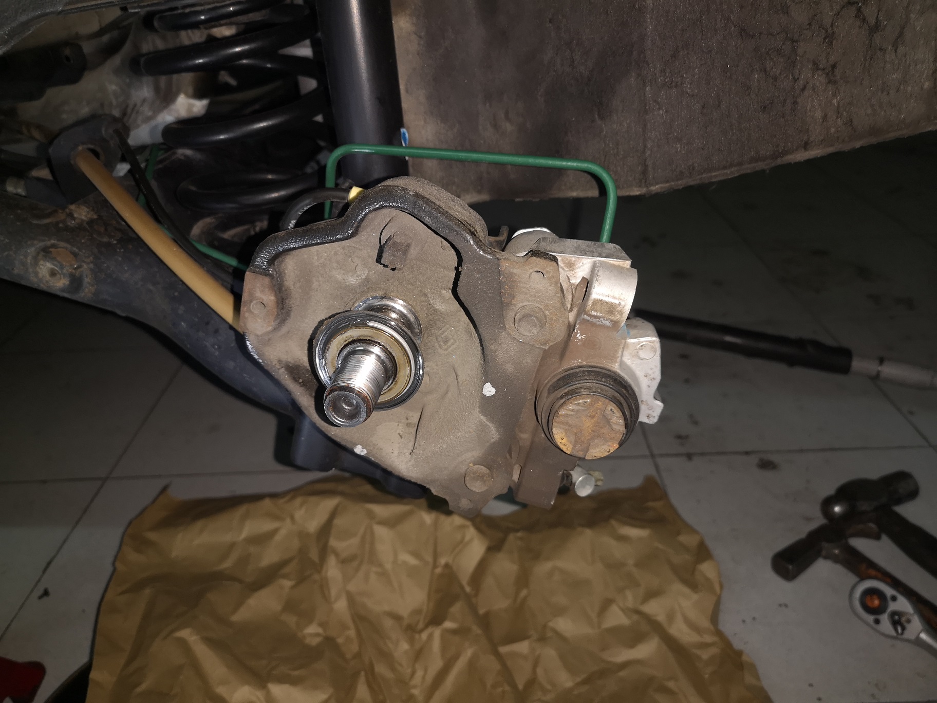

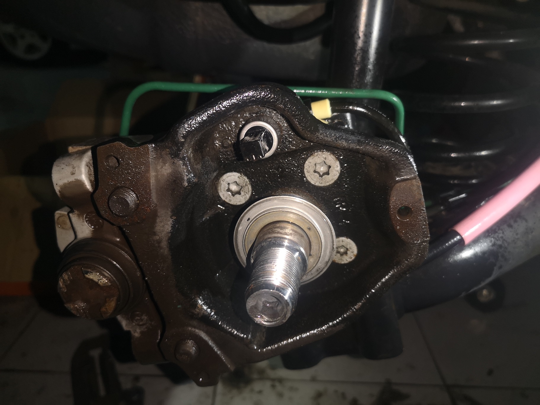

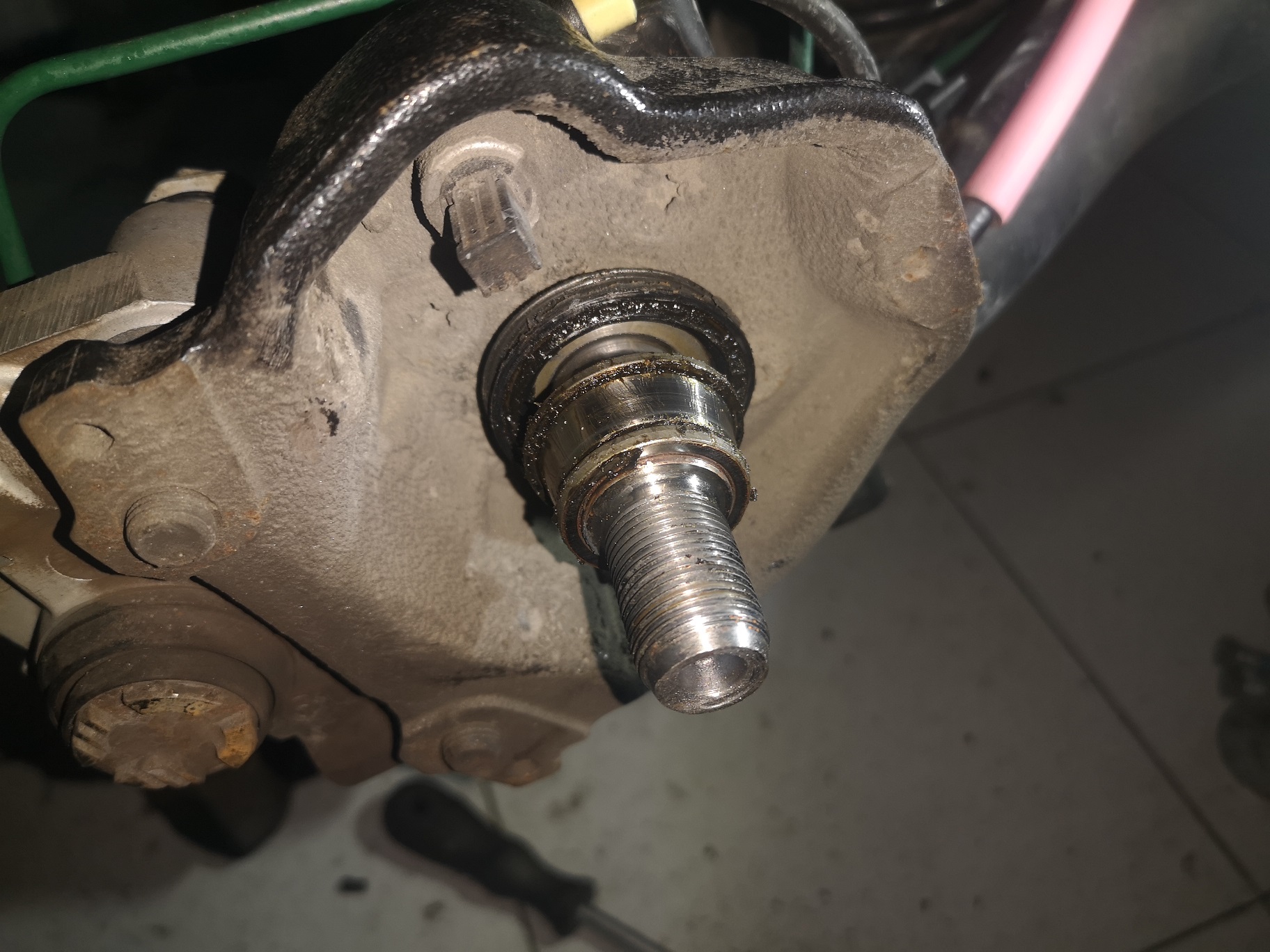

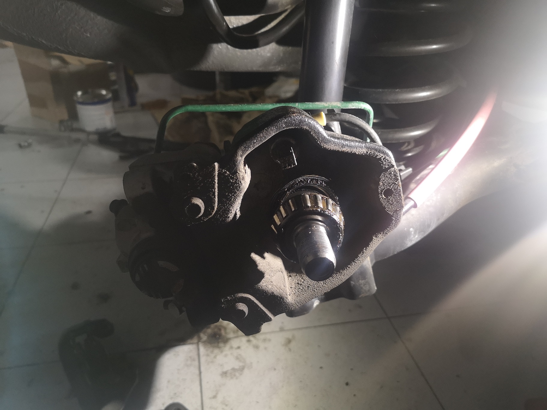

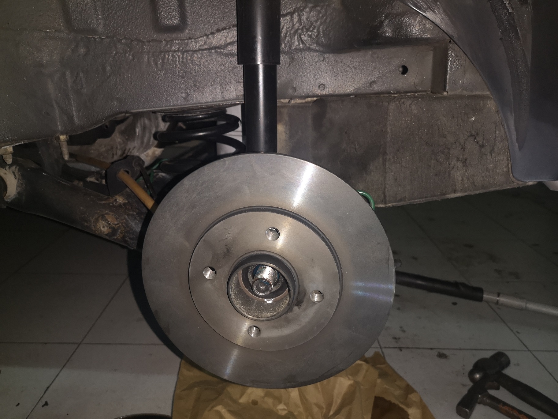

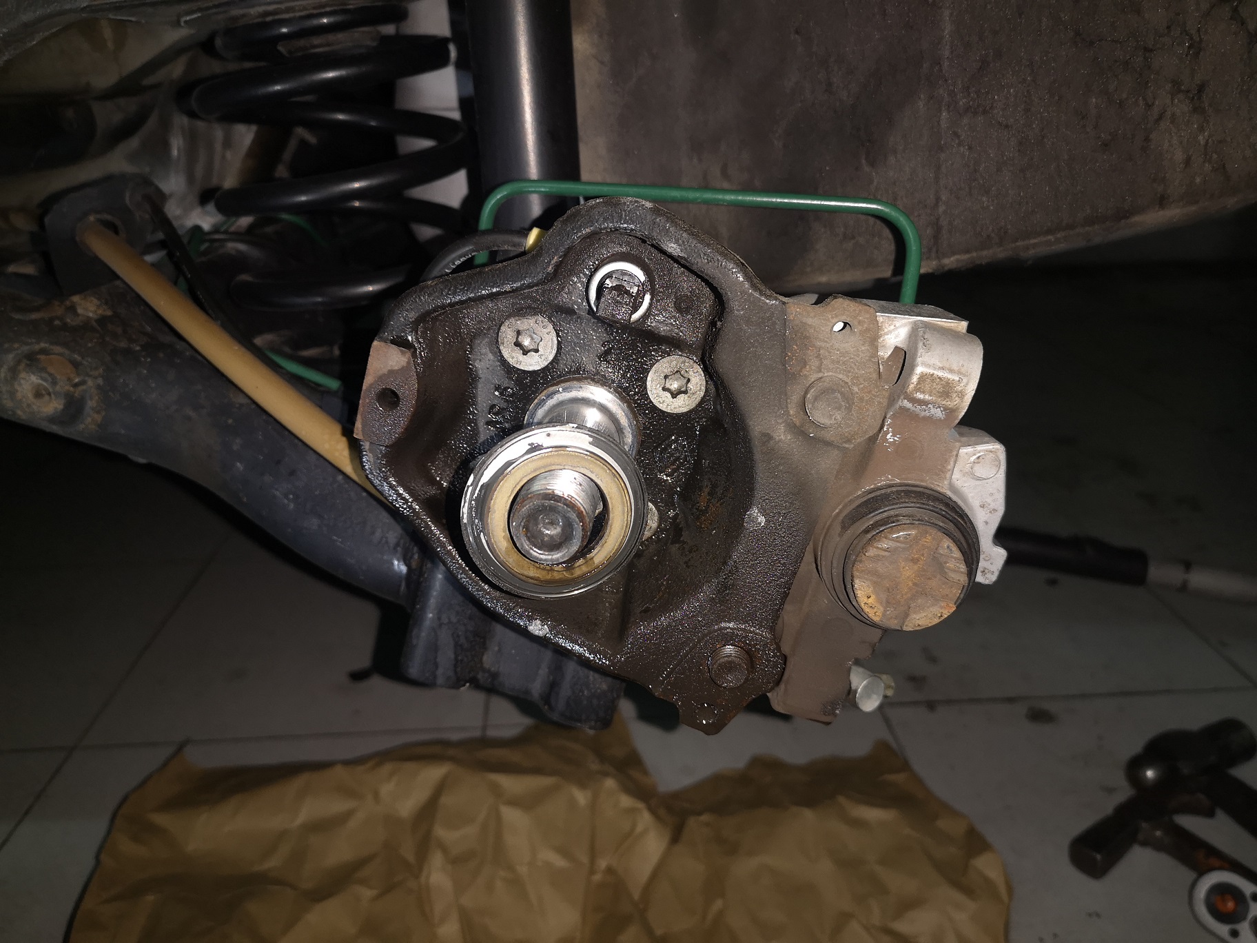

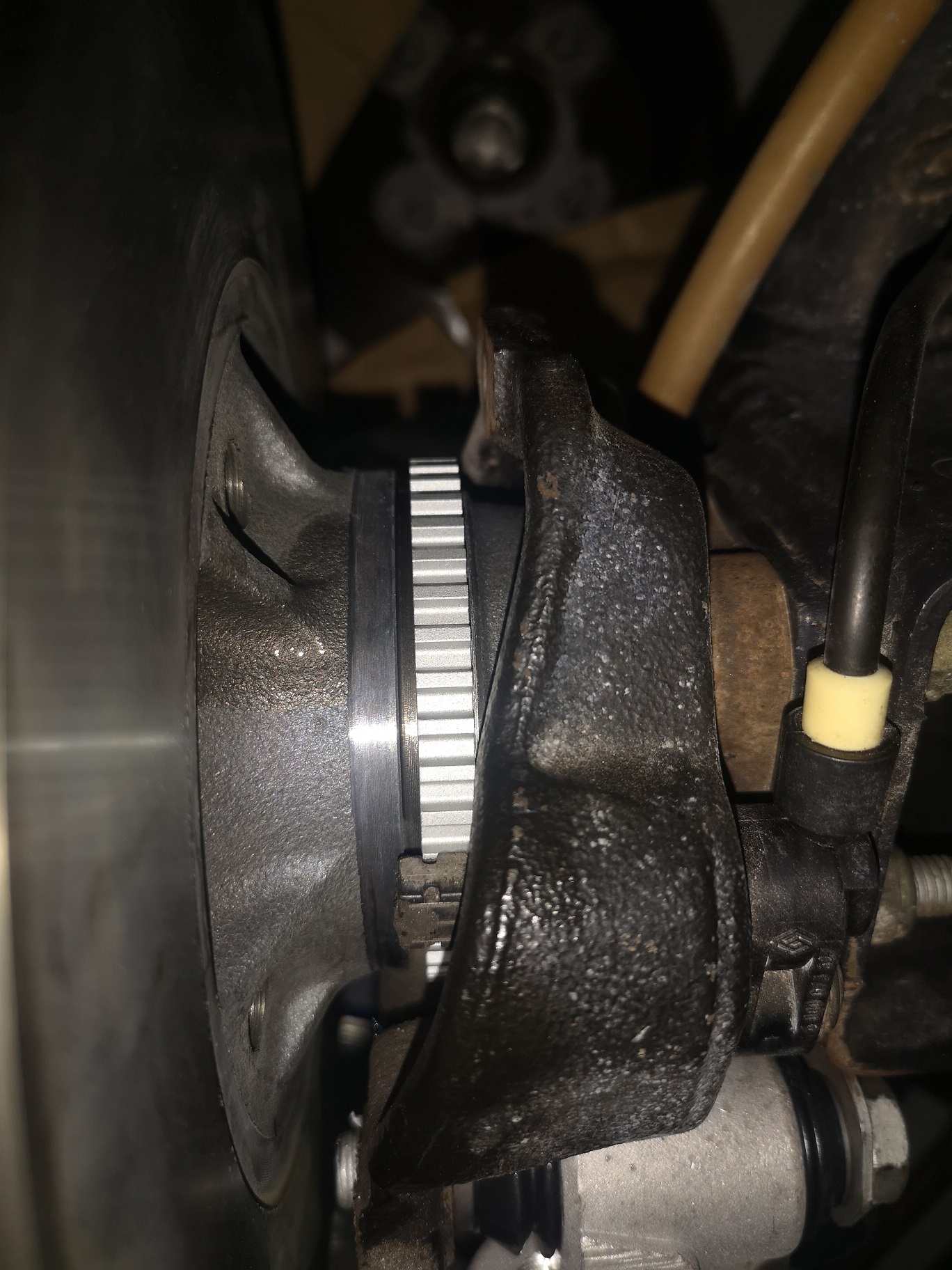

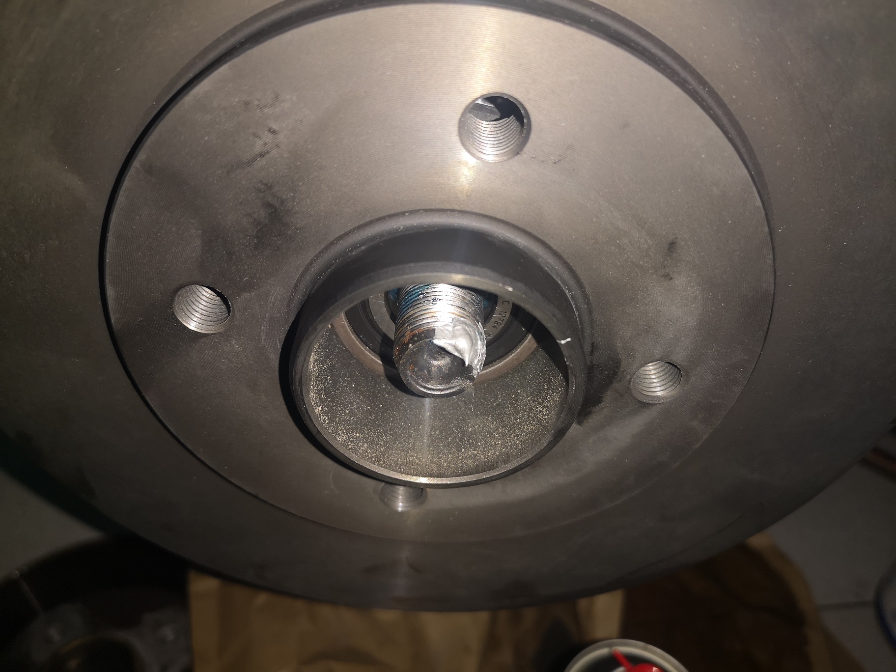

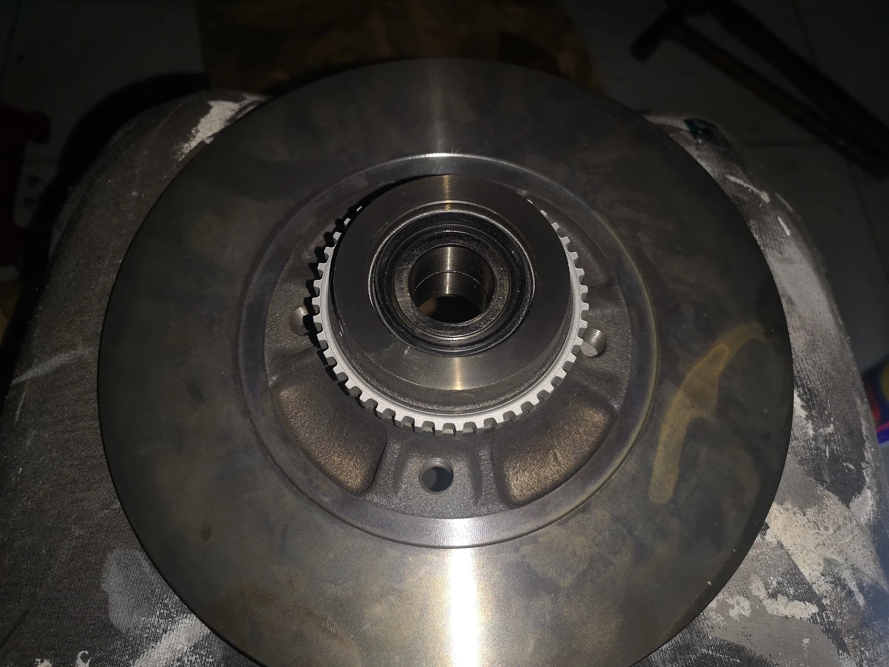

Since the pads brackets were curing i decided to remove the disc from the passenger side (Uk driver side), should be peace of cake right? Wrong.

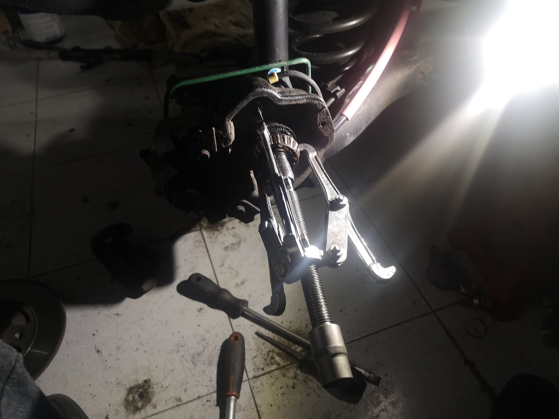

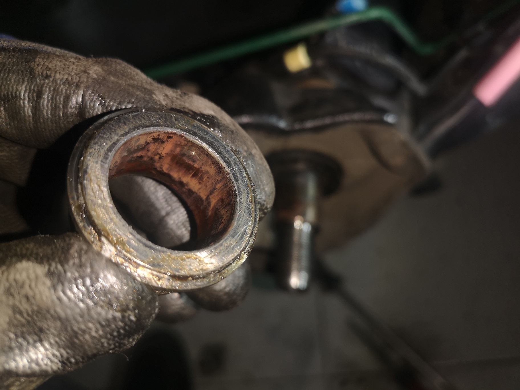

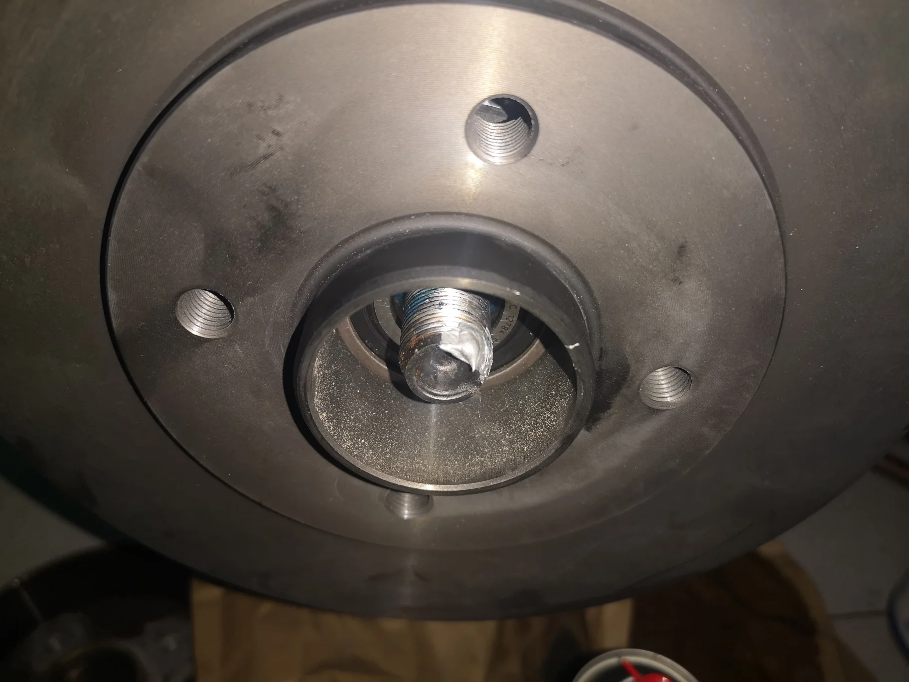

The disc refused to come off even with a giant hammer. Had to use a extractor to remove it for the hub. And removing the disc...the bearing was stuck on the axle.
I won´t get defeated by a french bearing :D

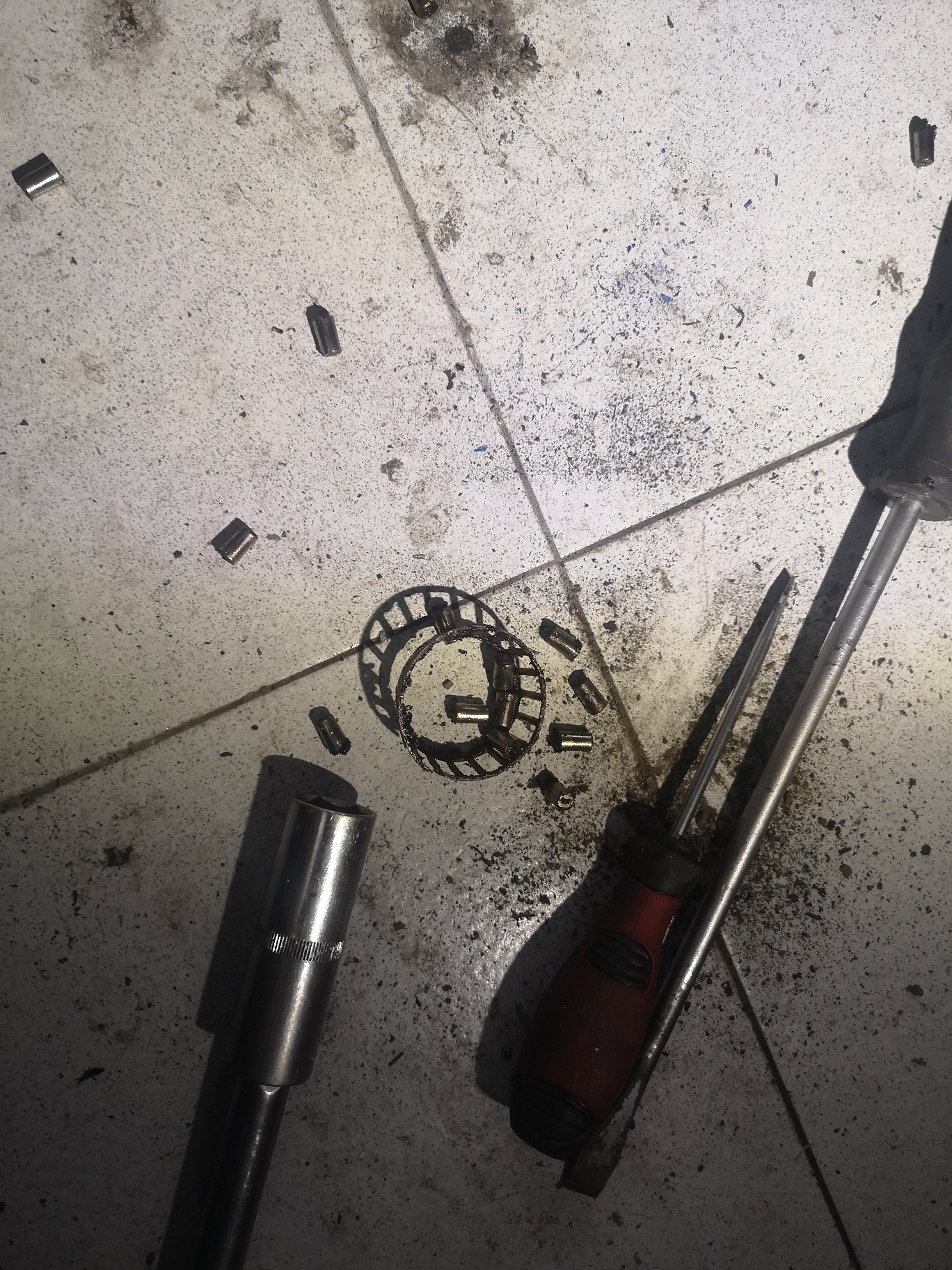

And the bearing exploded.

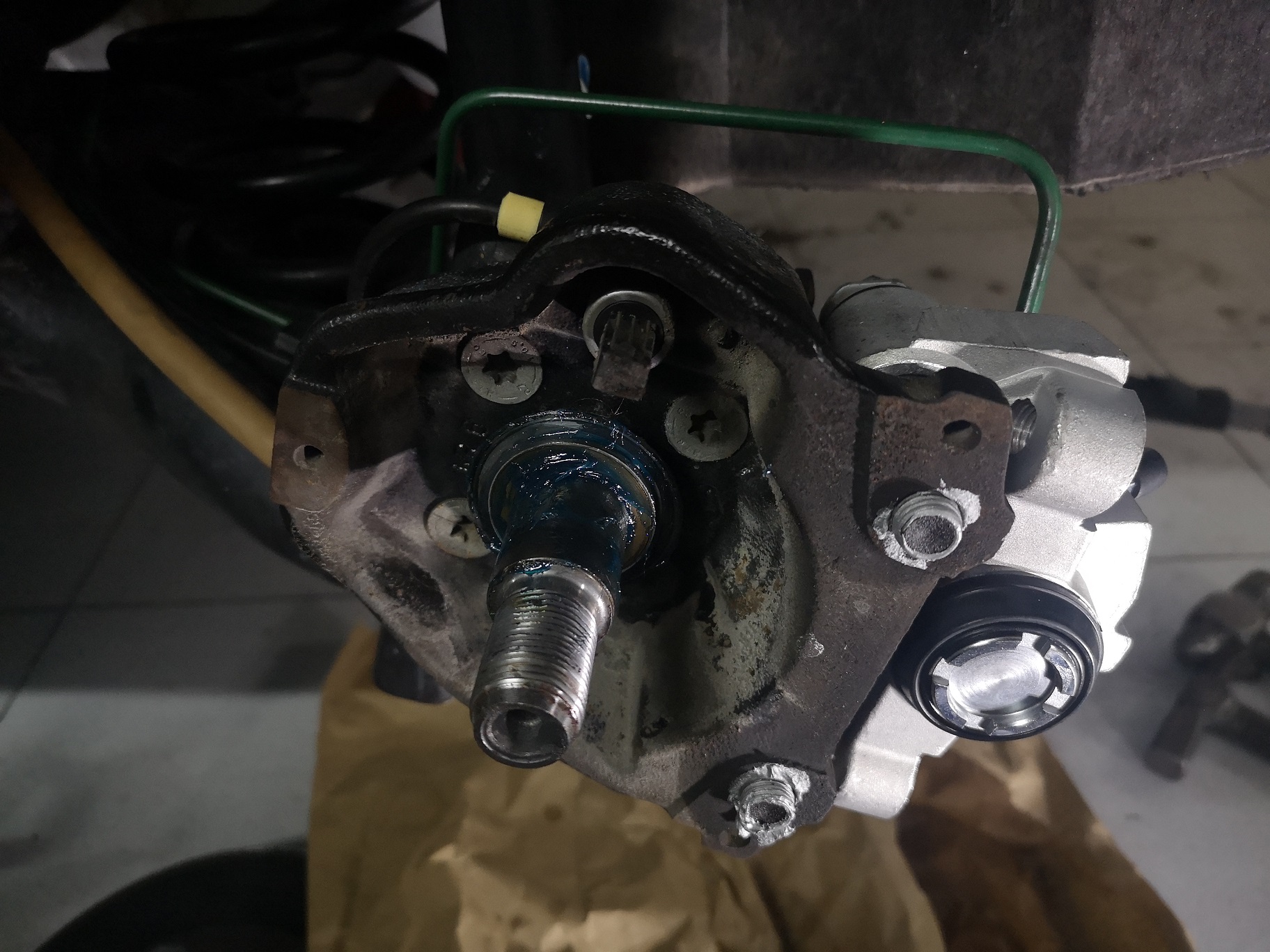

And was left with this...

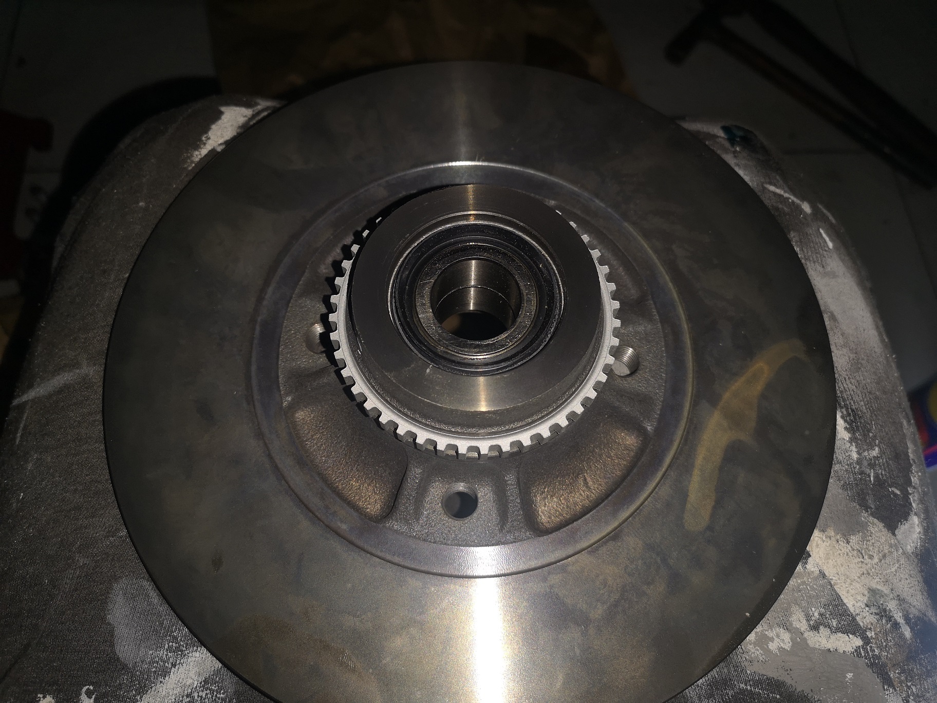

No wonder why it didn´t want to came off...
And all cleaned and ready to install.

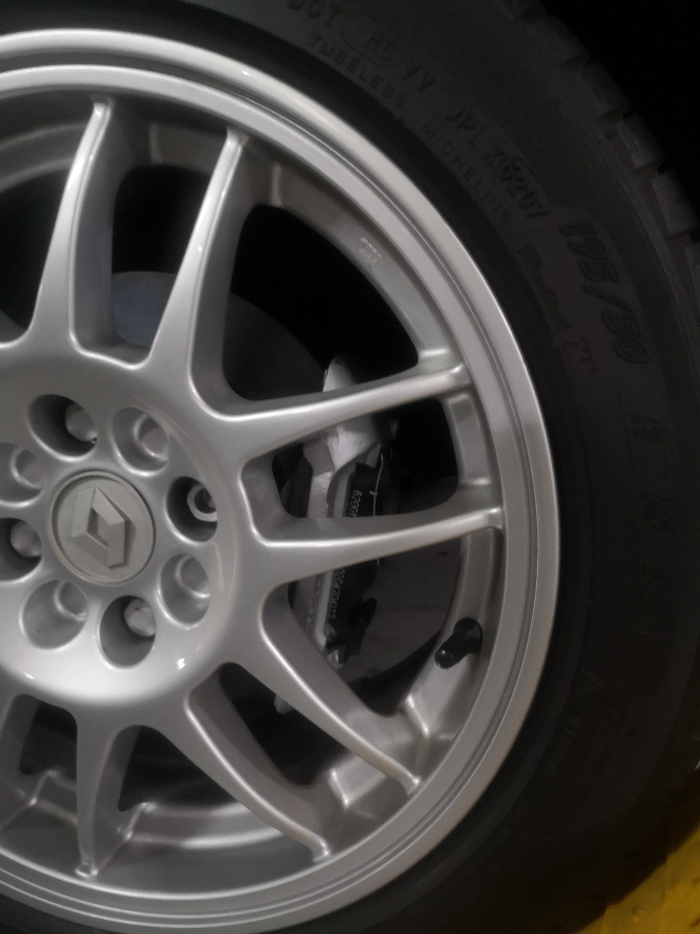

Everything in place .
Adjusting the parking brake

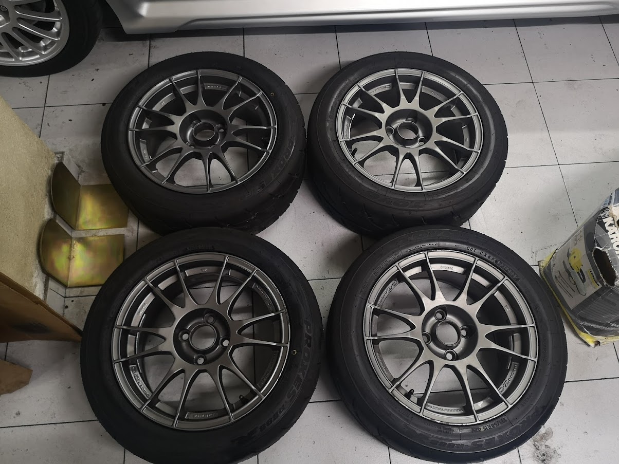

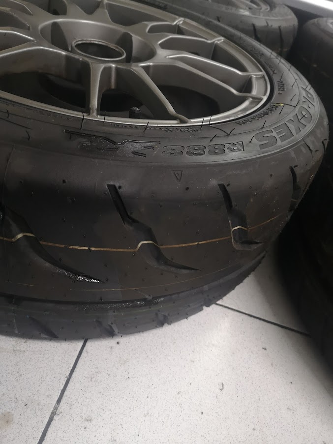

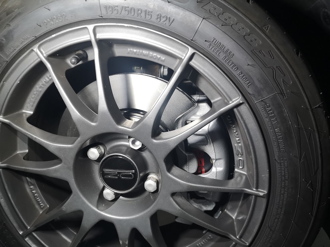

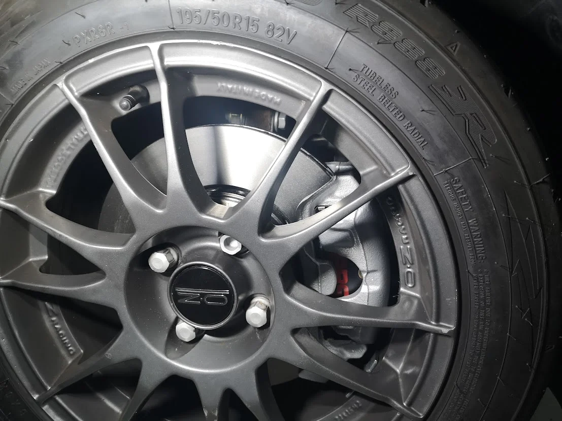

Oz Ultraleggera withR888R

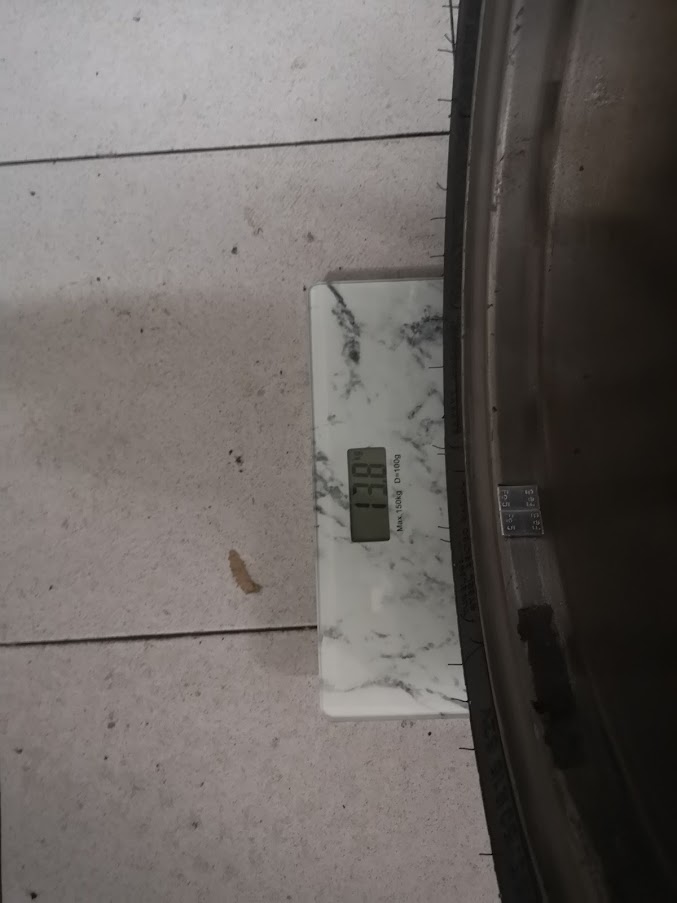

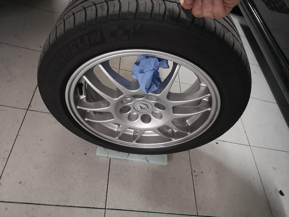

And then decided to weight them
Stock Clio Rs172 ph1 wheels with Michelin 195-50-15
15,2kg tyre+wheel !
And the OZ with the R888R
13,8kg . So about 1,3kg saved on each corner even considering the R888R weight 1kg more than the road michelins.
And some pictures after installing them :)
Will try to take some better pictures on the weekend :)

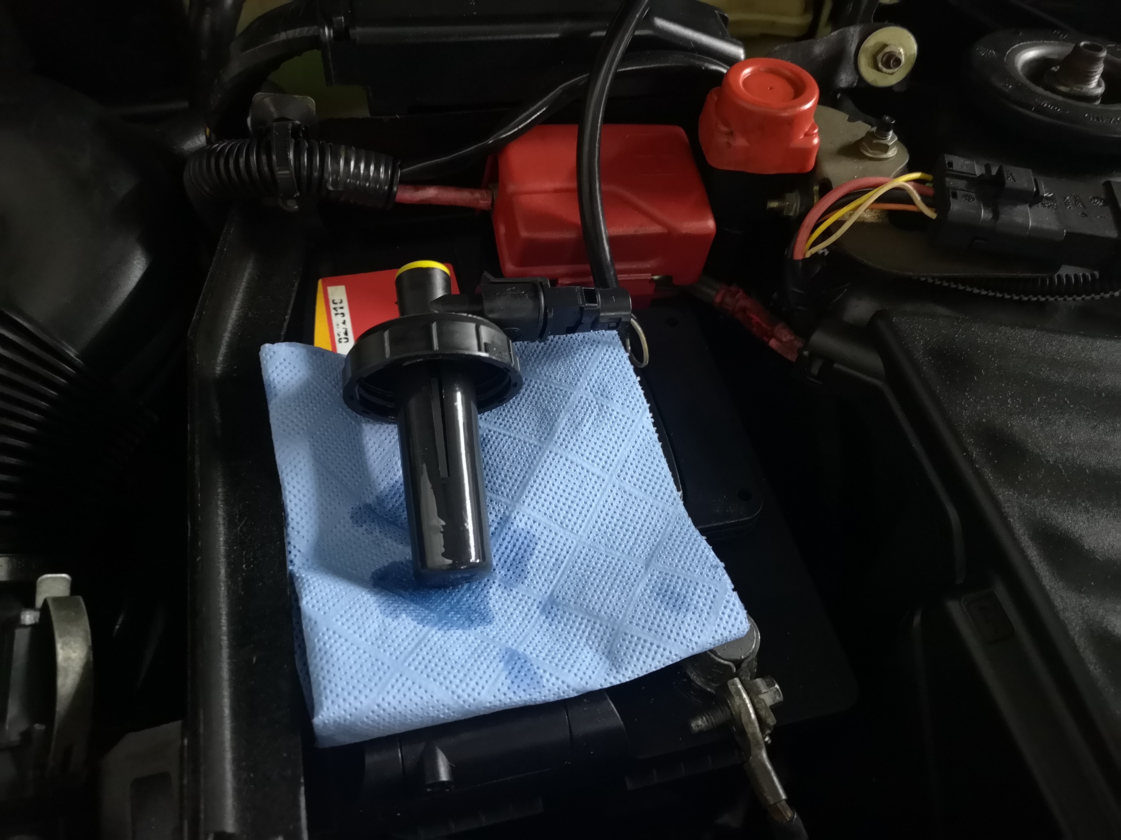

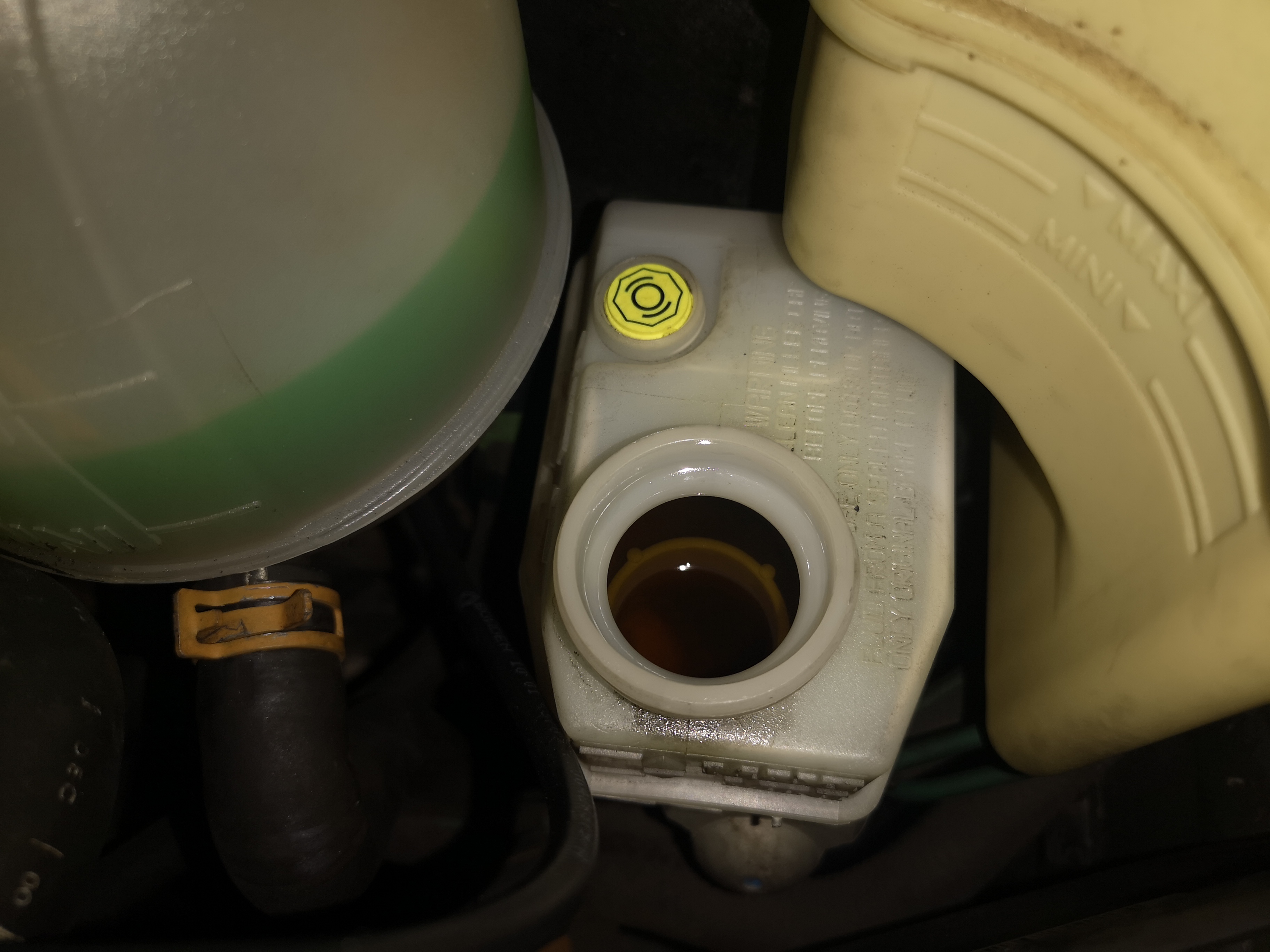

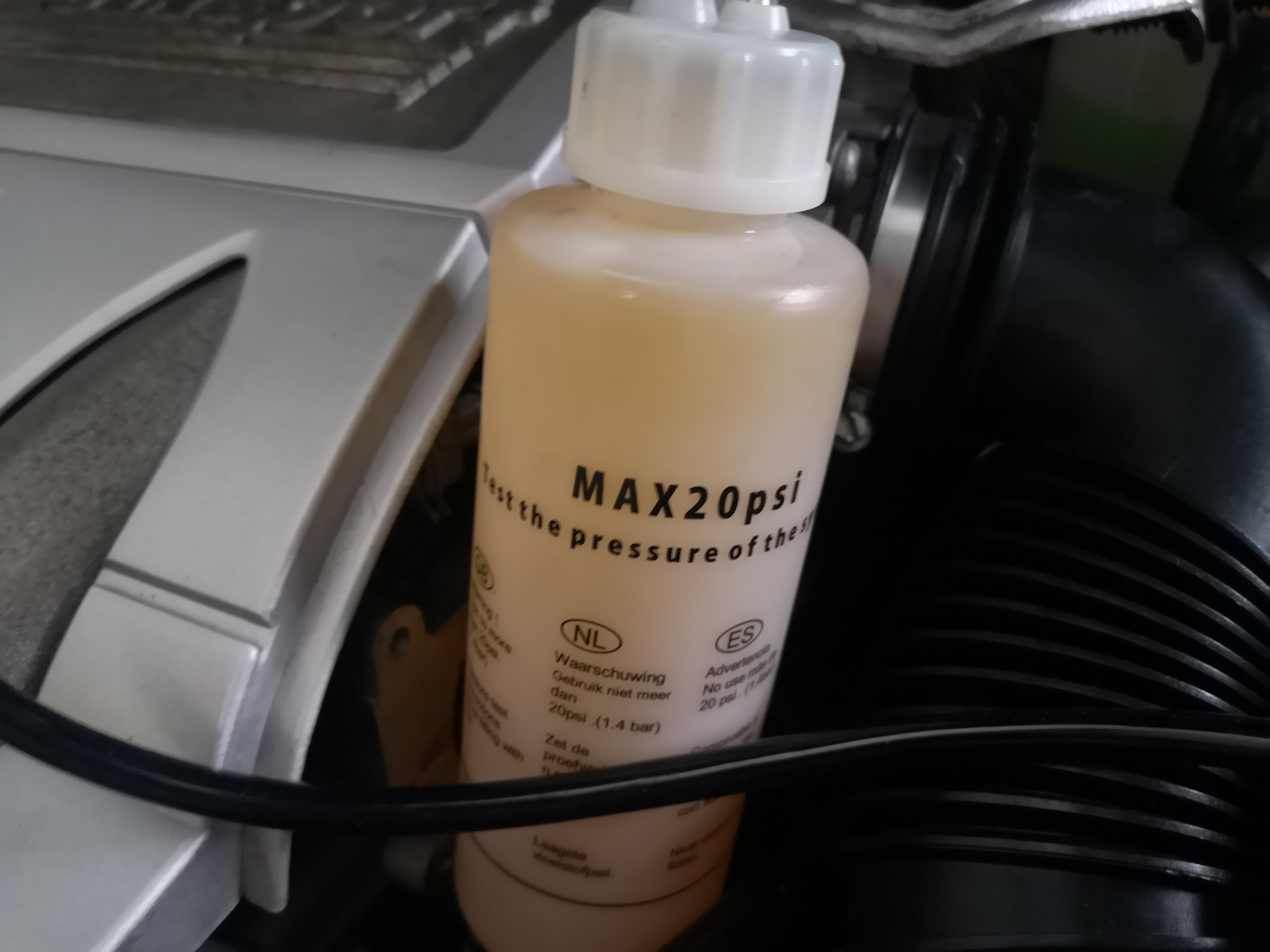

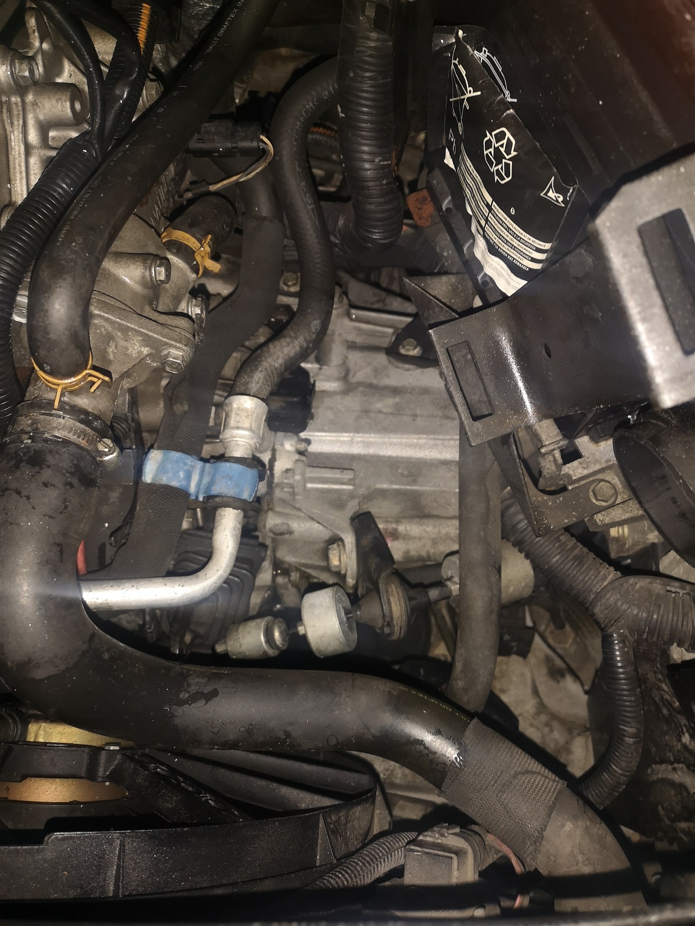

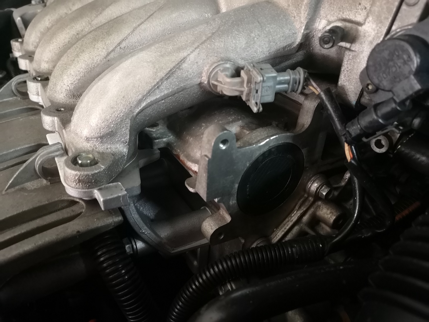

Since i bought the car i noticed that the gearbox had two oil leaks. One from the gear selector shaft, witch it seems is a known issue and another one by the gearbox bell housing. Since i have a low mileage PH2 172 Gearbox to install (50 000 km only and the bonus of the shorter final drive) i don´t want to remove this gearbox right now to reseal it. So, i just need to add some oil .
Removing airbox and clutch cable to get to the filler.
Oem oil is good enough for now.

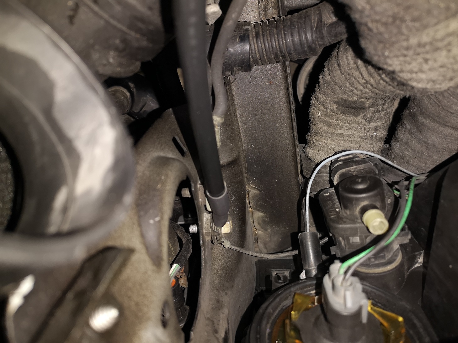

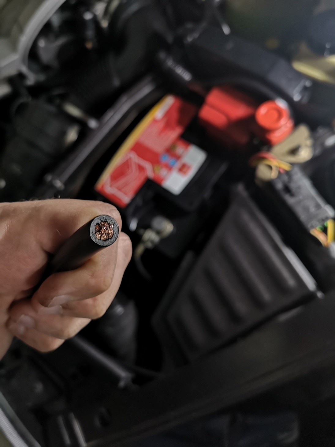

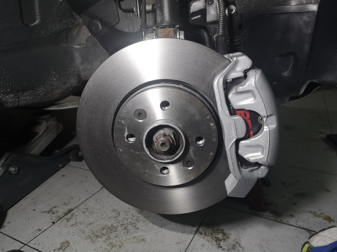

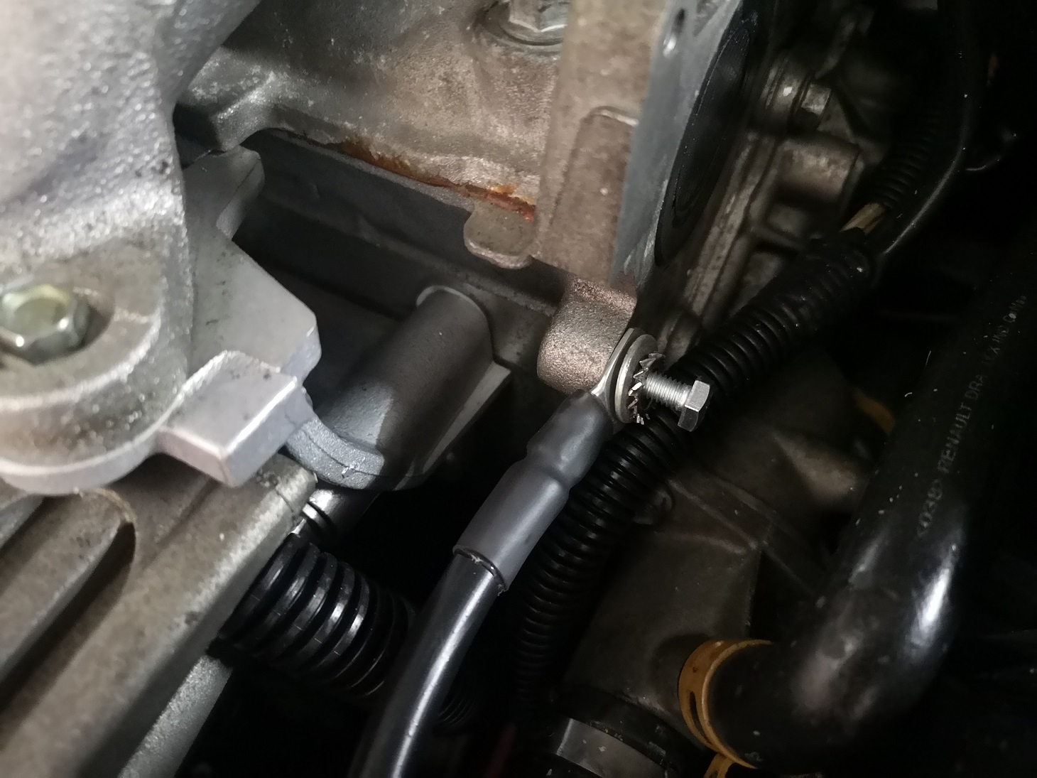

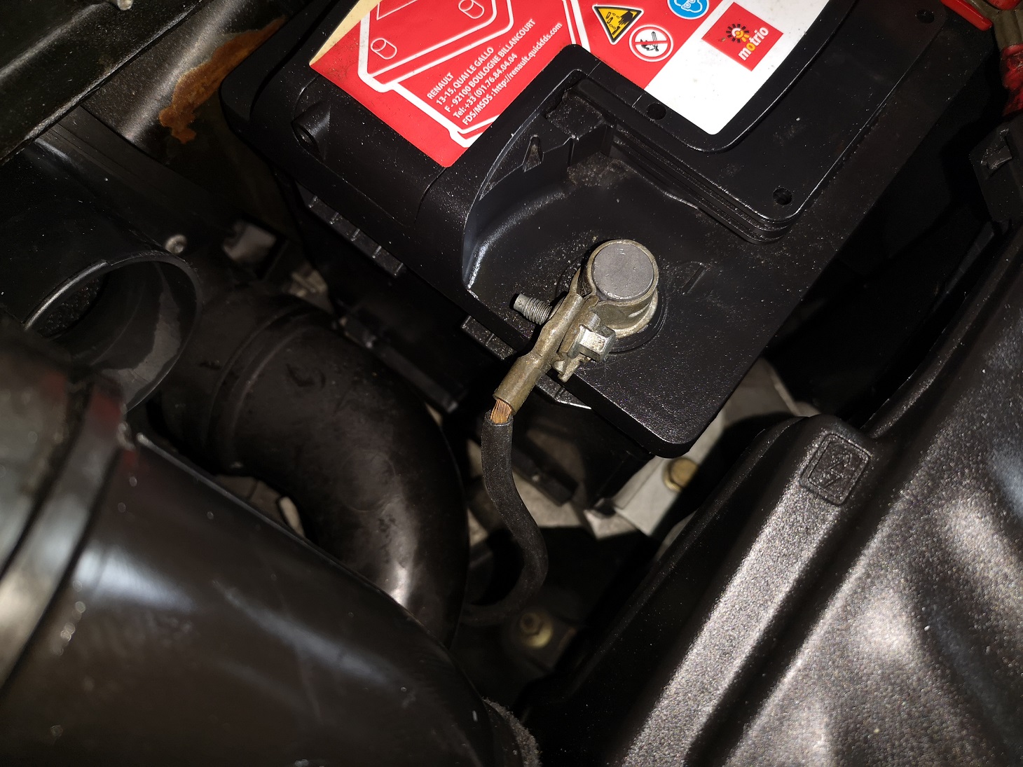

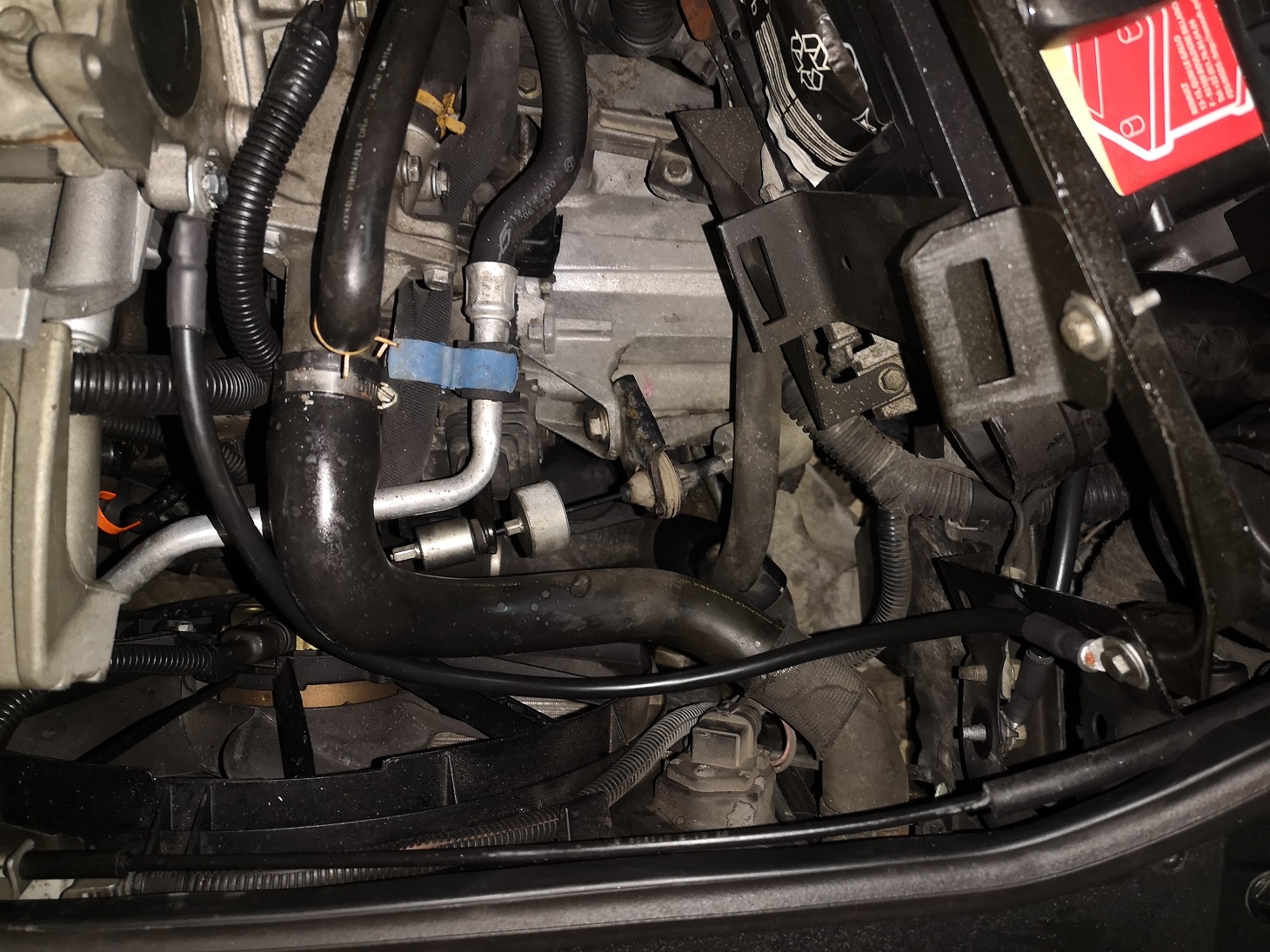

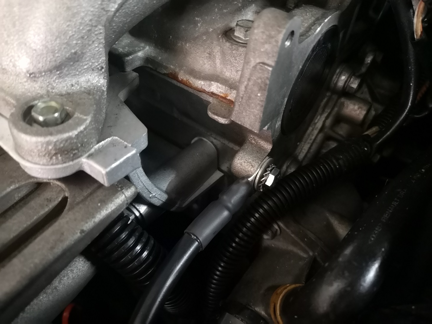

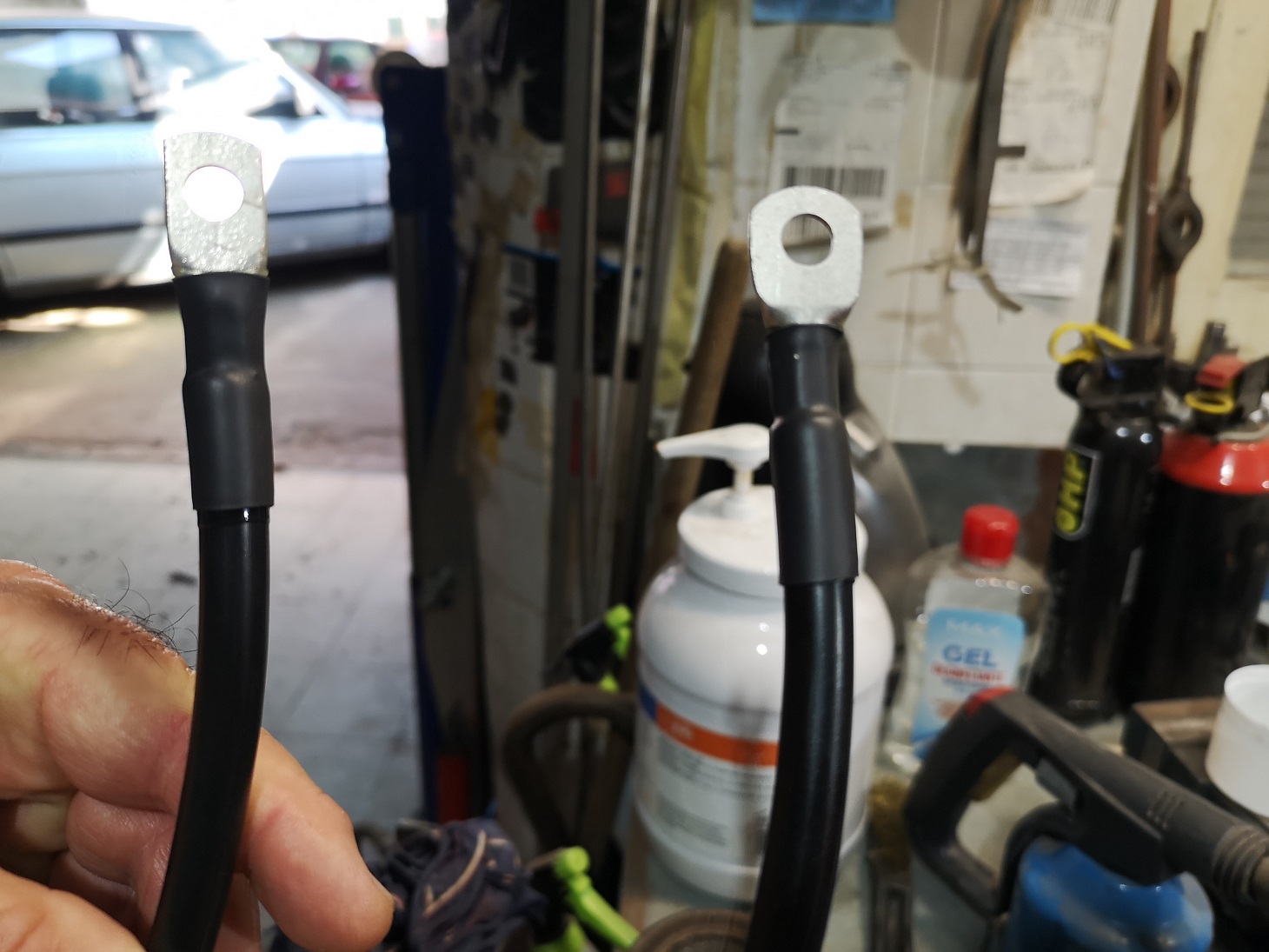

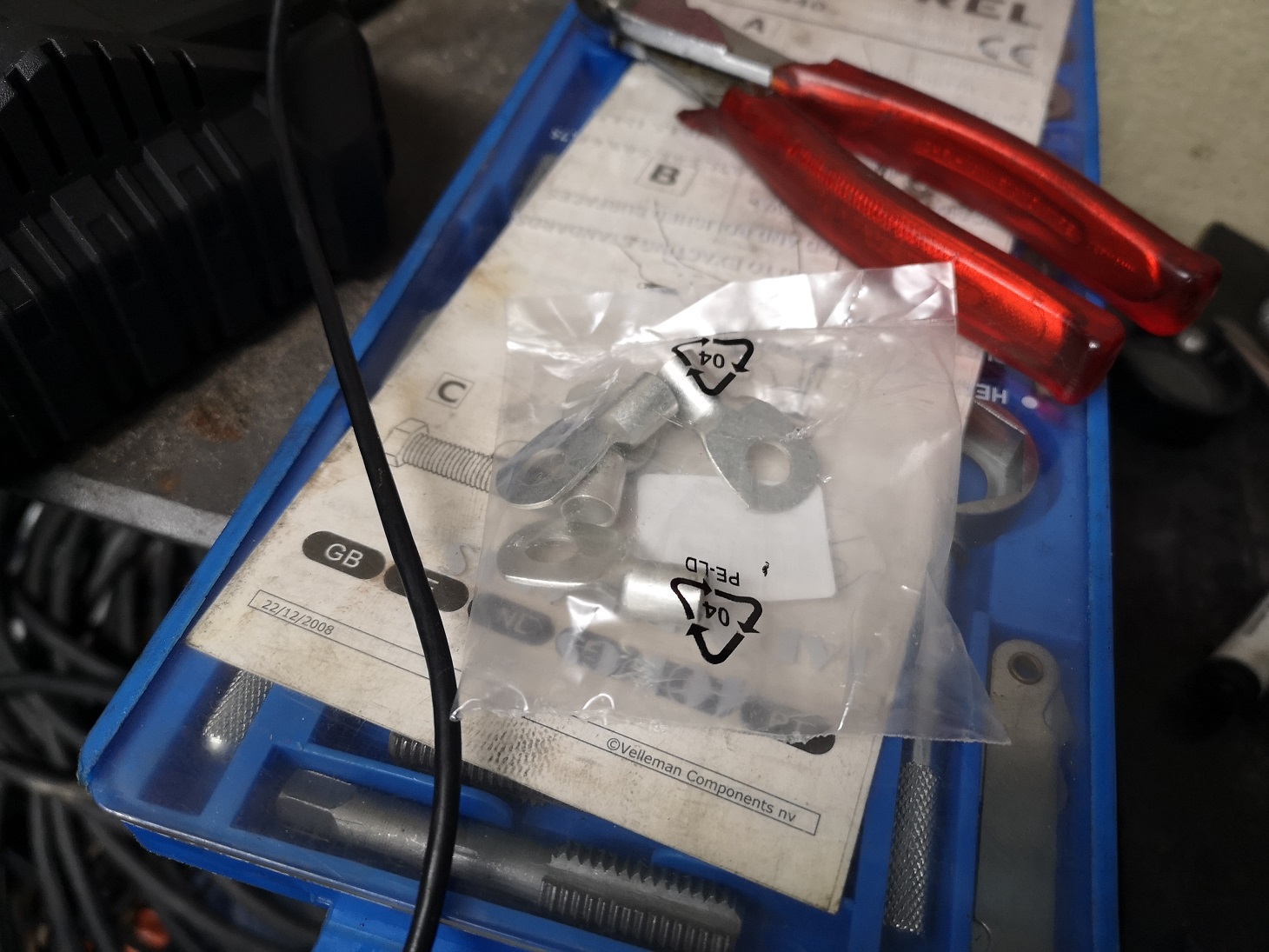

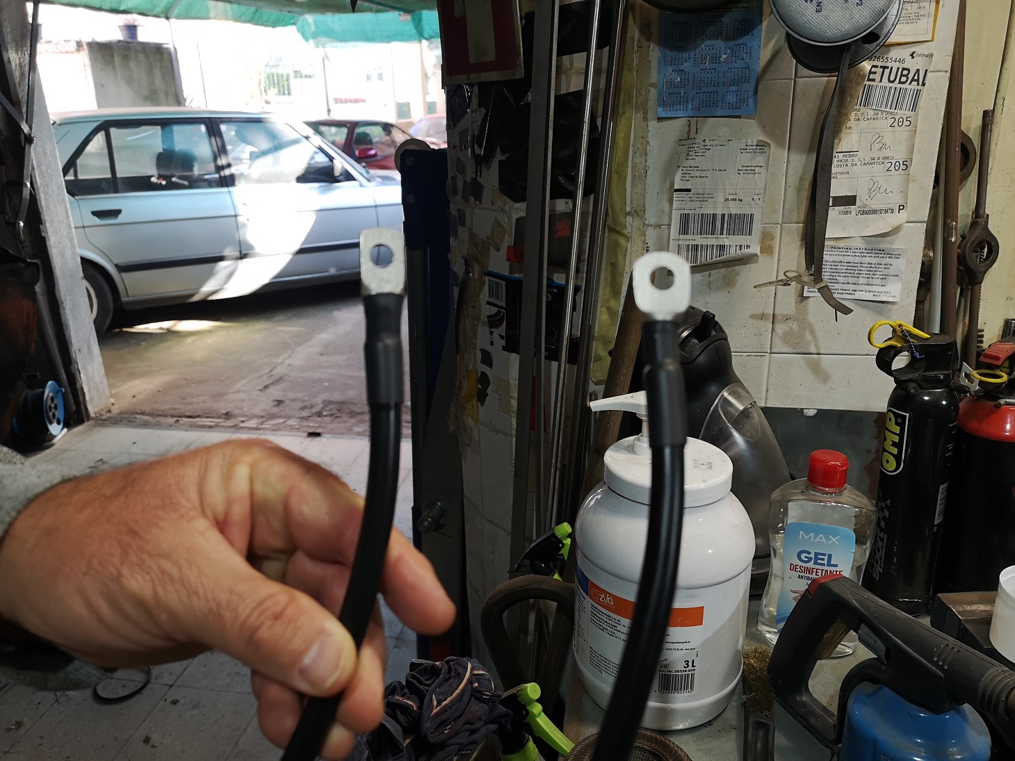

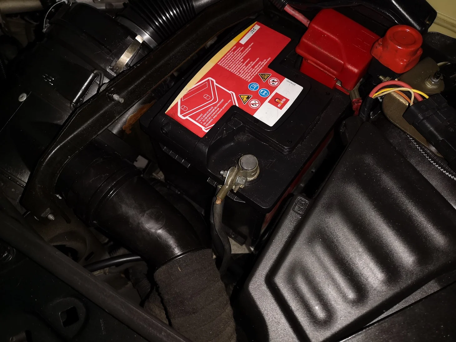

Also decided to take advantage of having some parts apart and decided to make two new ground wires for the car. The original ones look a bit tired and are too flimsy .

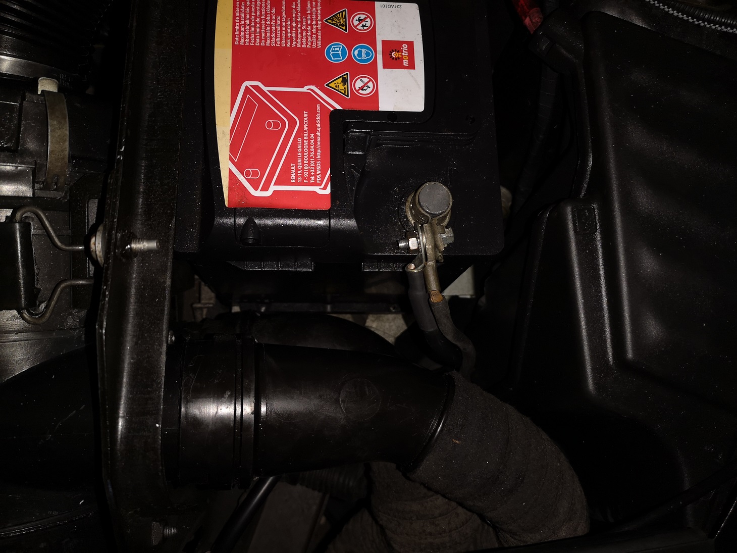

And the new 8mm wire.
Some proper terminals
And clamped with the proper tool . Looking very good.
One of them decided to use the same path as the original coming from the battery.

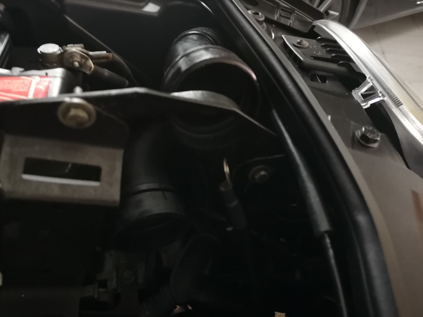

The other one connected from the head to the air box bracket that connects to the chassis. I think it´s better than nothing. Correct me if wrong :)
Where it connects.
Some free play and does not get caught in anyplace (Fan/Clutch cable etc).
Annnnd it survived :)

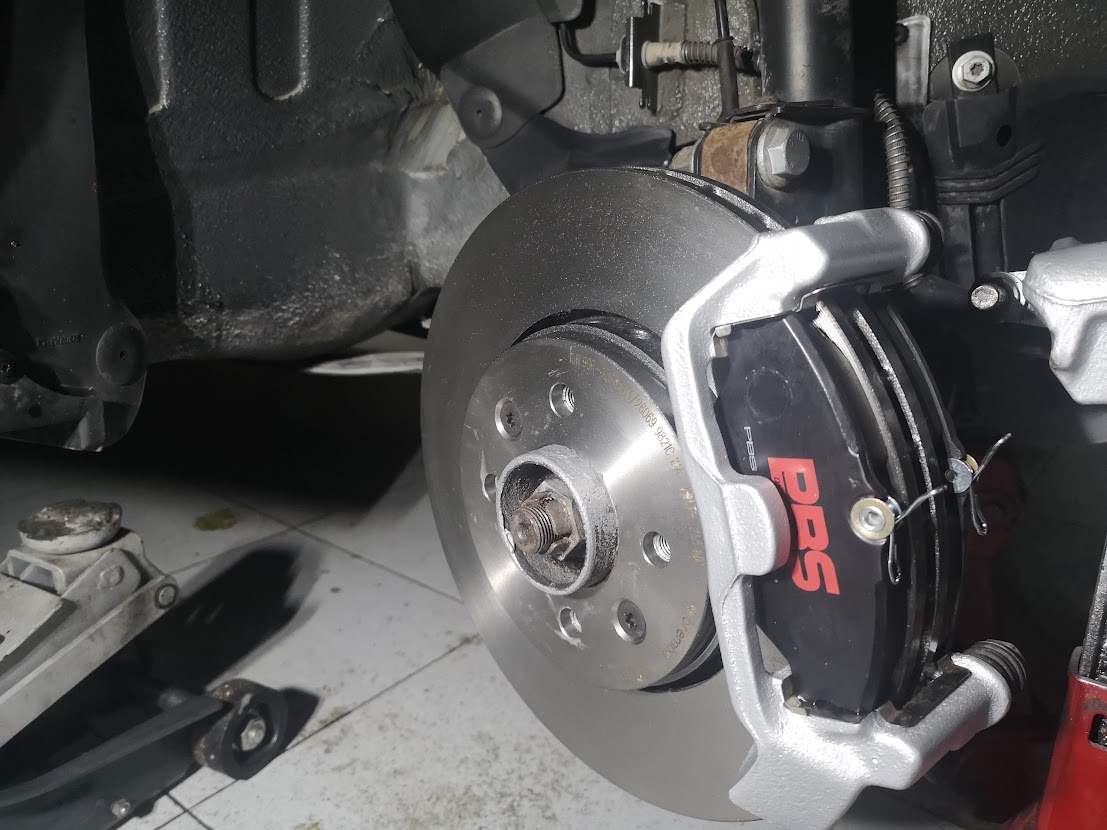

Managed to cook the PBS pads and the once silver front calipers are now almost black. After cooling down the pads were good as new regarding initial brake torque and feel, but they don´t withstand so much heat as i was expecting. I think next time will go to my trusty carbon lorraine RC6.

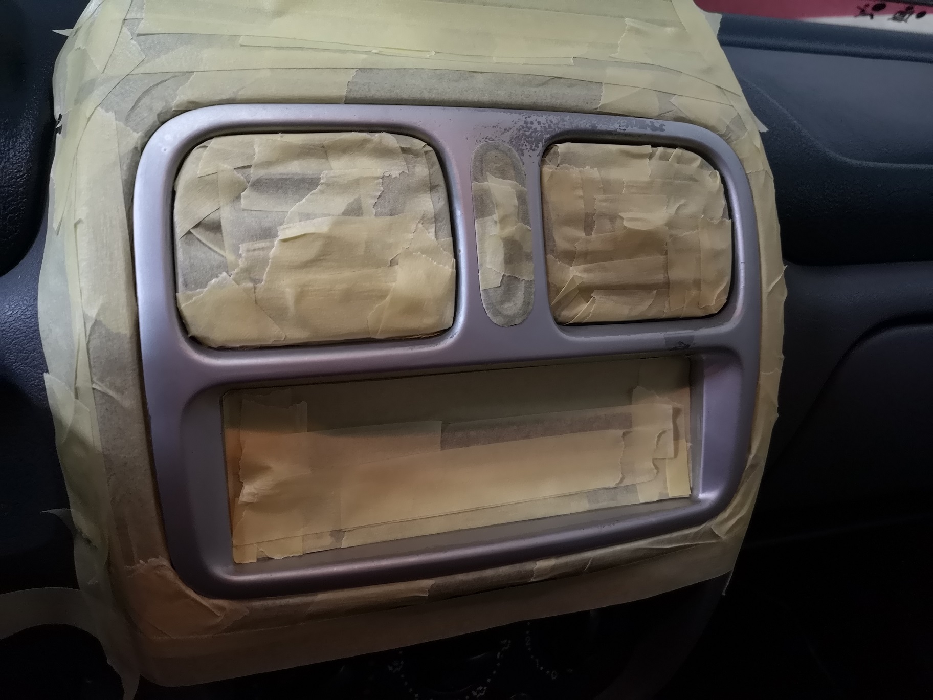

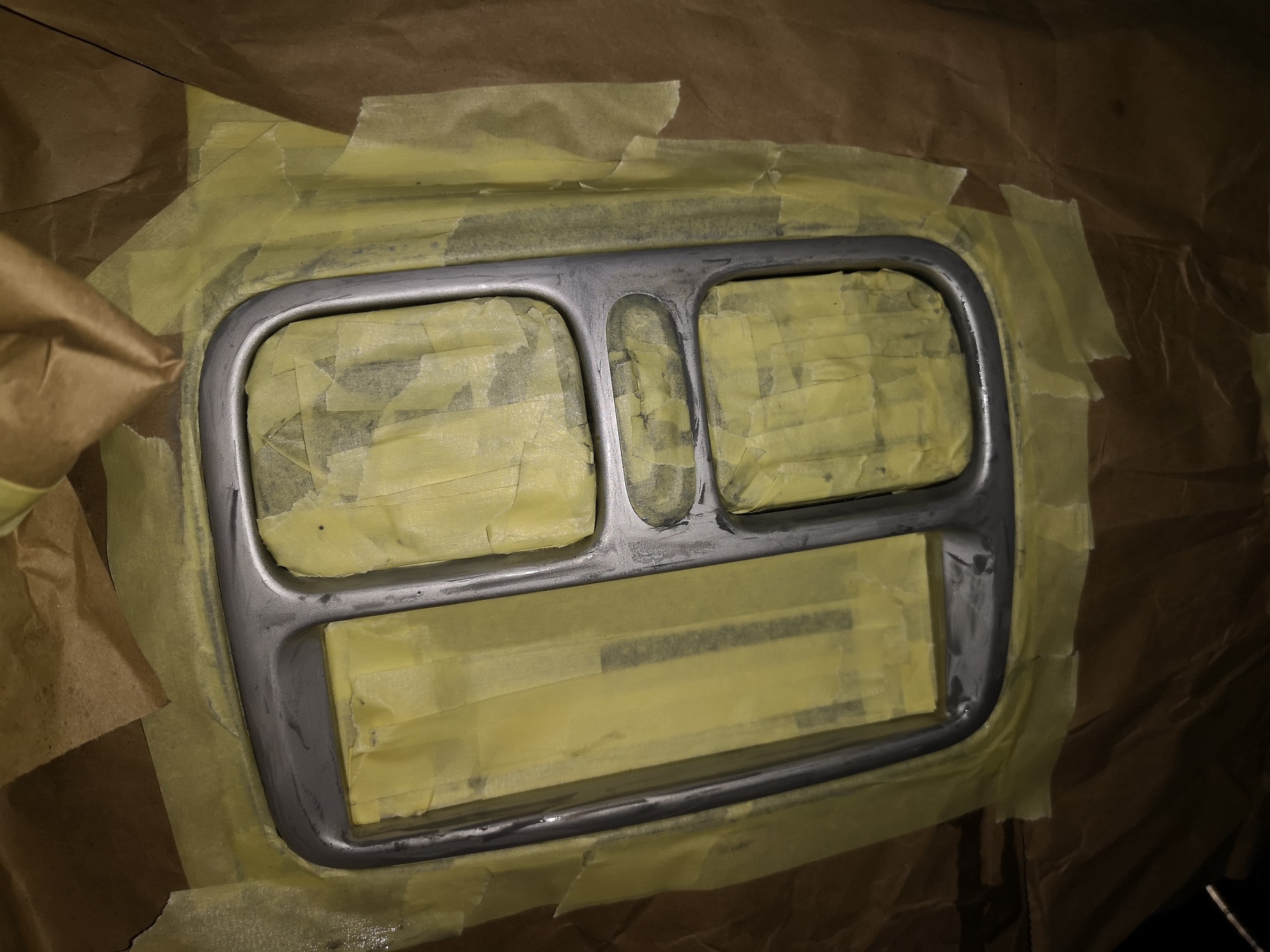

After that i decided to tackle something that i was getting postponed multiple times. And that was to take care of the center silver trim. Thanks to @Optimista who shared previously the color code i managed to get a very good result (at least for me!).
Before (The stains on the silver were due to some kind of cleaner).
During sanding
And the final result
After that interior work, decided to give a wet vacuum on the carpets, seats and a fresh coat of sealer on the paint. As you can see the color of center silver trim perfectly matches the original from the door covers and gearknob.

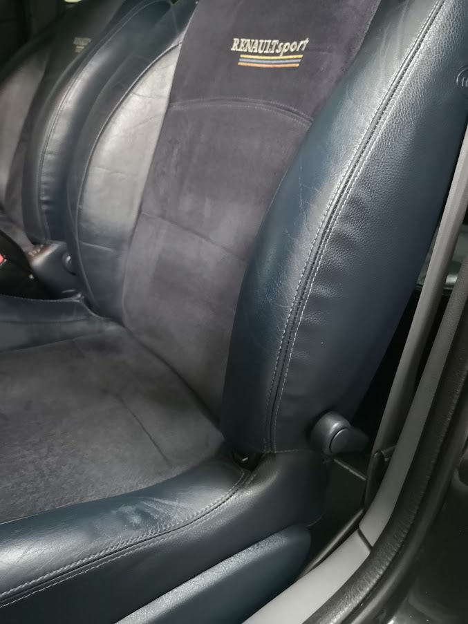

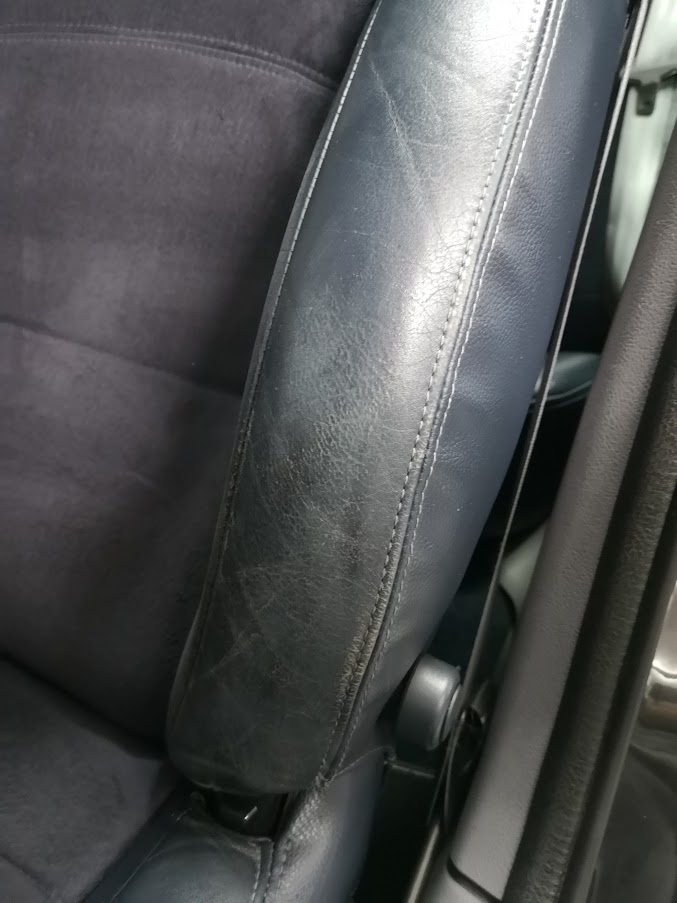

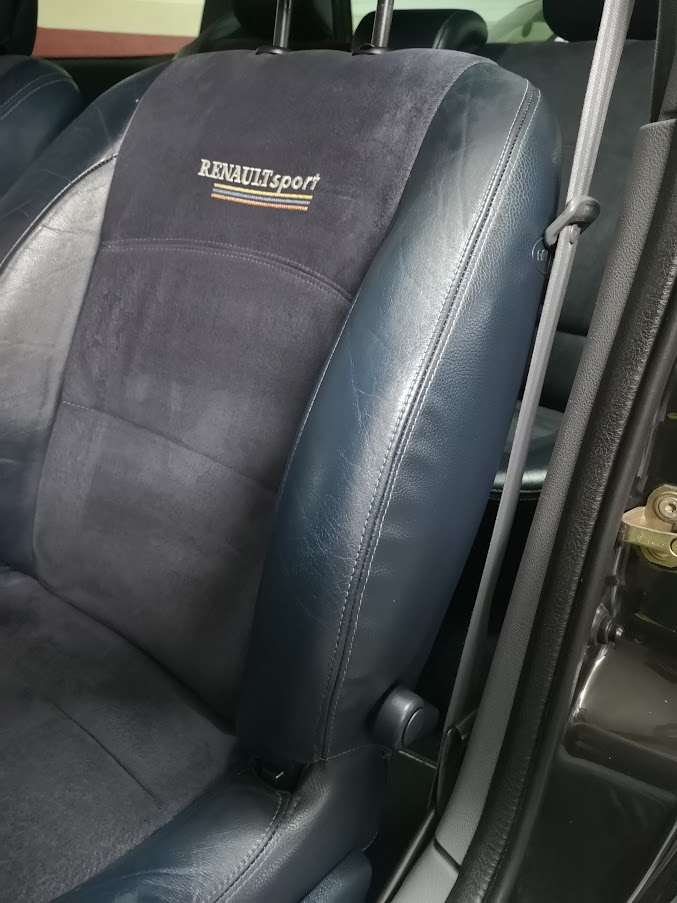

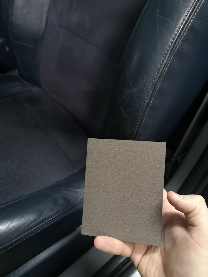

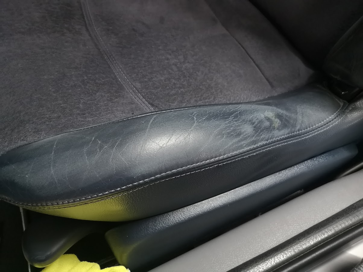

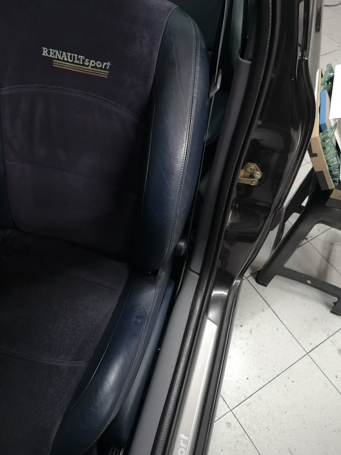

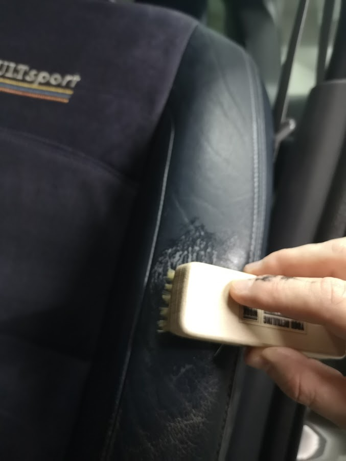

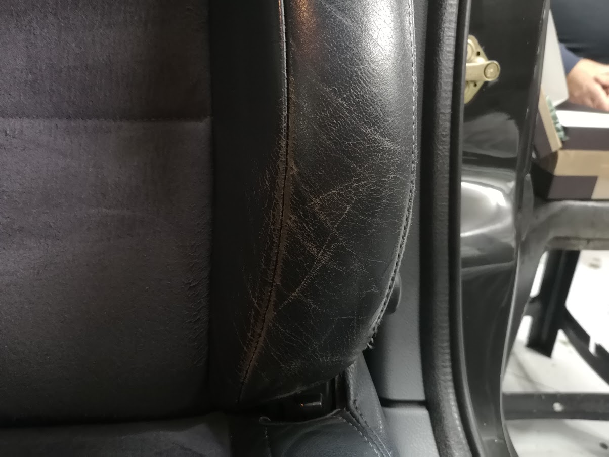

Last summer i picked up from a friend (In exchange of some euros, not for free :LOL:) a full interior for the PH1, front seats, rear seats and door cards. Why you may ask. Because they were in really good condition (85%) and you can never have too many spare parts 😄

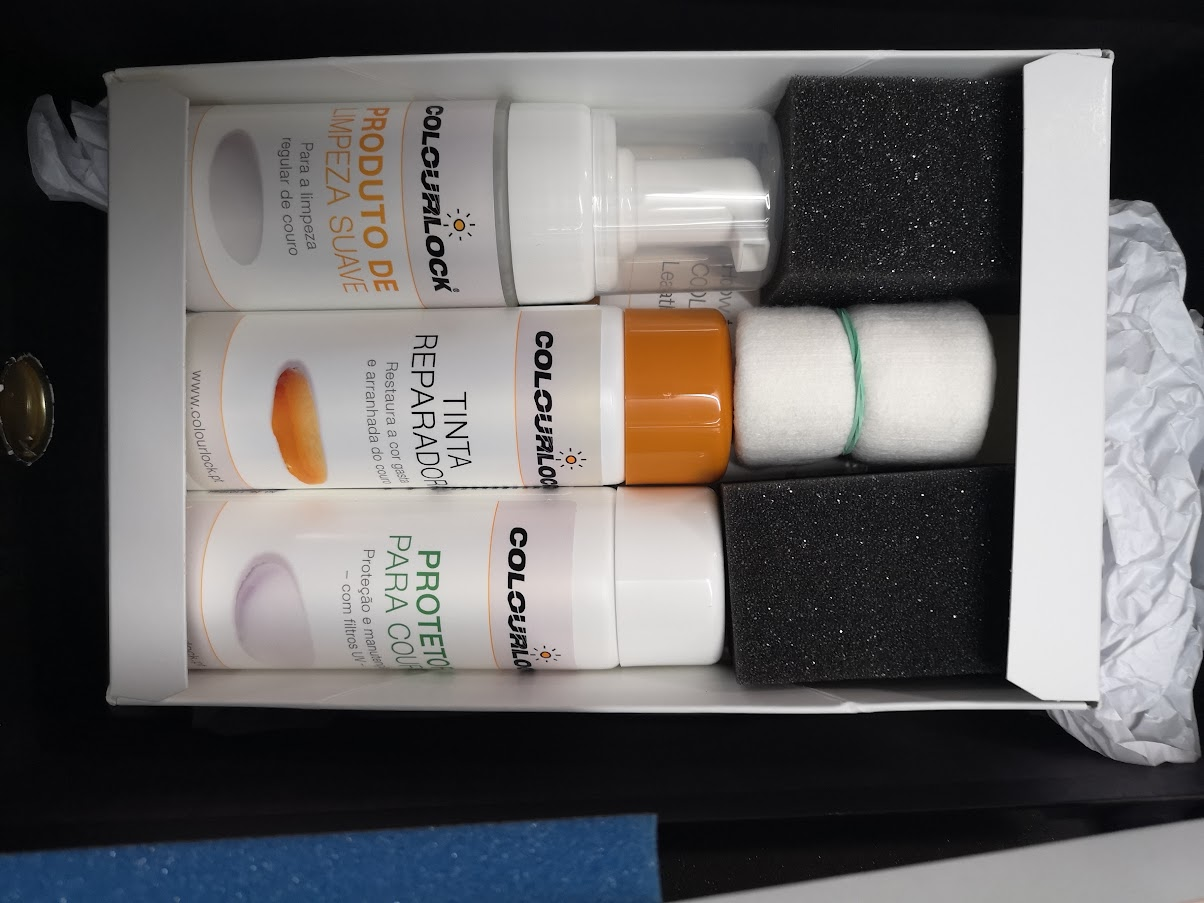

Since i have a spare set, i decided to try to refurbish mine. I talked to a friend of mine who is a very good detailer and he recommended me Colourlock products. I contacted them and ordered "Renault blue", i told them that it was for a Clio 172 RS PH1 and they seem to know what blue i was talking about.
The kit upon arrival. Very well packed.
Besides the sandpaper, this were the products that i have received.

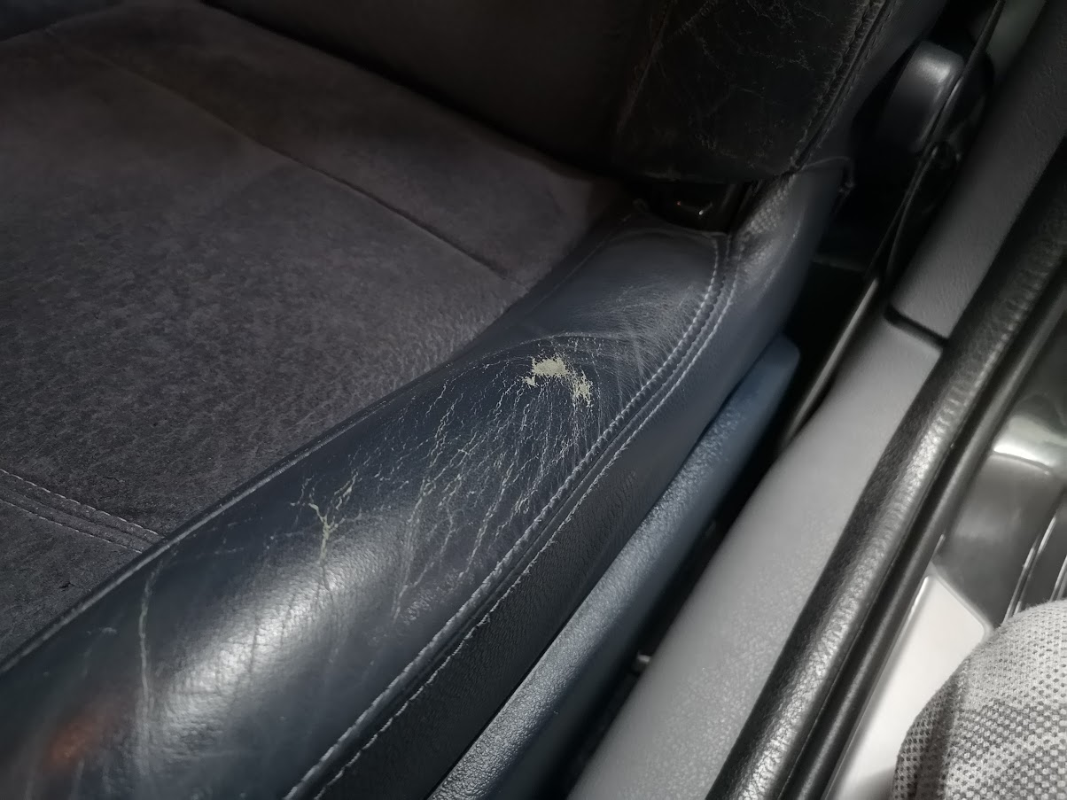

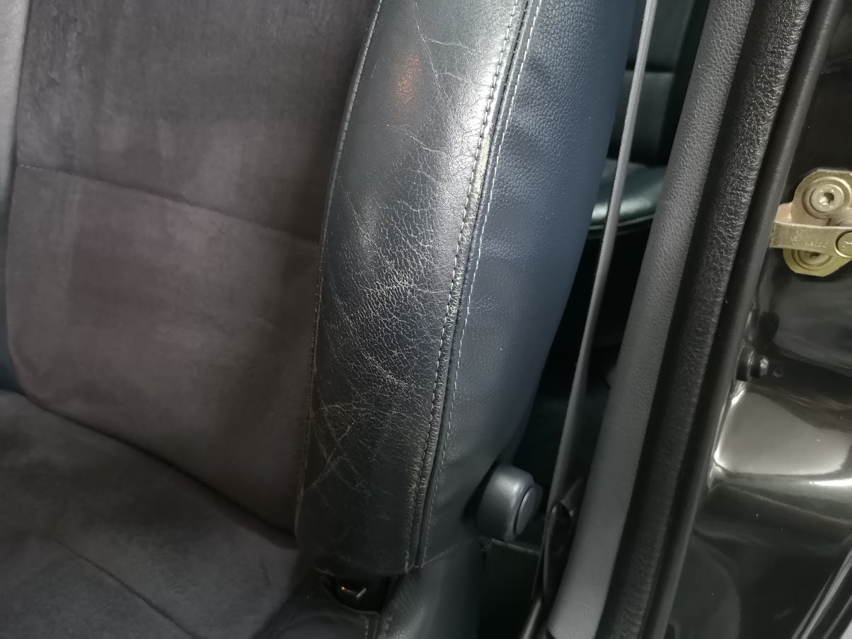

And some before shots of my driver side seat (The passenger was not it much better condition)
