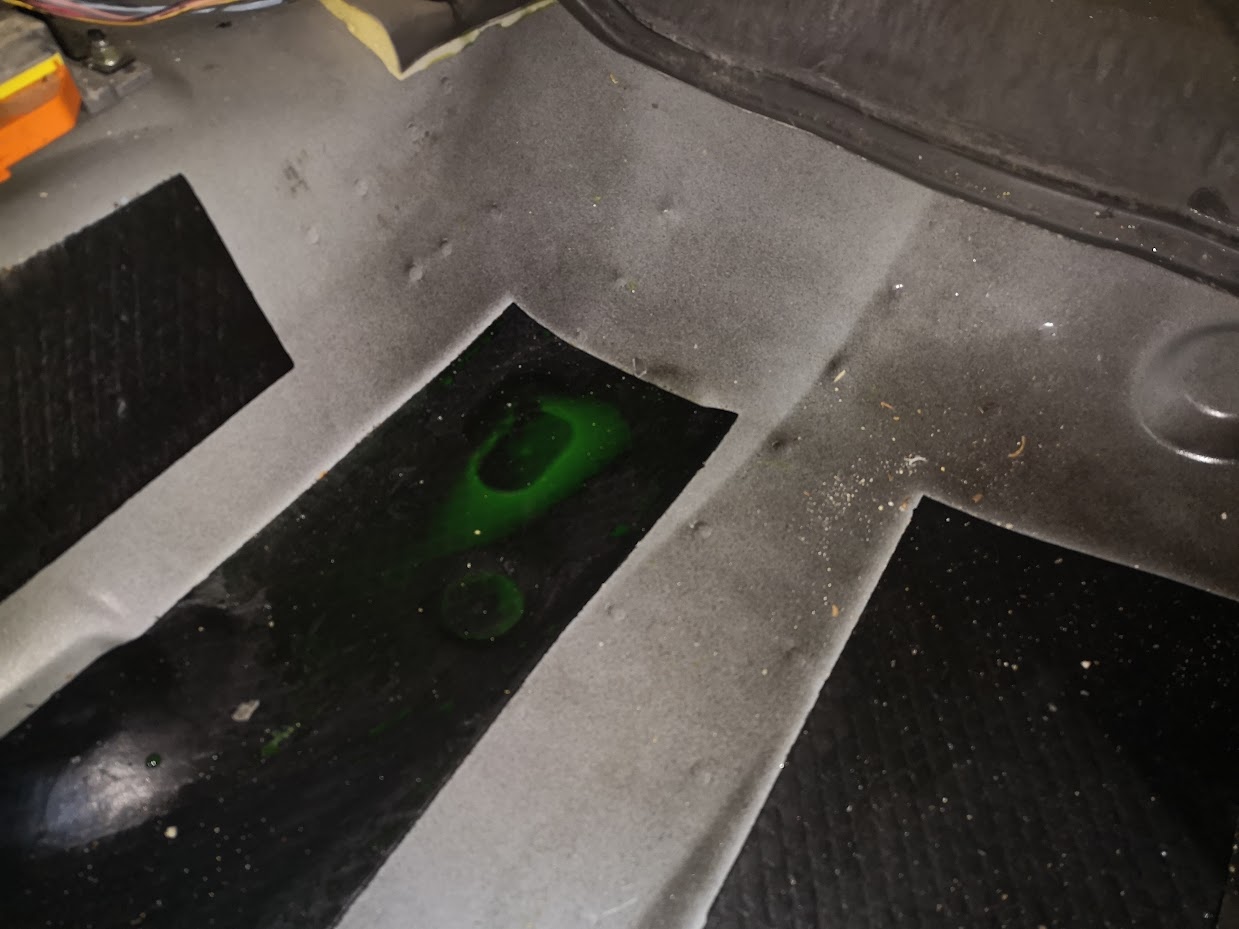

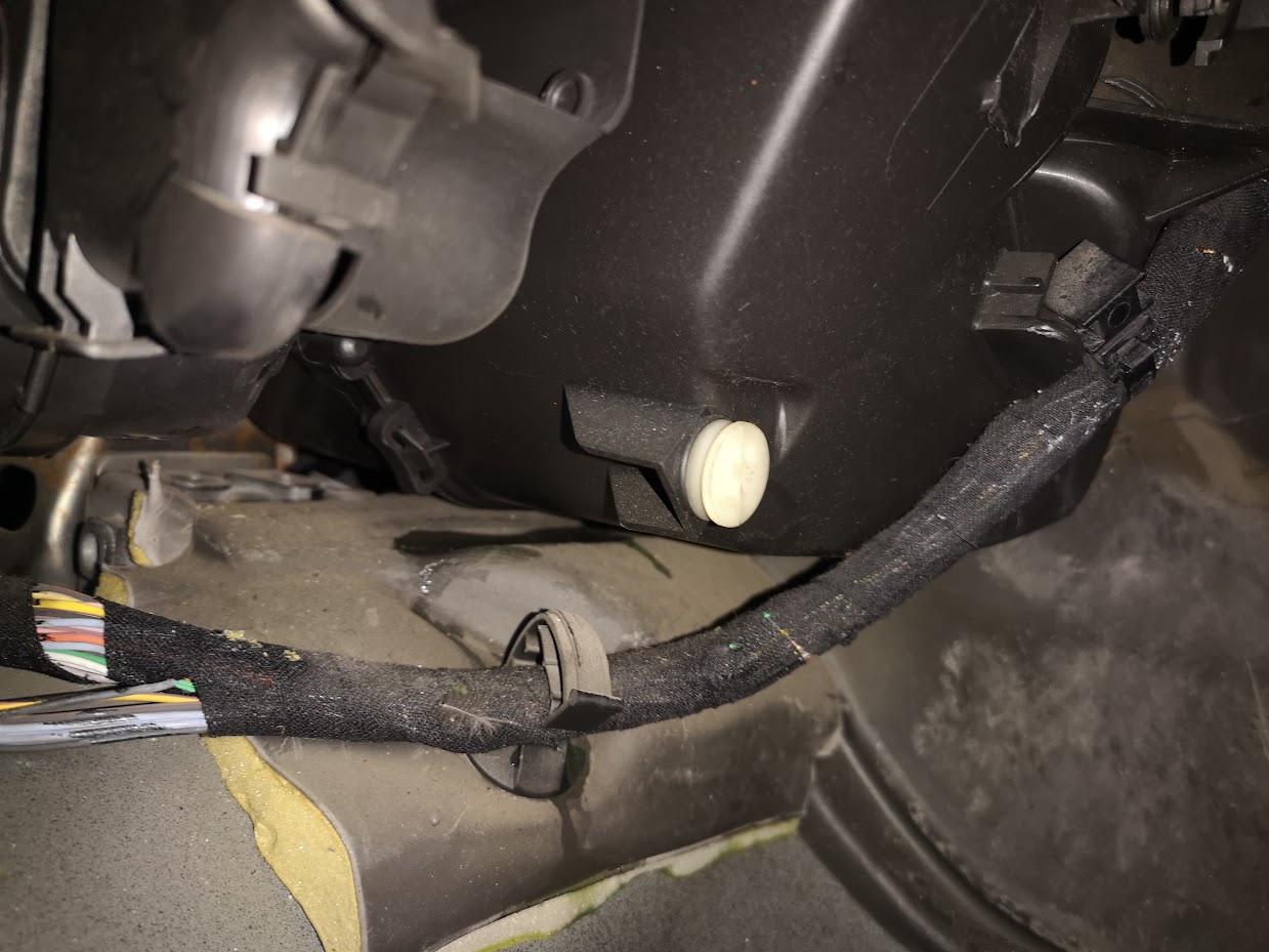

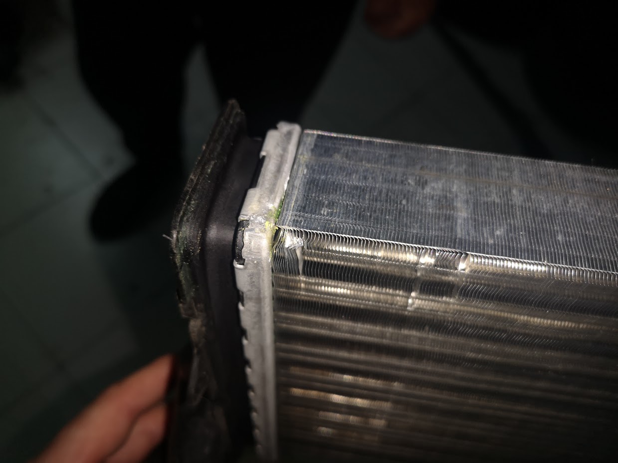

Noticed for a couple of month a slight coolant smell sometimes, but nothing in the floor of the garage, nothing on the engine oil, but i could smell it from time to time, but could not find the leak . Put the coolant system on pressure, and nothing. No pressure drop. Could not figure it out .

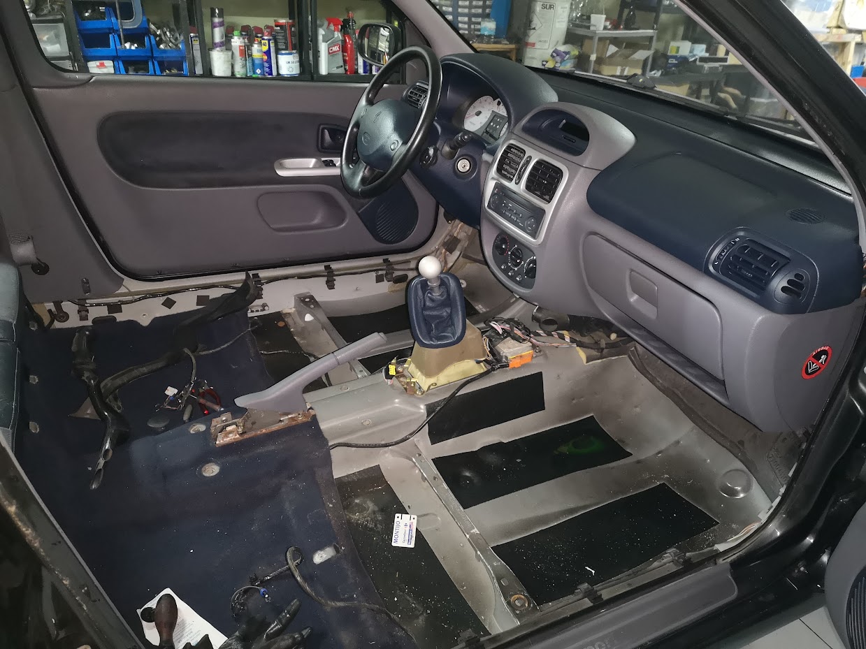

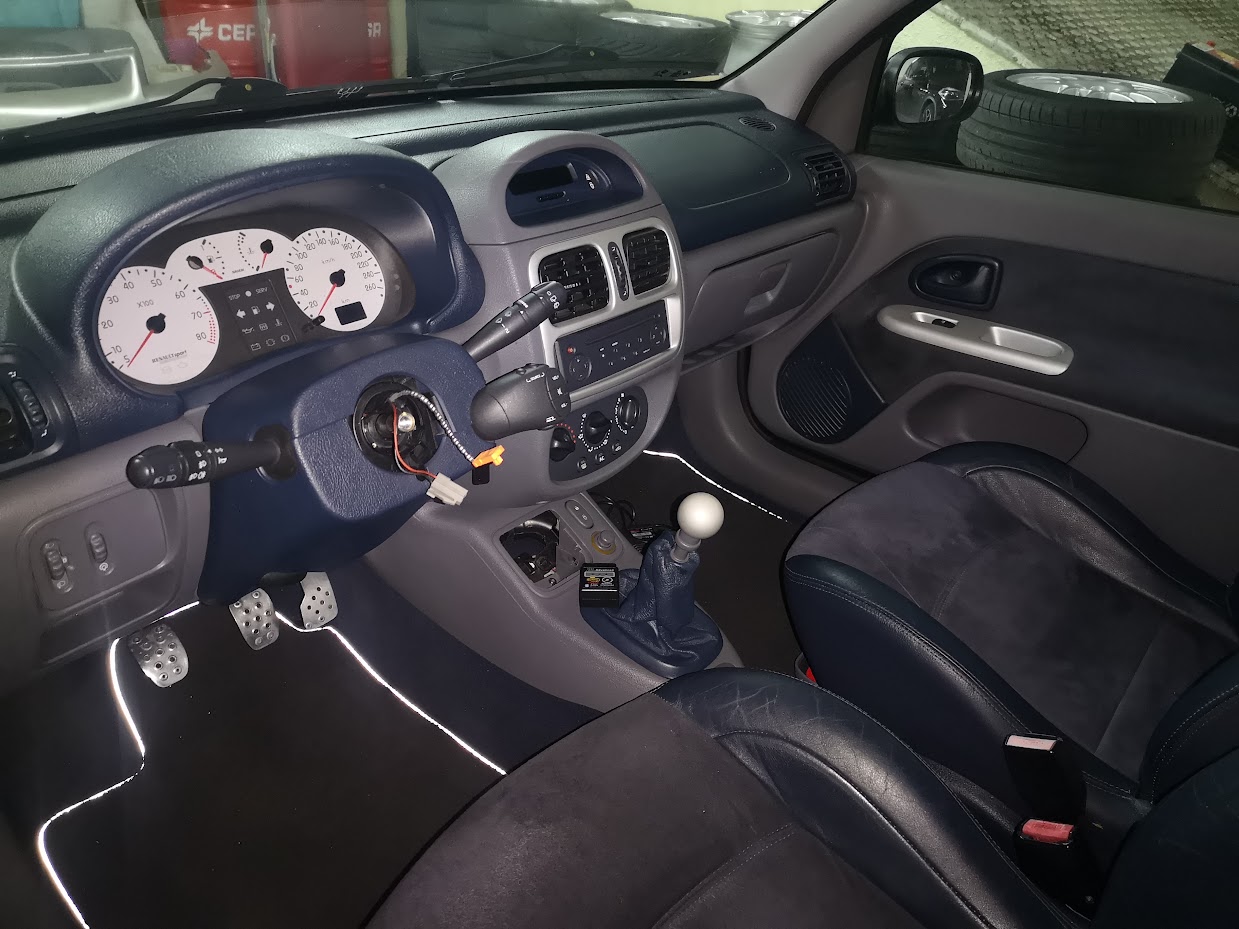

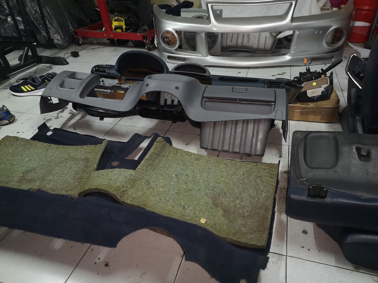

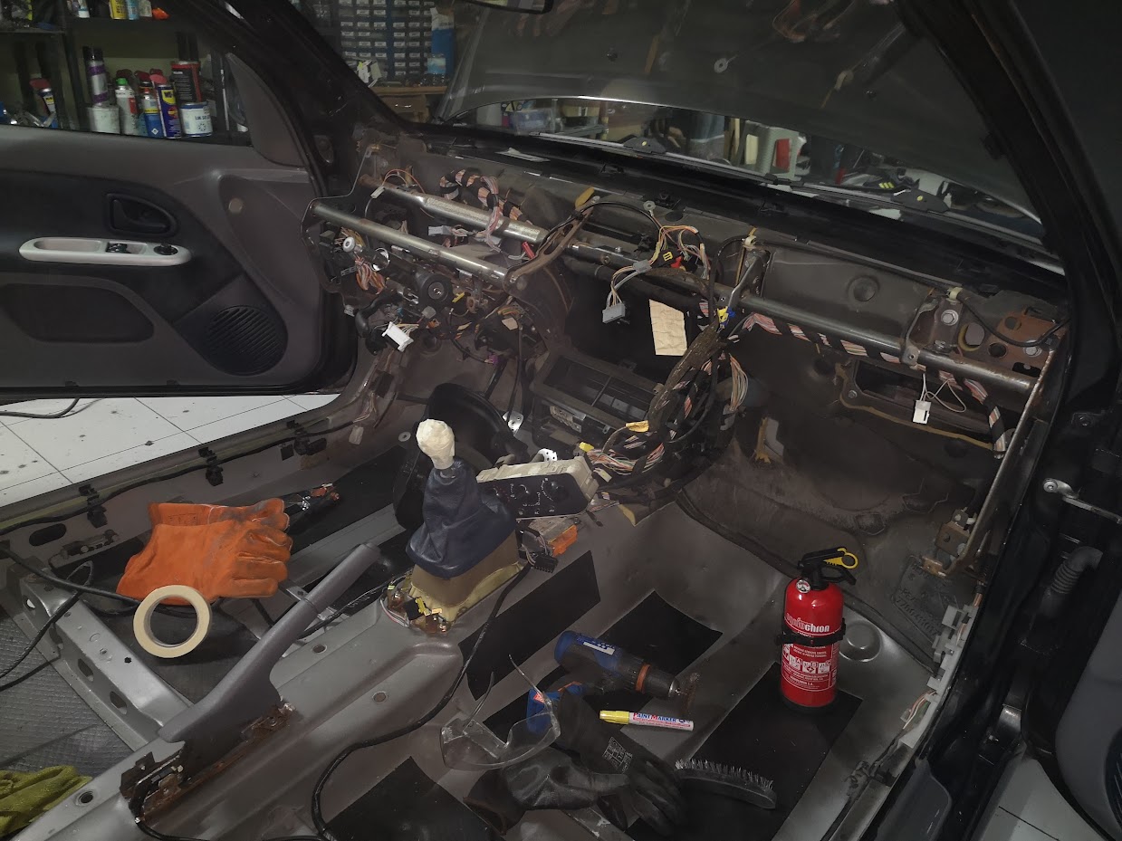

Since i had some free time, decided to remove the interior, and look what i found...
There it is my coolant leak. The heater core said enough is enough after 23 years. Since i had the colossal work of removing all the interior and dash, decide to perform some modifications that were in the back of my mind for several months (more on that later).
War zone
And parts everywhere!

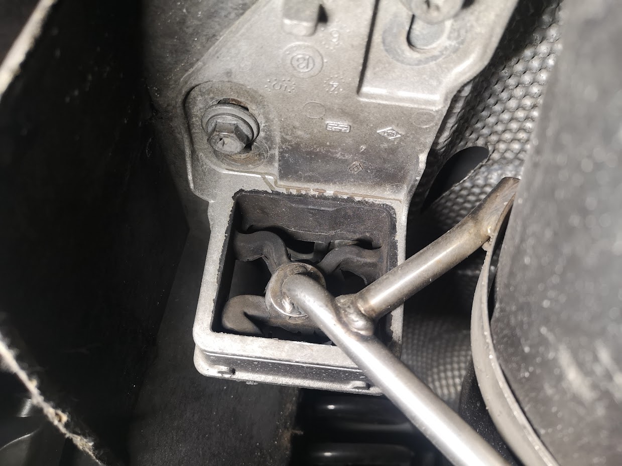

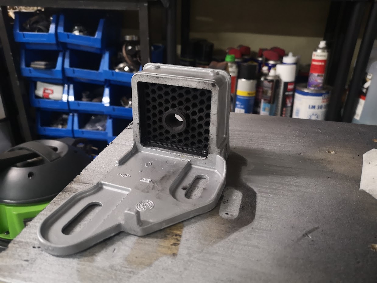

In the meantime, one thing that was starting to want some attention was the rear exhaust bush. Decided to give the Grams sold by Kamracing a go.
The kind guys at DHL charged 15€ for present it to the customs (a process witch i do myself in any order from the uk, but when it´s shipped trought DHL i have no other choice than pay it). After the customs taxes added this mount came in a total of 80€!!! :mad:
Installing it was piece of cake
The original was showing some wear but not as bad as some i have seen over here
And the new one in place
Great product. No increase in NHV.

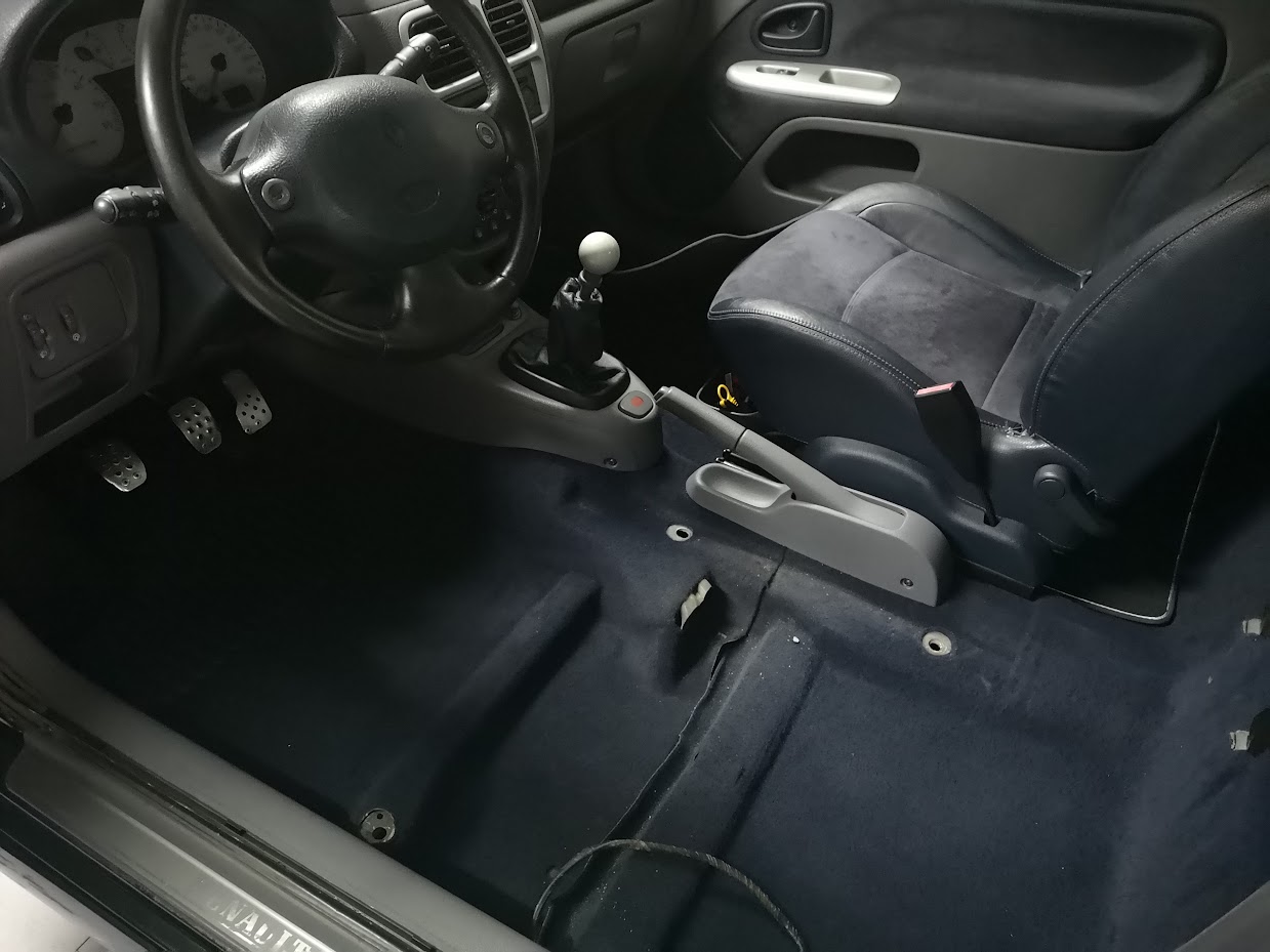

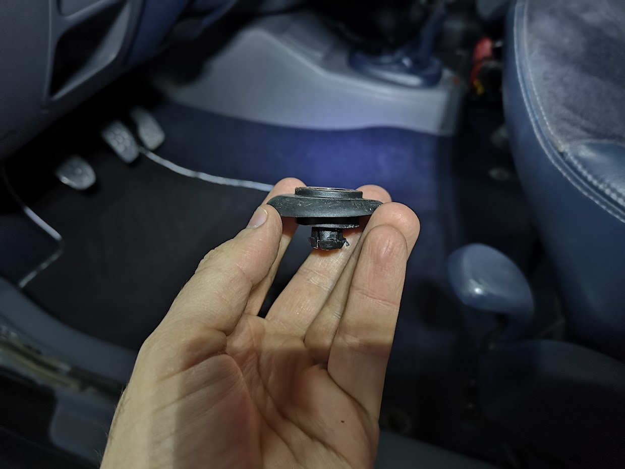

I missed your update about the interior when you posted it. Is there any negatives or drawabacks to removing the seat spacer? Being 6ft, I would welcome the seat being a little lower and now is the time to do it with all of my interior taken out.
@Filipe Dias Make sure you cable tie your Grams mount to the metal, mine fell out so had to cable tie it in on each side. <ine has been fine since.
Wow, didn´t know that! Will follow your advise. Thank you so much (y)
Imho, the only drawback is that the seat has some resistance moving forward/reverse due to the rails touching slighty on the carpet. For me is not a issue.
(y)
(y)
That's something I can work around. Thanks for letting me know.

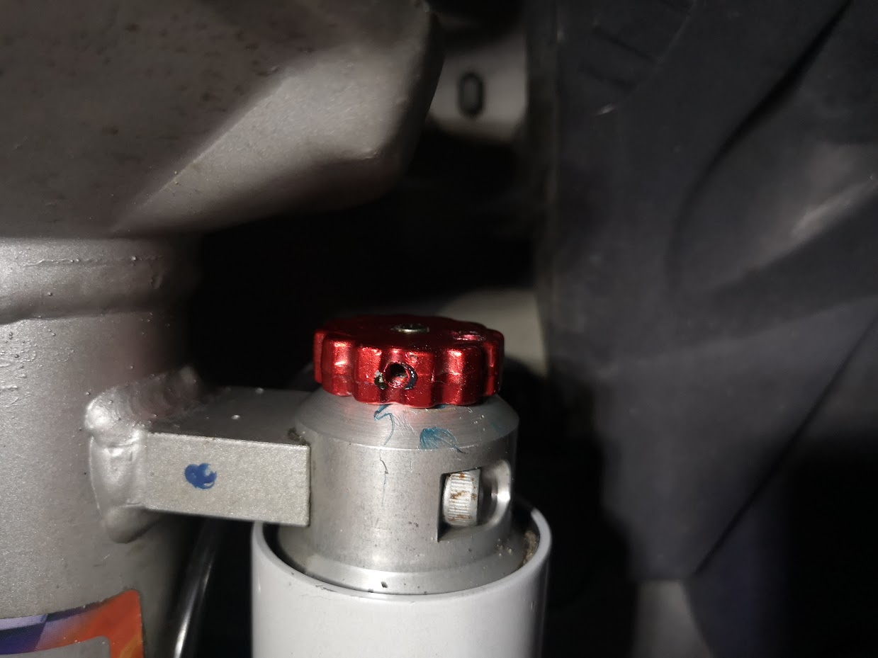

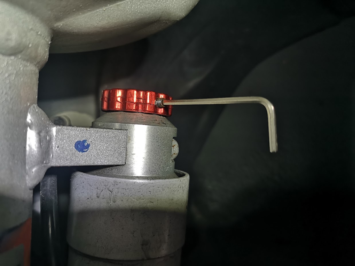

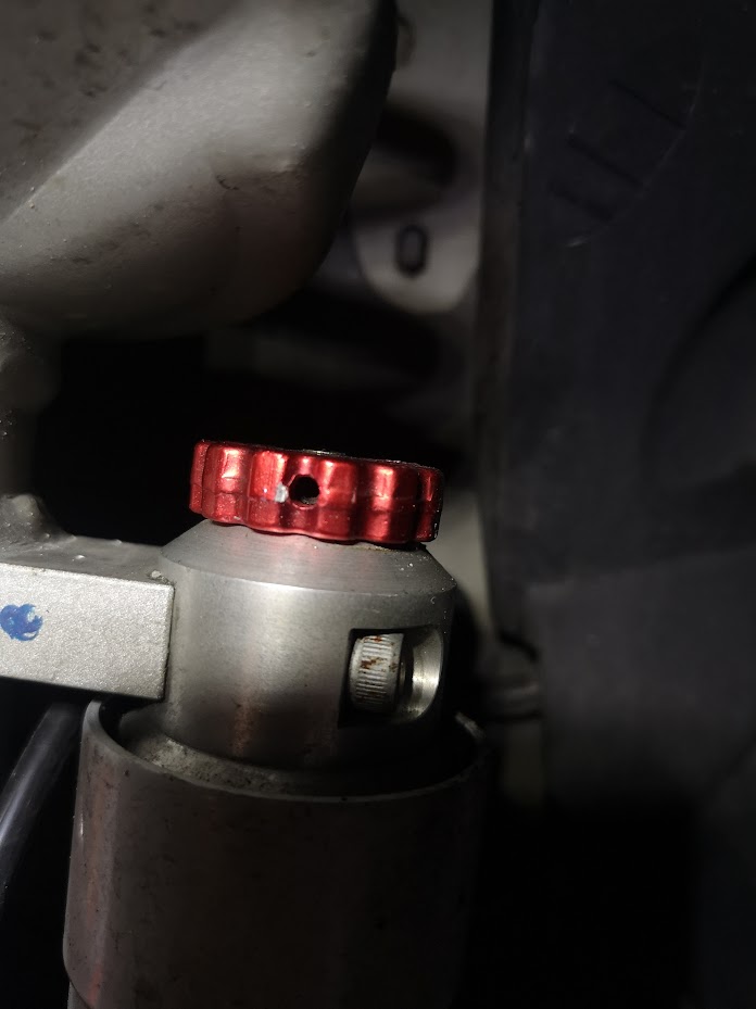

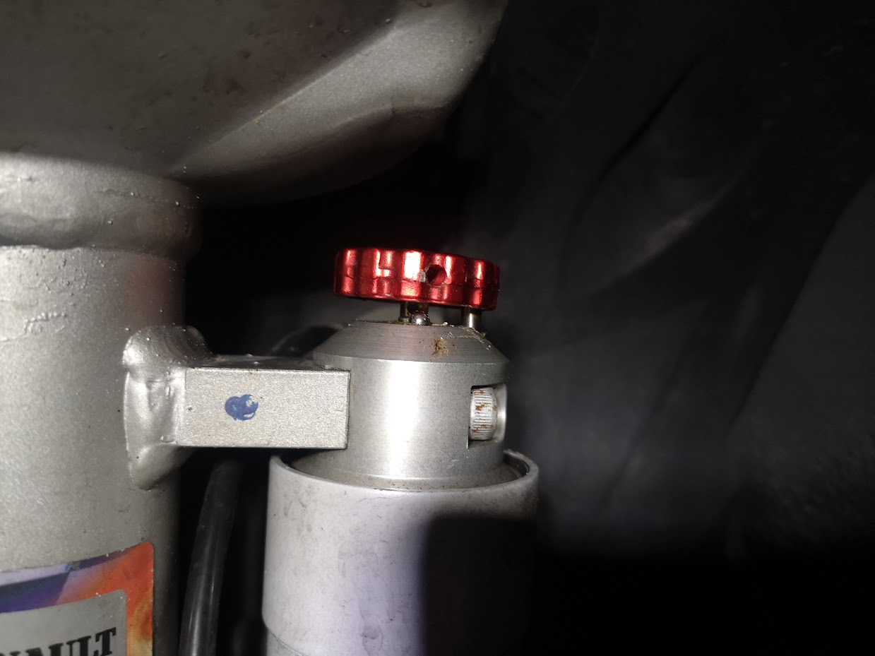

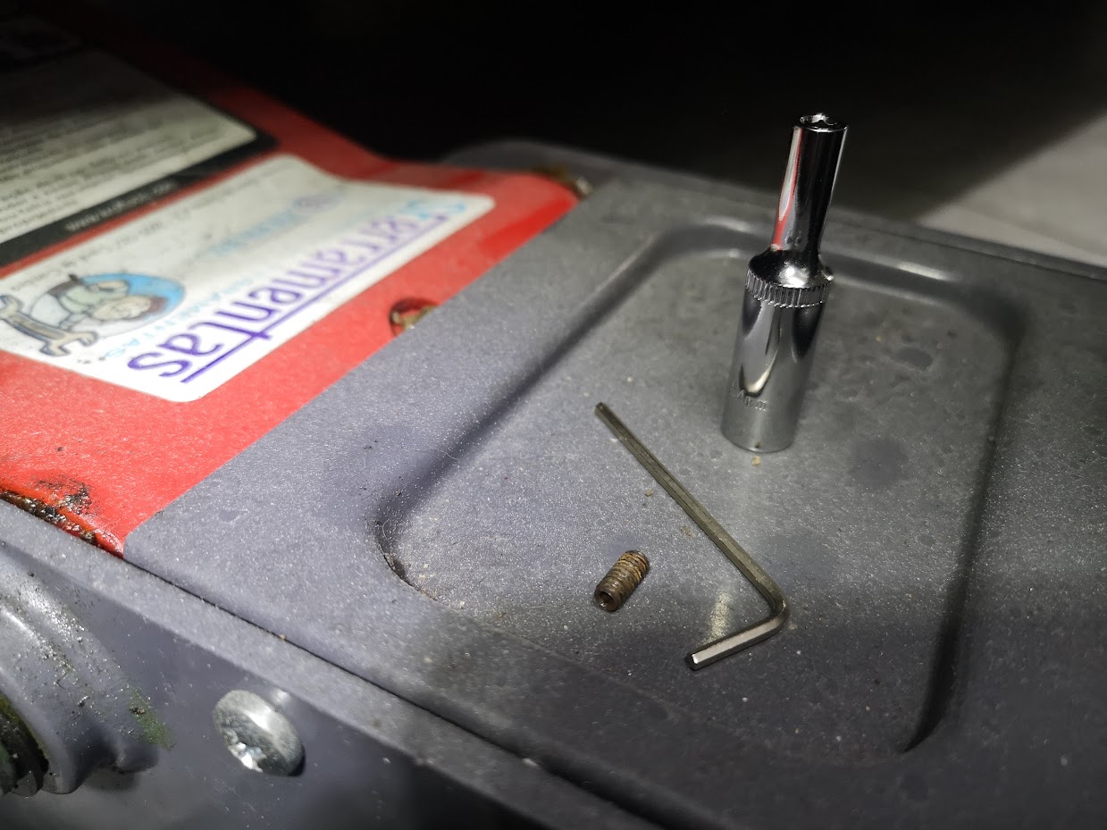

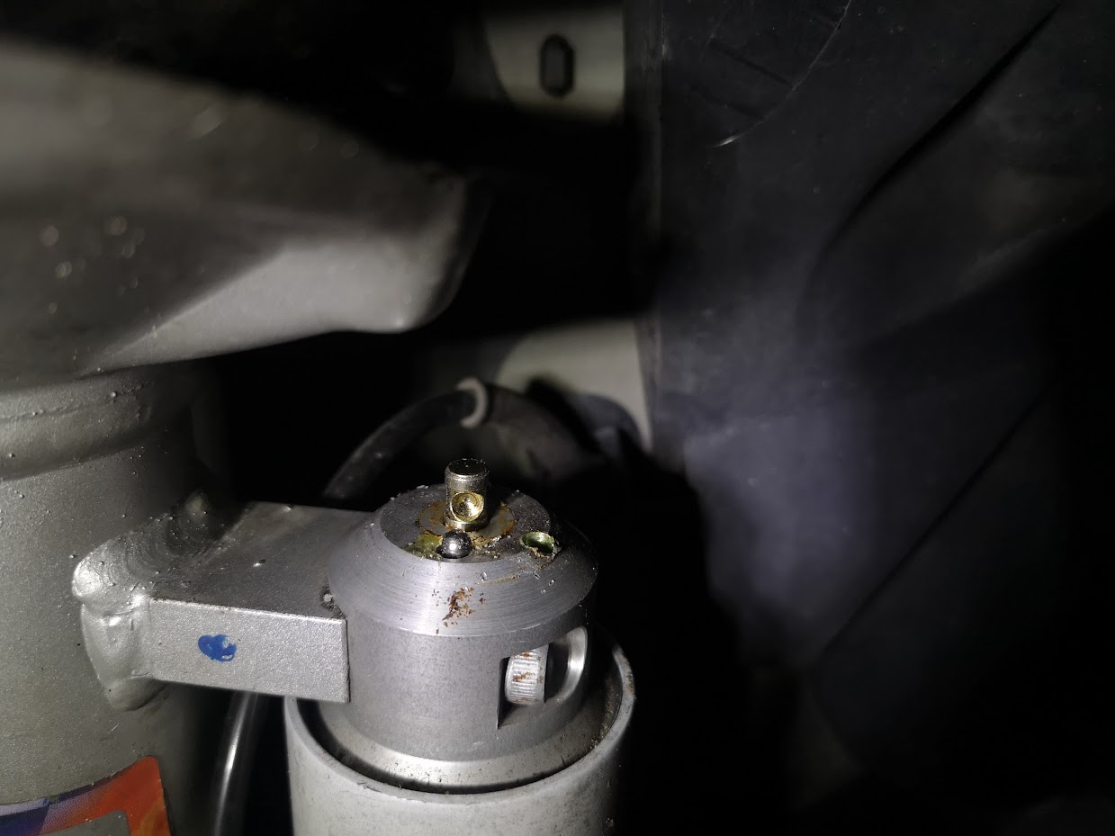

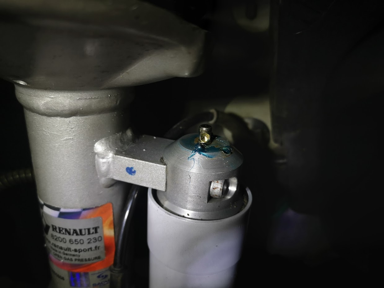

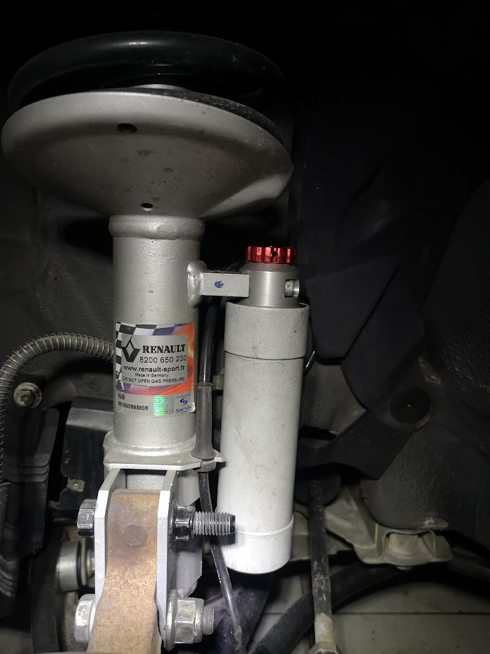

Decided to remove the locking pins of my Sachs. Due to the state of the roads in my area (Worse and worse every year despite the tax always being higher year by year) i decided to turn the damping down a little bit.
General view of the shock
The locking allen screw
Removing it using a brand new Key
Bolt removed
Removing the adjuster being careful
Everything exposed and in need of a good clean
Everything cleaned, lubed and ready to install
Then went for a big drive, and settled with -4 clicks face to stock. It´s perfect for these road right now .

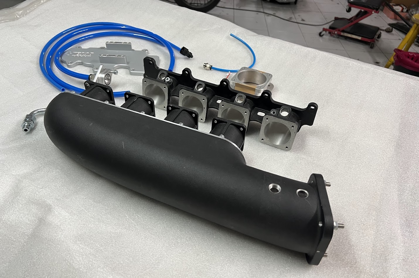

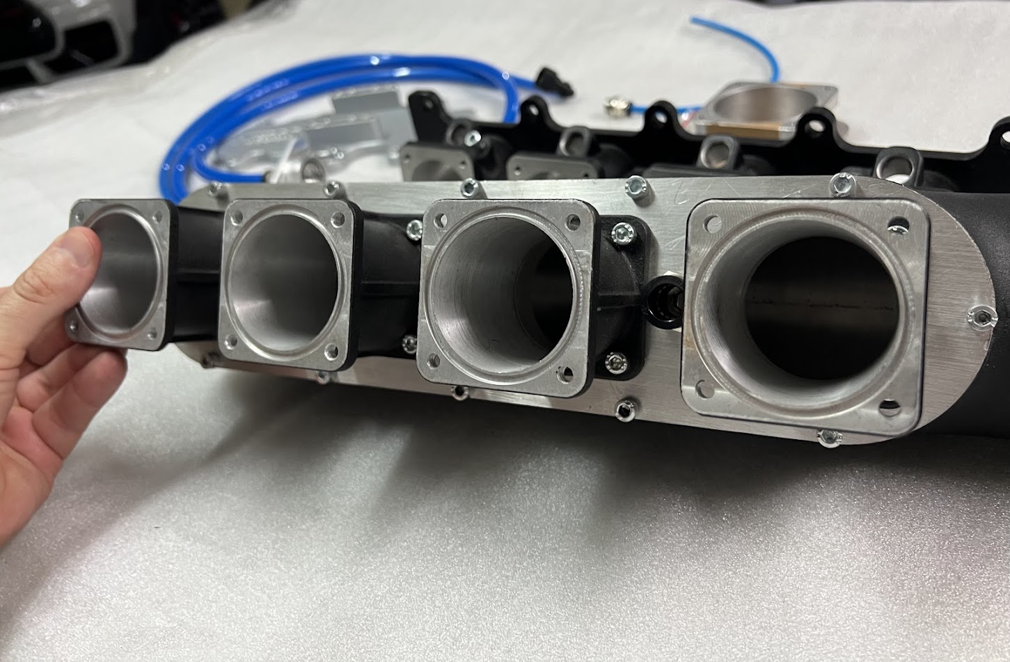

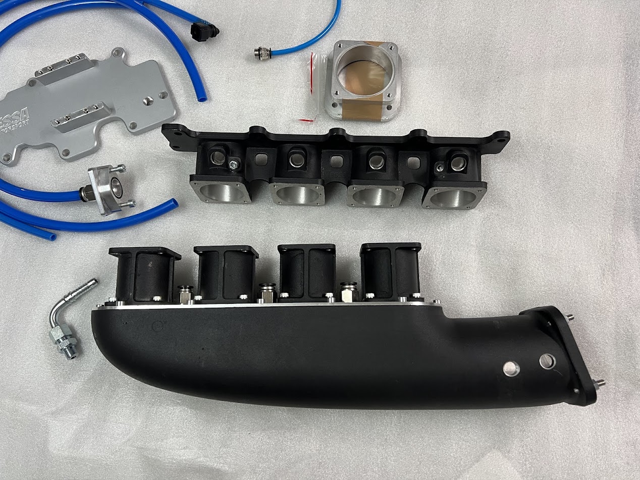

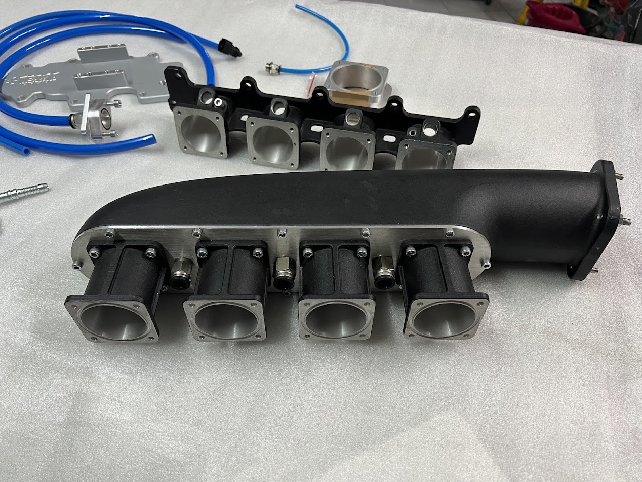

Now , to install this on the car i need a intake manifold.
Anyone selling a RS2 or Tessa Intake?
Hello guys,
Managed to buy a new Tessa for the Clio as I wanted.
Regarding the Clio, has been stood still for the last 4/5 months in the Garage . At the end of this moment will starting installing the new engine and will keep this updated.
