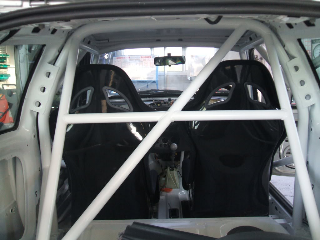

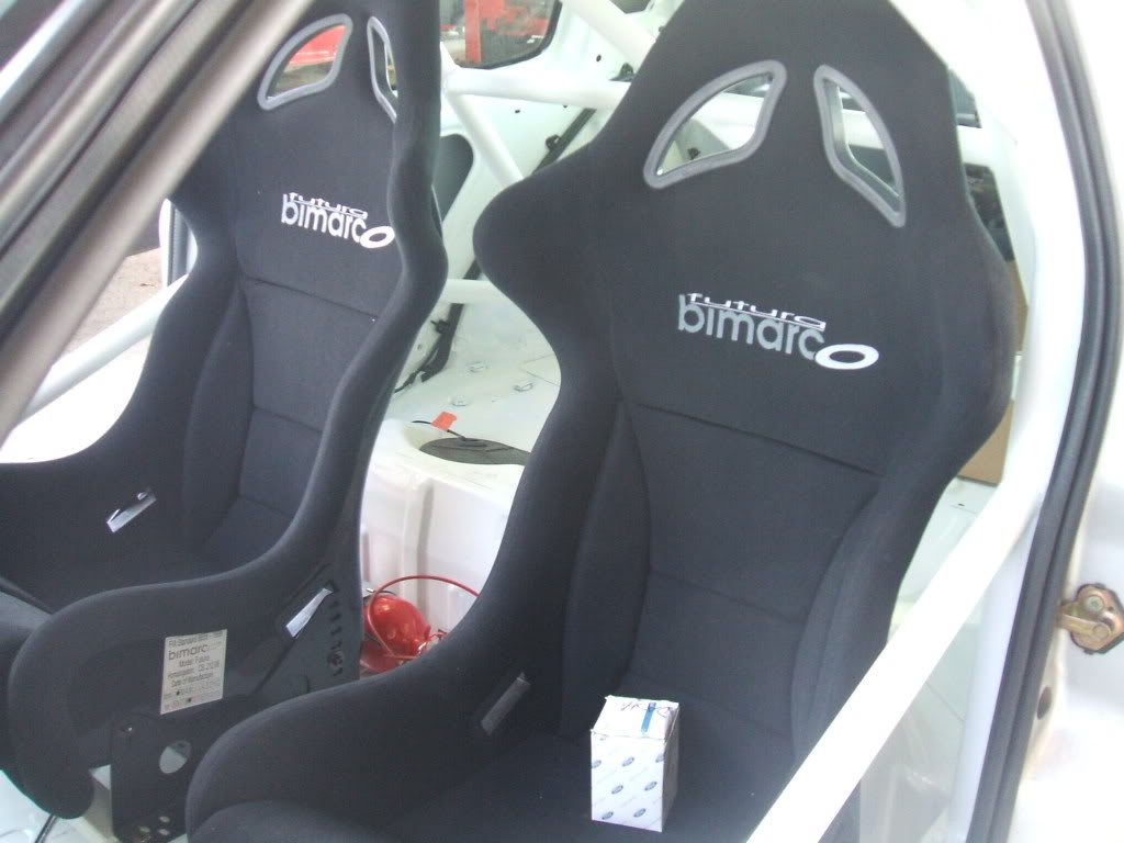

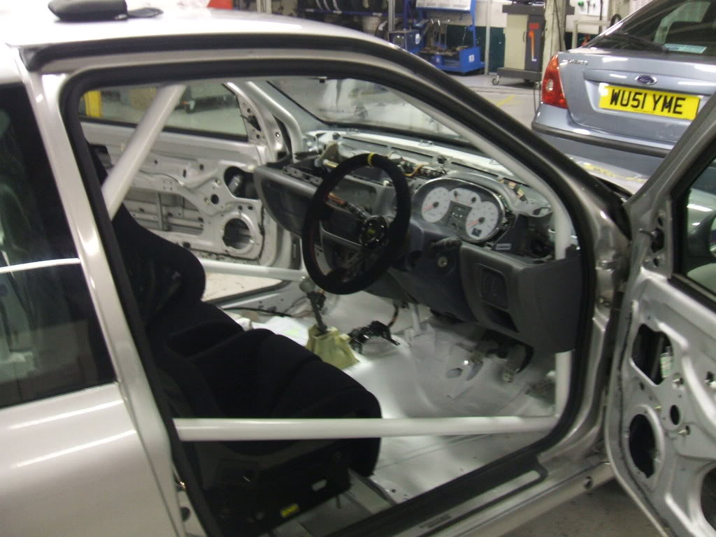

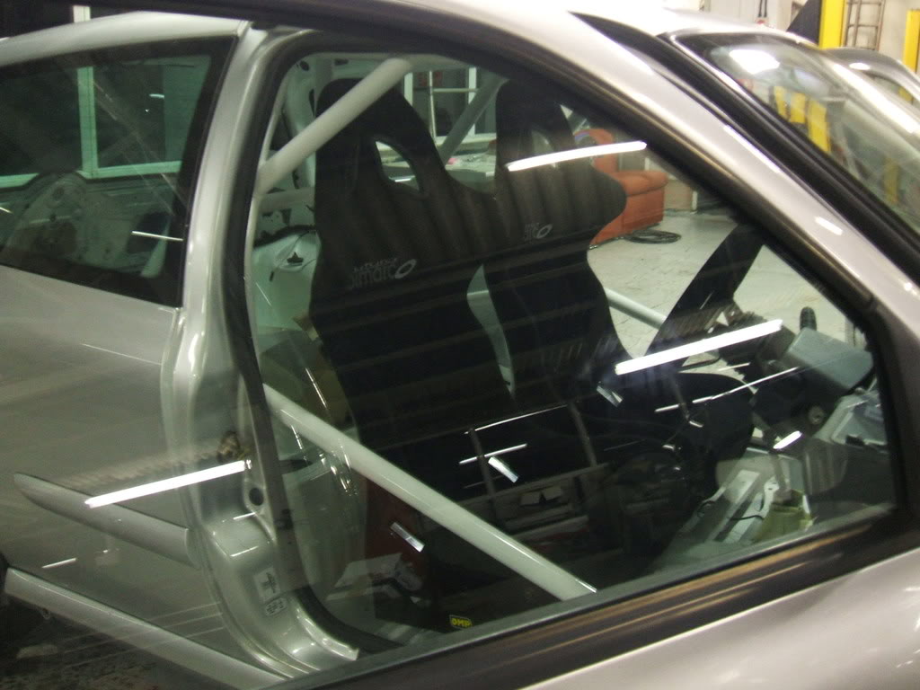

Went to London last weekend, and collected the race seats. Really pleased with them, but they fit completely differently to the Sparco seat that I used to place the seat rails, so will probably need to make some mods here to get them exactly where I want them. Hope nothing needs re-welding, as I obviously don't want to burn off all that nice new paint!

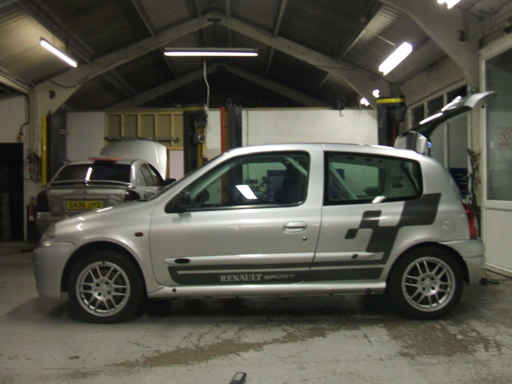

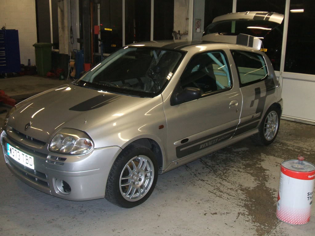

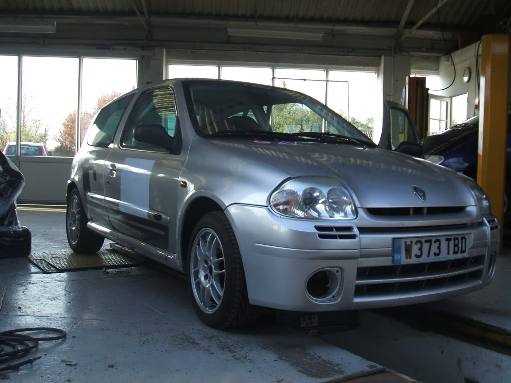

Controversially, picked up a set of Clio R3 rally car graphics off eBay. I realise that some will hate it, but the whole set cost £25, and covers some small dents on the roof from fitting the cage. Anyway, I like em! :rasp:
Starting to look like a rally car now! Just got to get the door squares and mud flaps on to complete the "look"!

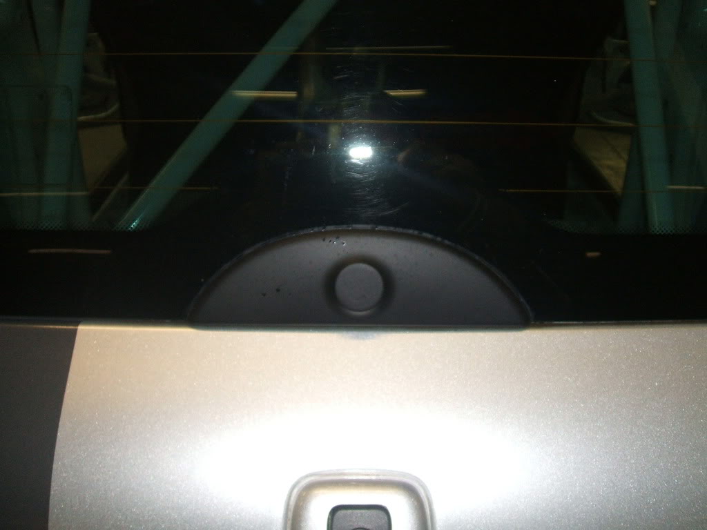

Final recent editions to the car are a suede OMP steering wheel, and a modified rear wiper blank.

what have you used for the blank?
Filled with plastic filler, then fibreglass filler, then polyester filler, the painted with "Plasticote textured satin black" from a rattle can. Looks pretty factory, which is what I was after.

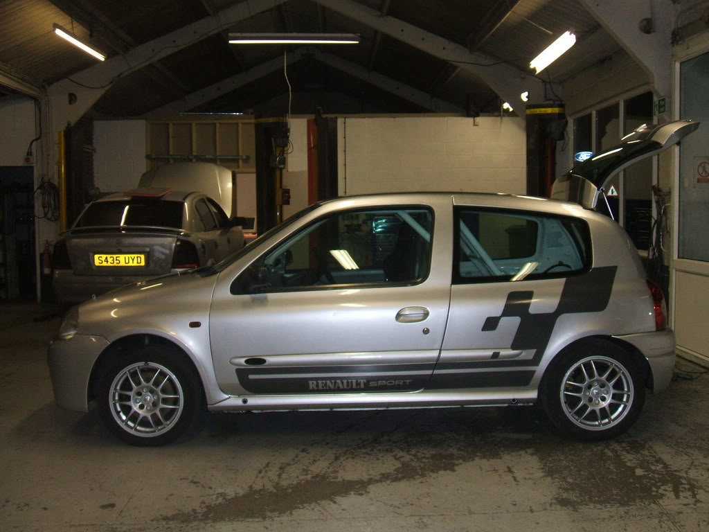

Spent 2 day over the bank holiday weekend on the car, and a few evenings between my last post and this one, and accomplished alot...

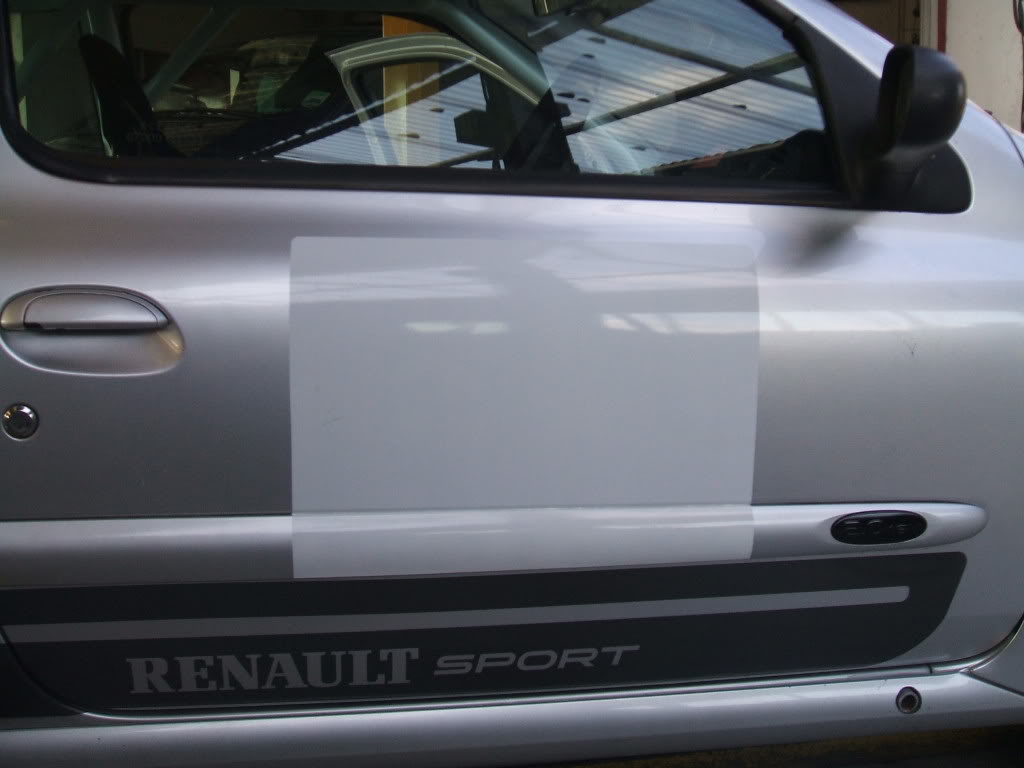

Applied the Renault Sport stripe to the offside, and both door cards:
Took the door rubbing strips off and painted the section where the door square sits in gloss white.

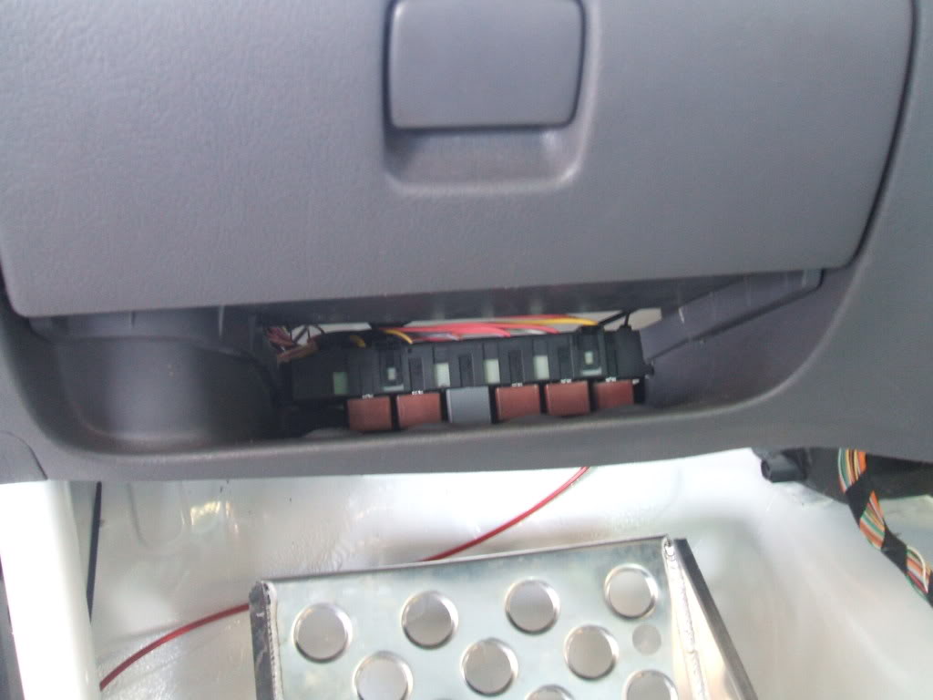

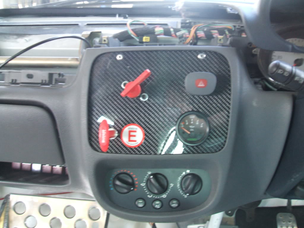

Mounted the UCH in the now false glove box:

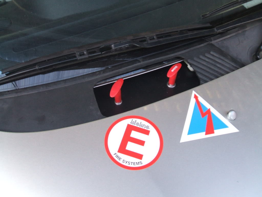

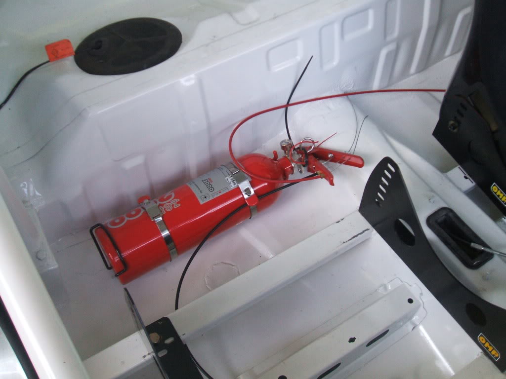

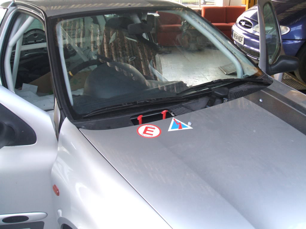

Next job was to mount the 2 pull cables for the battery master switch and fire extinguisher:
Had to fit these through the retained heater box, which meant taking it right out and stripping it down. At least it meant I could remove the A/C matrix. Took the box out and back in 5 times before I was happy with it!

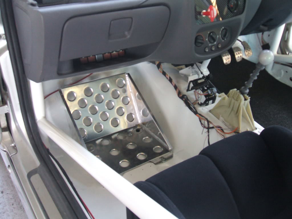

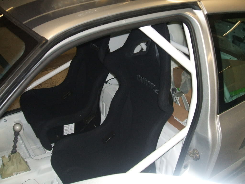

Next job was to modify the seat rails that I had welded in before it was all painted. There was no way around it, the MIG welder had to be used to burn all the nice new paint off, and weld in more metal. :(
Thought about it, and with some carefull planning and some demon fabrication, we managed to weld in 2 new bits of box section, without damaging much of the paint. The area was then primed and painted so that you would never know! When it was dry, I then bolted the seat in place:
With the seat in place and adjusted to suit, I could then mount the co drivers foot rest. Again, this took ages to fit correctly, as the floor is decidedly not flat! Got there in the end though:
Next up, the dash centre... I had bought a small piece of Carbon sheet to use to replace the area where the radio and centre dash vents used to be. This area would then be used for the oil pressure guage, the hazard warning swith, the battery master switch, and the internal pull cable for the extinguisher system.
Don't get too excited though. Only the pull cable works at present. Got to move the battery to the boot, and run new cables to the switch before the cutoff will work. Also need a sensor for the guage too.
Before I fitted the drivers seat back in, I then mounted the plumbed in extiguisher, and attached the 2 pulls. Still need to run the extinguishant lines to the pedal area, and to the engine bay though.

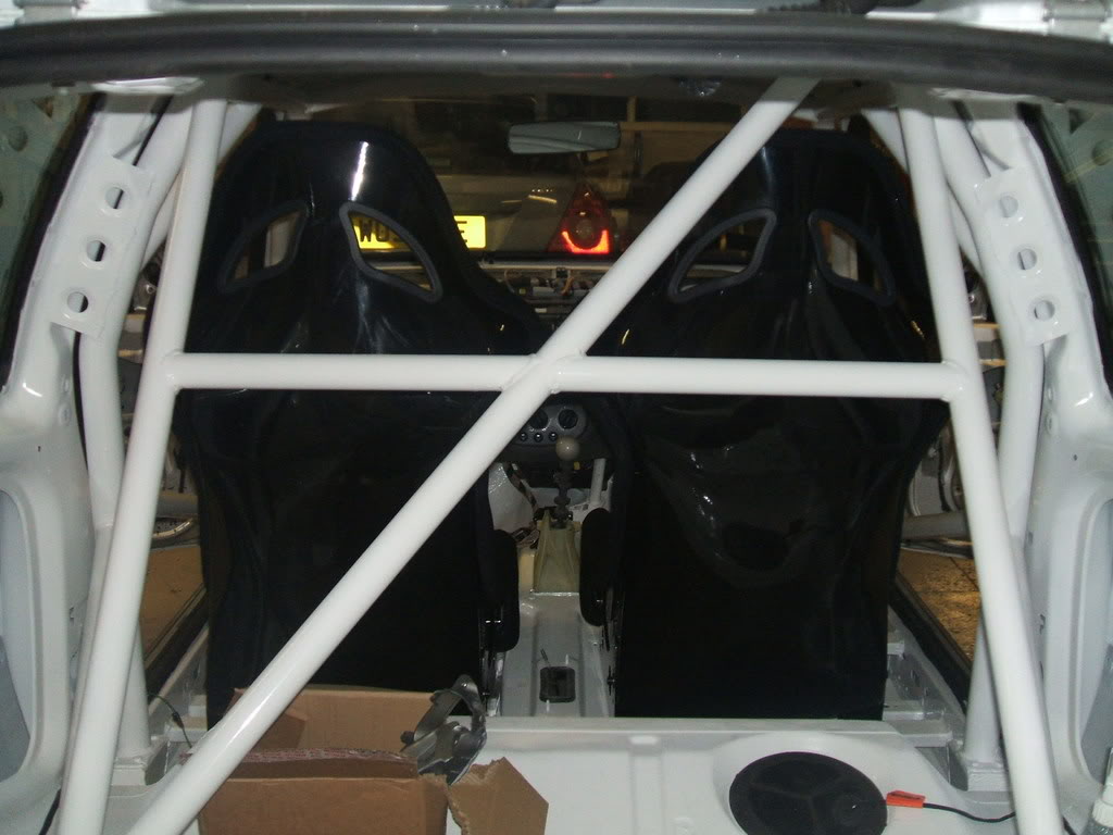

How it stands now:
Starting to look like a car again!

check with a scutineer about your cage mountings as i have just finnished a historic spec sunbeam and welded my cage in like yours it was a bolt in one the same as yours he would not give the car a MSA logbook as the cage should have been bolted in and not welded :mad: so i had to drill and bolt the cage before he would log book it .yet my mk1 clio was no problem as the cage for that was a propper weld in one , also the seat rails should have mounting plates on the ends where they mount on the floor
sorry if this is bad news for you but i would hate to see you get the car (which looks mint by the way) finnished then get it knocked back on a log book and you have to pull it all apart again to correct it like i had to

What do you mean about the seat rails? A strengthening plate on the floor where the seat rails join?

yes mate you need to weld a plate to the tunnel and the innercill where the rails are going i made mine about 1"bigger alround than the rails weld them in then weld the rails to them (abit like the cage mountings)

Yes I agree mine has a small plate on the sill side, just cut a peice and simply weld round to make it look right, can't see it falling.

you need them on both sides of the rail now also if its not logbooked yet you will need fia dated seats and clear safety film on the side glass(like window tint but clear) all these came in on 1/1/2009 for new build cars

The seats are brand new and FIA approved. Wouldn't have bought anything else. I also knew about the window film. Not sure wether to film the standard glass, or replace with perspex. Pros and cons to both. :S
Think I'm going to try and get the car log booked as is at the moment, and see if I can get it through. If not, I will have to burn more paint, and weld the plates on.

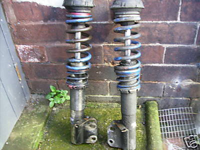

Won some FK coil overs from eBay on the cheap. Been told that they are FK Highsports:
One of the inserts is buggered and needs replacing, but thats ok as I only bought them for the bodies. Going to try and replace them with Bilstein inserts instead, but if that doesn't work I can always get a pair of new FK inserts for £185 all in. Are they any good?
Going to get some new longer springs too, to get rid of the helper springs. Don't need them to go super low anyway. What spring rates would people who compete in their Clios recommend? The car will only be used for single venue tarmac events, and I try to steer clear of anything too rough!
Any help will be greatfully received!

Do you know what the springs are now?
  RB 182 Cup
Not sure... About 200?
at a guess 250 tend to run 350 on mk1 track cars
That seems really high. A mate of mine was running 240's on his Corsa rally car.

Doesn't look like the Bilstein inserts will fit... Diameter of Bilstein insert is smaller than the FK's. Would mean getting a sleeve machined to fit them, which won't be cost effective. :(
How good are FK's?

^from what i have seen they are ok to lower car and thats about it tbh :dead:
