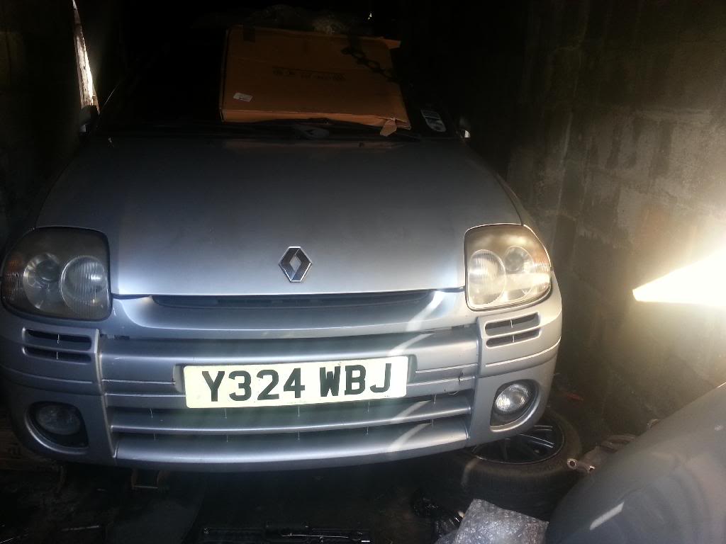

ph1 172 cup
  phase 1 172

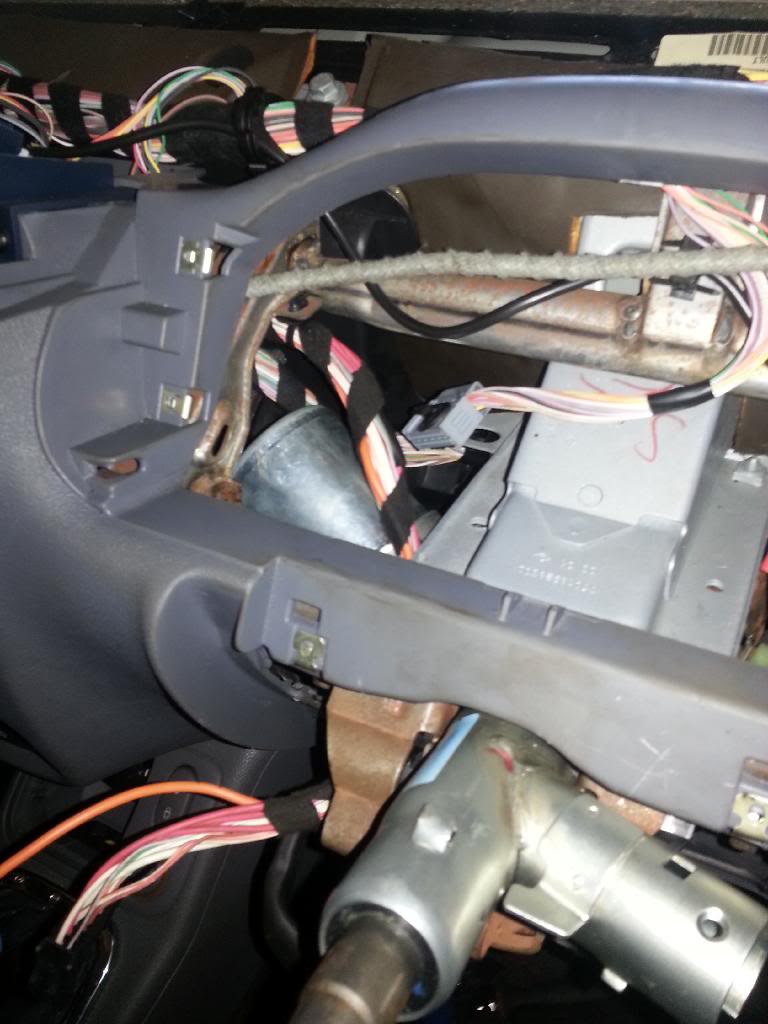

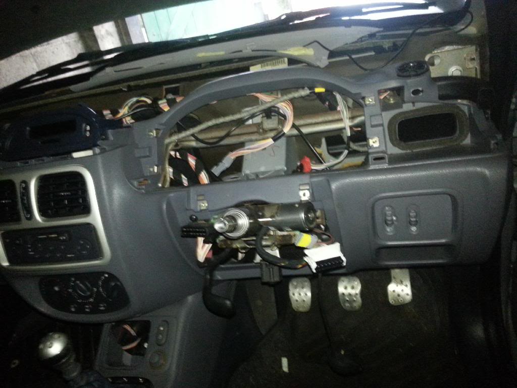

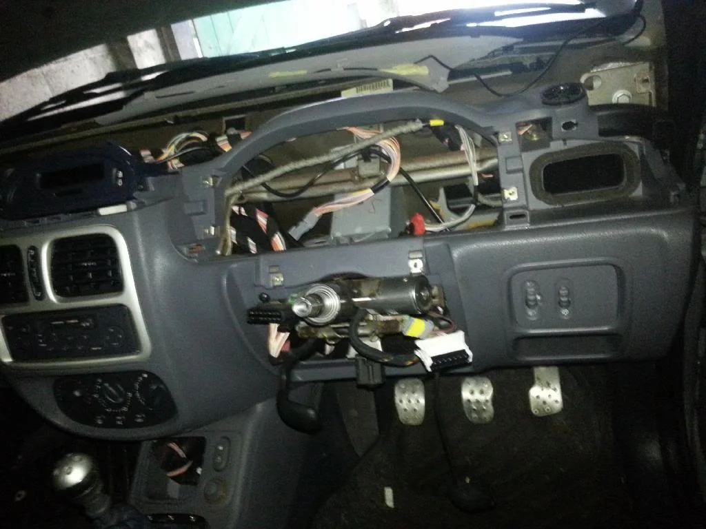

Got the dash out and the columns ready to remove

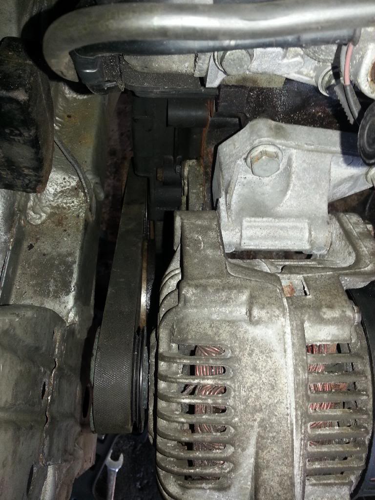

set away removing the aux set up and have had a few shite bolt related issues but progress is being made slowly
Its still got its undertray which suprised me and found the renault service sheets

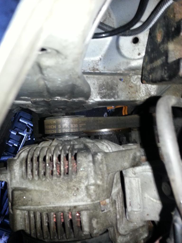

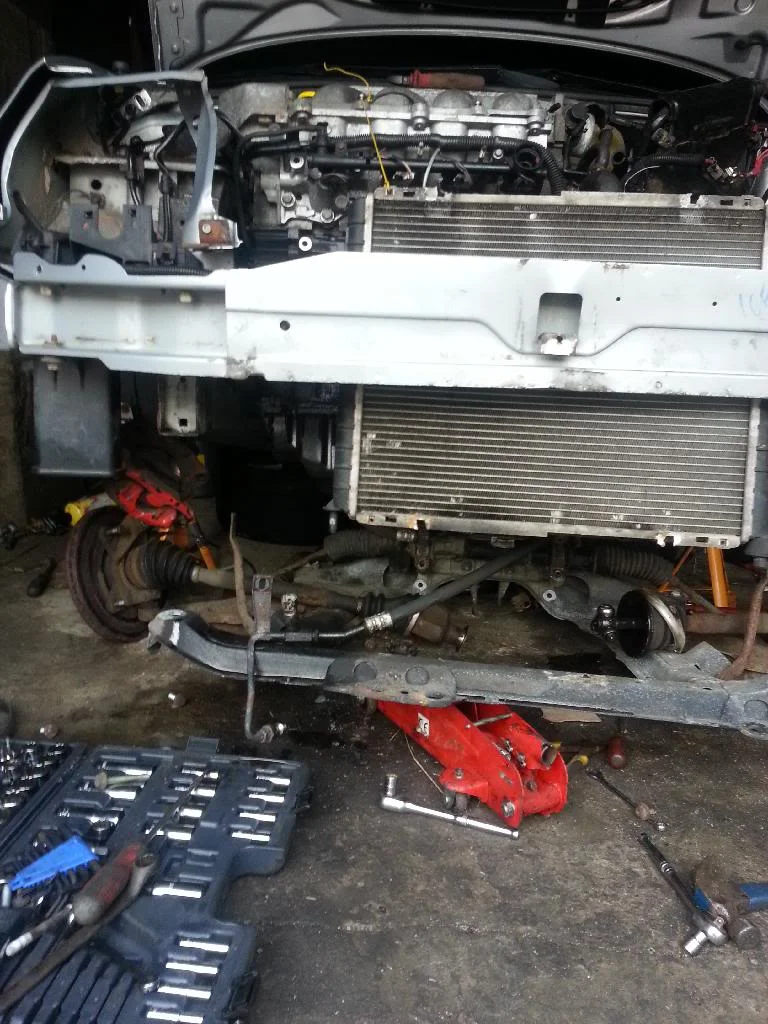

tomorrow il get the rest of the aux set up out and drop the subframe

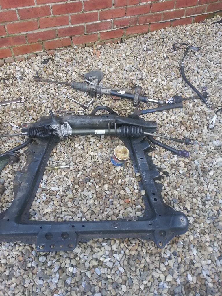

  phase 1 172

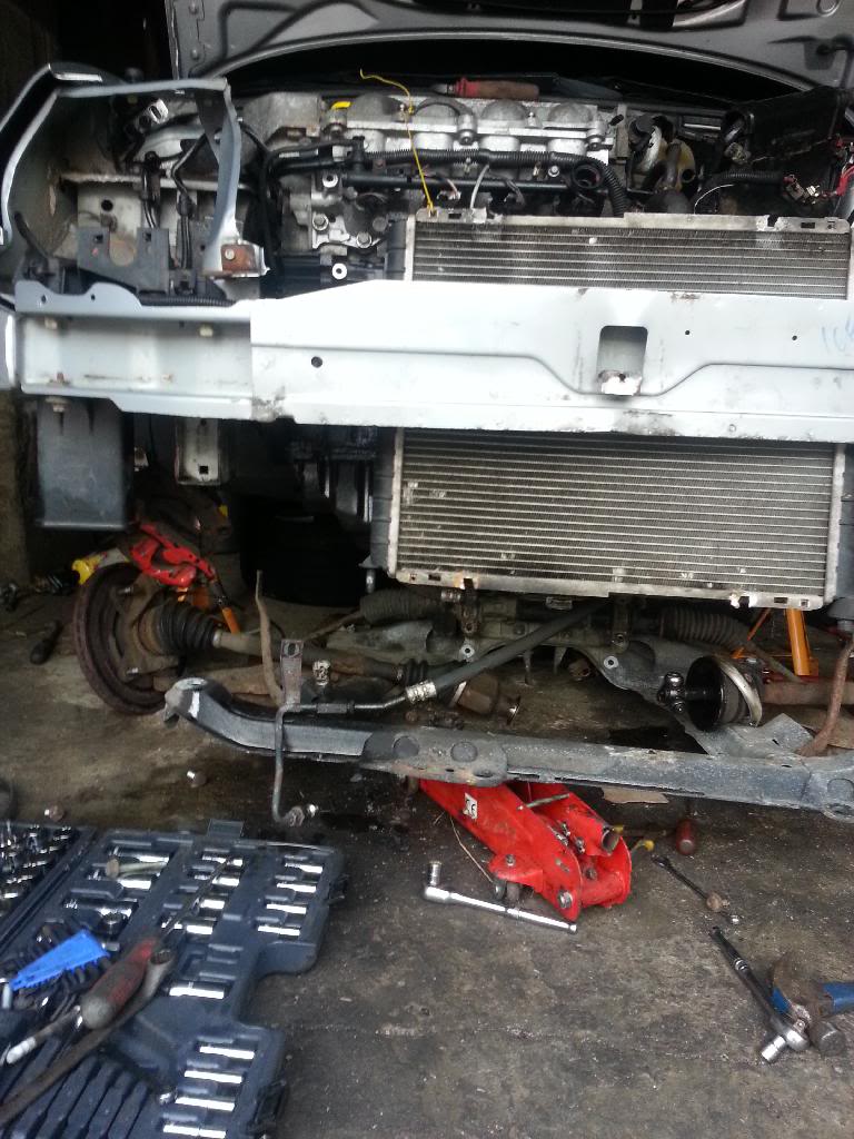

Subframe off completely now,rack and pas pipes/pump all off all thats is left is the exhaust-the bolts pissed me off so i give up for the day,drivers seat (so i can get it.to.get the column out) and the column

Really annoying me this now,daft things delaying the job all the time

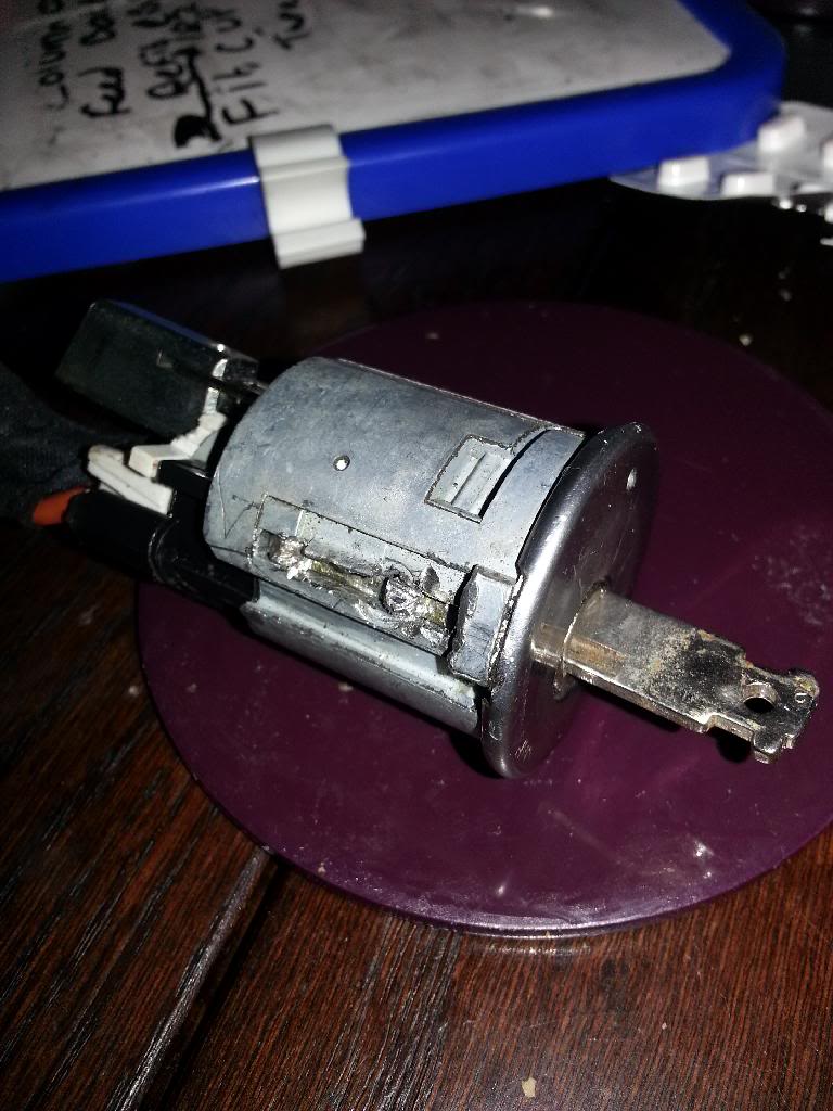

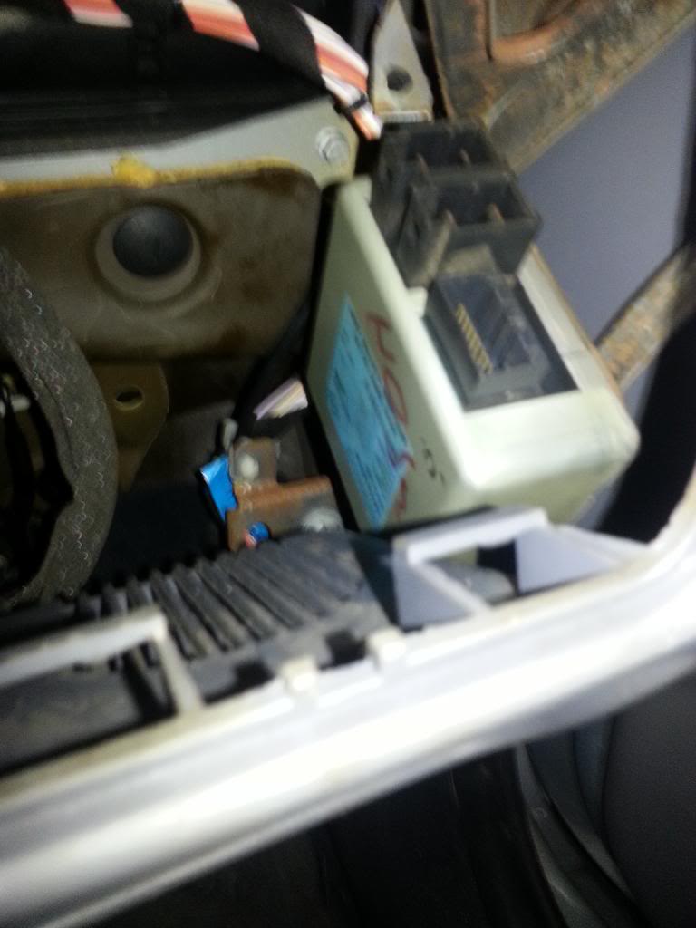

i should have know it wasnt going to end well since the keys been stuck in previously before i started trying to get it out the column
  phase 1 172
Iv got the column from the cup still so if that comes out ok il have a barrel and blade

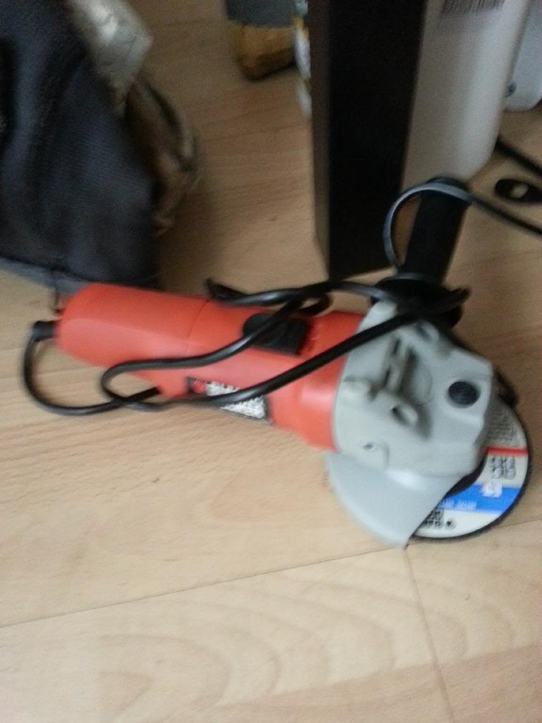

the issue im having is if i cant get that blade out i have no physical key for the doors so if the fob fails or the cars battery goes im doomed
Il see if it can be cut open some how

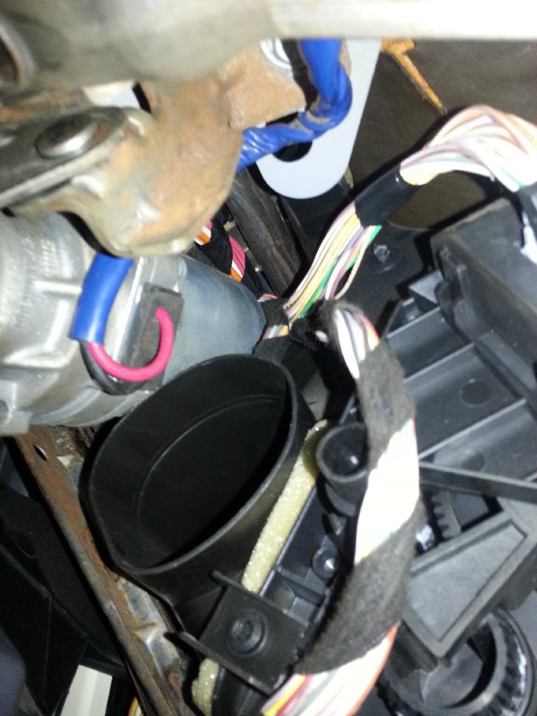

Quick update,the epas rack is in,damn thing took ages to get the motor in its bulky,had to split int in 3 and build in situ
problem i ran into was the airvent pipe ran right under the colunmn so it had to come off,hopefully itll refit or itll be blocked off to avoid overheating the motor

i managed to get the key out the origonal barrel so.i wont need to break in to.my own car lol

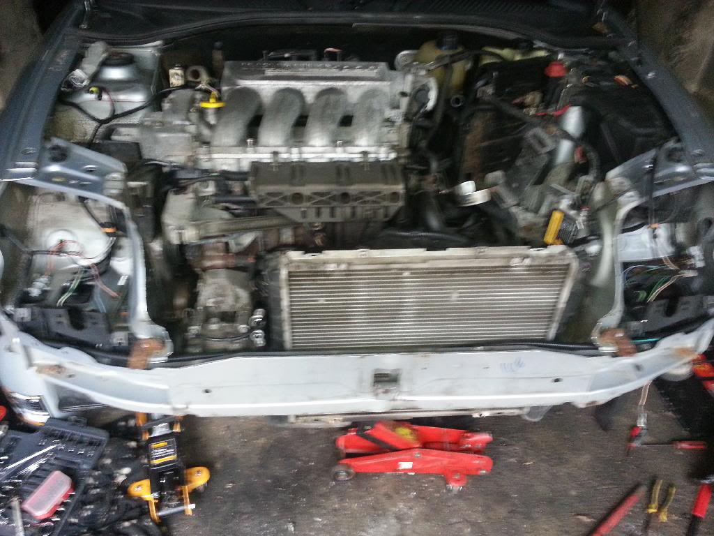

  phase 1 172

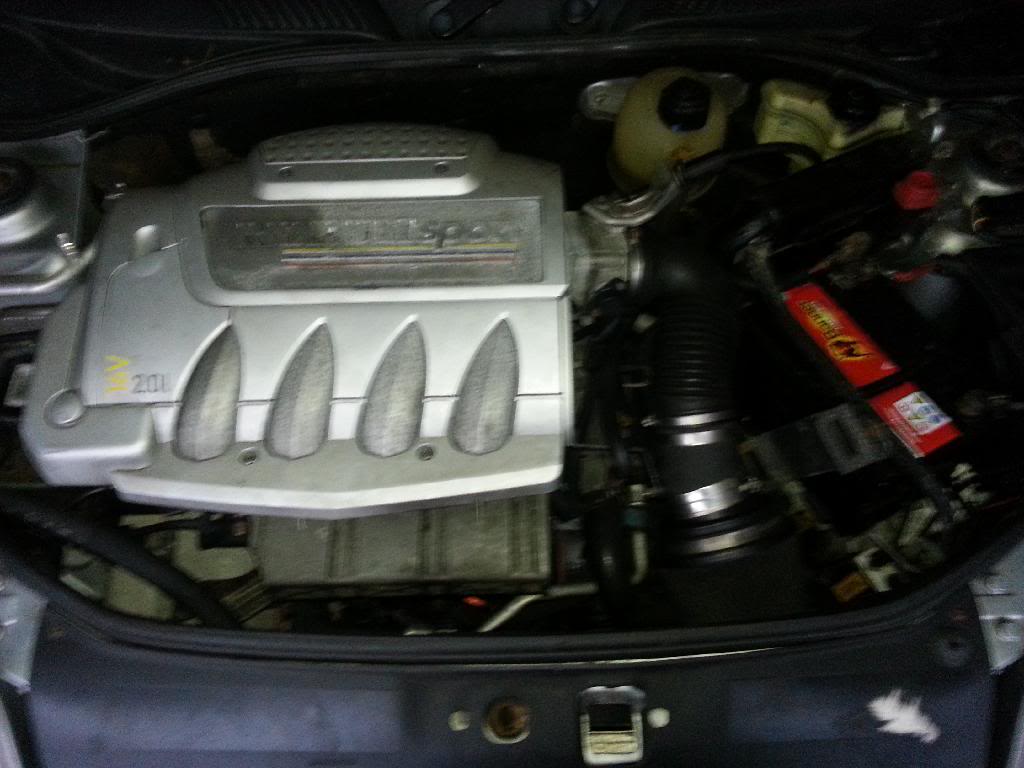

182 mani now on,dci mounted to the cup subframe and the new aux set up
hopefully get the subframe up and rack/column joint tomorrow

looka like il have to block the heater pipe off,the pipe needs to be right where the motor joins the column-not a huge loss but a lil irritating
awaiting some 25mm2 cable to reroute the battery into the spare wheel and the epas and cup conversion is done

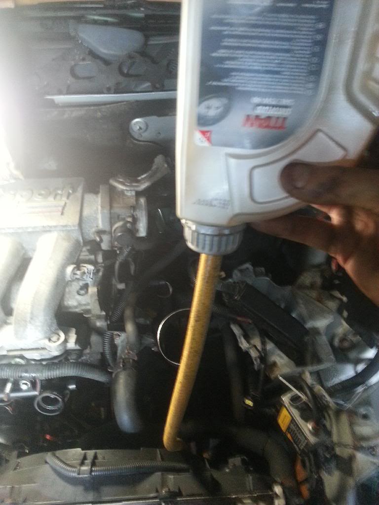

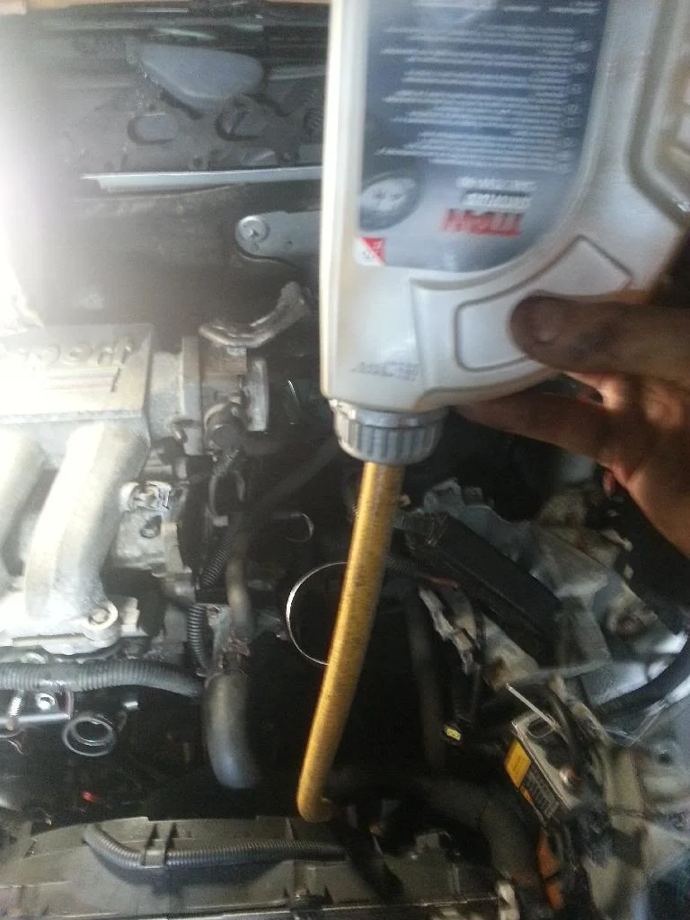

More specialist equipment
hopefully keep the box lubed nicely
Swapped bonnets over aliminuim now on and it looks like a car

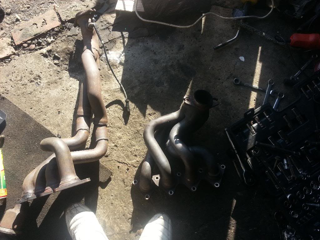

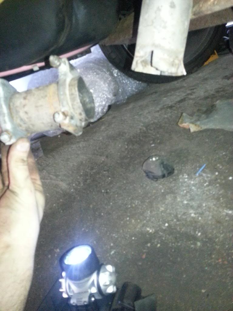

All was going swiftly and nearly ready for test drive,fee lil bits to go on and this has stopped me dead
that was supposed to link the 182 mani straight upto the back box and its got the the end chopped off

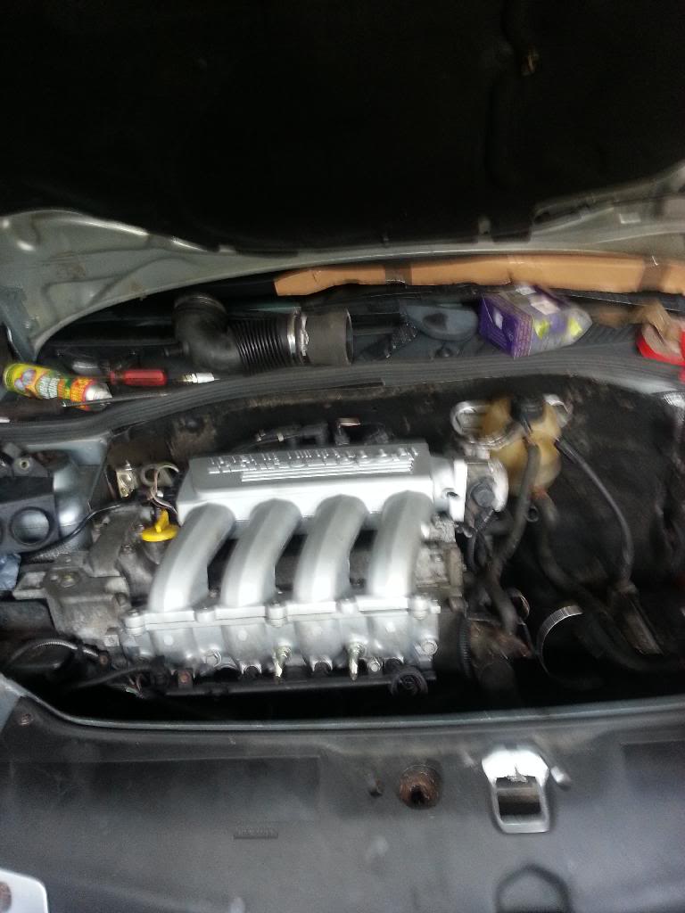

Matched inlets upto gasket-the ph1 inlets are a pi55 poor match
changed plugs while i had the inlet off

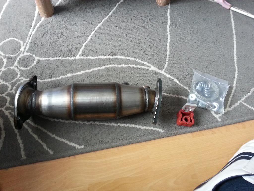

order a ktec sports cat,fitting kit and mount so hoprfully il.have it running this weekend

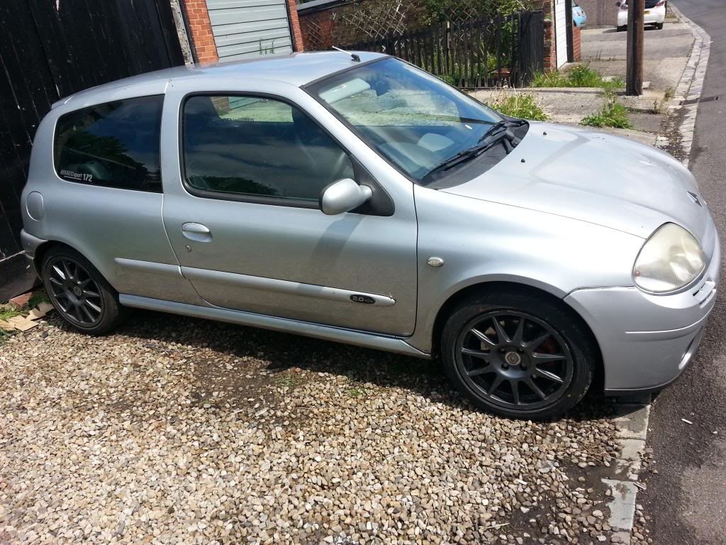

give it a good wash since its nice and i had a few hours to kills
just used the pressure washer and a bit wash n wax since it was covered in fly s**t i didnt get a chance to test out my new electric car polisher-always just done it the old fashioned way so god knows how its going to turn out
i maimly bought it to tidy up the headlights-i tried a 3m kit on a spare aet from.the cup and they looked better before i started lol so i was just going to.lightly polish them hopefully remove a bit of the dirtsy stanied look

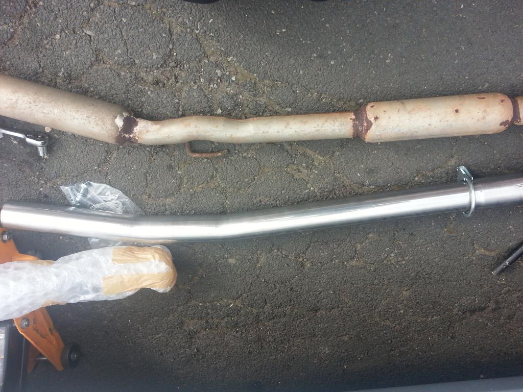

the old catback was pap so it had to go,ktec stealth supersport
