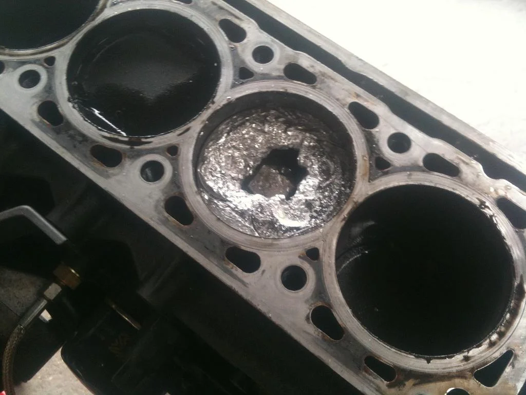

was doing a track day at Mallory Park today and it looks like the bottom end of my 172 went bang. Horrible noise then no power. Visually you can't see any problems but the engine will not turn over. Only done 20 laps!!

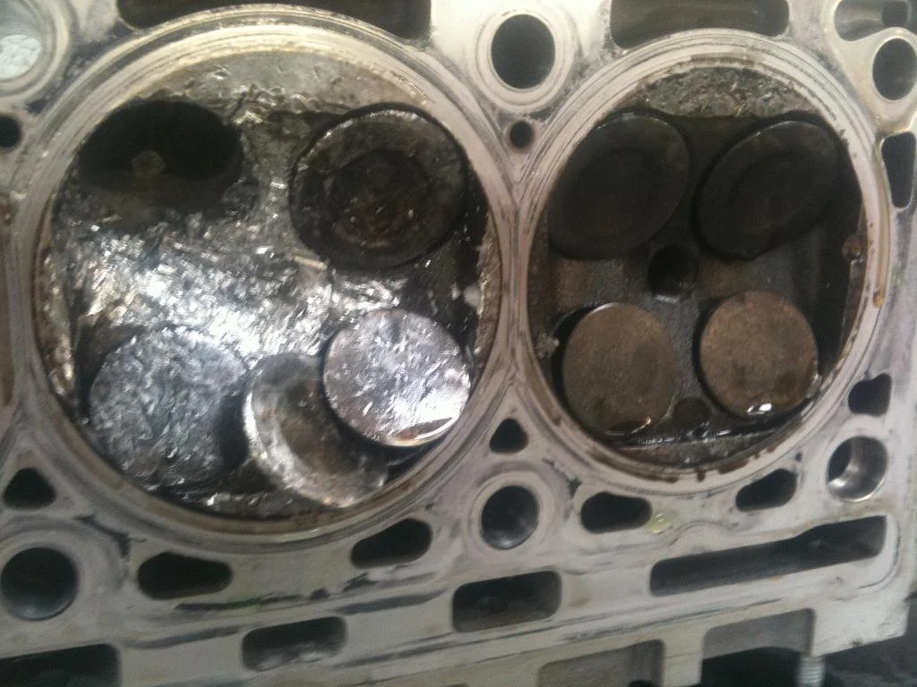

So, confirmed last night the engine is dead. Seems a valve dropped at high revs and destroyed the piston and head. Still looking for a good engine.. unfortunatey I missed out on Whiteley's! Any idea if a phase 2 172 engine will fit the car? Seems there are a few more of these about than phase 1's.

I had just come out of the hairpin at Mallory park, just gone up to third gear and was doing about 6500 revs and getting ready to change up so not long at all.

I also spoke to Ktec and they said there is a technical bulletin about valves dropping in high reving 172 engines. I did a quick forum seach and came up with nothing. Anyone heard of this before? Seems this is what happened with mine!
