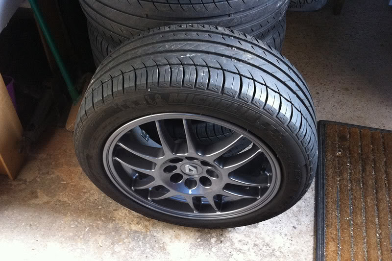

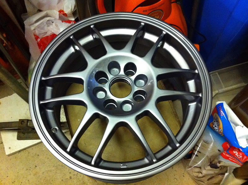

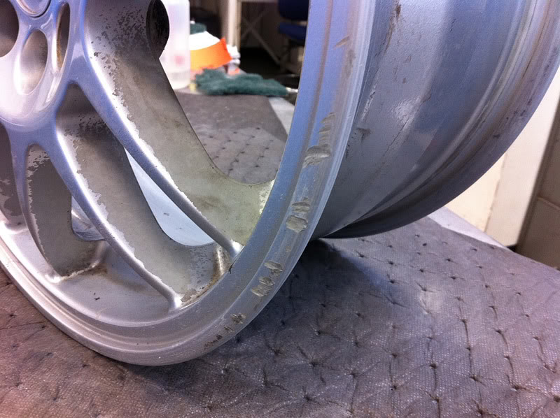

Starting with the wheels, looking a bit sorry after all this time.
The picture is how the wheel looked straight off the car! Remaining paint was rubbed back, high spots filed down then gouges filled DIY with 'chemical metal', then sanded smooth (took two fill / sand passes) finally sent for a lick of paint at the bodyshop, painted 205-110 GRIS METAL FROID-MET.
Turned out nice !

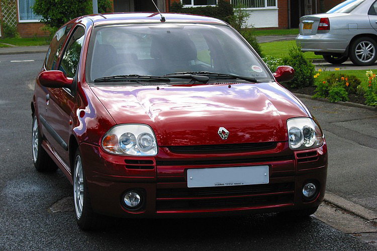

Ok, I should have at least started the thread with an old pic :)
Here she is eleven years ago

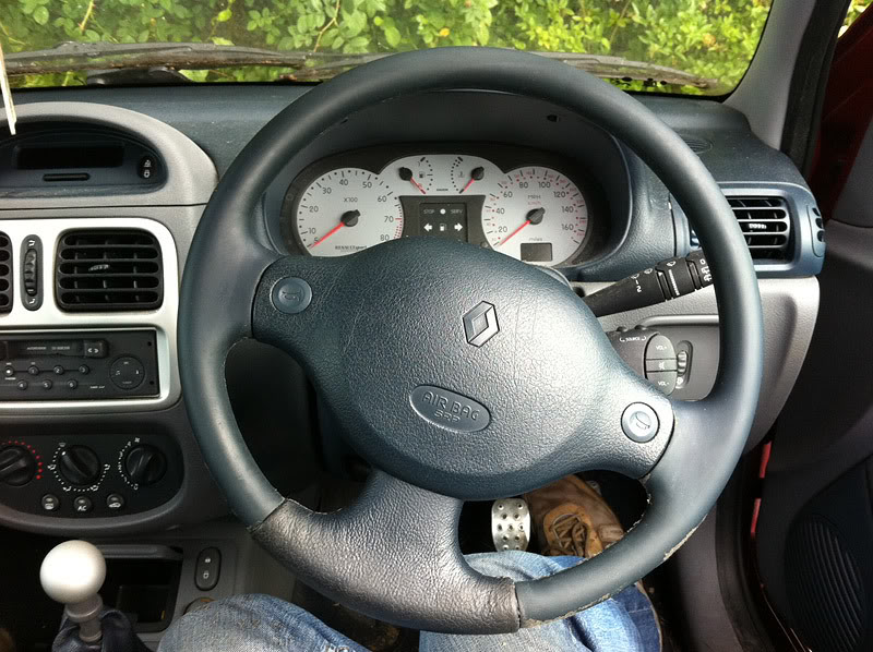

Also done the steering wheel, obviously wanted a lovely retrim but I'm putting the money into other parts of the car first so I went for a de trim instead :)
last bits of gule have been removed now, not too bad for now.

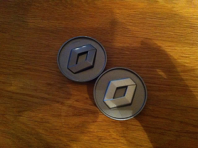

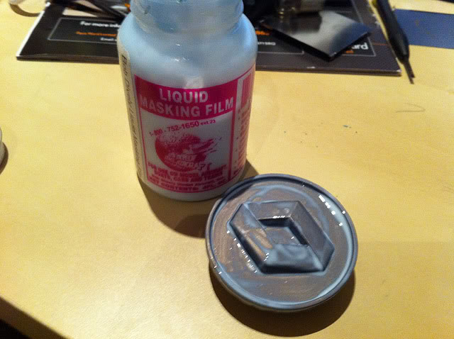

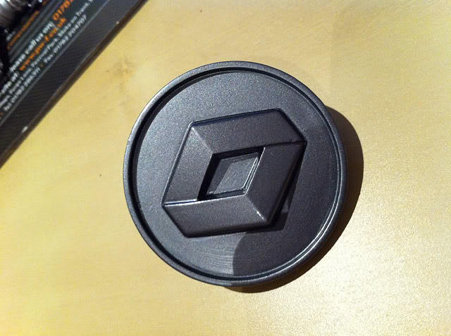

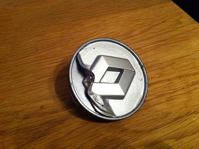

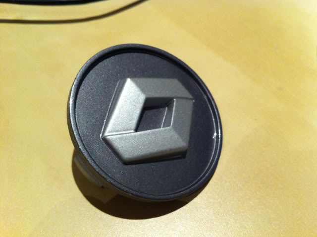

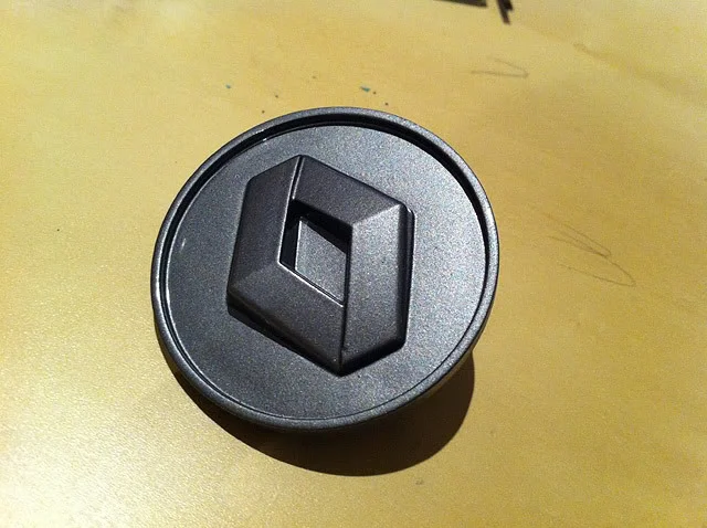

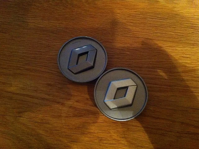

Just a finishing touch on the alloy centre caps. I really wanted the diamond to be silver on the centre caps, the cap is one piece so no way to remove the diamond and I wanted to do a neat job. So I used some liquid mask fluid.
Cap from the paint shop

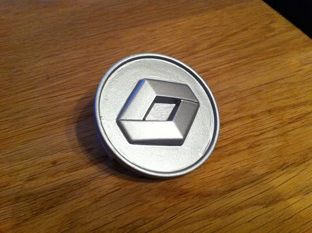

Liquid mask going on
Diamond cut out after drying (two coats of mask were used)
After spraying silver
Mask removal
The finished article
Before and after
I did toy with the idea of getting some chrome paint but I just used what was to hand and Im happy with it, I like the contrast it brings to the wheel, cant wait to get these on :)

Never seen that liquid mask used before, where you get it from? Might use that myself when I do mine
You must be the oldest member and lowest poster in one lol
Lol, I think your probably right on the post count bit :)
Best colour on a ph1 no question.
This is the stuff I used but it doesnt seem to be widely available at the moment
http://www.amainhobbies.com/product.../13914/n/Bob-Dively-Liquid-Masking-Film-16-oz
If you search liquid mask under 'toys and games' (its designed for masking paint on model car bodies) on ebay there are a few to choose from, Im sure they are all up to the job.

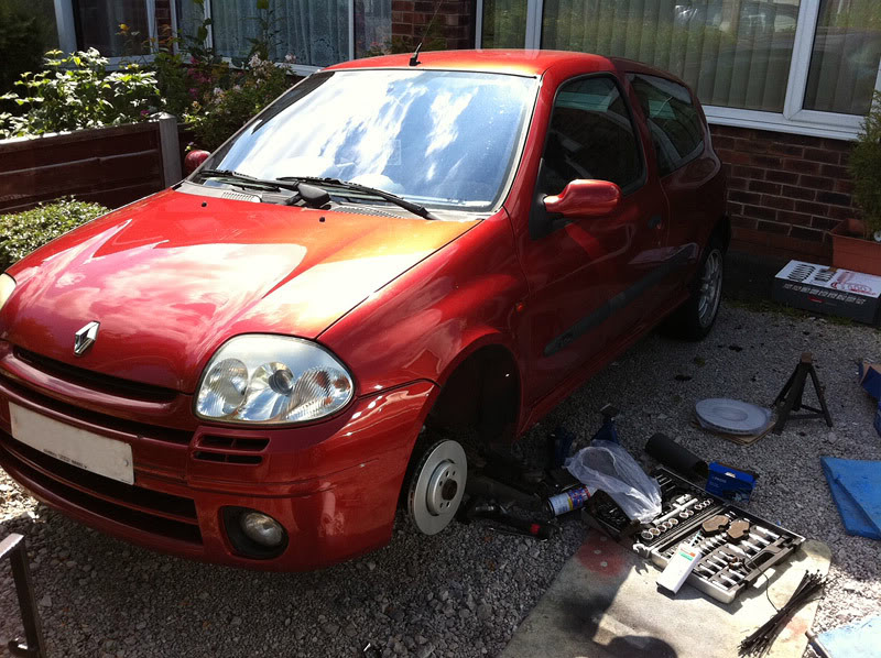

Ok an update, tyres on the rims
News disks and pads, callipers refurbed in silver
brake fluid changed, probably been in a while !

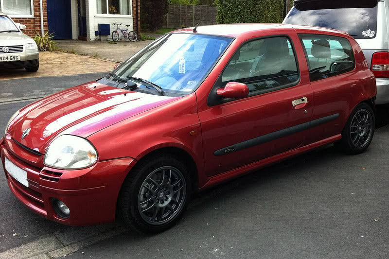

Back on its wheels (door handles and rear bumper away at the paint shop).

Interesting what you've done with the leather on the steering wheel, i've put a cover on mine but i'm not keen on the feel of it. What is under the leather once stripped ? ie plastic, rubber etc...

Have to say, i think silver would have suited the car better again rather than anthracite. But it's nice to see you have your old car and giving it the love it needs!
The wheel is a dense rubber, it feels realy good and looks great, I have not driven with it properly and dont know how it will wear but it had to be better than the crumbling leather ! Stripping the old cover off is easy, jsut pick all the stitching off, but where it meets the section at the bottom you have to cut it with a sharp knife where they are glued together (to leave the bottom bit in place).
I cant say I totally disagree, I got a bit caught up in a change for the sake of, but it will be interesting to see how I feel about them after a while, first impressions now the car is sat on them is I really like them so we will see !

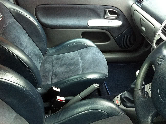

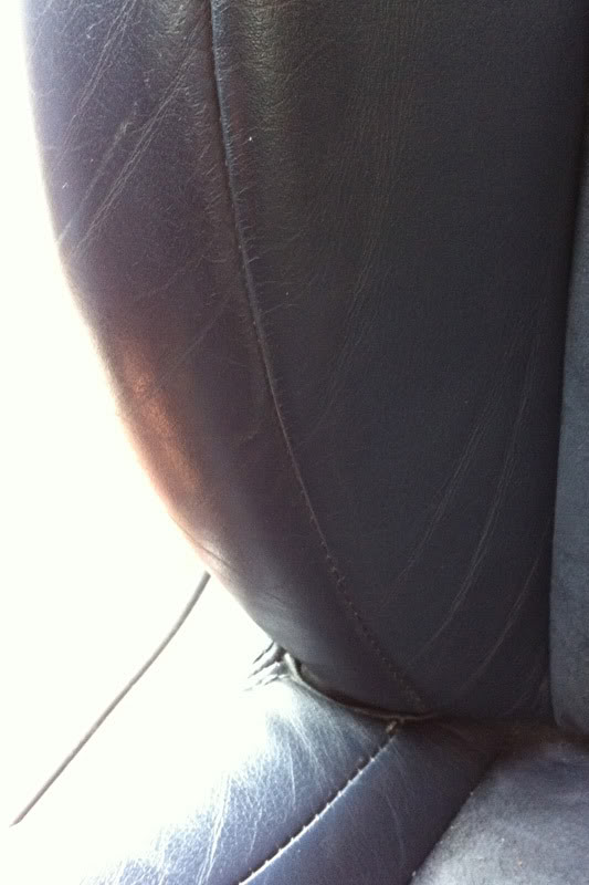

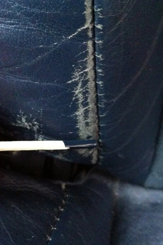

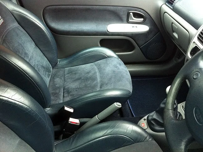

The seats were in pretty good order but had lost a little colour on the drivers bolster. I was put onto the Gliptone Scuffmaster kits by a friend and checked out the website. You can have a sample colour matched at no cost but on the database was a 2000 Clio 'd/blue' leather. I decided this had to be from a 172 and ordered a kit (~£16).
Before
The bottle looked a good match, having applied it I was blown away, a perfect match on 11 year old seats. The small bottles in the kit allow you to lighten or darken the colour, I didn't try / need to.
After
I ordered a set of mats from Ambassador mats (about £25 delivered). I would have loved another set of original mats but we all know that isn't going to happen. I thought black or grey just didn't go well with the blue interior, so took a chance on a navy blue set. I was very pleased with them. (would be even better if the edging was darker)

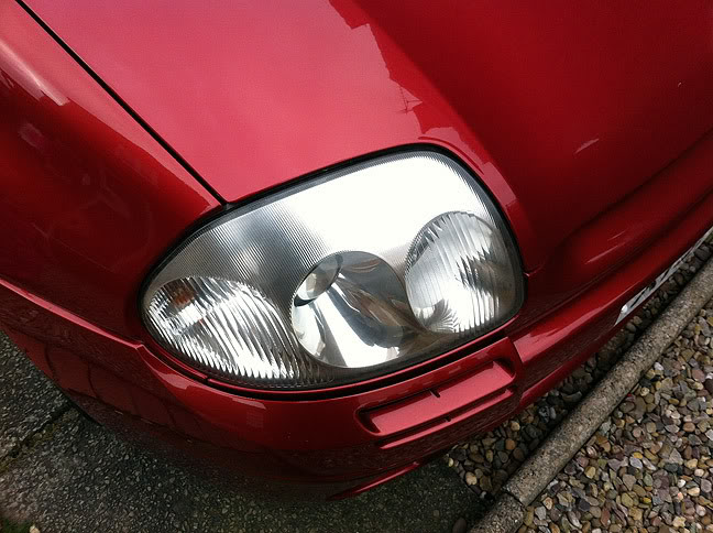

The headlights needed a tickle, I didn't go mad on them (in terms of time spent) but they came up pretty well. If I remember I used 1500 wet & dry followed by some 2000, then used my porter cable DA with some scratch X 2 (I haven't got anything very harsh for the machine) then some meguires #83 DACP.
Before.
After.

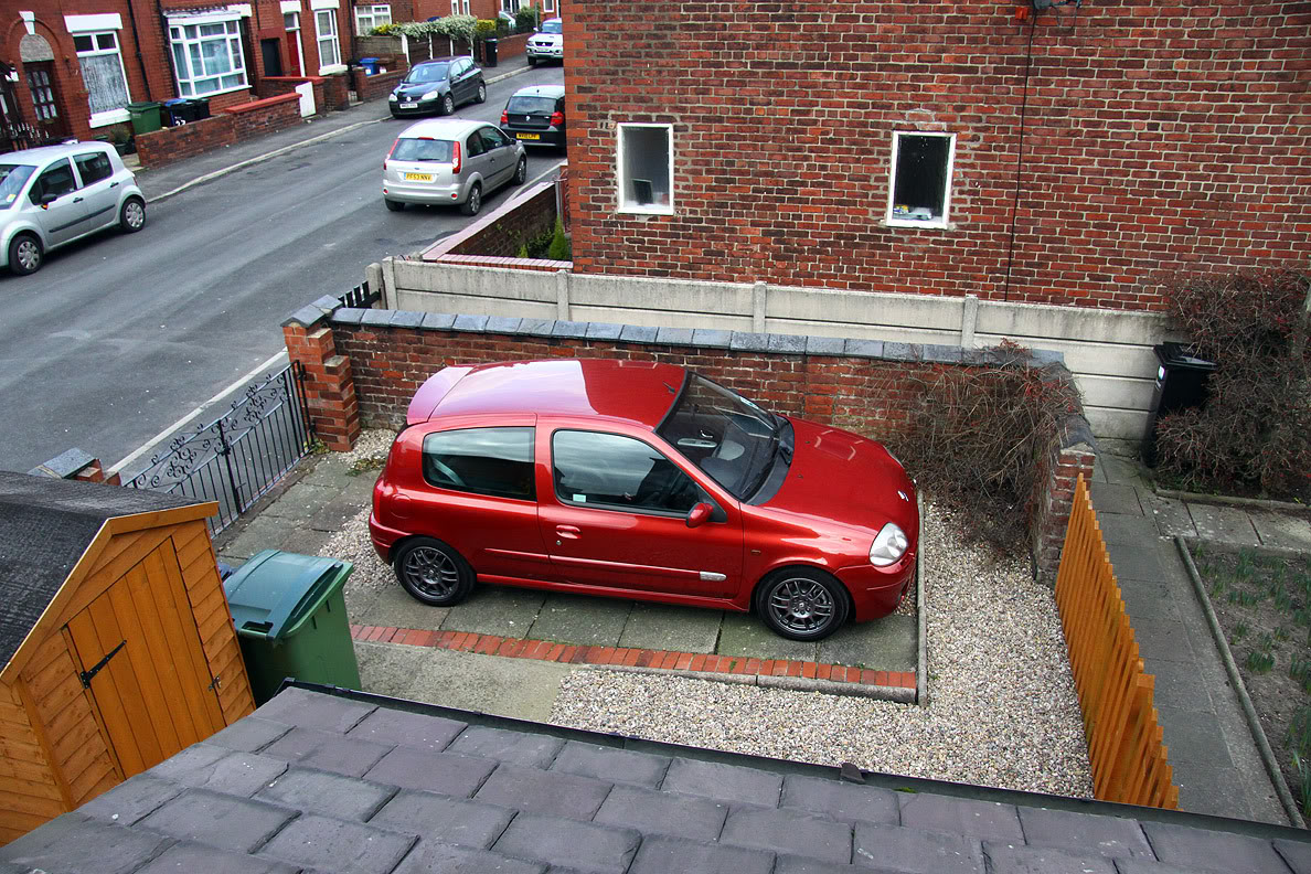

And a shot of where it stands now.

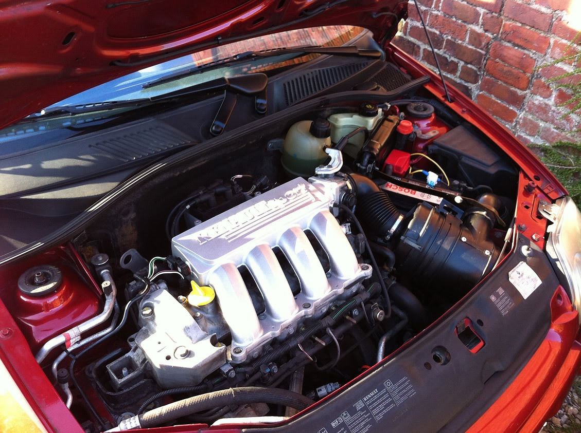

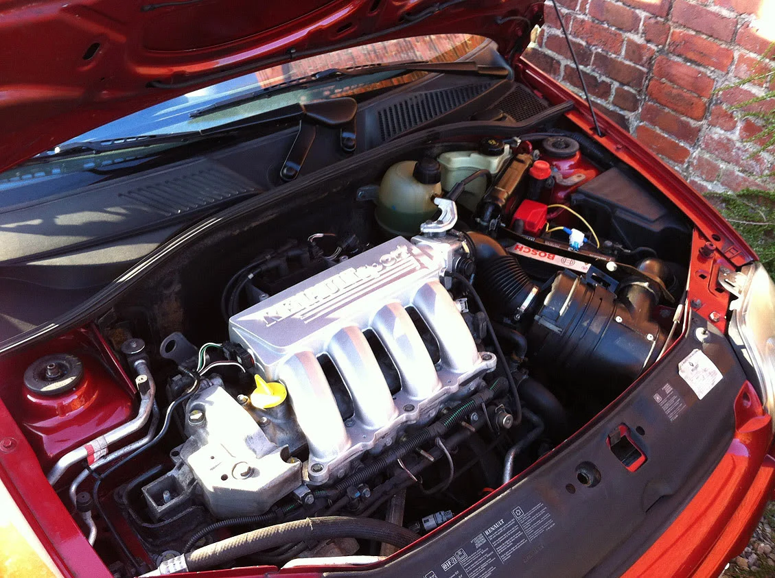

The engine bay got some attention triggered by fitting a new set of spark plugs. Inlet off for a clean, ecu cover and air filter bracket off for respray, wiper arms off for a respray. Washed the airfilter and hoses, stripped and cleaned the throttle body. New airfilter and pollen filter. Looking a lot fresher under there now.
Noticed I need a new front engine bay seal.
