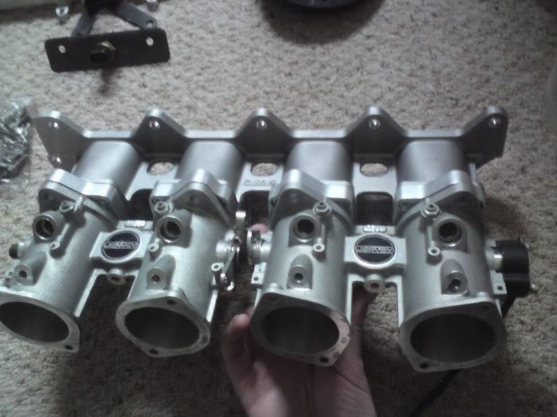

I first bought some 48mm DCOE Jenvey itbs, which came with linkage, throttle position sensor, air temp sensor, air filter plus more.
The plan at first was to fit it with Omex, but we decided, why not try on standard management?

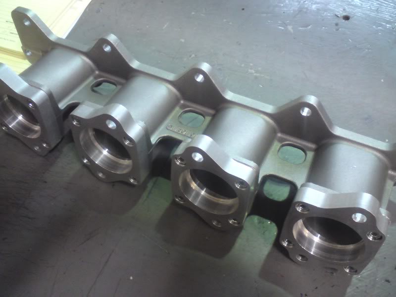

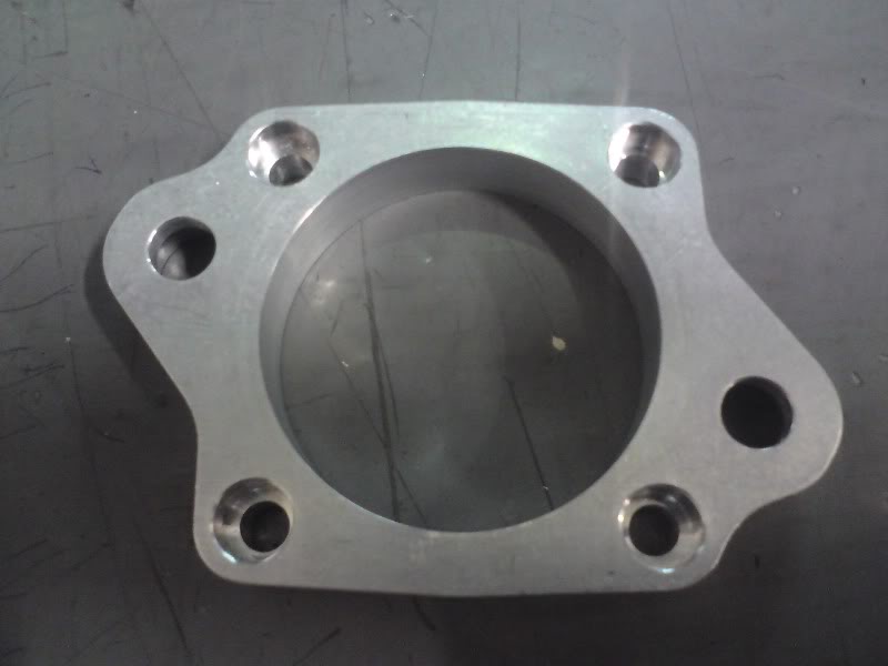

To start, we had some head scratching to do, as Jenvey do not sell a inlet manifold to fit DCOE style Jenveys to the F4R engine. I could have had a manifold made, but I was unsure on quality, so after a think we realised Jenvey sell adaptors to fit ITB's to twin carb manifolds.

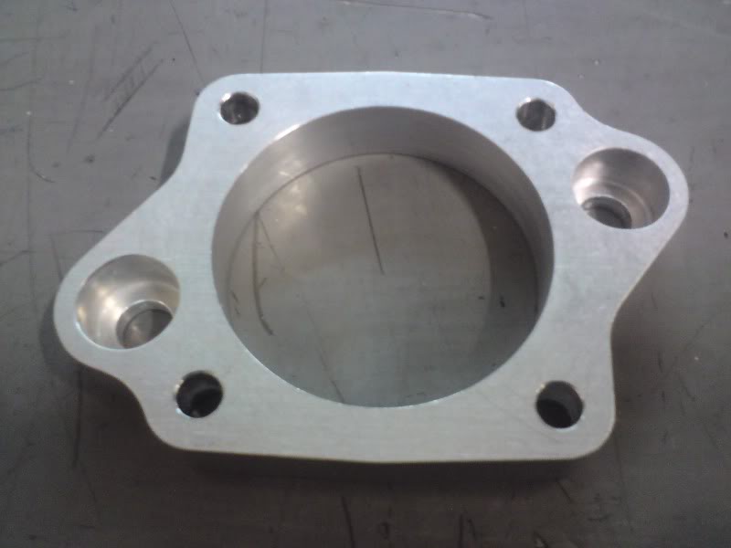

So I got on the phone and ordered a manifold and 4 adaptors, and got a friend to machine the small 4 bolt holes to the backside of the adaptors and fitted them backwards to the manifold so the Jenveys then bolted straight up:
Standard adaptor:
Drilled adaptor:
Adaptors bolted to manifold:
Jenveys offered up:

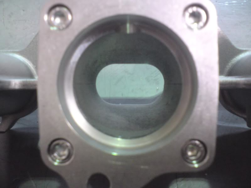

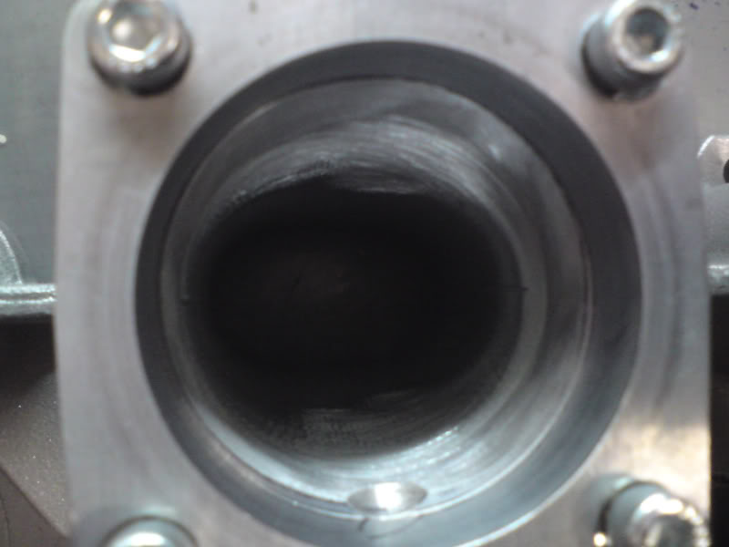

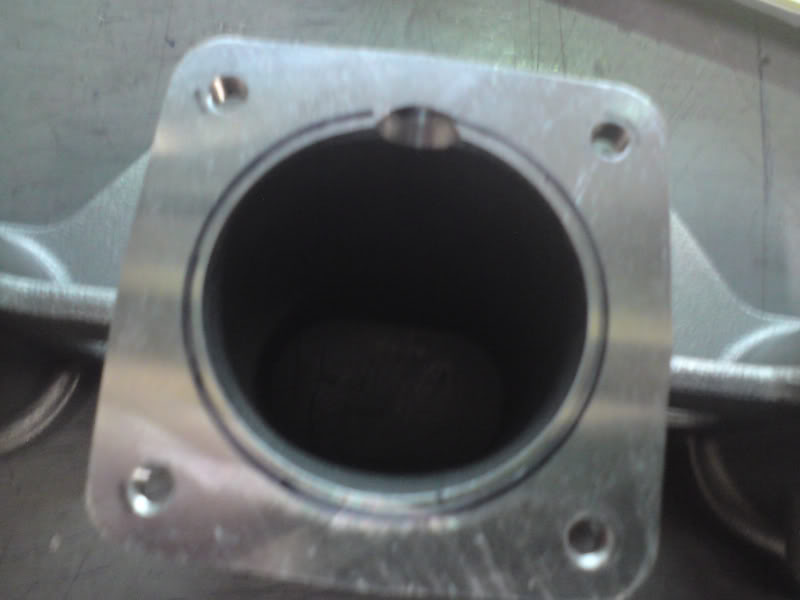

Once this was done, the manifold needed porting out to match the 48mm Jenveys:
So I took a marker pen and marked what I needed to grind out:
And I got busy with the porting :evil:
Its not the greatest job, but it works! I also left the back end of the manifold rough, to help the air and fuel mix.

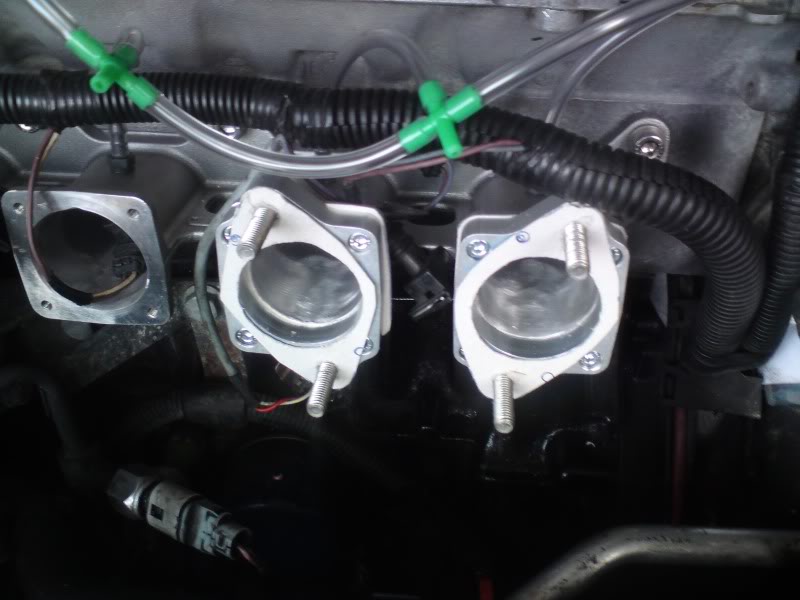

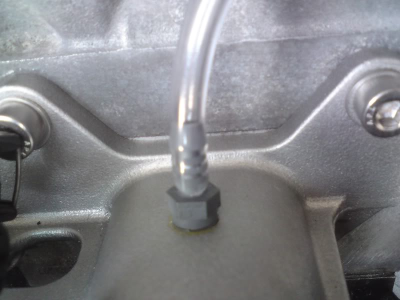

Next stage, the MAP sensor.
We needed to figure out how to mount the MAP sensor as most aftermarket ECU's can do away with this, but the standard ECU needs it.
More head scratching before and idea was hatched:
So I got on the phone to Bailey and ordered some dump valve vacuum adaptors and each inlet of the maifold was drilled and fitted with an adaptor:
We then took a vacuum pipe and ran that up to a tank, which in turn attched to the MAP sensor.
This, in theory, would mean the MAP sensor would be able to take an accurate reading from the inlet manifold, therfore retaining the use of the ECU.

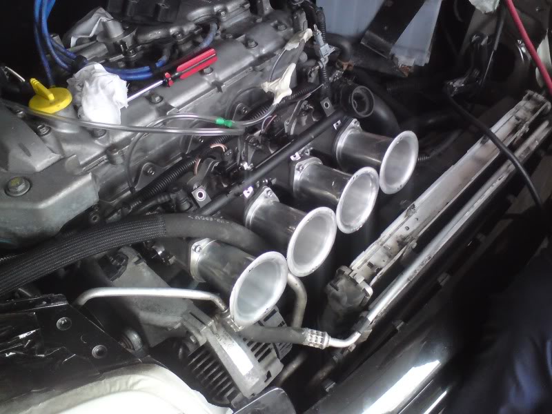

But before this, we offered the Jenveys up to the car:

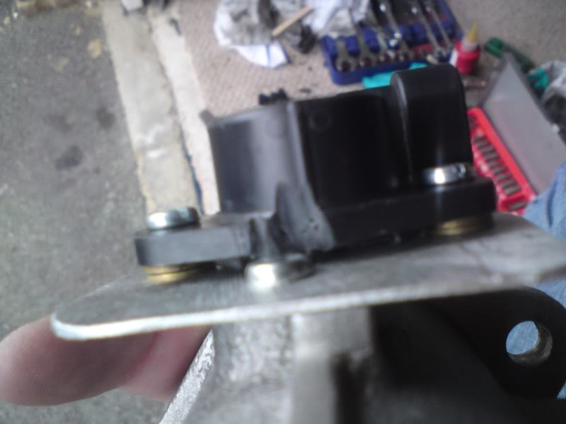

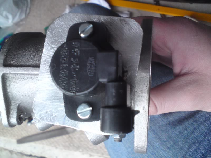

Everything looked good, apart from the throttle position sensor. The TPS could not fit onto the nearside Jenvey, as it would not rotate the correct way, so the only option was to fit it on the offside.
This showed 3 problems:
1) the TPS wiring was not long enough
2) The alternator bracket was in the way
3) The TPS needed to bolt on 90 degrees the wrong way
So more head scratching ended up with me taking a grinder to the alternator bracket, and then extending the TPS wiring. I pulled it out one wiring conduit, and extended and tucked them in with the conduit that carries the wiring for the injectors, to keep everything neat.

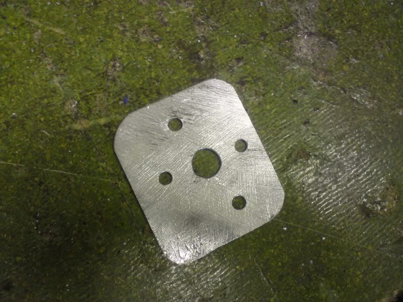

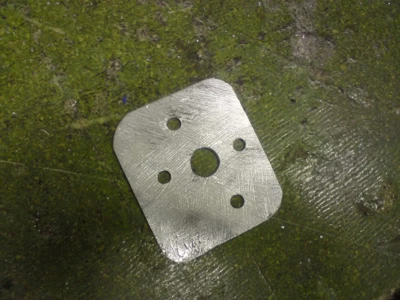

The only issue then was mounting the TPS.
So this bracket was made:
Meaning this plate was bolted to the throttle body, and the TPS then bolted to the plate at the correct angle.
We also had to grind a bit off the Jenvey spindle, as the Jenvey spindle is a D shape, where the Renault TPS is a flat shape.
I also took a bit of plastic off the TPS, to clear the bolts, but this has not effected the operation of the TPS:

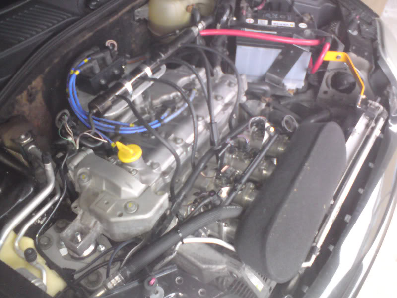

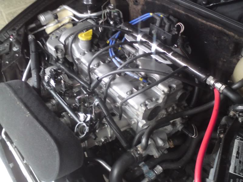

So we reached the stage where it all bolted up, all I then had to do was attach the air temp sensor behind one trumpet to get an accurate reading. (This will be moved soon as I have another idea)

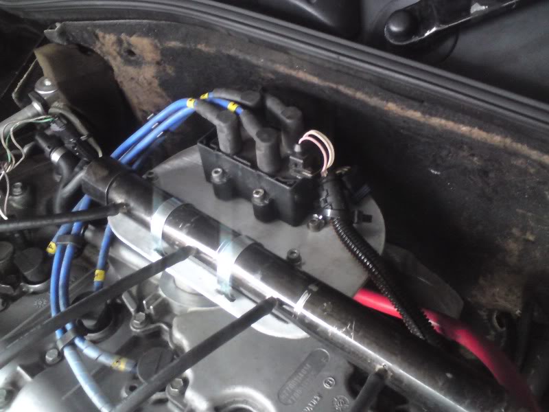

We then fitted the ITB's once more, this time with the coil pack bracket we made and the MAP tank also.
To overcome the problem of brake servo take off, we took this off the MAP tank, instead of drilling into the manifold as per usual.
Once this was connected, and we fitted a few more brackets (To hold the fuel rail still for example) it was time to start her up!
We were not expecting much, but not only did it fire, it ran well enough for me to put 200 odd miles on her for some basic testing.
The standard ECU coped well with the mods.

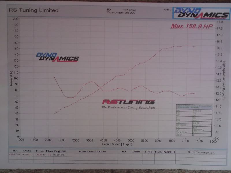

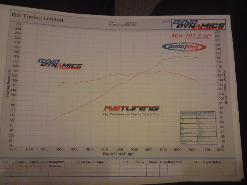

Once we had reached this stage, I needed it mapped, and contacted Paul Murray at RS Tuning. Going on his history of mapping standard ECU's he was a natural choice.
So today we made the 200 mile, 3.5 hour trip up to see Paul and see what he could do!
Long and short of it:
We reached:
191.3 BHP at the fly
159 at the wheels
158 lb ft of torque
Please check out the fabulous torque curve, nice and flat.
