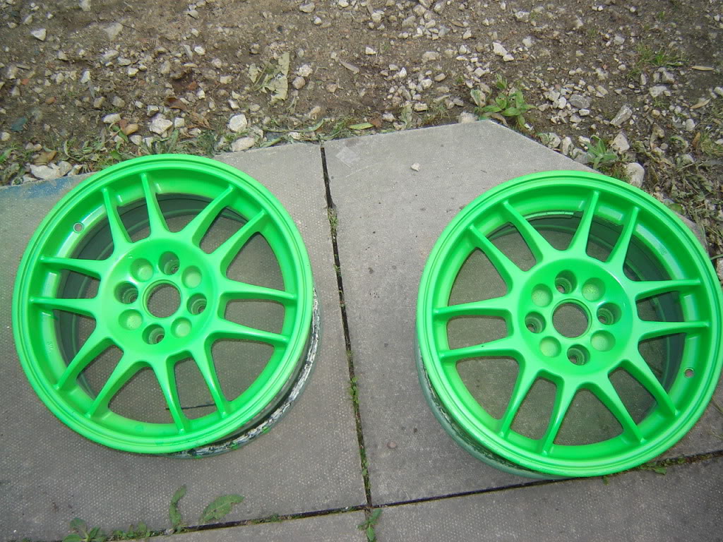

Paint arrived so i've cracked on with painting the wheels, just need to get the 888's fitted and ballanced now.

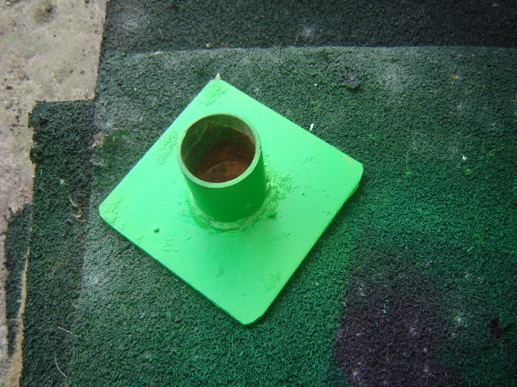

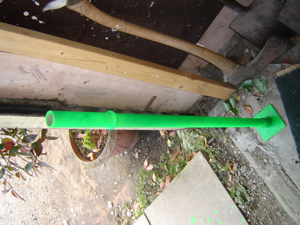

Made a strut brace for the rear which i'm quite pleased with.
(Don't know whether its best to put harnesses to this or bolt to the floor though so expert opinions please)

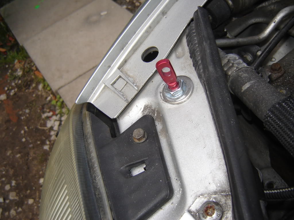

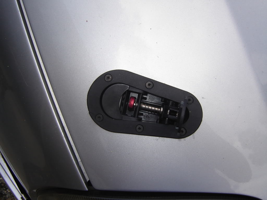

And fitted the aeroflush catches to the bonnet which i am well chuffed with because i never thought i'd get them to fit and work first time lol.

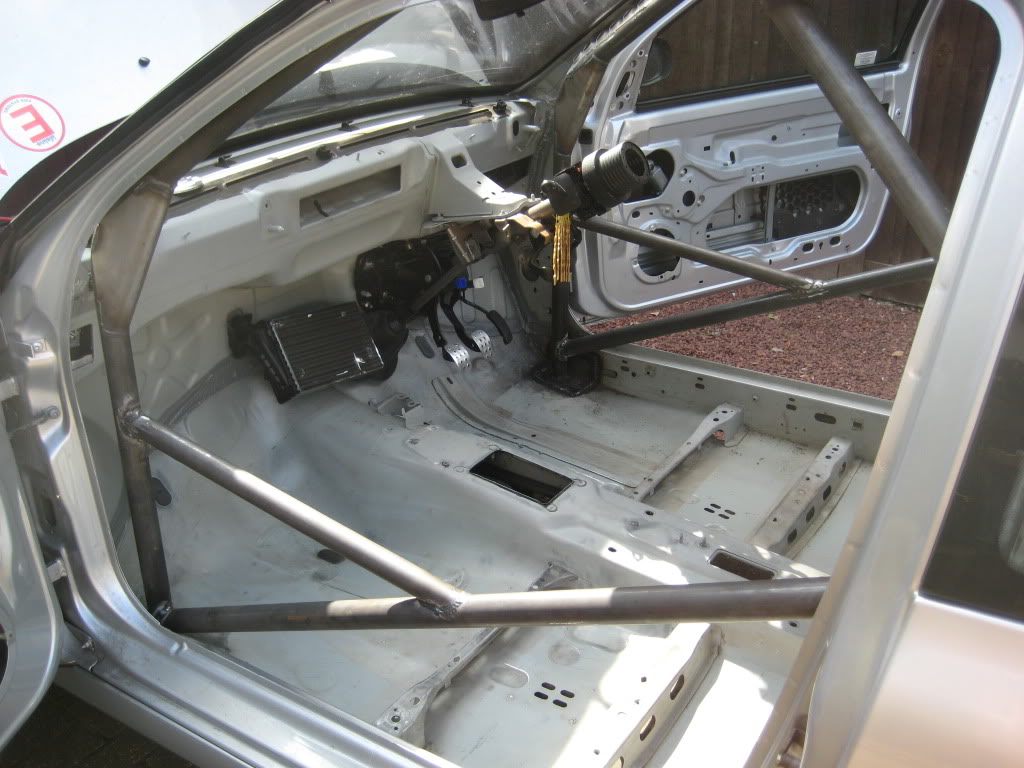

Presume the rear strutbrace will be bolted to the side of the strut towers? Without strengthening the towers it wouldn't be very safe. Are you having a cage? if not then mount harneses to the original rear seatbelt anchors.

The wheels look sooo much better in the flesh, proper cool colour!!! only a little bit bright!!:approve:
As I said!
I've not seen how the strut brace will mount?
We were supposed to be getting this great cage for next to nothing of a friend of Ashs family, as yet its not materialised and heard f**k all about it!

Yeah the strut brace will be bolted to the towers,
Tbh placed the harnesses in this afternoon an they look a bit sh1t going back to the strut brace so think they will be going to the rear seat belt anchor points.

Cage never happened in the end, f***s me off people who say they'll do something and dont!

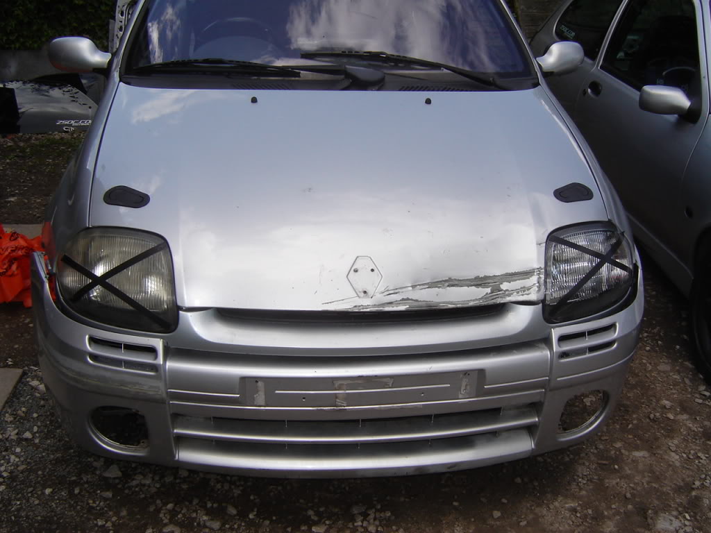

Finishin touches bein made tomorrow, Rear polycarb and a good clean then it should be ready for its first outing :)

Wheels with a dull shade of graffiti green paint and wrapped in r888's...

This is very ghetto, please dont crash it as I think it will just fold lol :) Looks awesome tho

Its basically at the stage my car was just before i got my cage in, a cage makes a pretty big difference to the cars twisting and i was quite shocked as to how different the car felt with the cage in.
So at some point try get one as it will obviously save you if you roll and make the car feel pretty good to drive
Nothing on the car is unsafe, i've made sure of this lol. But yeah i know what you mean theres not a lot to keep it rigid. I'll just let ash or kev crash it :rasp:
