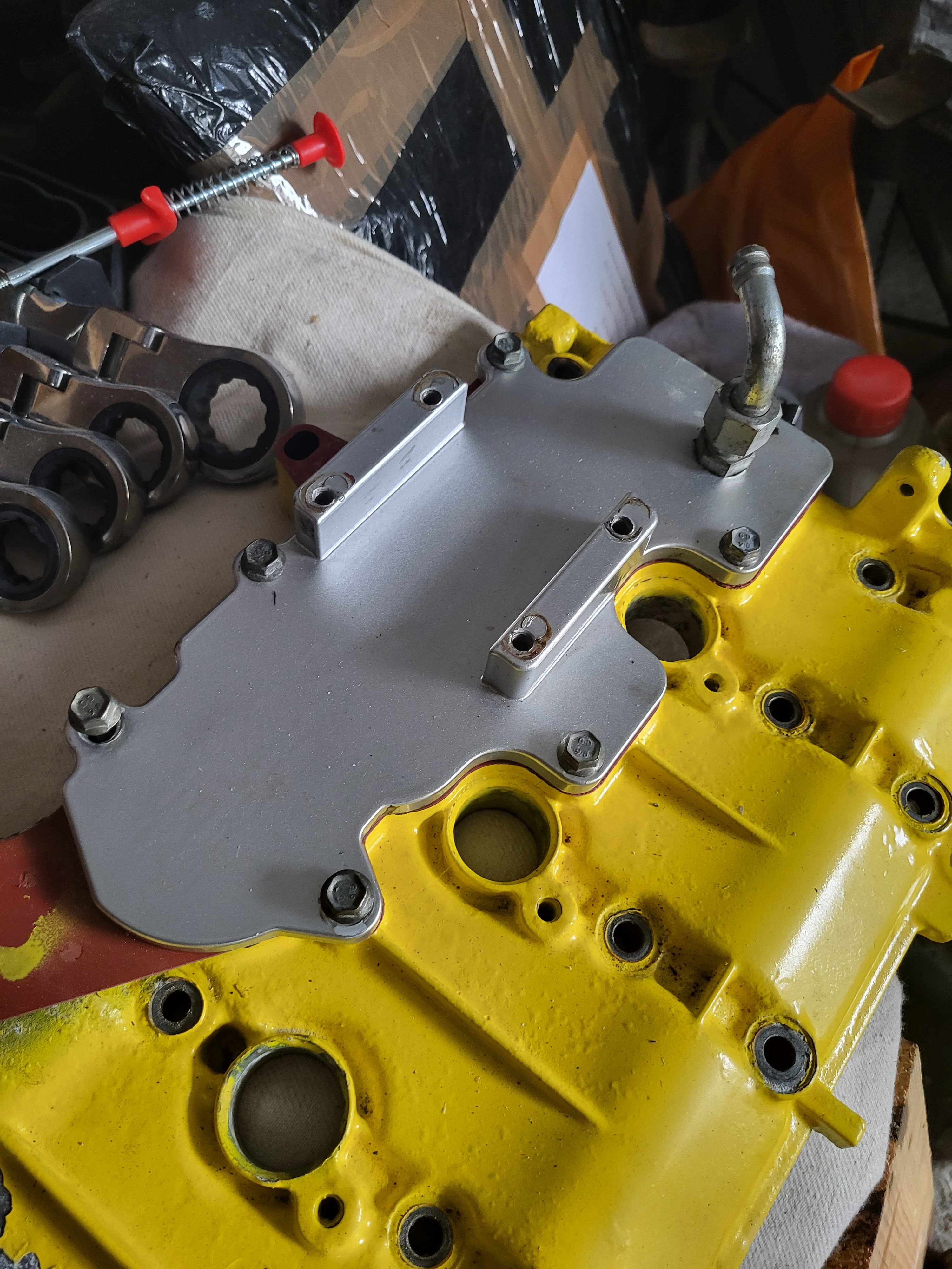

Also Also - (i wish you could edit posts) - has anyone seen a breather like this before? I has a completely flat bottom, no machined chanels what so ever, i assume this is part of a larger assembly? It also has no residual evidence of the channels in the rocker cover. I've basically just used it to mask up the breakther openning now so i guess its already ruined anyway.
I think that breather plate is a tessa one for coilpack relocation. Pms new style one is best,id go with that.

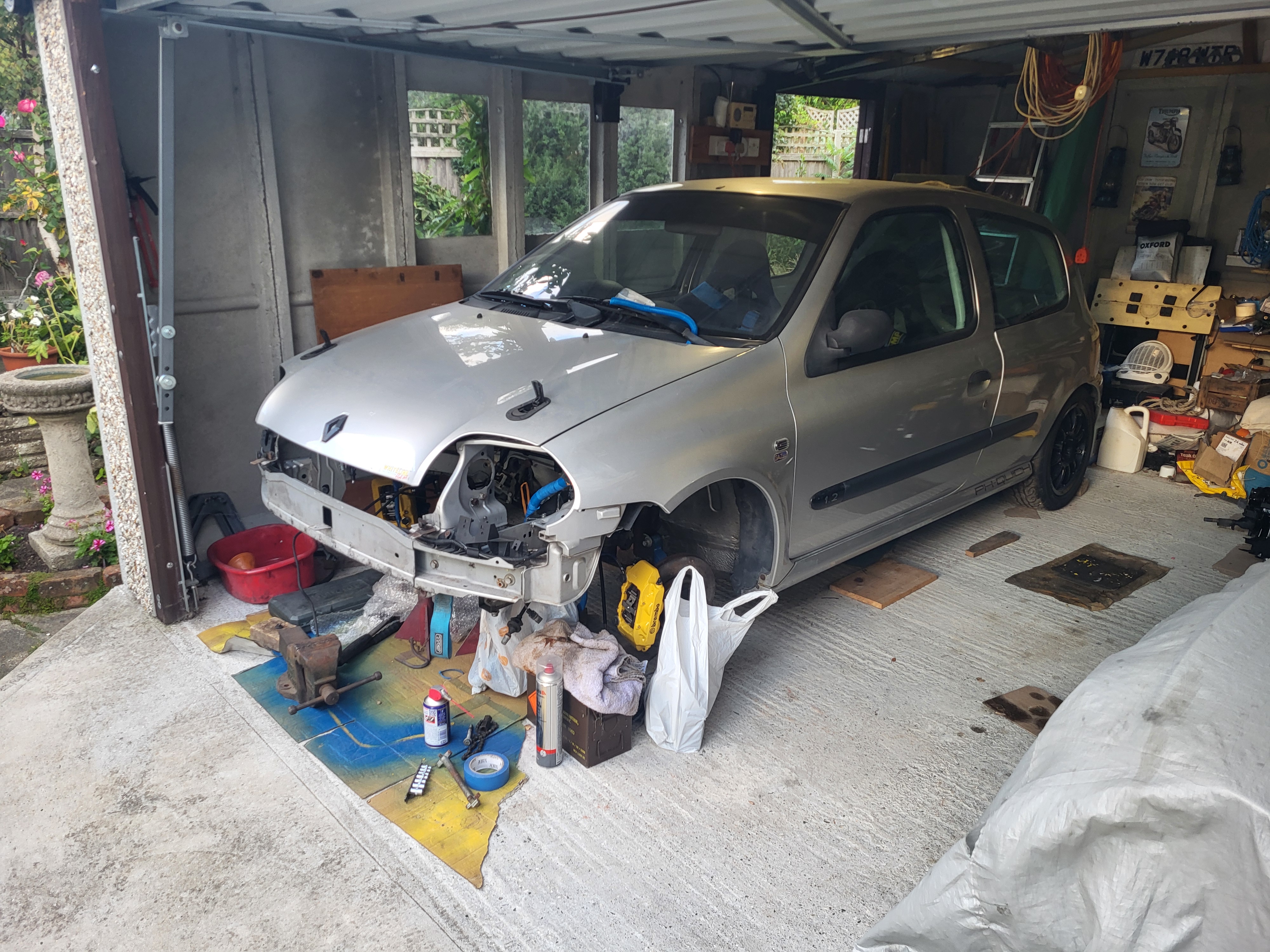

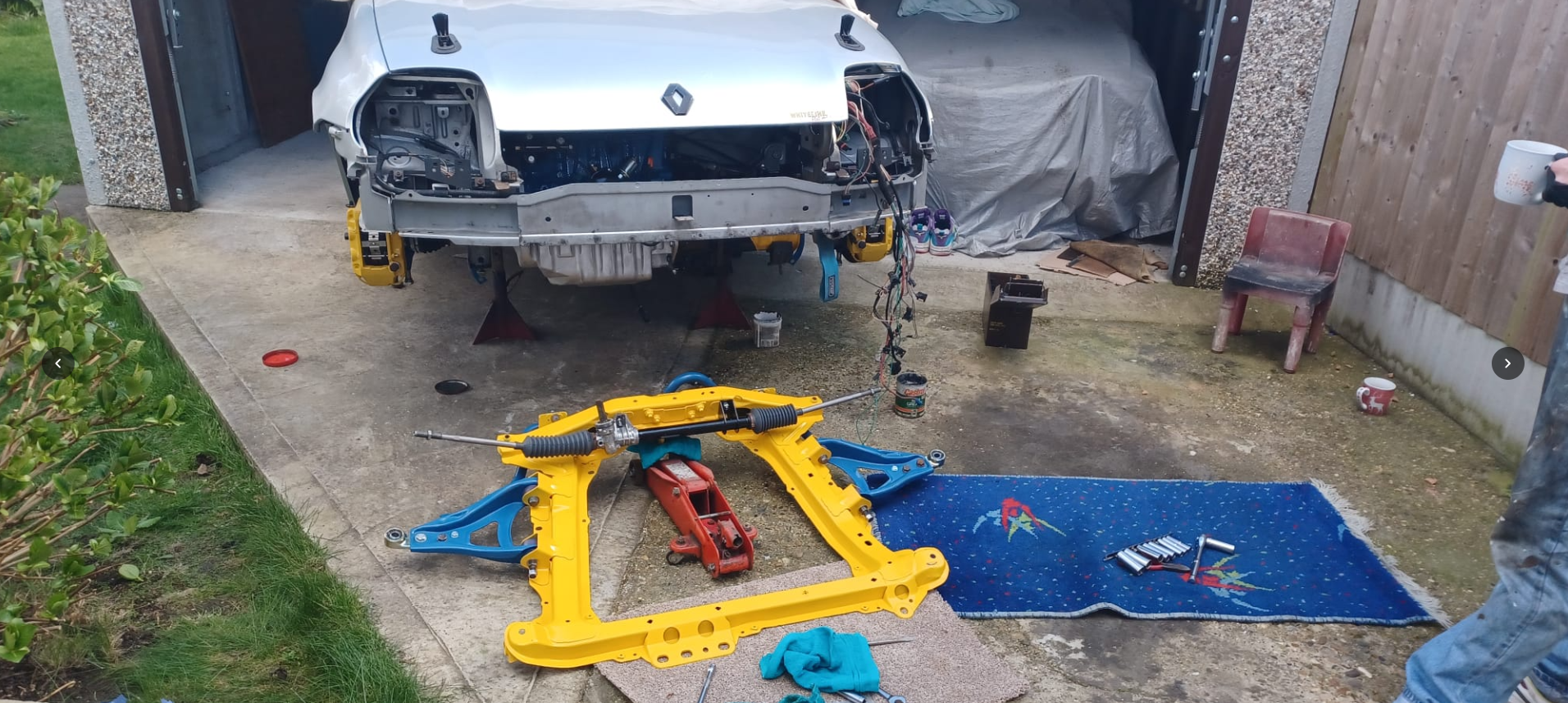

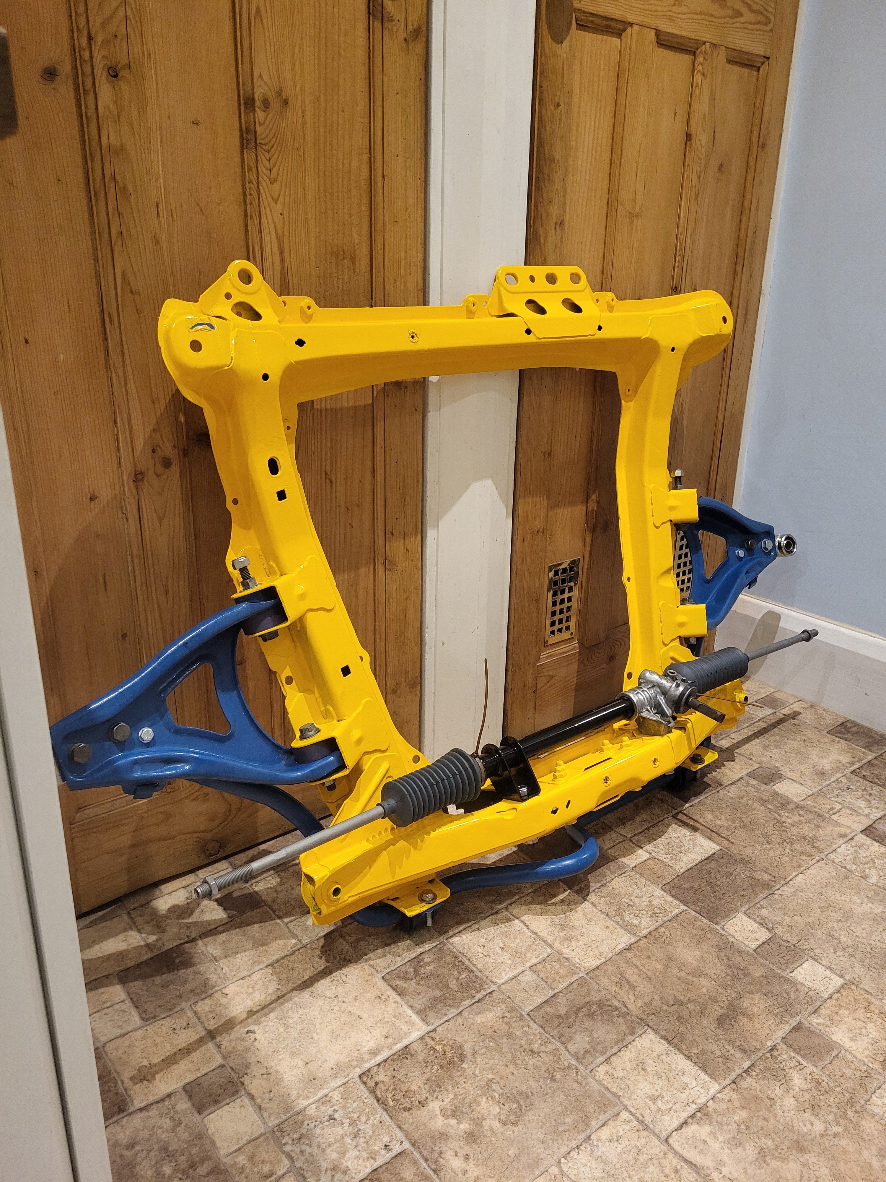

Dropped the subframe in situe - wasnt the easiest job as the was is basically up against the wall of the garage - left the hubs and brakes in situe. Need to actually work out how to get hte car our of the garage in this state... will be interesting.

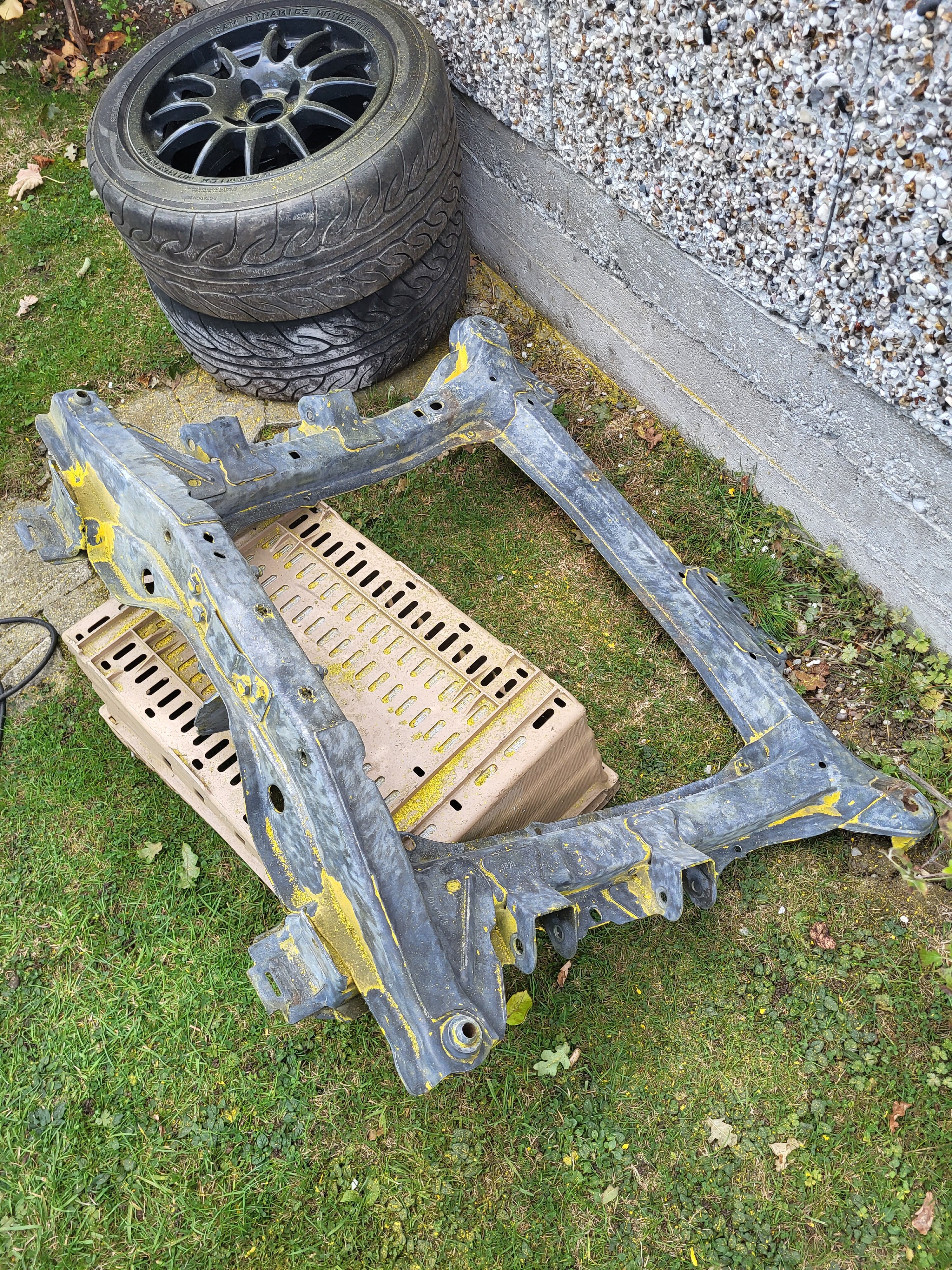

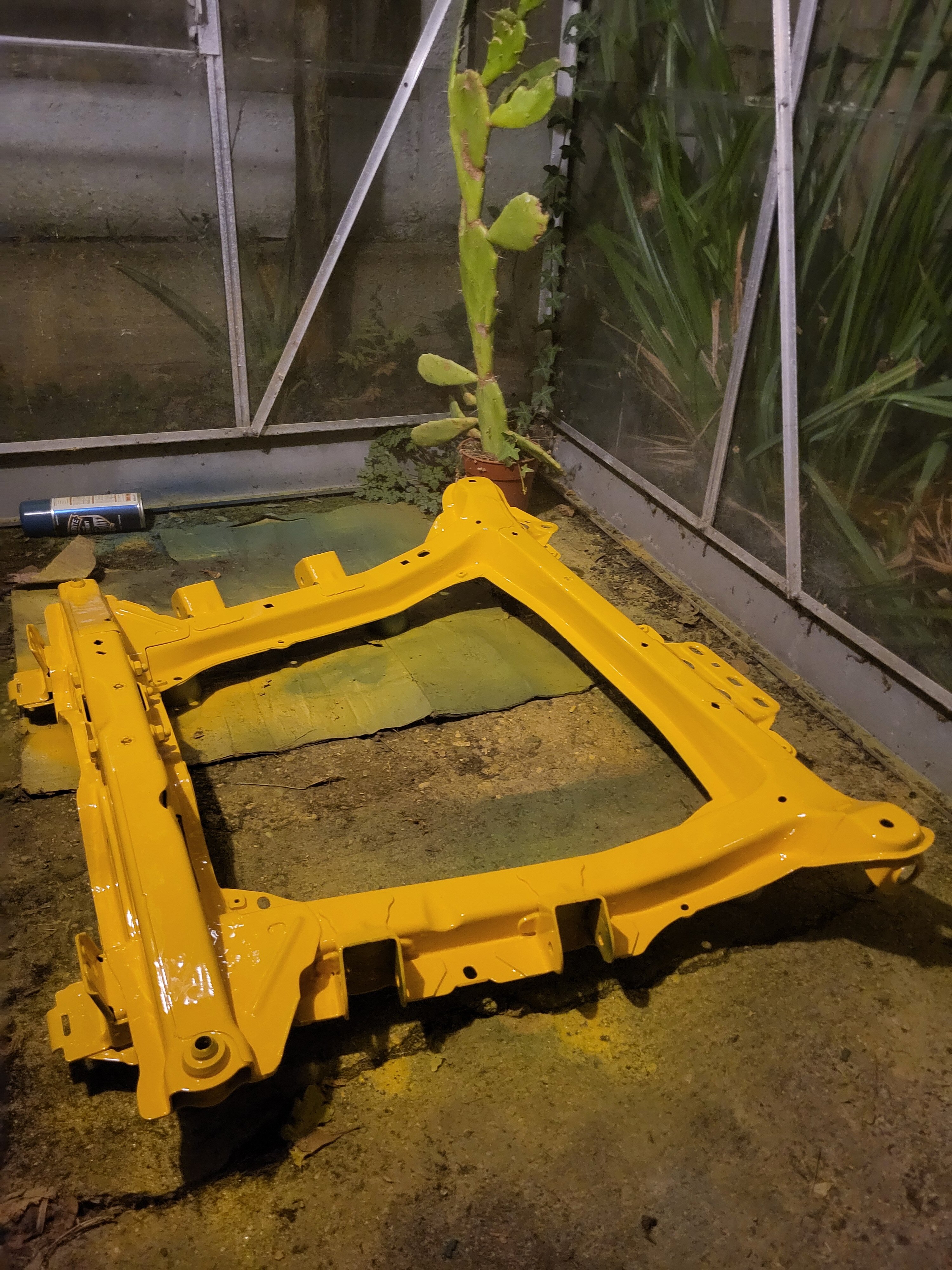

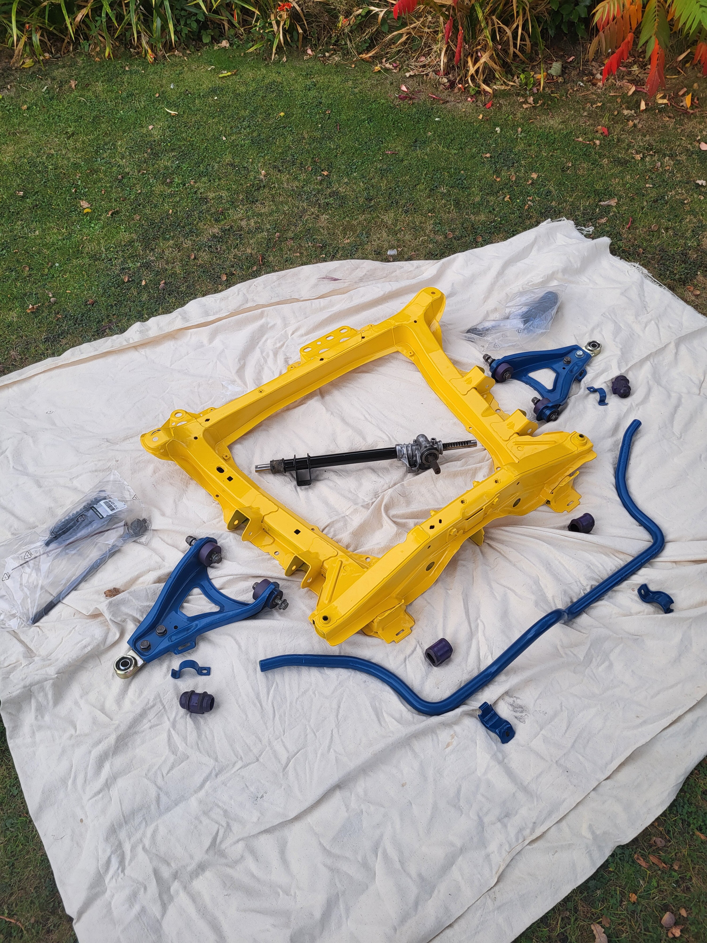

Stripping the old paint off the subframe - i did it with a paintbrush and it was chipped and looking a bit sorry so thought it could do with being redone.
Greenhouse has basically become my spray booth at the moment. Subframe after a lick of paint.
Need to do the underside this week.

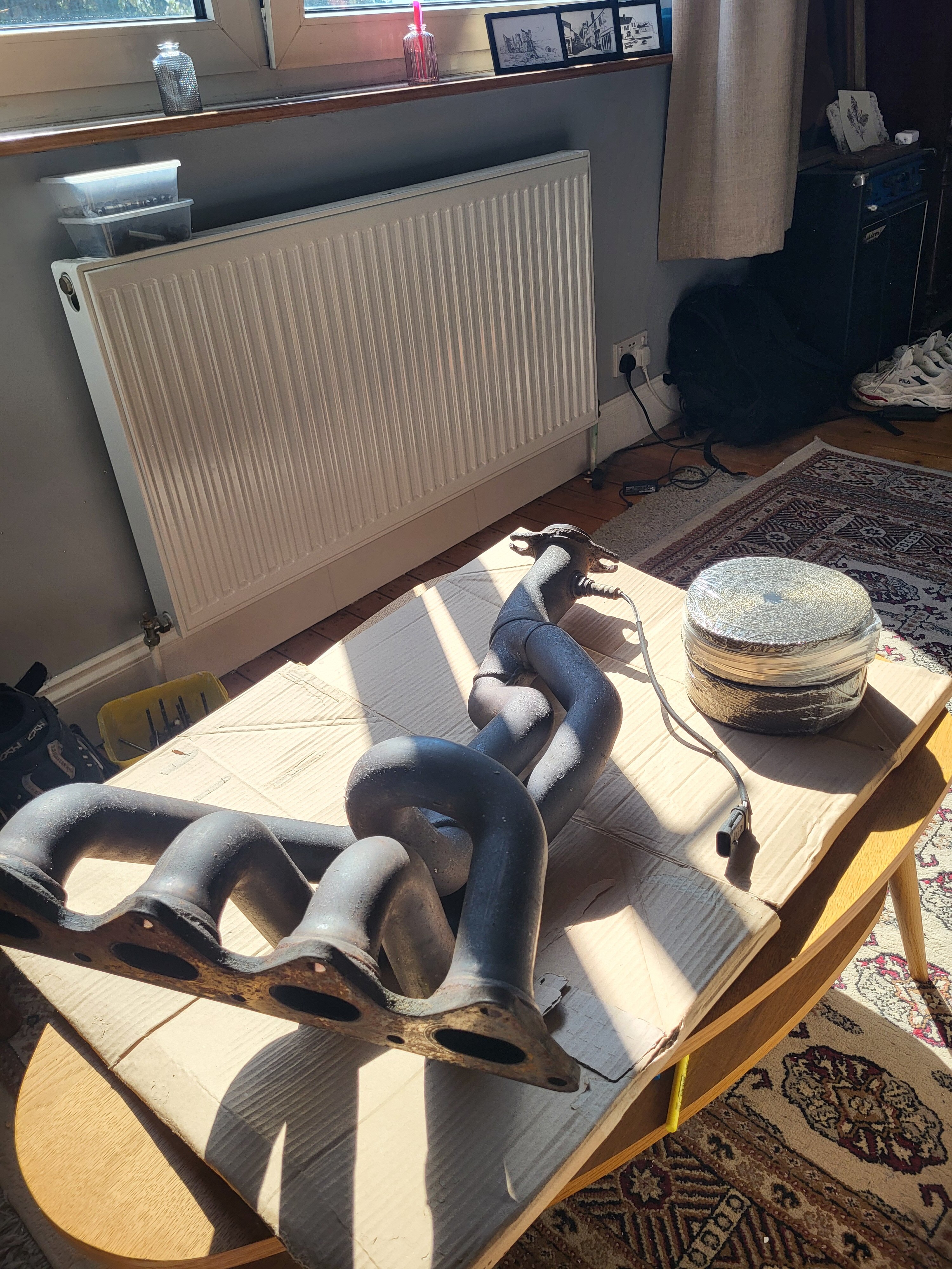

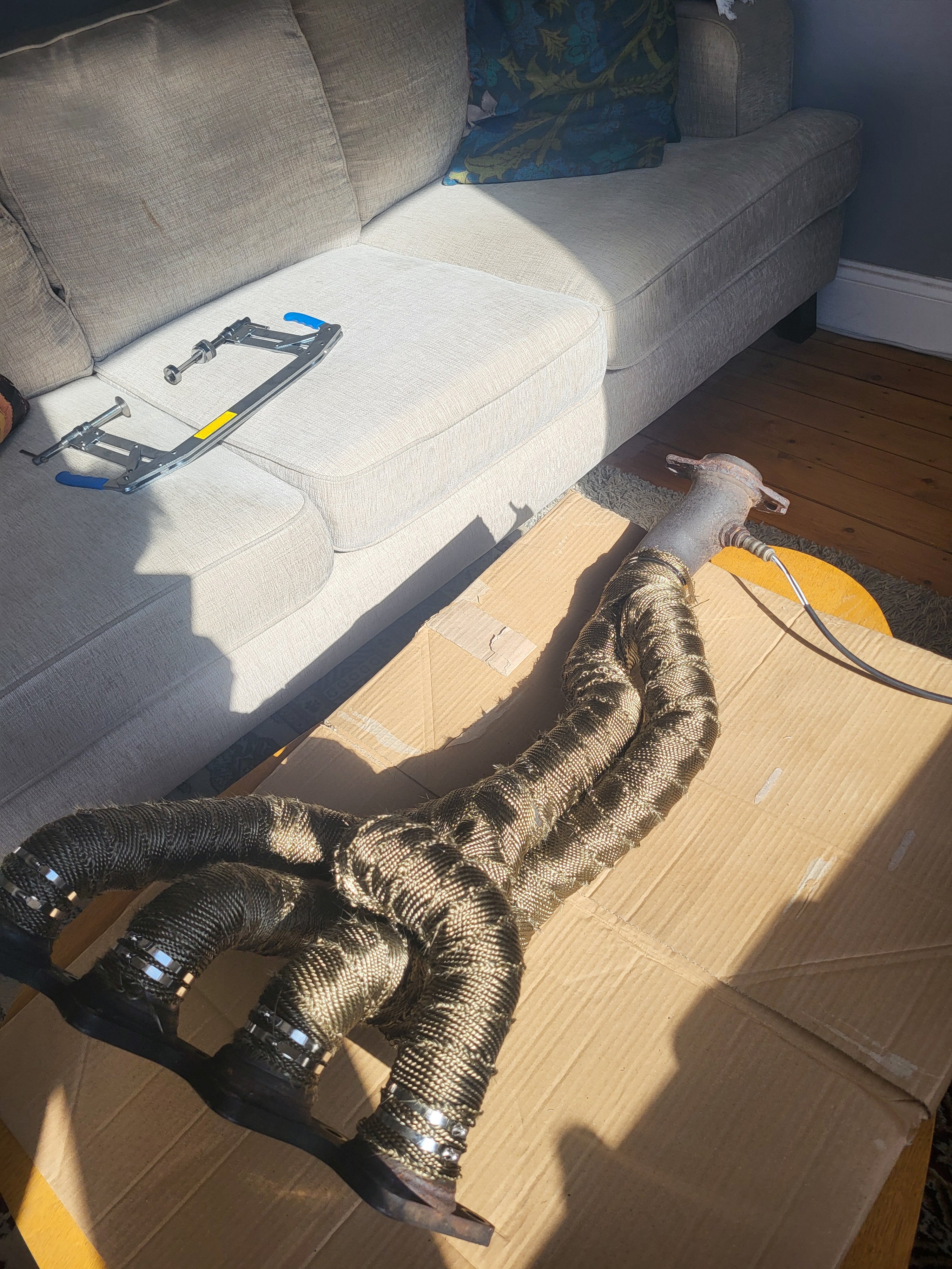

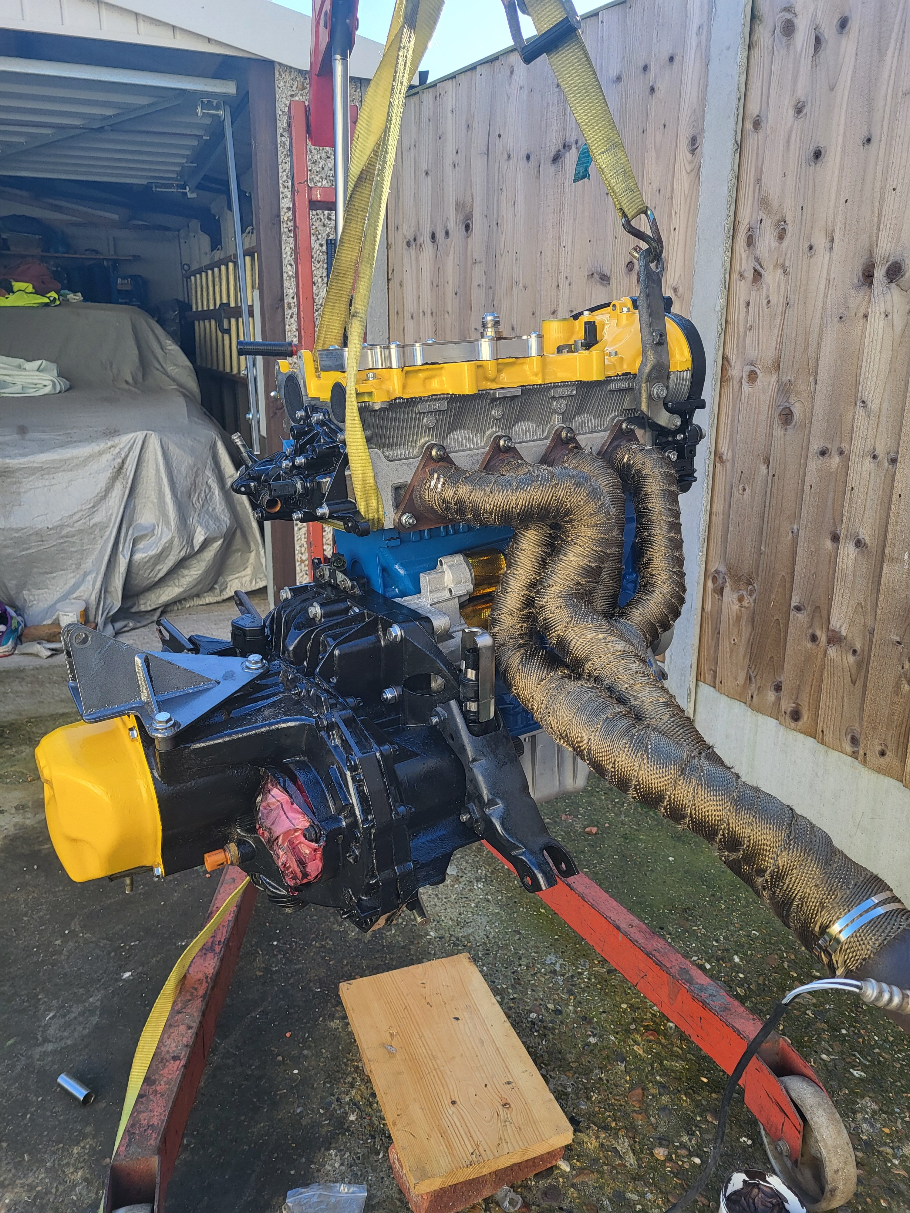

Another little job was to wrap the exhaust - I bought a 182 manifold a while ago and like the idea of not cooking my starter motor on track.
Before:
After: (quite an unpleasant job to be honest)

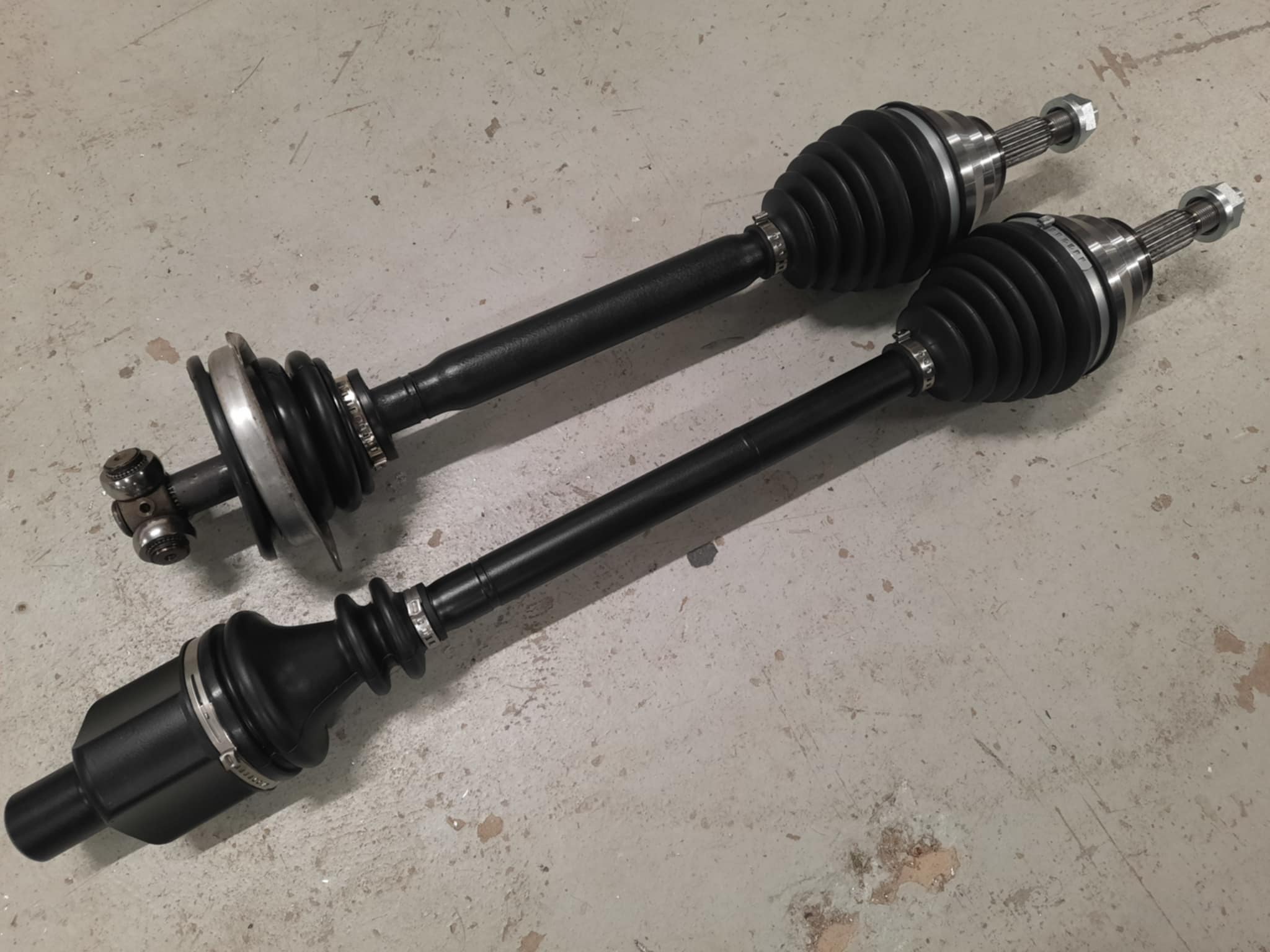

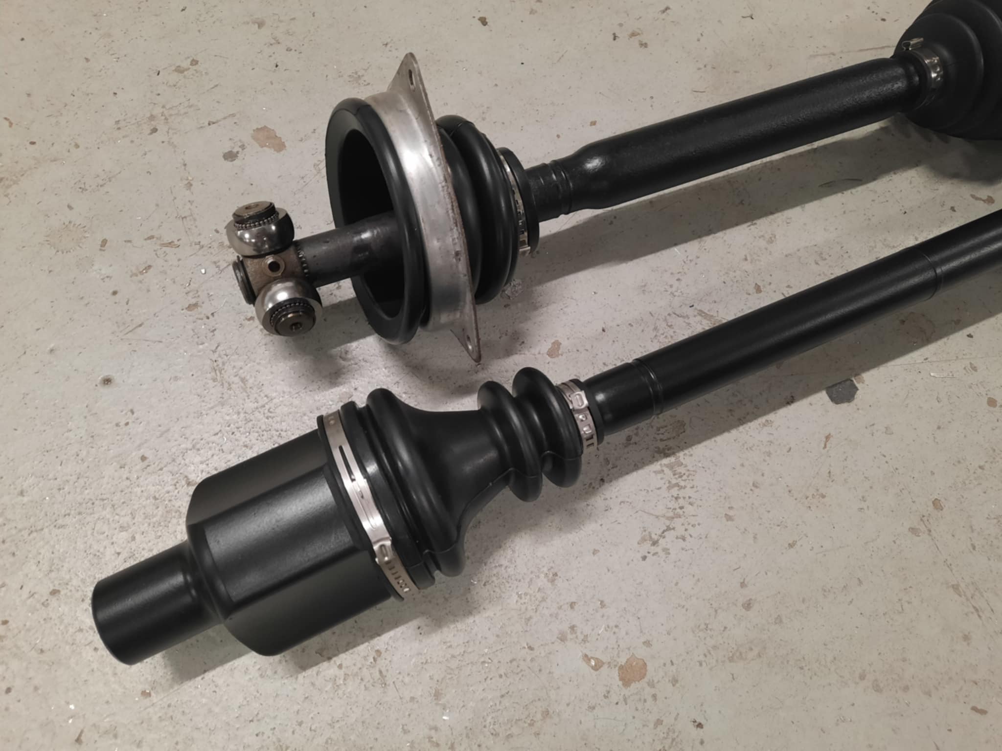

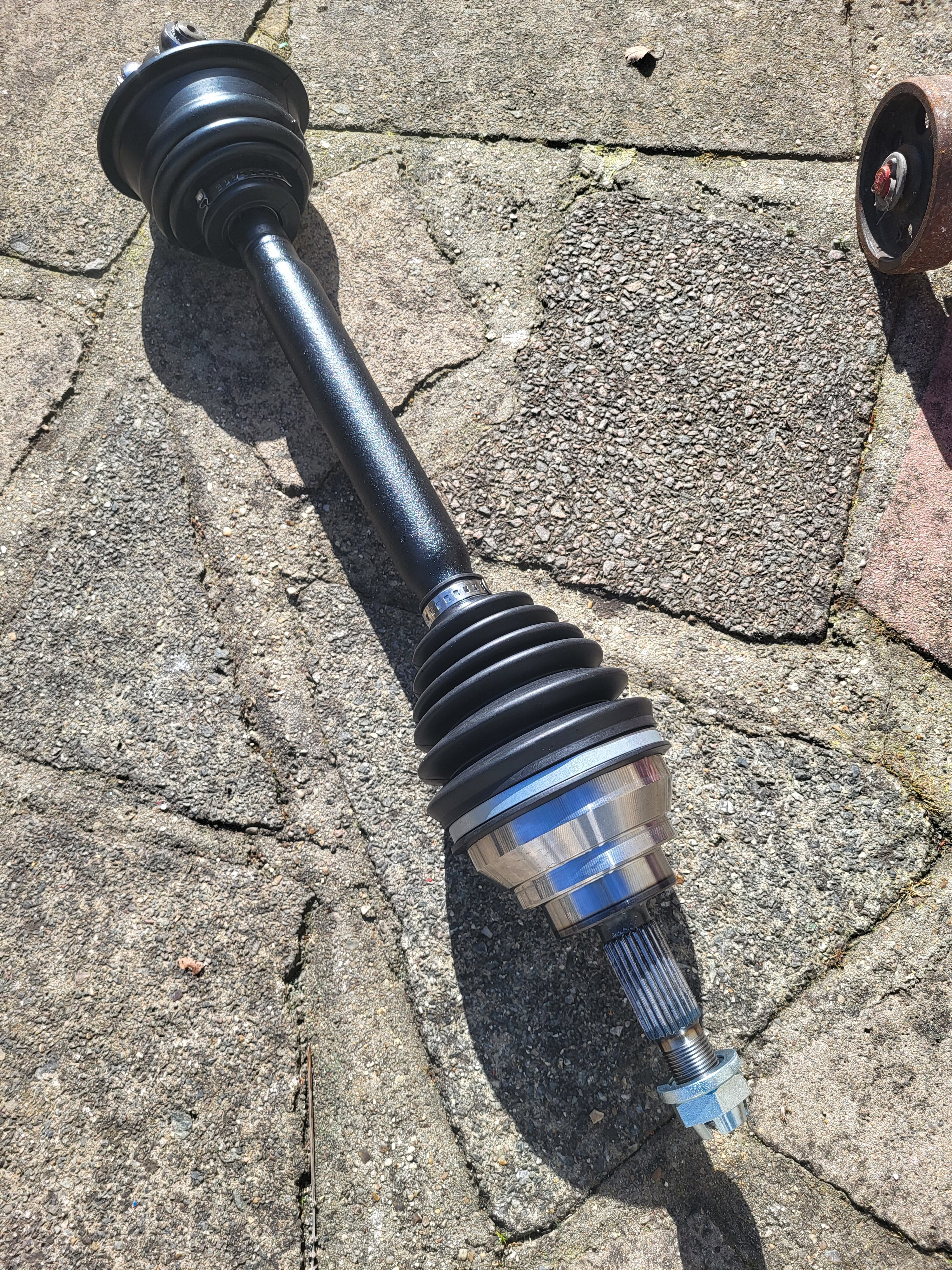

Also had my driveshafts rebuilt by Peter Withers, not sure if he uses the forum or what his name is on here but hit him up on facebook if you're looking for a refresh.

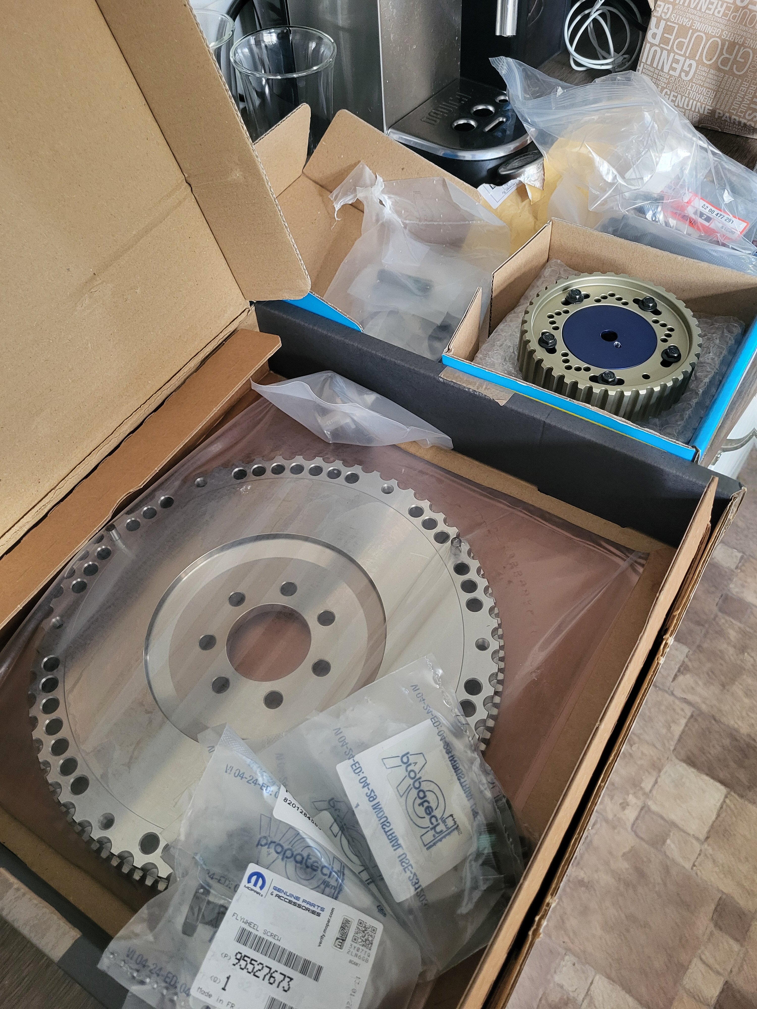

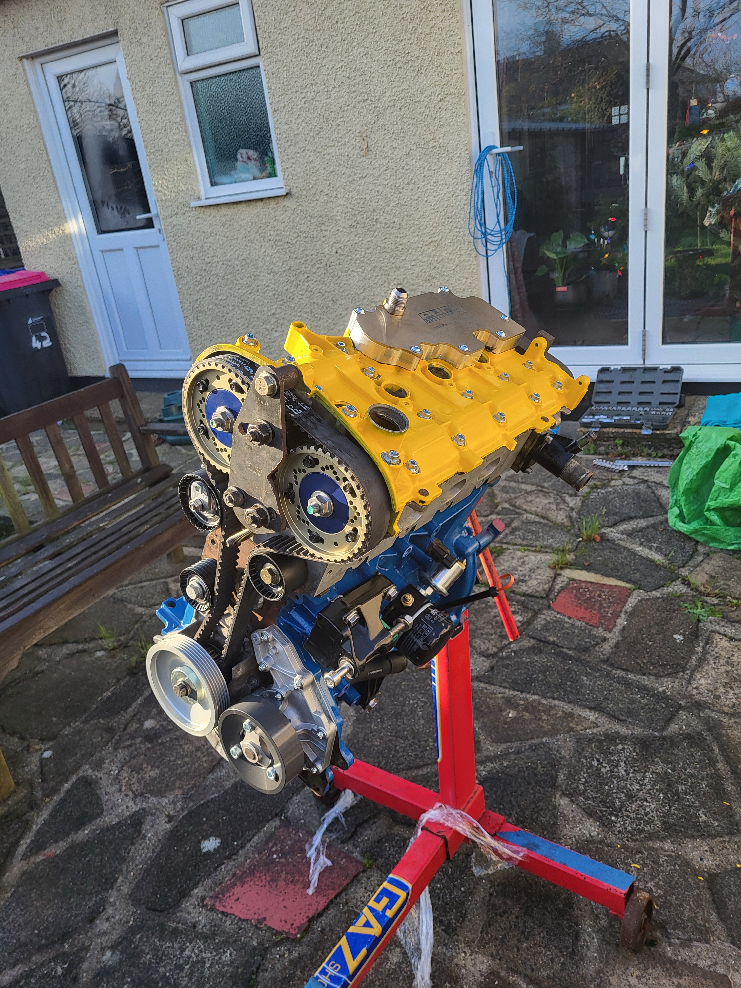

Got some new toys!!
Vernier cam pulleys
Lightened flywheel
Lightweight crank aux pulley
lightweight water pump pulley
PMS breather plate
the list goes on - it was not a cheap order in total.
the build is always the most fun part!

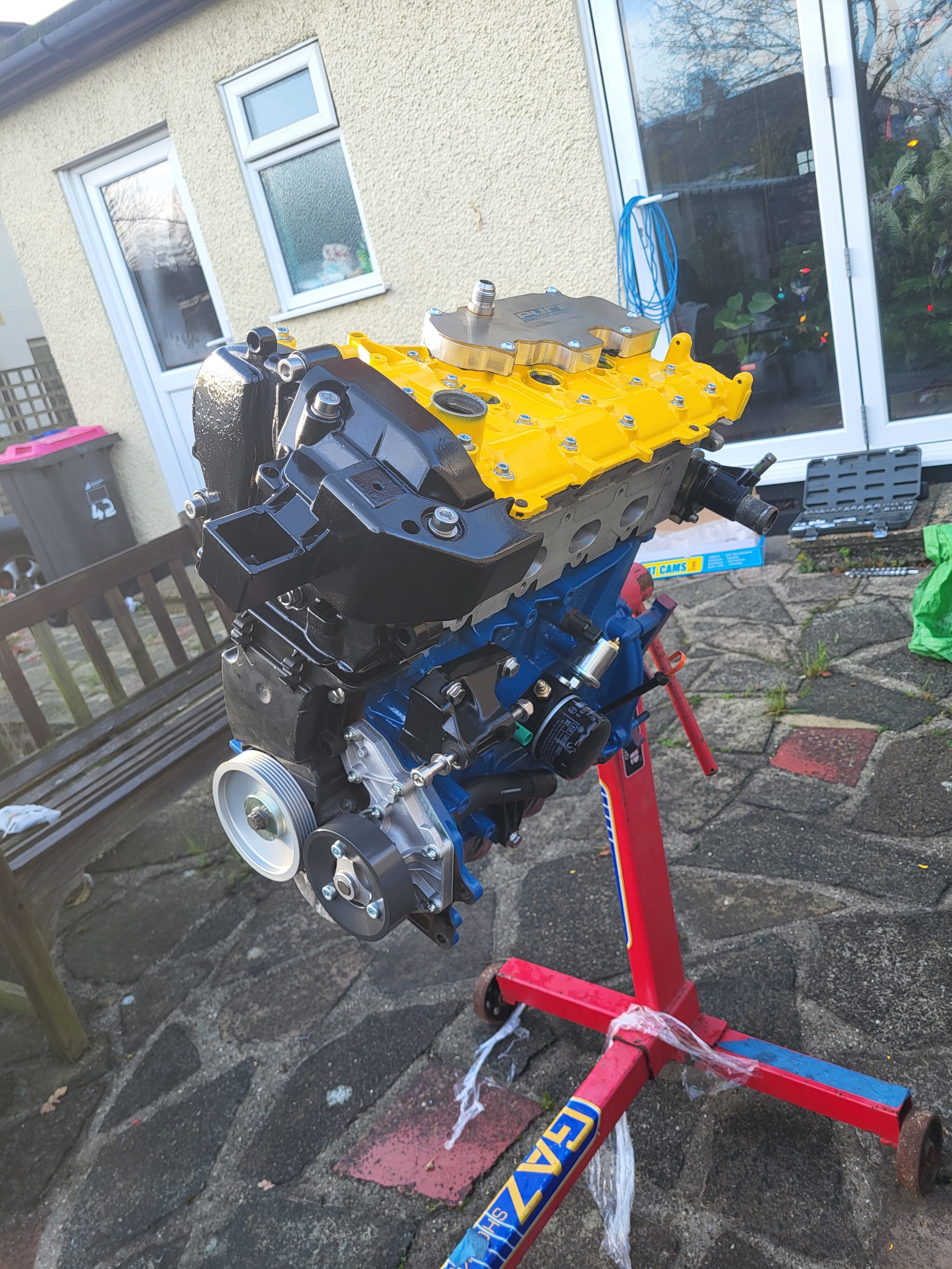

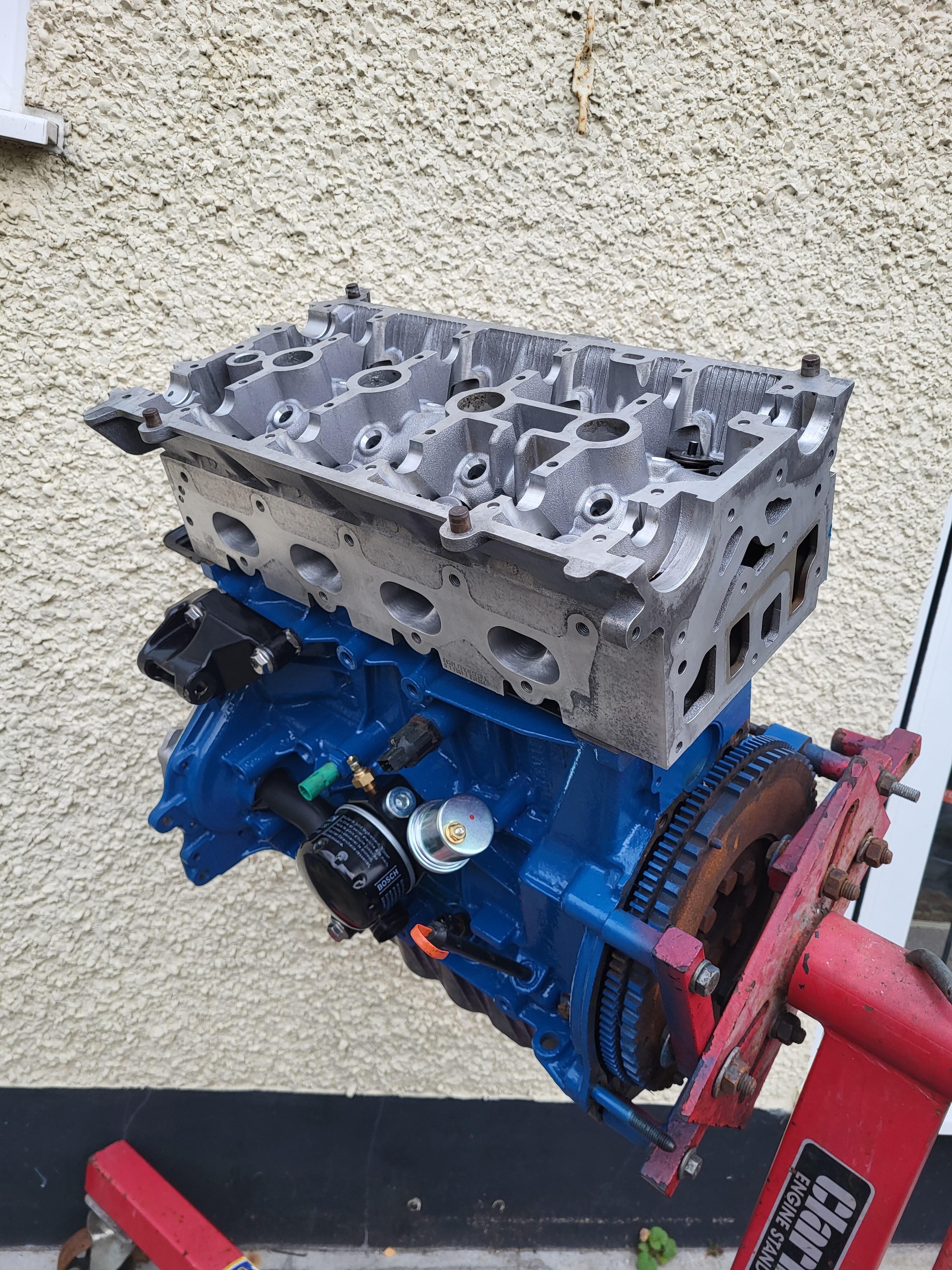

Having the silly desire not to leave my subframe outside in the elements while looking so fresh, ultimately silly since it will go back under the car where it will live afterwards...

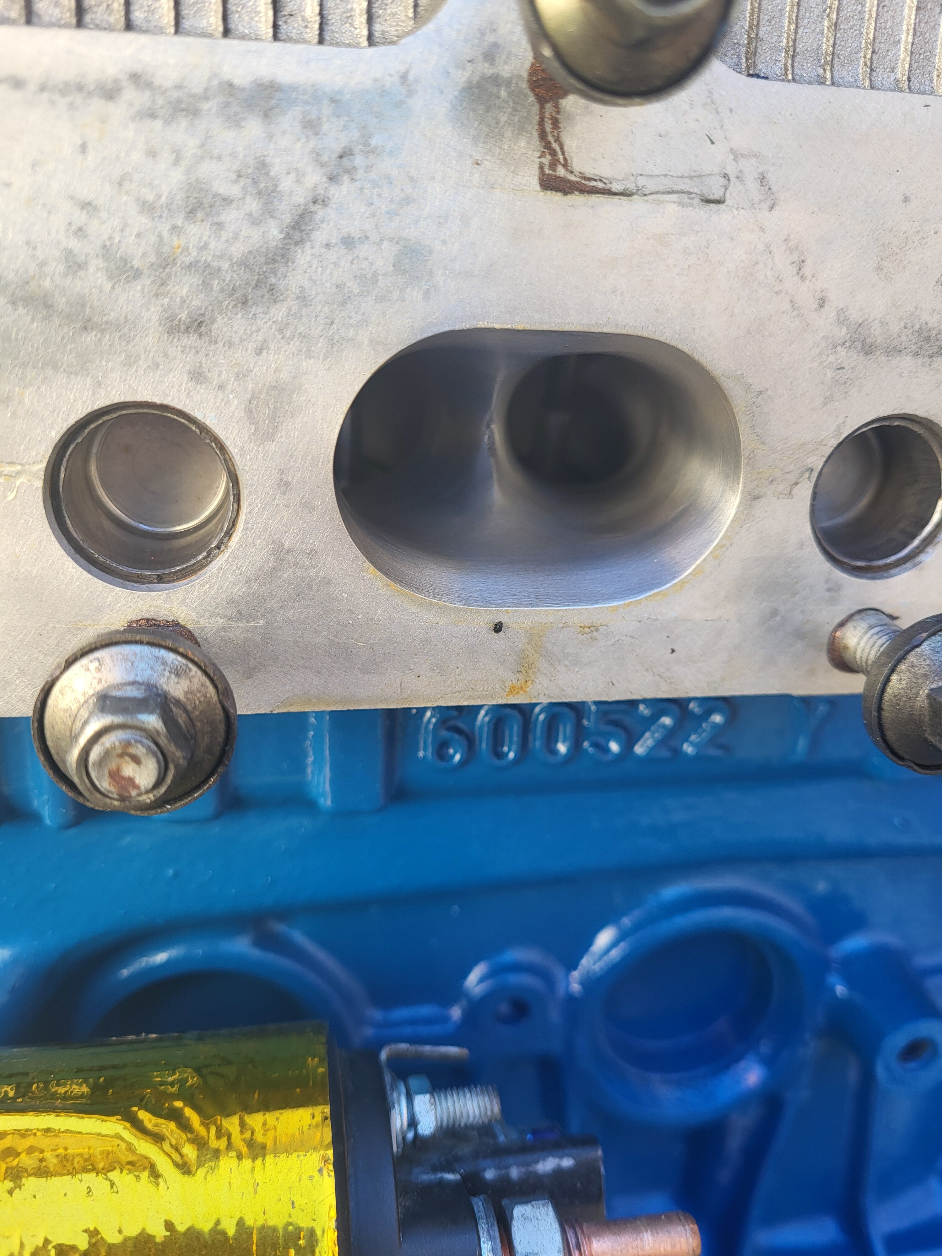

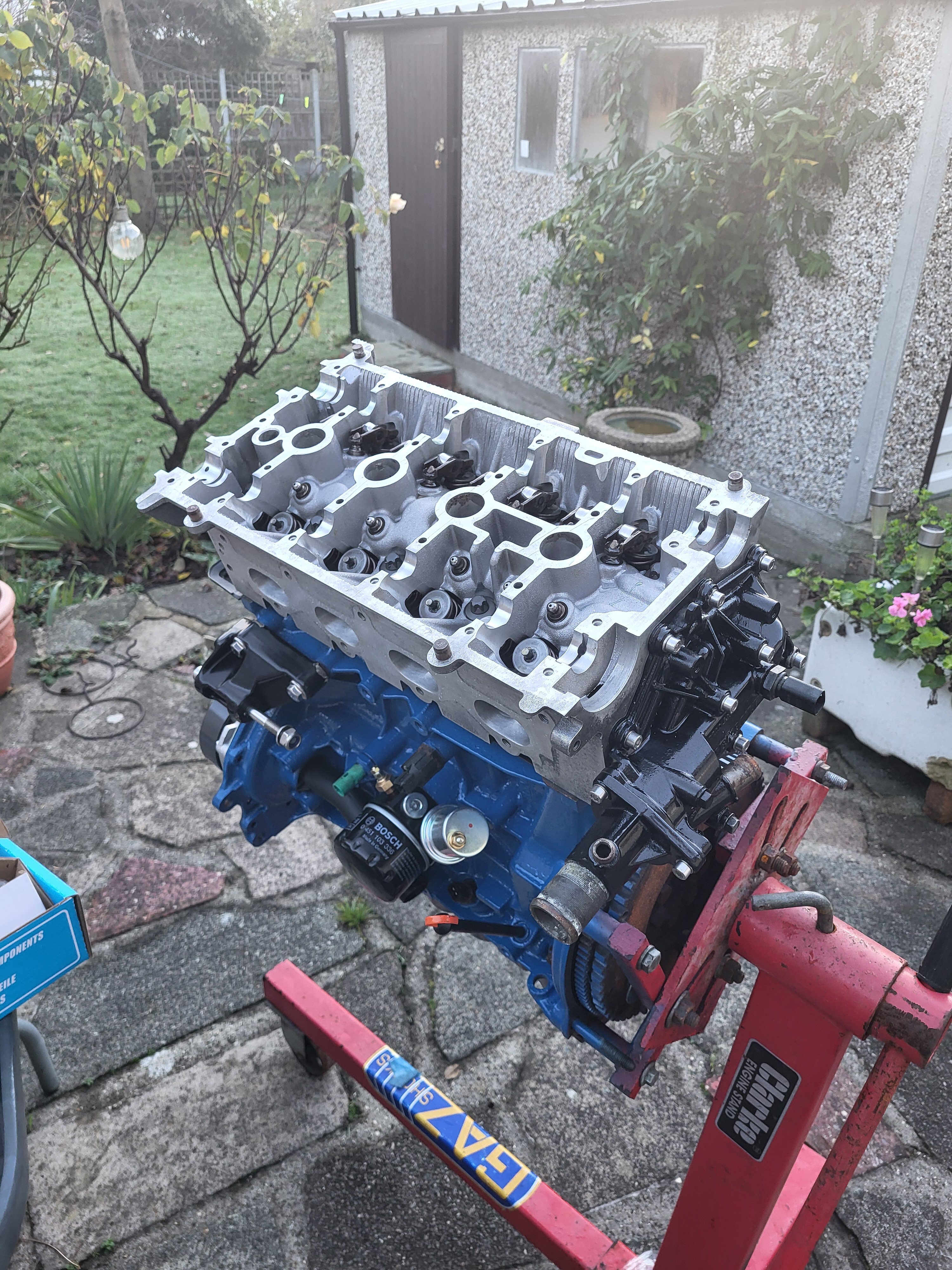

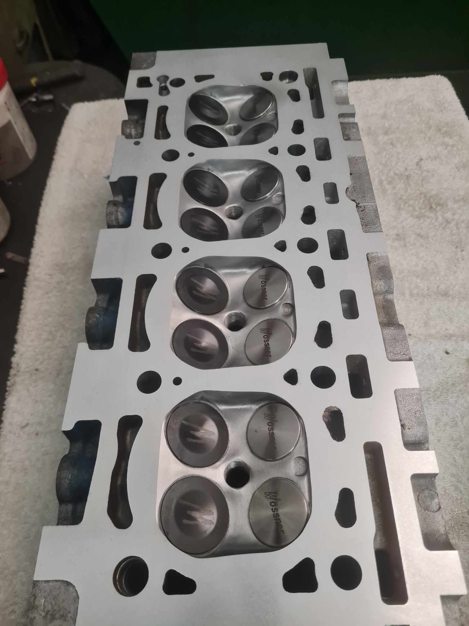

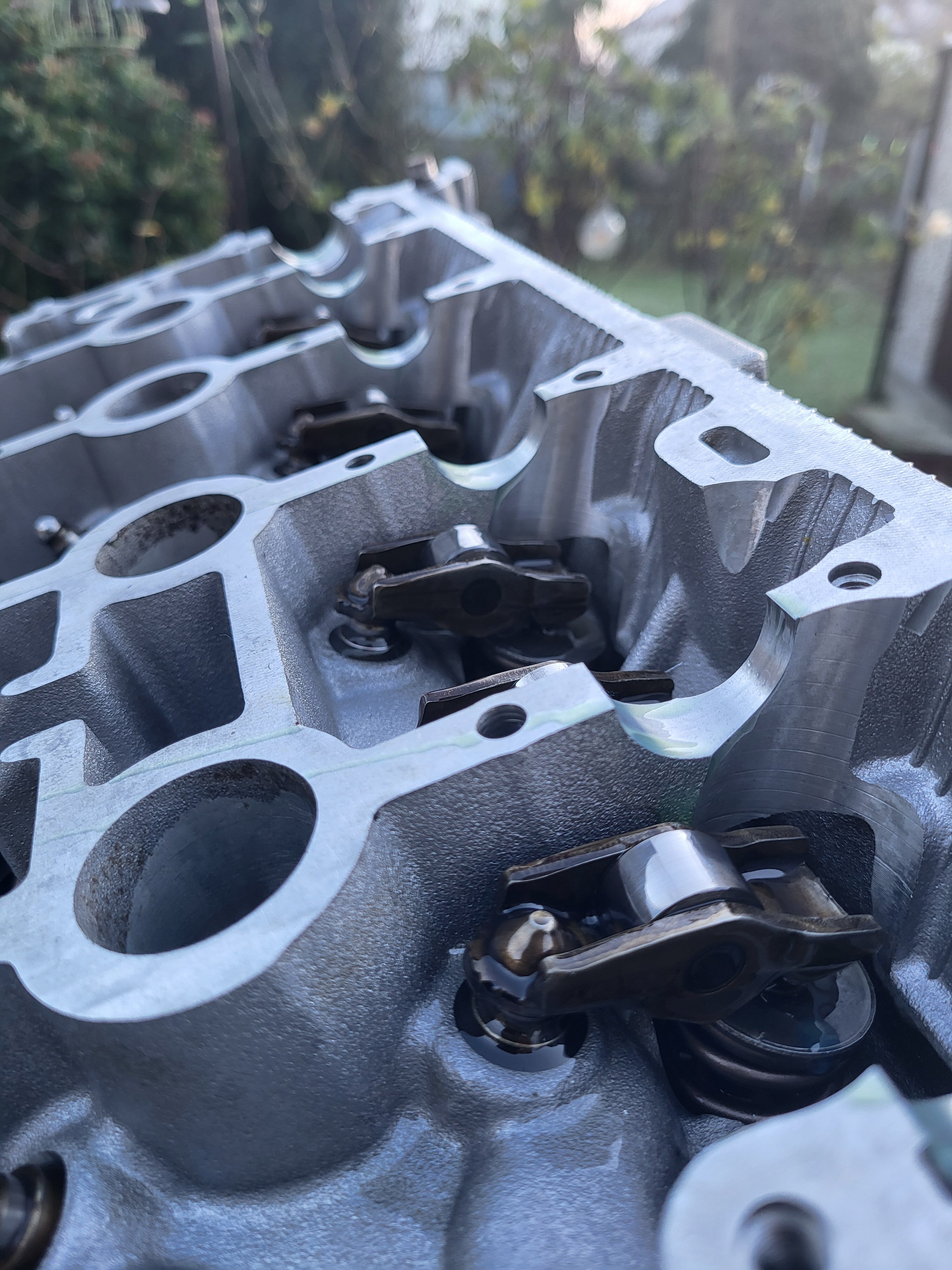

cylinder head has been ported/polished by M.S.Customs - again not sure if theyre on this forum but find them on facebook if you want work done! they recut the valve seats, modified the intake/exhaust ports, checked all the tolerances, pressure tested, gave it a skim and rebuild the head with Wossner valves and uprated cat cam springs (and new stem seals). Very happy with the result.
I hate putting heads on! so much at stake! and the need for so much force while trying to stay to delicate precision...
but its on! time will tell if on correctly.

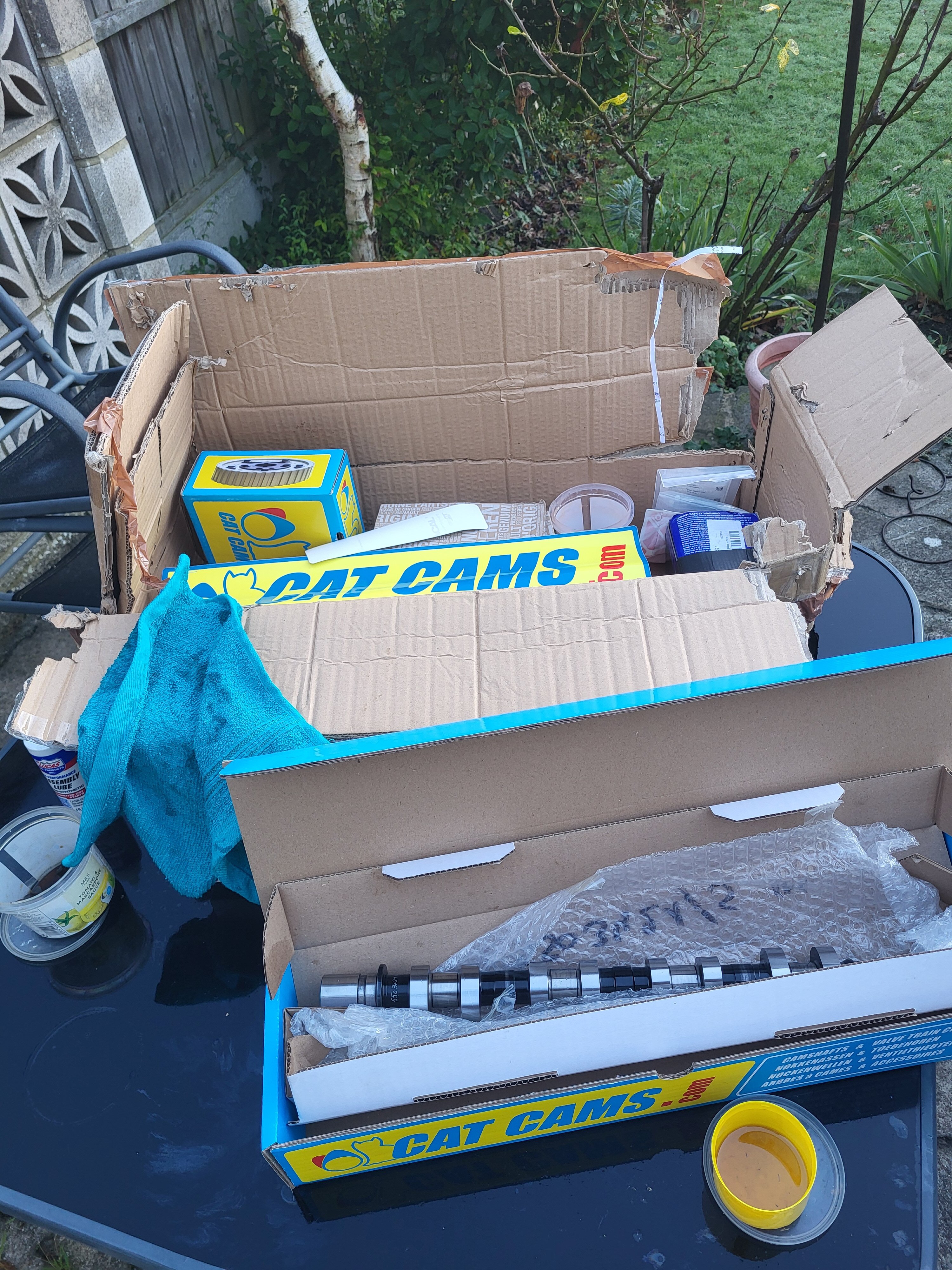

I found out the other day that the cams i have ordered (5503421) are on back order and wont arrive for another month. So my build has basically ground to a hault.

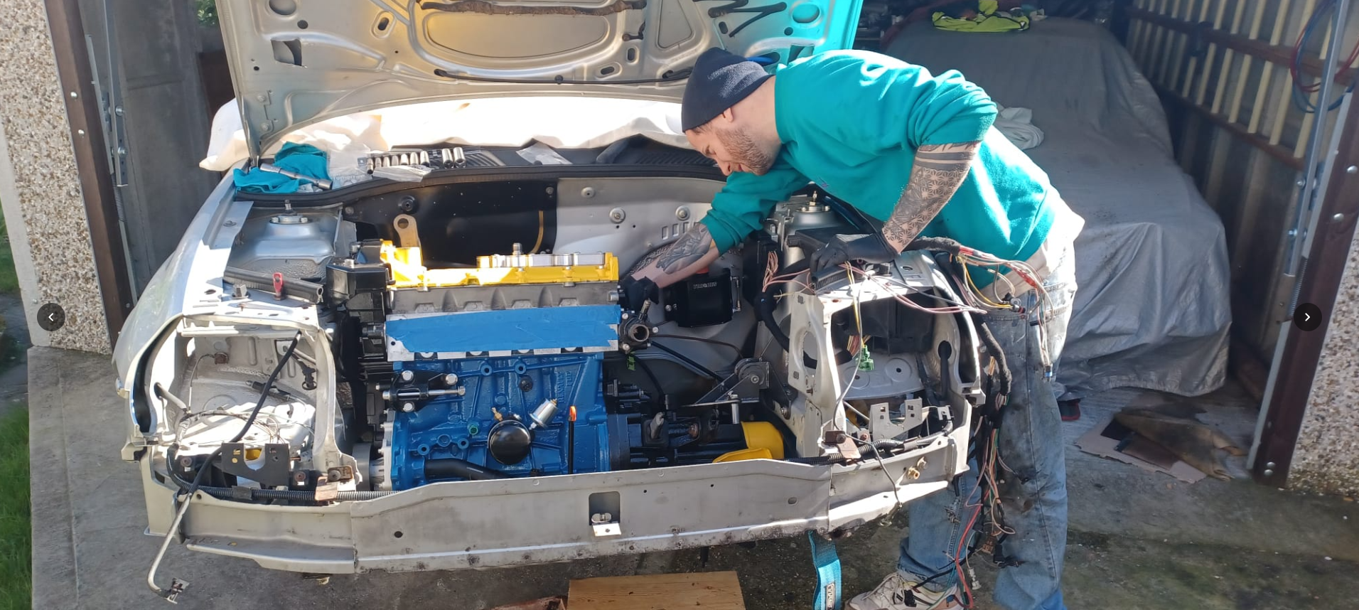

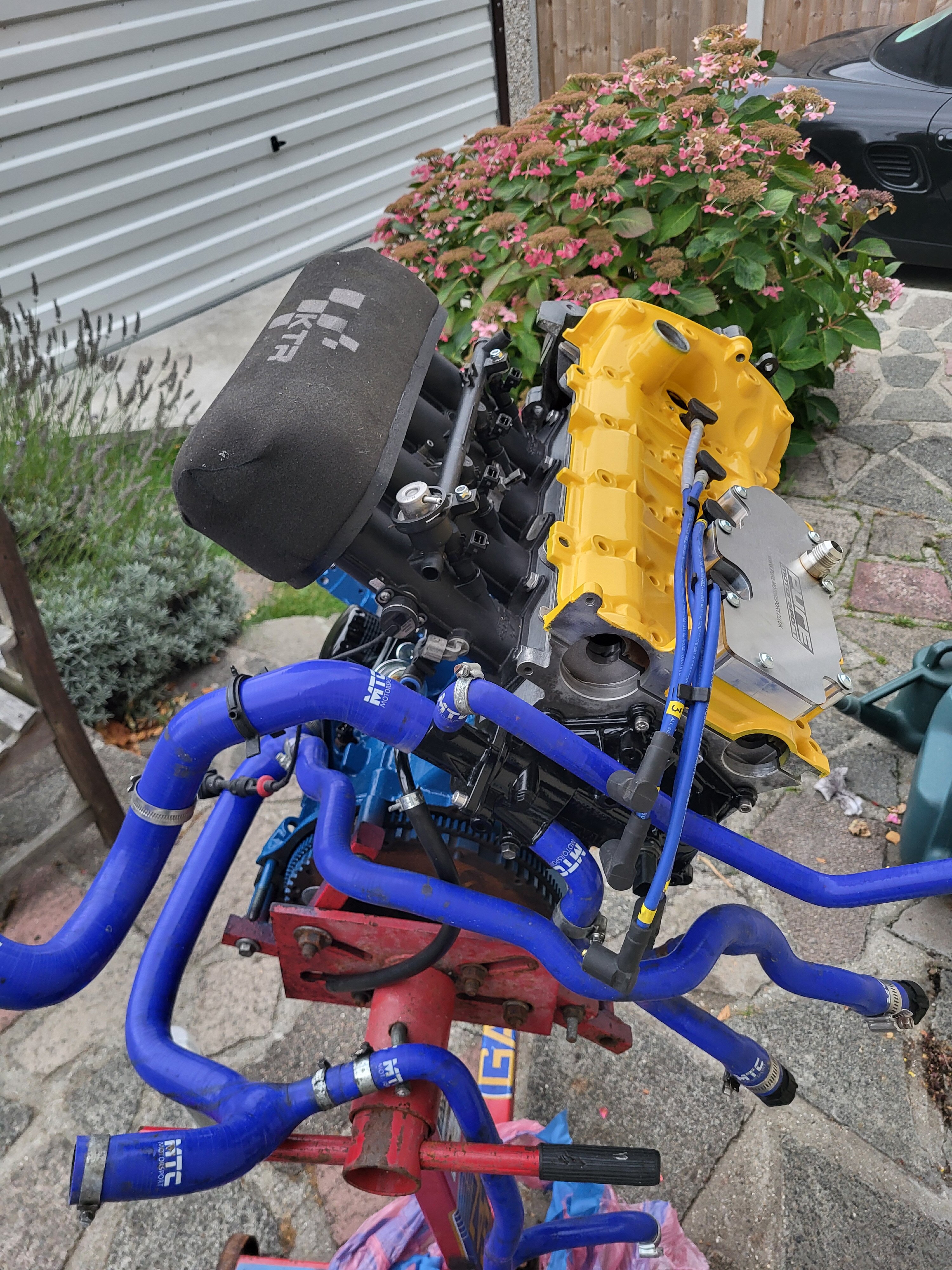

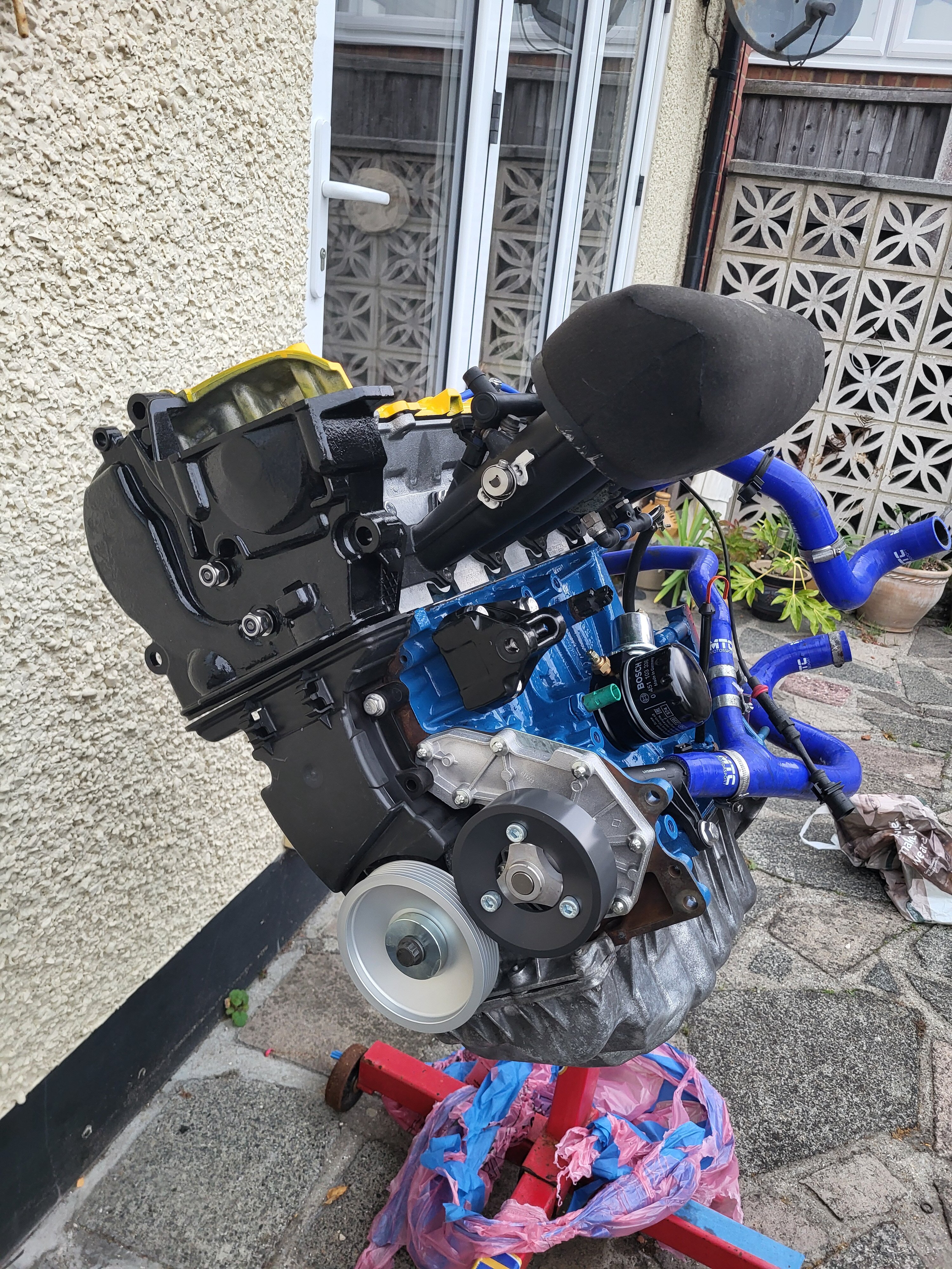

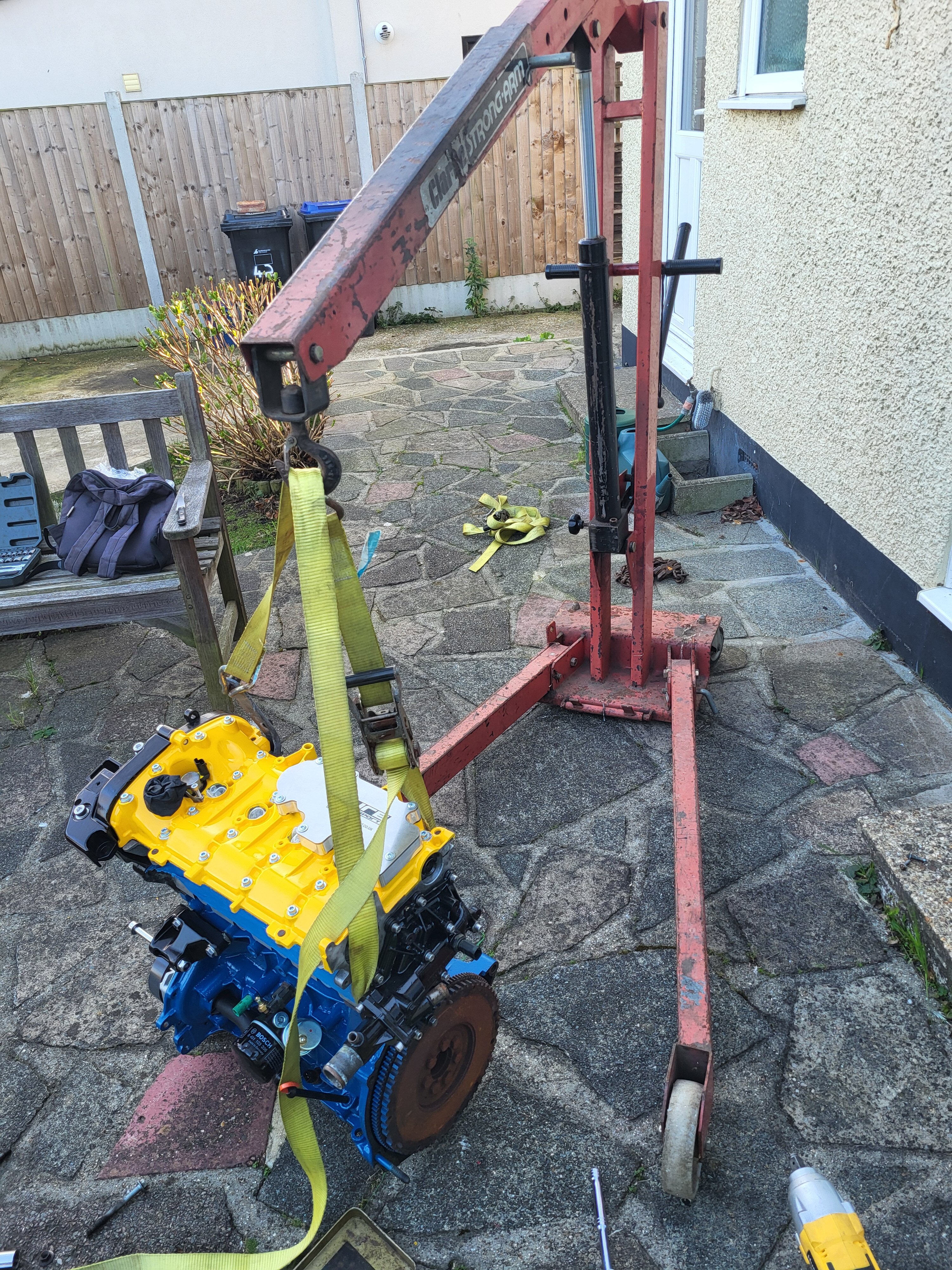

in my bordom i decided to just test fit a few bits i had lying around to see what the engine would look like once complete. great use of time if you ask me!

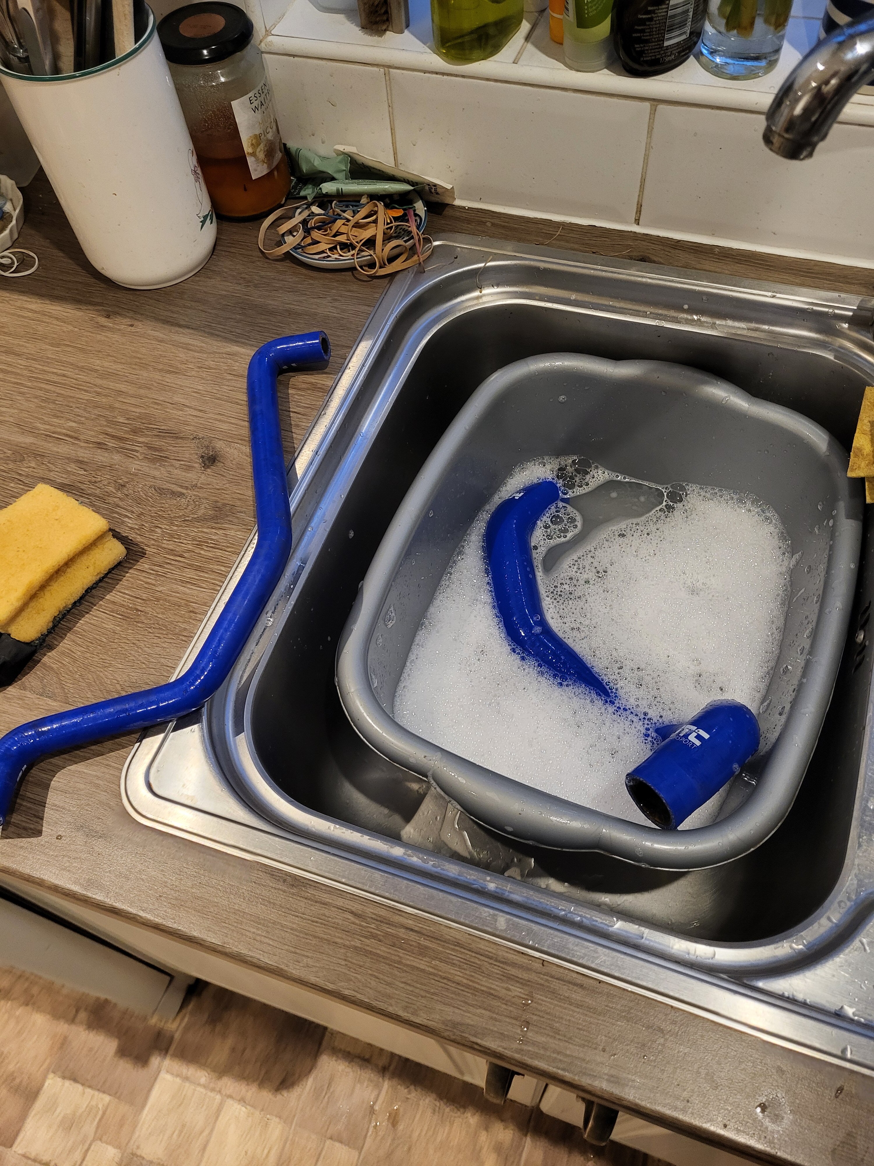

realised then that the second hand hoses i bought were dirty...

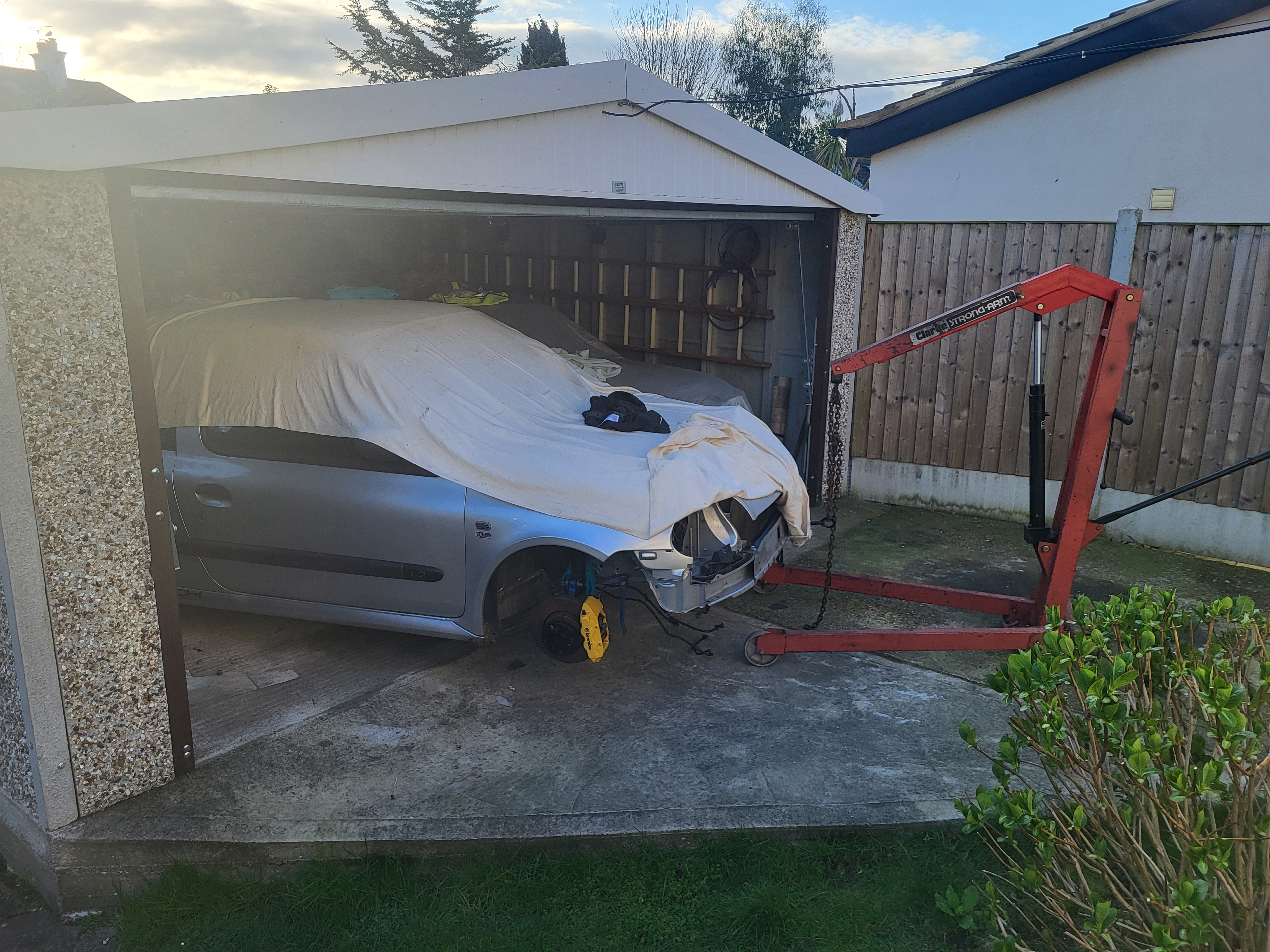

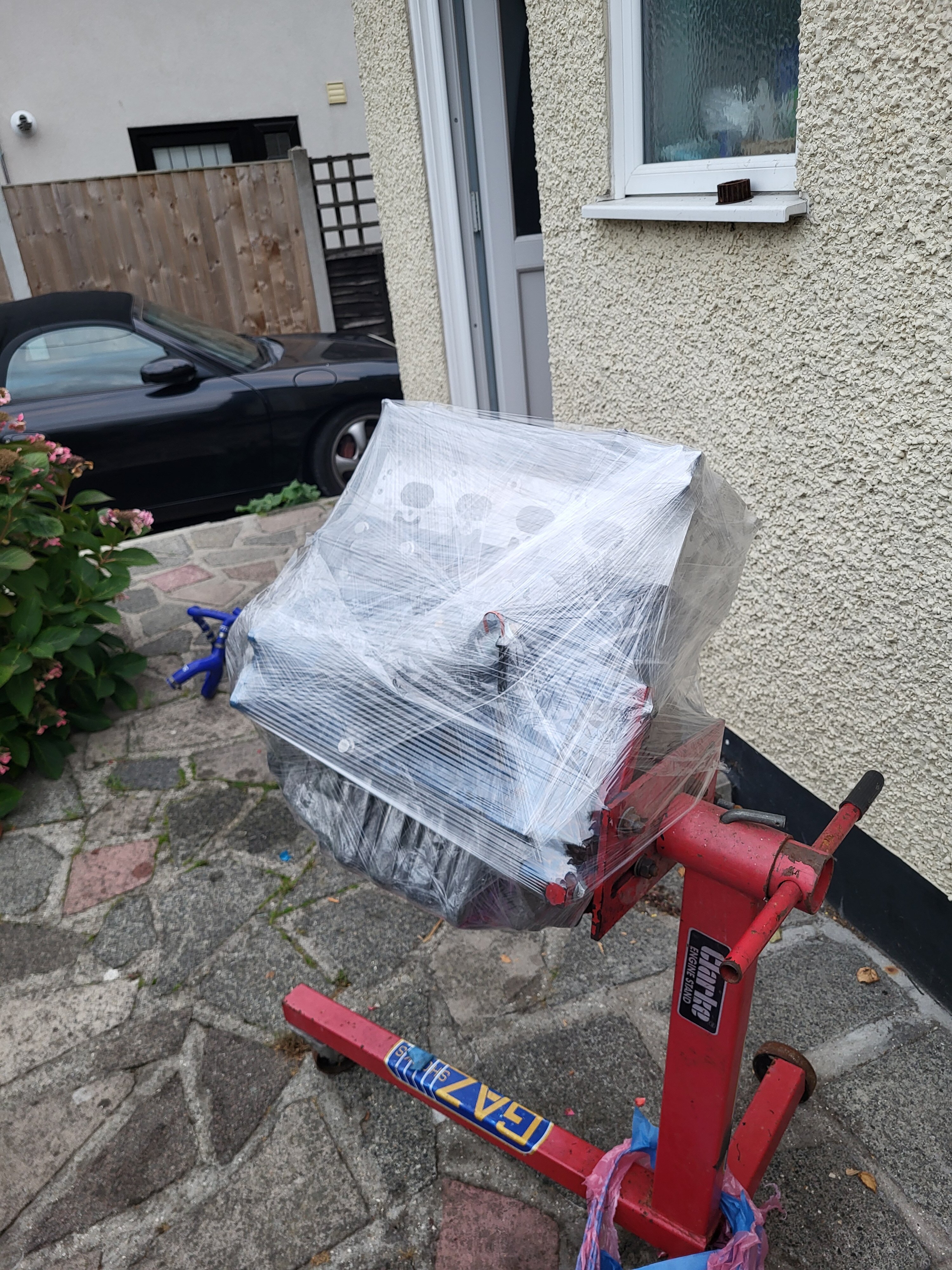

And finally, in case you wondered how i leave my engine out at night with the newly refurbished head exposed... ask no more.
After this a few bin bags over the top and just tape it all up!
How much was the driveshaft refresh? Mine are looking quite tired now and could do with some sprucing up.
Also make sure the clutch you're fitting works with the lightened flywheel. I made the mistake of fitting a stock clutch the first time around, which wouldn't engage any of the gears. Ended up going with a Sachs Performance clutch kit as they have more clamping force than standard.
oh wow, thanks for the heads up, i hadnt considered at at all! this is an engine dynamics one, didnt say anywhere that it wouldnt work with the standard clutch but will check.
Drivesaft refurb was £250 - quite steep considering the price of pattern parts but was all proper Renault components used.
Might be worth sending ED an email to check, means you'd avoid pulling the engine back out like I had to do lol
£250 doesn't seem so bad considering you can't buy the ph1 shafts anywhere now!
This was my thinking! I read so much about people getting the wrong lengths with pattern parts and having knocking issues. Especially for ph1s as it sounds like they changed every dimension a tiny amount just to make sure the ph2 parts wouldnt quite work right!

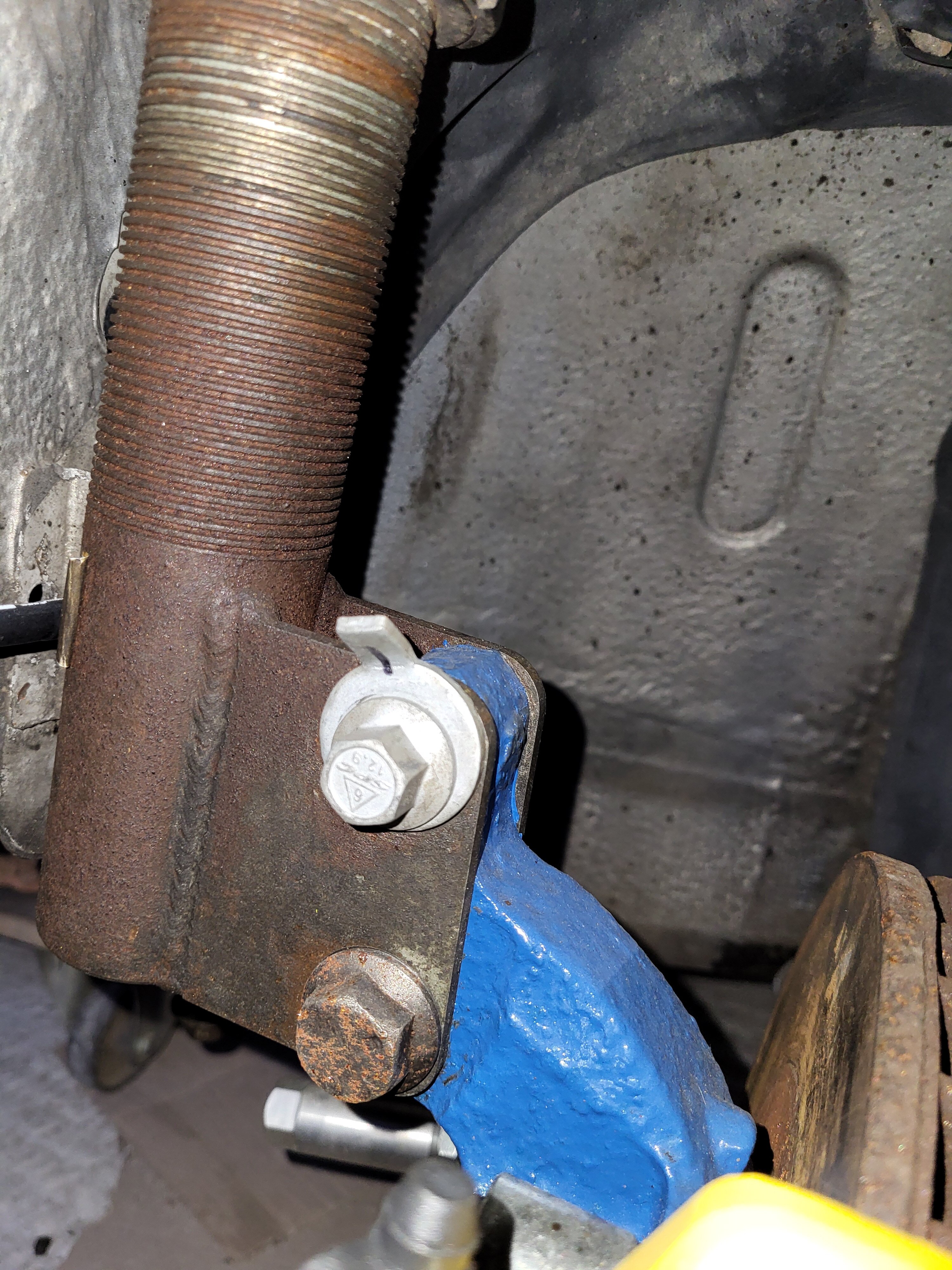

@Struggler Good to see the Ph1 getting some love :love: Front subframe all looks great, it's on my list of things to do along with the rear beam, any tips? I was going to get it powder coated along with the wishbones but someone else said raptor the subframe, not in any rush, it doesn't have an MOT currently and I SORN'd it for the Winter yesterday, but am going to come up with a plan!
I think my one tip would be to remove the pivot bolt on each side rather than removing the bracket from the body. This way you can avoid the risk of the captive nut just spinning. Once that happens it becomes a massive headache. Downside of that is you need ot drop the fuel tank a little one side to get a bolt out but still not remotely difficult. I managed it all on my own.
I was going to go down the powdercoating route but read some stories about peoples cracking and chipping almost immediately. Not that this wont happen with painting but its pretty cheap to paint.
Also recommend the axle spacers, really imrpoves the stance.

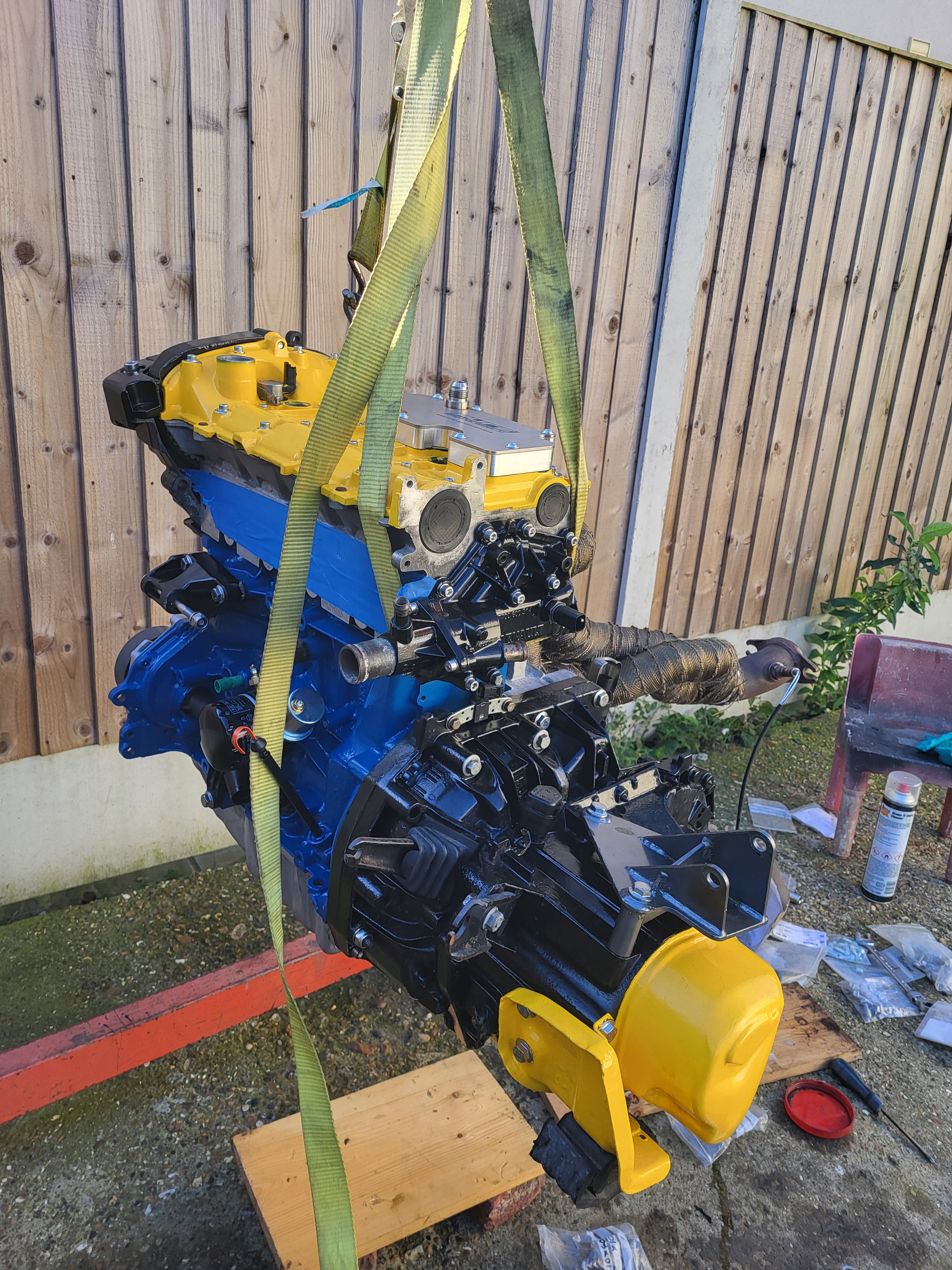

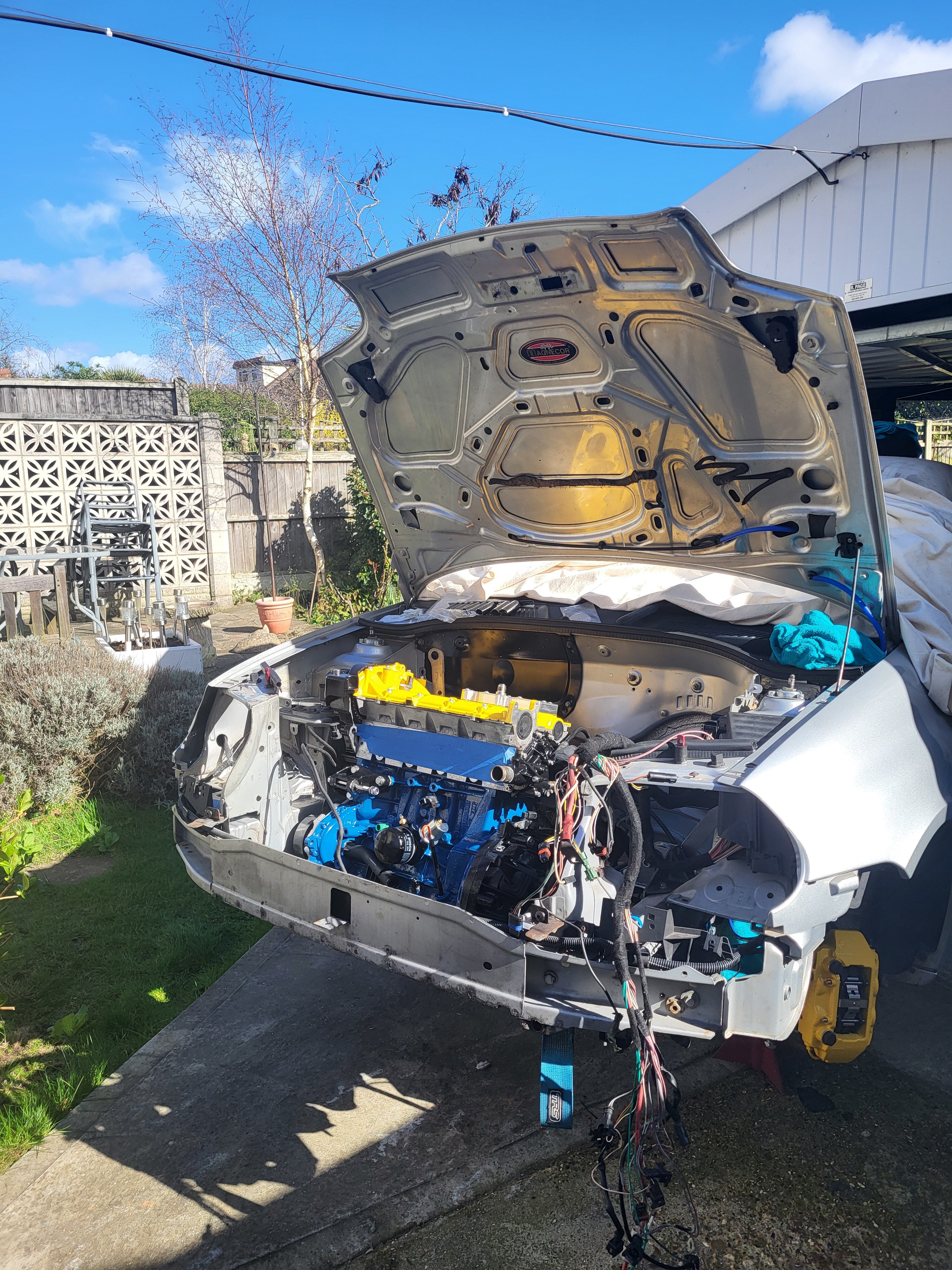

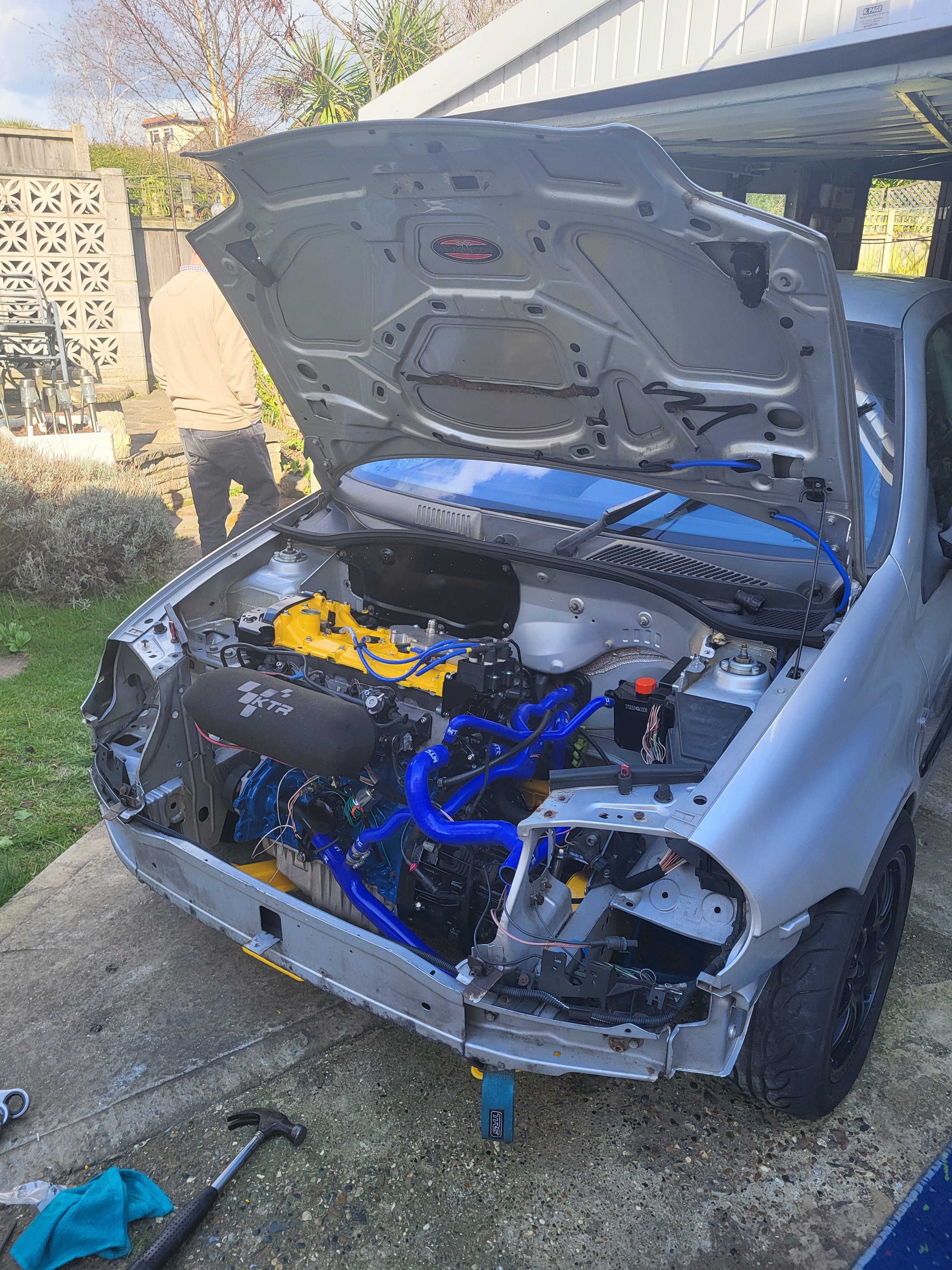

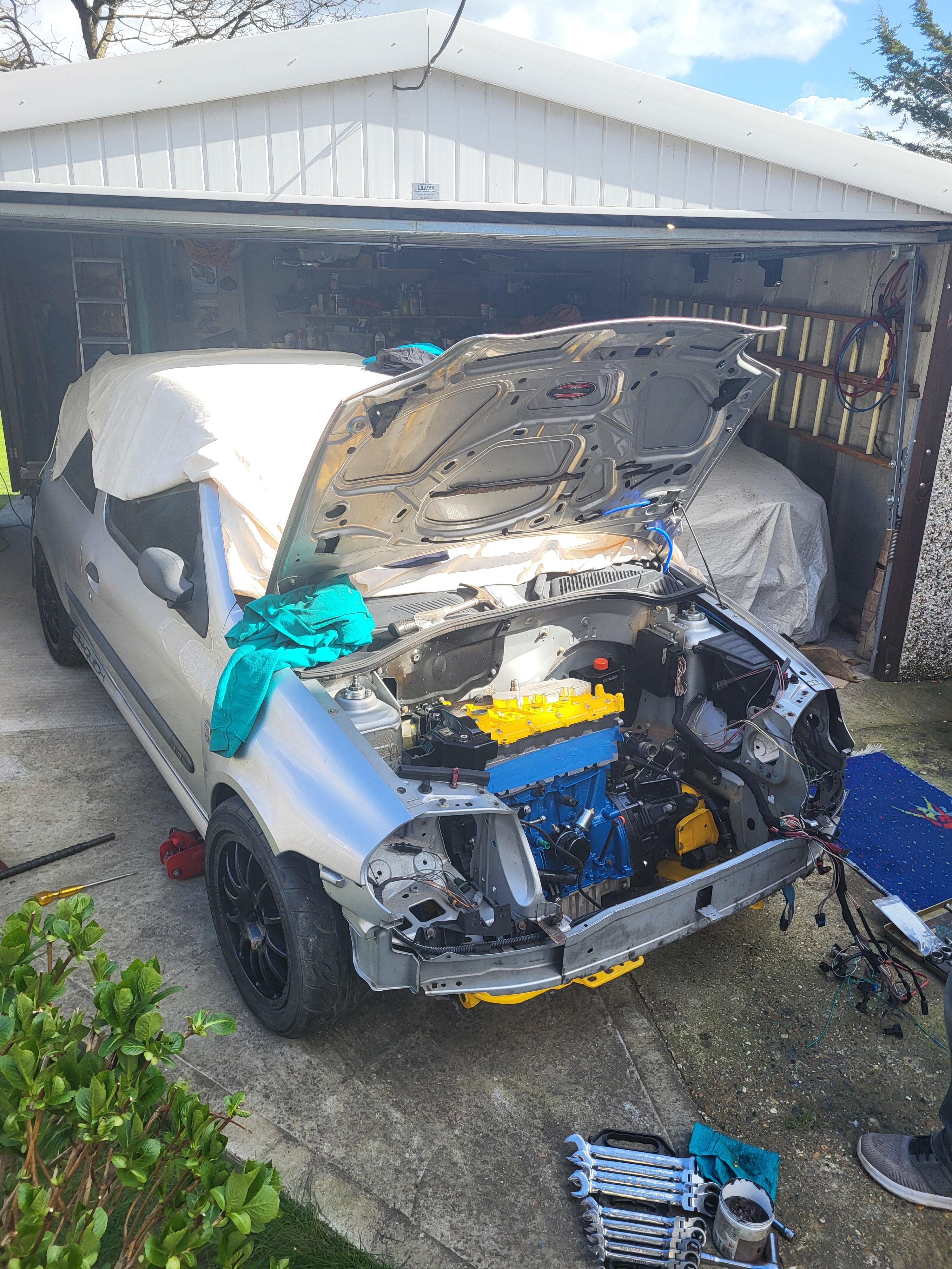

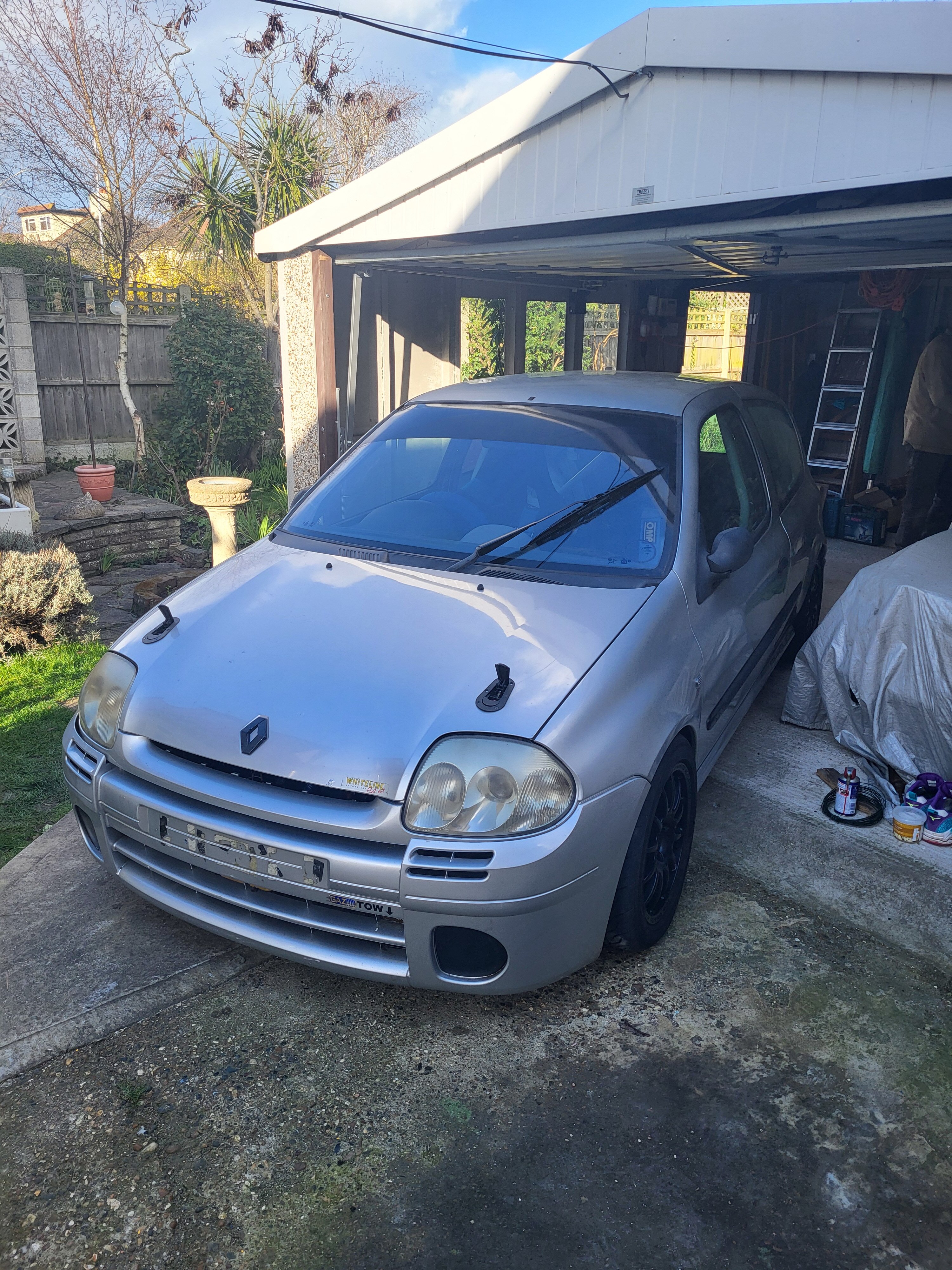

Update!
I've not really updated this in a while. The problem i have is the cams are still on backorder so I'm really just spending my time getting other bits and bobs done.

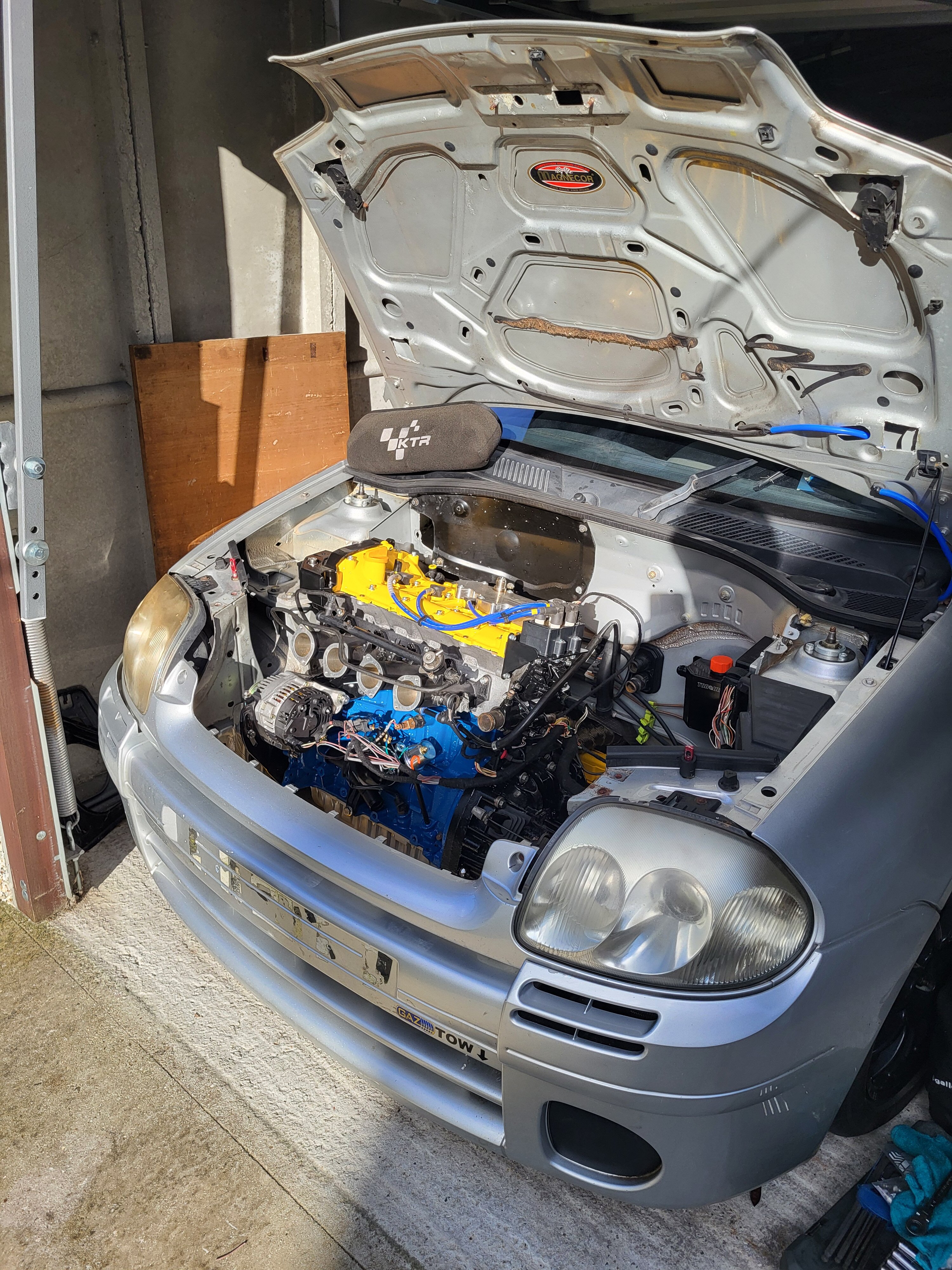

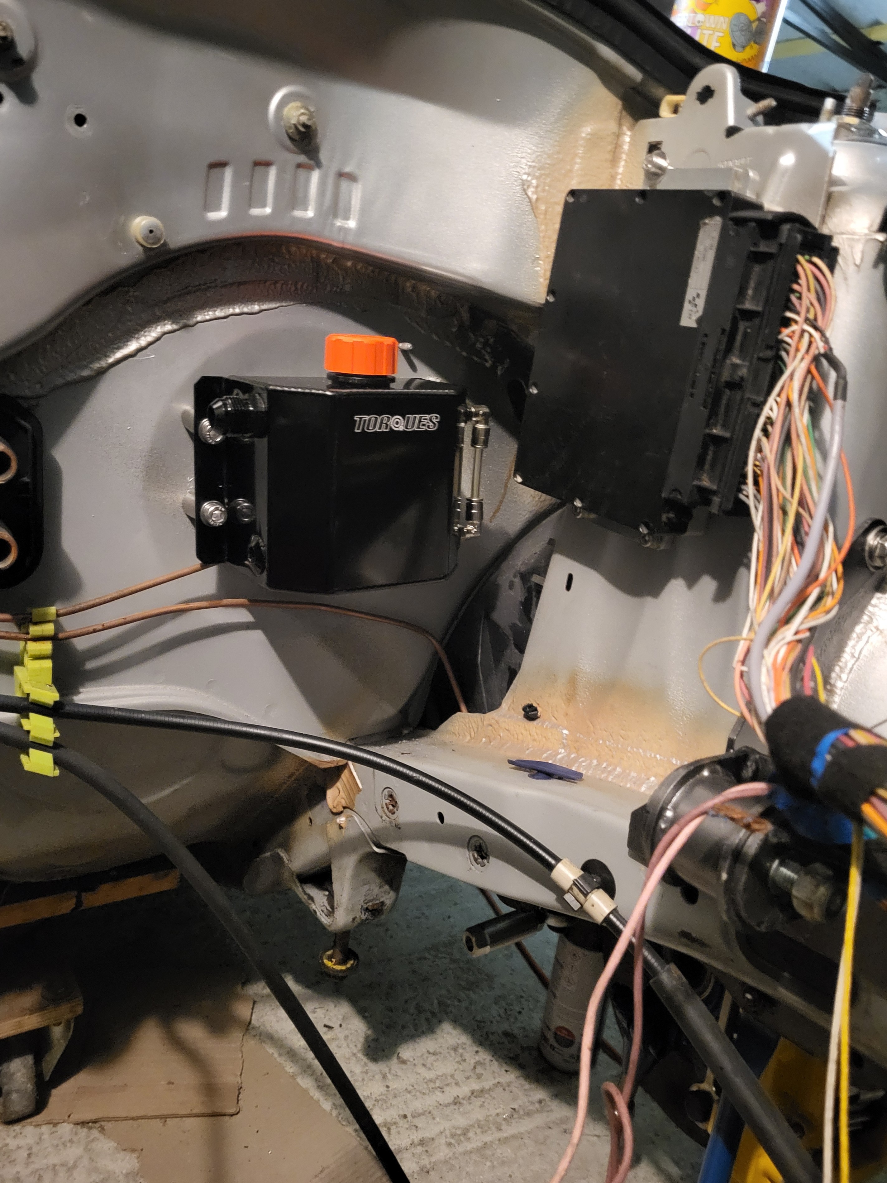

Fitted the ECU to the shock down and the catch can. Im running the PMS gearbox mount so theres really not going to be anything else to mount to in the area. You might also notice that I've used some spacers on the catch can. I put brakeline pass through right in the middle of this section of firewall before realising i wanted to put hte can there. Rather than move it ive spaced the can out on top. restricts access to the brake line which isnt ideal but its using M8 bolts so not going anywhere. Might change later but will involve draining the brake system.
Also its not as wonky as it looks! its just the body shape makes it look so ;).

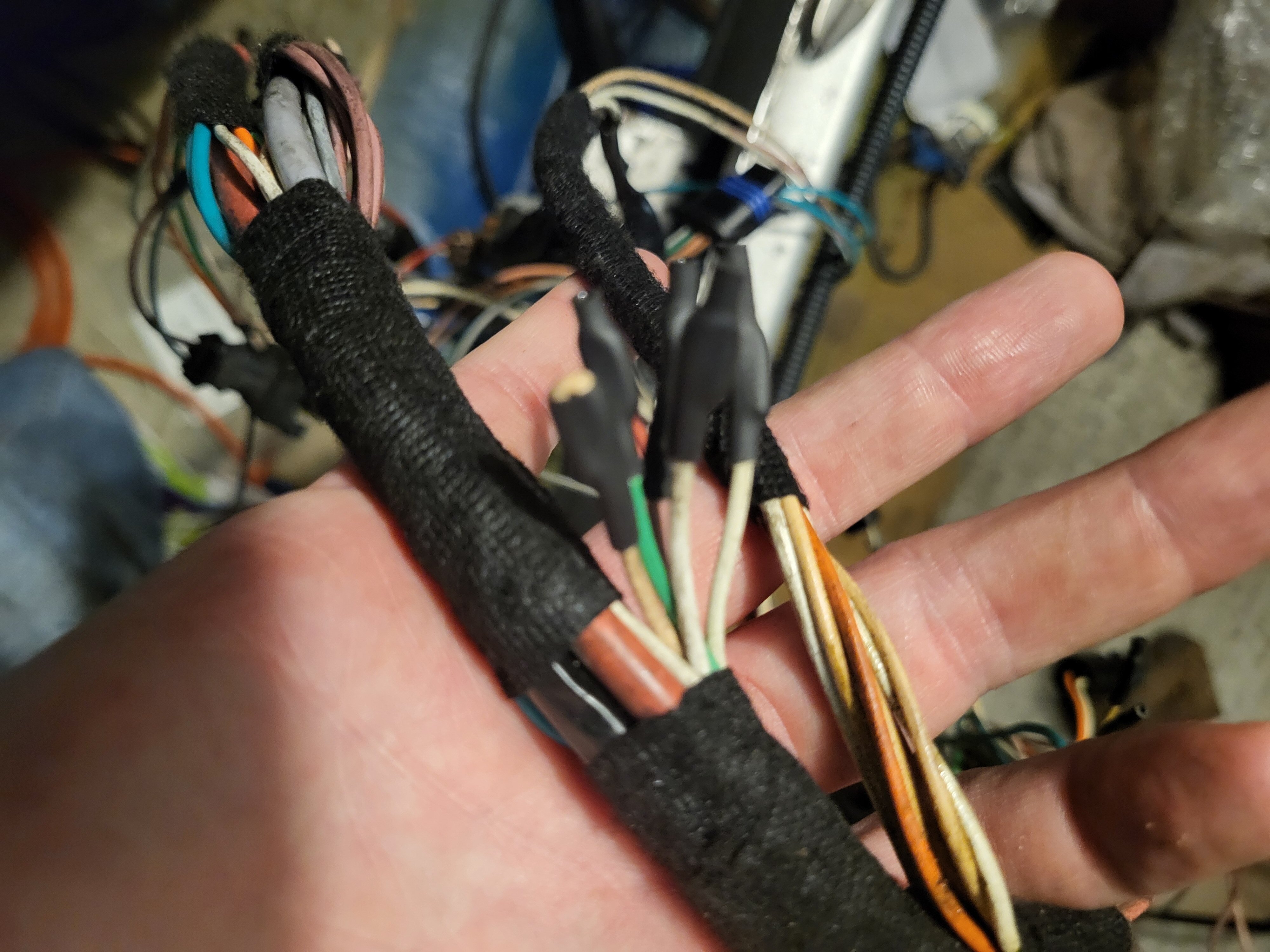

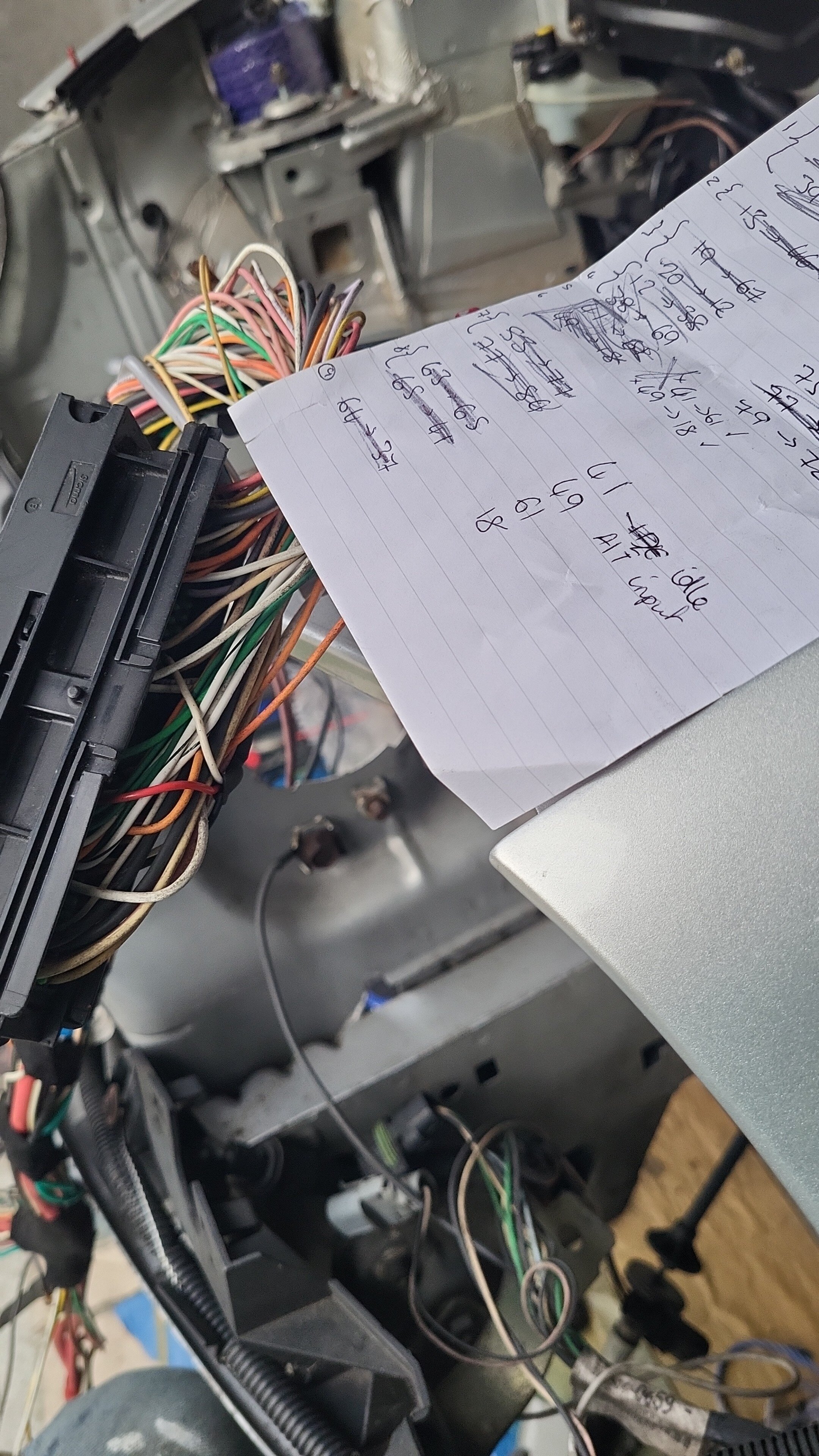

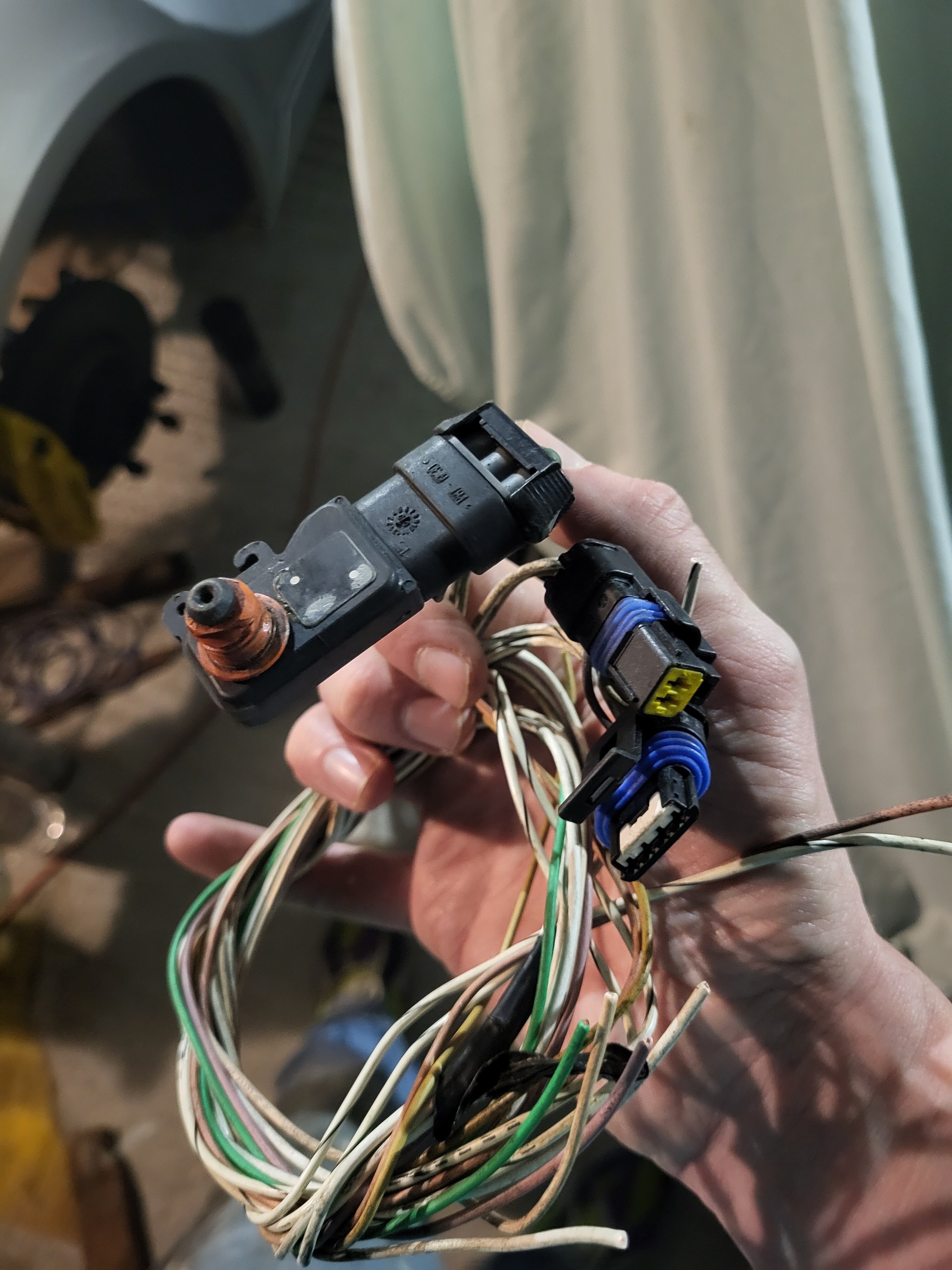

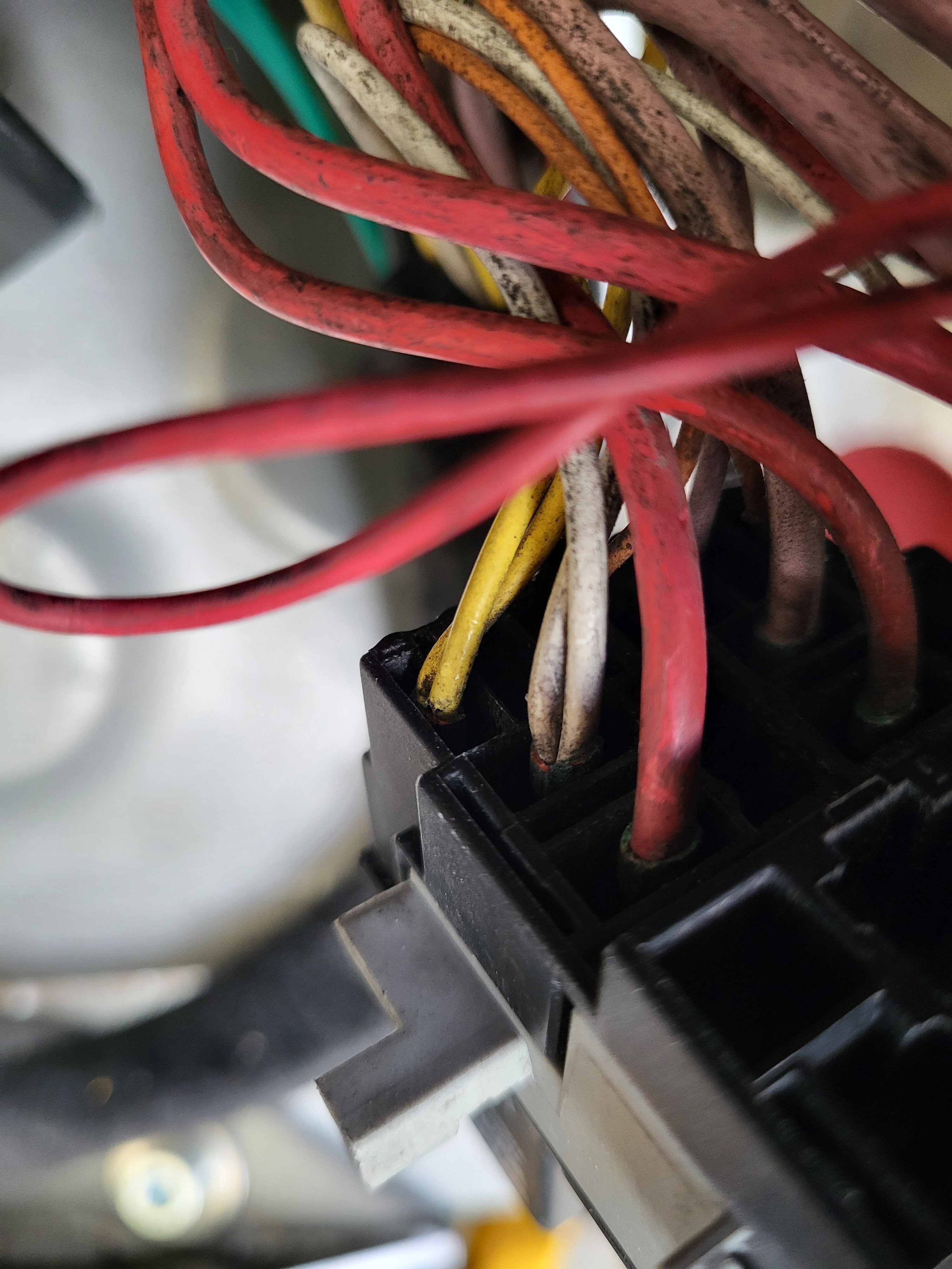

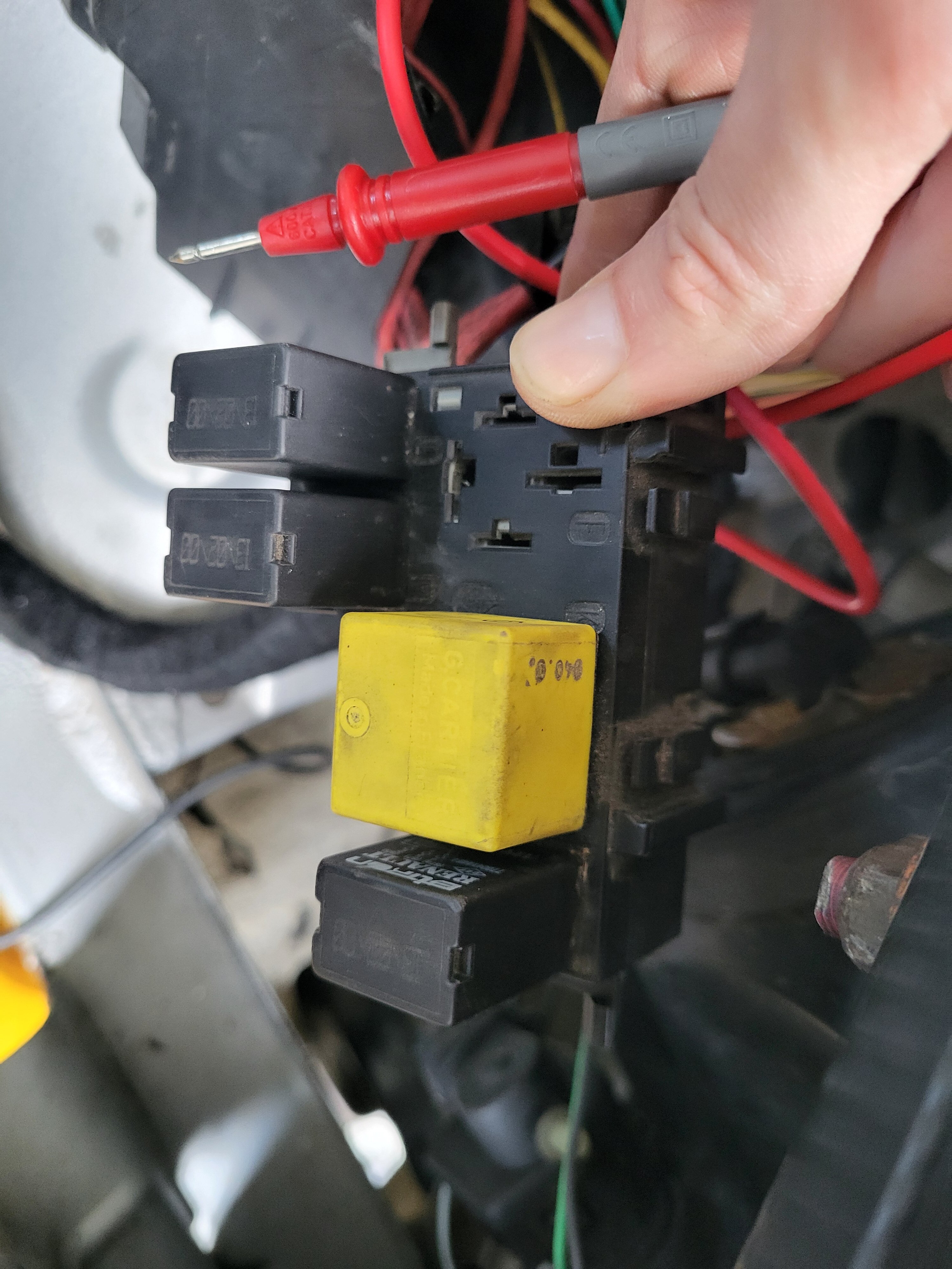

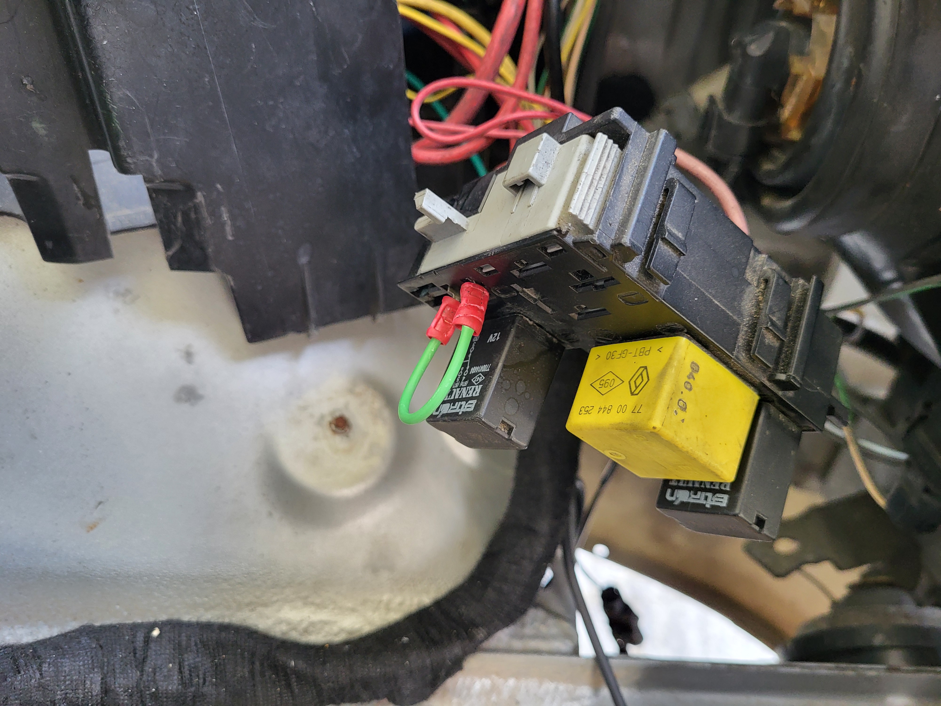

The Gen90 ECU im running is designed only for the ph2s, and Renault made the wonderful decision to completely change the engine loom with the facelift. So you had the wonderful task of repinning all of the ECU to match. Horrible job that im not 100% sure ive done correctly.
Then went about hacking some connectors off the loom to tidy it up. ITBs cannot run an idle control valve or MAPs sensor so they're gone. Also not running VVT so lopped off the VVT solenoid connector. Left some length on the wire in case i change my mind and want to put it back on!
All capped off!
Another wonderful ph2 only design - the ITBs run a throttle position sensor, same as the ph1 but a different unit with its own wiring. KTEC supply an addaptor for the ph2 throttlebody, which again is obviosuly not compatible with the ph1 loom.
So cut that off and hard wired it into my engine loom
Then just started rewrapping the loom to tidy it all up. probably not worth doing at the moment since i dont know the final routing for the wiring until the engine goes back in, but makes it look a bit tidier!

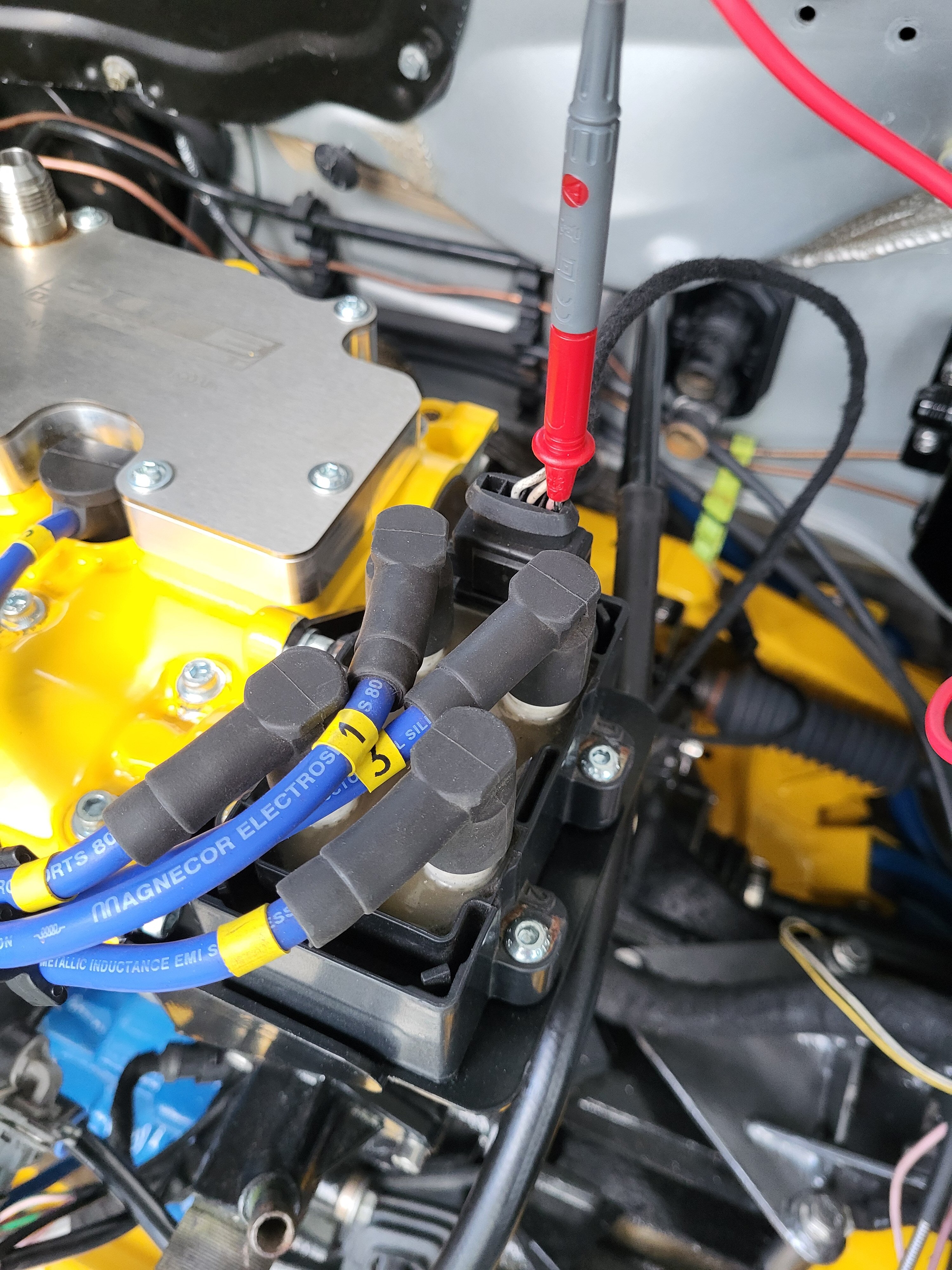

Thinking about it, now that ive repinned i should be able to power it up, I'm unclear on if the gen90 runs an imobiliser, which obviously might be quite unhappy when it picks up my key in the ignition.
I should probably invest in the wire and software so i can do some of the software side.
If it’s second hand and got a map on it then it might run better than mine did on start up.
Isn’t the immobiliser on a different ECU behind the gear stick? I never did anything about an immobiliser on mine
Behind?
There is (what i think is) the airbag module in front of the shifter, bolted to the floor, but thats long gone.
Im pretty sure there is another computer behind the dash somewhere near the fuse box. Maybe its in here.
Will stick the key in next week and see what the light does.
Oh maybe was thinking of the airbag module. I knew there was something behind it!
Yeah I wouldn’t worry too much about the immobiliser, mine seemed to still work and I didn’t do anything and I’m a proper ham fisted idiot when it comes to fixing things.
No , the immobiliser is part of the UCH box , not a separate ecu.
thats great news! thanks!
Where abouts is the UCH box?
Is it somewhere in this general area?
Yes that’s correct , the black box that all the loom connections plug into where you have circled.

So, its been a while since I posted hasn't it!
I had a nice timing plan for the build set out with the engine being back in the car before winter. Got to ordering all the parts to make that happen, then... CatCams.... Placed my order through in October with plenty of time and sunlight and nice weather left of the year but when following up was told they needed to be specially made and would take 6 weeks, which ground everything to a halt a little but I found the above loom work to get done in the meantime.
Unfortunately the delays kept coming and I started to panic that the engine was going to be left outside over winter without even the rocker cover on. Had I known I would have kept the head inside and waited until spring, the engine stood outside per the last image I shared albeit with a tarp around it.
Anyway, nearly 12 weeks after ordering, literally when the days are at their shortest and we are down to single figures, this finally arrives!
Not wanting the open engine to be outside a second more than it needs to I went down to Essex to get the engine built up thinking hopefully if I start at 8am I can get it all done before the light fades.

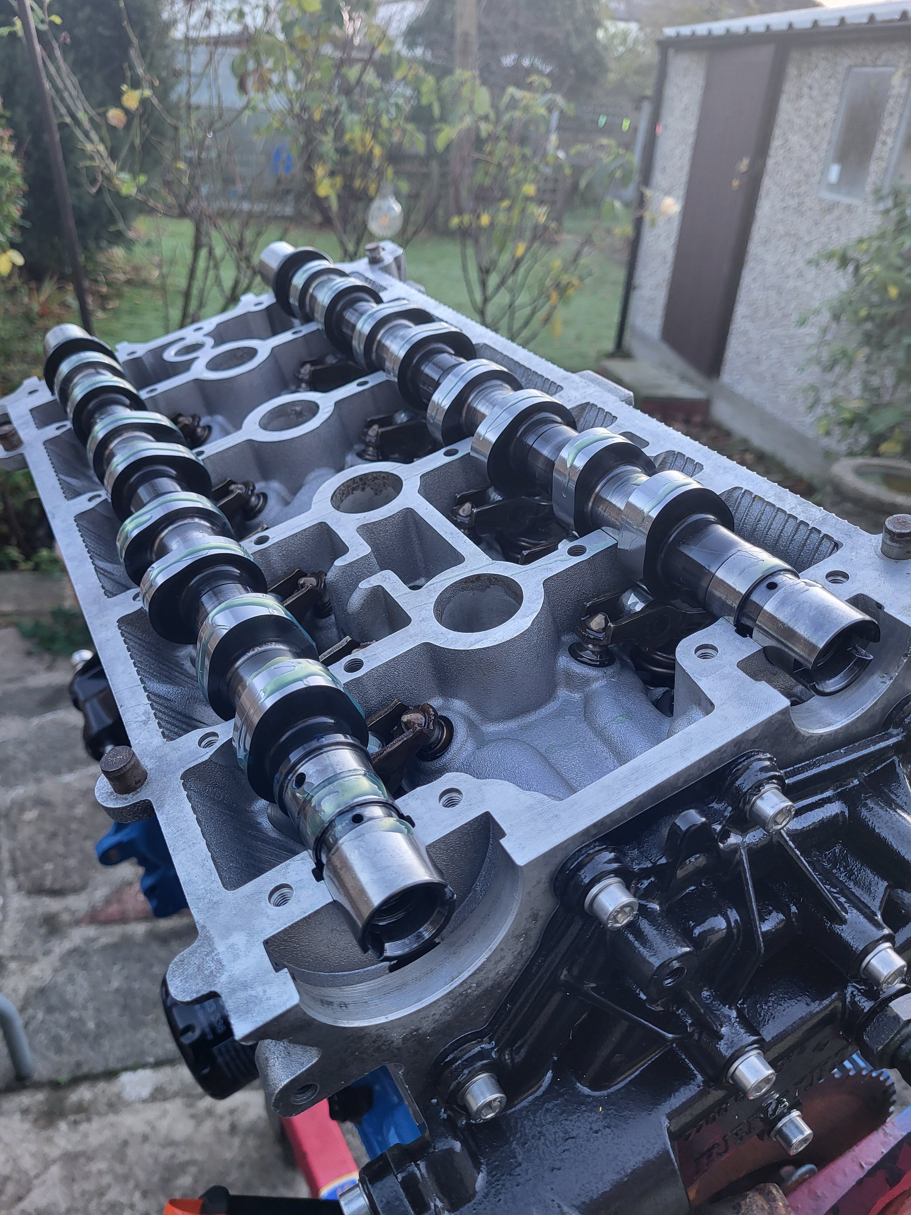

Nice little pile of toys to fit.

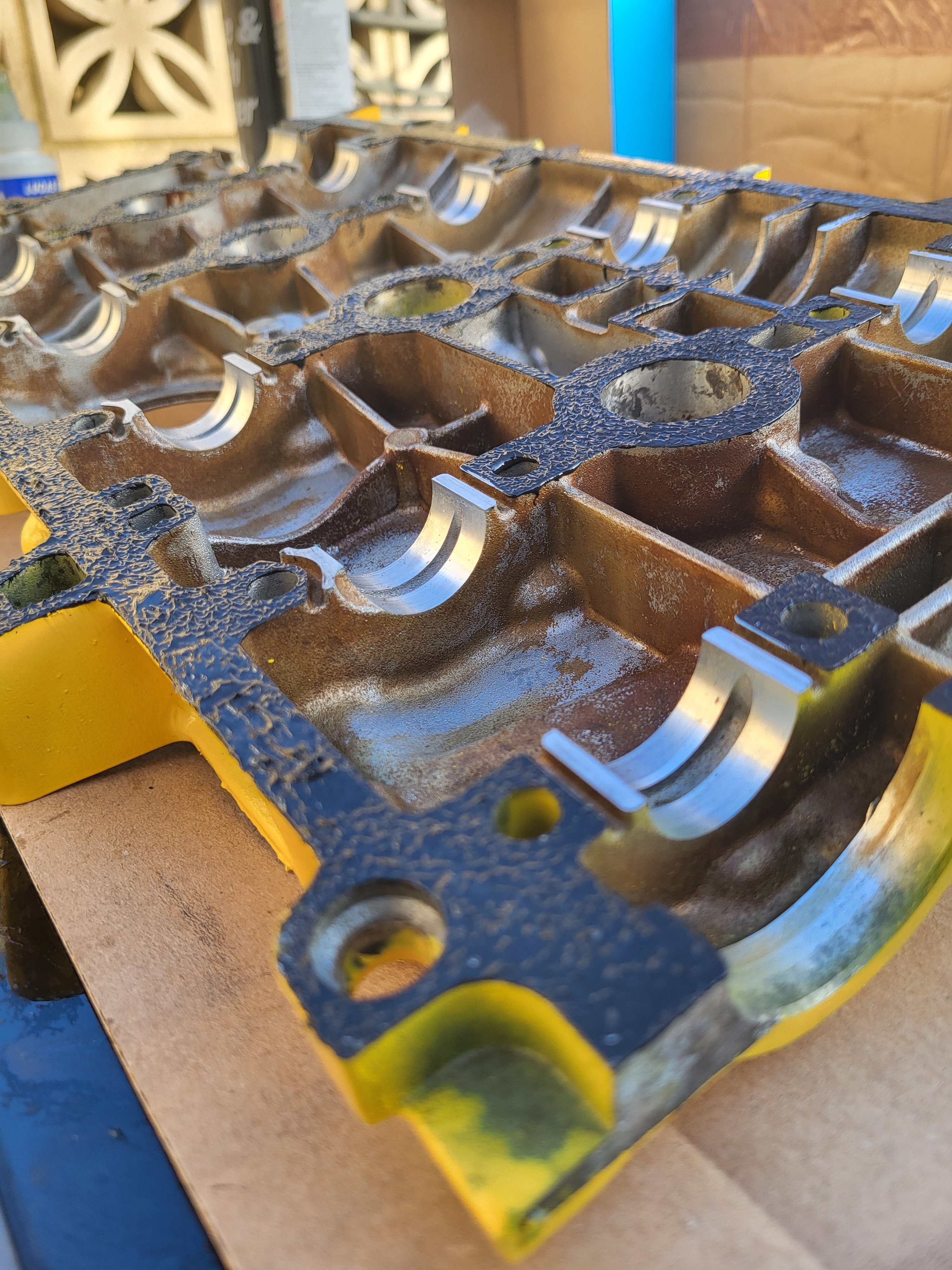

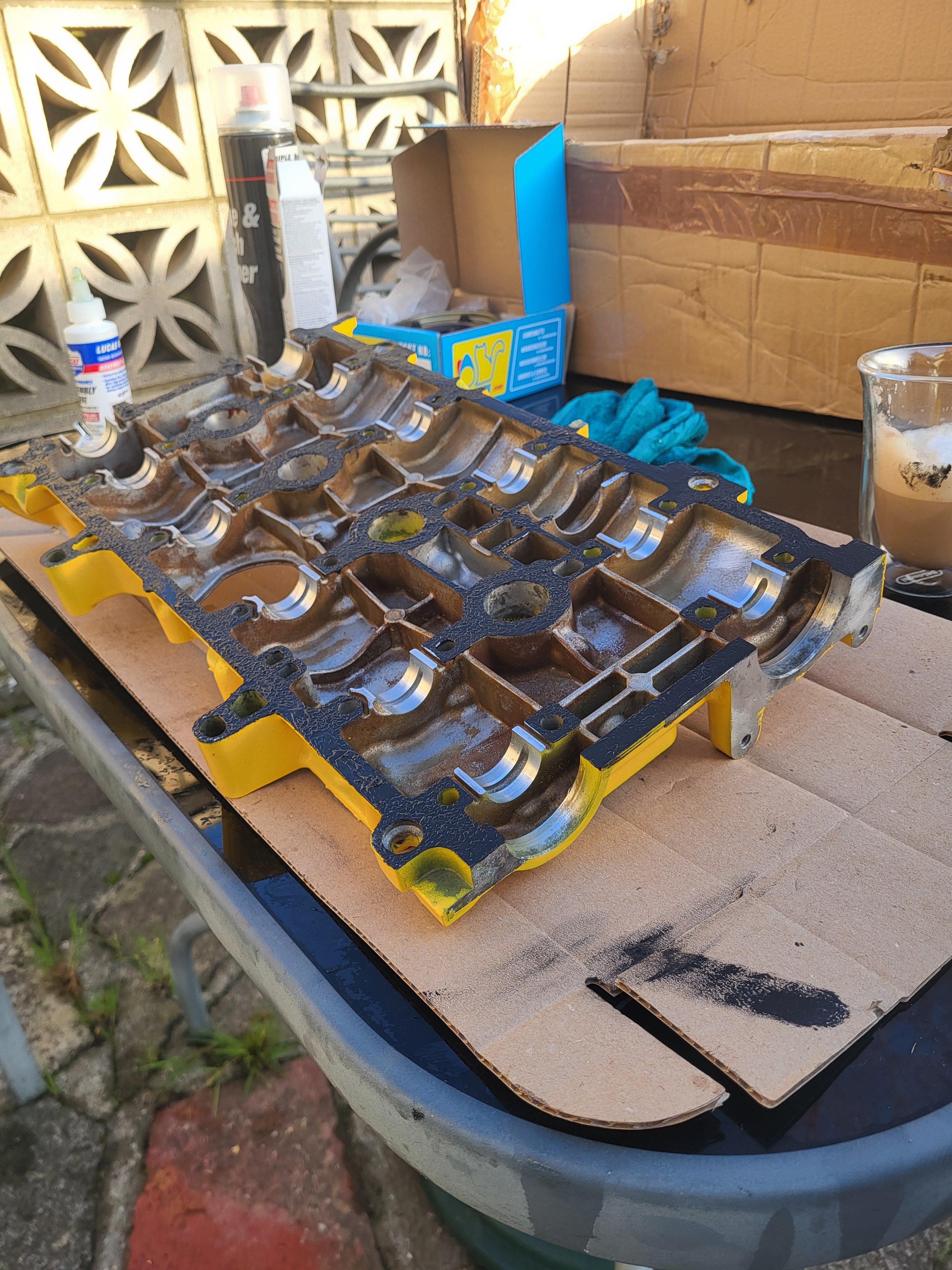

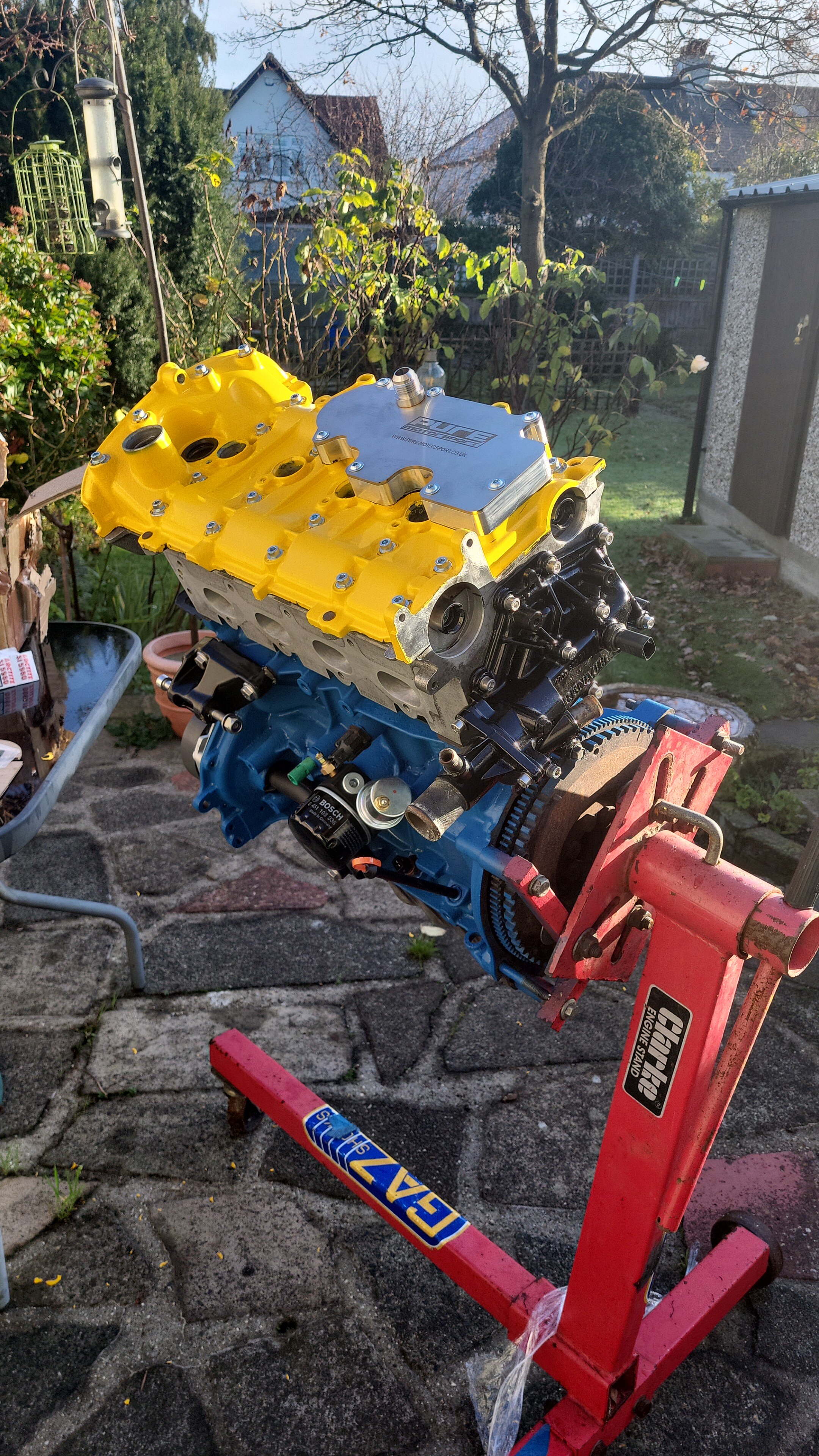

Lifters and followers fitted followed by cams with lots of assembly lube
This stuff is the bane of my existence. Knowing that putting on too little risks an oil leak that can only be solved by removing all of the timing etc but too much risks some silicone coming off and clogging the oil pickup and destroying the engine makes it a task fraught with anxiety, especially for a first time... and it gets f**king everywhere!
Did I put on too little? too much? time will tell but only a very small bead came out the sides so I am hoping I fully Goldilocks'd it.
Running all the bolts down ruined my lovely painting... oh well, not time to dwell, it still looks good from afar.
See! looks fine. Also you can see how much gasket stuff came out the sides, if someone knows for a fact that I've screwed up royally, please let me know... gently.
Then it was just a case of putting the cambelt on and timing it up.
This was... interesting, and I'm a little worried the timing may be every so slightly out. You see some videos of people just putting the timing tool in with a finger and it sliding gracefully left to right. Mine does, it goes in with a push, but needs a push. We are still talking one handed push, but full palm not fingers. Most sources suggest that this is fine and I put some of it down to the aftermarket cams and springs having a lot of overlap at TDC, even with no cam pulleys installed at all the cams didn't want to sit perfectly level as the springs were under some compression at TDC.

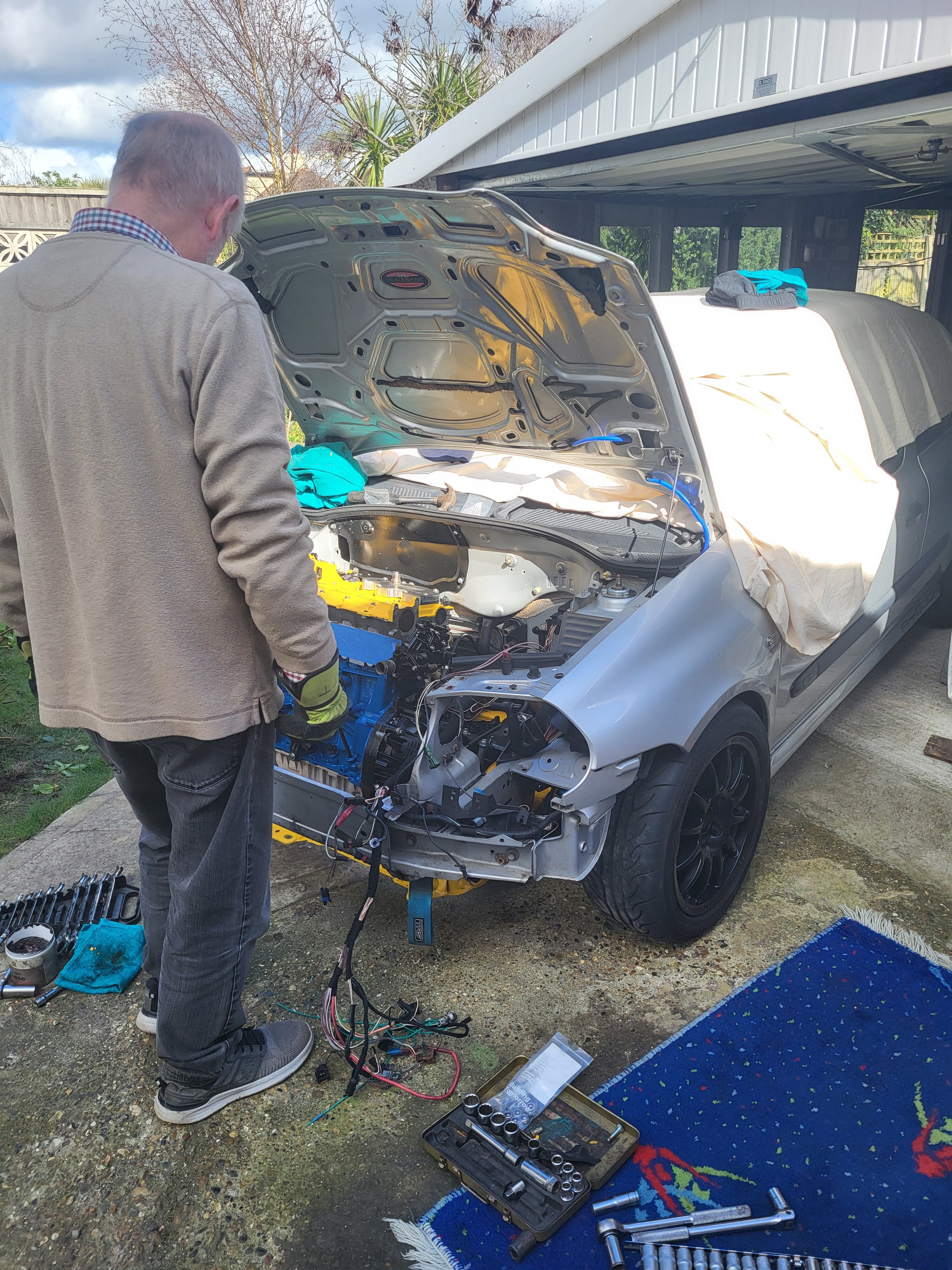

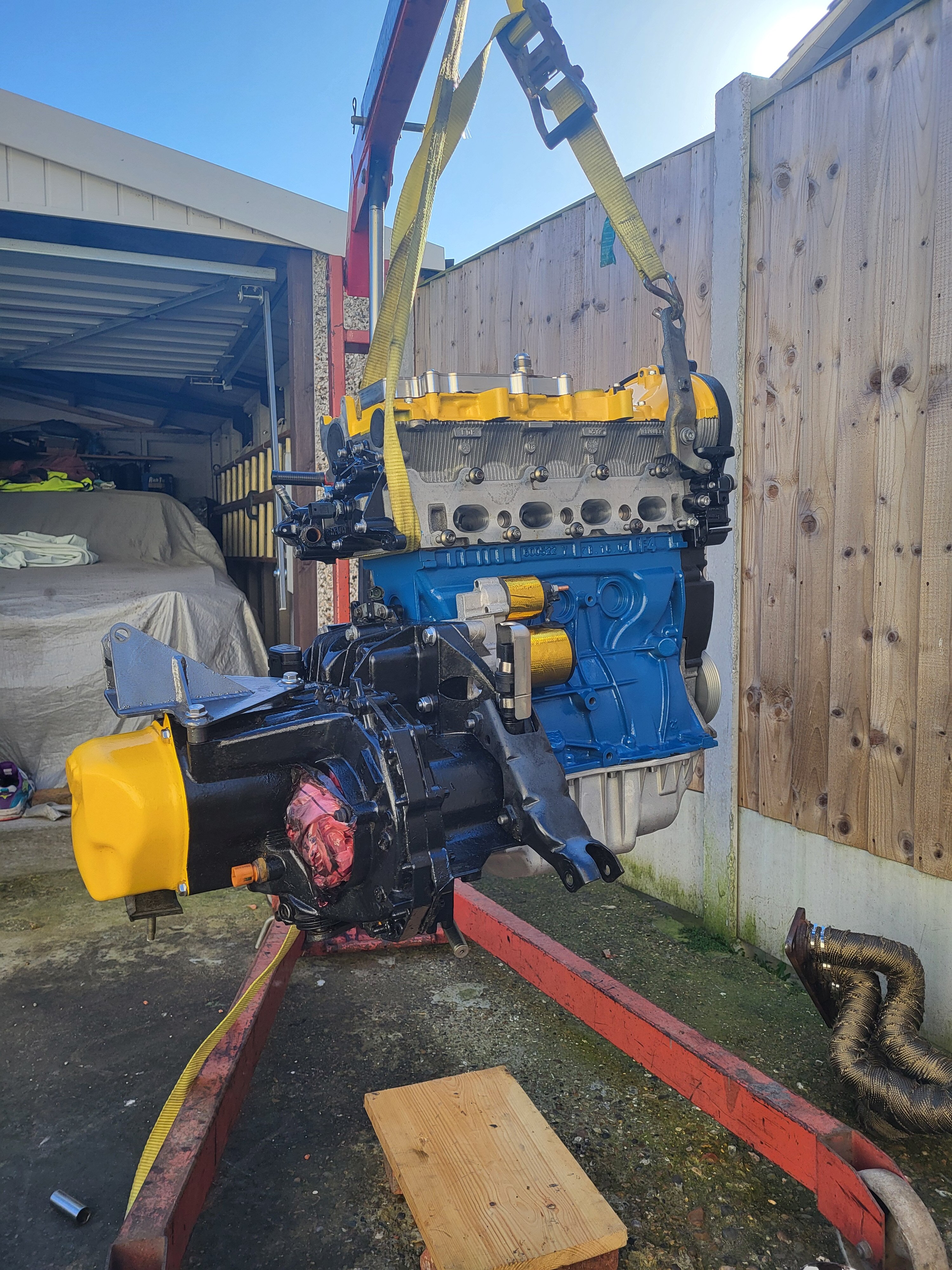

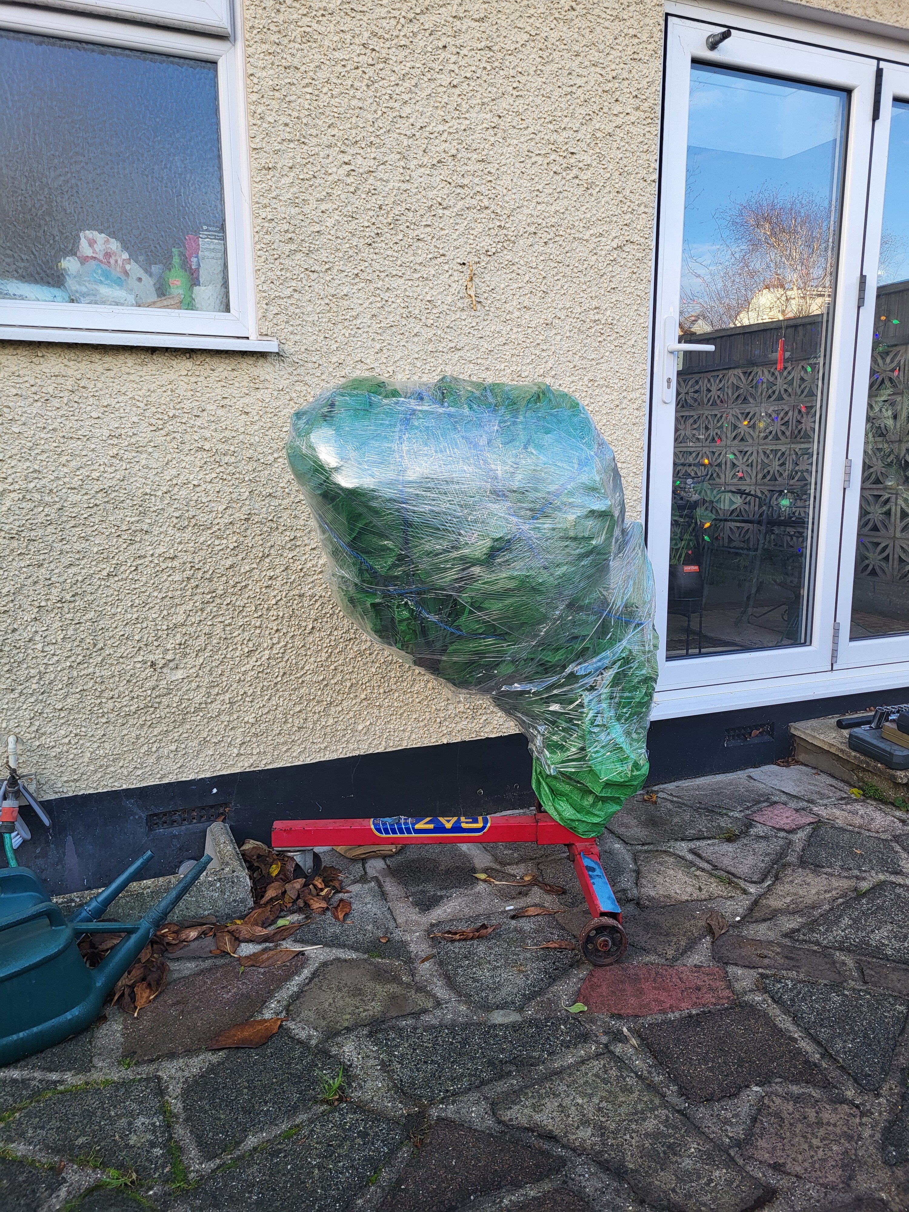

Anyway, engine is a lot more built up and sealed now for the winter and I tried to do the best job possible as winter prep.
This is clingfilm, tarp, and clingfilm again to there are any pockets to hold water. I almost want to string some Christmas lights around it and call it festive.

Hmm, so I appear to have made the mistake of following the video by James Stone as a guide... Not the first person on this forum to do this it would appear.
I've used the silicone he used in the vid SI5890.
Now it would seem I'm in the difficult position of deciding if i scrape it off and start again or risk it. I am leaning towards the latter at the moment as I did head the warning and use sparingly.
Unfortunately people use/recommed the wrong stuff for the cam covers. Id scrape it off and use the correct anaerobic flange sealant to avoid any future headaches. If a bit of sealant comes off and blocks an oil gallery or oilpump strainer, be engine rebuild.

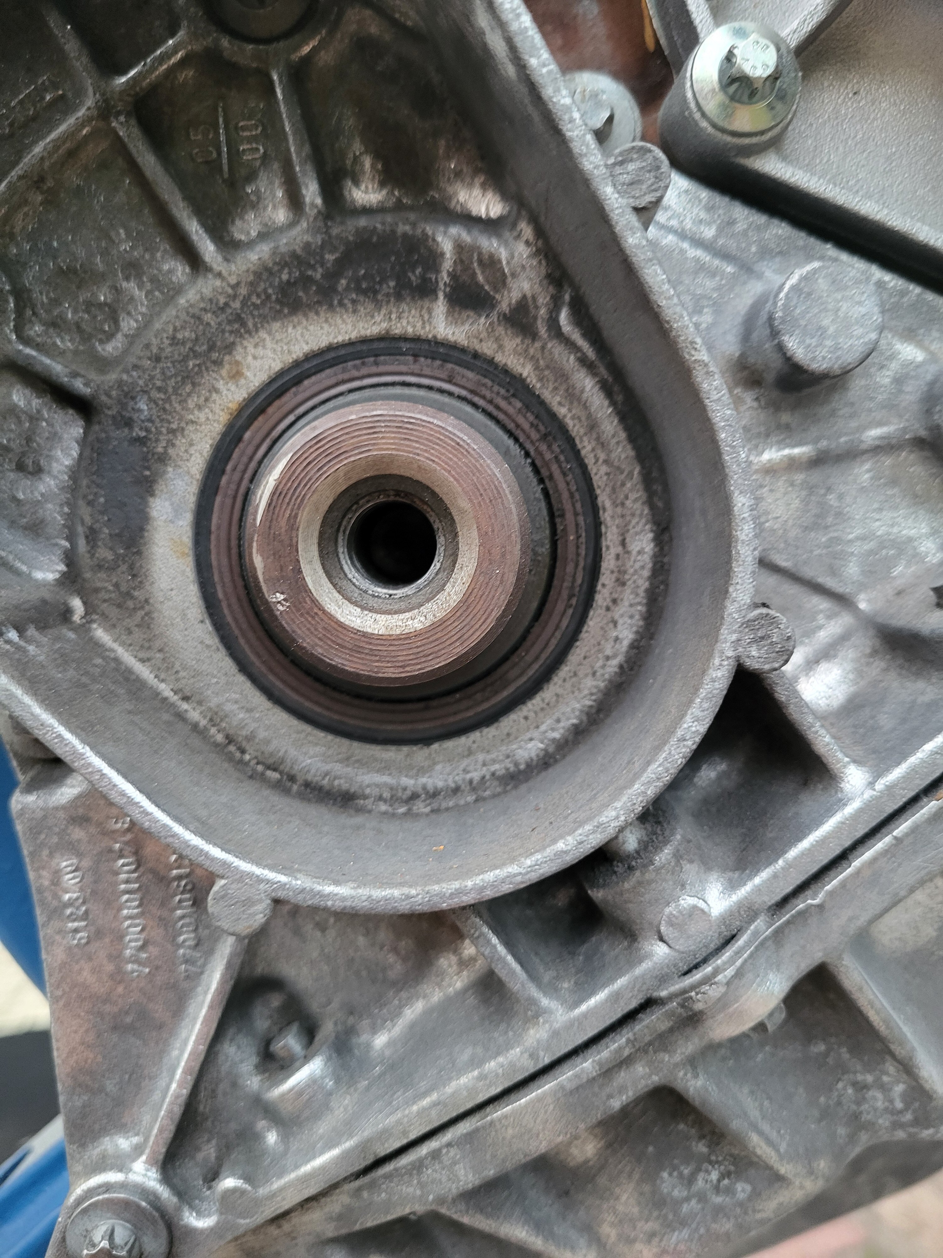

I don't suppose you have detailed the no.1 main bearing re-seal and other common leak points, i should inspect those once i drop the sump.
Ah, that makes sense now. I didnt even twig at the time. I haven't got a thread as such but just picked up all the info from various posts on here. Feel free to drop me a DM with any queries, just literally done the no.1 main last week.
I had noticed a post on AW Motorworks facebook page mentioning the front crank seal housing leak & also the part number for the gasket. Im going to do this one also for all the cost, and like you say I had just been looking at the dci oil pump of PMS site last week and reckon I'll throw one in while everythings in bits.
Link doesnt seem to have worked but was posted on 12th November if you want to look back. I also have a few screenshots from the manual that others had posted on here with the method for doing the No.1 main that I can send if you haven't came across them on here while searching

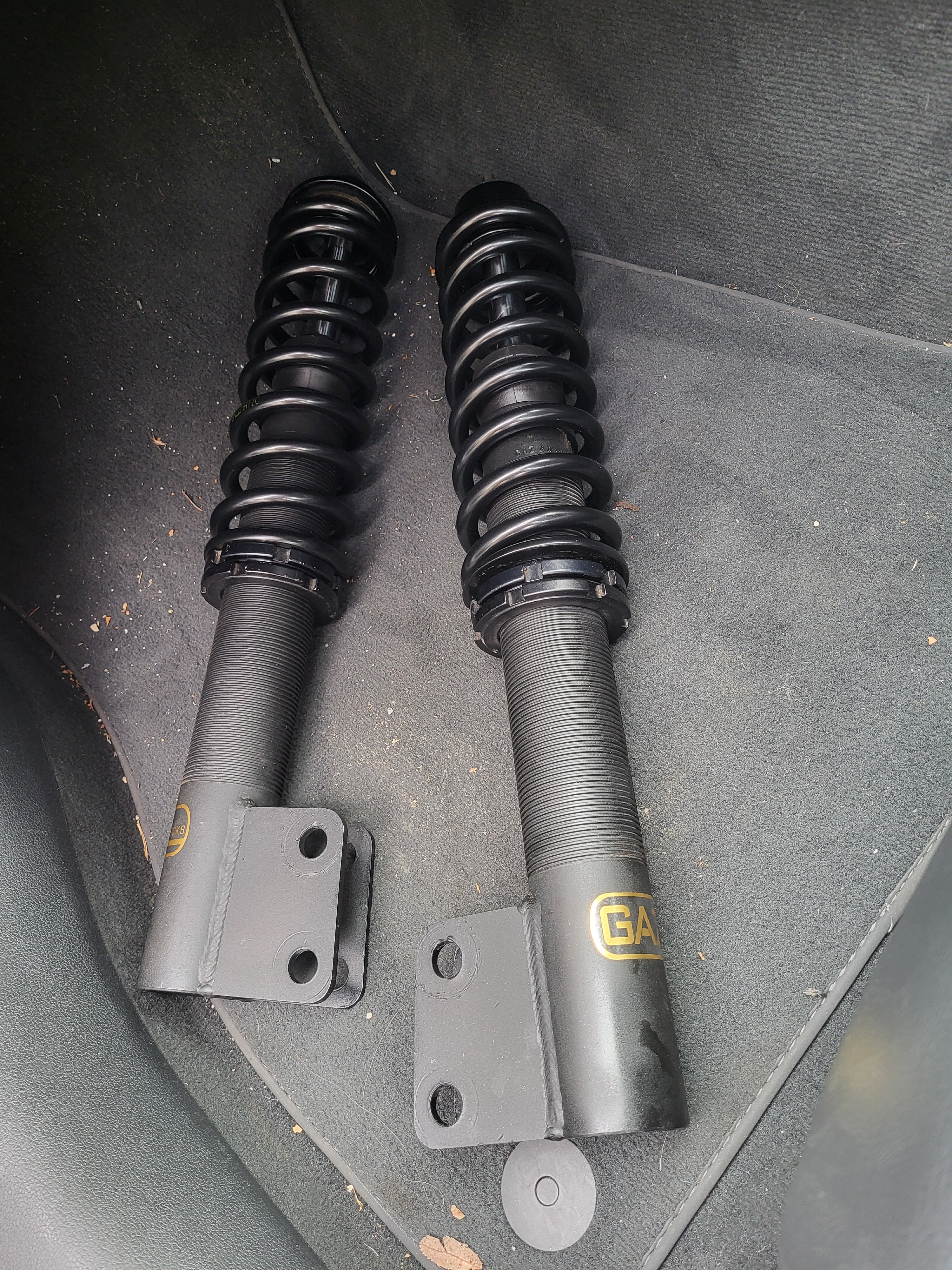

Shocks are also a little on the scabby side, not considering replacing them until i read some threads about refurbing. I never took any better pictures of them but they're about 15 years old now, springs are equally scabby.
Ended up getting them shot blasted, re-coated, new springs and fully serviced for £200 which im very happy with. I know people have mixed opinions on the gaz ghas but they're fine for my skill level and for the cost.

Nice progress I have gaz on my 182 they don’t need a refurb but are scabby as f and I want to tidy them up bad!!! and I have to say I can’t fault them on track.. little gross on English roads tho 😂😂
Well the servicing costs a very reasonable, especially if you pay cash and drop them off/pick them up yourself!

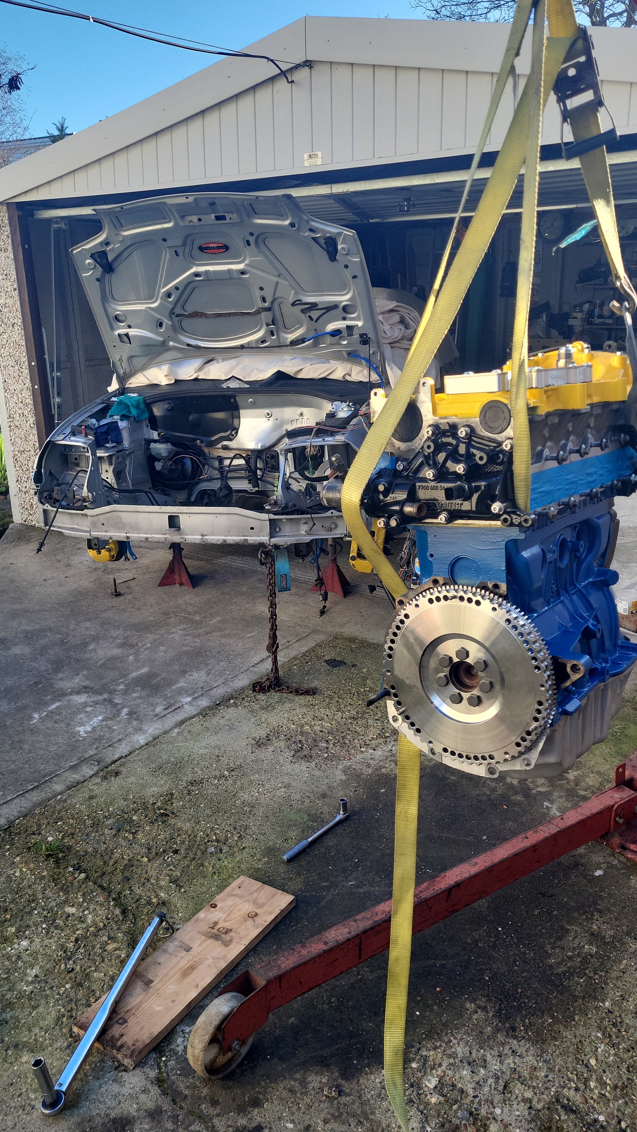

Right! Reasonable update this time!

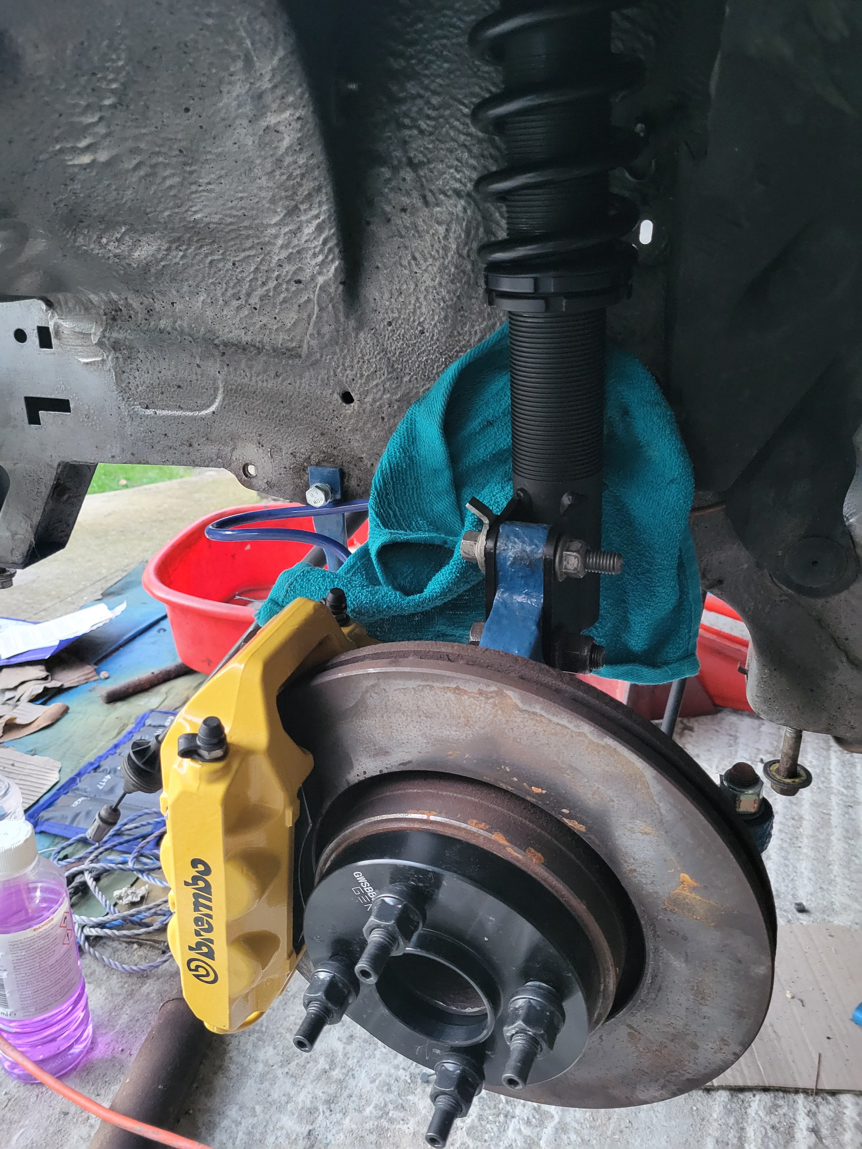

Firstly - front suspension back on and looking good! I need to get some kind of cleaner for my arches to make them sparkle a bit more! any suggestions would be great.

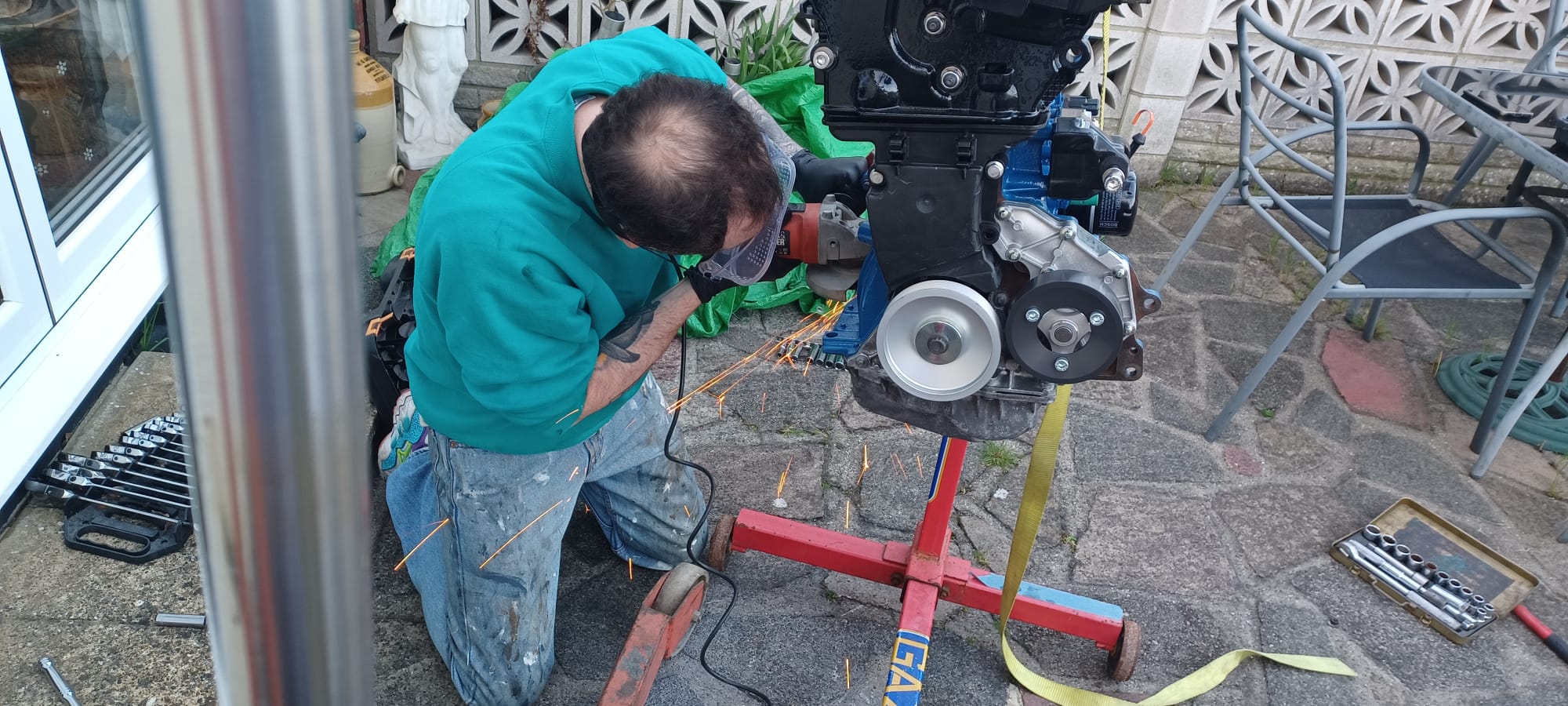

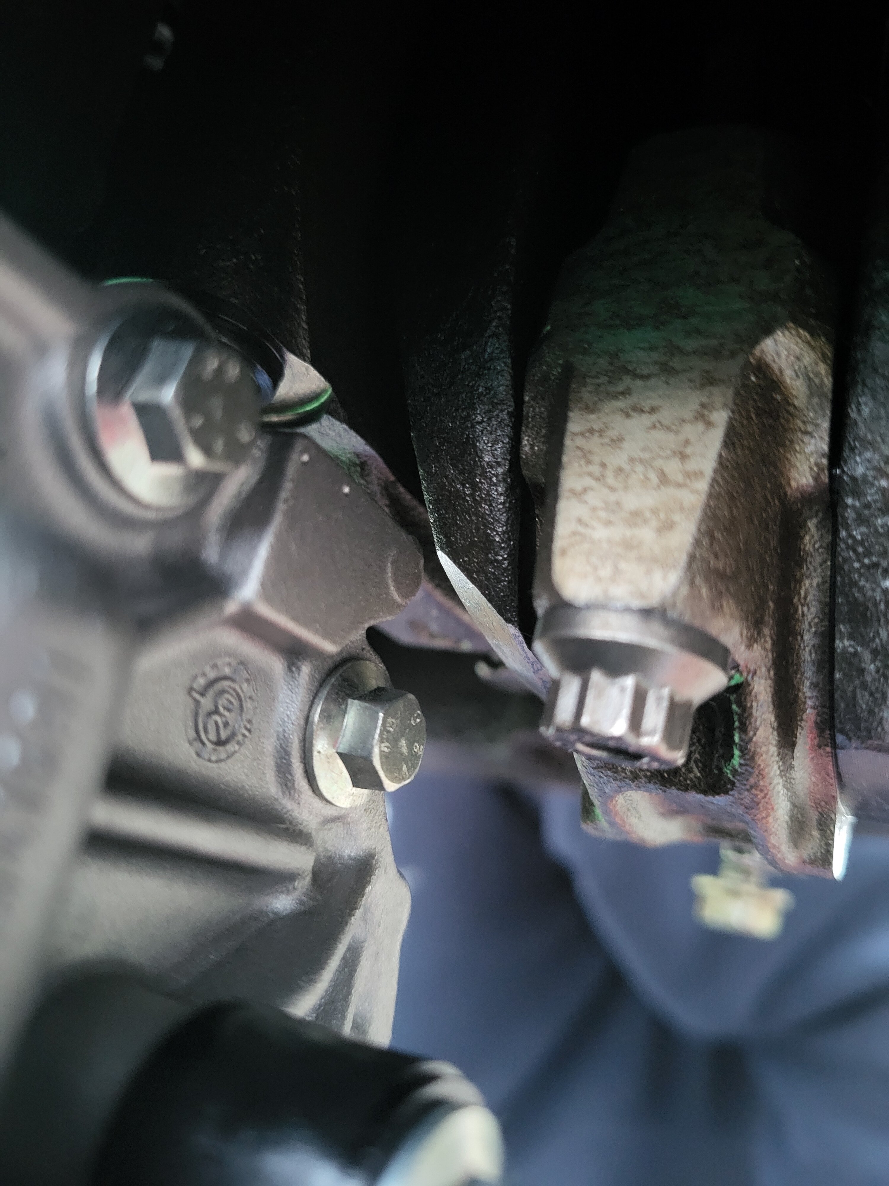

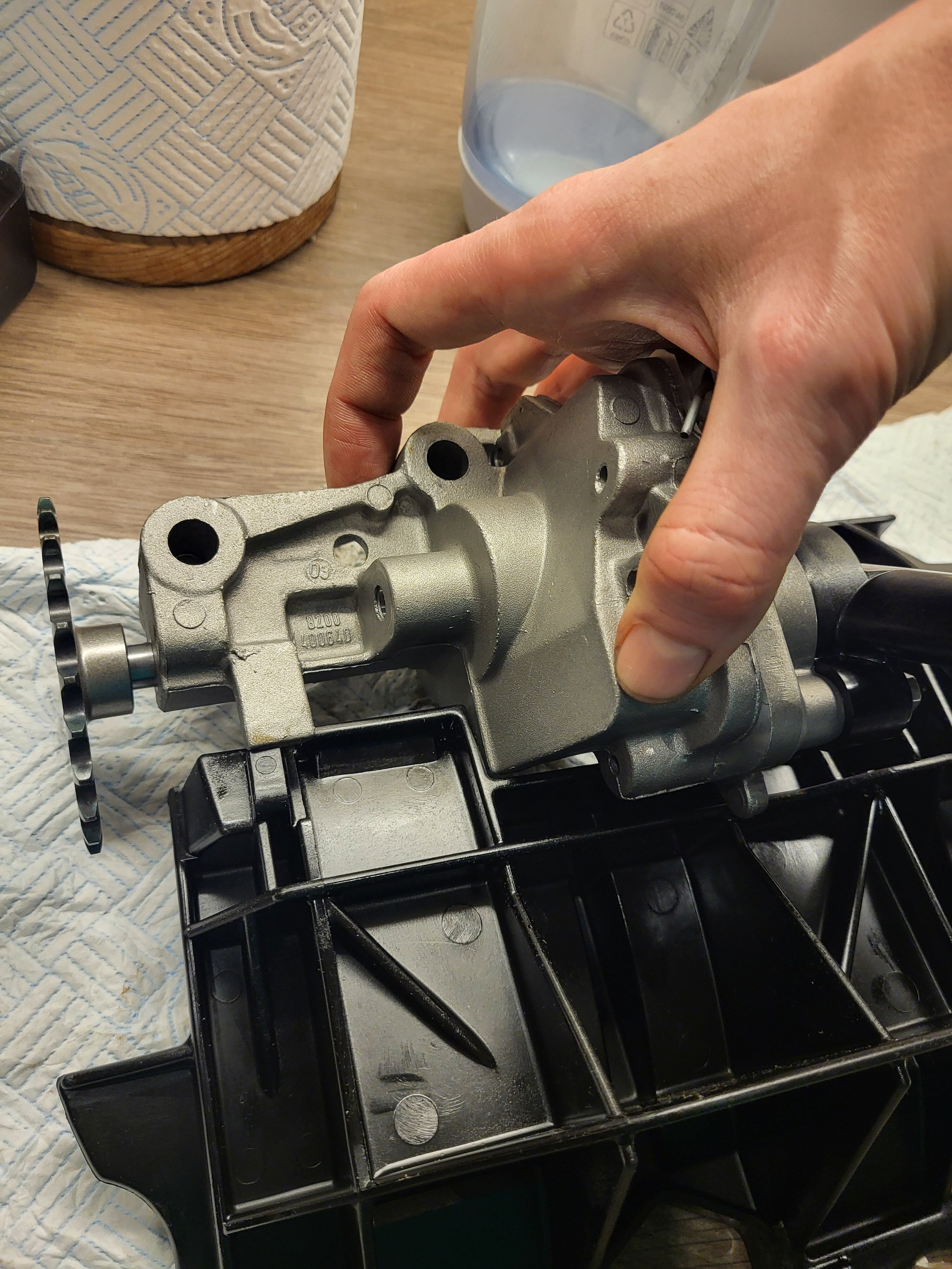

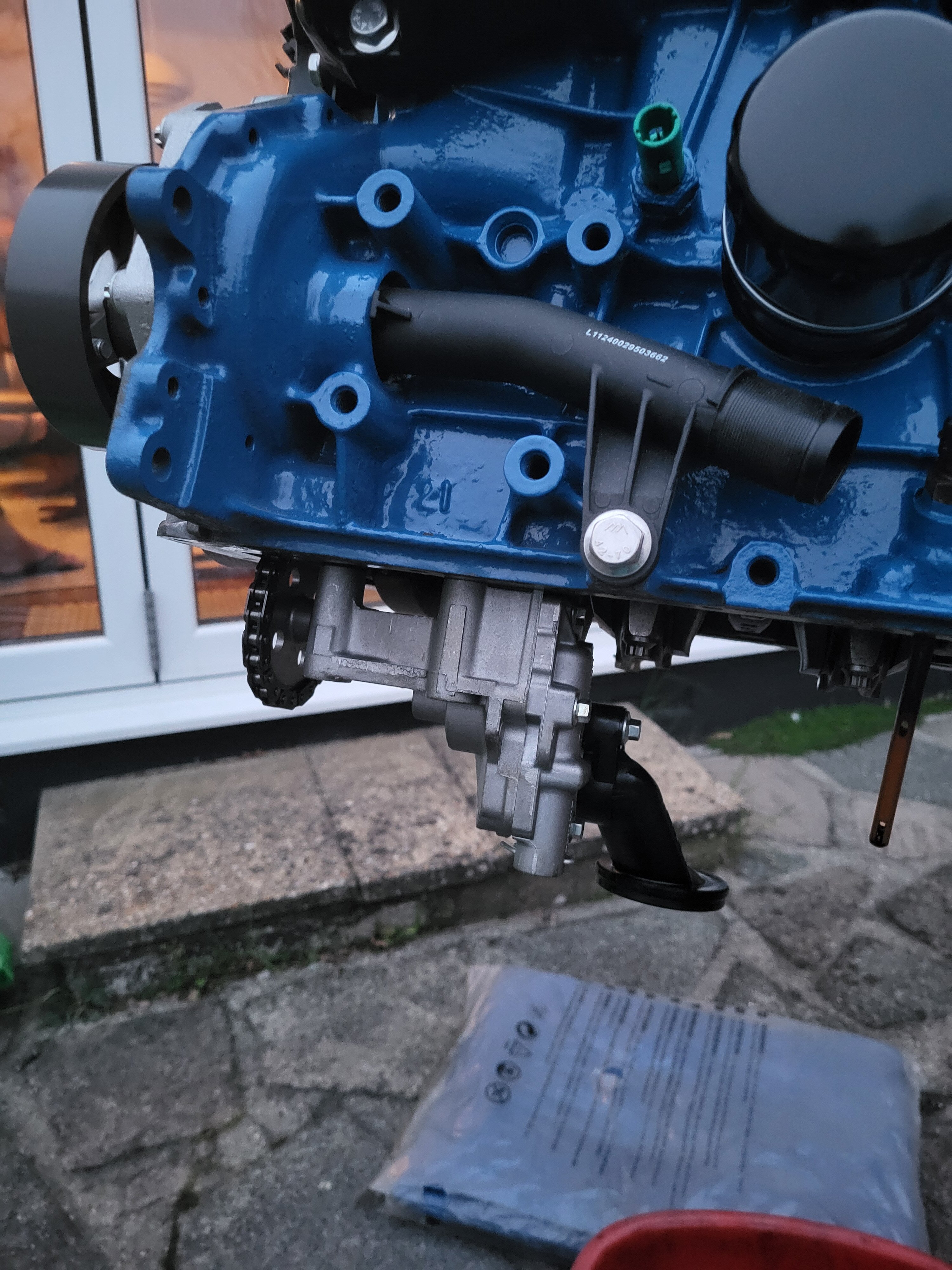

I was then hitting a bit of a wall with the build. I new I needed to drop the sump after I had to drill half the headbolts out and managed to get some swarf down the oil return, then the "while you're there" fairies came flying in telling me to get ARP bolts and a new oil pump while I was at it.

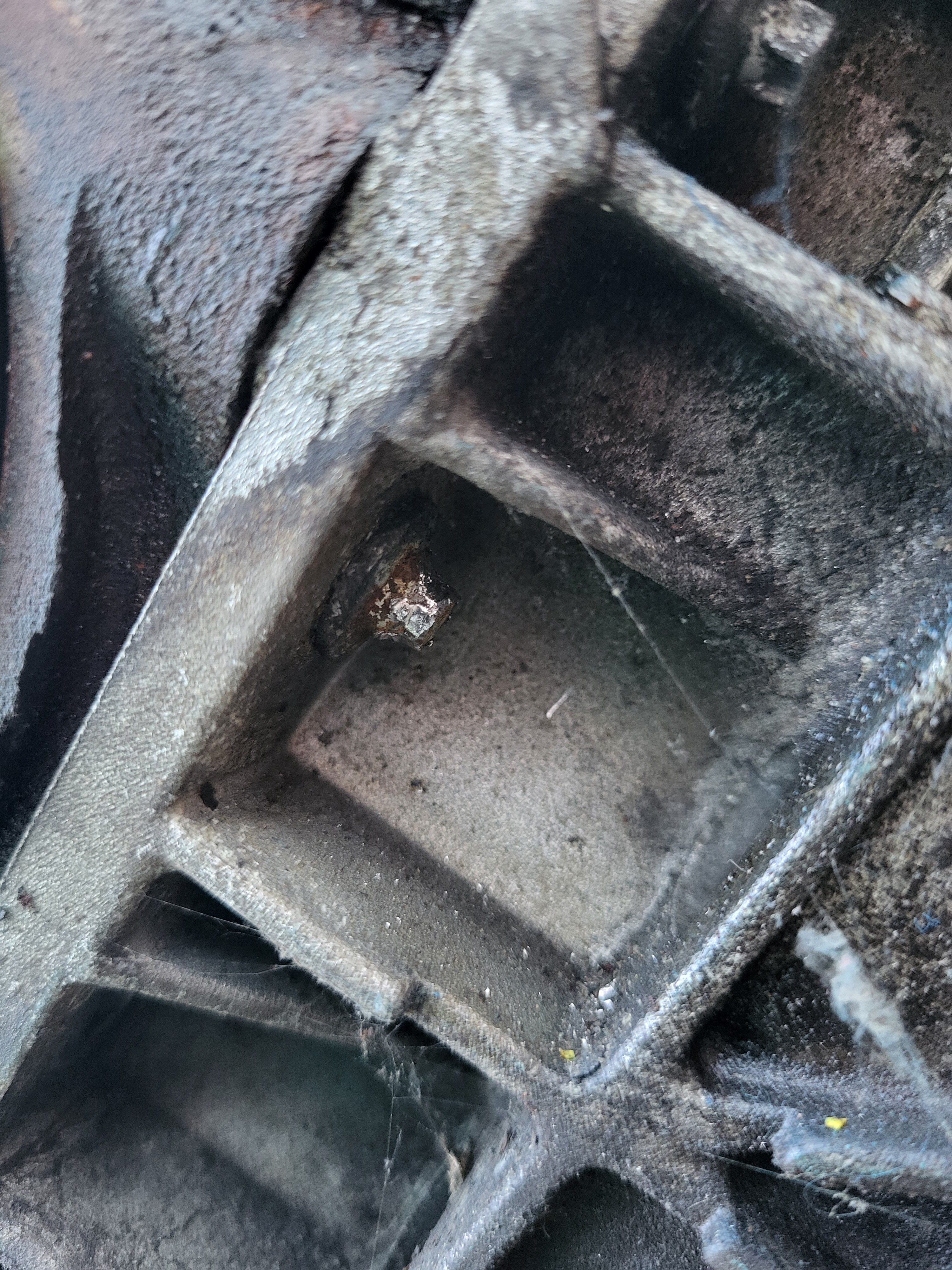

Annoyingly, the sump bolt behind the flywheel had completed rounded, and I couldn't get any access to it while the flywheel was on and the engine was on a stand.
Eventually managed to borrow one and down she came.
And this was the offending bolt

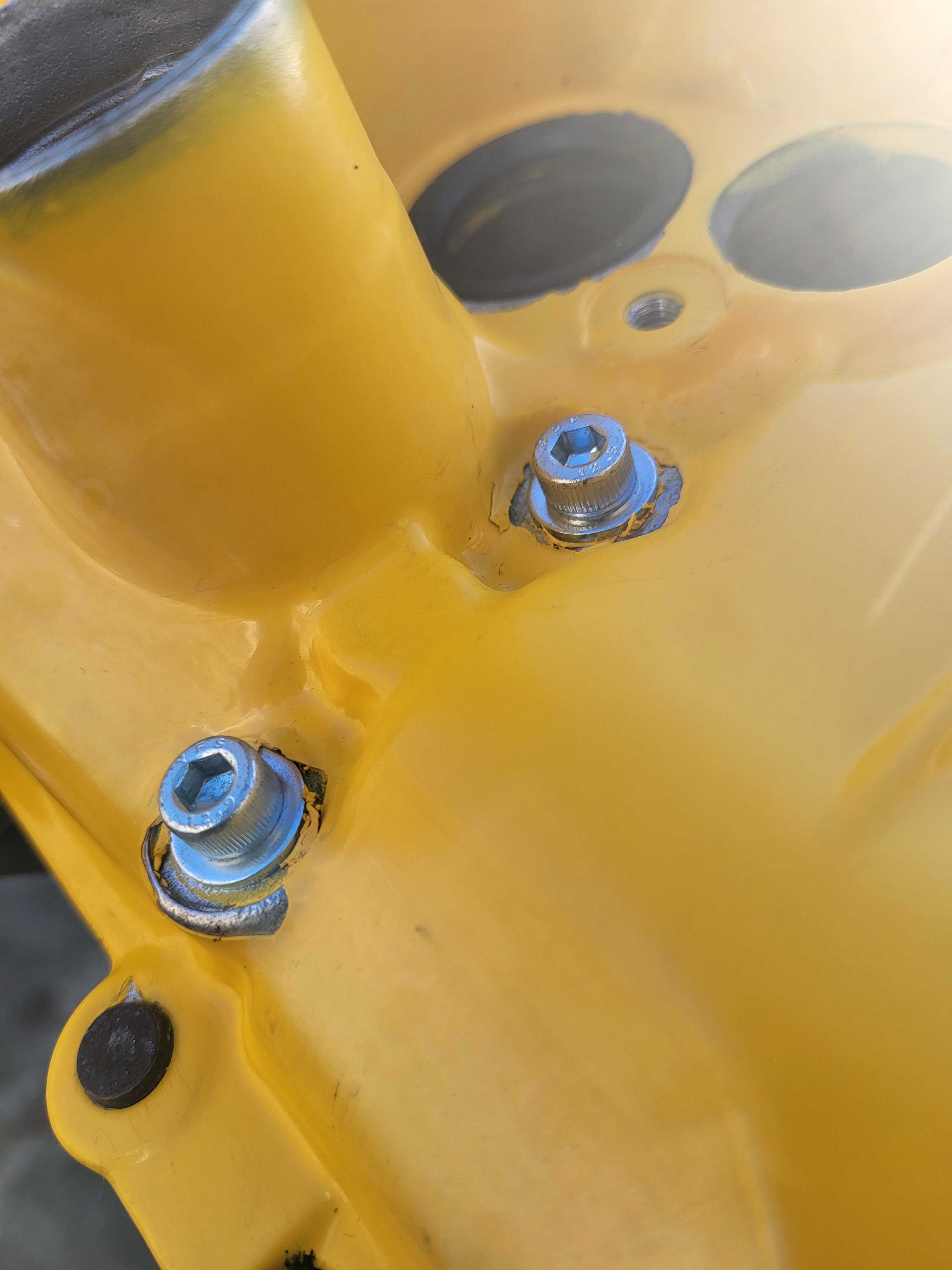

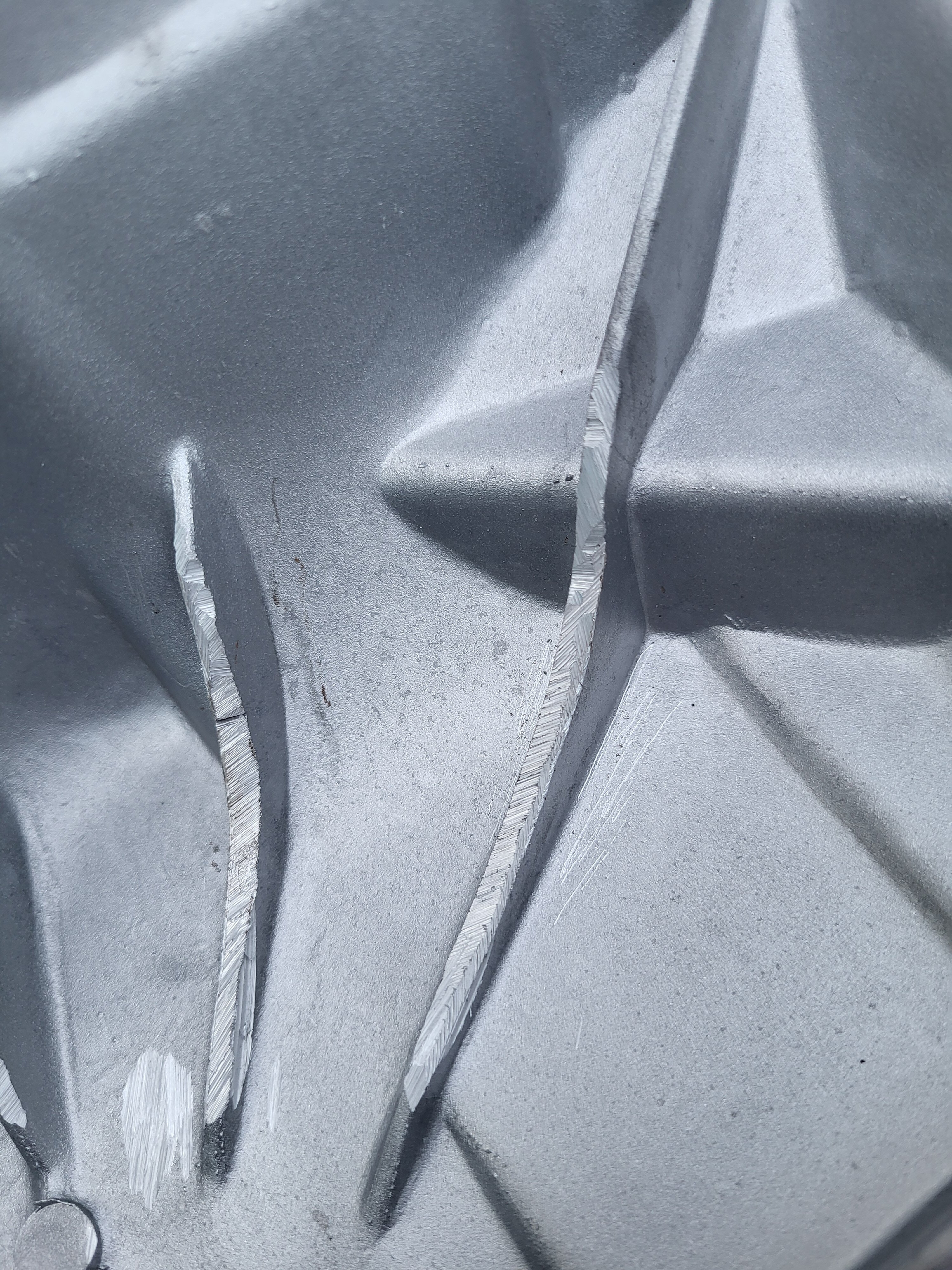

I had bought a megane oil pump which required some modification to the sump, thought better of doing it to my only sump so bought another one. This meant this sump was surplus to requirement, so just went at it from the side with an angle grinder. Actually quite easy once you remember that aluminium doesn't spark like steel does, so you know when you're hitting the bolt you're trying to cut.
Ended up having to cut 5 off in total. bought some new allen head bolts to replace them all. Photo from my dad of me grinding (inc depressingly growing bald patch :cry:)
Only photo I took of my modded new sump, this ended up being not nearly enough to clear the new pump.

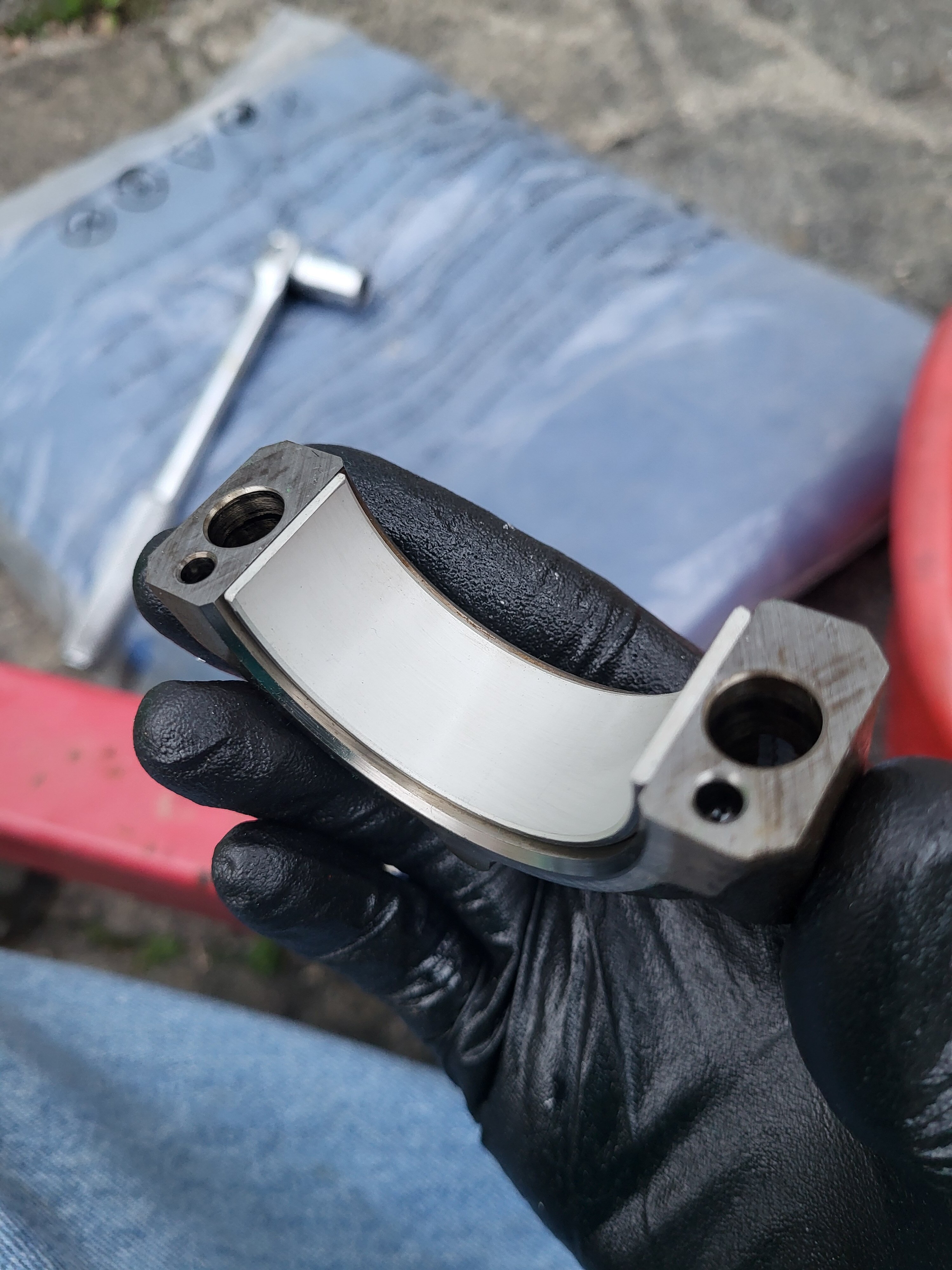

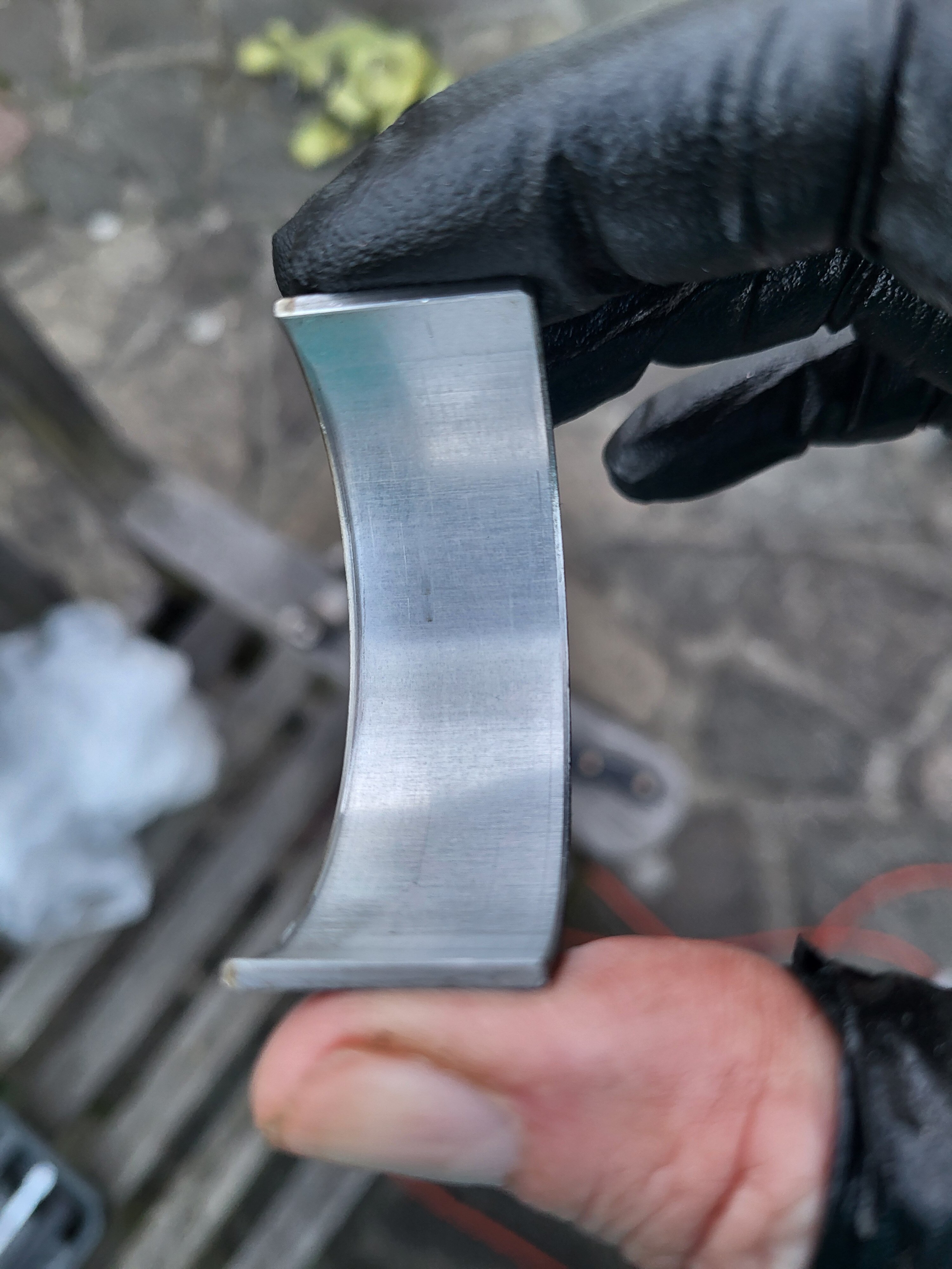

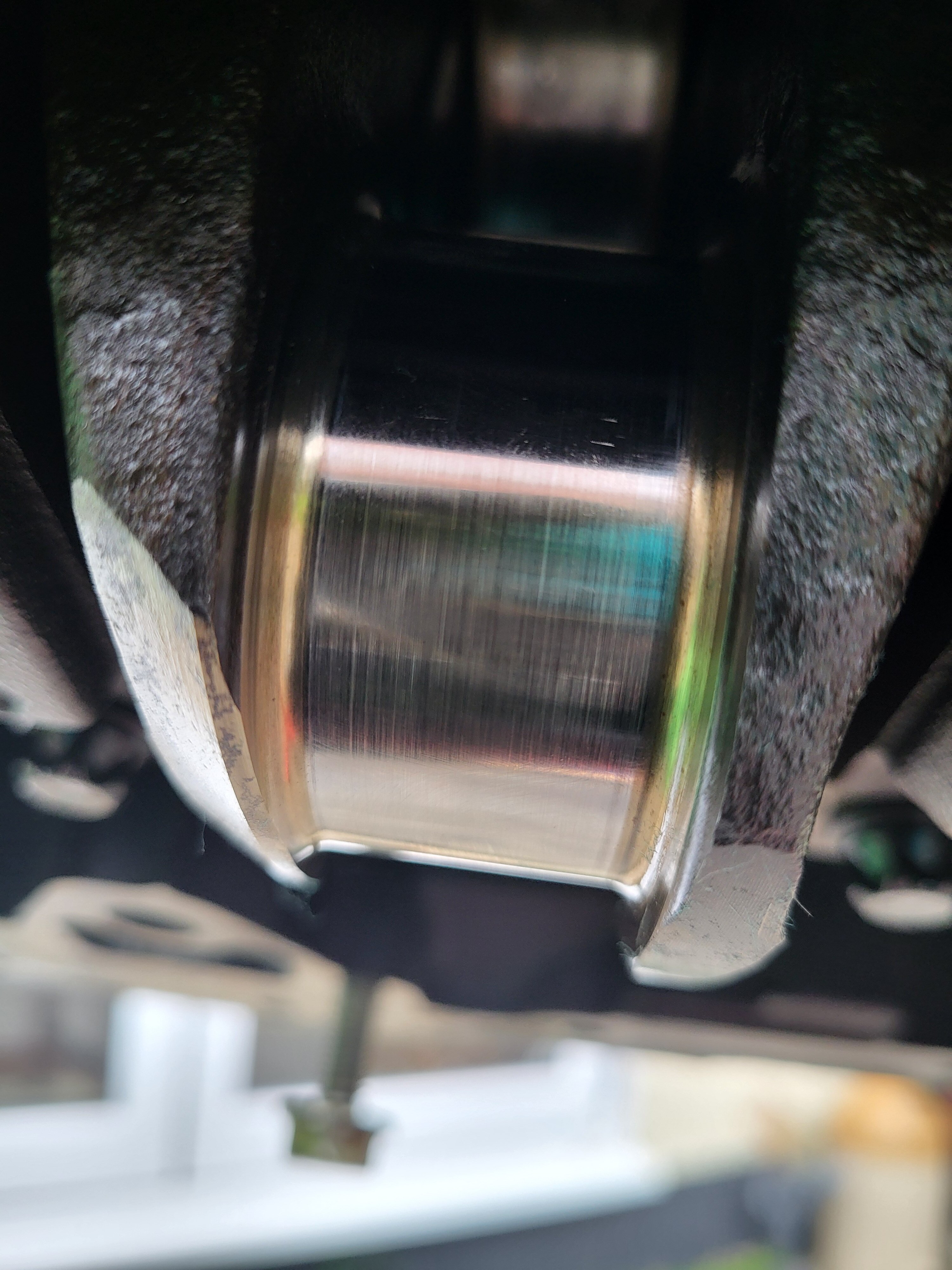

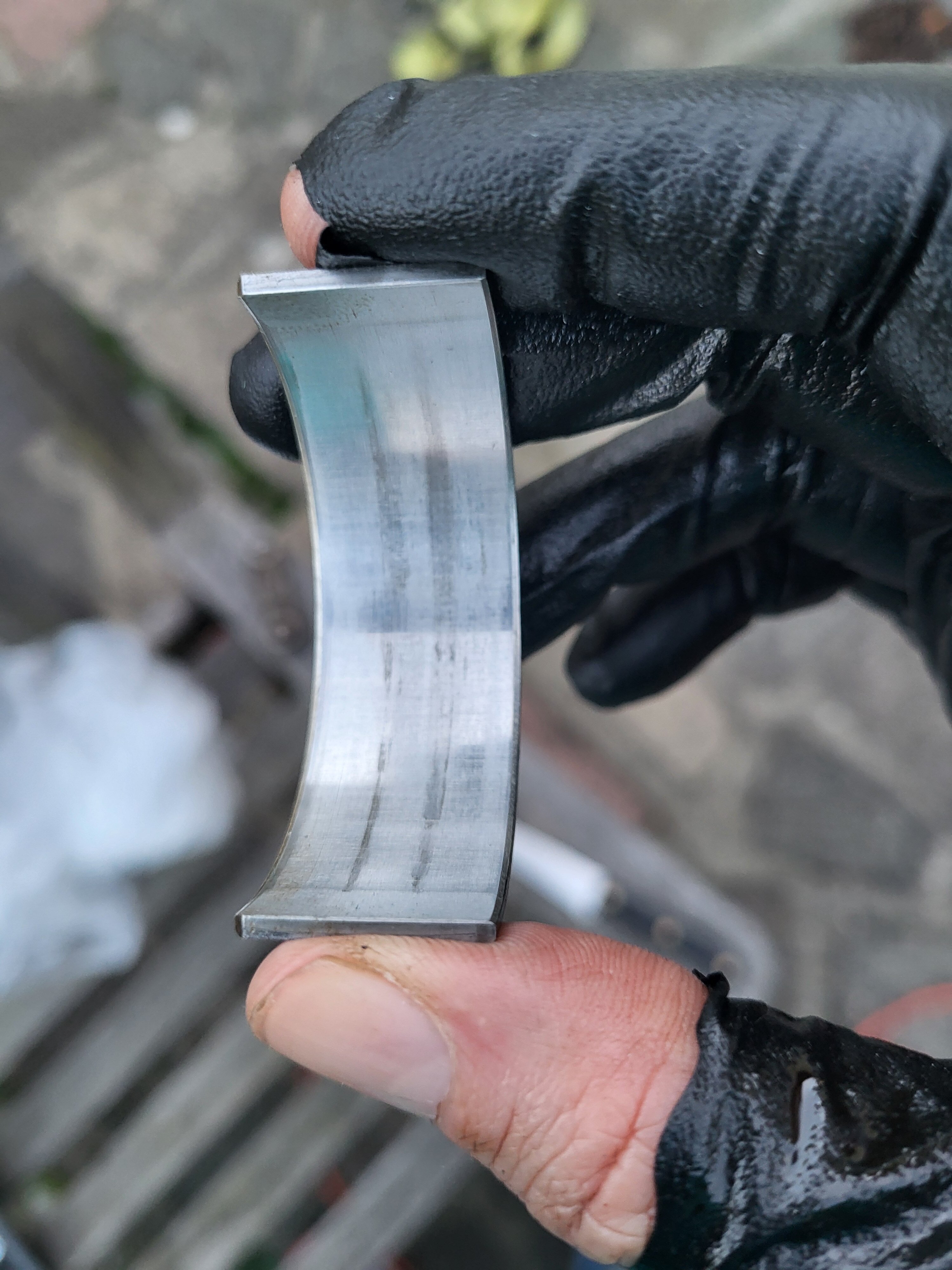

So, sump off I set about changing the big end bearings. I'm quite happy with how the old ones looked, nothing you can feel with a fingernail meaning the 90k miles its done have been quite kind to her. This is cylinder 4
Then I realised, that if the old ones come out perfectly OK my intervention can only have introduced more potential for failure with no benefit (assuming best case scenario is new bearings are OK like they were before). Oh well, not time to think just need to crack on.
Crank journal for reference, this looks a bit worse than it is, its perfectly smooth to the touch.
I also wish the bearing had a tab on them. For lateral positioning and to be confident that you have them in the correct location. This is the first time I've done bottom ends so more error proofing would be preferred.
My parts bin special early 172 let me down again, the windage tray didn't fit the new pump, thankfully I found one on ebay for very cheap that looked to be correct. I'd heard of other ph1 owners having this problem so was already prepped for it.
Run out of photo space, pt2 incoming
New oil pump installed, it looks huge by comparison, i had to go back and cut more of the sump off, but I didnt take any pictures.
Very close to the crank too, but Nick from PMS and members on here assured me this was OK. Also ARP bolts were installed when I put the new big end bearings in.
And as far as I was concerned, that was the engine rebuild complete. I put the crank back on with new bolts and a new seal, filled her with oil and cranked it with a drill and the oil filter off until it came pissing out, refitted the oil filter and pumped again for a while to get the oil circulated, then it was an early night ready for a full day on Saturday.
7am start, much to my neighbours delight I'm sure, was to get the car out the garage. Subframe is in the shed so basically chained to crank to the tow eye and lifted the front end and rolled it. Probably not great for the tow eye but I have confidence in the material properties of steel. Front end isn't have heavy without the engine or subframe.
Then it was a case of redressing the engine with the gearbox. Starting with the new TTV racing flywheel.
Gearbox and starter motor - person I bought it off had put some gold heat proofing on it, between this and the heat wrap on the exhaust I'm hoping I dont need the heat shield as I cant find it.
My nice new ported head revealed for the first time
And finally the exhaust - the exhaust I hear you say?? Yes. My plan was to basically put the engine on the floor, and lift the car over the top, so having the exhaust in installed should be OK. I like this picture a lot, though I wish I had taken the bin bag out of the diff first.
Lifting car over the top of the engine...
And lifting the engine in :). All went better than expected, only issue was that I didn't have the front lifting eye so had to lift around the head, this had to effect of tiling the engine forward so the exhaust was hitting the exhaust heat shield. Oh well, it bends.
First time I had seen my new refurbished shafts as I hadn't bothered unwrapping them. Very happy with the result.

Subframe out and lined up with the car.
Followed by the wheels and putting it back on the ground. And for the first time in over 2 years, the engine was actually in.

I had more or less insinuated that I was going to completely clear my parents spare room of car parts, so from there just kept on fitting things until I ran out of light and documenting any issues I found along the way.
Then even some bodywork went on - so it resembled a car for the first time in about 3 years!
Bodywork is very tatty - I need to decide at some point if I want to get a body shop to look at it and get some bits repainted etc or if I want to just accept its a track car and its pointless making it look too pristine.
That's basically when the weather started to turn and the light fade, it was gone 4pm at this point and my back was not in a happy place. So car got put to bed, very different to how she woke up.
Closing pic from my dads phone - I'm over the moon with the progress that was made today. Fitted the linkage also which I didnt take any pictures of but this is me fiddling with the gear shifter. If there are tips to align this perfectly, please let me know. I think the exhaust bashing the head shield during installation might have dented the shield as the linkage was hitting the shield a lot.

SO! a small but far from insignificant update! After getting the engine back in and wired up I did some cranking to circulate the oil and then tried to start... nothing, just crank, no spark. Initially I thought the ECU wasn't powering up and might be dead which was a little scary. Overall it was a little disheartening as electrics is far from my strong point and I didn't really know where to start. Checked 12v was getting to the ECU to switch and perm.
Just started checking everything. Continuity between the coilpack and ECU pins, injectors and ECU pins, 12v where necessary. I kept coming back to the fact that pin 1 (white wire) on the coilpack wasnt getting 12v. I found out I was getting life from the ECU as it was sending power to the fuel relay (pump is on a switch so cant use pump prime to tell that ECU is on).
Traced that wire to the top relay here:
Played musical relays and it seemed that they all worked individually but none of them in that slot. looking from underneath, 12v was getting to the main feed (red) and switch (yellow) but never coming out the send wire to the pack. My suspicion is a dodgy earth wire that you cannot see in the image.
So just bodged it for now and eureka! i got a spark. From there I could get it to go on easy start but not under its own power.
tbh i was happy with that because a spark rules out a lot of potential problems (ECU failure being the one i was concerned most about).
checked all the injectors again Monday morning and they were all pinned correctly so was scratching my head a little. Doesnt help that with a race battery you only get about 5 attempts before you need to charge it up again.

I’m a little confused , is the bodge wire on the relay still in or have you removed it ?
What’s the status with that , as you’ve said it all fires up ok now , if that’s how I read it .
The bodge is still there. it basically bypasses the relay and provides a permanent 12v to the coil pack. To be honest, it may remain long term depending on what amperage the coil pack pulls.
The potential fallout would be adding a drain to the battery but the feel appears to cut out when key off.
I cut the battery isolator when I leave the car so in this case it would be fine either way.
