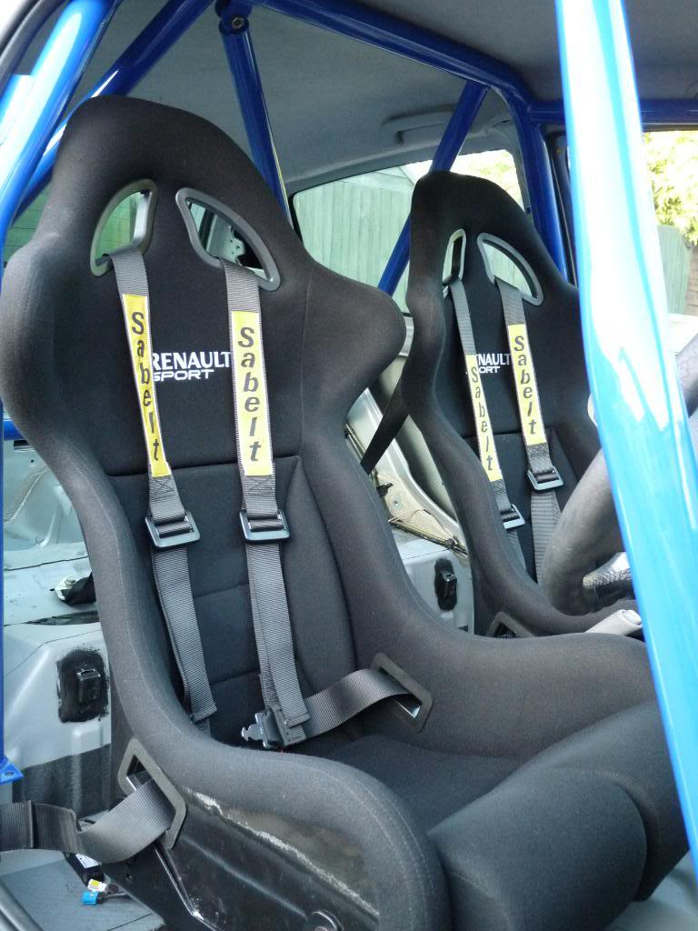

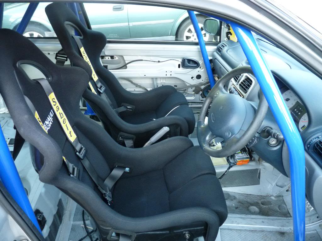

Passenger seat and harness fitted

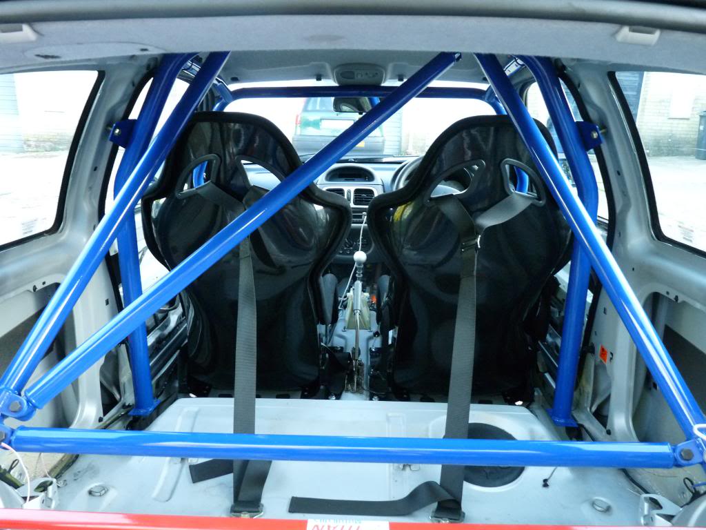

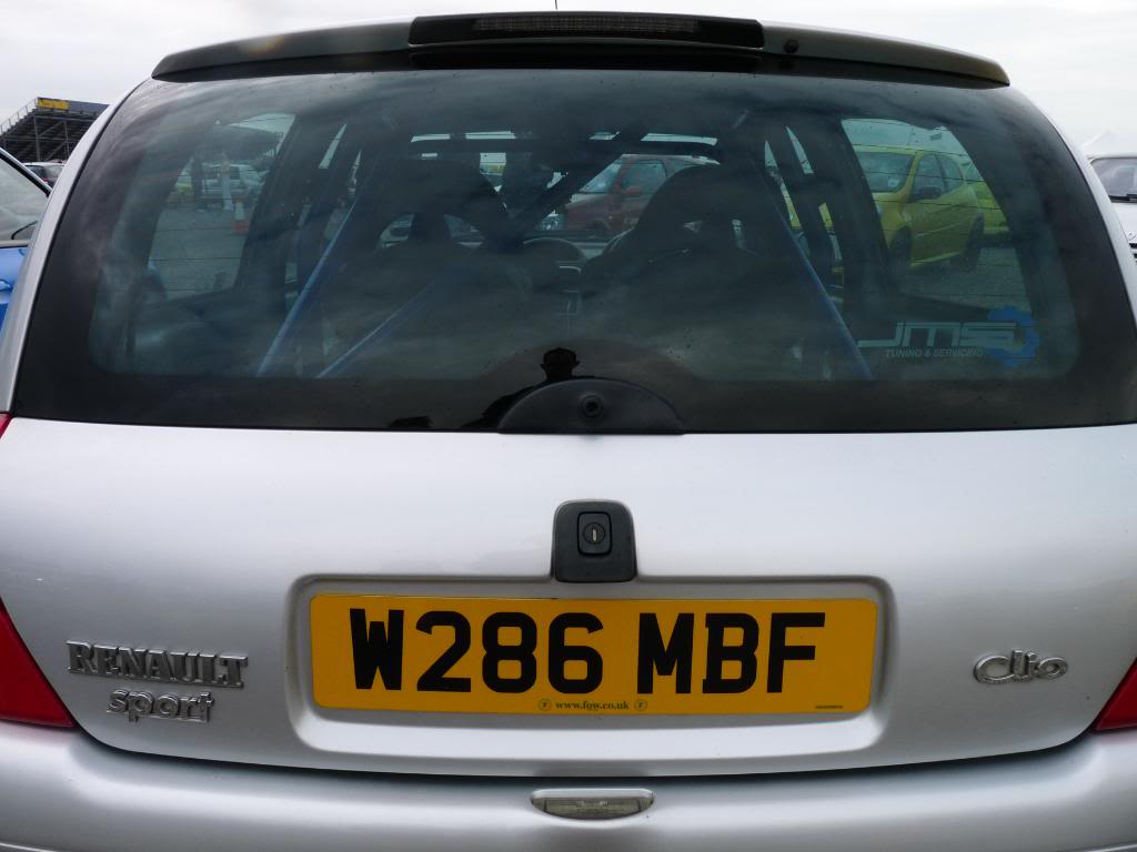

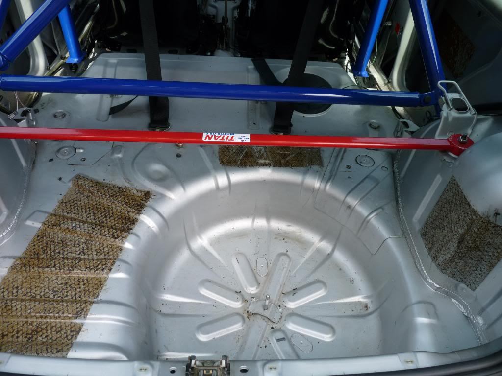

Collected cage and bolted in loosely

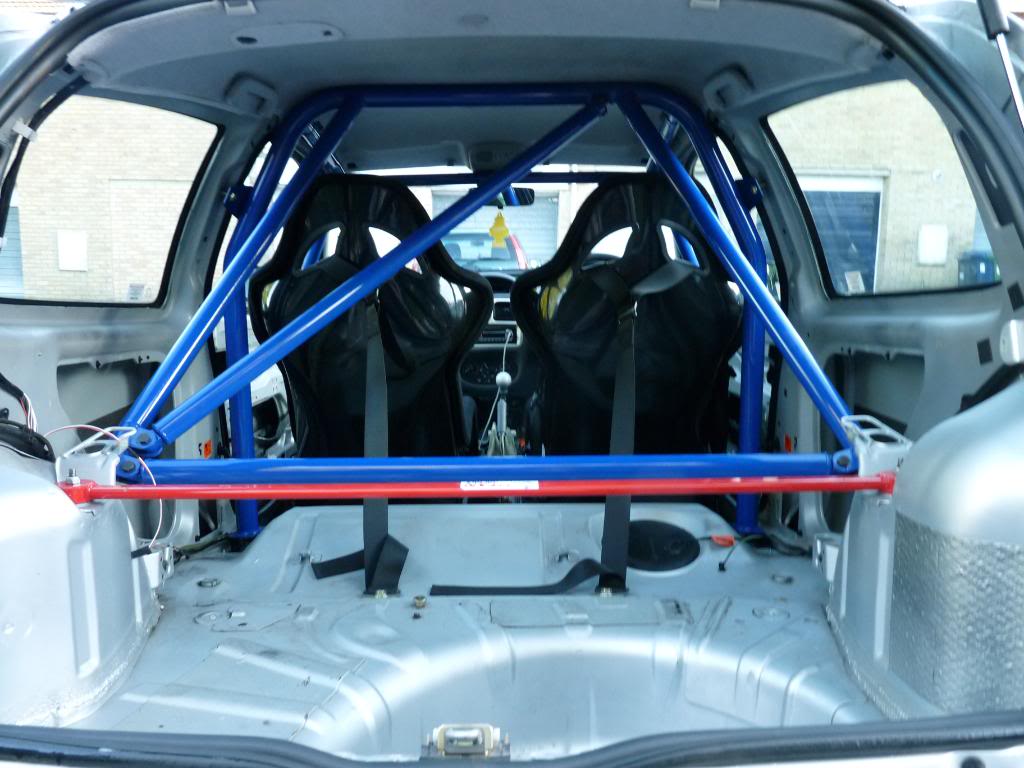

What cage did u get mate? Looking forward to seeing this at the Cambs meet whenever that happens :)
Edit: Oh Dannys cage nice!! Im very jealous :) Also even though the bore is kinda wierd on that exhaust its quite loud with a de-cat lol :D
  Discounted 1*2 parts
Yea danny's old omp cage :)
Finishes off the interior nicely, not sure how much of the dash i want to strip out.

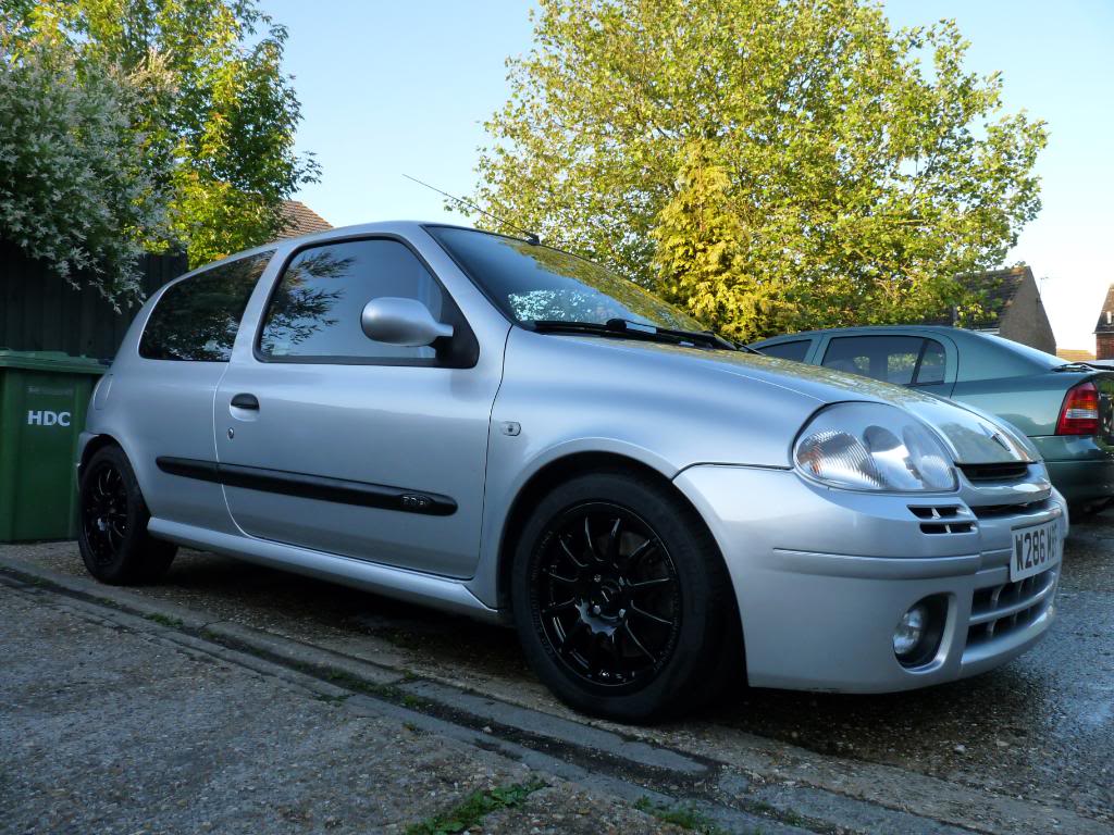

Some pics.........

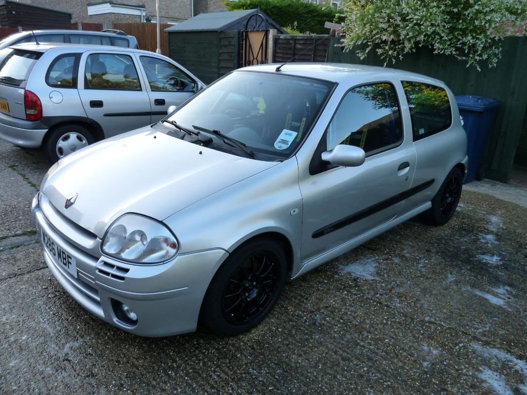

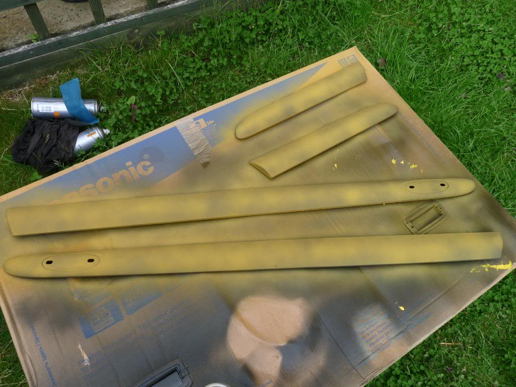

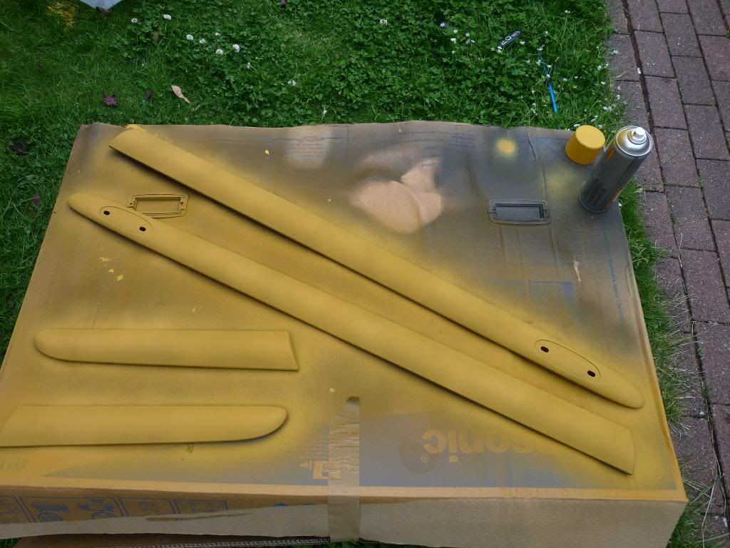

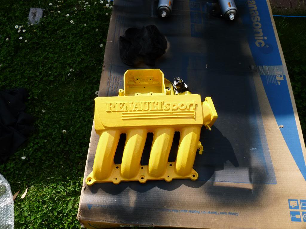

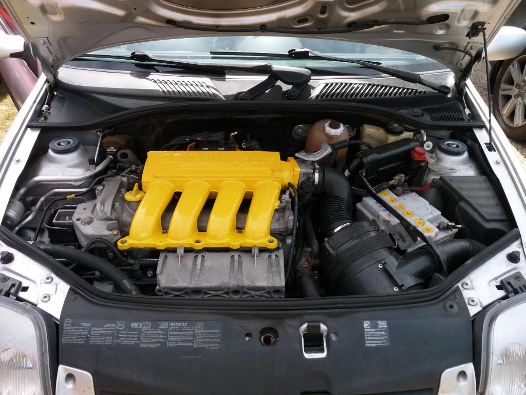

Hamerite'd matched inlet manifold

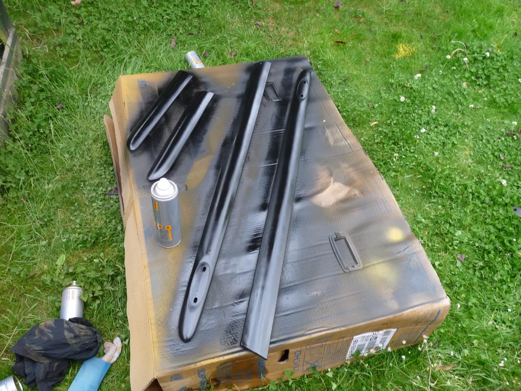

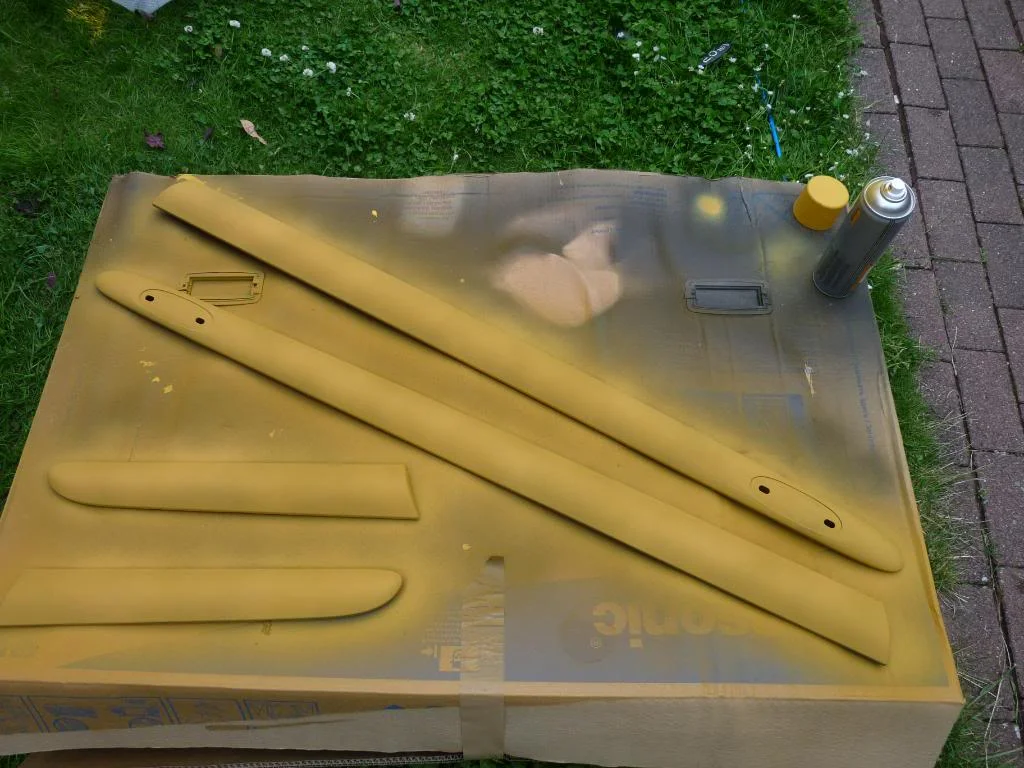

Removed rub strips to spray

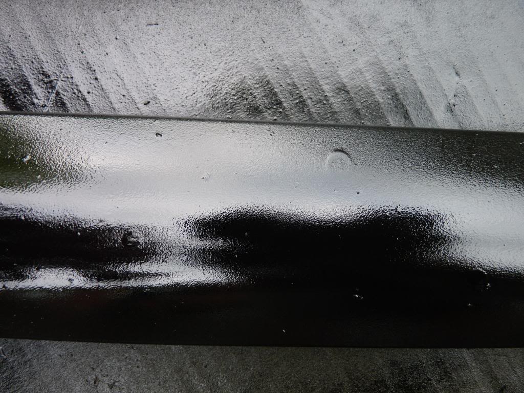

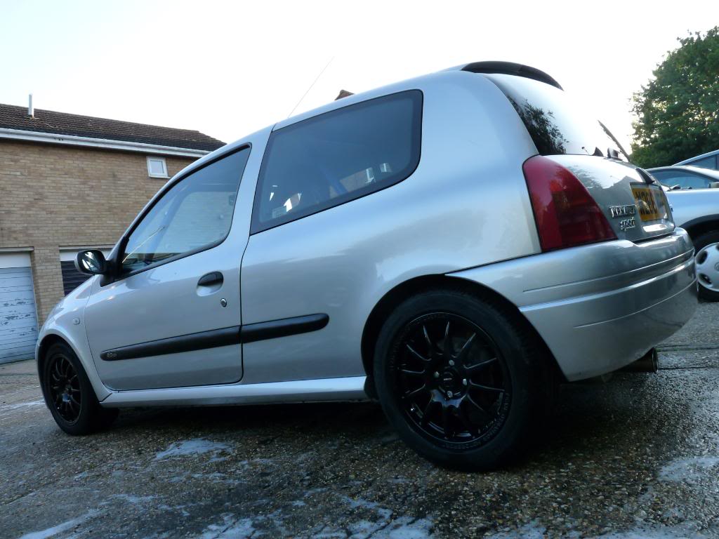

Didnt get a particulally good finish but at least looks better than before. Looks better now they are black and not faded grey!

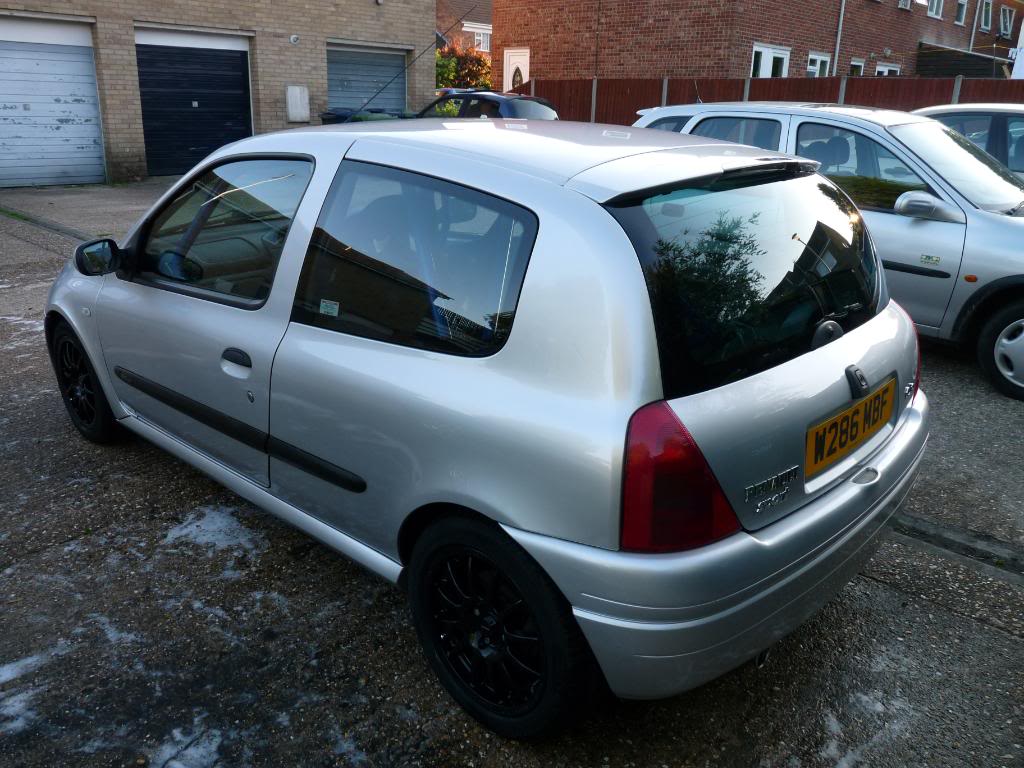

Thats all pics for today, car is filthy atm so will get some better pics once washed

did you not rub the bumpstrips down before painting them mate????
Yea but not very much thinking i may rub it down with some fine wet and dry and give another couple of thin coats of paint.
must admit i smothered them in SRP and polished them up. Now they are fitted to the car they look alright. No means 100% but then its a track **** so i'm not too fussed!

Looks like you painted them with a paintball gun??
But like you say, it matters diddly squat. Its for driving, not looking at!
Rough and ready eh? Nice work, although the rub strips could have done with some more TLC :p
haha yea i've had a hectic weekend trying to organise moving house and the side strips sort of got pushed to the back of the priority list
i'll make them look nicer in time :)

:eek::eek:Repaint rub strips!!!:eek::eek:

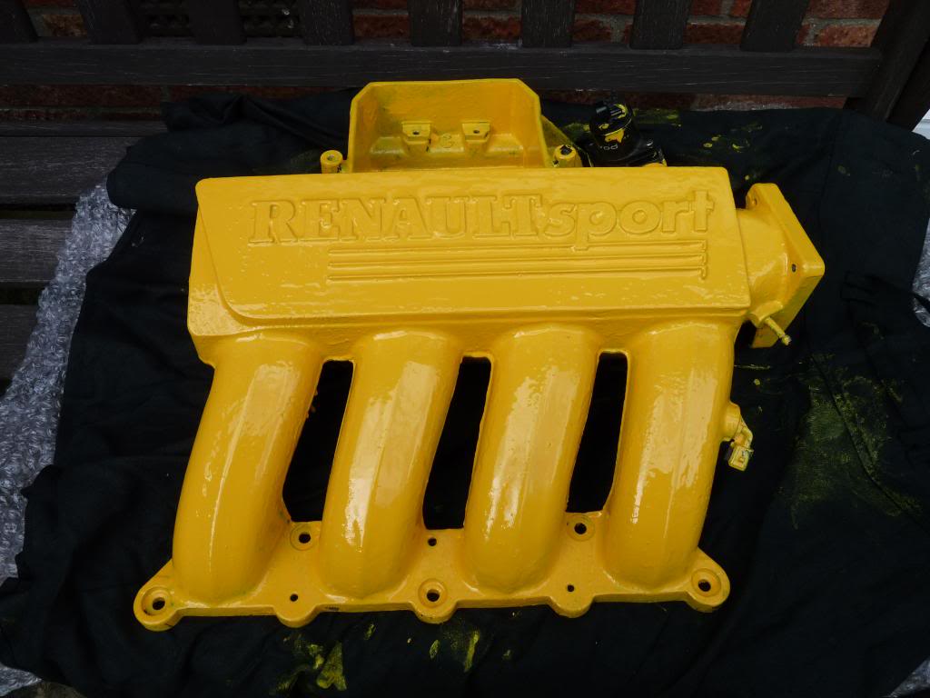

Did you use hammerite primer on your inlets? Hammerite does not adhere properley to aluminium without primer.

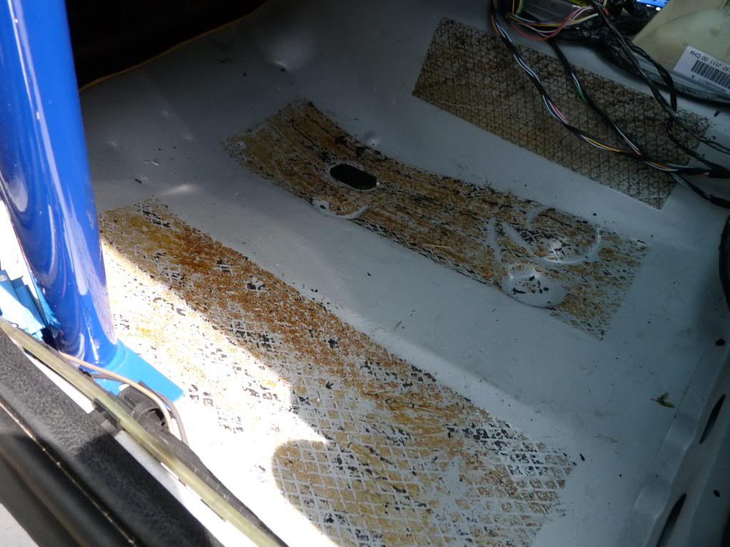

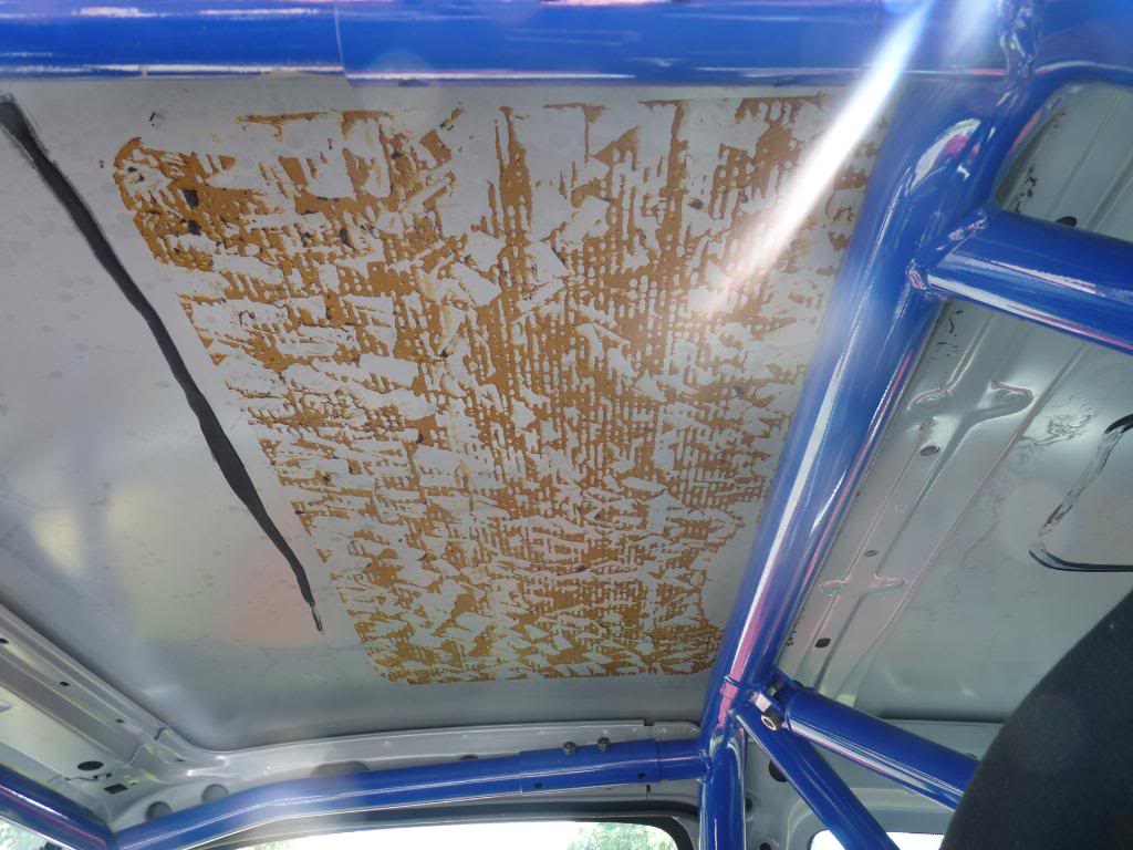

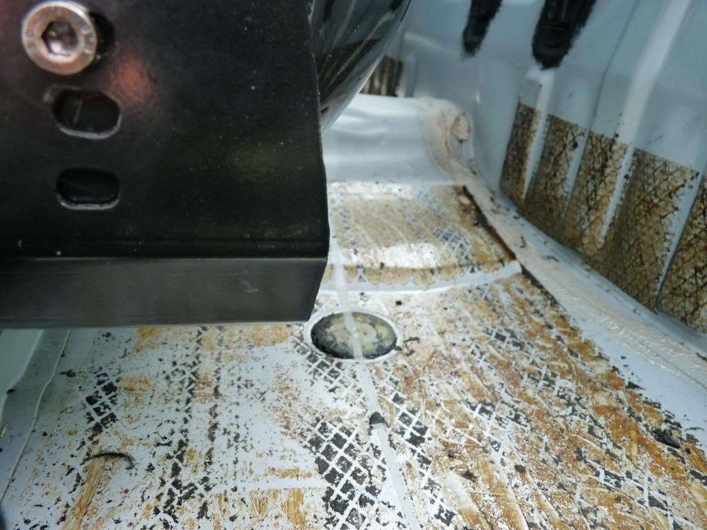

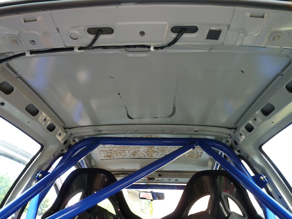

Removed all the tar sound deadening and the roof lining (another 10kg :))

Picture of more poorly handpainted manifold! Again this will be done properly when the a/c comes out

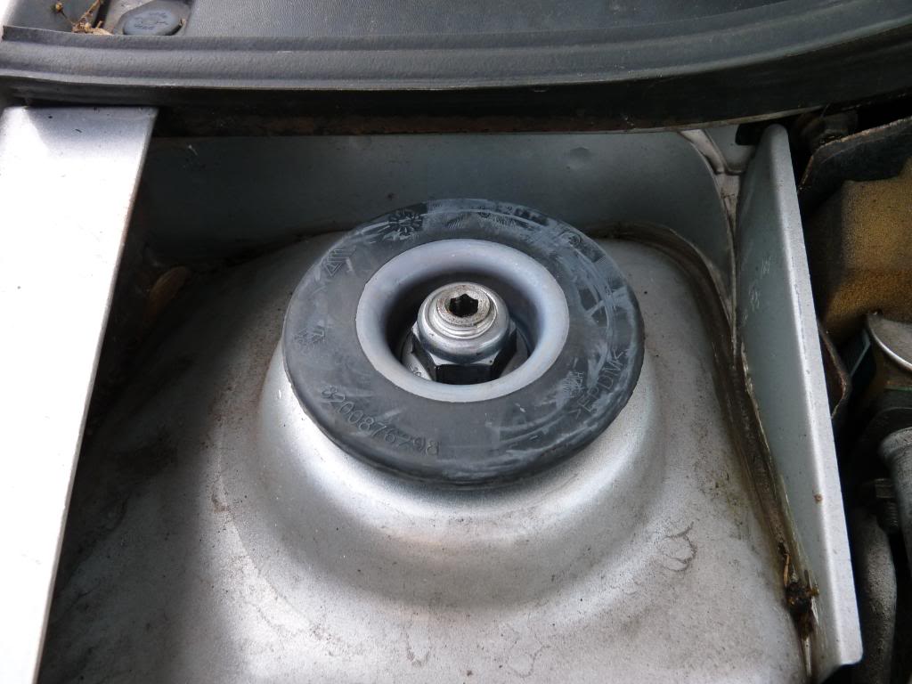

And the top mounts were creaking like a b*****d so i fitted some new ones before i had the 4 wheel alignment done. The old mounts literally crumbled as they came off and the bearing felt rough as you like!

How did you get rid of the tar matey? Was it a pain in the ass? 10kg saving! Thats crazy
Used a heatgun to warm the tar and the glue up and then scraped it off with a wallpaper scraper

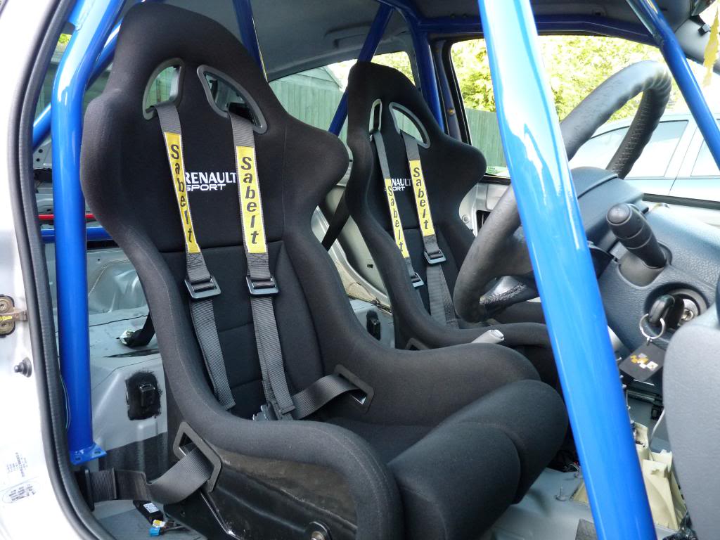

The seats i bought from here. You can buy them from JMS for around £800

I got rid of the tar on the roof by leaving the car out in the sun so it melted alittle and made it really easy to peal off the sound deadeding. Tip for the the sticky stuff... use a paint brush to soak it with white spirit and leave it for 10 mins then use the scraper lightly and it will come off really easy. Good progress!

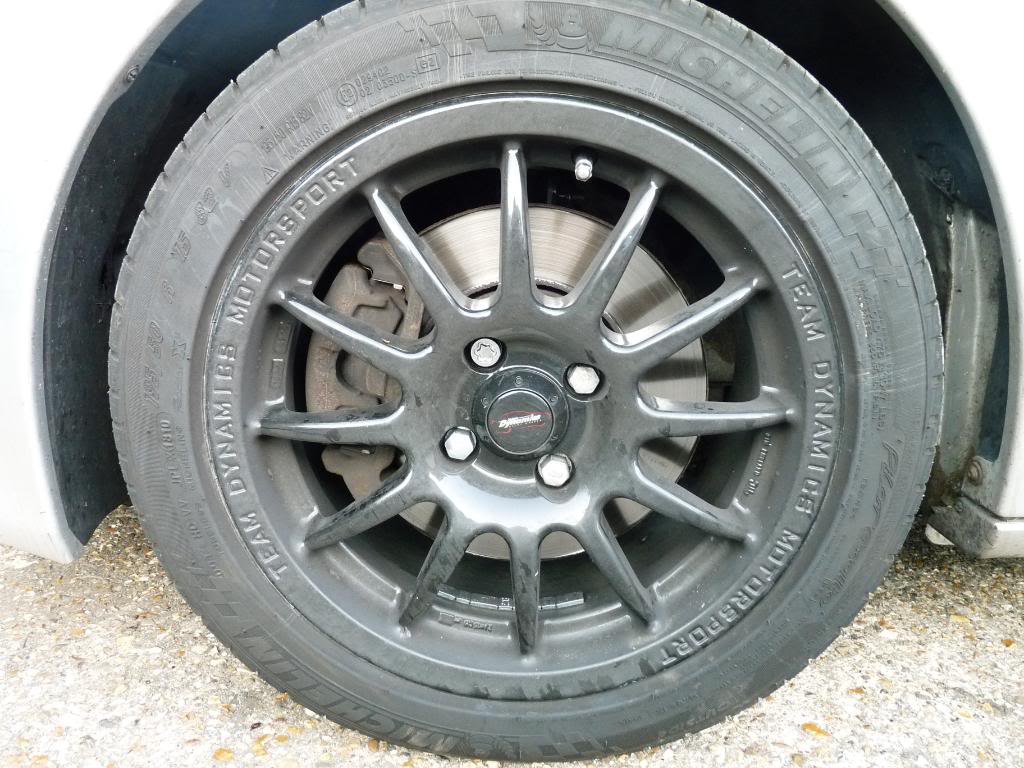

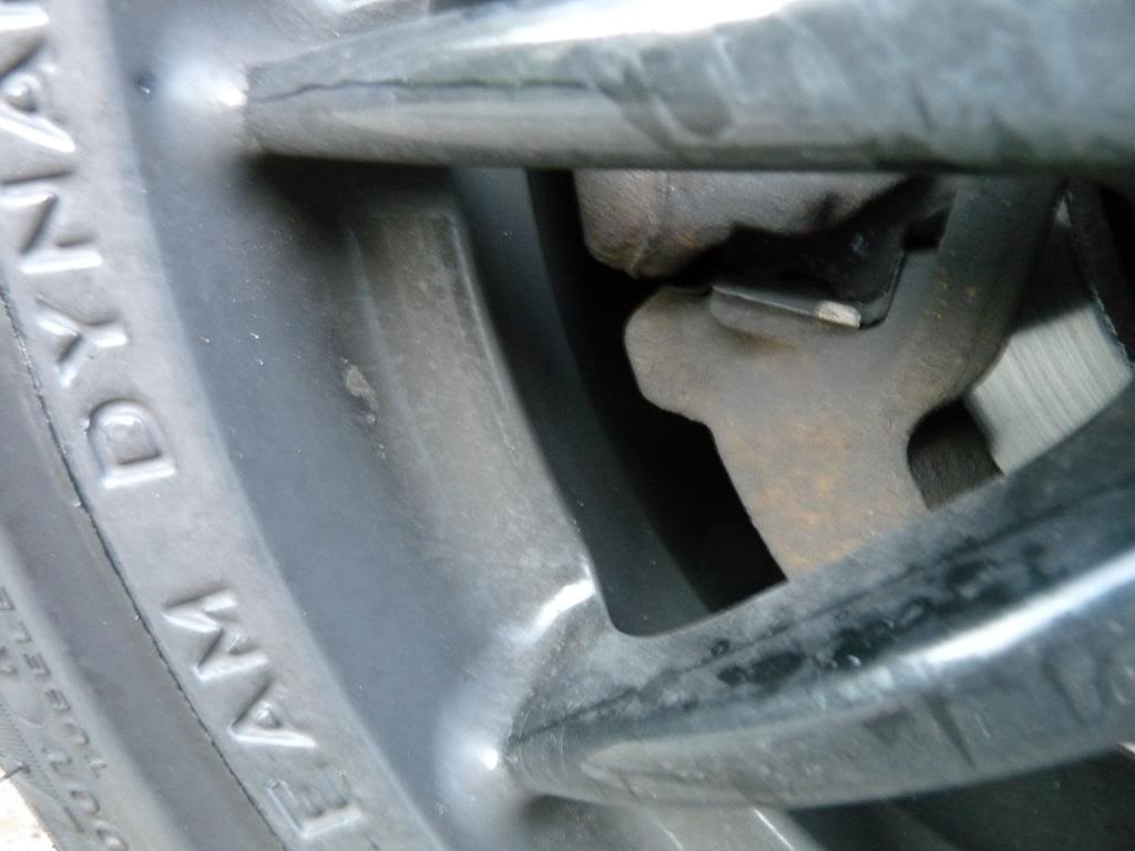

Had MOT today, needed a few bits and pieces to pass
- Brake imbalance by 65%!! That explains the brakes pulling to the left
- Washers not working
So had new discs and pads all round. Just went for the OE stuff as its 1/3 of the price of uprated bits
New washer pump fitted as well, now I have working washer jets!
Finally thought i'd have an oil/filter change, seems to run a little smoother now.
Getting cage bolted in properly next week so more pics to follow :)
  Lotus Exige, 182
It's a false economy going for oe front brakes on a track car, imo. As soon as you get it on track, you'll get bad fade after a few laps. Brakes are the one thing that need upgrading on a standard 1*2 before track use.
As the title of the thread says, this is on a budget. I want to uprate the discs at some point but havent got the spare cash at the moment. The brakes are s**t loads better than they were before hand so all is good at the moment.
If i experience massive brake fade after my track day i may reconsider the order i buy bits in

autoglym instant tar remover will literally dissolve the tar glue s**t left tom, its amazing stuff, ive used it in mine
