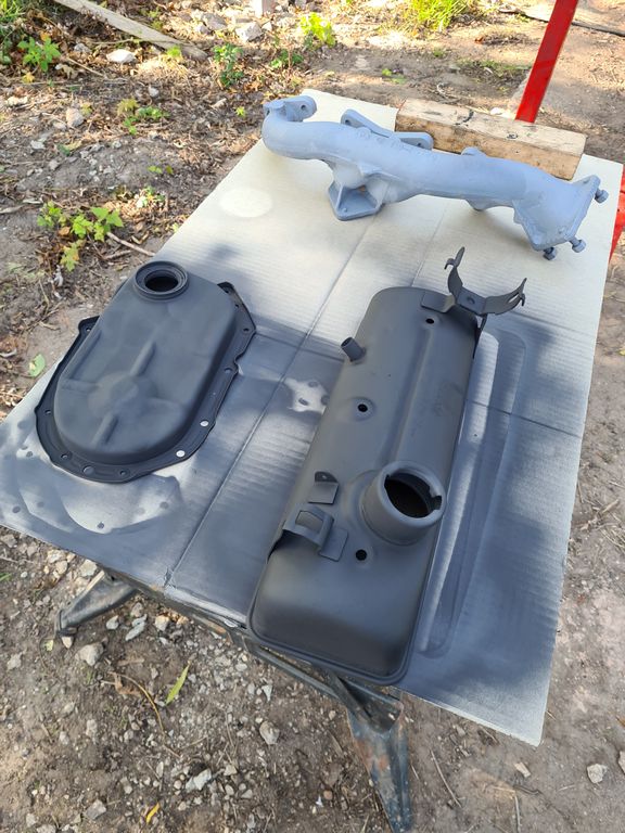

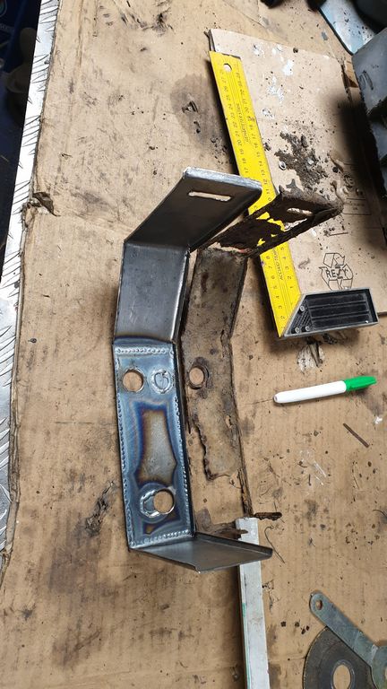

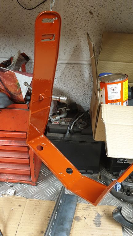

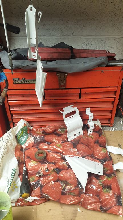

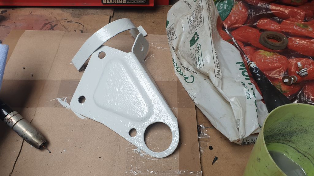

I was having a load of stuff blasted and coated for the 21 so i hoofed a few bits in for the 9 too, primed them up on Sunday. Fuel pump/filter bracket, towing eyes, stuff like that. Pretty sure I took the wheel cage up there too, didnt realise till now I didnt get it back so will have to chase that up.
That is all :)

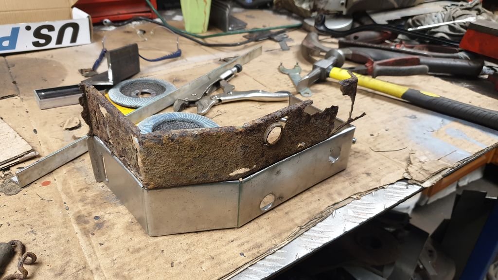

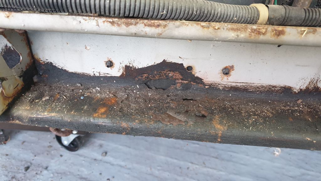

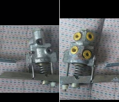

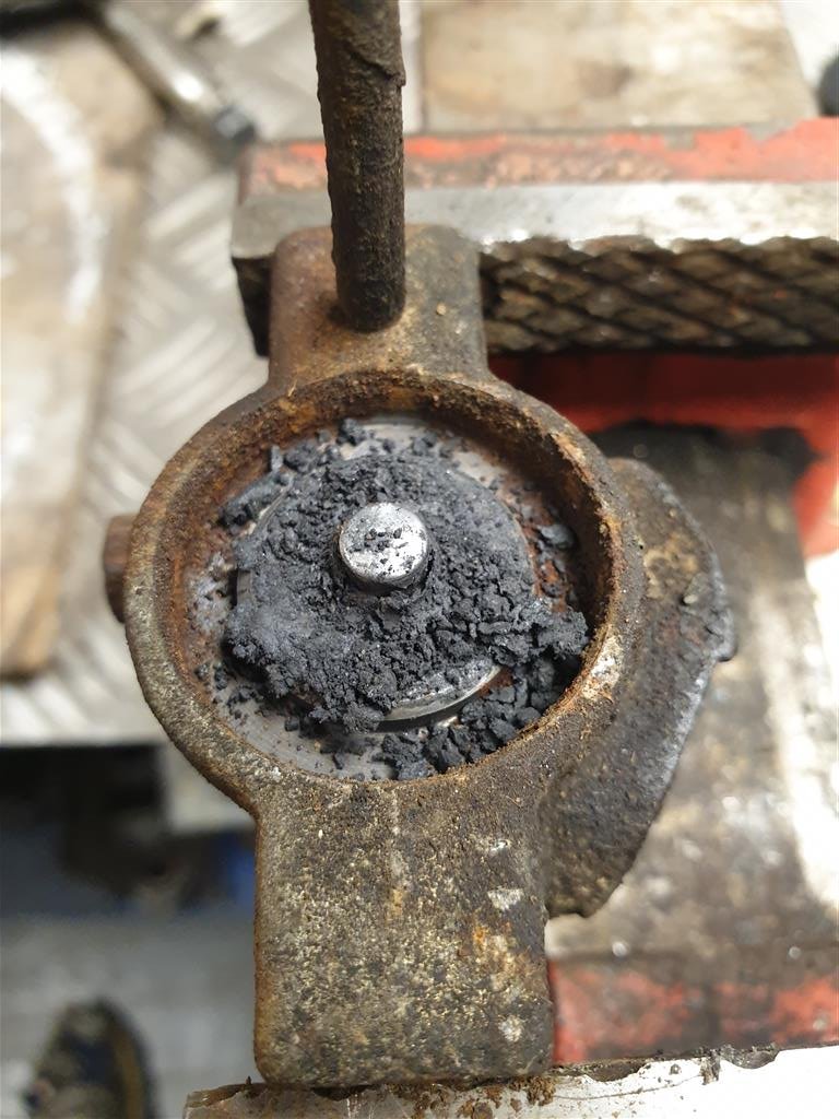

The rear bias compensator isn't looking too hot!

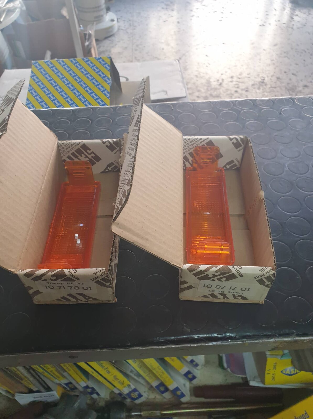

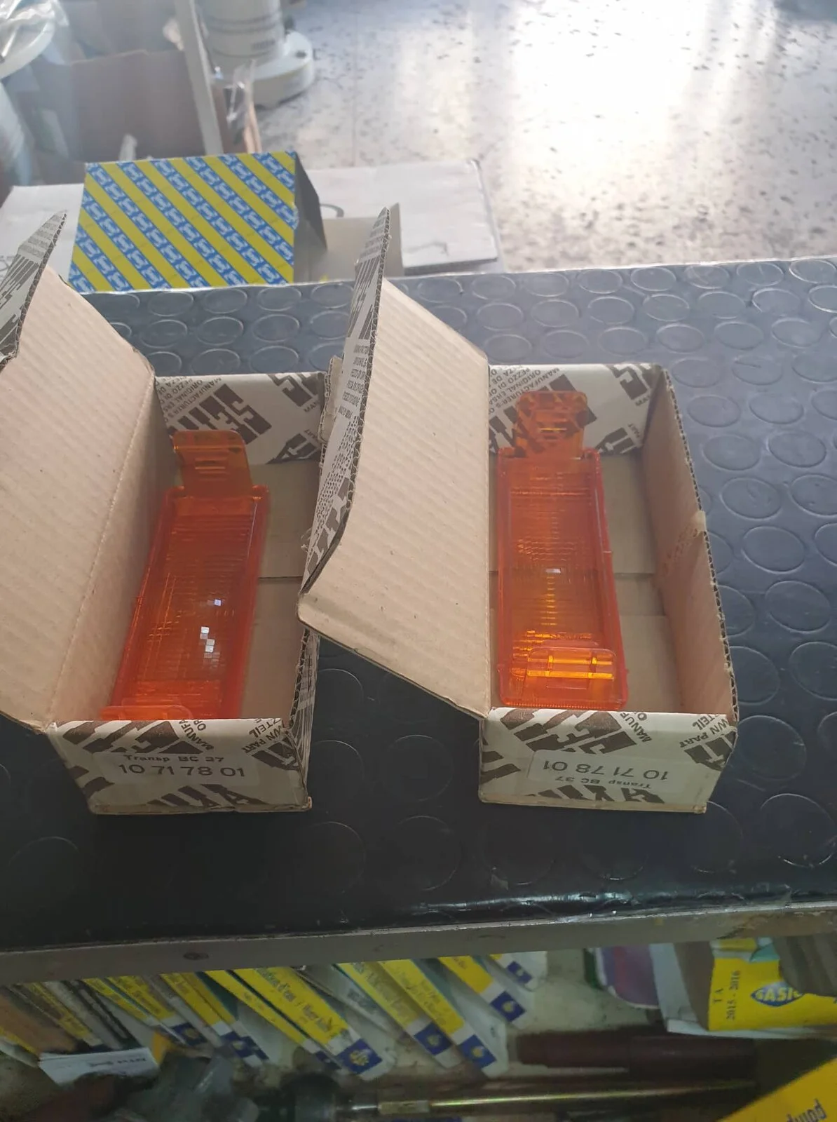

Would you believe a New-old-stock one of these popped up on a R9/11 Facebook page. I basically jumped down the guys throat (digitally), sent €100 to a total stranger and low and behold...it shows up at my door as promised.

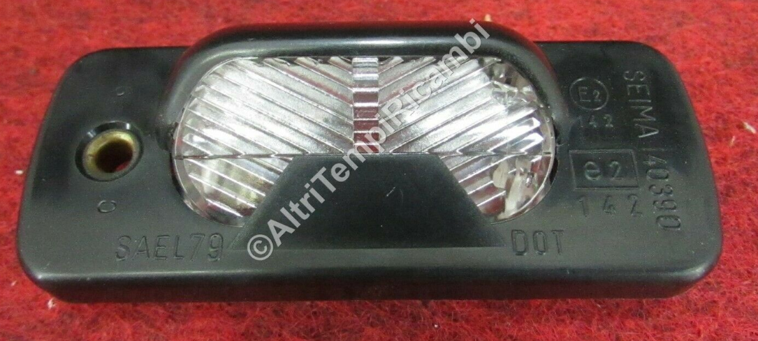

Also bagged a NOS numberplate light from italian eBay, on the hunt for another. Found some in Turkey but they wont ship to the UK.... fail!

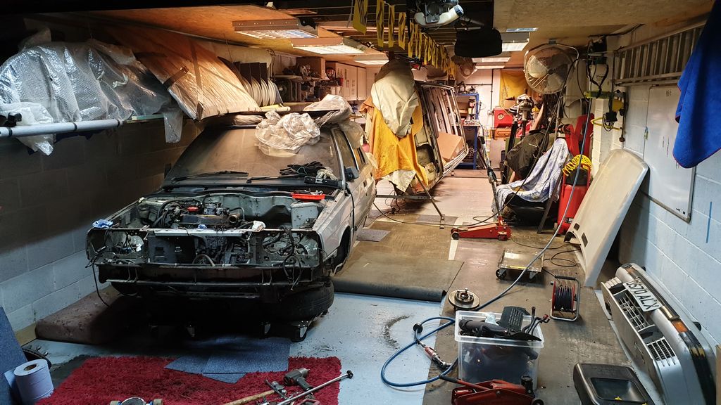

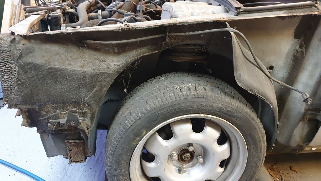

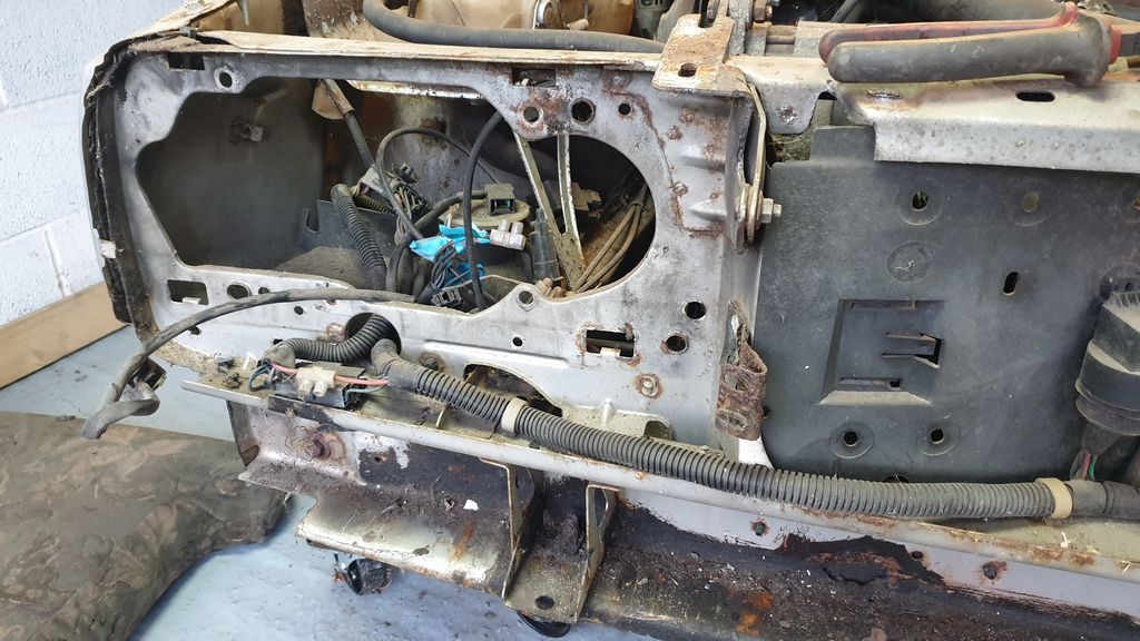

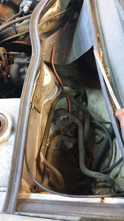

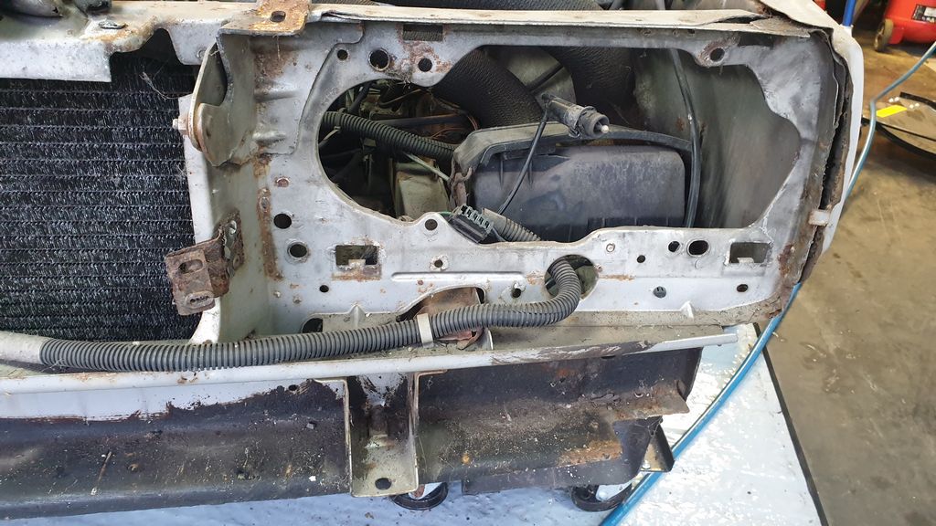

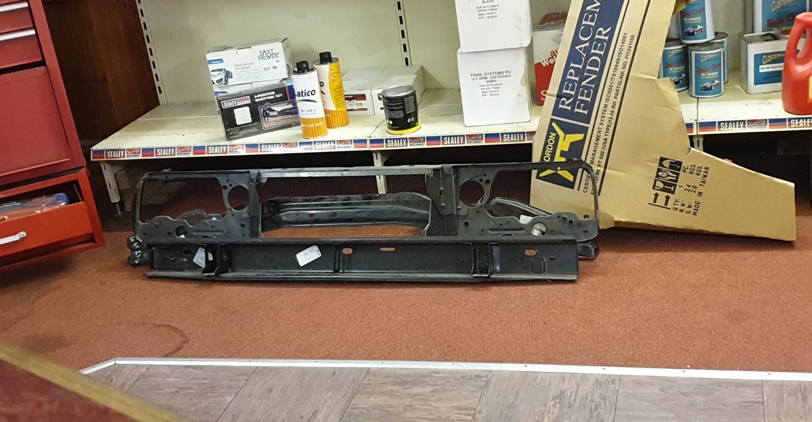

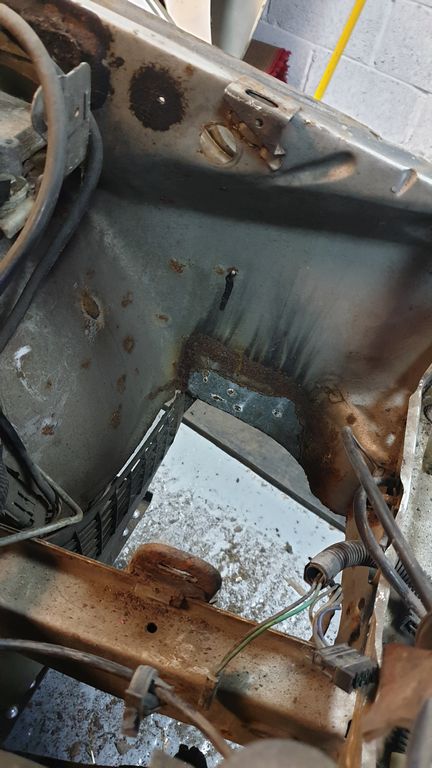

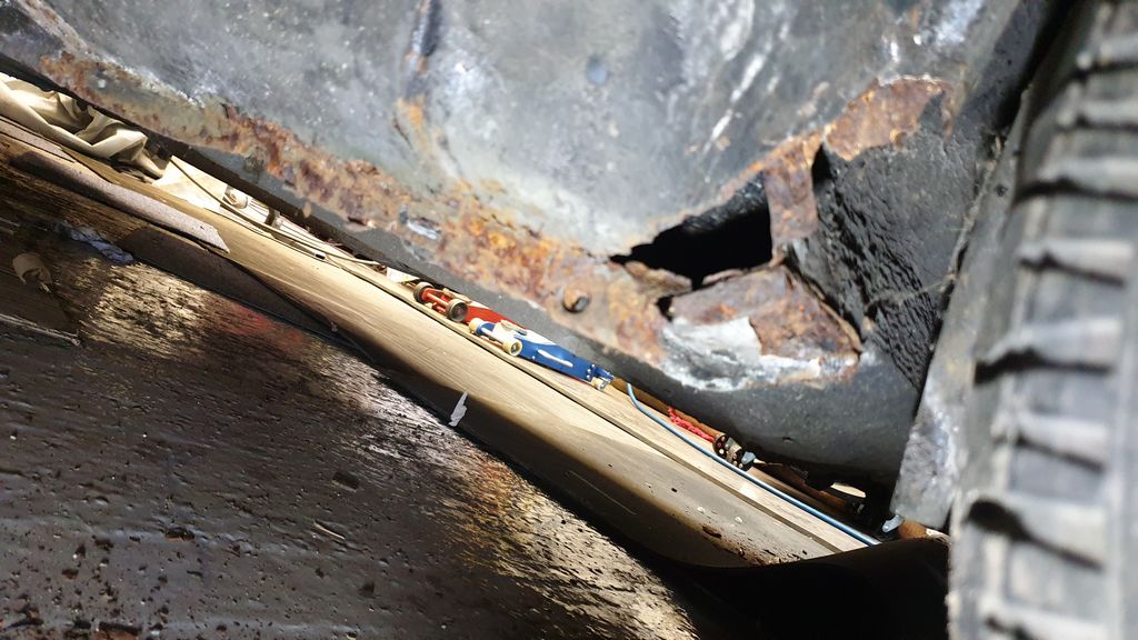

I recall years ago taking the front bumper off the 9 and seeing the front crossmember a bit yukky - not perforating, but not mint, thinking about it that was over fifteen years ago now so when this complete front crossmember and headlight surround panel came up brand new I booked a day off work and did a six hour round trip to get it.
Having already sniffed out a NOS front bumper, main beam headlights (outers), surrounds, grille and badge i'm not far off having a complete new front end for it. If anyone sees the quad light dip beam units (inners) brand new let me know,

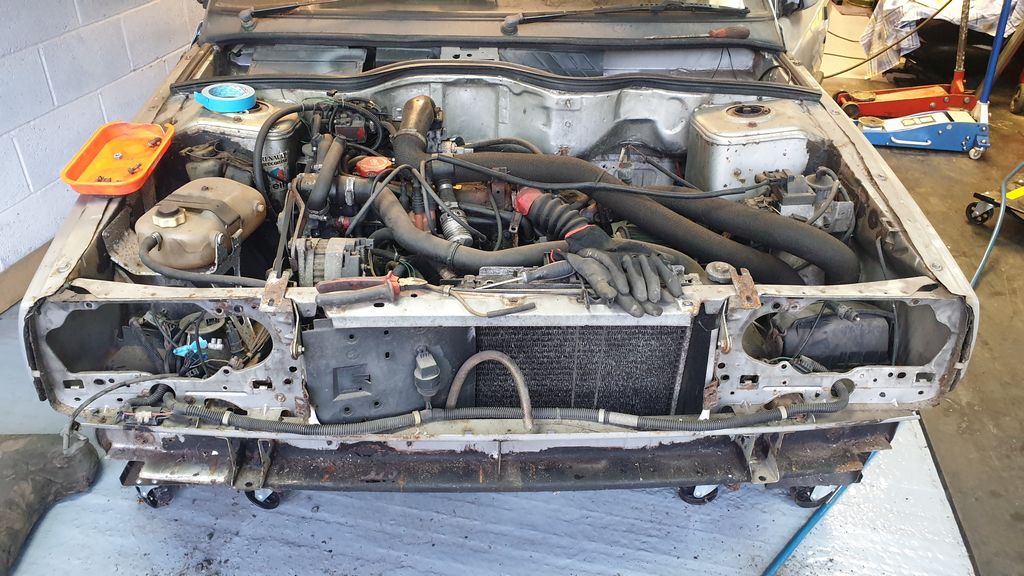

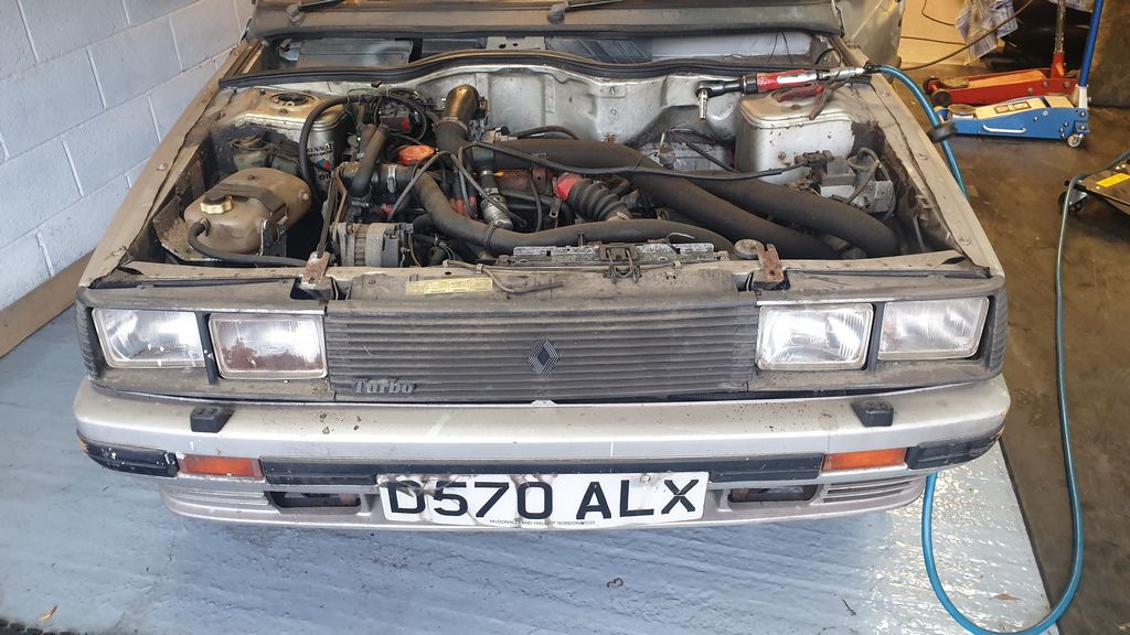

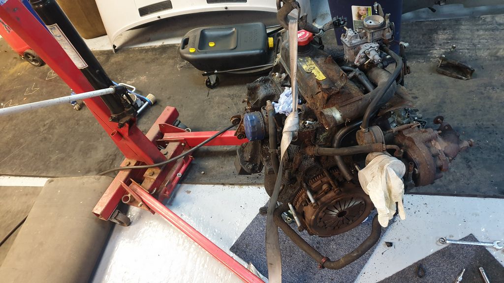

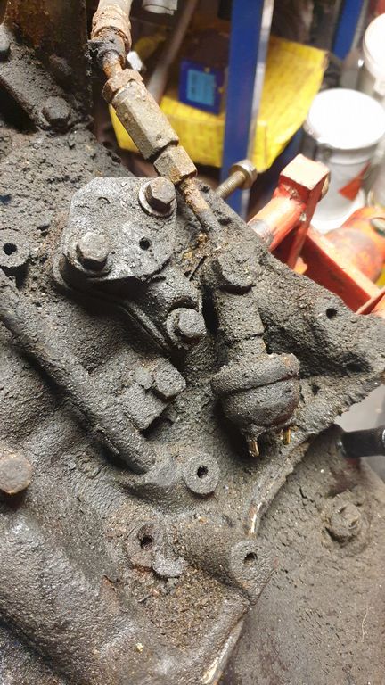

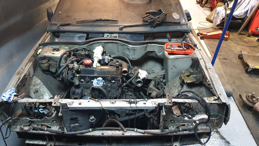

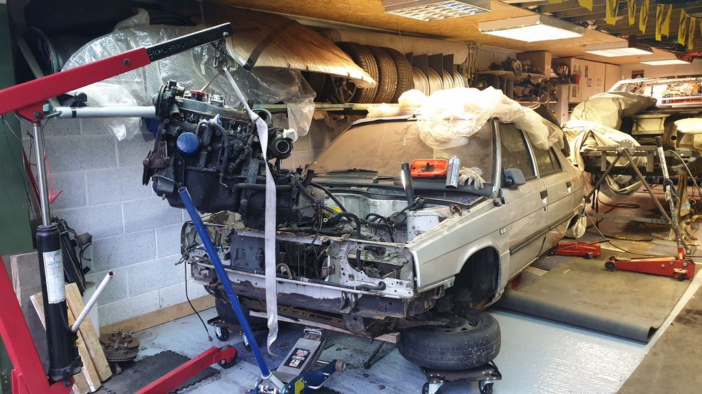

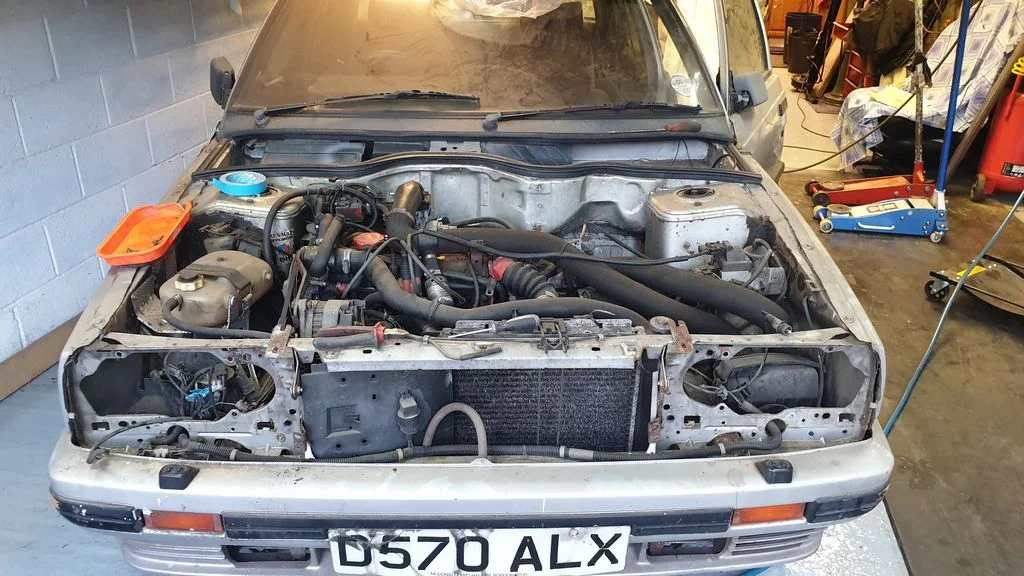

...and then decided to pull the engine and box.

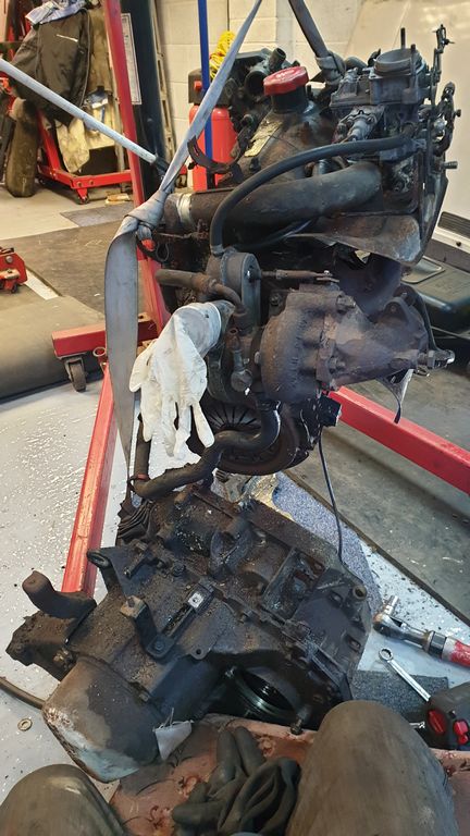

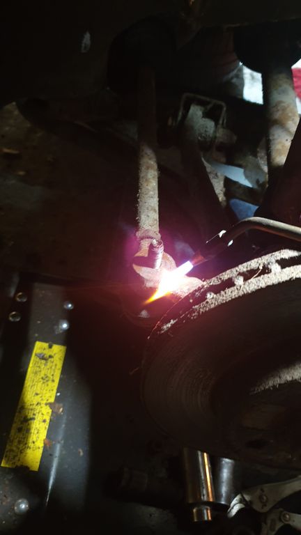

Typical steering balljoints stuck, had to get the OxyTurbo out

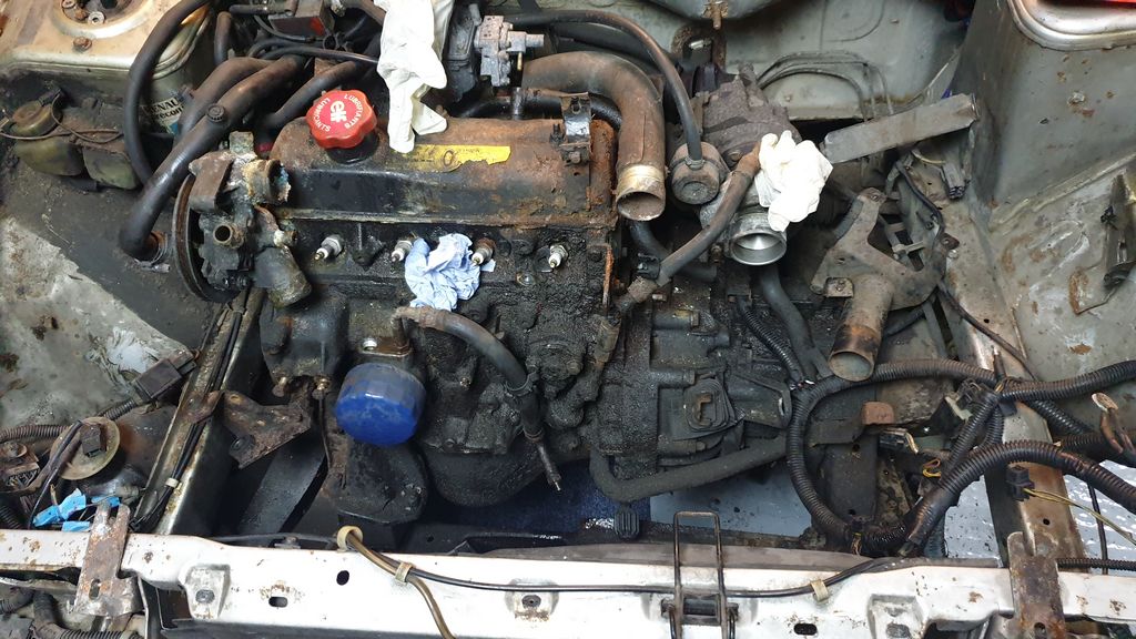

Out she comes for the first time in my ownership (which started in 2002).
Dropped the box off, then the turbo before I decided enough was enough.

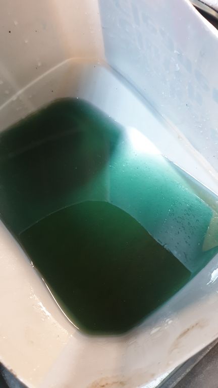

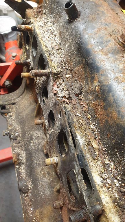

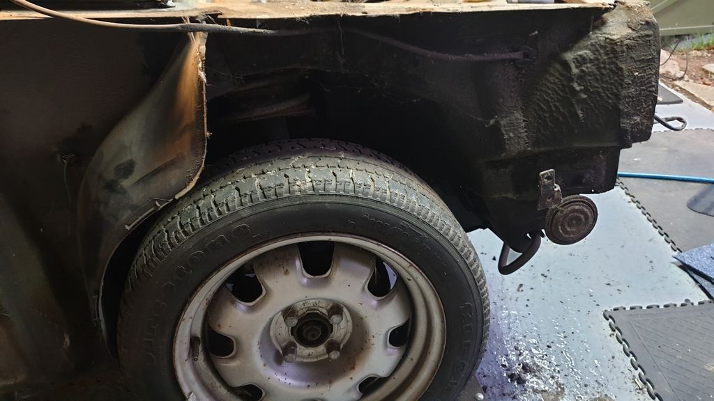

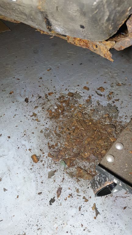

As an aside, this car has been off the road since 2005, and this is why a good quality antifreeze is important in your engine for corrosion inhibition as well as its obvious other qualities - look at how much corrosion there isn't. This is fifteen year old antifreeze.

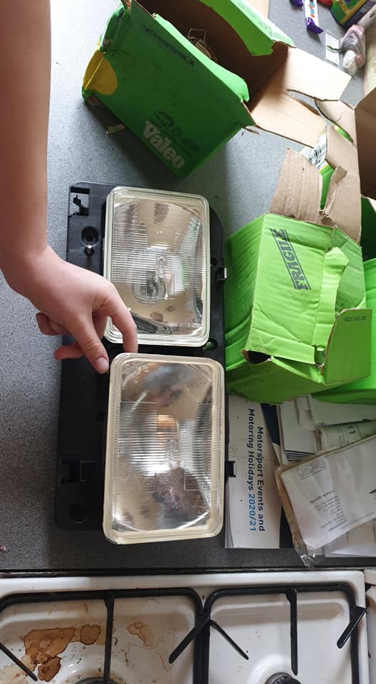

I found a new headlight backing mount online (still looking for the other side), so I dug out my new lights

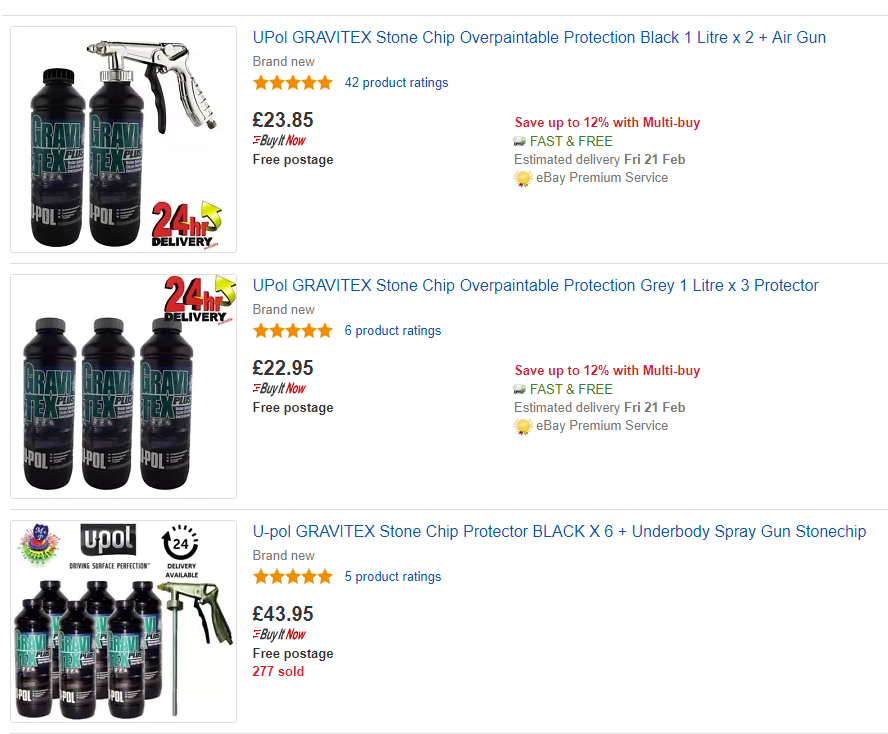

Dave would you use Gravitex over Bilt Hamber Epoxy undersealer?
Gravitex but probably for the wrong reasons.
Gravitex is cheaper (but still an excellent quality product)
It's also spray-on giving a nicer and thicker finish (see earlier pics in thread), IIRC the Bilt stuff is brush on. I am fortunate to have a very hefty 250L compressor though so I get great delivery and no pressure drop.

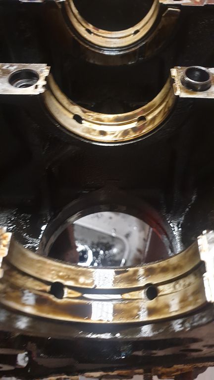

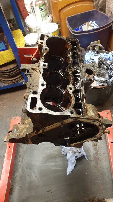

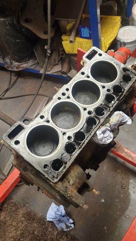

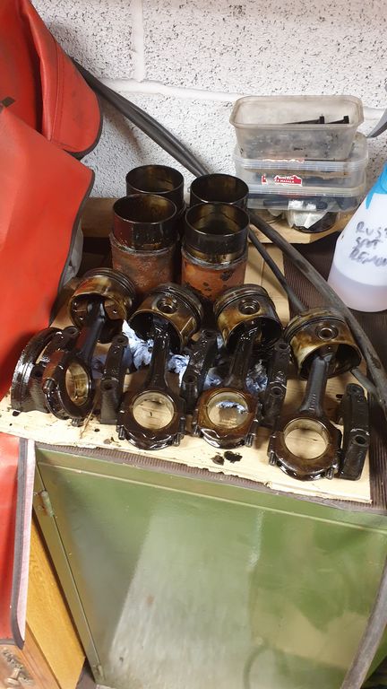

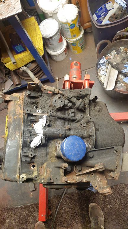

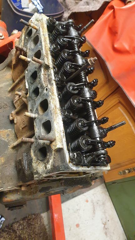

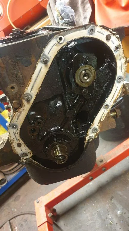

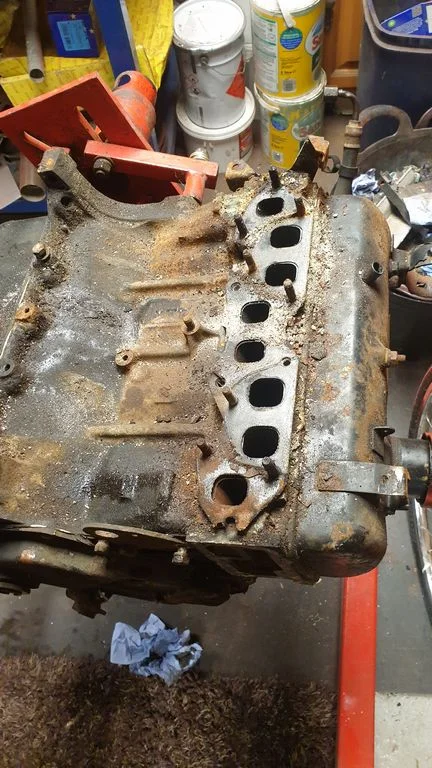

I recently discovered in the parts stash a set of brand new pistons (with rings!), liners and gudgeon pins, and some big ends and mains too and I fancied a bit of engine tinkering so I pulled down the 9 engine. I was amazed how good it was considering, the crank is in fab condition.
Humped it on to the stand, couldnt be bothered to get the crane out. Should know better but I got away without pulling anything...this time.
It's properly grotty on the outside
Decided to break it all the way down and send everything off for vapour blasting
Ready for extreme cleaning!
I need to keep the rods, the pins seem a sliding fit in the pistons but a tight fit in the rods so will prob send to a machine shop to swap the new pistons in. IIRC they need heating and pressing?

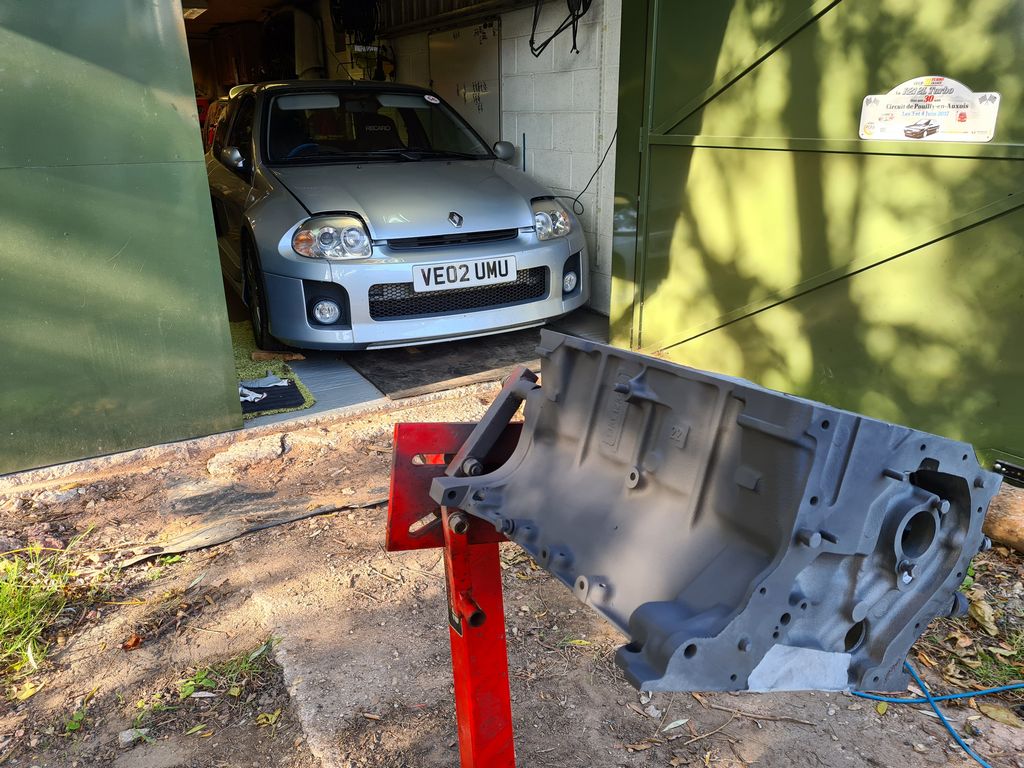

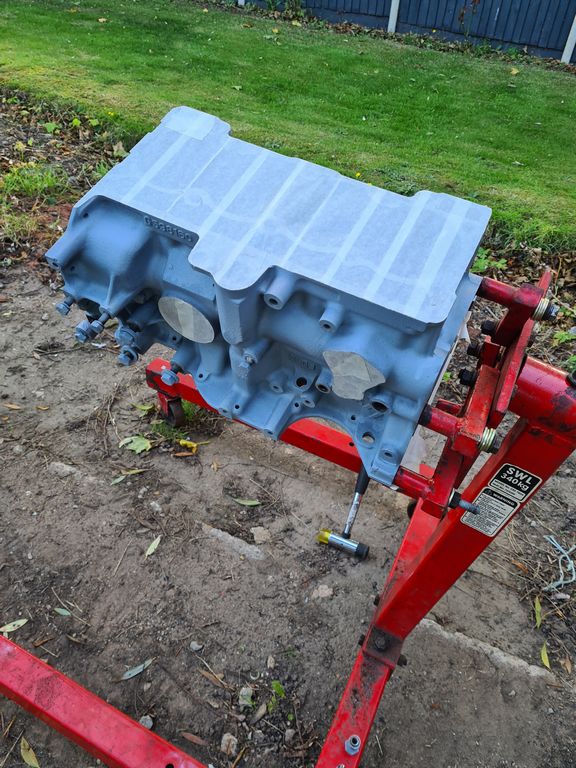

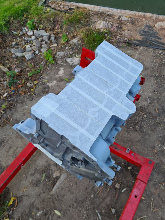

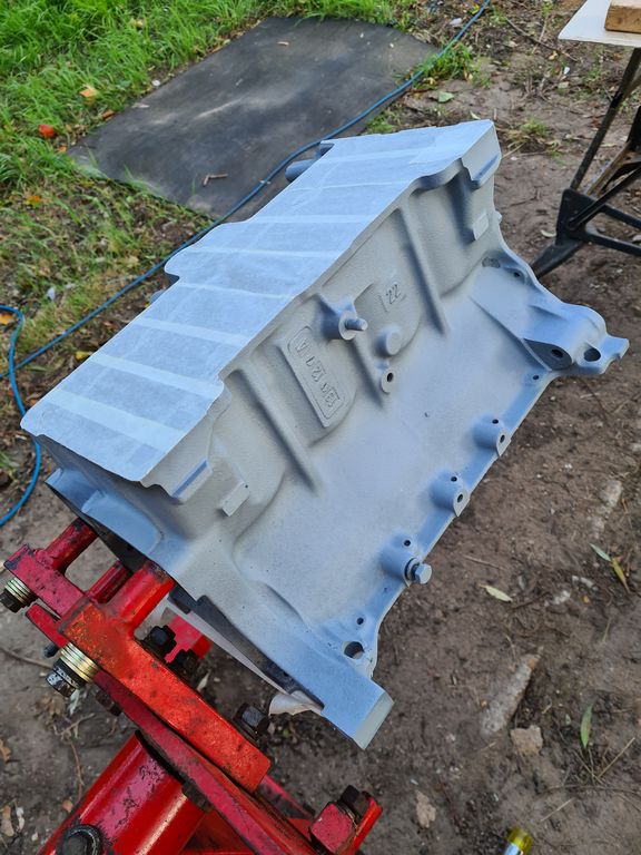

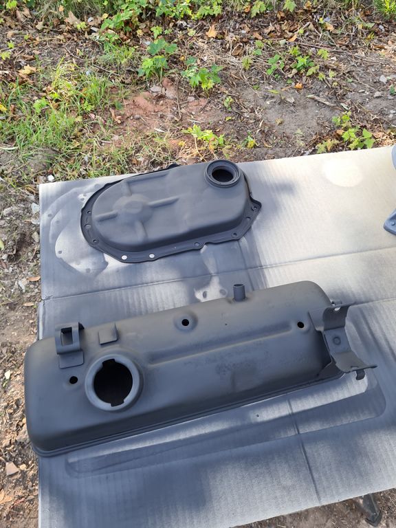

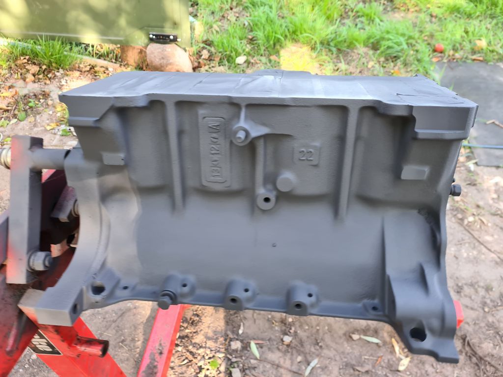

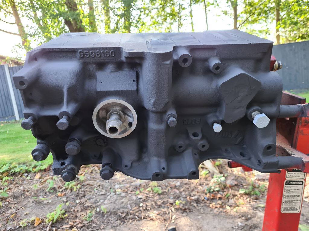

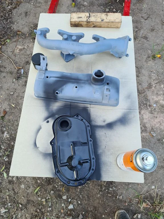

Engine has been back and sat in my living room for a couple of weeks, so last weekend I threw some paint at it. Seems in decent condition given the age, and that it was sat for 15 years (with coolant in), particularly the liner seats which are absolutely mint. Really shows how much difference it makes having the corrosion inhibitor in there.
