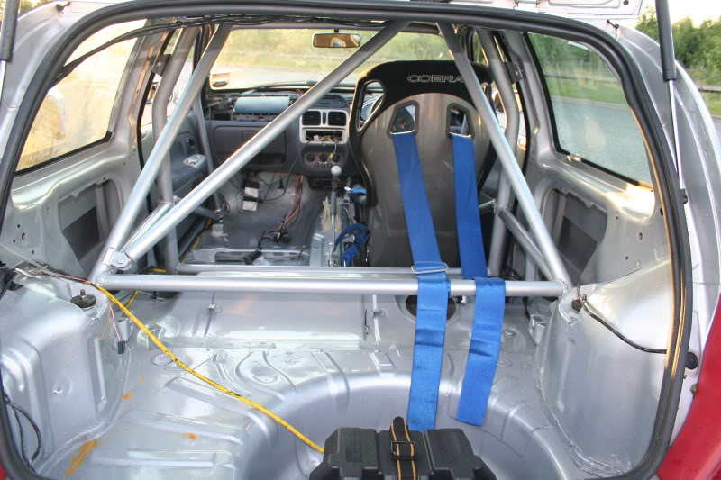

OMP cage (weld in) with optional extras :p
Cobra evolution S's
Cobra alloy 5mm side mounts
Cobra subframes
Sparco 3" 4 point harnesses
OMP eyelets and load spread plates
Full interior strip, primed painted and 2k lacquered

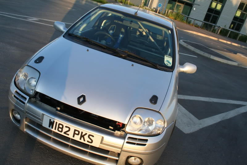

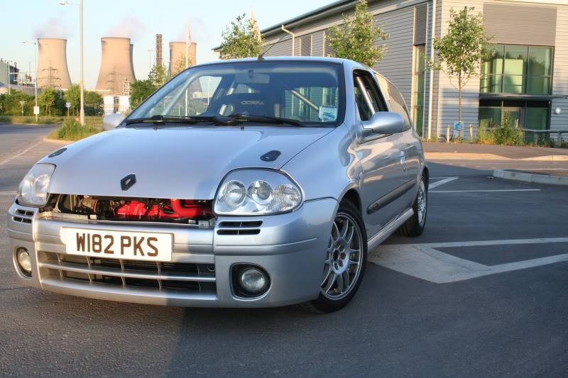

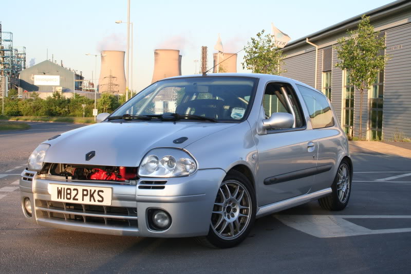

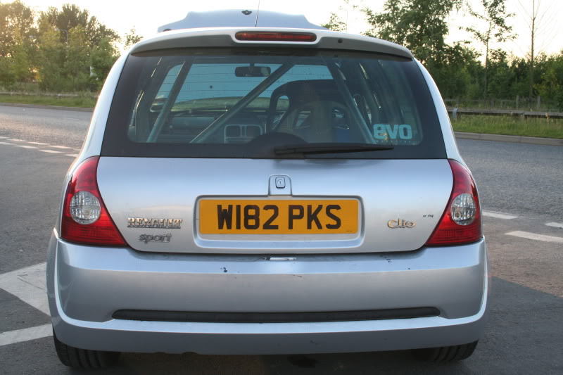

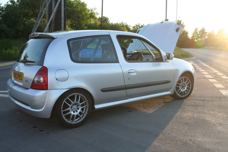

It needs the suspension setting up still, the rear is too low and the front it a few mm too high, the driving position needs sorting, brakes need a good re-bleed, the front insert for the bumper needs to go in, need to get the tacho working and the top dash back on, passenger seat in and a few other odds and sods...oh and a bloody clean!
Not bad it took just over 3 months to do (the full bespoke engine build took less than 5 weeks which i was pleased with, seems it doesn't have to take 12 months these days)
Its cost a shocking amount of cash but.. meh it goes and looks great imo! cheaper than modding the r32 though, exhaust (manifold, cats too etc), CAI filter, sway bars and a remap just cost £2700 for that :/
a few pics (adams 197 sneaked on a few)
oh should see you all at fcs! fingers crossed!

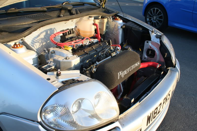

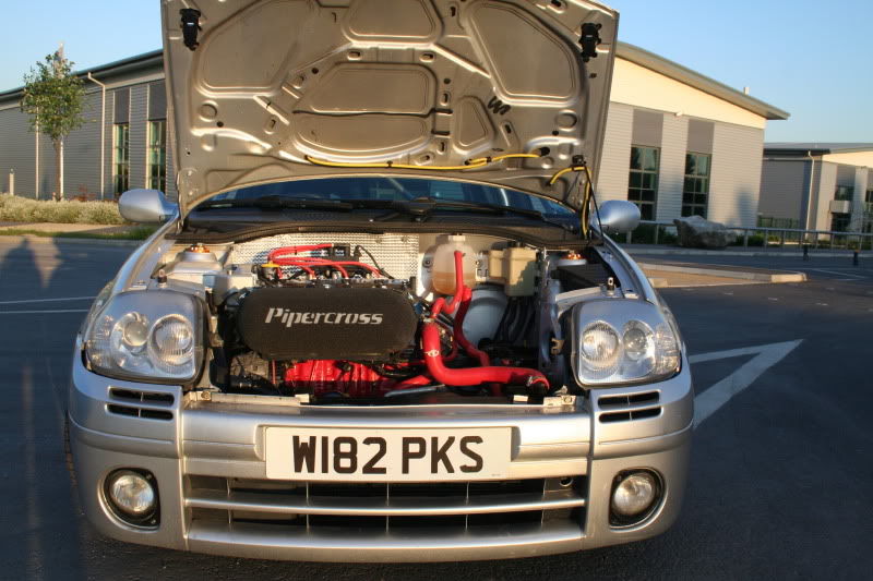

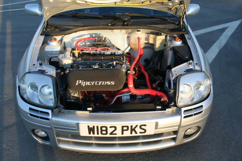

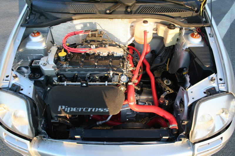

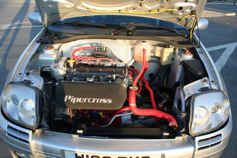

Looks good, engine bay is very nice. gonna finish the dash off?
How different is the Cup master cylinder?
the rear doesn't over take me anymore lol, i changed from a cheap bias valve to the tilton one at the same time though! i got it off ebay it looked the same as the non cup one, renault said it was the same!
So I would guess the tilton fixed it

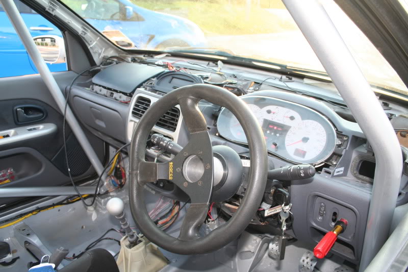

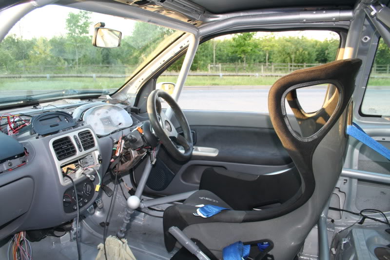

Awesome bit of kit there Ben. One question tho, whats the red screwdiver-esq handle by the instrument panel dimmer control? (pic 14 i think)
  C63 AMG, F430 & 172
And to think I can't even be arsed to jack my car up to clean the insides of the wheels!
remote brake bias adjustment

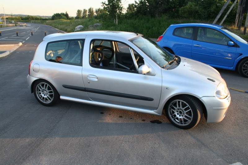

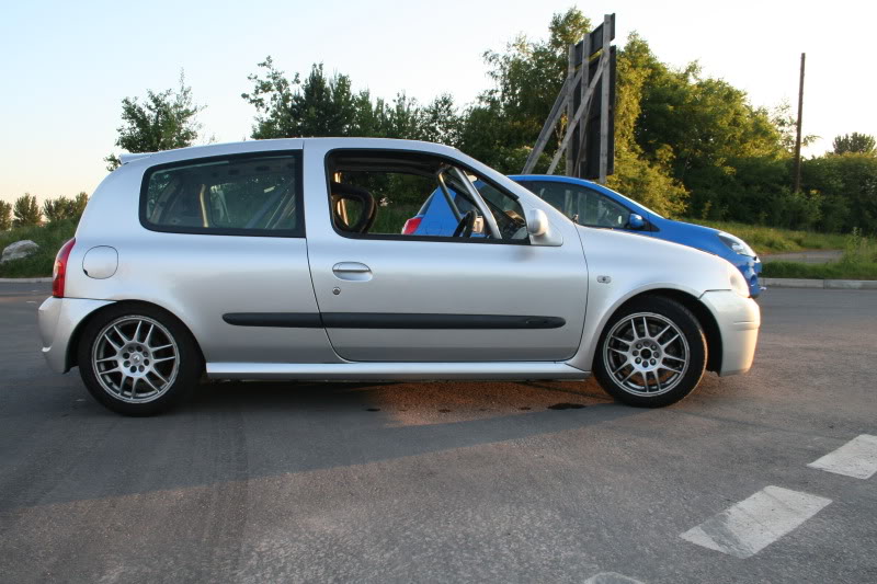

Loving the ph2 rear and ph1 front, proper beast this.
Love everything about it. I'd just take the front down a tad and leave the back.

Looks sweet, I was mega impressed with the tidyness of the engine bay!

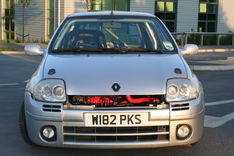

Looks so good that engine bay!

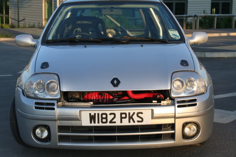

What are you doing with the front? going to get a grill?

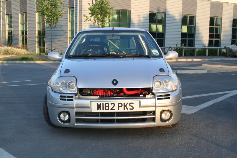

yeah a piece of shitty body work slots in there
I forgot to put it back on when i fitted the bumper, then thought.... f**k that I'm too tired lol
