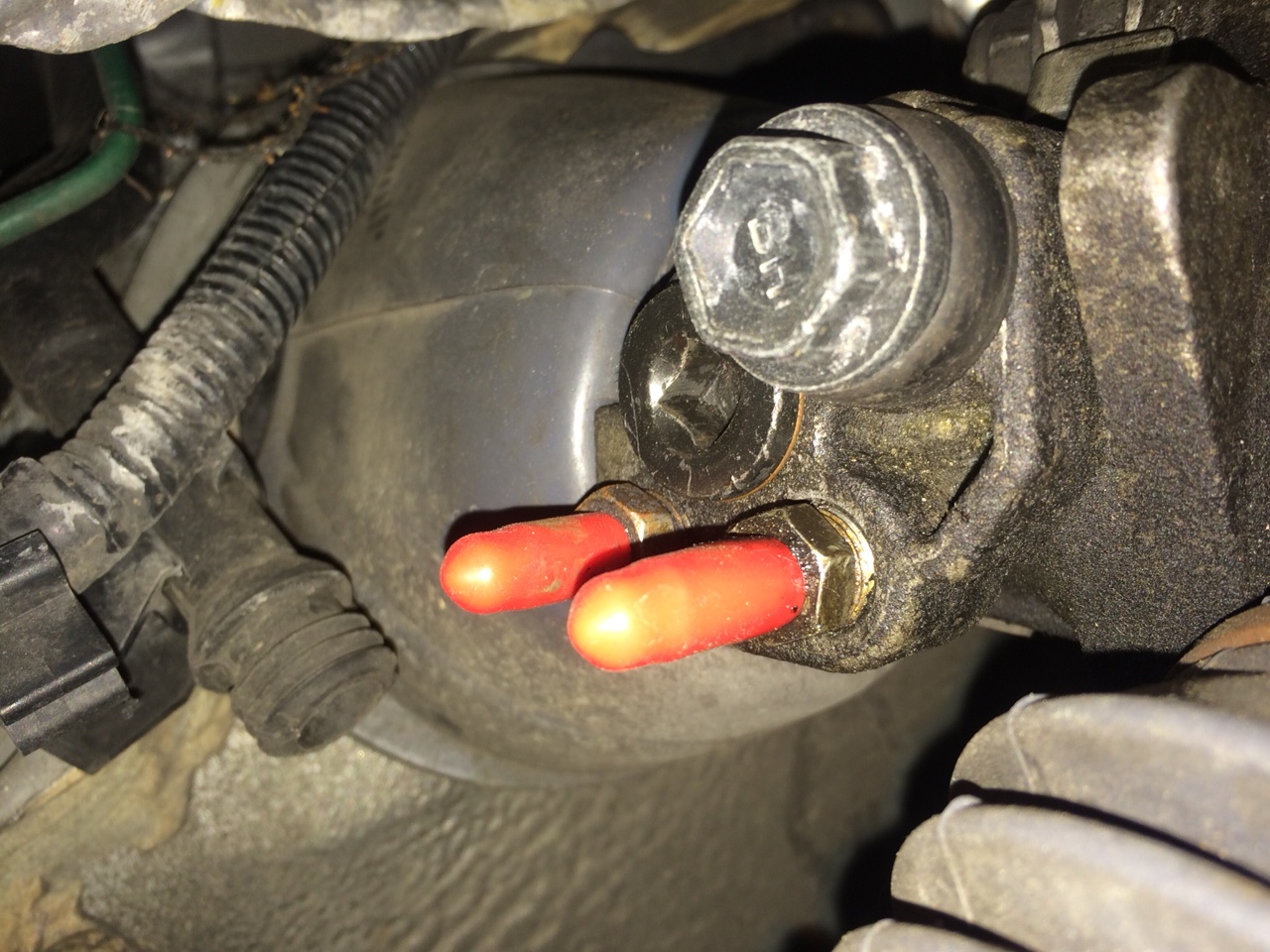

Pictures of your looped rack for EPAS. What fittings have you used?

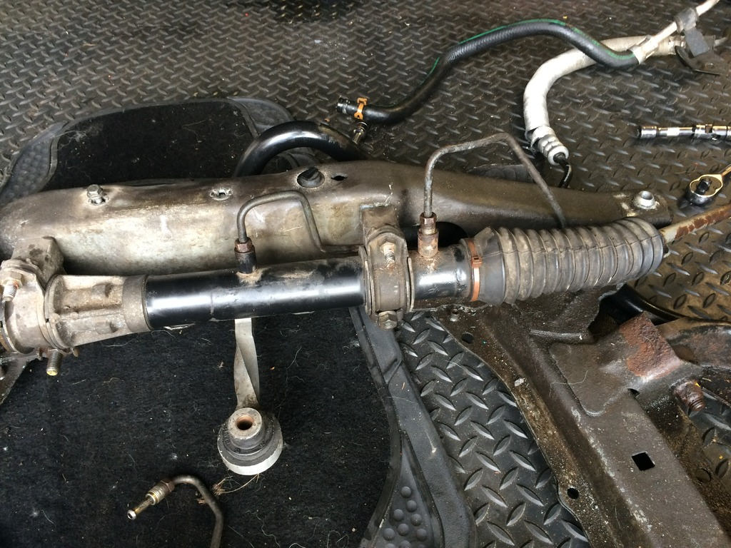

If you are leaving the rack in the risidual fluid will be enough to keep it lubricated.

So is what I'm saying correct? Or instead of draining the part that get looped just leave what's left inside?

Found mine in my tool box , I read somewhere the odd size one is a Vauxhall sump plug .

Did you drain all the fluid out of the part that's been looped and grease inside the bit you've bunged up?
Once the pipes were all removed , whatever was left inside has stayed behind .
The other end is looped as we all know , just left what was in there behind.
