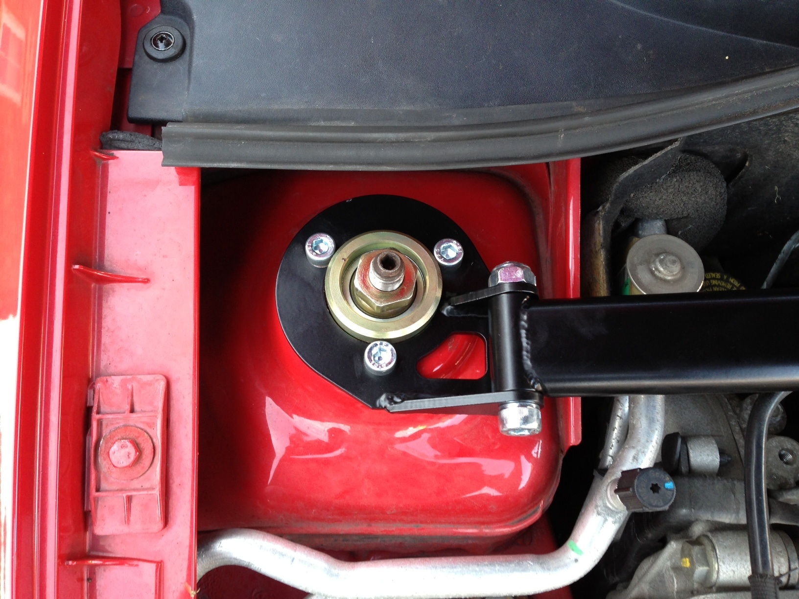

The top cap should not make contact with the turret,and should have a 4 to 5mm gap.
If you machine the modified nut/spacer, it will become thread bound before it contacts the bearing, causing a REAL problem.
This thread and the link in post 2 about covers everything there is to know about top mounts.
The pictures from the red car has the modified parts fitted.
https://cliosport.net/threads/182-top-mount-failing-questions.819193/#post-11615686
