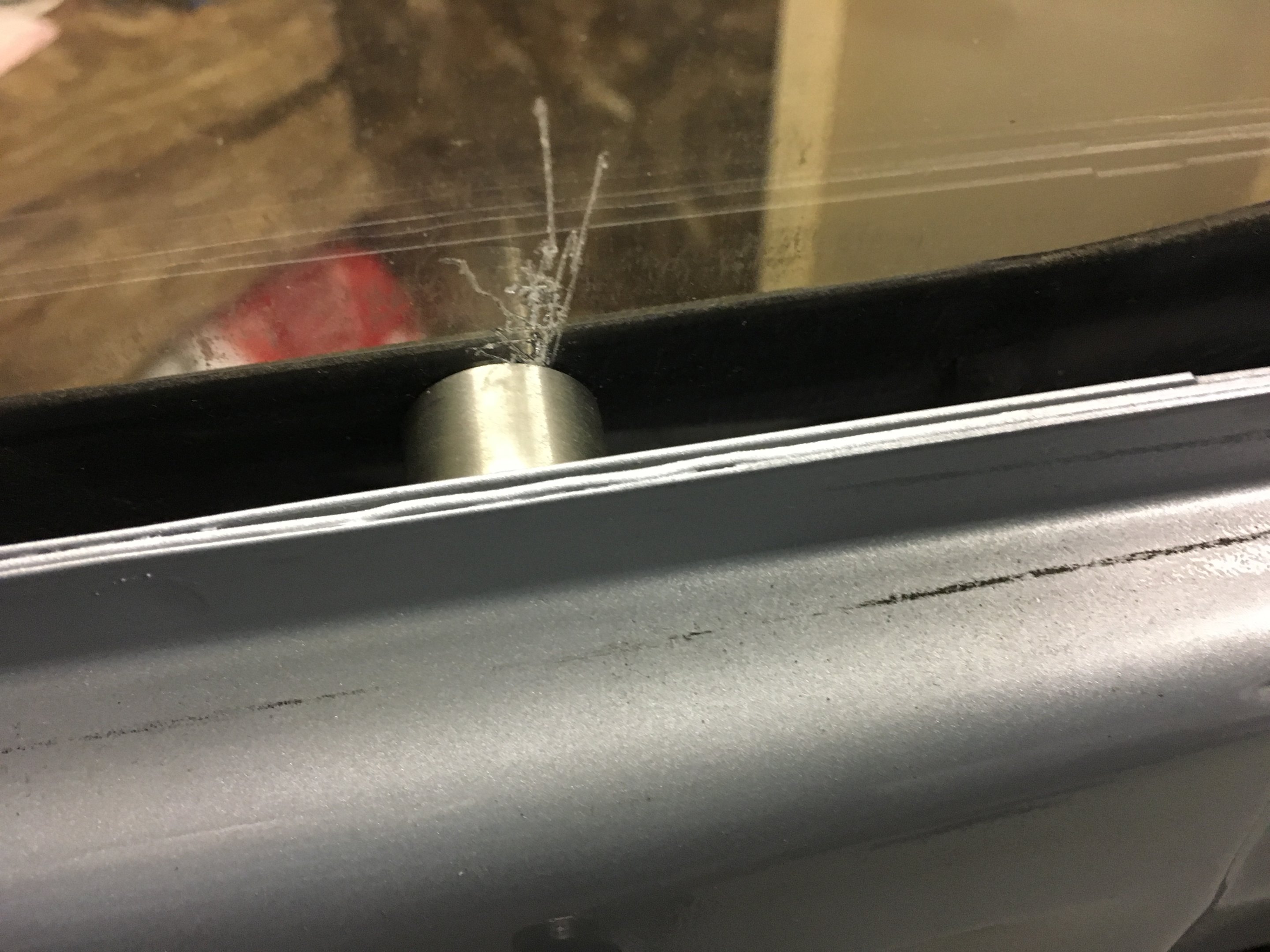

So I’ve purchased some secondhand front poly windows and they’ve got horrendous scratch marks from the previous owner mounting them poorly.
My idea is this...
Ok so that piece of metal spacer has a hole in the middle of it.
My thoughts at the minute are to drill a hole in the door, put a bolt through the door and spacer and then use a nut to clamp the spacer to the door whilst the bolt pushes against the window, keeping it in place
Any other ideas that’ll simplify my thoughts?
