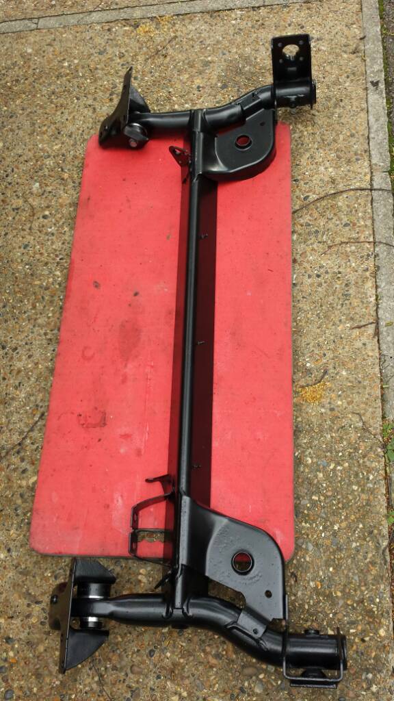

I had mine done 2 week's ago.
I removed everything and got the bits done with the beam.
The rubber bush comes out, there is a split at the back.

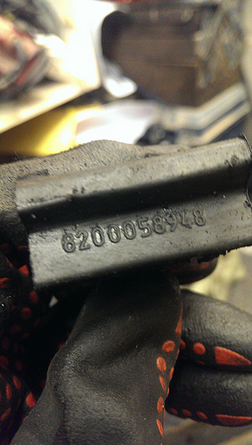

Here's the Product number for anyone.
Debating it OEM bushes seem same price-ish, aftermarket are £25 a pair.

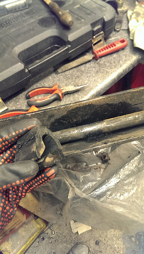

I did it on my drive, cut the center of the old bush out (the rubber part). I used a sharp chisel, hammer and lube so that the chisel didnt get stuck in the rubber bush.

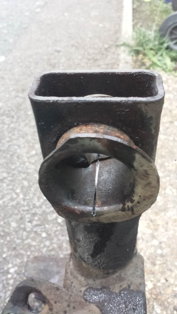

Then cut a slot in the steel outer, i used a hacksaw.
Then just hit with hammer.
Like so.

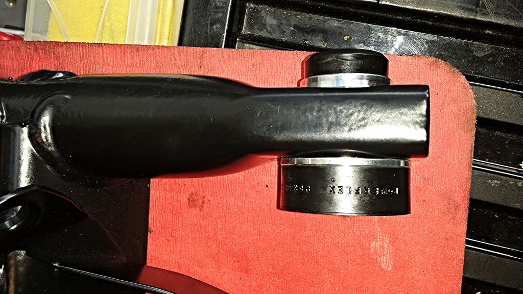

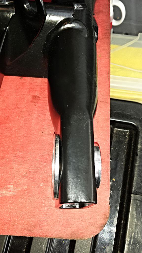

To fit the new Powerflex bushes, i used strong Loctite on the alloy outer and tapped/dressed it in with a bit of wood so not to damage the alloy.
The polly bush just pushes it.

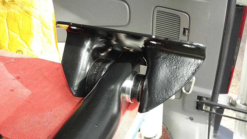

Job done. :D

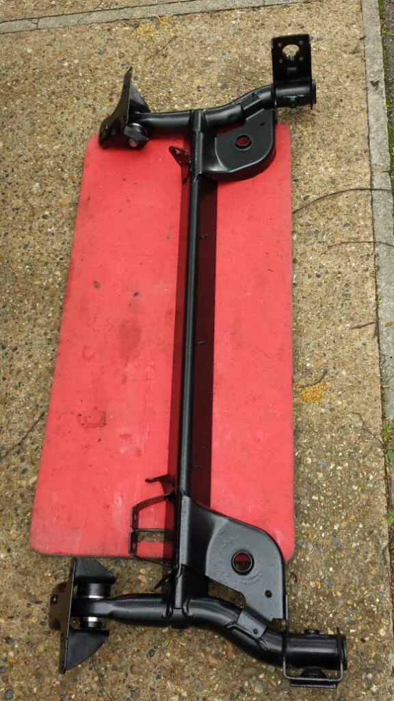

^^^Now thats beam + bush p**n.
