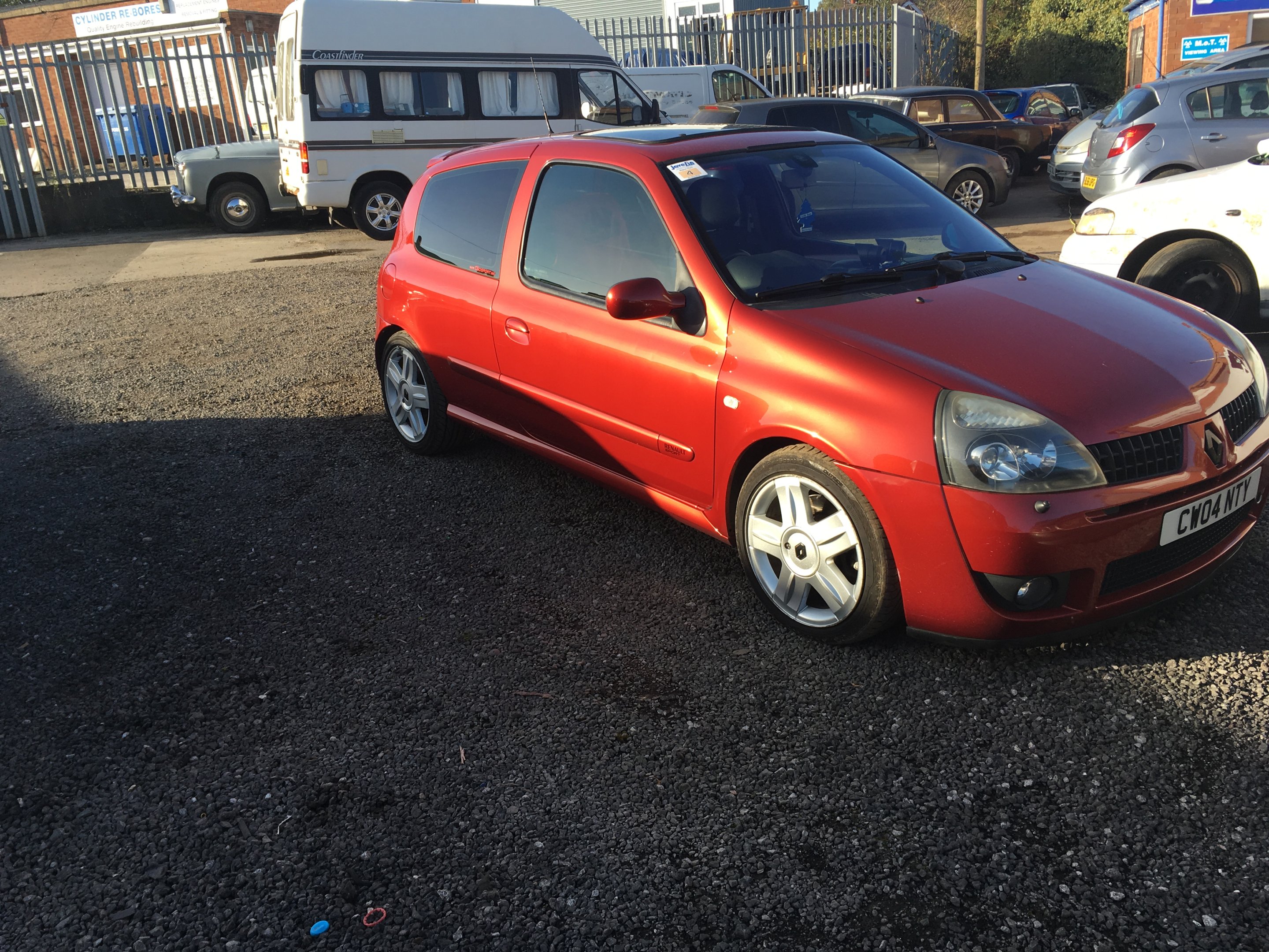

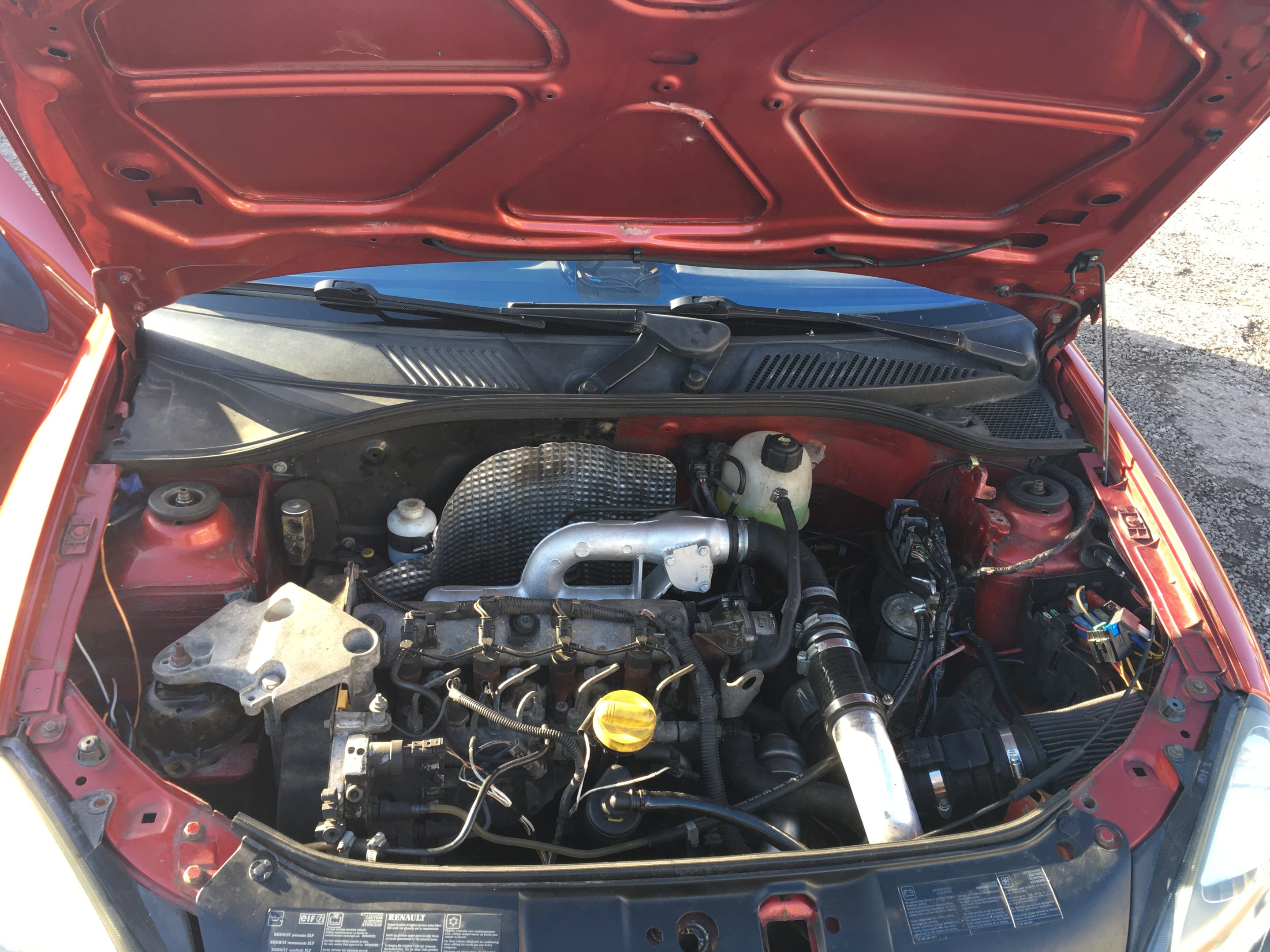

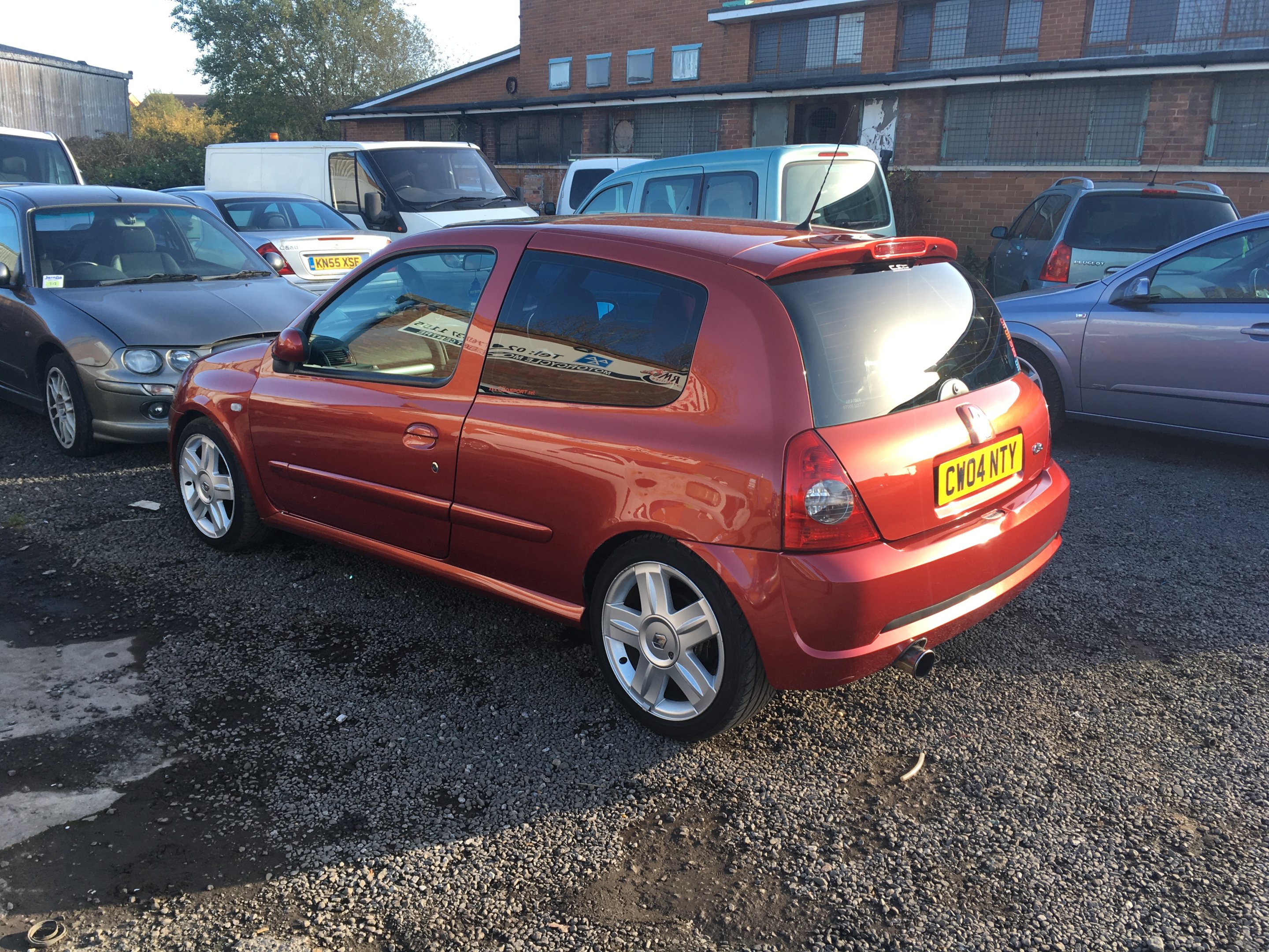

Well as some may know, I have a forever on going mk1 16v Clio that I'm still converting to a 1.9dci 6sp track car, but due to the amount of work coming through the doors ATM I'm slacking.....
Roll on a year or so and now I've acquired another frankin derv.
I give to you the ONLY 1.9dci converted mk2 in the country, one of the first very few done, only one other is know abroad.
Little spec list :
- 1.5dci shell ( originally was a 1.5)
Converted to a 1.9 with a Laguna 120 engine ,
- megane NDO 6 speed box,
- quick shift selector and 6speed cable gear stick
-custom drive shafts.
- Traffic van ecu and engine loom ect all re wired to comunicate with the Clio clocks and UCH. Also generic map and it goes like the clappers, 1.2bar boost comes in slightly hard at 2500~ rpm lol

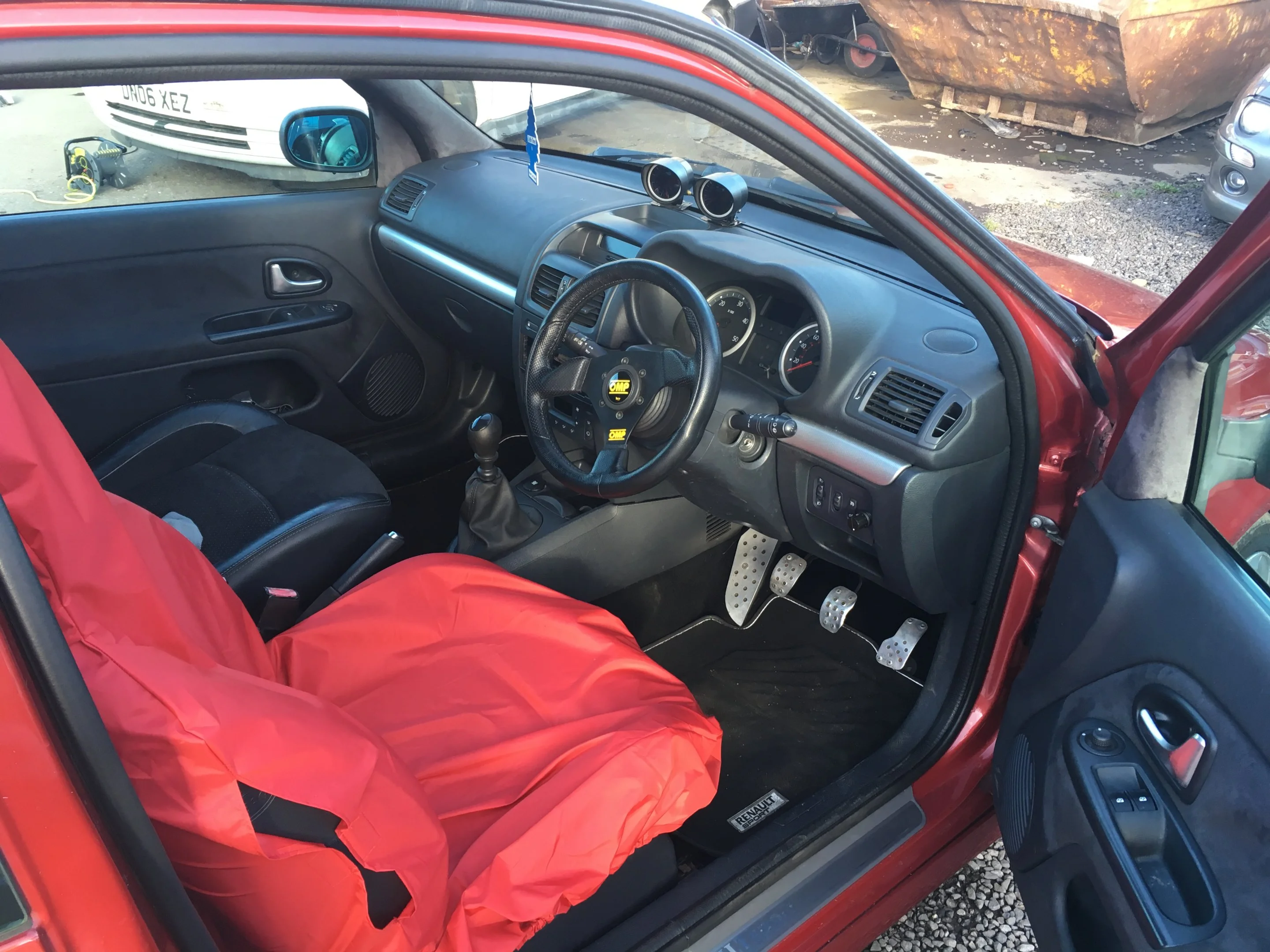

- full 172 suspension
- full 172 interior , and exterior kit
-front mount intercooler
- 2.5 straight through unrestricted exhaust, ( little back box been fitted as it's loud enough )
- depo racing boost / EGT / oil temp and pressure gauges
Loads I've probably missed for now.
Anyway , I'll cut Te s**t out.
Planes for this is as follows :
- full respray in flame red again.
- half cage and nicer seats
- BIG hybrid GT2056V turbo charger from a 2.5dci Nivara
- custom injectors IF needed
- BMW Bosch CP5/6 HP pump
- swirl pot
- oil cooler / diesel cooler.
- complete HARD pipe intwrcooler pipework
- 4 BAR T map sensor
- 80mm MAF
- uprade brakes to twin pots
-TD 1.2s in 15s.
- coilovers and bump correction kit
Then when engine mods done go to DervTec who mapped my Astra to 192Hp and get them to work their magic on this , hopefully push 200hp without any problem.

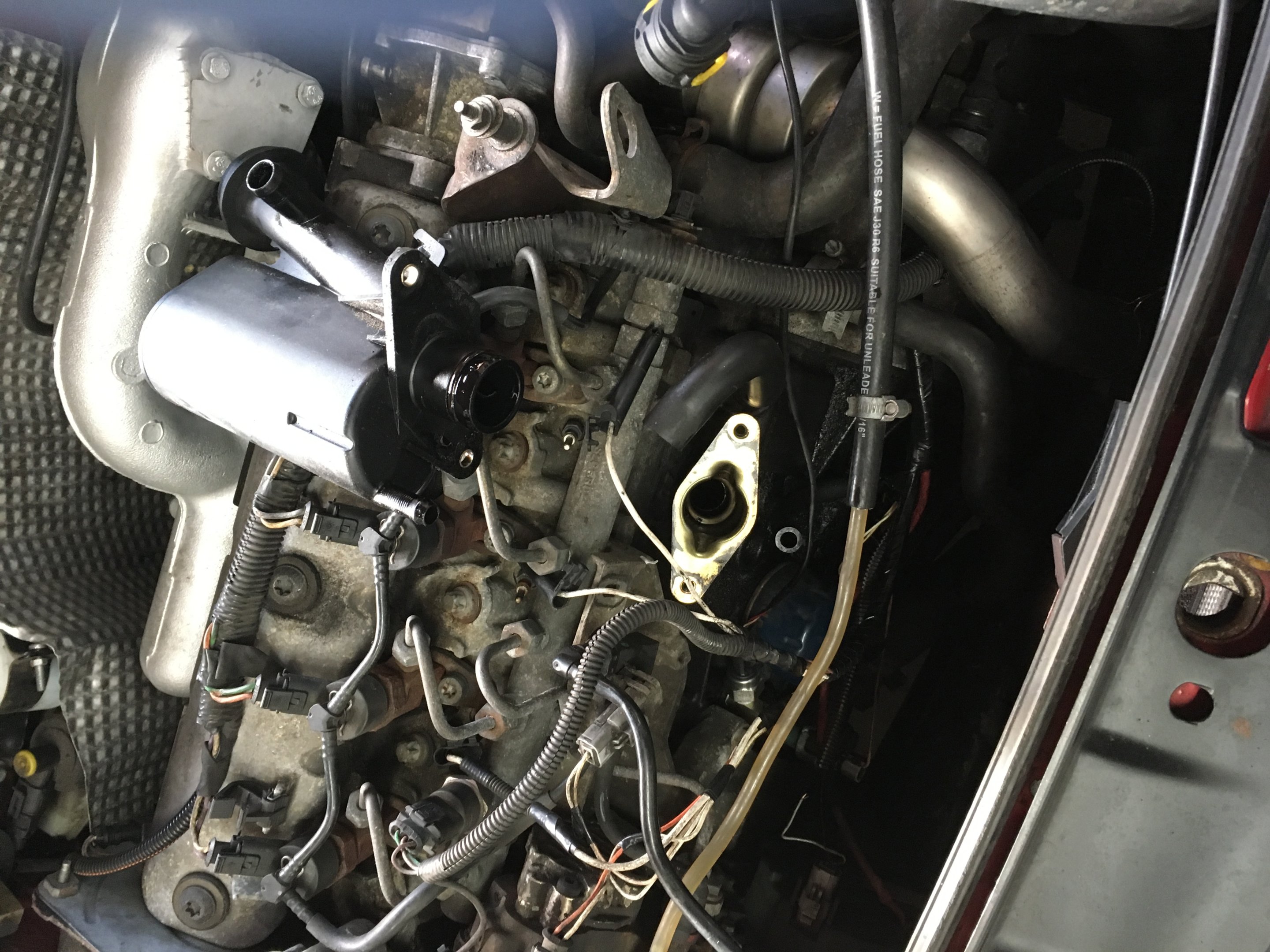

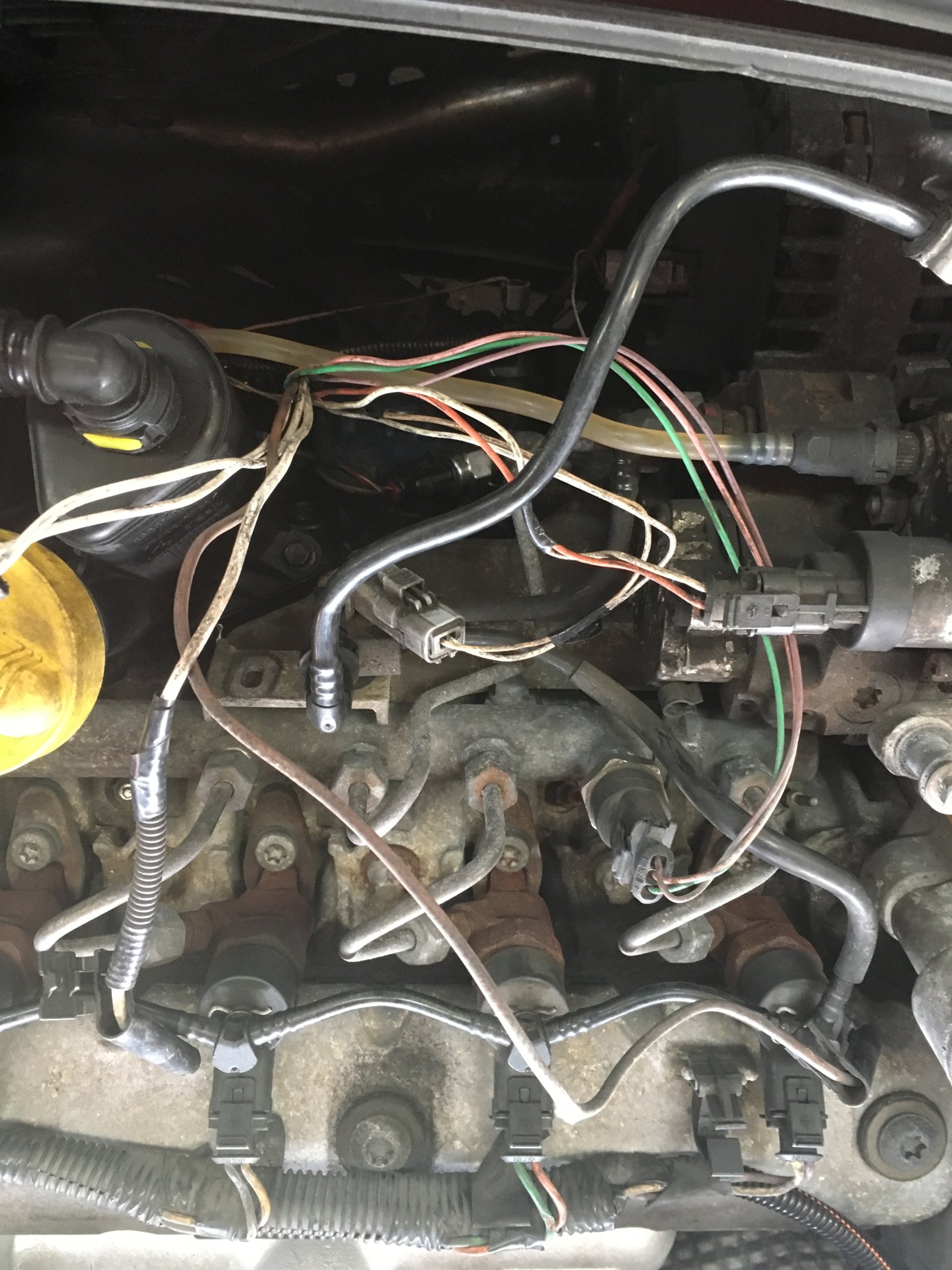

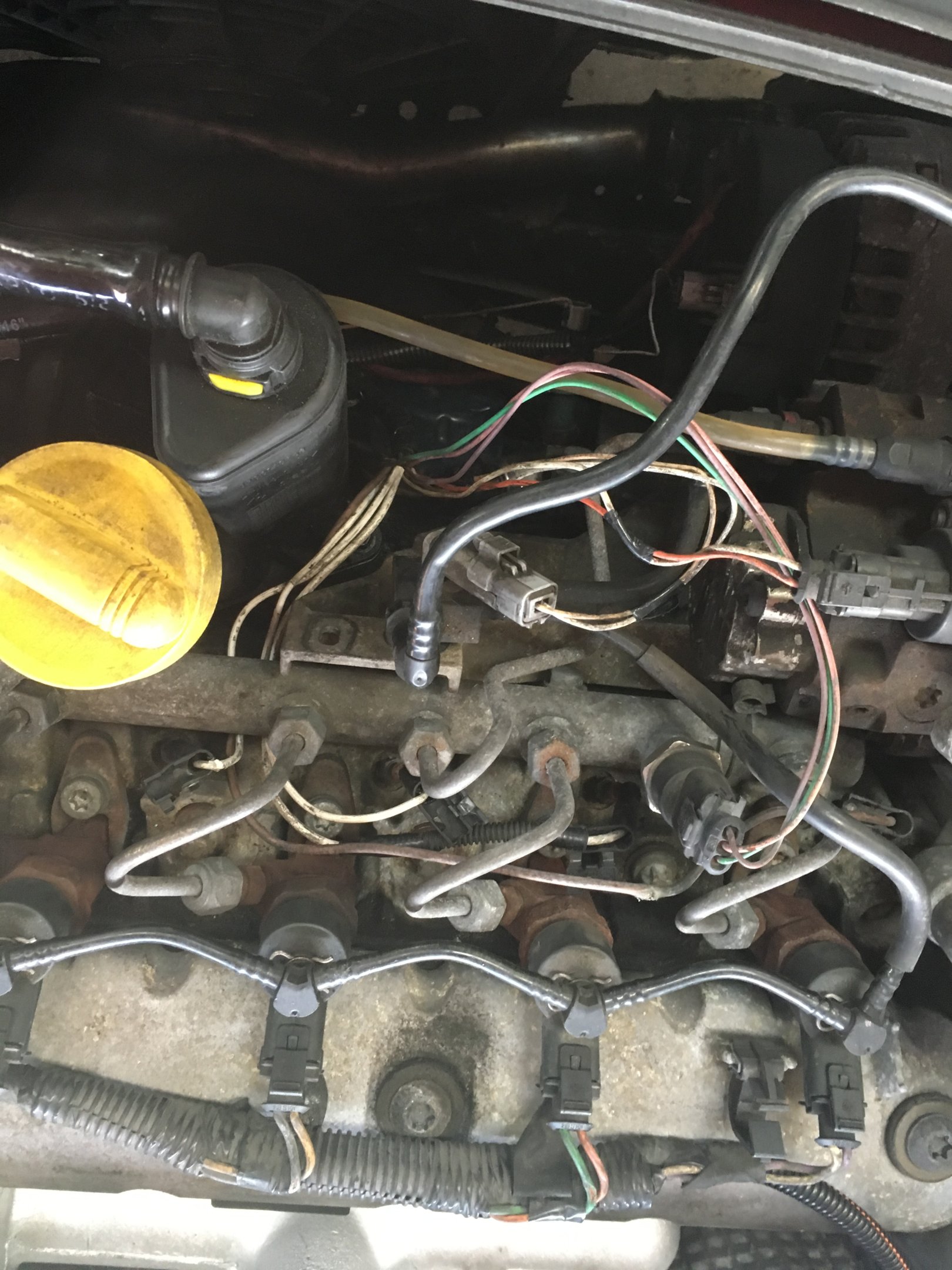

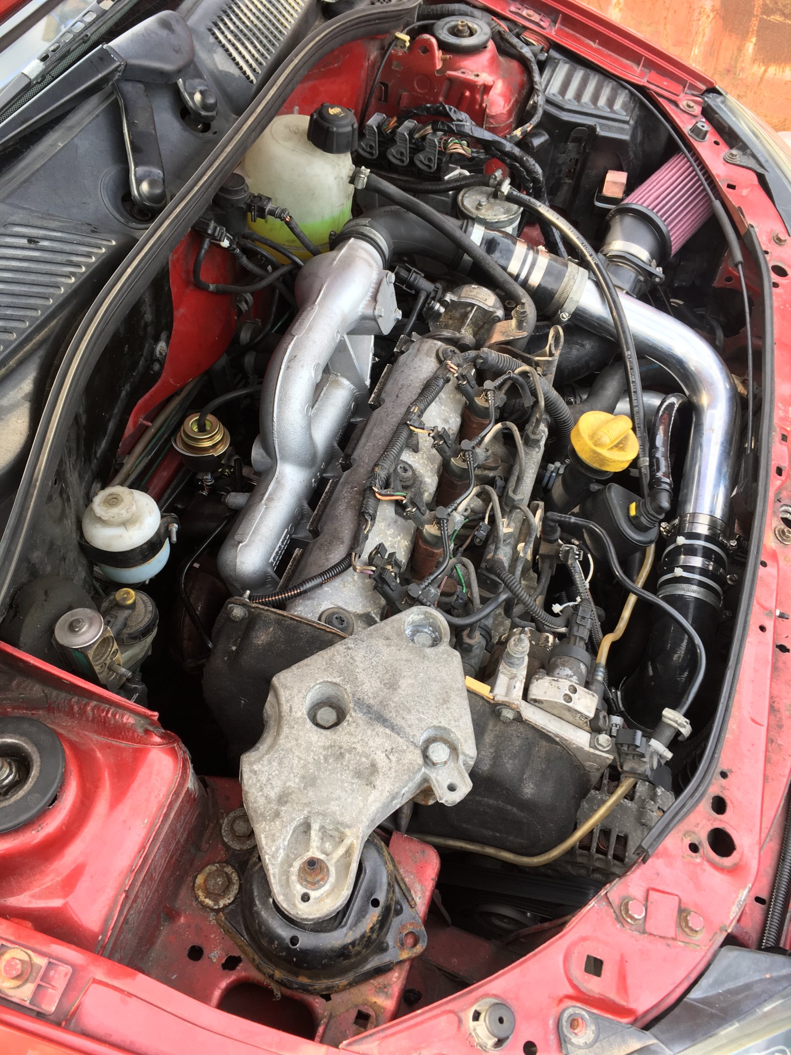

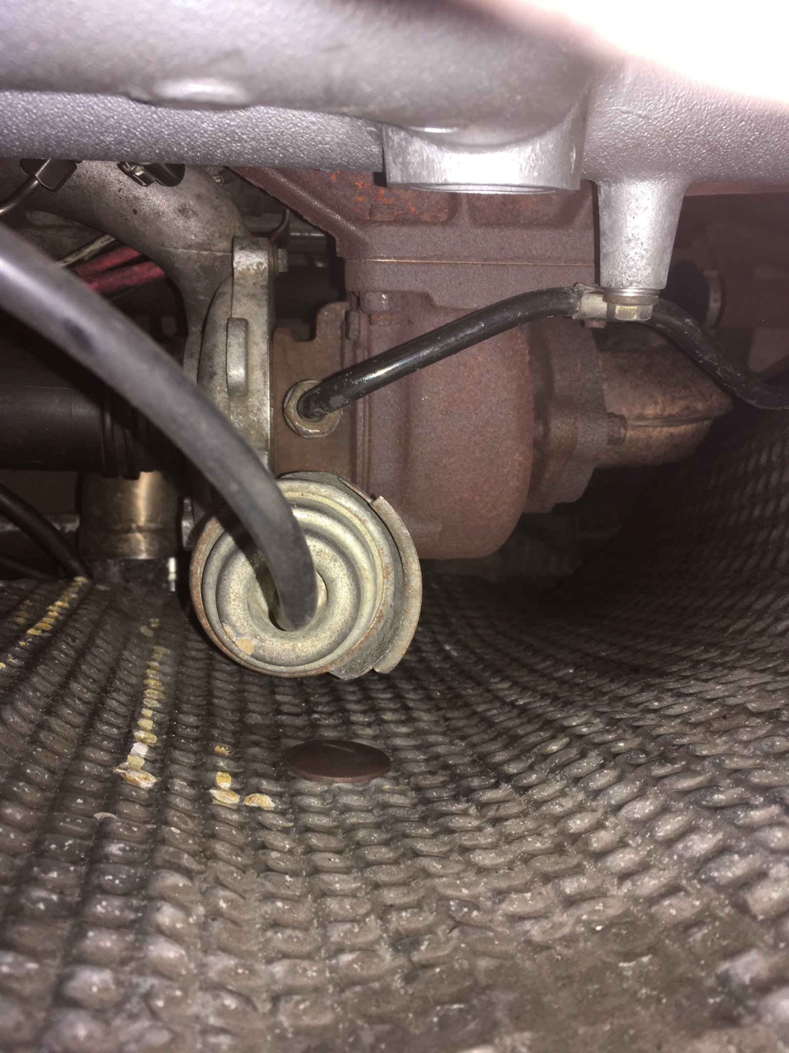

Well , found abit of time today to fix a few things , and start re routing engine loom to make a neater that factory job. Glow plug loom to run under fuel rail now rather than over, as shown in pics
Secondly fixed the annoying oil leak for the 3 time.... thought I'd fixed it before but it still weeps. So this time I've took the oil canister off , dissasembled the metal bracket from it and ' swelled ' the bottom of it to the point I've had to hammer it into the block. Low and behold no more leaks. Proper job that ;)
Now to order a s**t load of loom netting/ trunking, make a few brackets up for ecu / fuel swirl pot ect and fit a Nissan square coolant tank near the fuse box so I can run a better angle on boost pipes, new turbo is going to be a tight fit... and I mean TIGHT

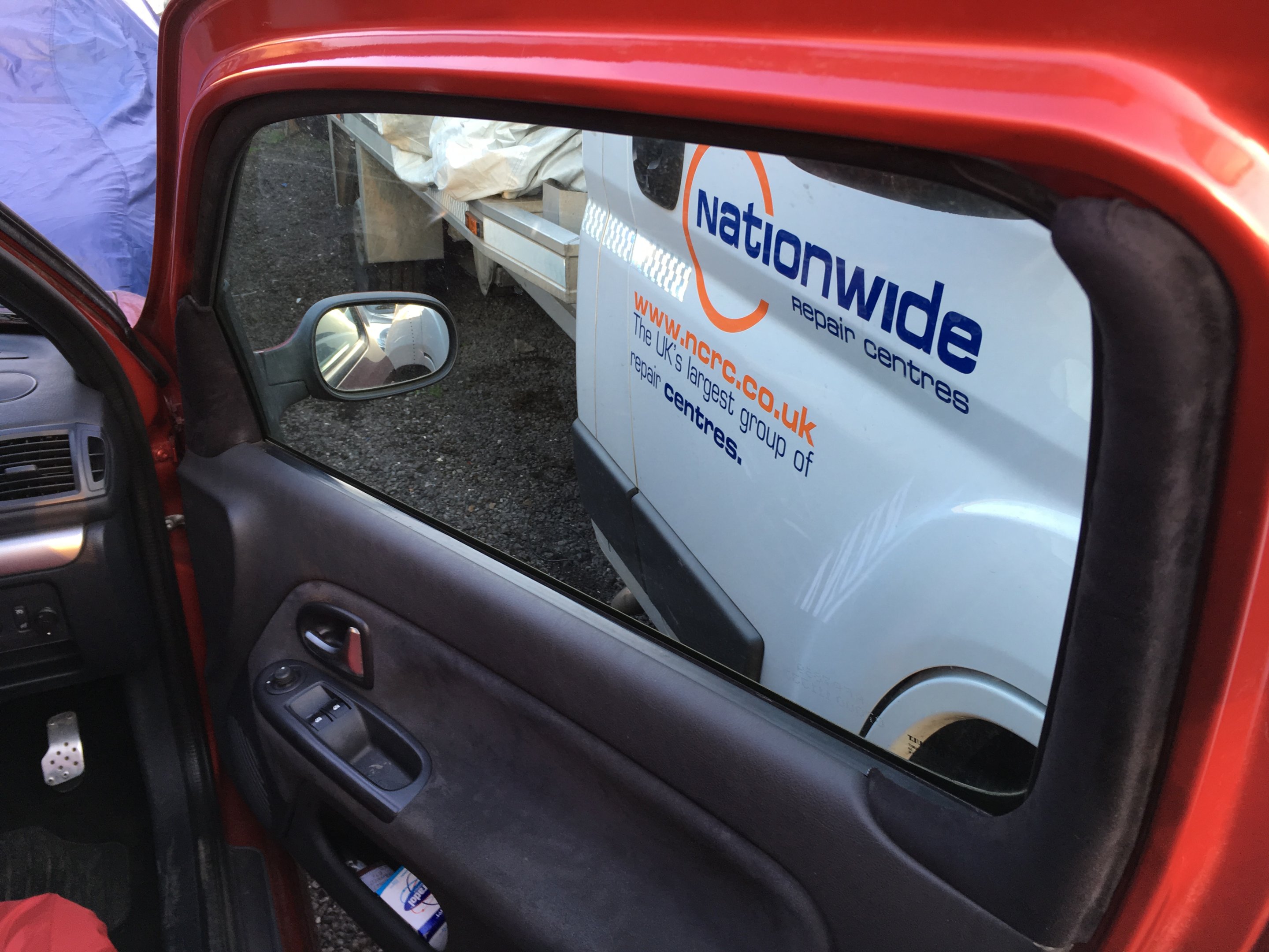

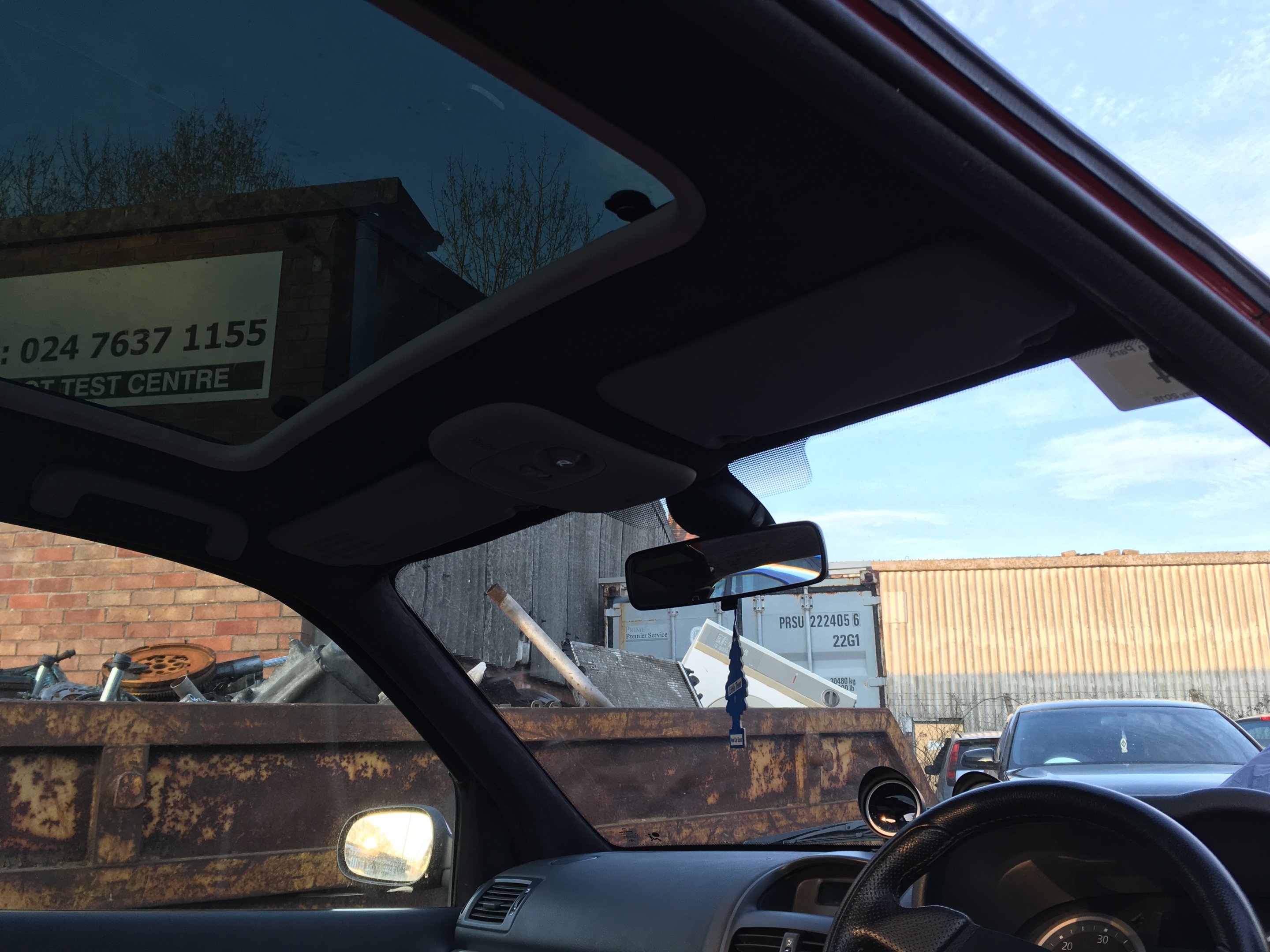

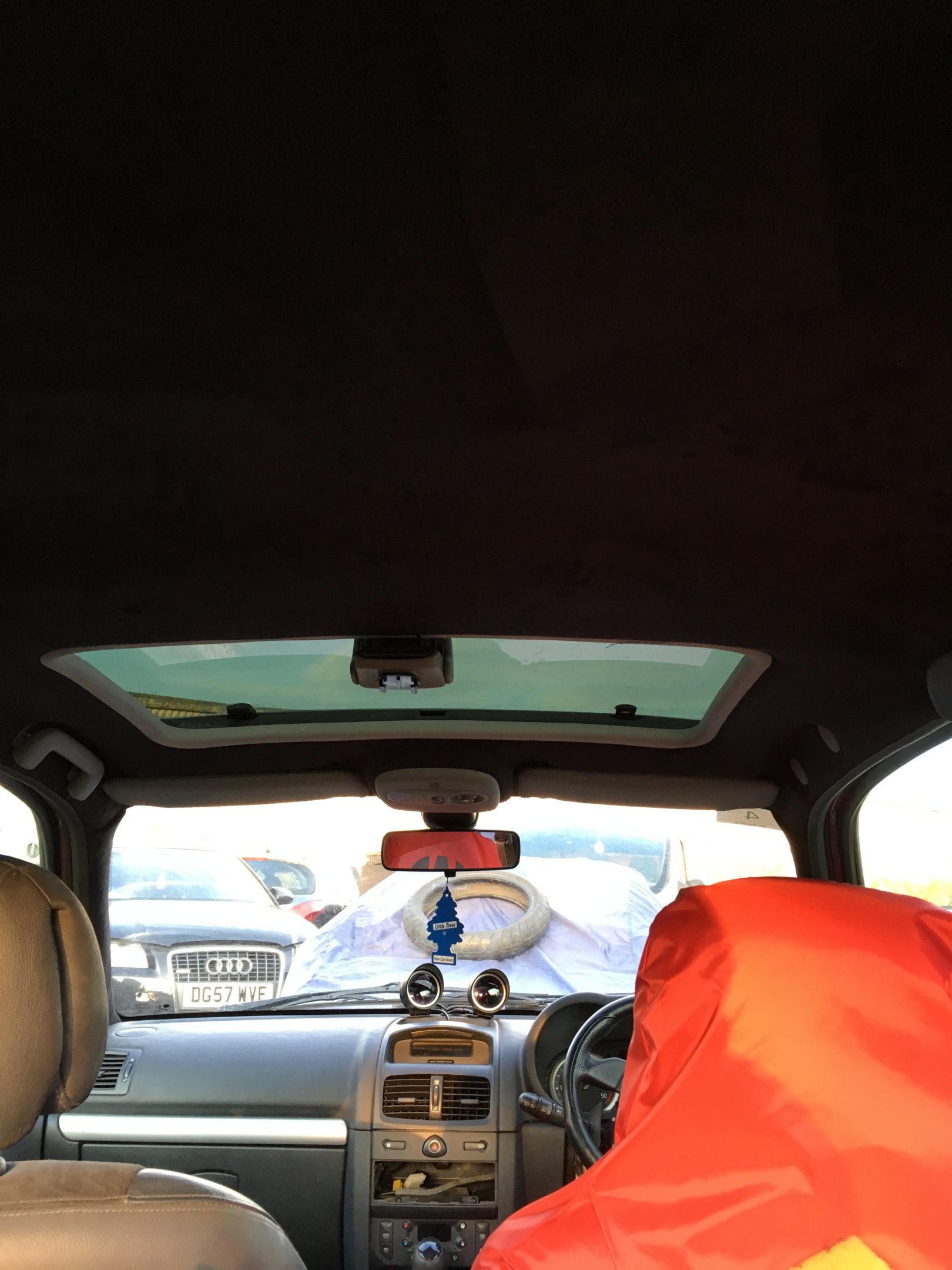

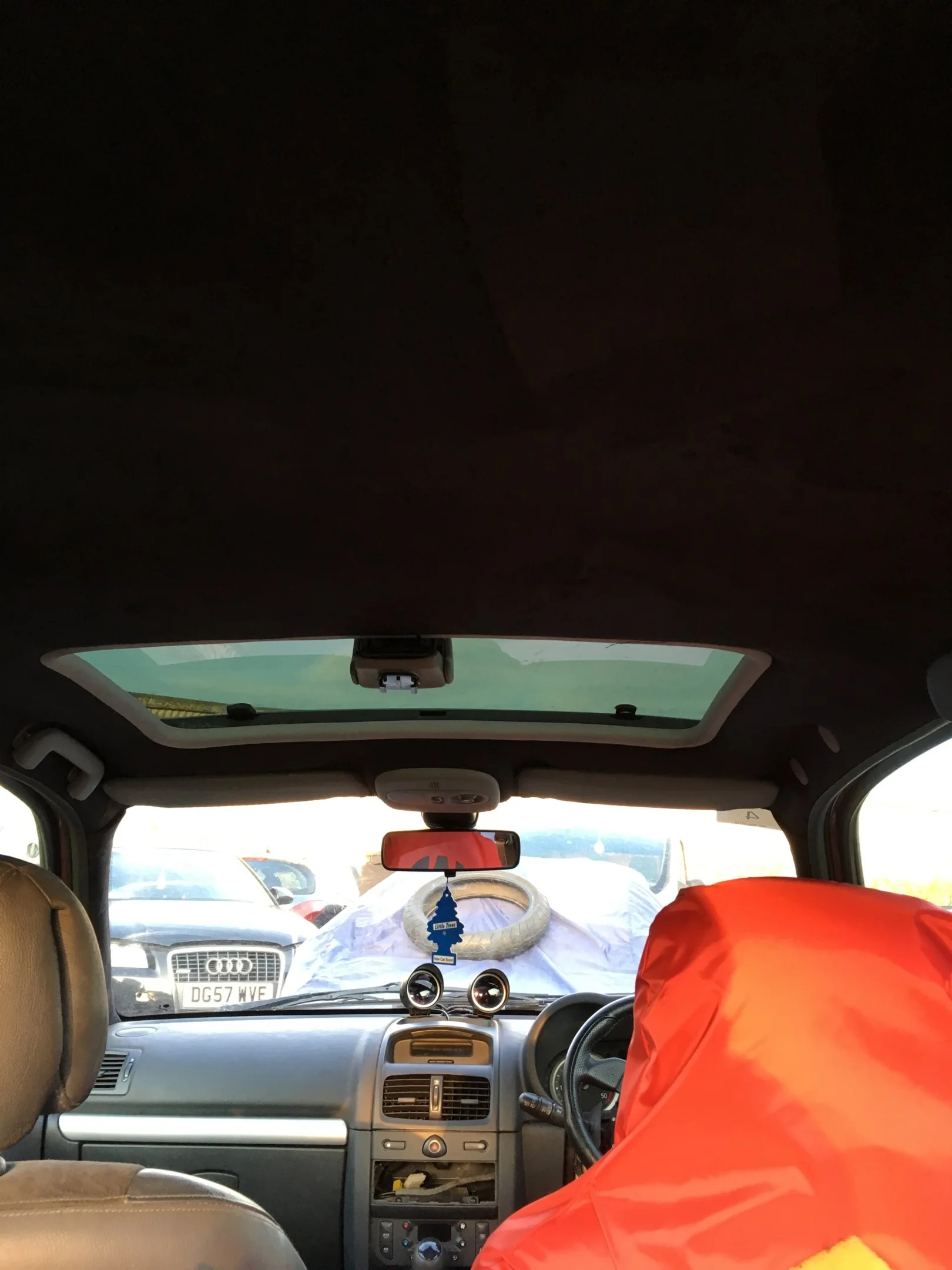

Firstly , re-sealed the sunroof and desided to redo the head liner in black faux suede aswell as the door trims. Will do for now until I deside what to do with the interior

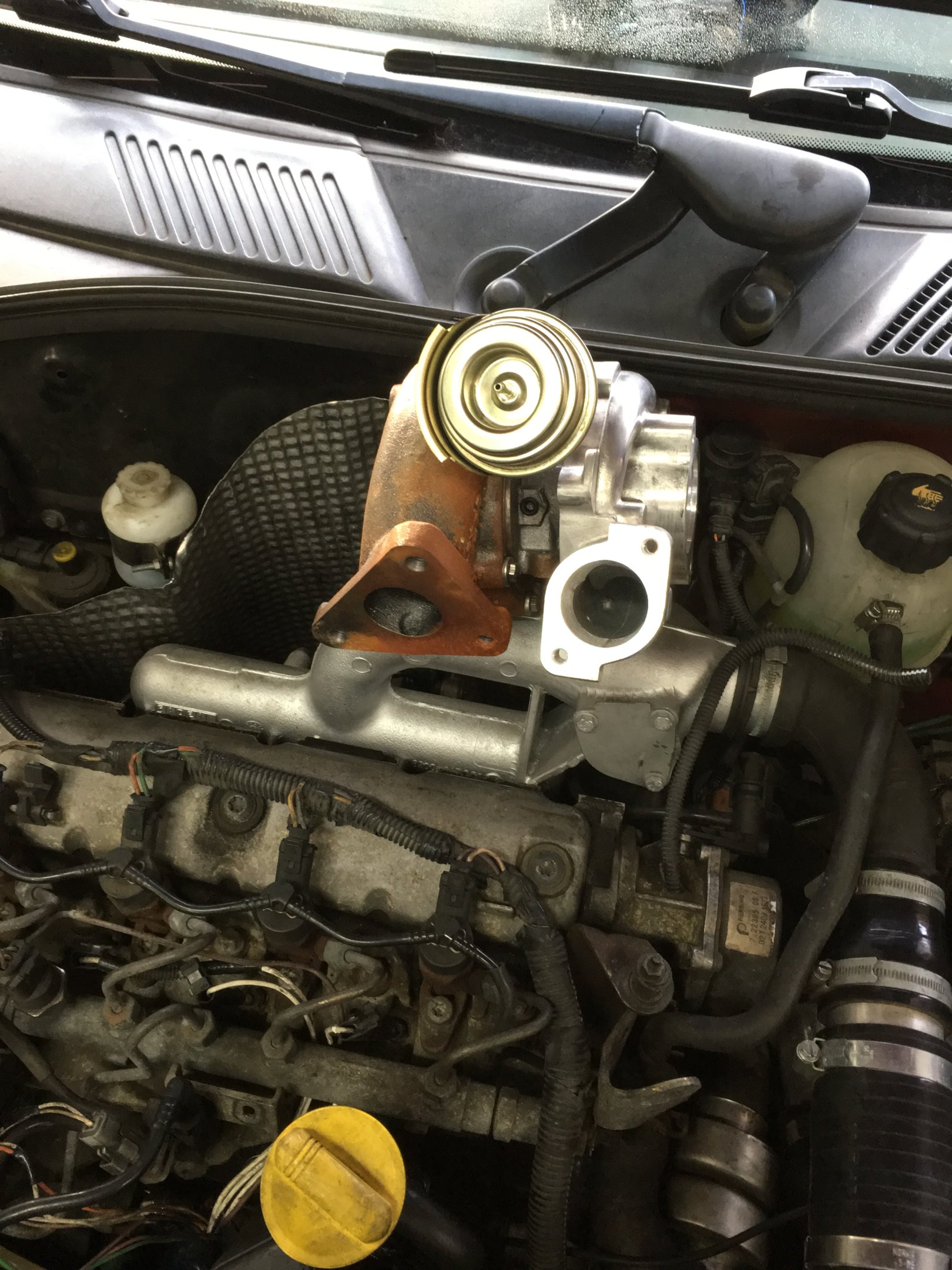

Then onto the engine , many lack of photos as I'm more of a ' get it done and don't take photos ' kind of guy ? Hybrid turbo , consisting of standard GT1749V cold side housing machines to fit a GT18/20 wheel from a golf. Hot side housIng was a standArd GT1852V setup with cutback fins to ' reduce ' the turbos efficiancy , basicly stopping boost creep / over boost with having zero restriction on the exhaust. This was coupled with a 2.25inch boost pipe system, stI'll need to maschine the last pipe to fit to the inlet.

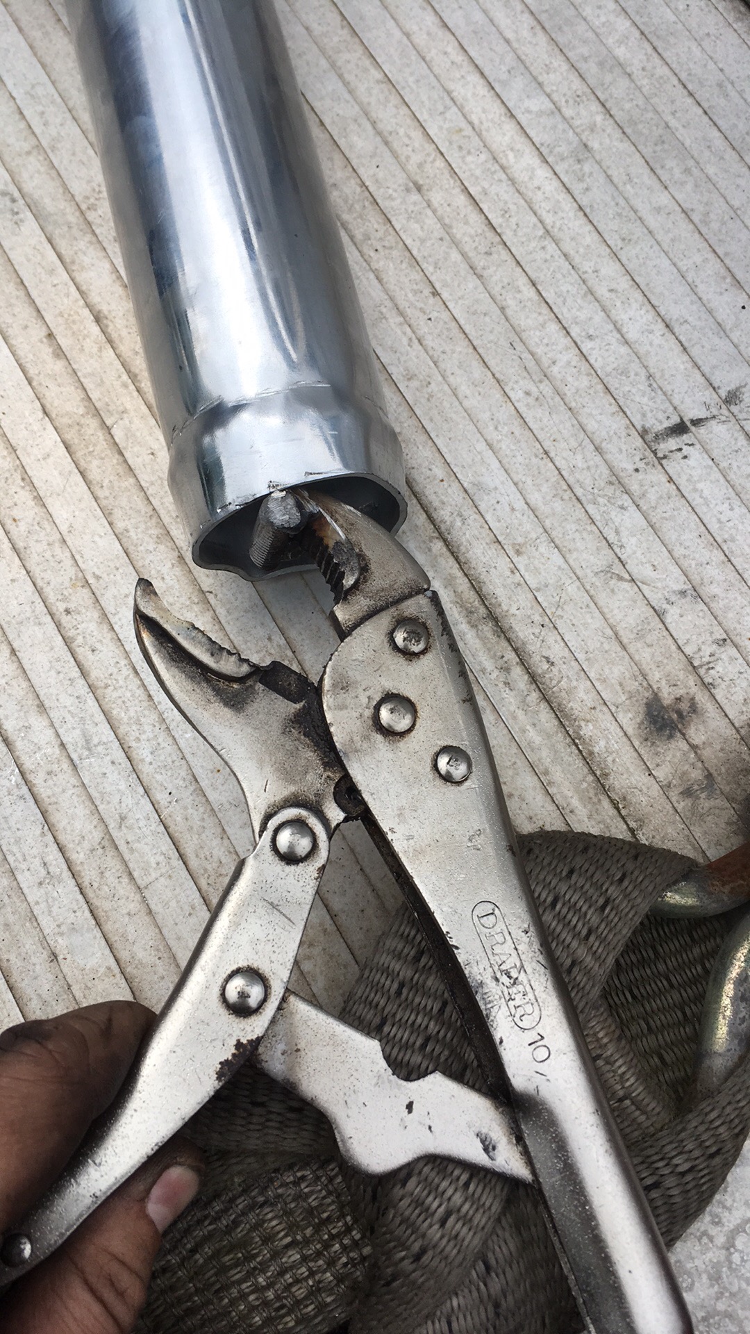

Boost pipes also didn't come with a lip for keeping the hoses on so I modified badly a set of grips to do a lip, looks s**t but works.
