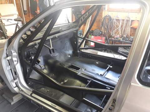

Project Lightweight, Trackday Clio 172
Interior is painted. ?

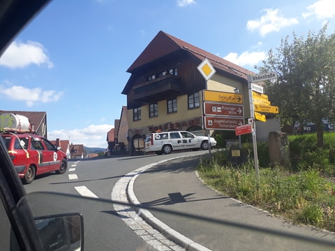

Last monday, it was time to start with the Scrapmetalrally.
We didn't know this when we entered this, but the start was just 2,3 km's from my home. :ROFLMAO:

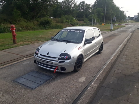

The first day was from Zwartemeer Netherlands to Fulda Germany. We drove on the highway, to cover some distance, but also on very narrow roads like this.

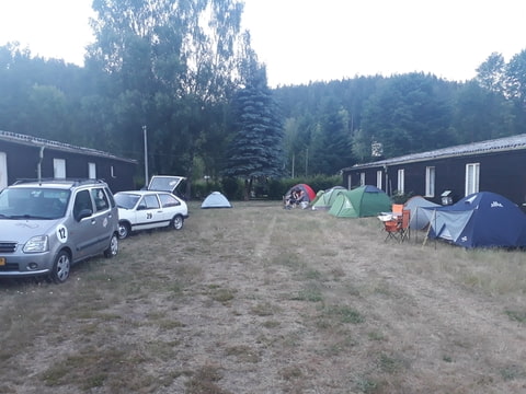

At the end of the day, we got to a campsite which was occupied, so we had to go somewhere else. We arrived at something which must haven been a Stassi trainingscamp in the past or something like that.
We put our tents up in between the very old barracks.

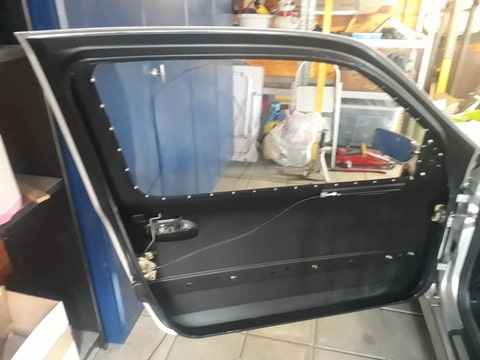

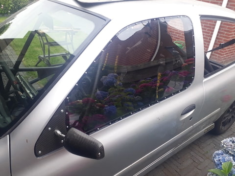

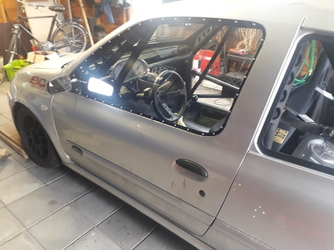

@scullyg40 I'll be watching with interest as to how much you save from the doors by gutting them and going poly/lexan windows.

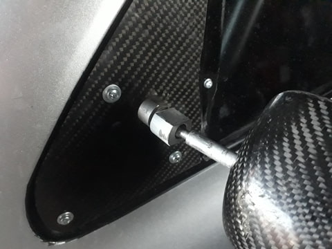

@scotiamr2t It's been a while, but I've got the first one done. I've gutted the inside, fitted polycarbonate window and fitted the carbon mirrors.
Starting weight of the door was 25 kg's. The bare door, gutted, weighs 9,8 kg's. So by going to fibreglass doors, there's still about 5 kg's to save, but at the cost, it's not worth it for me. Standard glass weighs 3,5 kg's, polycarbonate 3 mm one, weighs 1,5 kg's.
Total weight of the new door is 12,6 kg's. Saving 12,4 kg's, and that's just one door. :cool: Total weight savings 163,7 kg's.

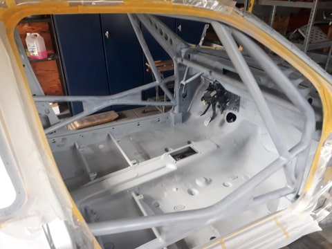

Well, the cage build is done. I spend a lot of hours to get this done, but I am quite pleased with the result, to say the least.
Now that I'm done, it's time to make up the numbers. Offcourse I weighed everything, and although I added nearly 75 kg's of steel, the car has only gained 12 kg's in weight. Very happy with that. And I have still to fit the polycarbonate rear screen, which will save me 5 kg's hopefully? And the lightweight battery, which will also save me another 10 kg's most likely.

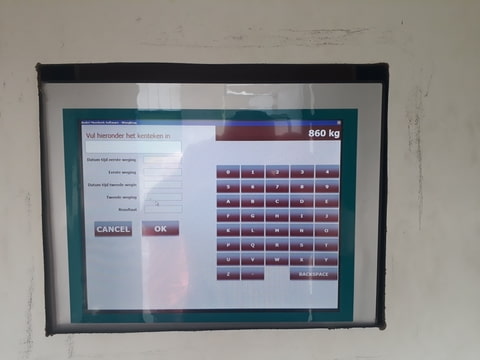

Apart from that, I also asked the logistic department at work if I was allowed to use their weighing bridge to finally get a number of the entire car.
The car weighs:
980 kg's with me and 20 litres of fuel
860 kg's without me, but with 20 litres of fuel. Fuel weighs 0,72 kg/dm3, resulting in 846 kg's for the car alone.
I also took the opportunity to see the weight over the front and the rear axle.
Front axle weight is: 640 kg's
Rear axle weight is: 340 kg's
This gives a front/rear weight distribution of 65/35.

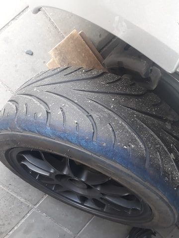

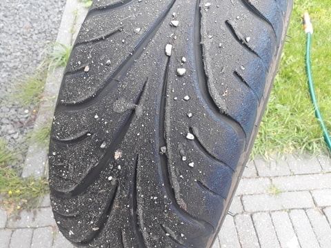

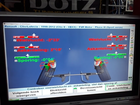

When I wanted to refresh my brake fluid, I noticed my tyre have excessive wear on the outsides, and they are colored blue.
What does this mean? And how do I solve it?
Do I need to change my tracking? Currently it's like this.
The top one is camber, then caster, then toe.
Hot tyre pressure after each session is checked, and is regulated at 30 psi.
I've noticed that a lot of heat is created with the tyres/brakes after each session. I also feel, that I lack grip coming out of the slower corners. I've always put this down to the low weight of the car, but hopefully someone here can shed a light on the tracking if that might be the case.
I'm thinking I need more camber, but that will also effect my braking. Will more caster be advisable to give more camber just in the corners?

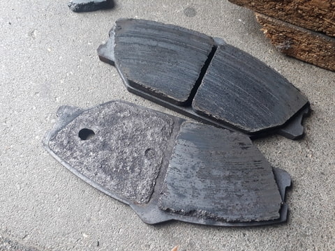

My left brake pad has crumbled. They are Carbon Lorraine RC5+ and I did my first trackday with them in march 2018. Since then I did about 8 to 10 trackdays I think, with an average of 4 to 5, 20 to 30 minute sessions. Is this normal that they gave up after this amount of track time?
Might it also be heat related that they have crumbled? Should I upgrade to RC6 or higher, or a different brand of brake pads?
See my reply to your other post about this but I'd say they've lasted well. I've just changed my RC6s after 3 races and a test day. 2 of the races were wet hence they have crumbled like yours. (worse than yours actually although they were still attached to the backing plate)

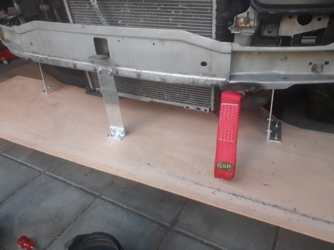

So instead, I made a start with this. :)
At the moment I am waiting for some aluminium to arrive to make the brackets.

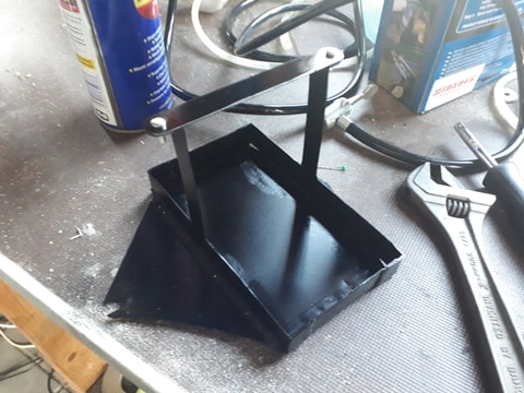

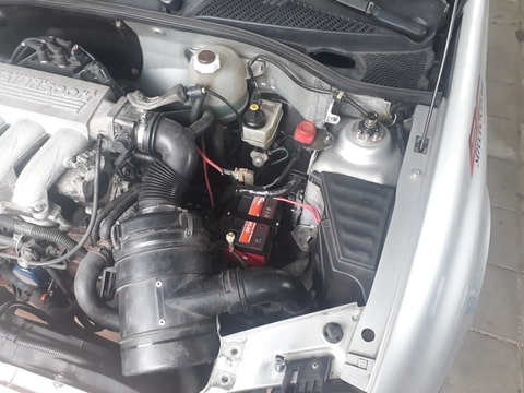

So I continued with my lightweight battery.
Made a battery tray for it.

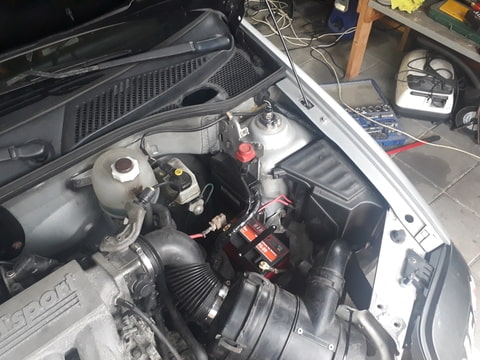

I relocated the ECU, to get better access to the brake fluid reservoir, and I placed the lightweight battery in the same position as the original one. This way, there is no need to modify the wires, and moving the battery to the back is pointless with the battery and battery tray weighing just 1,2 kg's.
Pretty happy with this, as it gives me more room in the engine bay, and saves me a ton of weight. Weight saving with this mod is a staggering 13 kg's, bringing the car weight down to 833 kg's. Unfortunately the splitter will add another 5 or 6 kg's.

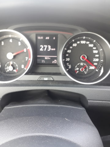

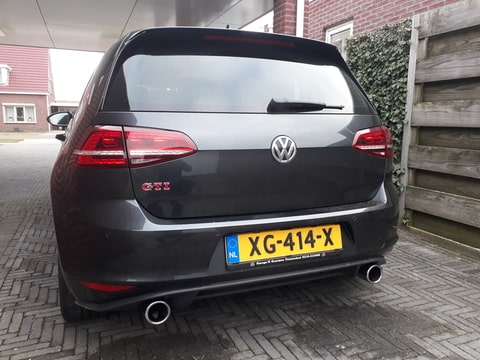

I did a top speed run on the German Autobahn with the Golf. Pretty sure theres a bit more in it, as I had to let go of the gas because I was closing in on some other traffic. But I'm happy with the pace of the Golf, also because it handles the speed so well. For the UK people on here, 273 km/h is about 170 miles an hour.

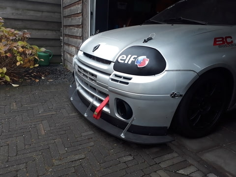

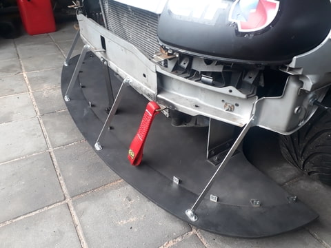

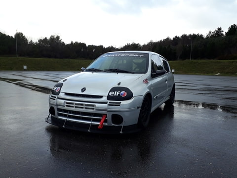

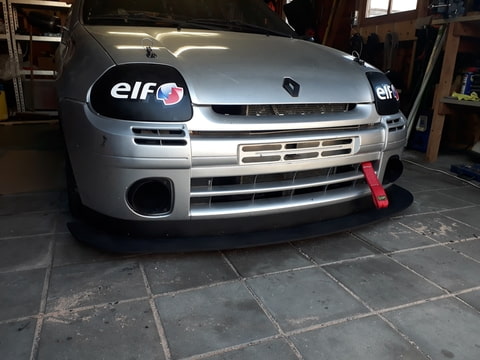

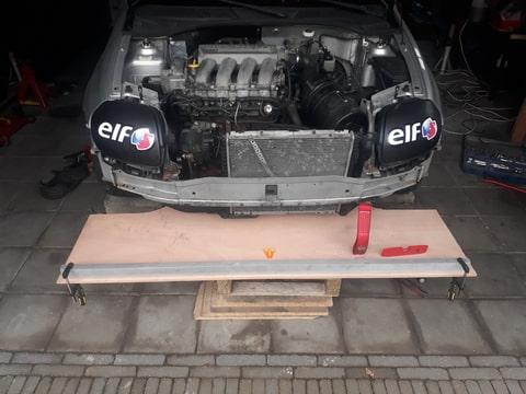

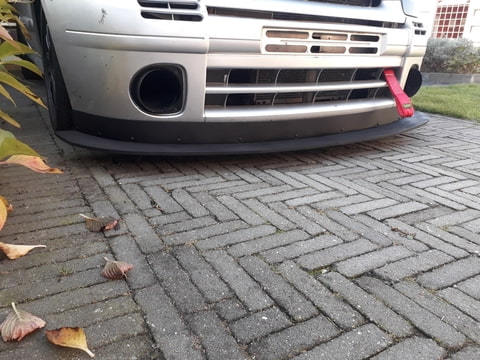

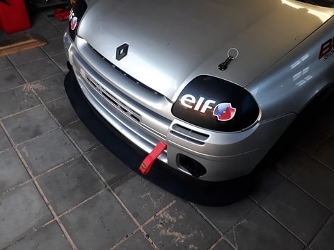

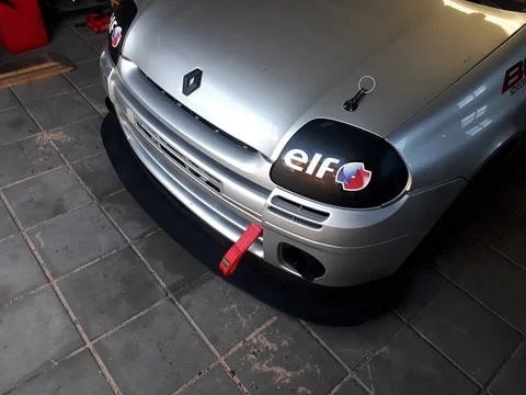

I also got the splitter finished. Very excited about this, can't wait to see what this does on track. :cool::cool:
It's mounted in 5 points, 3 in the front, and 2 between the wheels. It still flexes a bit on the front, I'll see how it goes, and if necessary I will add splitter rods or something to hold the front in place more.
It sits 5,5 cm's from the ground, and extends 10 cm's from the air dam, and it goes through underneath the engine, almost to the steering rack. If this isn't functional as a splitter, than I'm lost. If I can't feel a noticable difference, I will remove it and tell everybody aero mods suck. 😁
It weighs 6,2 kg's, which is quite a bit less than my lightweight battery mod, so I didn't add any weight with this basically. Car weight now at 839 kg's. I'm also working on the rear window at the moment which should save 4 or 5 kg's. After that, I think I'm pretty much done with the weight saving programm, and I will probably focus more on the handling, which is when it will get expensive I suppose. 😆

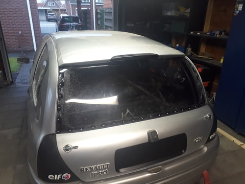

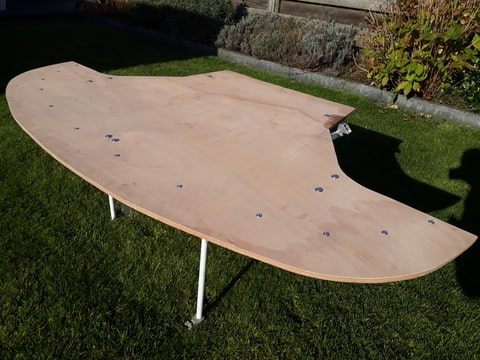

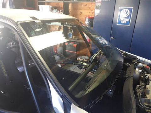

First I need to update on my bootlid, I've made the polycarbonate rear window.
It didn't work out as nice as I wanted it to, because of the curves in the bootlid, I couldn't get the polycarbonate to sit completely flat at the sides. But it did save me a lot of weight. 3.8 kg's to be exact, bringing car weight back down to 835 kg's. As said before, this is probably as light as the car will be, as I don't see any real weight savings anymore, but time will tell.

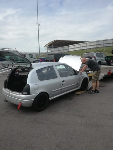

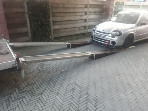

To get the car to a trackday in the first place, I need to get in on and off the trailer. This wasn't possible anymore as to how I did it before, because of the splitter. So I did some calculations involving sinus and cosinus etc to see how the ramps needed to be. And this is the result, and I'm happy to say it works, with 1 or 2 cm's to spare. :)

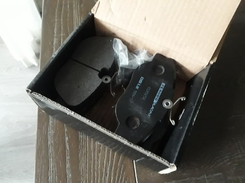

Then onto the trackday. First session was a wet one, and I needed to bed my new brake pads in so easy on the brakes. Ferodo instructions say you need to brake 25 to 30 times with about 50% braking power and for 4 second periods.

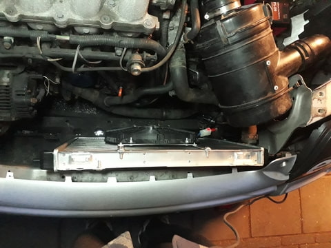

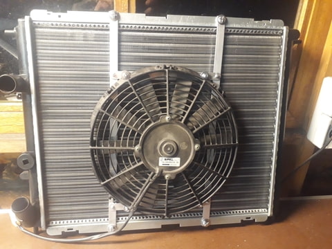

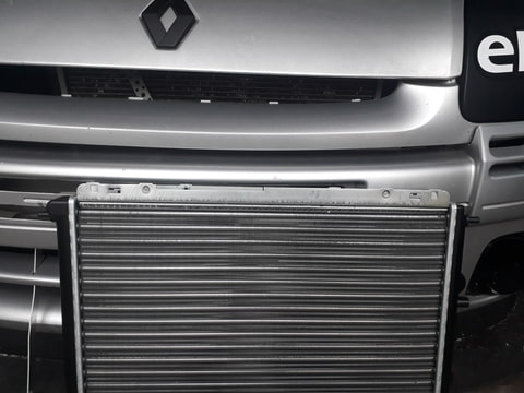

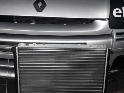

As I had a puddle of water beneath the radiator, it seemed a good idea to change the radiator. As I had a Spal fan laying in my garage it seems a good idea to mount that at the same time.
Because a radiator has a pretty hard time on a track car, I bought the cheapest I could find. Immediately I noticed a difference, namely that the fins on the new one are much thicker, and fewer, as can be seen here.
Other than that, the fitment is good, but I'm not really sure if, and how this will affect cooling capacity.
To mount the Spal fan, I had to make a bracket.
Then it was time to mount it all back.
I've saved another 700 grams, but I've gained enormous in space, so that my big sausage fingers can reach the butterfly plug on the gearbox. Checking oil level, and changing the oil filter is also very easy now.

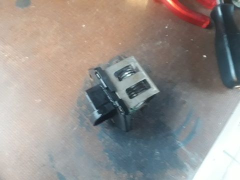

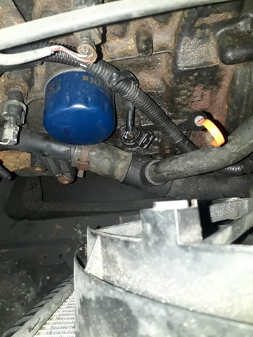

One question though. Who can tell me which sensor this is?
It's mounted behind the original radiator, I guess it's the air temperature sensor? I've just cable tied it for now.

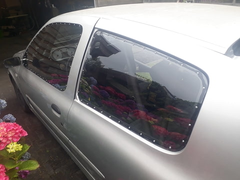

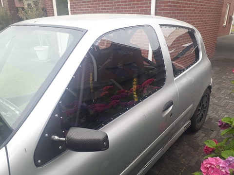

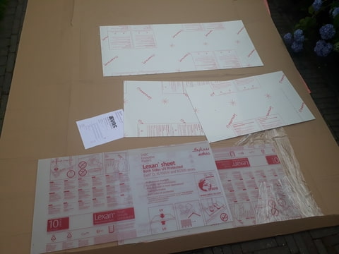

How much polycarb did you get mate. I'm going to do the same.
I had to look it up, but here it is.
1 plate 1230x560 mm
2 plates 800x470 mm
2 plates 1000x500 mm
The windows on the side turned out okay, but the rear window doesn't look to pretty if you are bothered about that. There's to many curves in the bootlid.

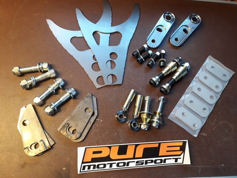

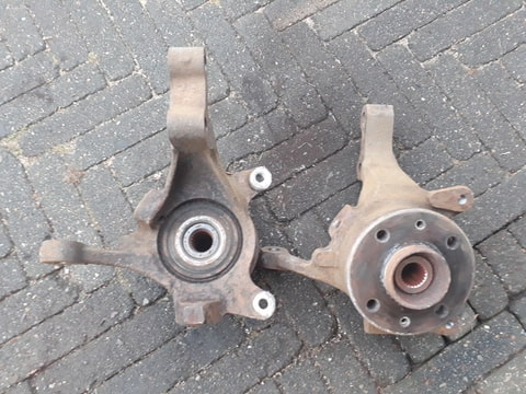

@scullyg40 Whats your plan with the laguna/cup racer hubs? I got a pair recently but its the coilover that is the problem, either find some original ones or get your ones custom mounts
For now, my plans are to go for the PMS Roll Center Correction kit, as to my opinion, it's just the best option around, because part of the roll center correction and bump steer correction is already in the Laguna hub itself. A bit of track width gain is also welcome, and the bump steer is adjustable. But that being said, if I do come across a nice set of @NorthloopCup I will buy those as well, but my budget doesn't allow that earlier than next year I suppose. :rolleyes::sneaky:
I've got BC Racing coilovers, so they are not a problem to customize, as the strut and the coilover are separate items. So it is easy to modify the BC racing strut to the 65 mm of the Laguna hubs with the PMS plates.

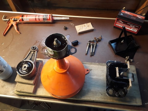

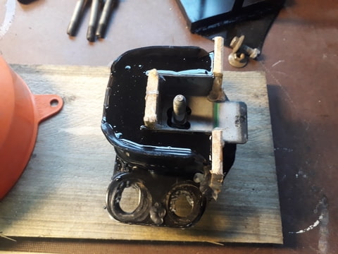

Because my car jumped out of gear 2 times at the last trackday, I thought it was about time to beef up my engine mounts. I have to add, it happened just 2 times, in the same braking zone, which was bumpy, and it was wet, so my ABS got activated as well.

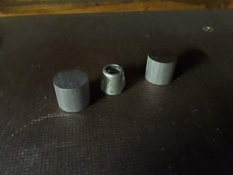

Since I'm to cheap to spend a fortune on some Vibratechnics, let alone the PMS engine mounts, I looked at alternatives, which I found, thanks to this thread:
Getting everything sealed up was a bit of an issue, glad I tested it with water first, but I managed to get it al sealed. Mixed the 2 components together, and poured it into the mounts.
Let's see how this goes. Engine movement is eliminated for sure, but vibration is present to say the least. :ROFLMAO:

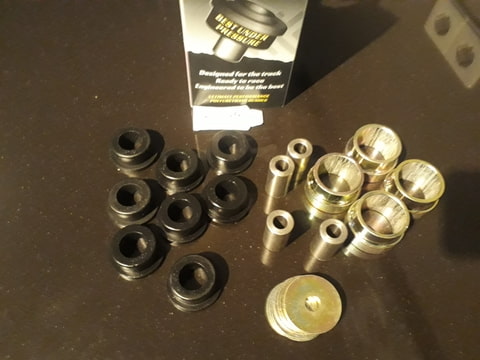

I ordered 2 packages, and the first one, my Powerflex black wishbone bushes, arrived. I can't wait to get the second package, as it contains some really cool stuff :cool::p Not gonna say what, but it has to do with the first package. :giggle:

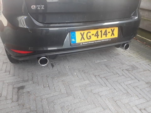

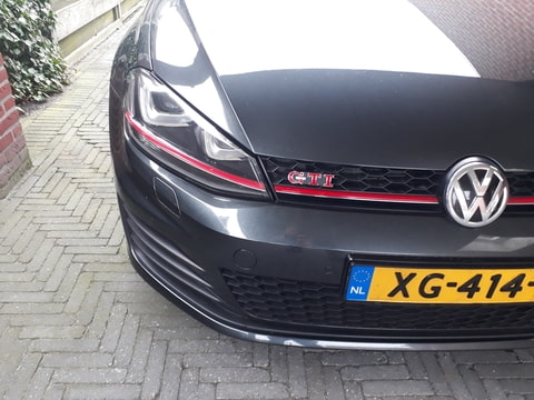

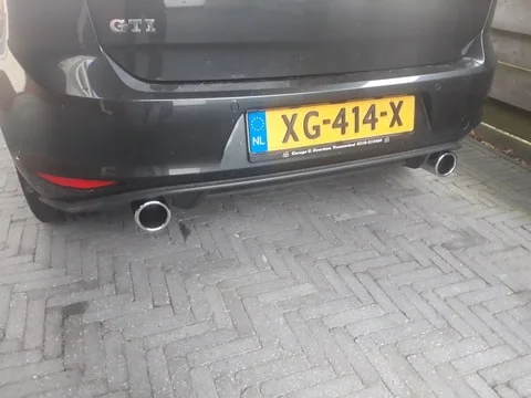

I also did a small upgrade to the GTI. Normally, I'm to much of a purist to mess with the badges, but I felt since the car has 300 hp, and Clubsport brakes, it is allowed to wear a performance badge. But I did it because I think it matches much better with the red line in the front, and the red badges on the side and contrast nice on the dark grey body.
