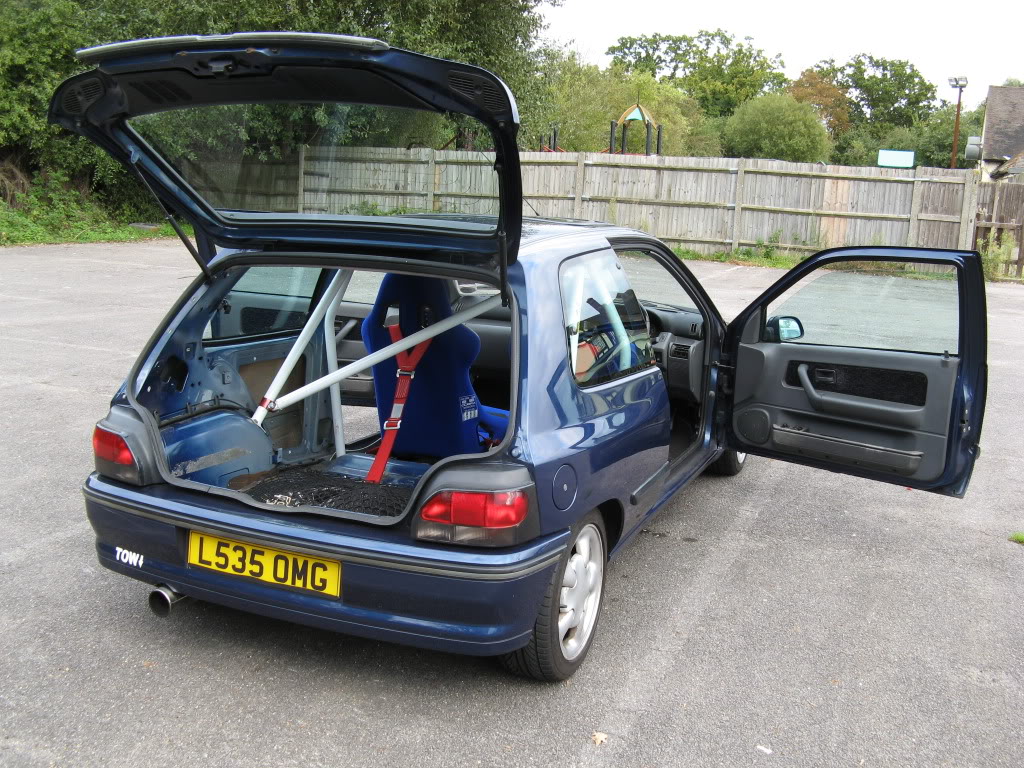

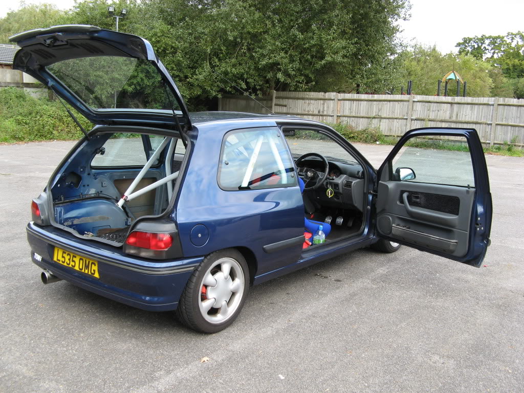

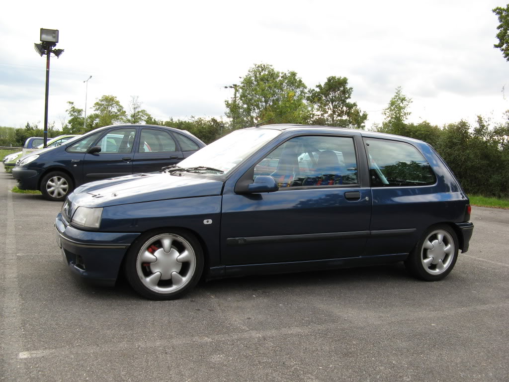

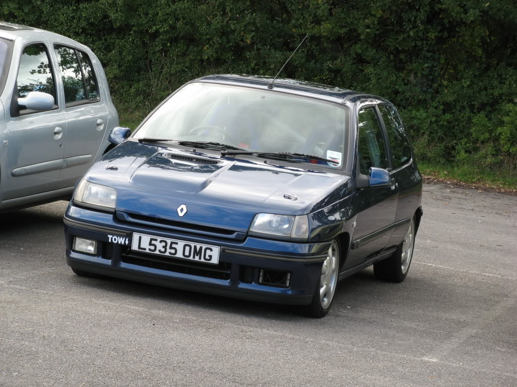

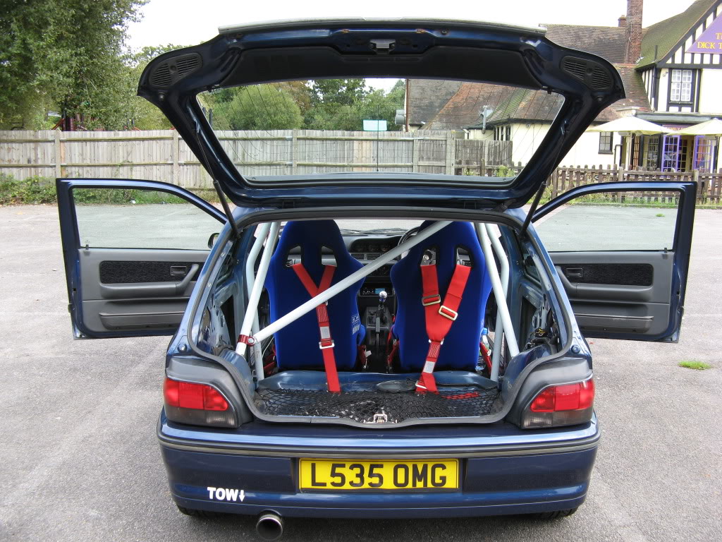

pic of the car as i bought it!
it was more or less standard,
slightly lowered,
K&N filter,
decat and mongoose exhaust
lighten flywheel.
metal monkey dials

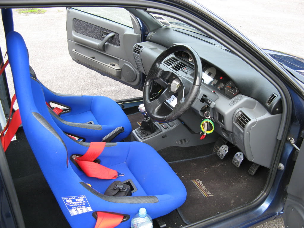

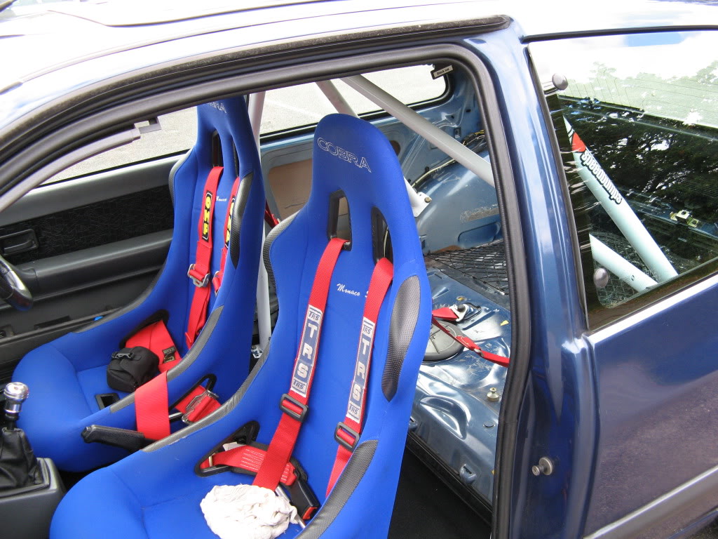

In the meantime, i began to strip the car out! i had kept the seats from my old clio, so they went in, and i picked up a halfcage from a lad on clio16valver, aswell as a new sunroof motor as the old one had packed up letting it leak!! (which i also found out the hard way). also threw the areal from my old clio on as this one had been snapped off.

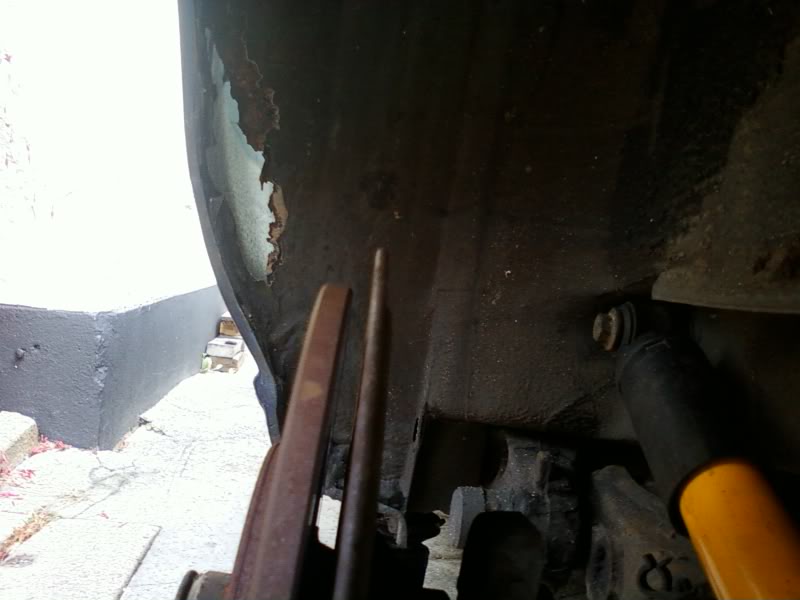

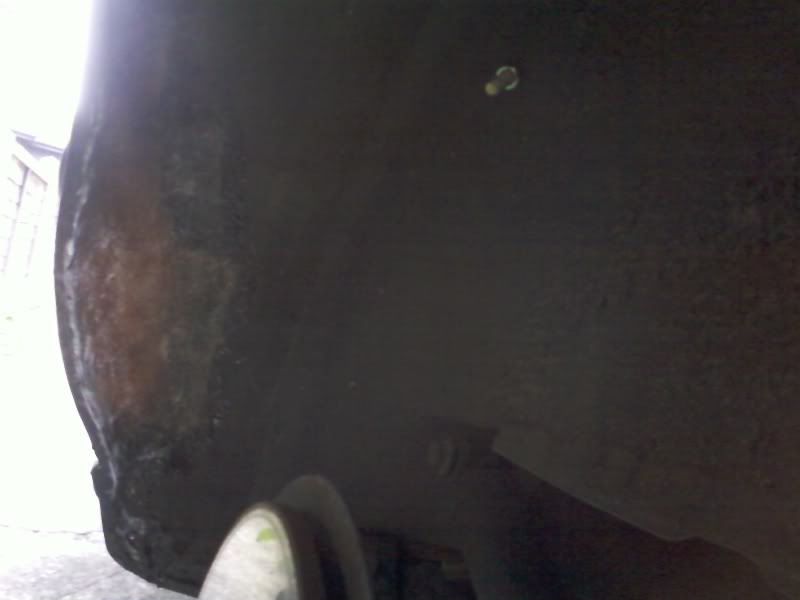

While she was off the road, i set about sorting the massive rust hole that stripping it had uncovered. i grinded it back to bare metal, painted it with rust stopper, and fiberglassed over the hole. Not permanent, but i intend to have the arch replaced at somepoint.
Hole:
Fiberglass
after this i painted it very thick with hammerite paint. i know its not the best job ever, but its not really bodywork so meh. its held very well so far!

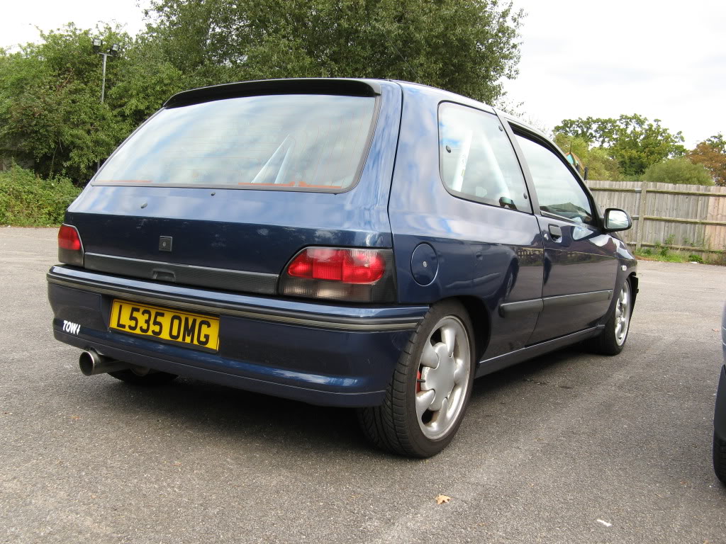

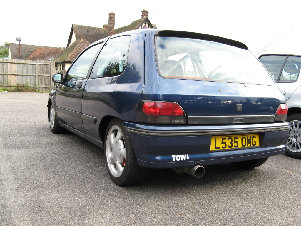

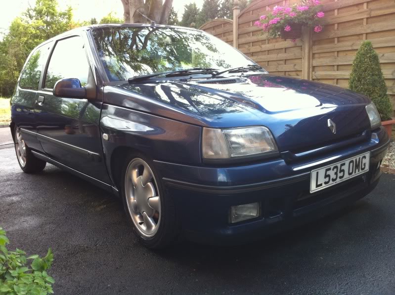

How she stands now

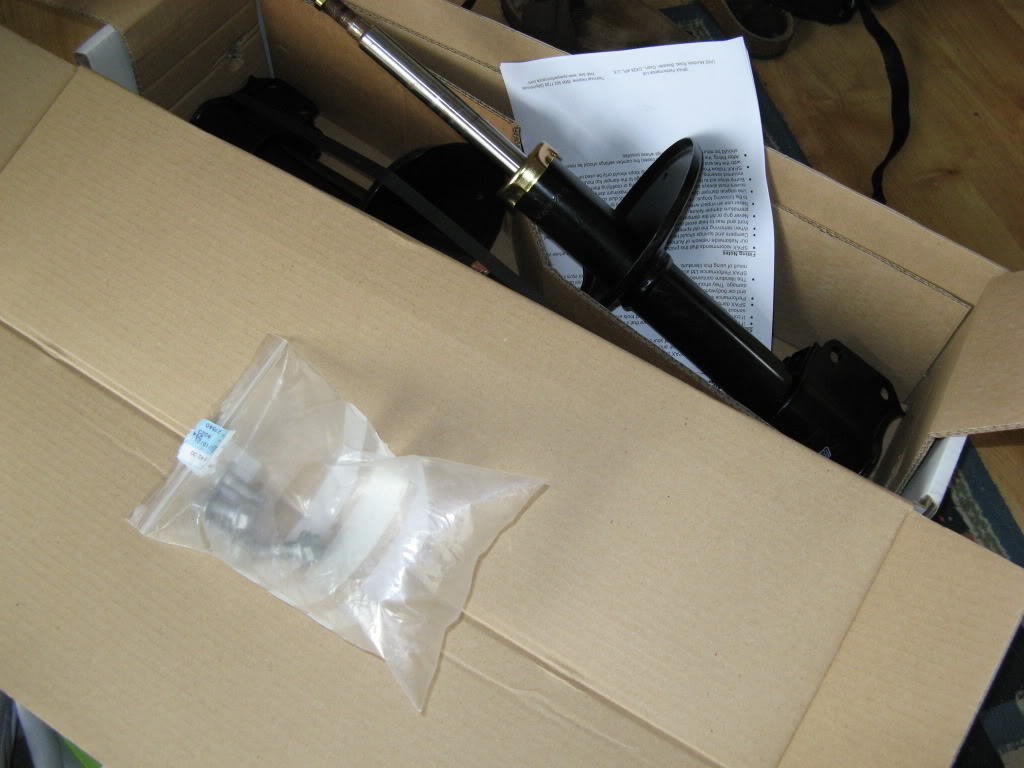

got up really shocked to see the postman outside clutching a big box with spax on the side!!
(i only ordered them wednesday eve)

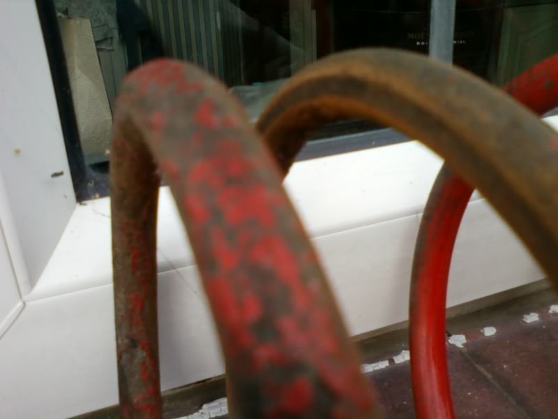

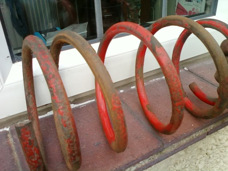

i carried on with what i was doing, and removed the springs,
i cleaned it up a bit and took a picture!!
should i replace these springs?? im not sure what condition you can let them get to before performance will suffer!

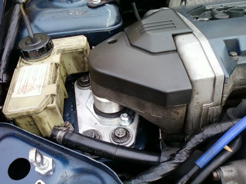

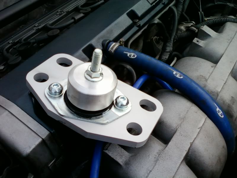

after this i got to work on my engine mount.
very easy job and after half an hour or so, it was in!!

after putting it all back together, she feel great, much stiffer and the engine doesnt have much movement at all!!
Unfortunatley, i think the upper gearbox mount might also be on its last legs :mad:
it does let a bit of movement through so now the engine moves very lop sided!
but thats a job for another day!

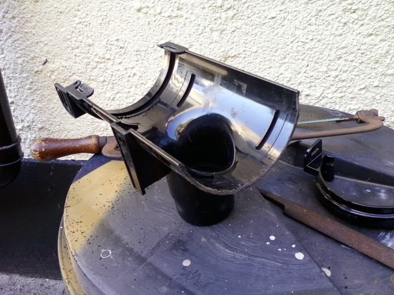

followed foxys guide and purchased this! from b&q
yes a nice piece of guttering!
i then hacked it down as a trumpet for my cold air feed!!
pickey mods FTW!

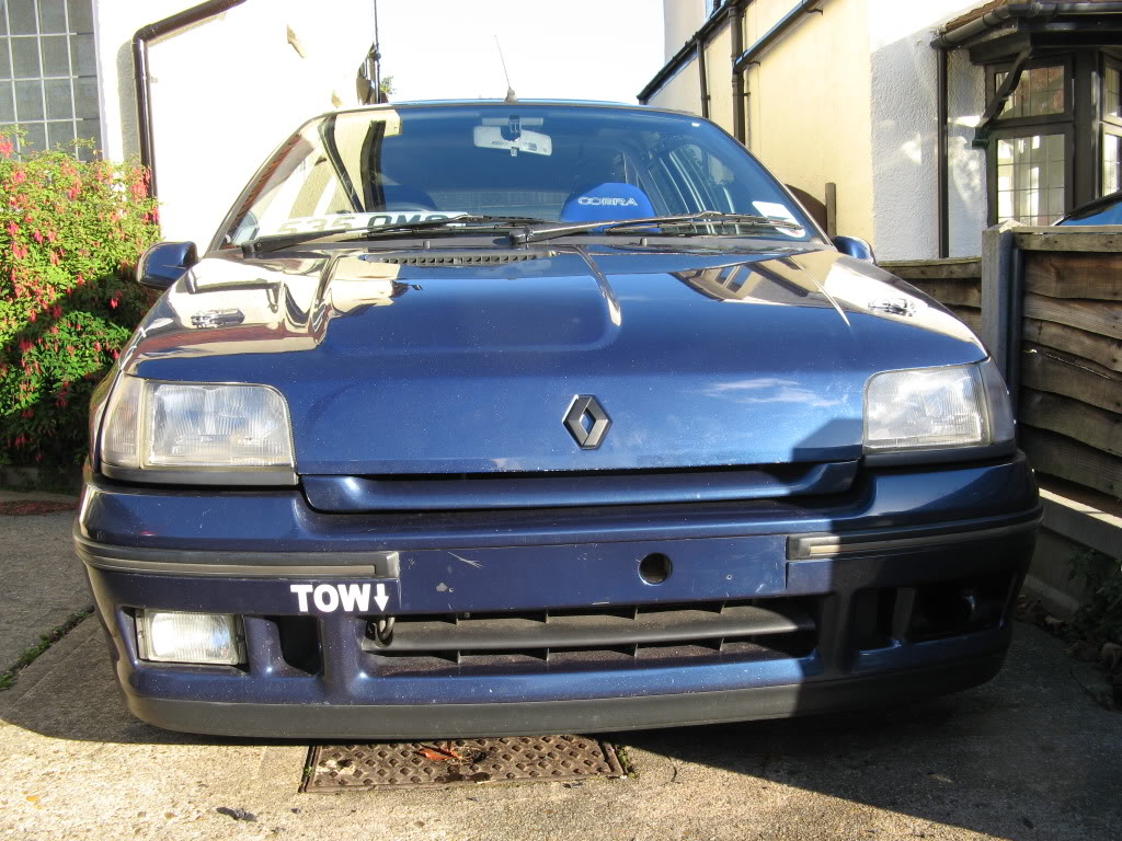

i also cleaned up the front bumper as it was covered in glue under the numberplate!!
have ordered a cut down front plate and a new rear palte which should come in a few days!
cant wait! i think new plates really tidy up the look of a car!!

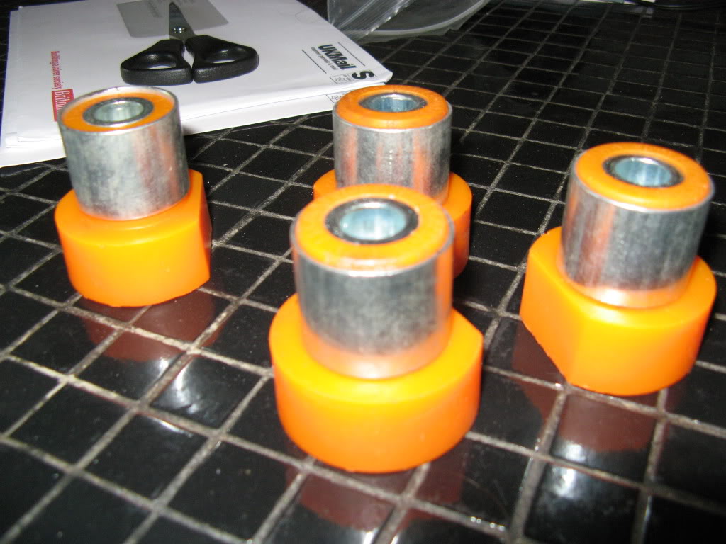

also have these on ready to start fitting tomorrow
yeessss polyurethane wishbone bushes, should stiffen her up that little bit more!!

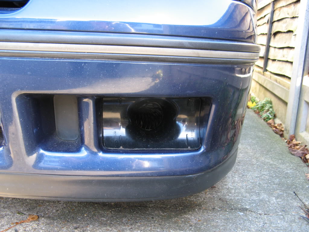

just the one for now,
theres no way of getting the other to the airbox,
not sure whether to replace the other fog with a blanking plate

vibrates like buggery! but the engine feels alot less like its swinging from a chandelier and about to fall out at any second,
i think i need to do the gearbox mount too before it really stiffens up!
im pretty sure the bushes need welding it,
the entire subframe assembly bears an uncanny respeblance to the mk2s lol
i dont think renault really changed much tbh, have you got polybushes then??
as mine came without instructions and im not 100% cetrain where needs welding!?
is it jsut the outer sleeve to the wishbone??
