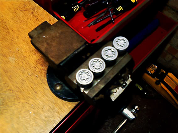

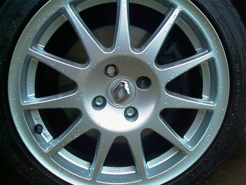

Just need to give the locking wheel nuts a quick spray of silver hammerite now to tart them up.
Gaz_
  Extreme mode
f**k em off imo! Cause nothing but grief! I sooooo need them wheels. When i had my old Cup, getting new Turinis for it was one of the best things i did! I'll have to do with a refurb now (house saving :()
  Cup Packed FF200
Locking wheel bolts are a pain, I just don't over tighten them lol
I agree, new wheels can make a huge difference. ;)

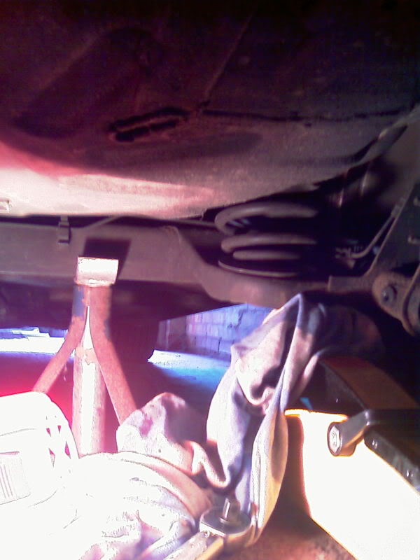

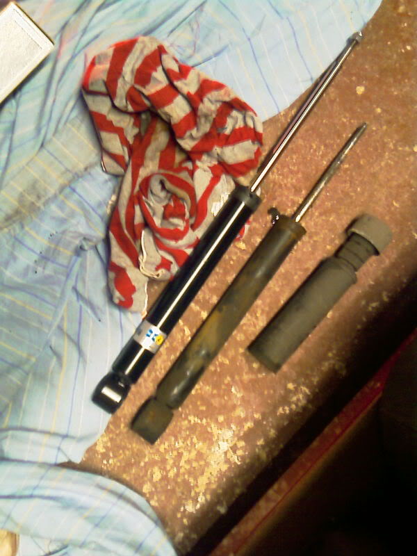

Cutting a long story short I noticed one of the rear shocks had gone last month on a weekend drive. Having a company car and the clio being in hibernation until the better weather I got round to replacing both rears last week.
Couple of surprises along the way mind.

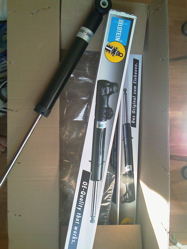

Someone somewhere along the line had fitted two different shocks, I thought they were both Bilsteins but the one that had gone was not.
After weighing up the options (and I have to say Renaults £60 per shock, inc bushes and dust covers was very reasonable I thought for once) I went for a Bilstein B4 replacement. Used these in the past over standard OE shocks and although not really an uprated shock they do seem to take the punishment and work well.

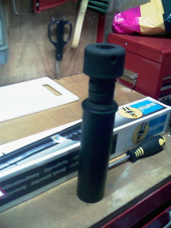

Only really problems were that the OE Renault dust covers don't fit the shaft from the Bilsteins (Bilstein is thicker dia) so a little modification was required. Plus the top bushes on the under side were both deteriorated, so I had to source these separate as Renault sell them as a kit with the shock...which was annoying!
Just cleaned up and treated the metal tops to the dust covers for good measure.

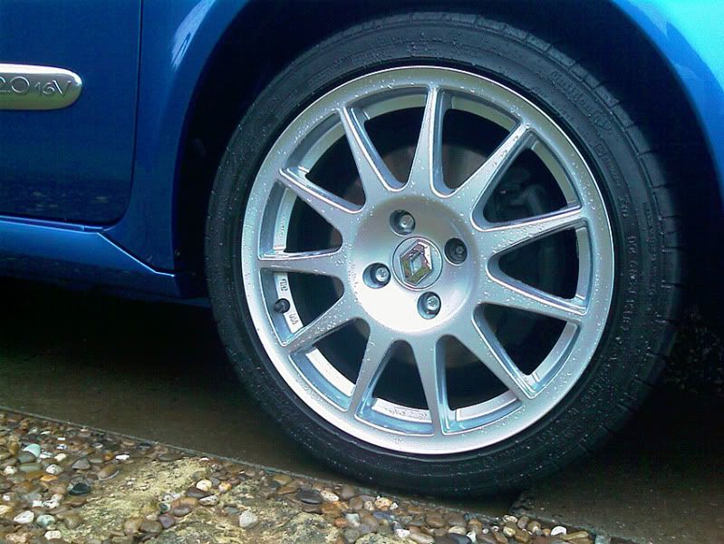

are your side bullets chromed m8? look very shiny..... i really want to do what your doing with your cup to mine, make it an absolute minter and keep it as std as poss. lets see how much money i can save 1st! doenst need much, wheel refurb and a couple of very minor scratches sorting out, then just clean it and clean it some more!
  Cup Packed FF200
No there not chromed mate, I guess there just very clean! :D
Gaz_
  Extreme mode

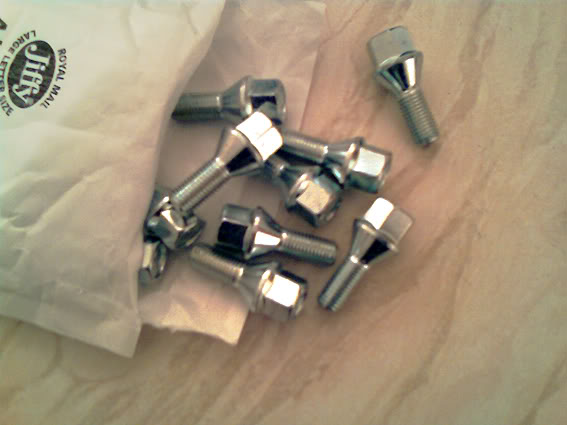

Any idea what size the wheel bolts are? That's next on my hit list along with wheel refurb!
