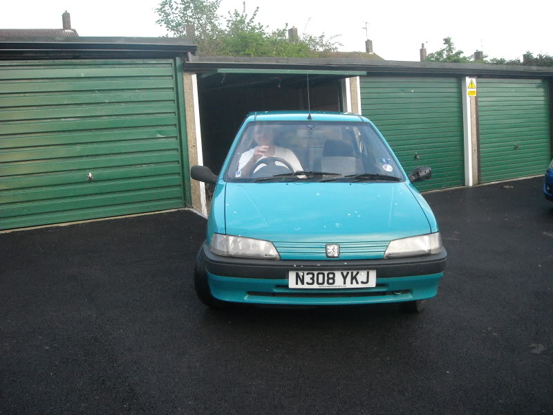

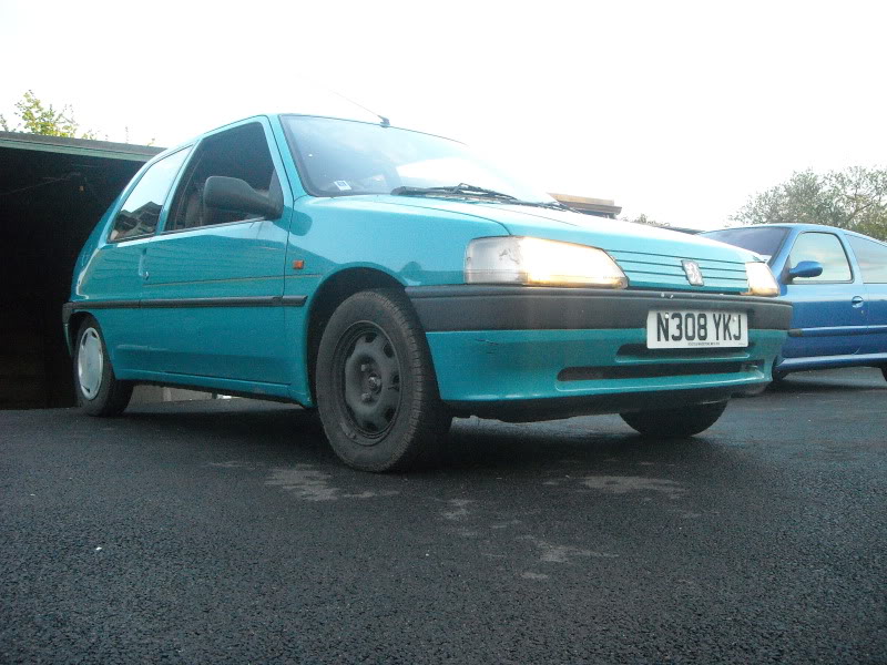

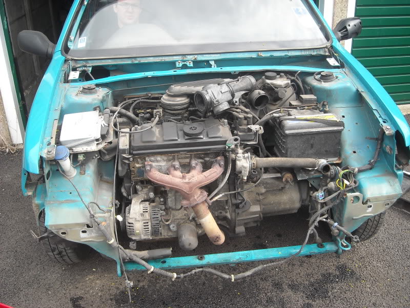

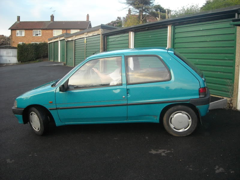

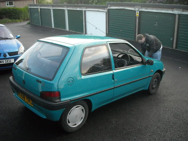

Me and a friend bought this just to mess around with, with the idea of turning it in to a fast road/track car
its a 1995 106 1.0 with 69,000 on the clock, the first thing we want to change are the hubs from 3 to 4 studs, and fit some bigger brakes, as the ones on the car a shot the pedal goes all the way to the floor, and last of all the engine (1.6 16v vts/gti)
it only cost us £100, which i dont think is that bad :cool:
heres the pics

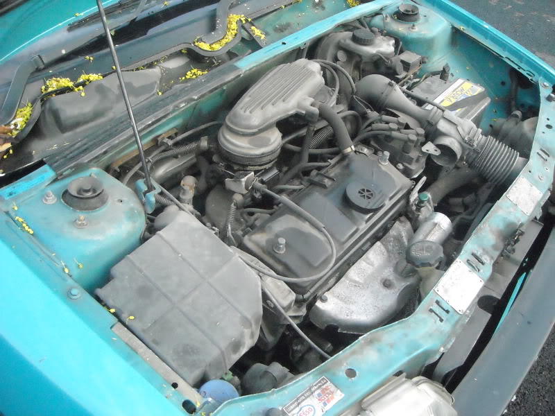

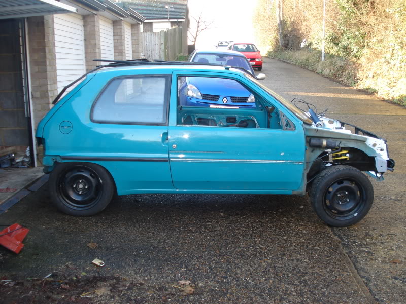

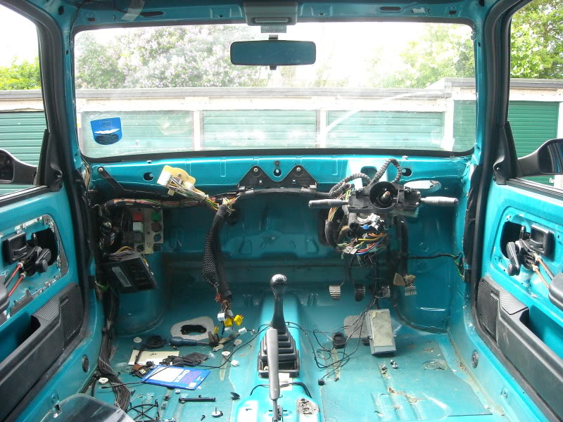

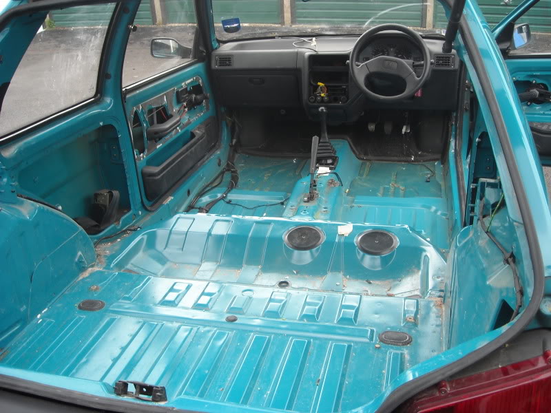

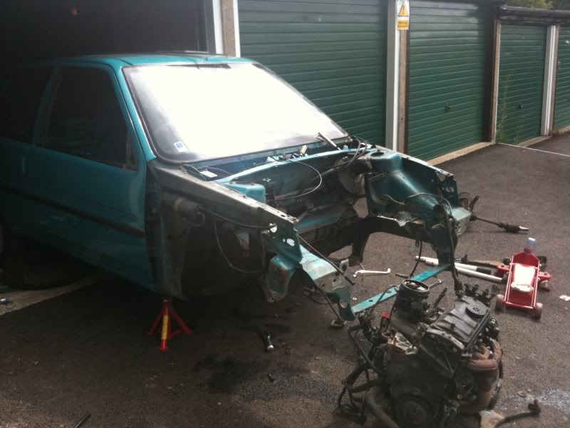

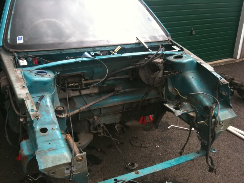

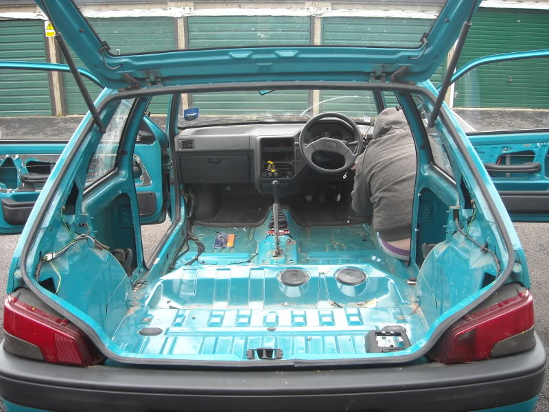

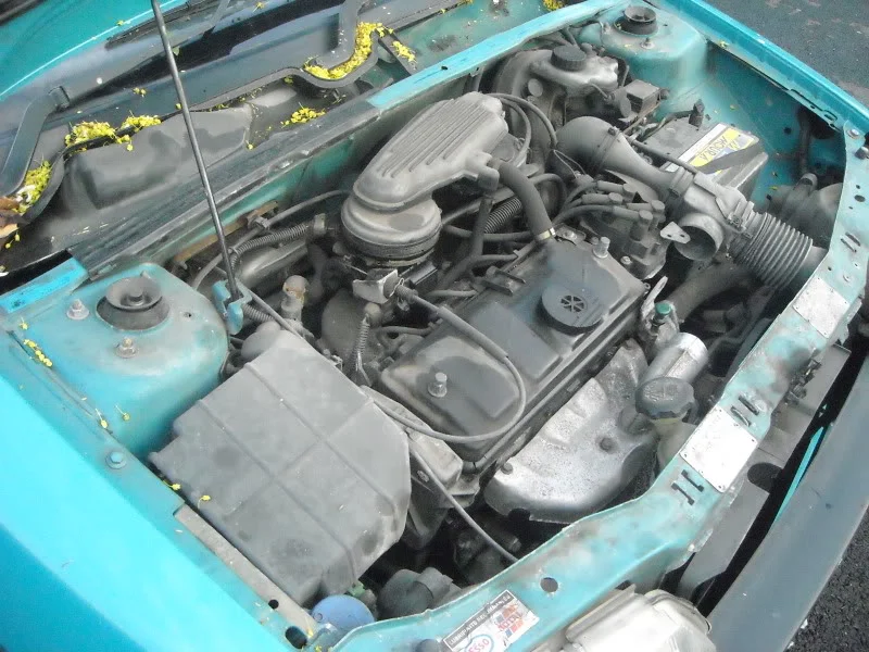

started stripping it, still got a bit to do

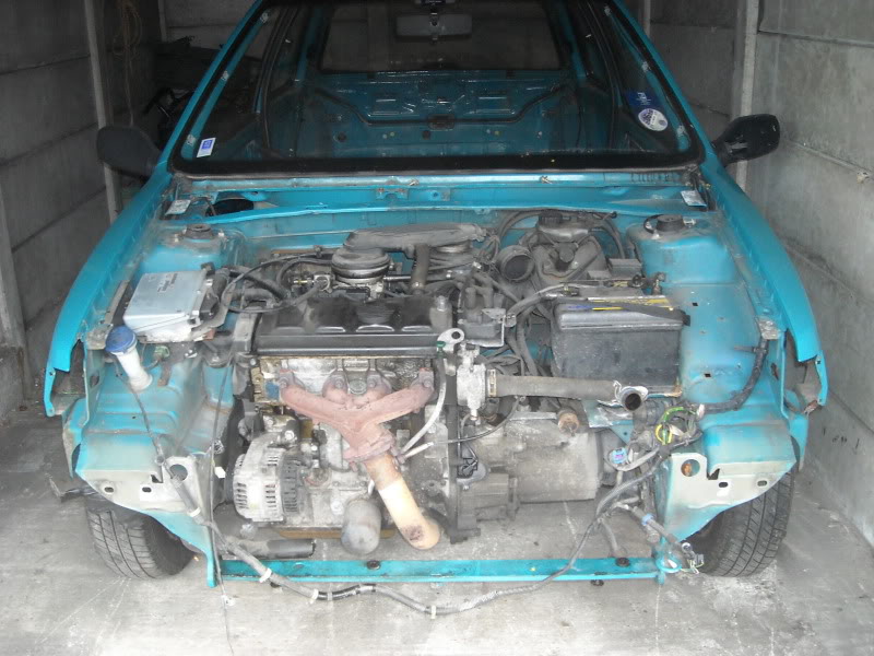

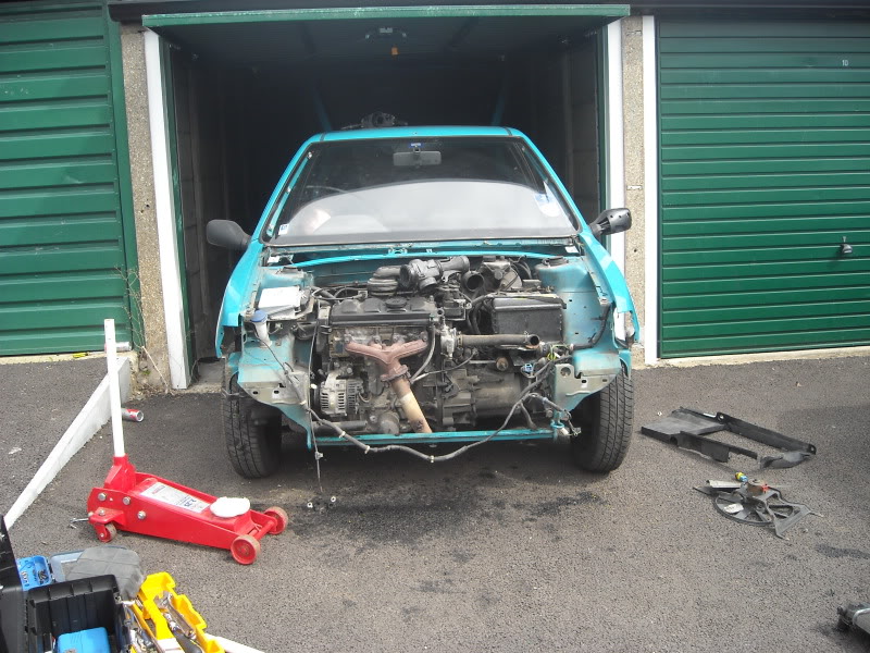

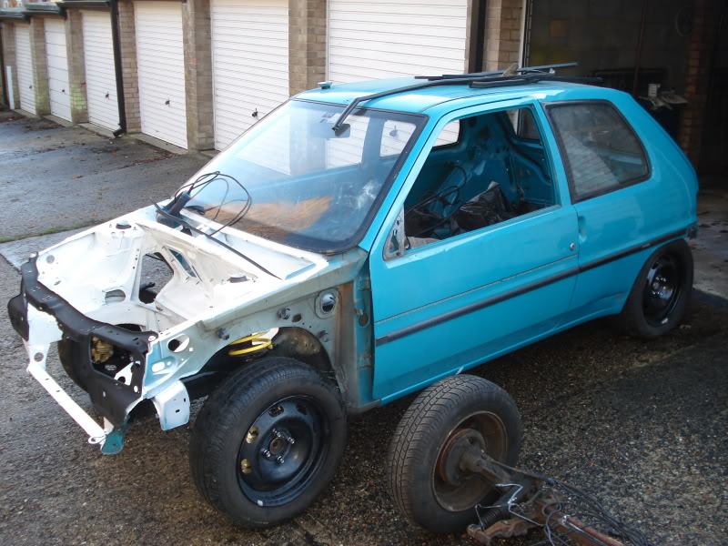

done abit more stripping and starting to get ready to take the engine out

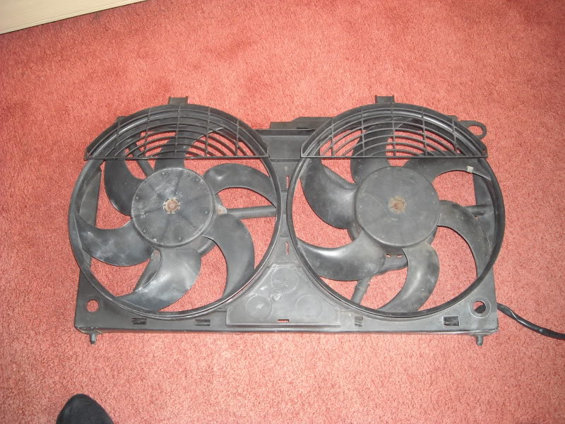

then bought a twin fan set up for it

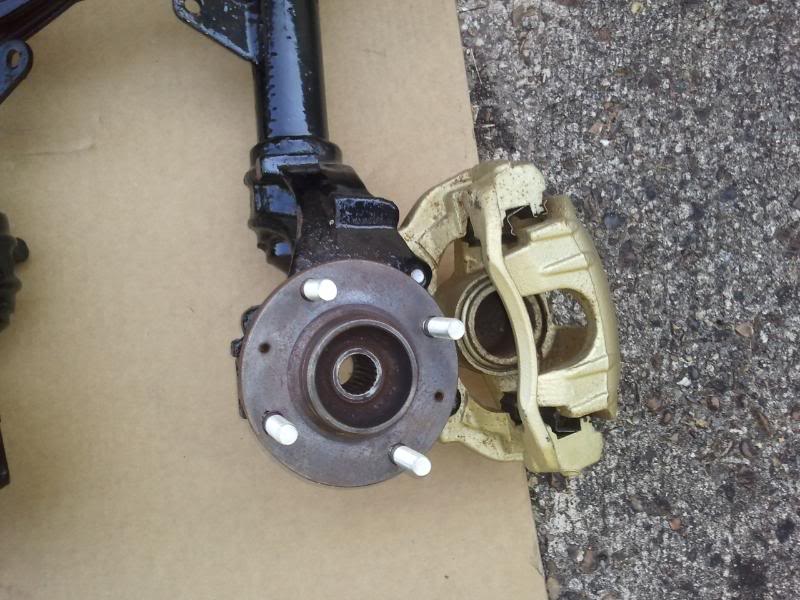

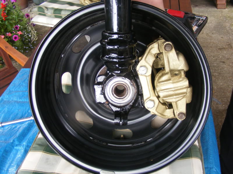

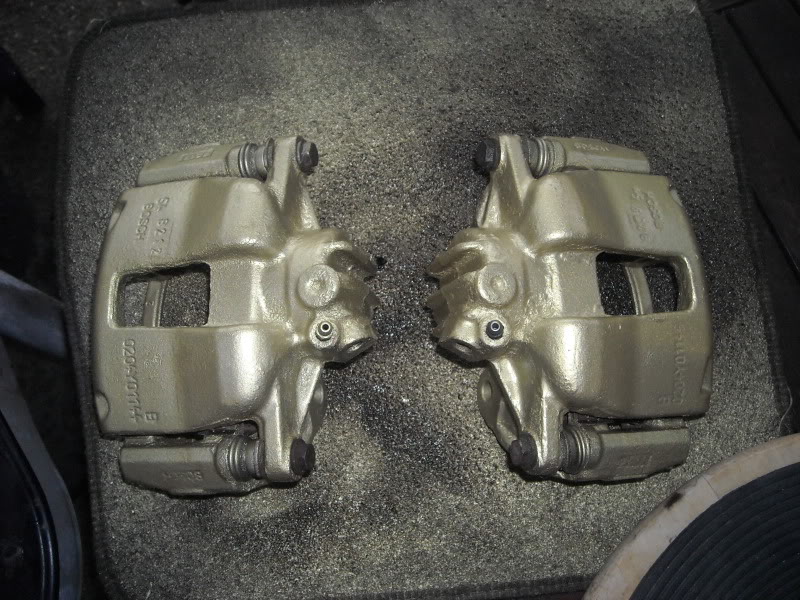

got some bigger brakes for it
there of a 2.0 307 and they are 283mm

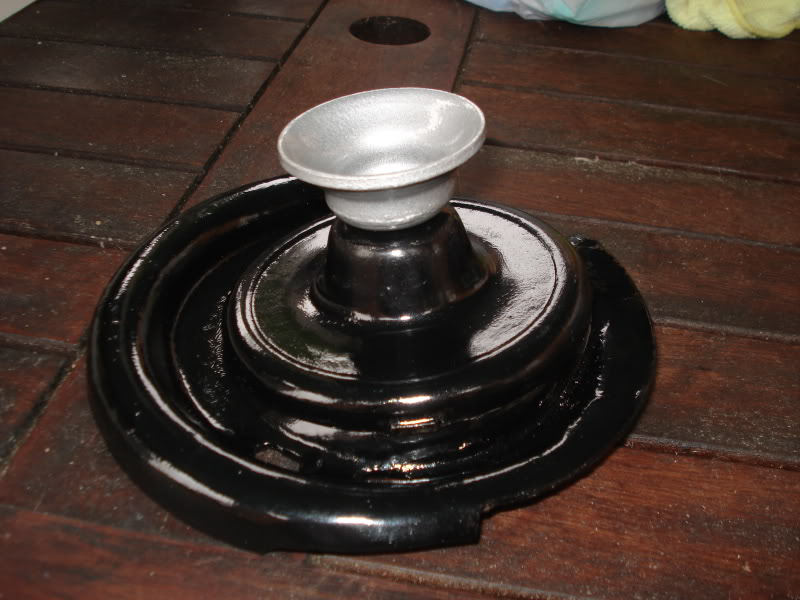

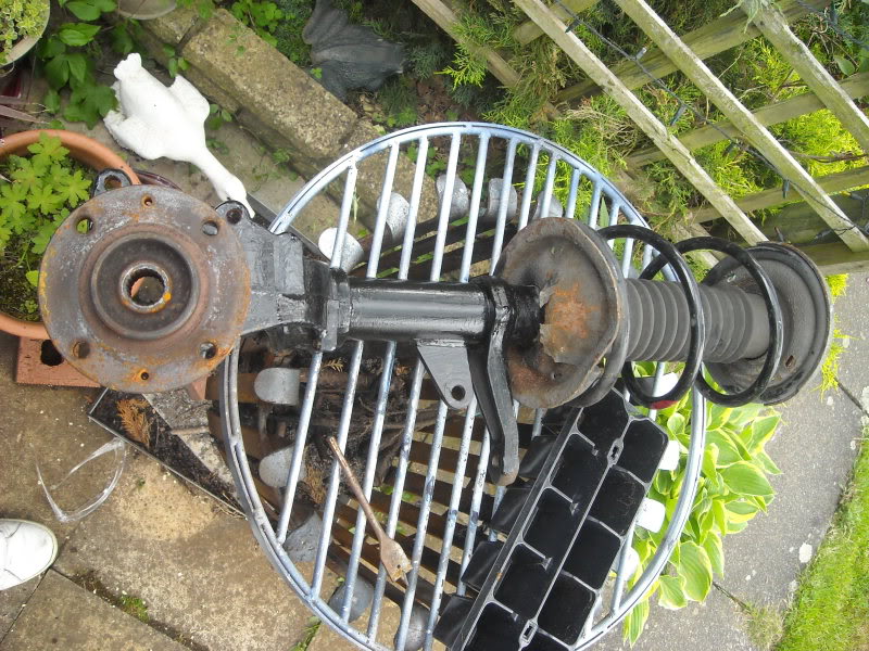

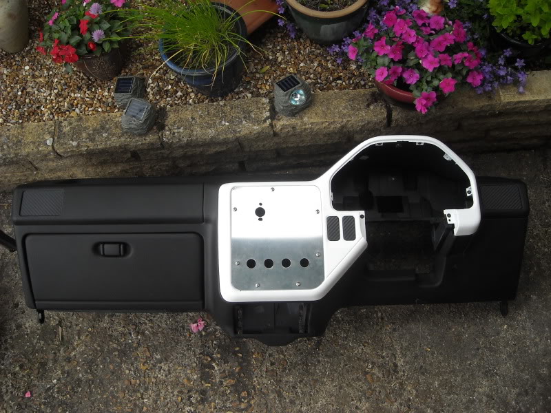

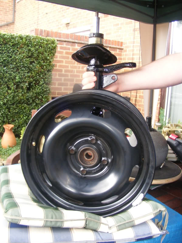

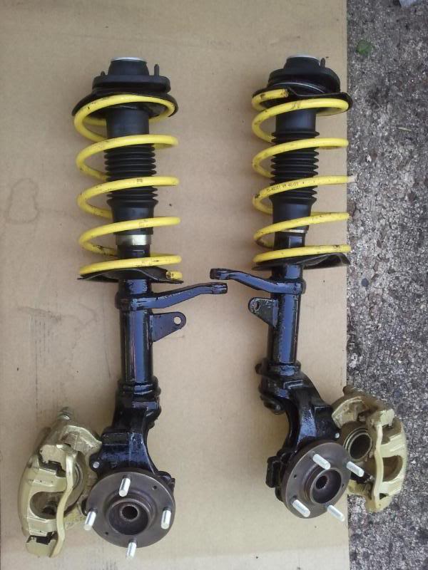

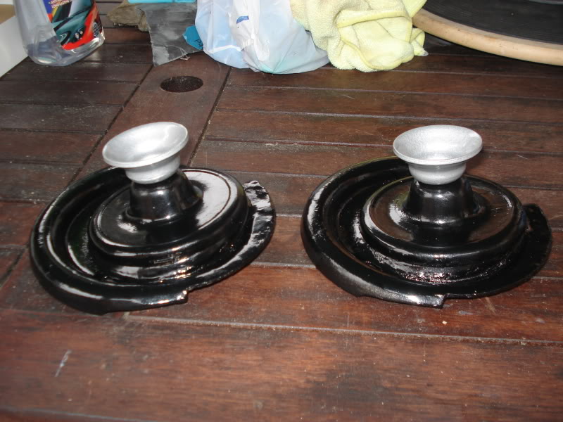

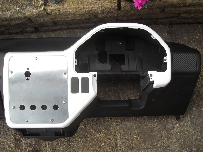

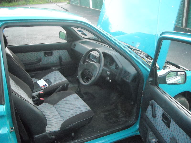

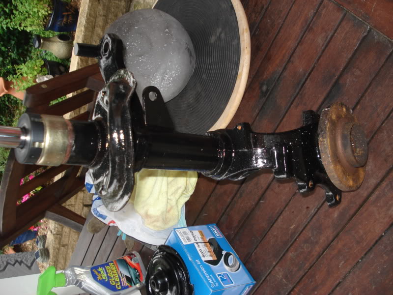

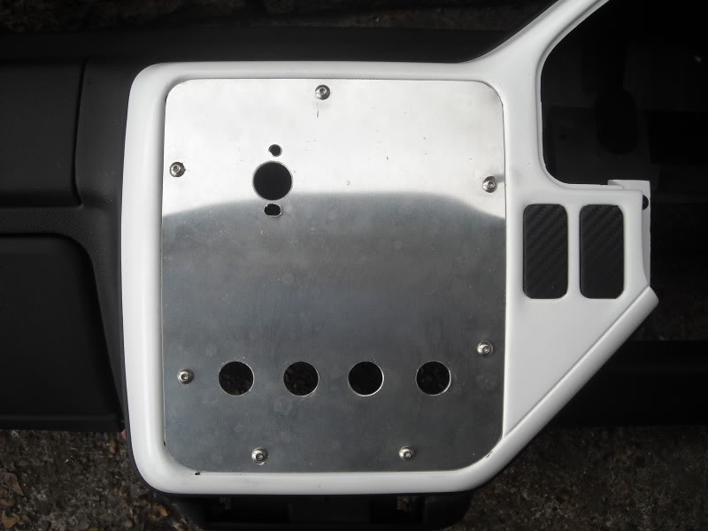

ive started to sort the dash out and starting to repaint some 4 stud struts i bought

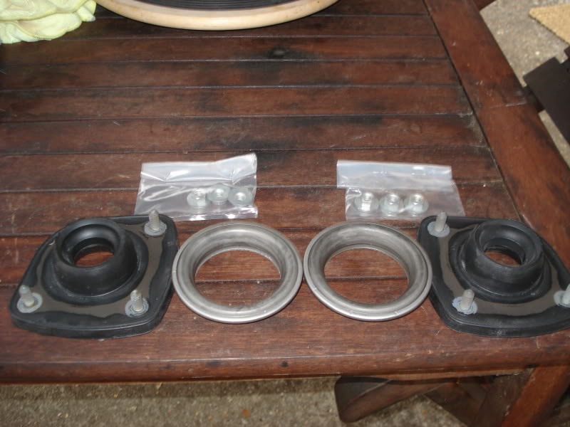

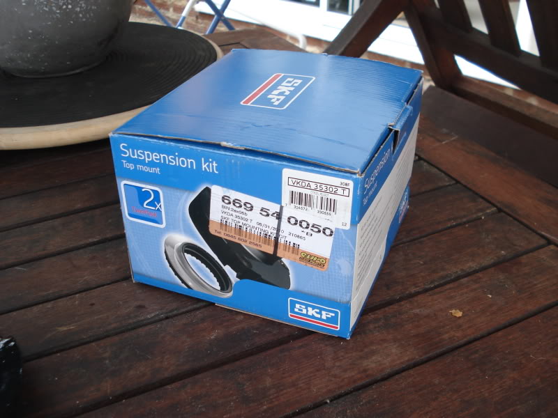

started to tidy up the struts really and buying new bits for them, just need new bearings and there done

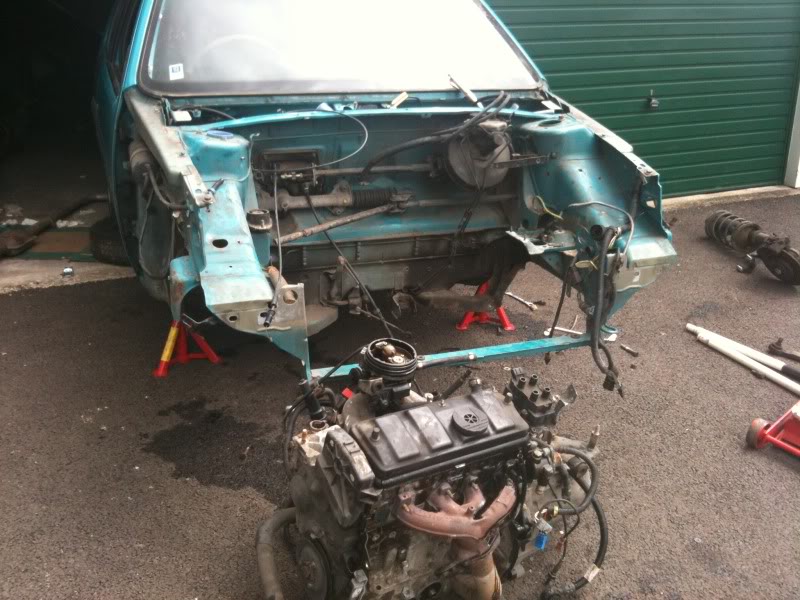

finally some progress got the engine out today

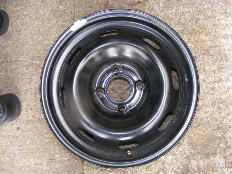

went to pick up a set 15" steel wheels today, they just about bfit over the brakes

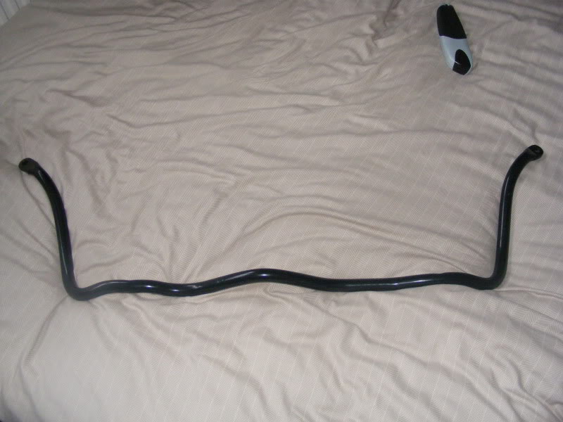

bought a vts anti roll bar 22mm and got it powdercoated

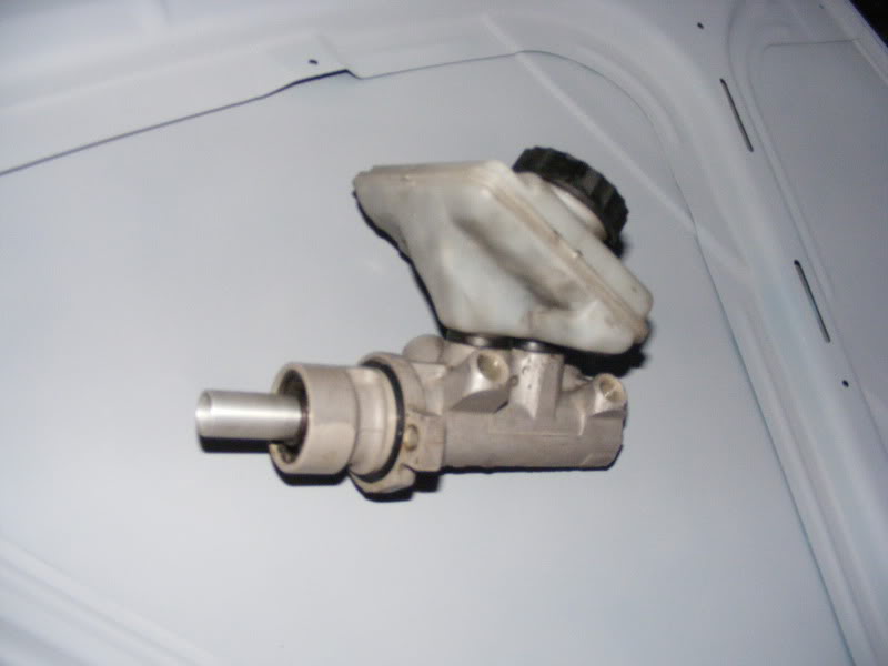

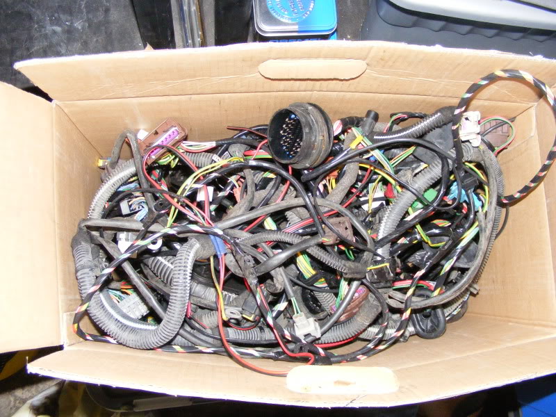

also ive bought a bigger master cylinder 23mm 4 port and a vts interior loom to run a rev counter and digital dials

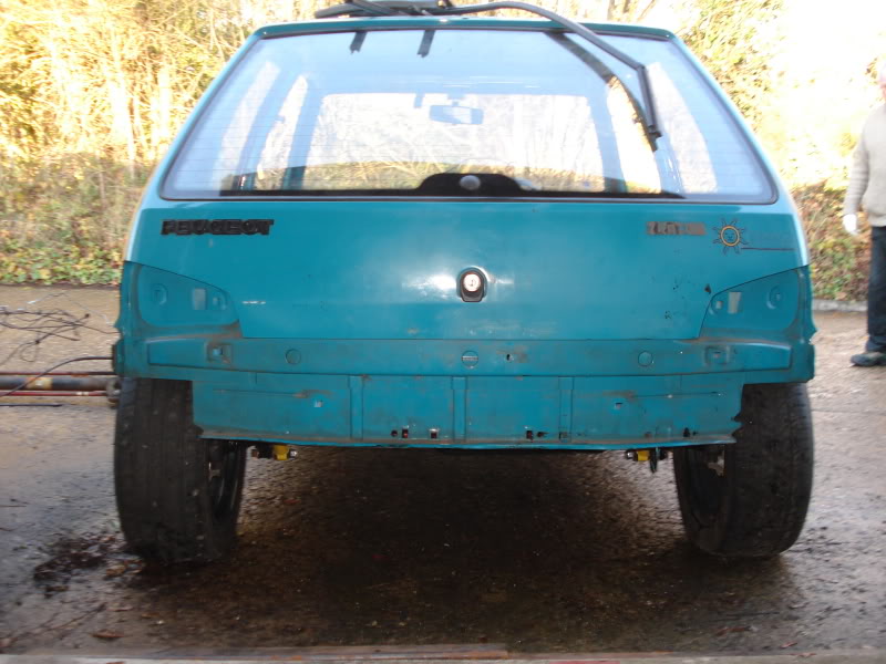

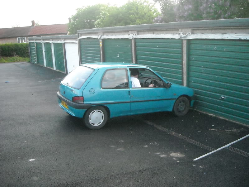

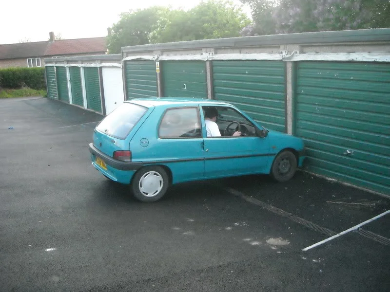

Umm..... in the second picture..... have u accidentally driven it into the garage door?

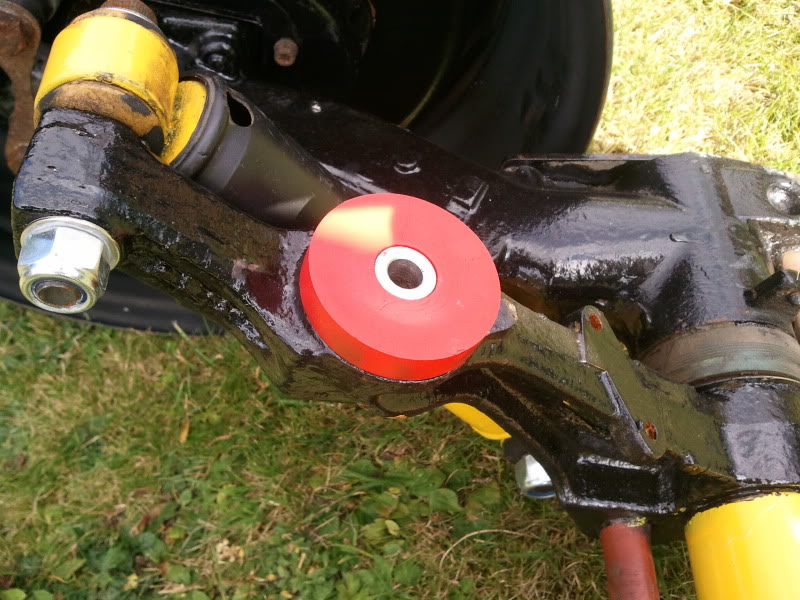

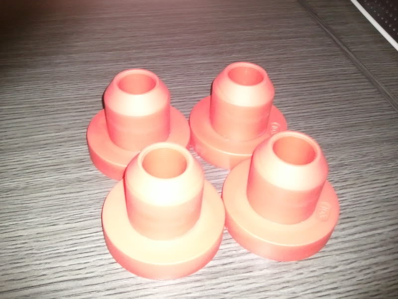

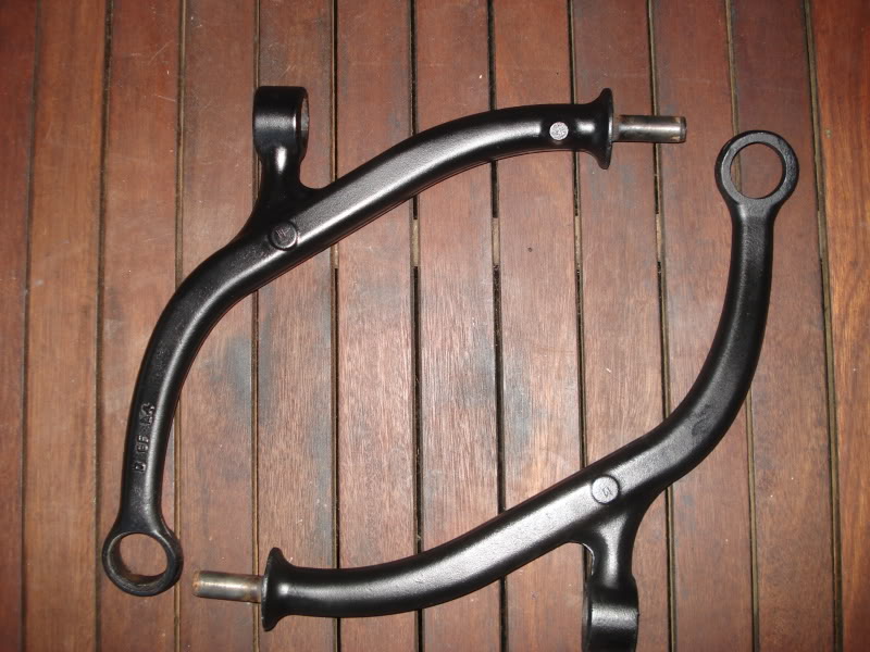

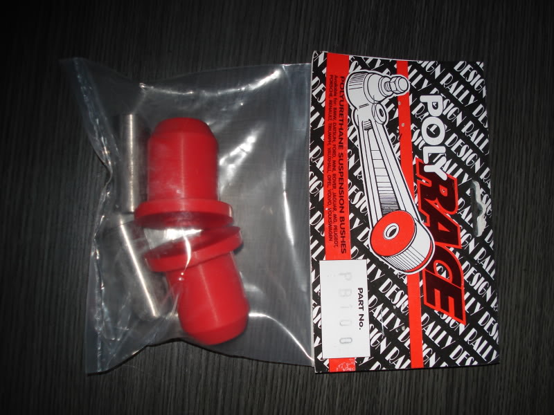

bought a pair of VT wishbones that that im in the middle of changing the bushes, balljoints and mounts. upgrading the bushes to polyrace ones

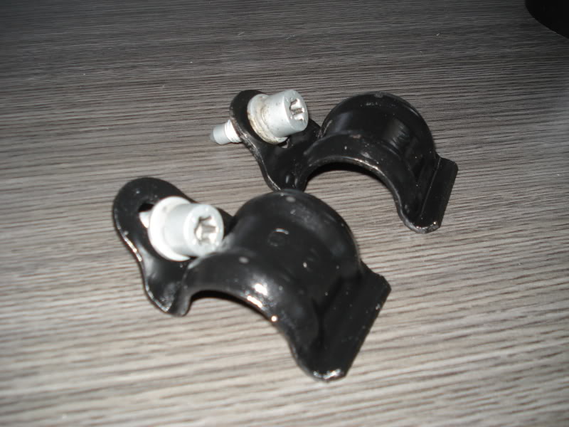

also bought the clamps to hold the arb on, again going to get polyrace arb bushes for them

changed my mind on the colour of the car didn't really like the battleship grey once i sprayed the bonnet, so im going to spray it matt black

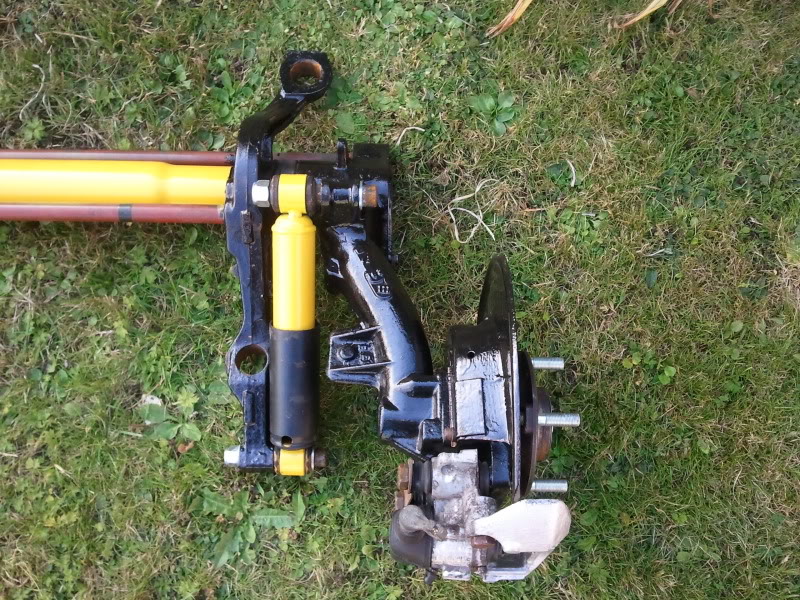

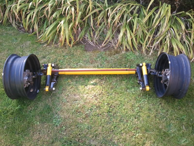

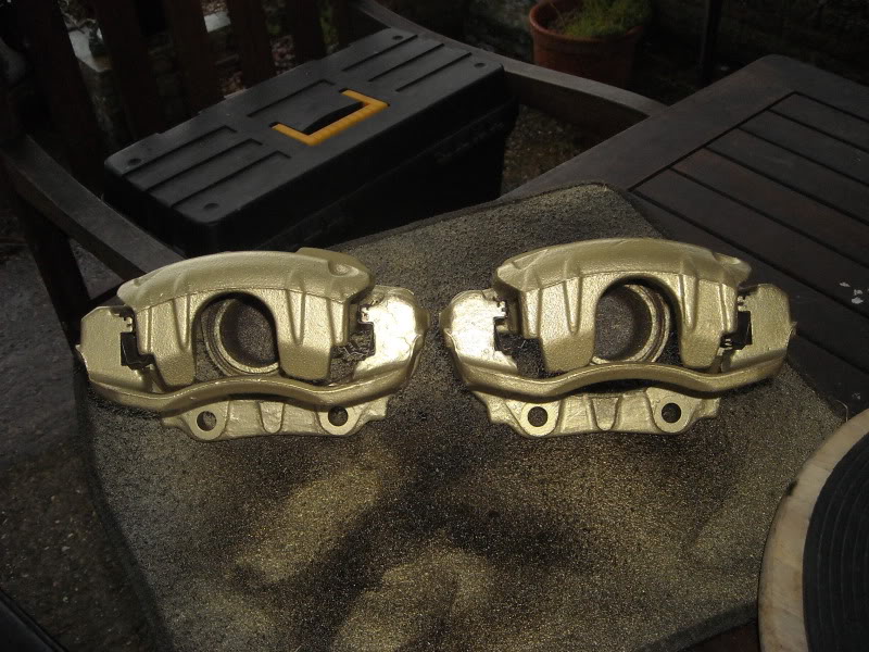

bought a rear beam, all ive done is cleaned it up and painted. i had to buy new calipers fot it aswell as the bleed screws had snapped and could get them out, all i need to do now it buy the bushes for it and then i can go on

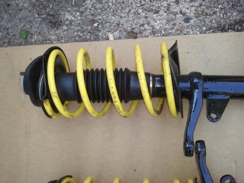

also bought some lowering springs for it there 30mm apex and also bought studs for it instead of using bolts and fitted them

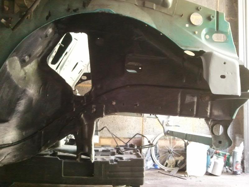

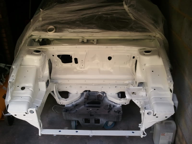

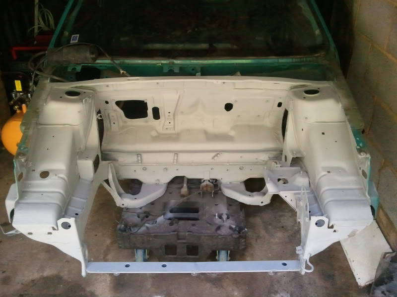

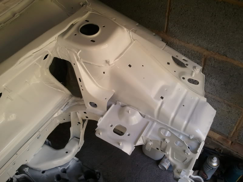

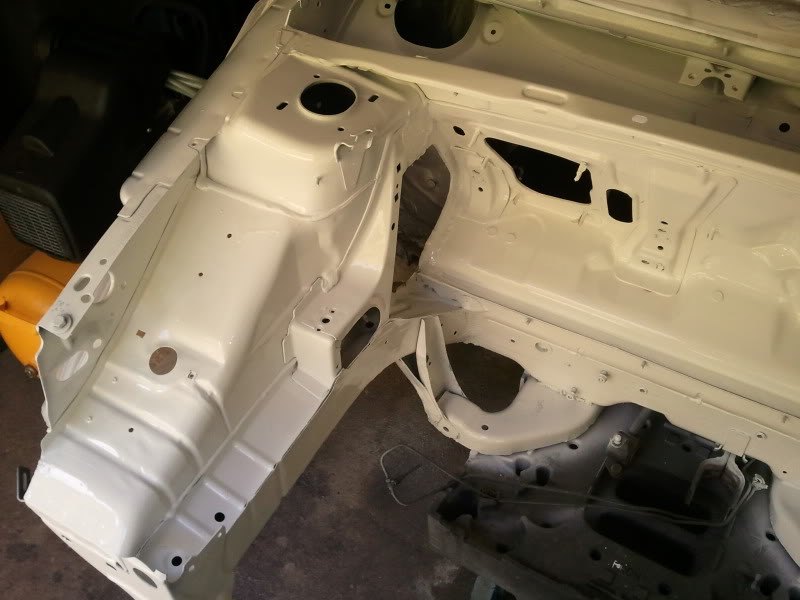

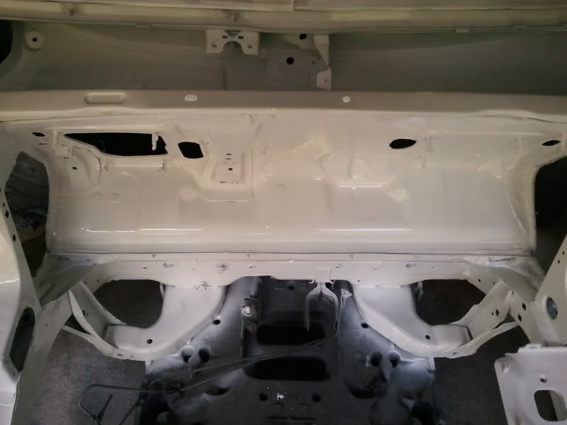

ive started to paint the engine bay aswell, im just waiting for the paint to come then i can finish that bit off and make it into a rolling chassis once ive found some tyres for the wheels, the bay is going gloss white and so is the interior and ive undersealed the arches too

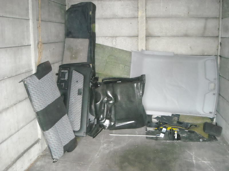

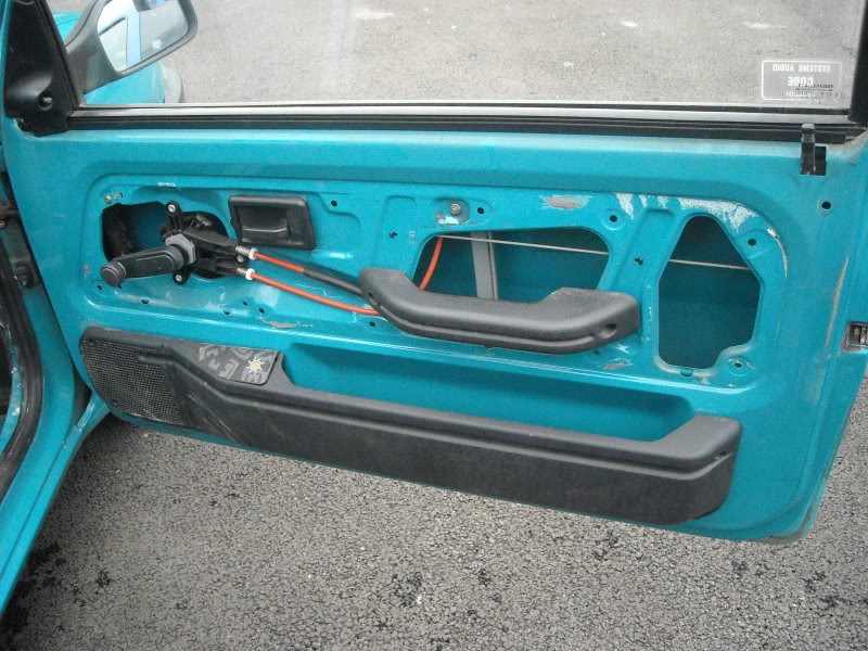

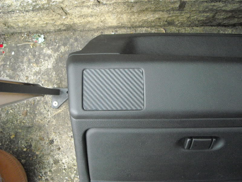

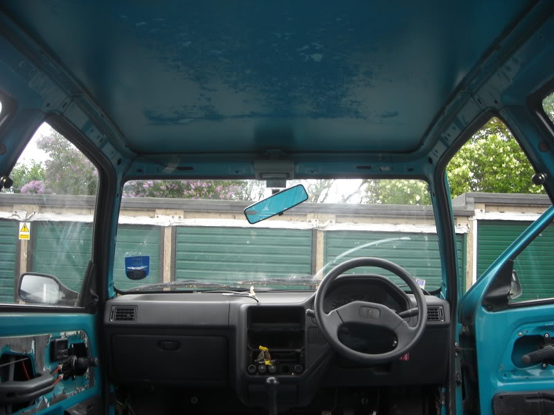

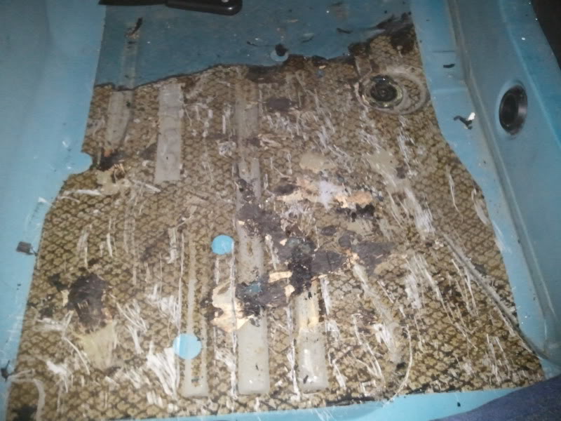

all ive done inside is started to take off the soundproofing / tar stuff which surprising weighs quite a bit

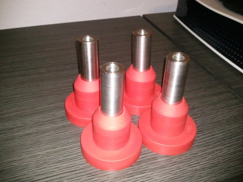

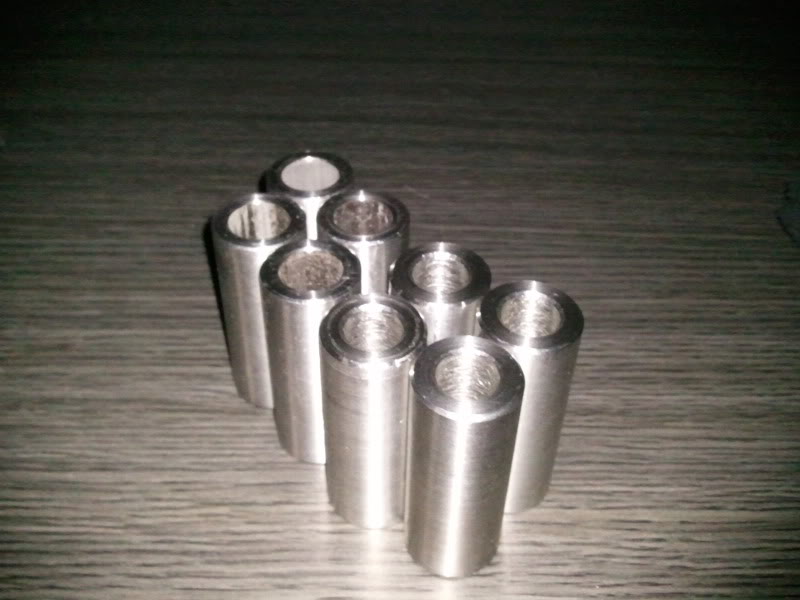

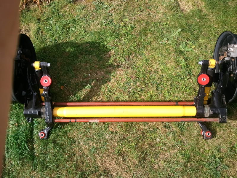

bought the bushes for the rear axle, had it new metal inserts made as the axle is off a later model 106 which takes a 12mm bolt and the the car takes a 10mm bolt and the housing that the bushes go in are different sizes, pics aren't the best
also sprayed the engine bay today aswell

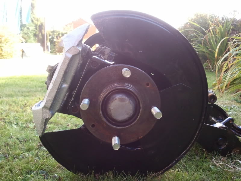

finally finished the 4 stud conversion now, fitted the rear axle today
the axle need rising as wheels are too far in the arch are rubbing aswell, didnt get pictures of the underside will get some tomorrow
