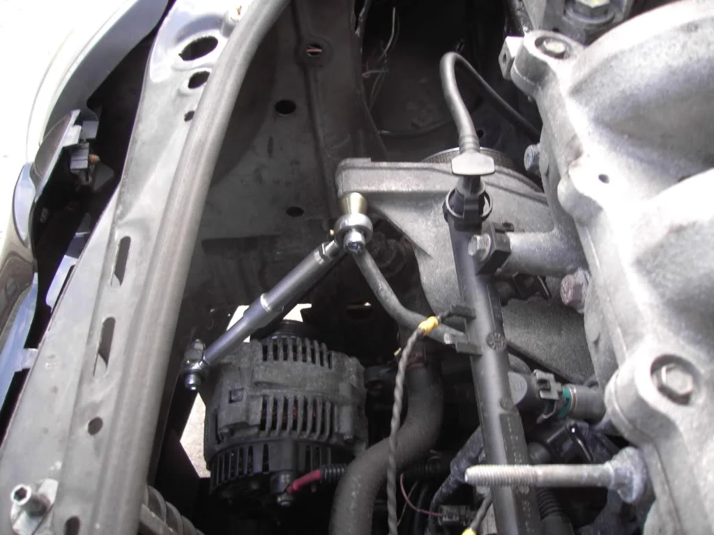

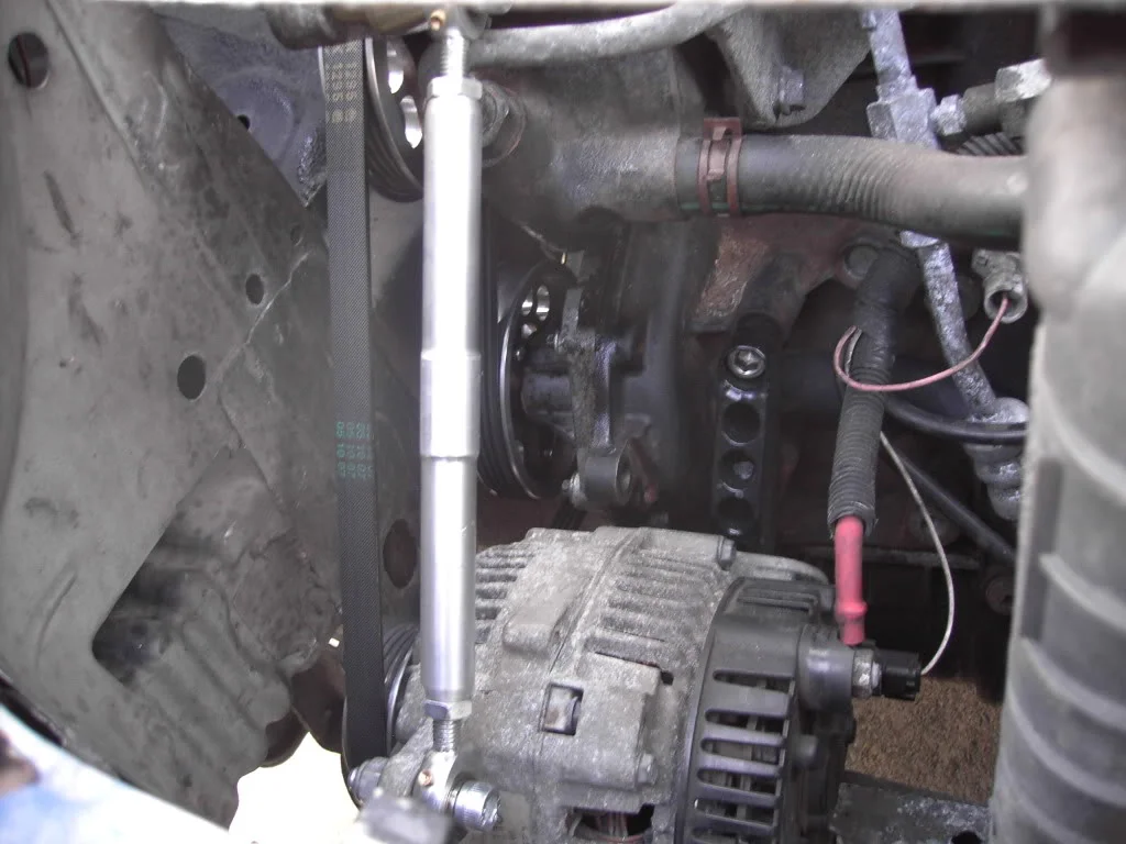

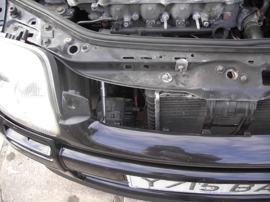

was very very immpressed at how well the kit was made and how light it all is, as said in his ebay advert will save 16kg and around a kg in rotating mass...good times :approve:
So got the car booked in on a wedensday and drove off in his amazing courtesy car...1.0L Micra
picked the car up on Friday and drove it home :approve::approve::approve:
was very very immpressed at how much the revs seemed to pick up, car now feels so much more urgent through the whole rev range, and the loss of weight from front of the car has made a difference also
so much easier to change the aux belt now
here are some of the kit fitted to my ph 1
overall very impressed with the kit, and the service provided by nick top bloke and really knows his beans, have a look at some of the kit he has/is developing for his race car
http://www.pure-motorsport.co.uk/ClioShopLevel1.htm
in all very very happy with the kit and would recommend it if your looking at de-airconing your clio much easier than trying to hunt down a cup altenator and parts and it dont half look bad either
cheers nick
