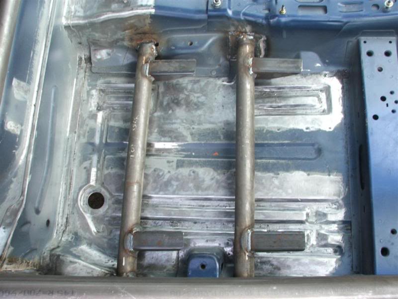

Normally there are a couple of options/ My car has these sort of things, which the previous owner installed:
http://www.demon-tweeks.co.uk/perfo...ult/clio-98-05-172/omp-tailored-seat-subframe
They are 3mm thick and obviously made with angle and such to minimise flat bar, but one of mine has still cracked.
The proper way is this sort of thing:
Which is lighter and nicer but a fair amount more work.
Beyond that you need to think about where the load goes and how you're going to transfer it without bending the mounts.

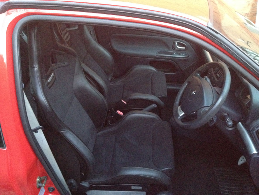

Correct Jon, fixed position. Will leave the passenger side standard. It's not a car I ever intend to have rear passengers in even though it is still a road car. The passenger seat is only staying so as not too look to mental..
Figure the 10mm I gain from your mounts over trophy ones plus say another 2cm from losing the rails should be bang on. I prefer an upright position for my back but currently have a small leg clearance issue with the wheel.
If this causes mot issues? Don't know if it does then will put the usual rails back in for that.

The proper way is probably a step too modded for the car. If it was a stripped track car then in a heart beat.
Looked at the omp/cobra option the other day, obv track cars loose the pretensioners mounts. I still need to keep it. The cobra one looked like an option as I could re drill it for recaro alignment. But there pretensioners design won't fit without raising the seat on some rails as they do .

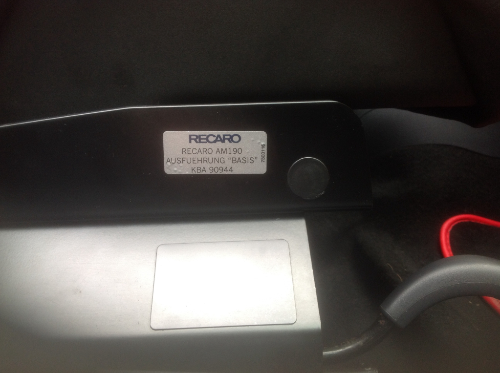

John, my recaros come with mini subframes built on, which you then mount on frames such as your versions. So are base mounted like trendlines but have full length rails rather than just points on the seat to bolt to.
So basically have fitted directly into the trophy..
But a little too high for knees/wheel.
