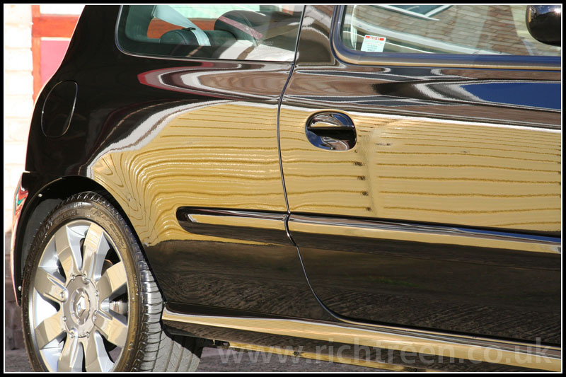

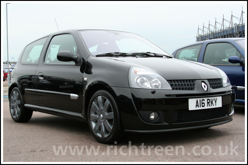

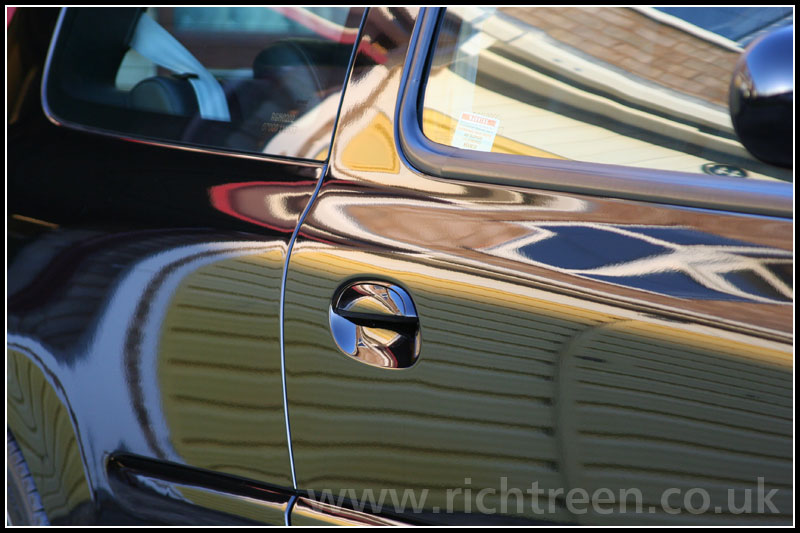

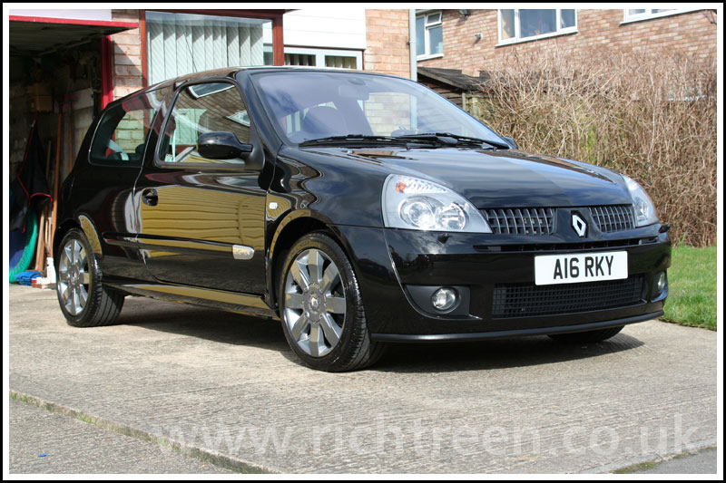

Black gold is a nightmare by hand if you have any real defects or swirl marks to deal with you will need a more abbrassive product to use first before the Autoglym Super Resin.
On my own Black Gold car summer process was:
Wash
Machine Polished with the Porter Cable and Menzerna Polishes
Zymol HD Cleanse
Waxed With Swissvax Best of Show and Zymol Destiny.
Winter Process will be
Wash
Klasse All In One Paint Cleaner
Jeffs Acyrlic Jett Sealant
Lmabswool Eurow Mitt for washing, air dried after a final rinse using an Aqugleam filter, Wheels washed with car soap only, sealed with Autoglym Super Resin and Extra Gloss and topped with Poorboys or Swissvax wheel sealants.
