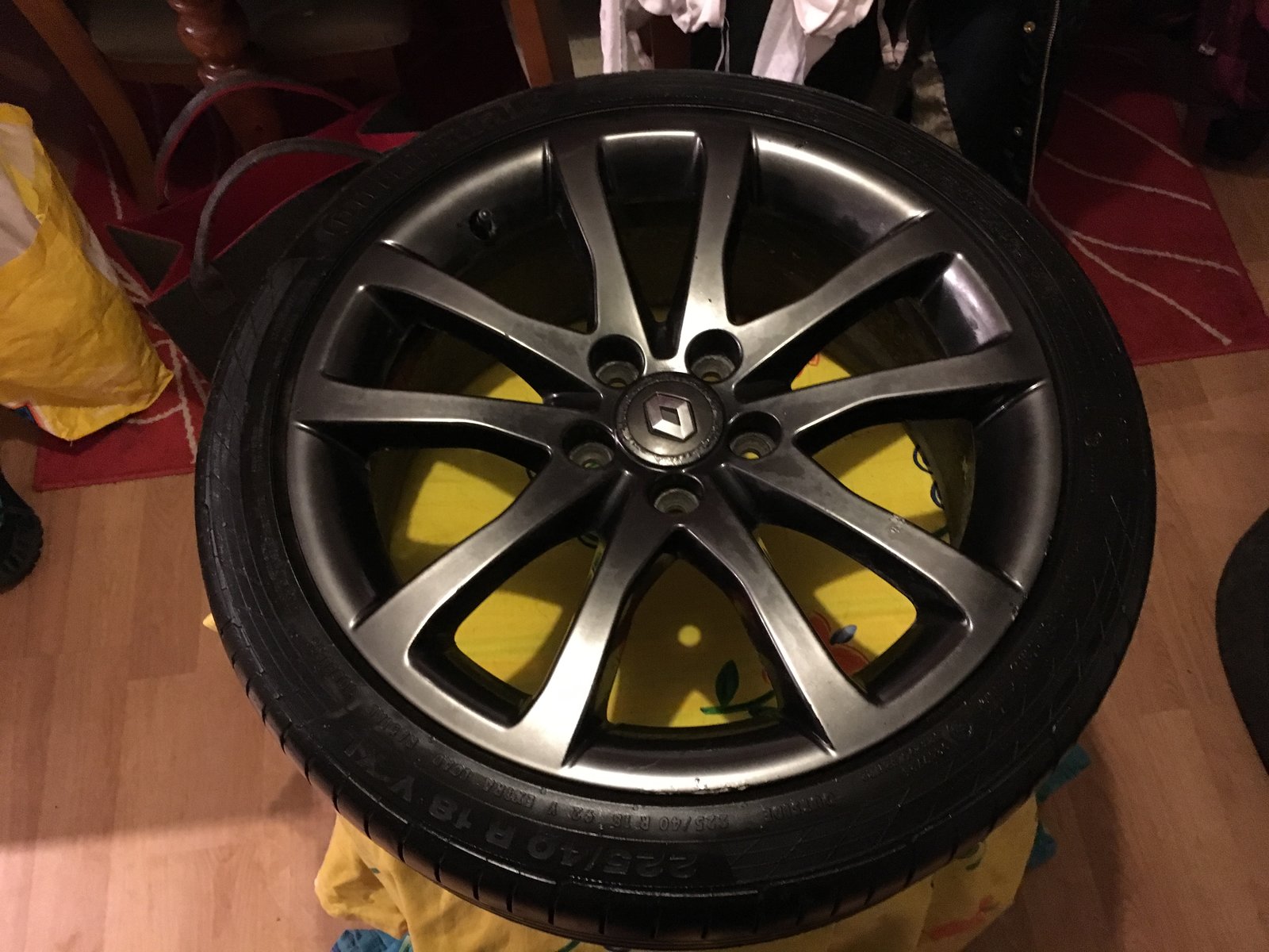

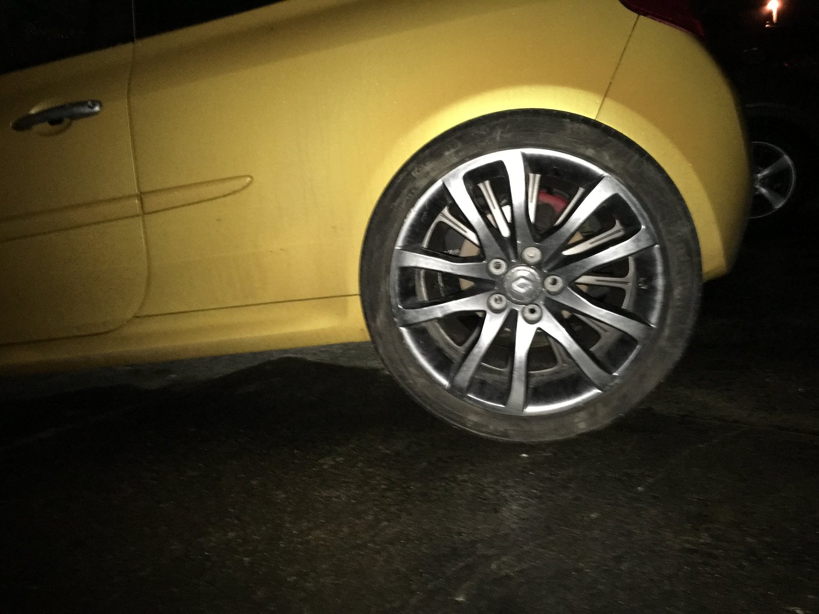

I bought some Laguna interlagos (Megan's R26.r) alloys on the off chance that they fit my car. I had in the back of my mind that Renault altered the PCD and centre bore of the hubs from the mk3 Clio/mk2 Meg/mk2 Laguna to the mk3 Meg/mk3 Laguna but I bought the wheels anyway.
As it turned out, they didn't fit, I was right.

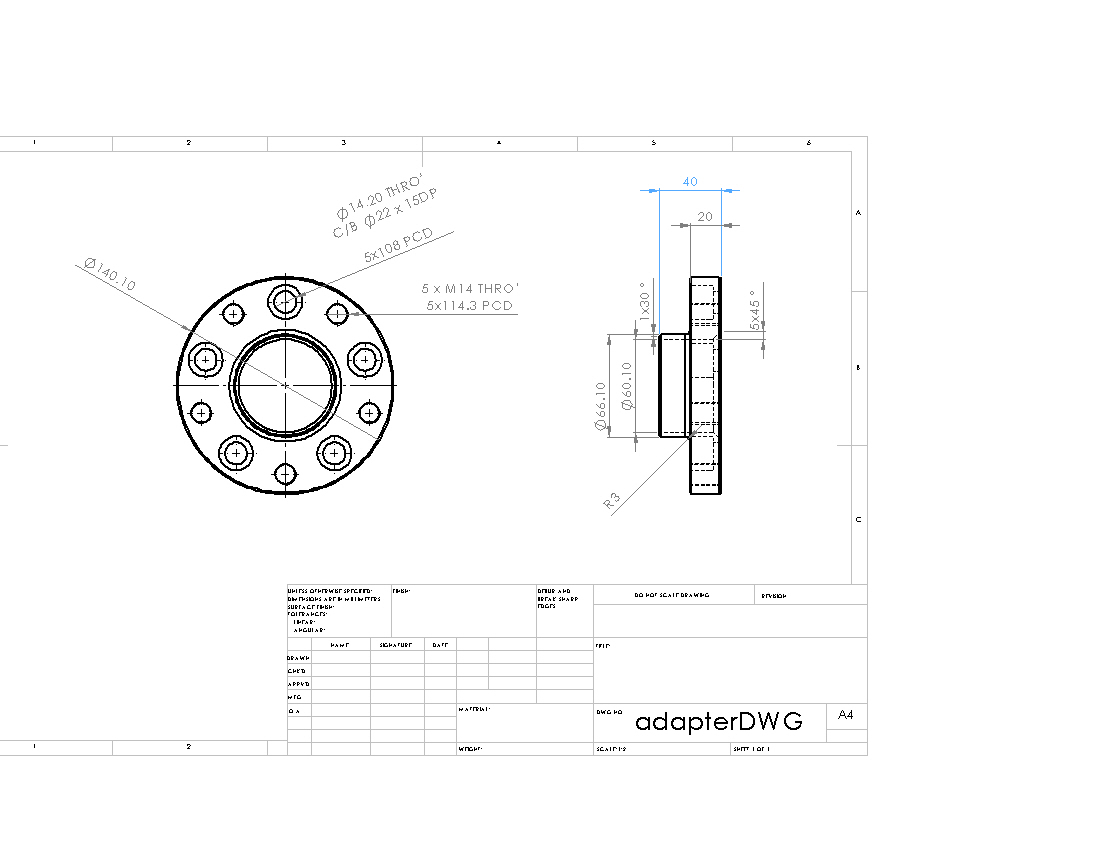

Mk3 Megs and Lagunas have a 66.1 centre bore (mk3 clios have 60.1) and a 114.5 PCD (clios have 108), so I knocked these up to be made in work. Note the tapped holes, this was a first draft, steel inserts were going to be made to save the aluminium threads from being stripped.
I knocked these up as I didn't want to pay £120 per corner for adapters.
Here's a drawing for anyone able to make these.

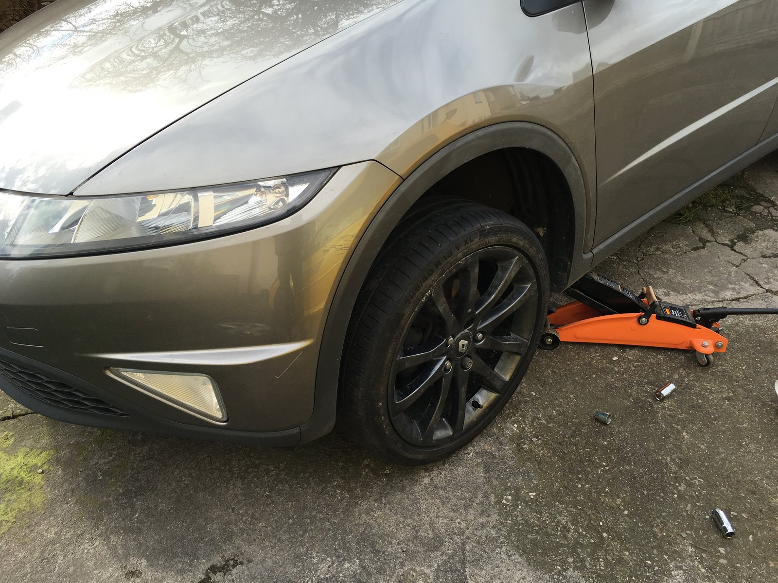

But, they fit my girlfriends civic 😧 every cloud and all that.

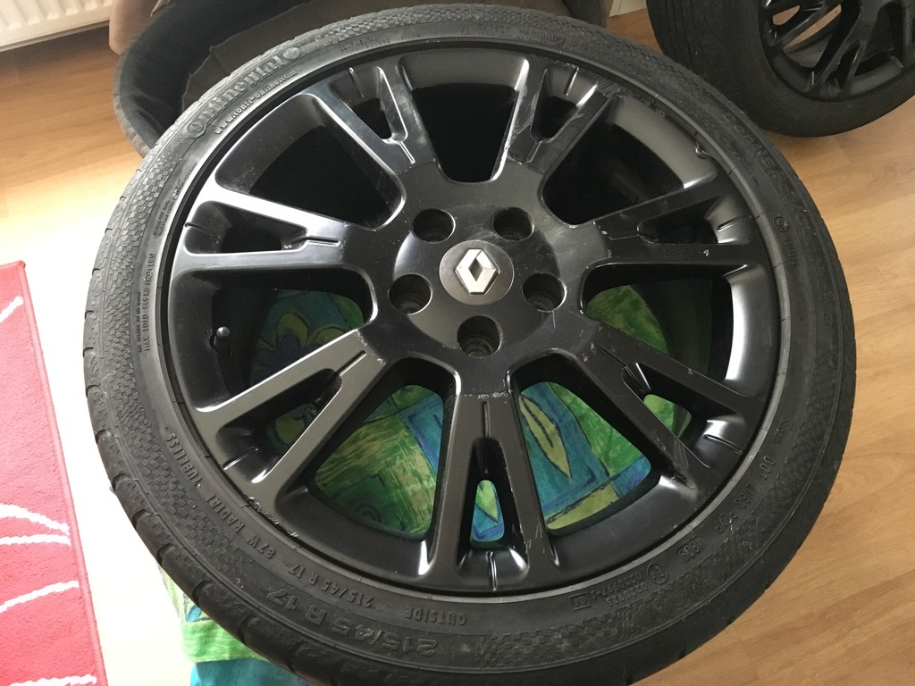

It was turning into a pita to get the adapters knocked up in work as they're a pretty big foreign job. And I found some speed lines with tyres at a decent price so put the Laguna wheels on the back burner for the time being and bought the speed lines.
Pics to follow but they're in decent Nick, there's a few dents and scratches that need filling in and as I hate black wheels, they'll be going white.

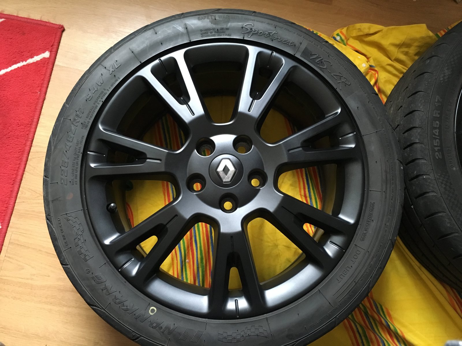

So I picked up the speedlines on Friday with the aim to have them resprayed White.

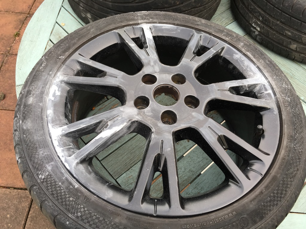

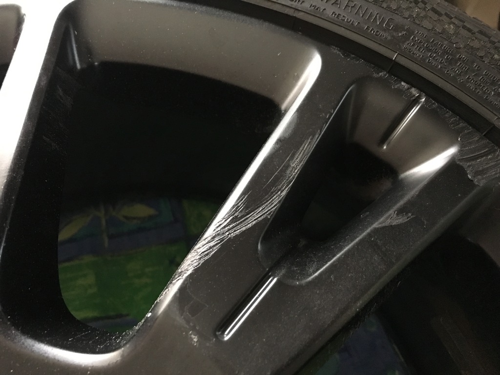

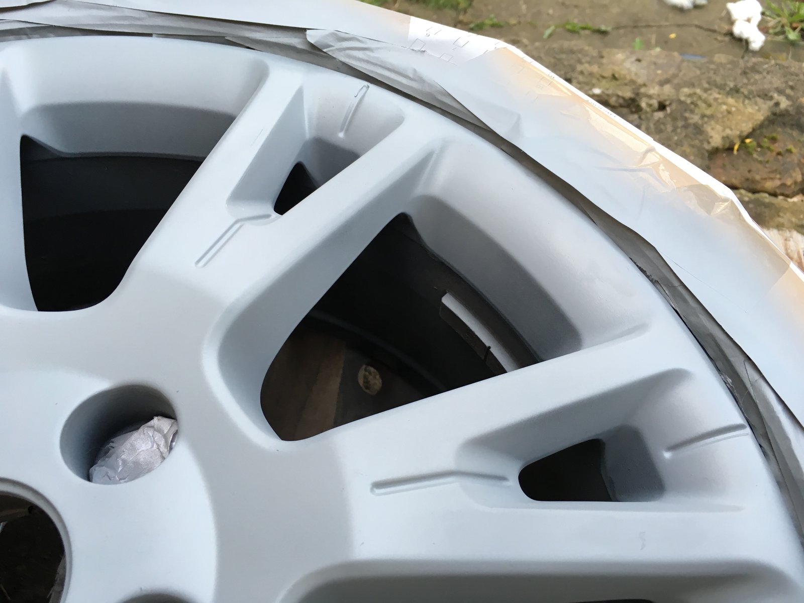

I didn't realise how close the oulton track day is and I started smoothing out the defects in the wheels to fill with chemical metal. It's a bit overkill but I got carried away.
Thankfully, only two need a bit of work.
The plan now is to get them nice and gouge free before giving them a coat of satin black to tidy them all up ready for oulton. Then when I get some more time or spare pennies, I'll have them done white.
The anthracite centre caps are going on the r27 Raiders and I've got a spare set of centre caps to go on these. No point respraying mint centre caps when I've got some tatty ones to do.

Cheers, here's today's efforts.
^^thats actually the worst one :D

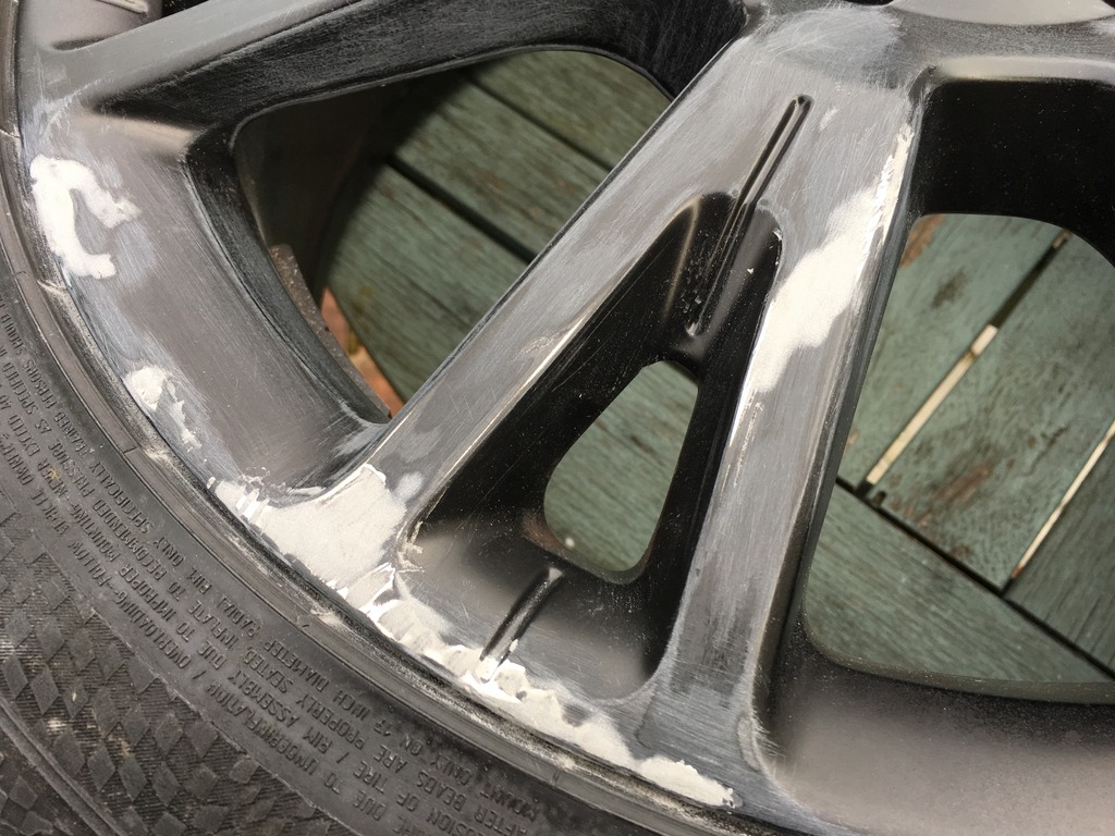

I should've just bought white spray from the off rather than satin black again. I had more primer than I anticipated so I could've easily changed the colour.

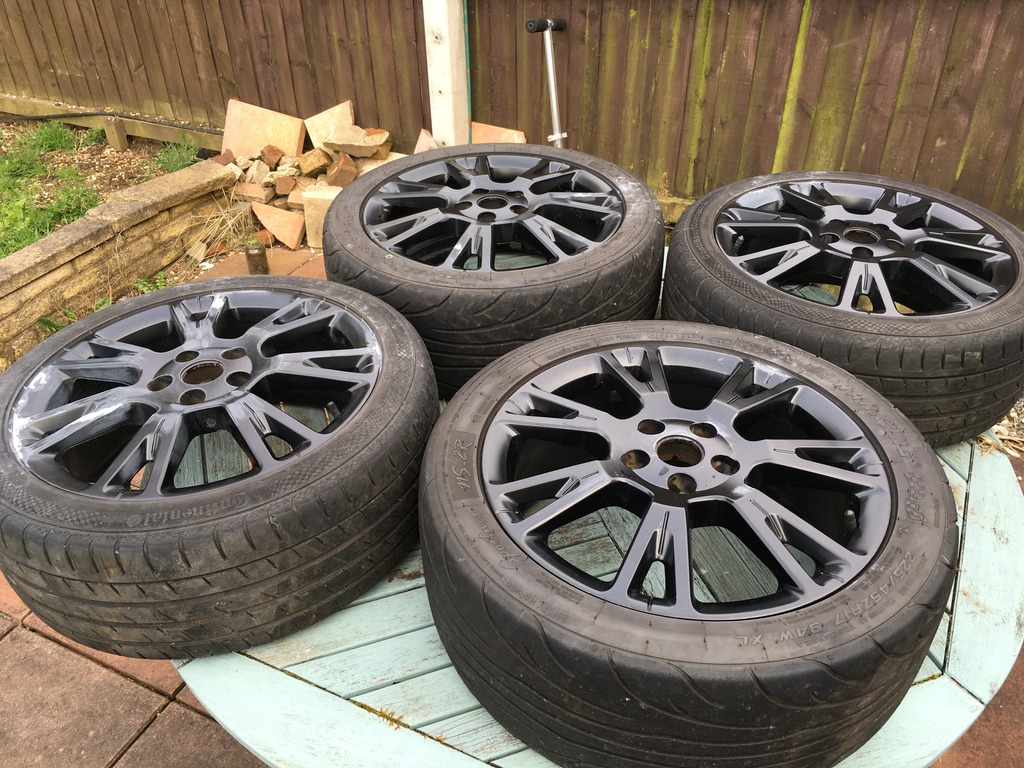

All in, I'm pretty chuffed at the filler job. They aren't perfect but I doubt anyone will notice once the paint is on... It took me a while to find the repaired sections myself.

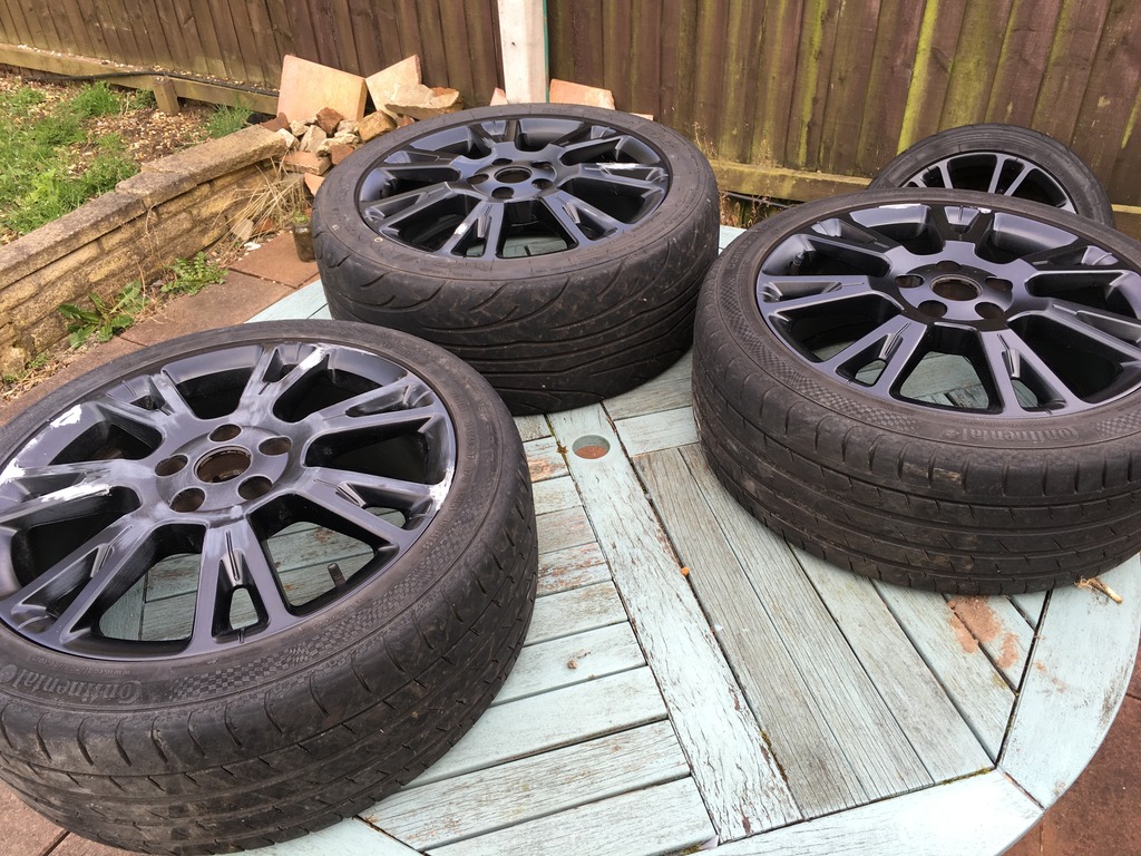

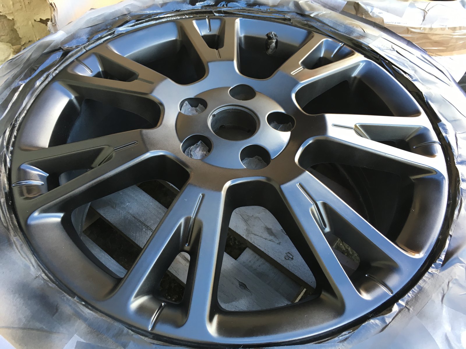

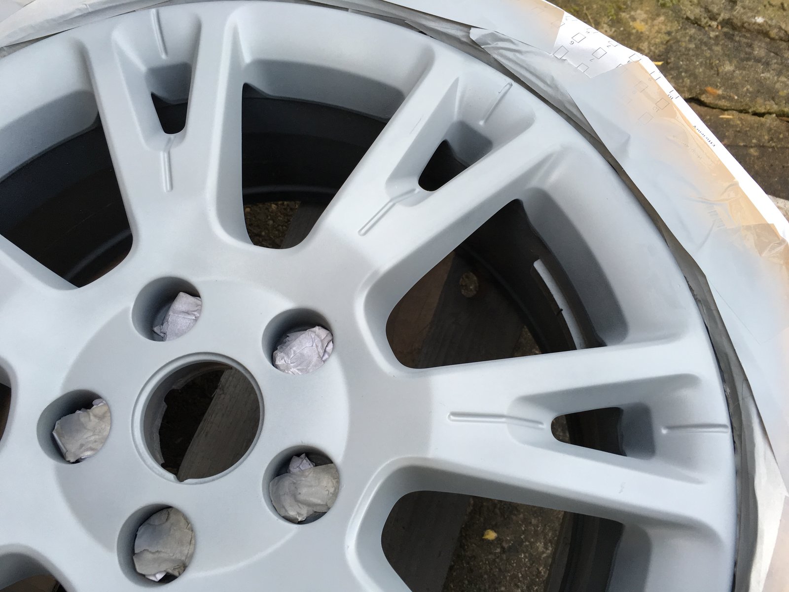

Here's today's efforts.

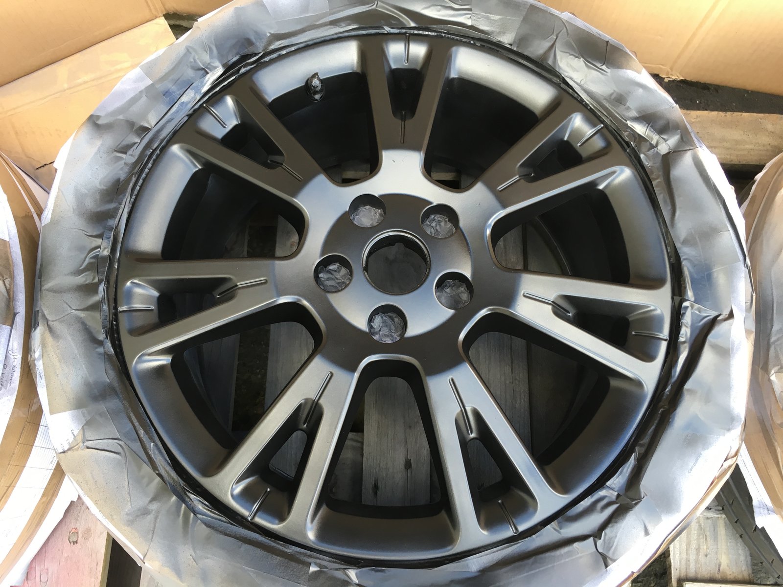

After the second coat of satin black
Exciting s**t
After they dried
This is the first one I unwrapped. I was half expecting a bit of tape to peel away a f**k load of the paint. Thankfully they all came out ace.

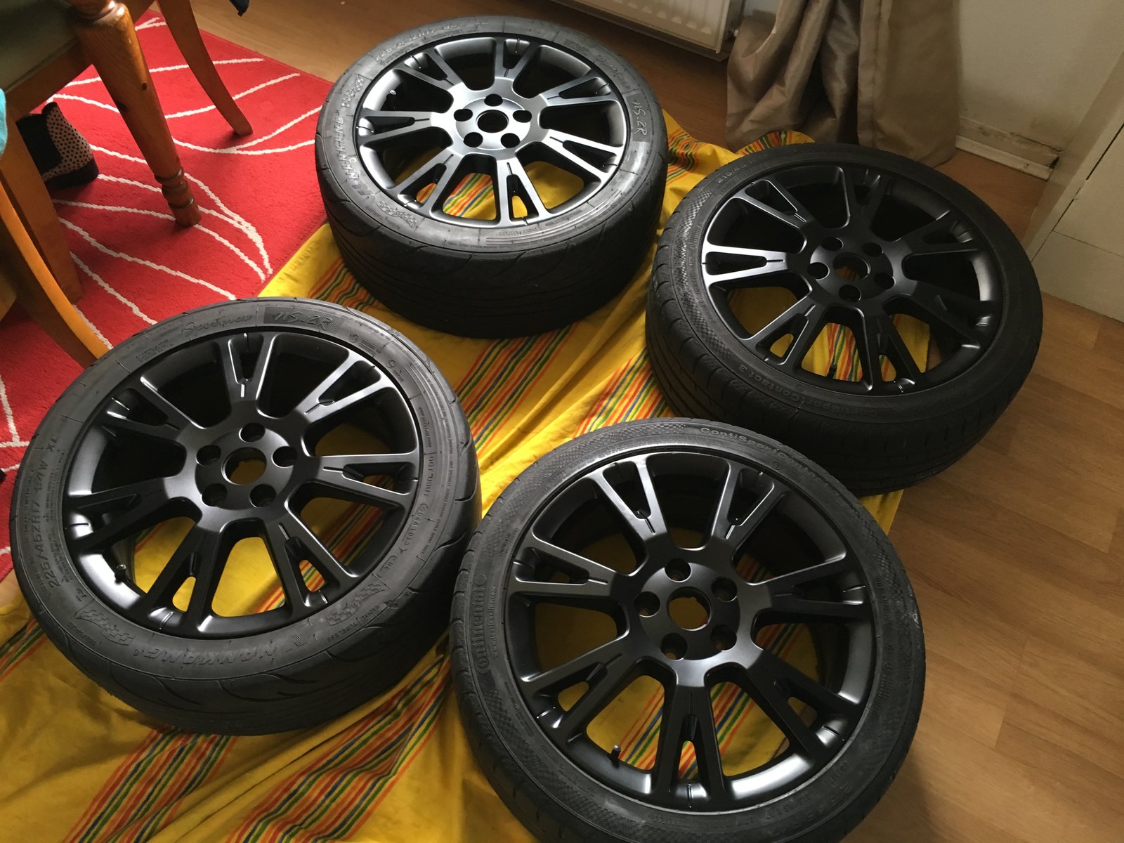

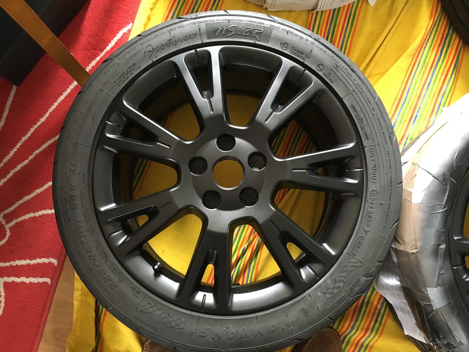

Four Mint* speedlines :smiley:
*mint if you don't inspect them with a microscope.

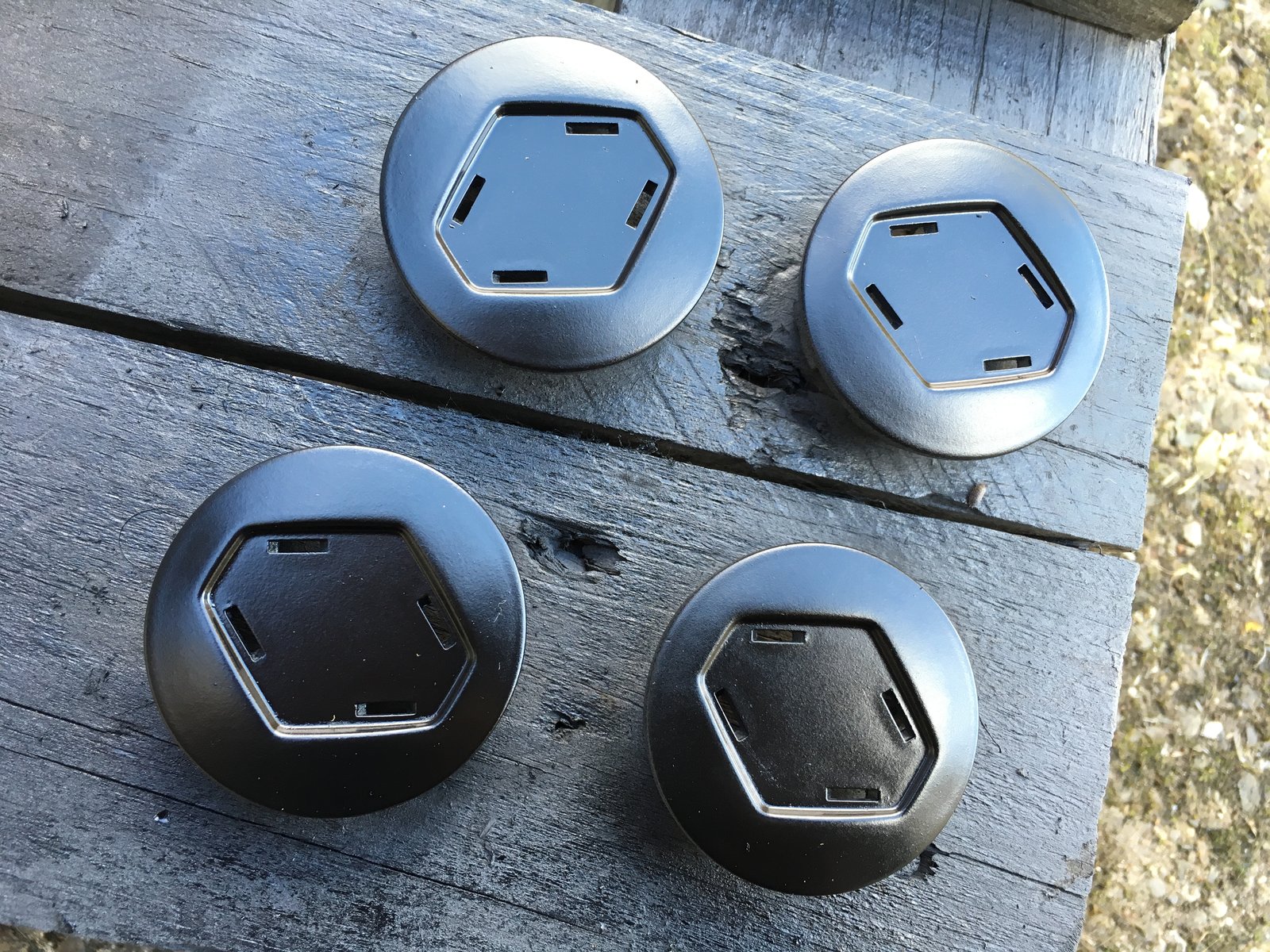

Centre caps done... Upside down for some reason. The diamonds are a bit minging. Hopefully some mild compound or autosol will save them next time I clean the car
One complete wheel.
Taking them to work tomorrow to get balanced then they're all ready for the renaultsport day on Friday :smiley:

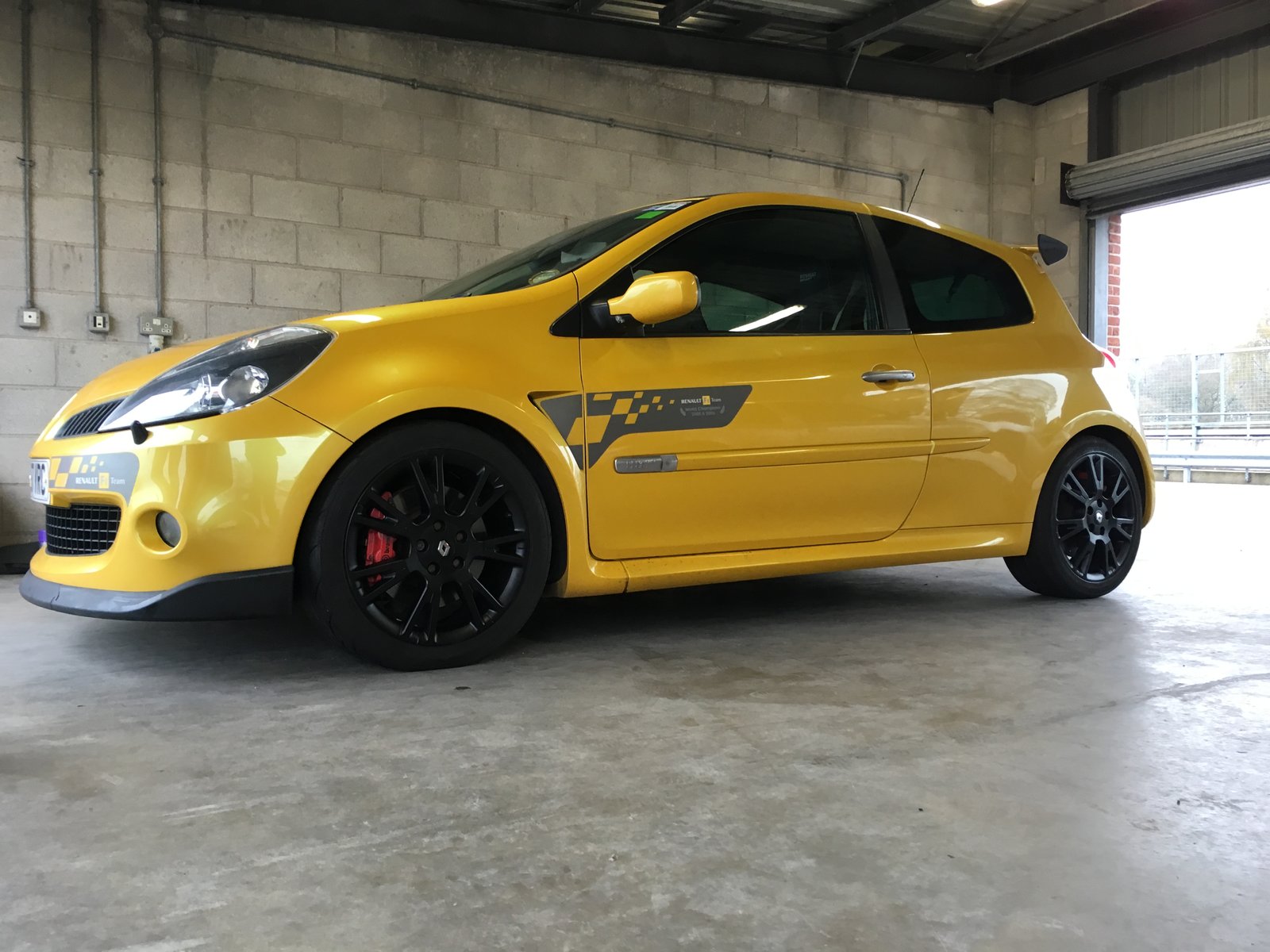

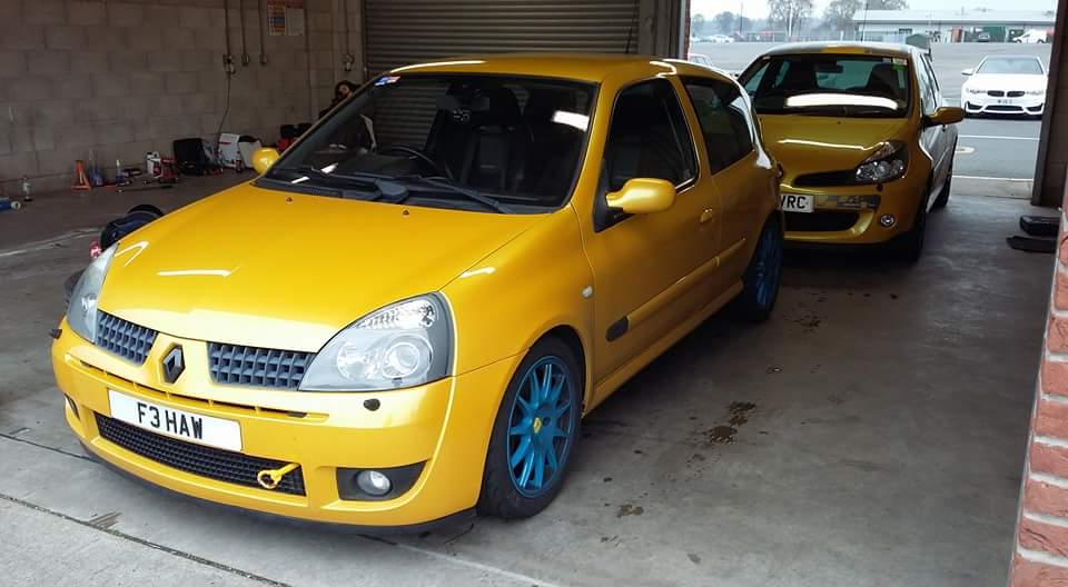

The car behaved brilliantly yesterday at oulton. The only problem was brake judder which got quite severe after a few laps. So upgraded pads are on the shopping list.

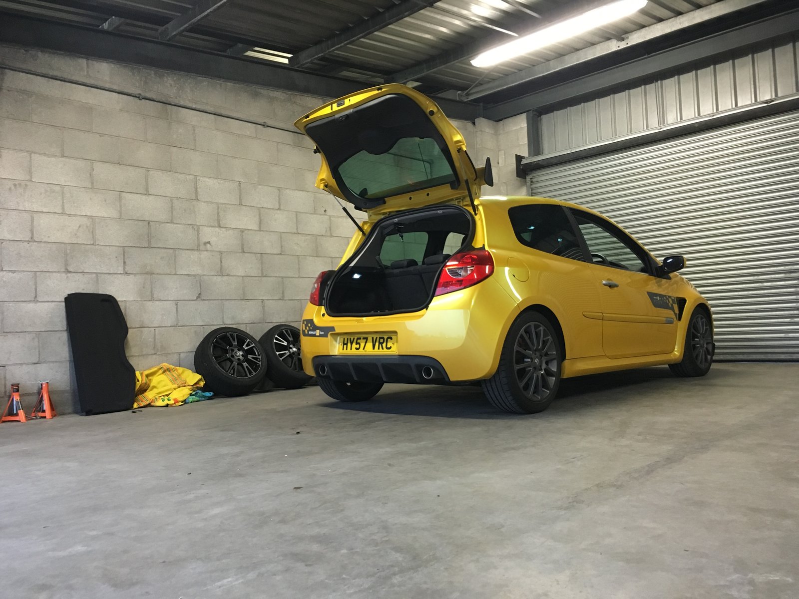

I arrived early and got everything unpacked.
The speedlines went on after the sighting laps. Full badman spec. Black looks uber gash and the car is crying out for spacers.
I love when mine and Tom's cars are together. LY ftw. And my friends M4 lurking in the background of the shot.
I'll have to get another couple of ns2rs for the rear of the Clio as they were pretty ace, even when they were cold they had more grip than the contis... Getting a bit sideways at lodge on the first lap. I got a bit too enhusiastic tbf.
As I thought, they were awful in the wet. I still couldn't touch Sarah and her friend in their 200s on wet tyres so I put the contis back on and let some air out. Which seemed to work, the car was more planted through every corner bar hizzys, so I gave up trying to go fast and started trying to just be smooth the chicane after a bit of coaching from @p@blo. Which resulted in some skids. The Clio is such a fun car to get moving around at relatively low speeds.
