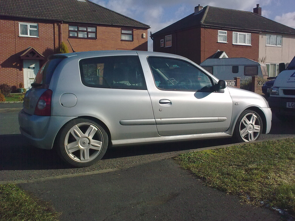

  Renaultsport Clio 172 Cup
Mine are great, really pleased with them. I have been on them for about 800 miles now so will be returning to Fred when he is available to set them up accordingly.
Stiffer than standard suspension but not unbareable, but feel alot more grounded, corners alot better.
I have mine with 17's on at the moment, back is all the way down I think, and fronts are probs halfway+, I only get a little rub when cornering a roundabout hard, and when I am 3 up in the back and go over a stupidly sized pothole.
Hopefully getting 16/15"s soon so this will improve greatly, and looks wise I will let you decide for yourself ;)
Taken only a couple of days after having them fitted, so they have settled a bit more now.
  172 with k-tec sound
they look awesome mate, the height looks perfect to me, they settle pretty quickly by the souns of it

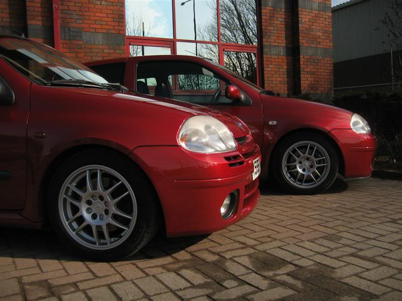

They feel like the softest aftermarket suspension I've ever owned and considering how low the car is it doesnt feel much stiffer than standard. I supoose for normal road driving thats actually a good thing. Would be great if tehy were damping adjustable for when you want to be more 'spirited' but of course they then wouldn't be as cheap.
One thing I would say to people to watch out for is to not go this low
(Closest one)
As they driveshafts have rubbed against the chassis when cornering so I'll need to raise it, planned to anyway so no great hardship!
yeah will watch out for that mate thanks, just want her lower than she is at the mo, plus my rear shocks are leaking so i needed them anyway.
